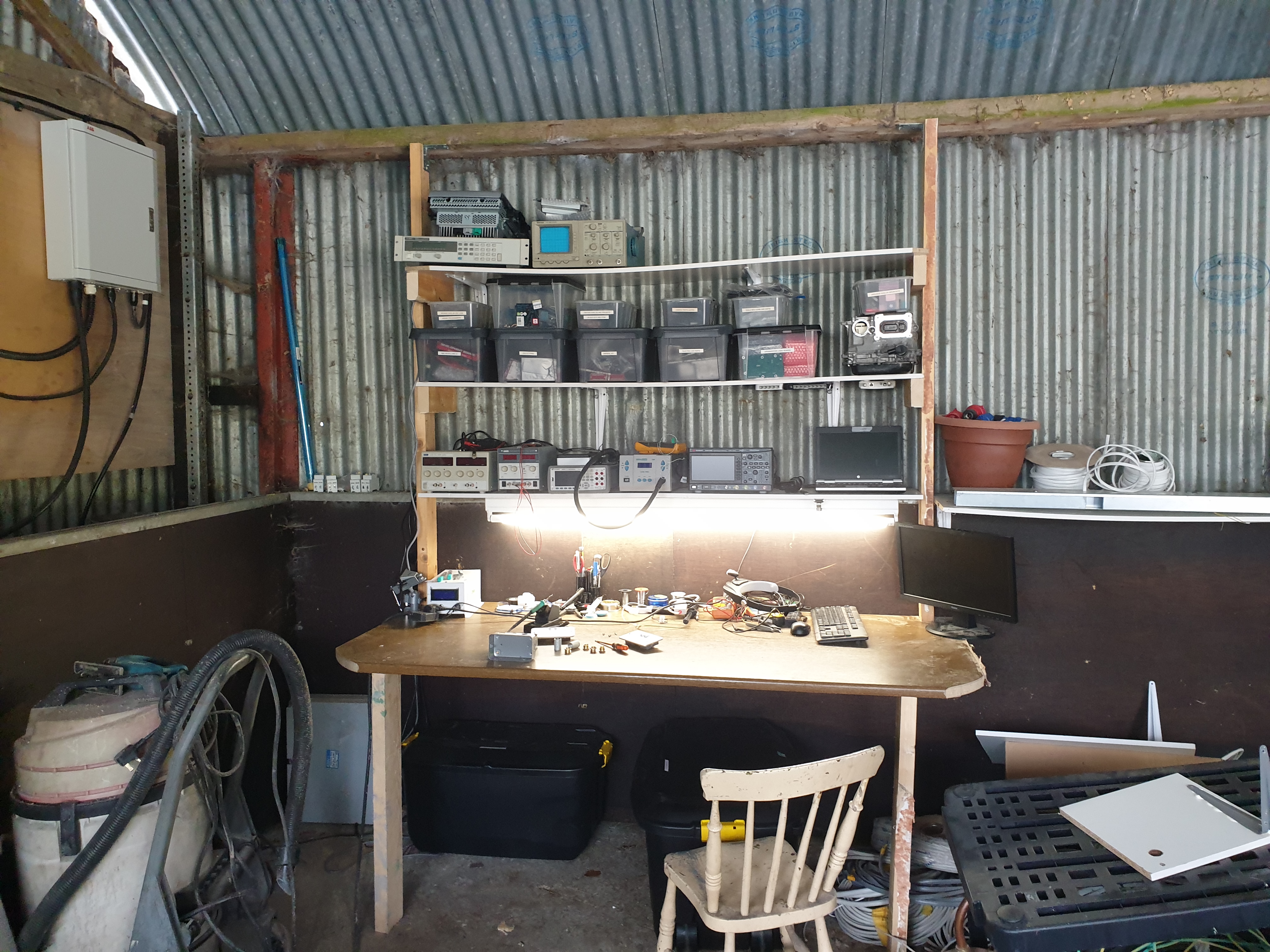

I'm slowly getting the new workshop up and running so will be able to troubleshoot these various bugs out of the system as well as continue development on new features. I appreciate folks bearing with me in what was a real nightmare of a time moving house and home particularly over the last few weeks. My feet are just beginning to touch the ground the past few days.

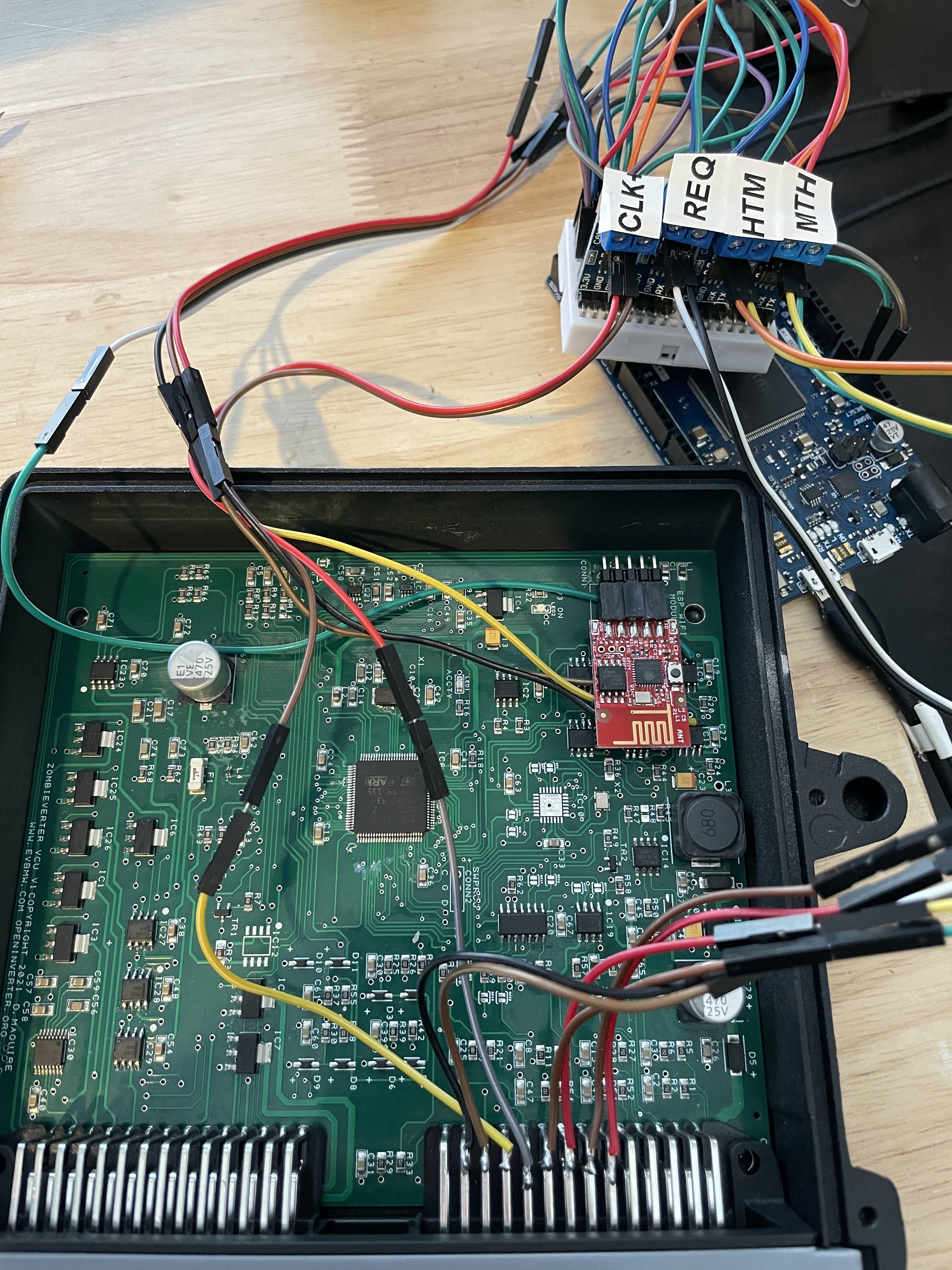

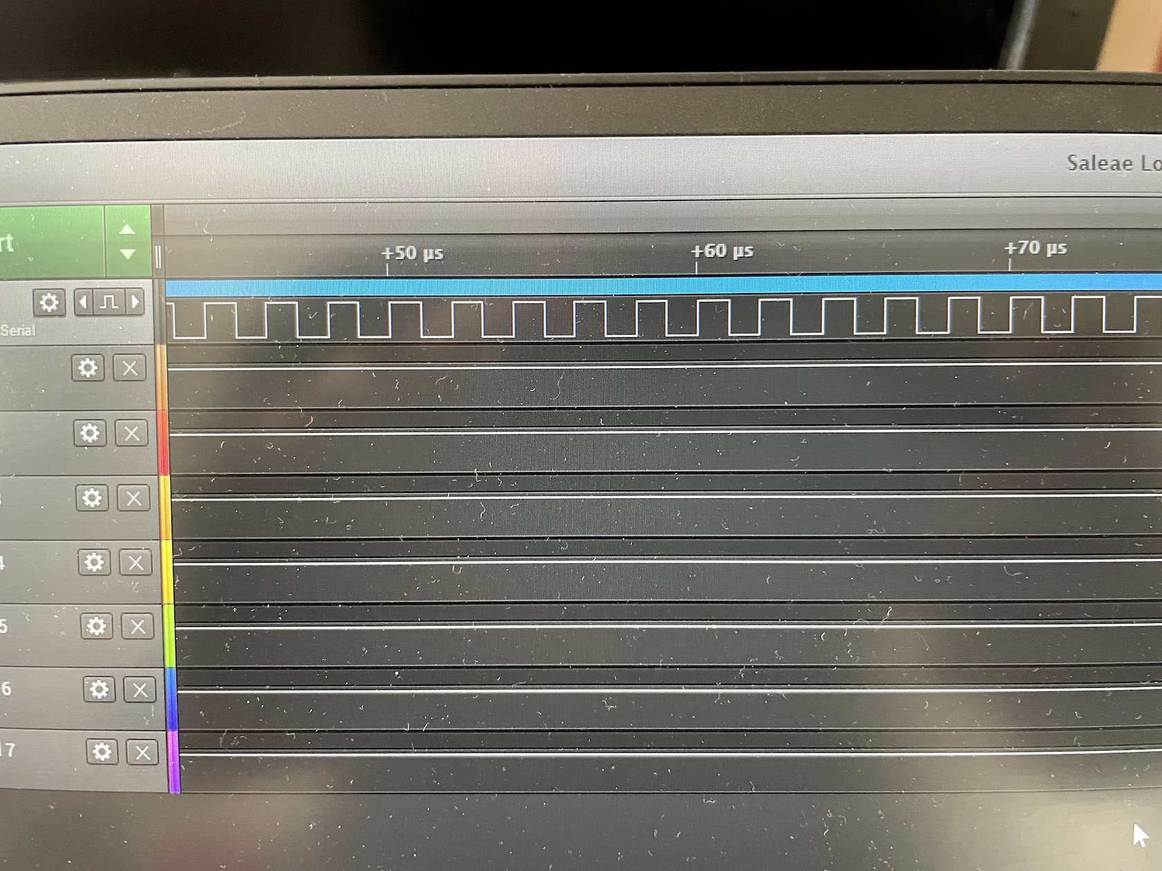

I can't get the sync serial working in my kit. No pulses on CLK, REQ and HTM.
I used a logic analyser to check the input on pin1 for IC18 (CLK) and it's receiving input: Is there a trick in getting the can transceivers to work?
Could the can transceivers in the kit be faulty?

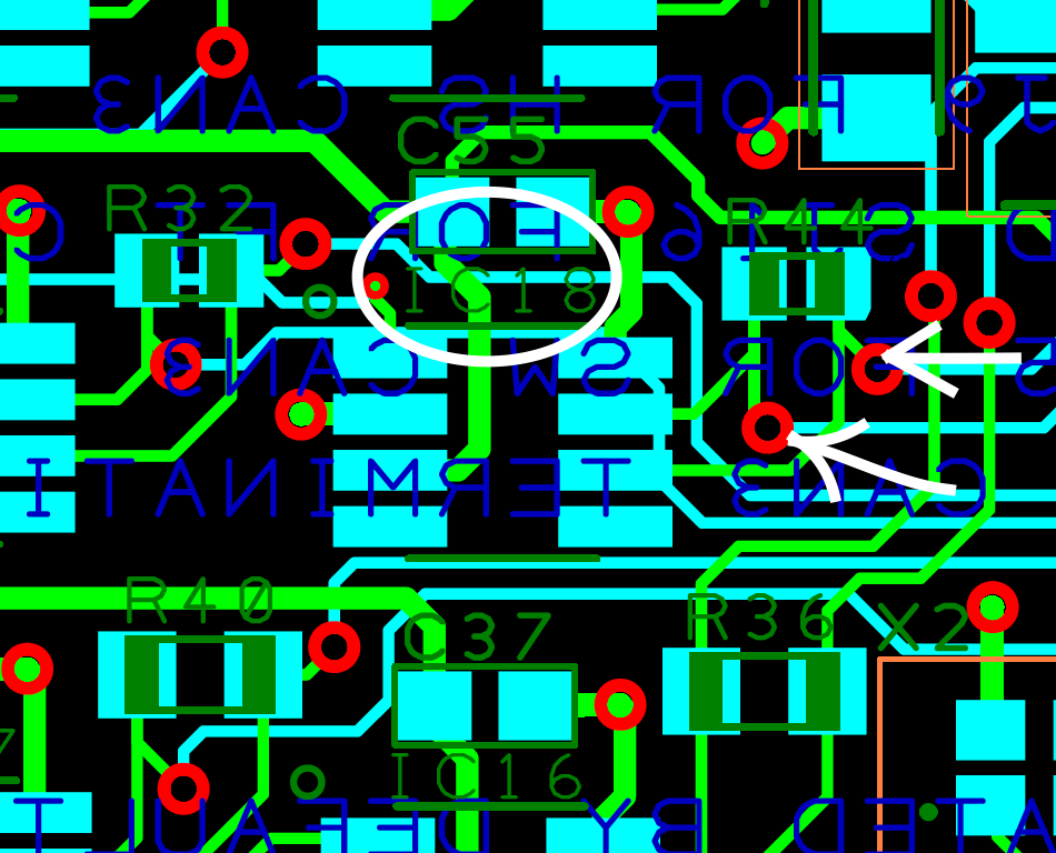

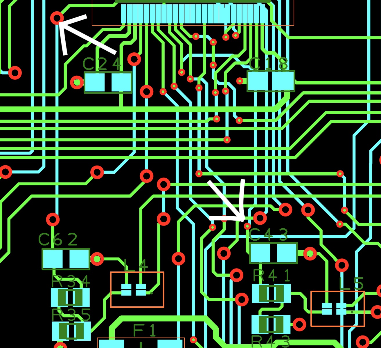

Thanks. I checked and the wiring seems fine.EV_Builder wrote: ↑Sun May 01, 2022 5:49 amCheck wireing first. Who is supplying the clock?Zechy wrote: ↑Sun May 01, 2022 3:24 am I can't get the sync serial working in my kit. No pulses on CLK, REQ and HTM.
Is the inverter switched on?
I then measured at the white arrows and didn't get any CLK+ and CLK- signal: Then I used external can transceiver modules between the input pin 1 and the 56pin connector: The syncserial then gets to the inverter and I get data back on the MTH cables.

Pohh good job. Then it's time to check orientation?

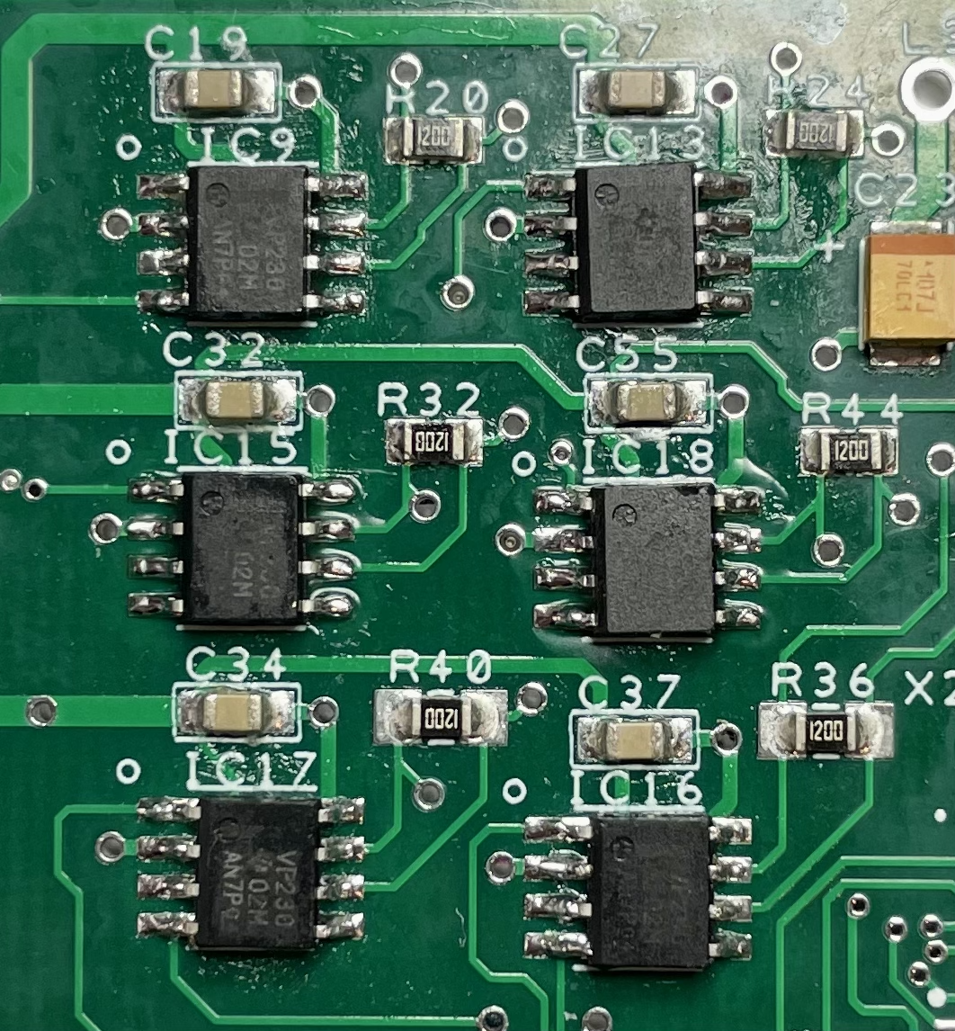

Think the transceivers are bad, as im having the same issues.
Fed CAN to 2 of them and received nothing the other side
Fed the same CAN to 2 known working ones (from another project) and received the other side as expected.

Yes I supplied the can transceivers as due to this nonsense chip shortage JLC and any reputable sellers such as Mouser not only don't have any but wont even say when they will and no doubt I've gotten bitten by fakes. Again. I caught one batch on testing. Anyone affected by this let me know and I'll sort replacements once I find another source.
