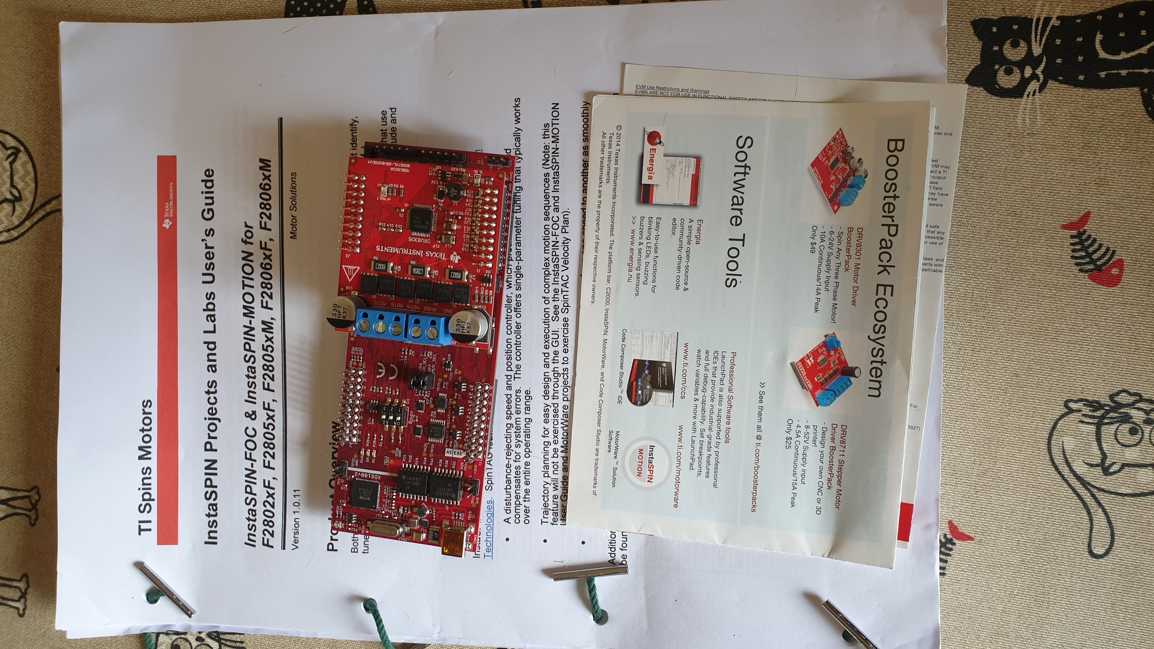

Posts: 4005
Been thanked: 1129 times
Yeah true. Would grab one myself but not a free penny these days thanks to house purchase. In related news I did get this nice little donation from a patron.
