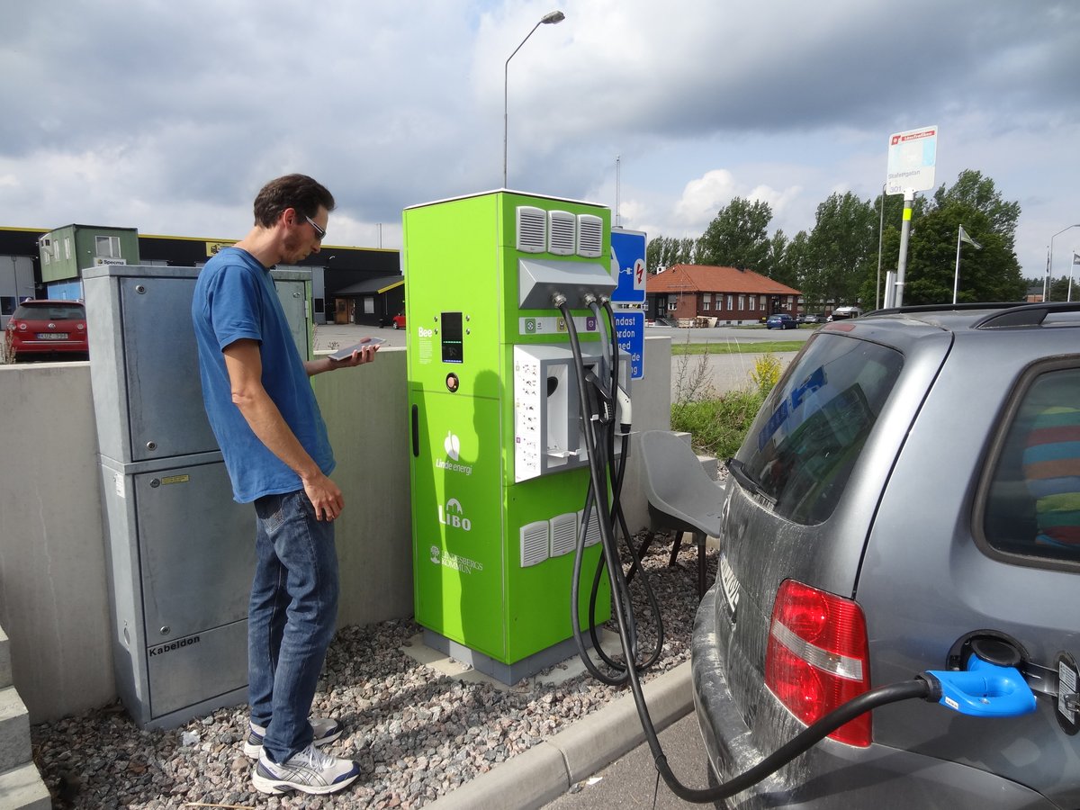

So we completed our journey yesterday and it was 4250 km. I used the apps to reconstruct the energy used off payed chargers and my faint memory for all others:
  • Payed kWh: 376
  • Free kWh: 297 (94 from free fast chargers, others from Schuko)
  • Total kWh: 673
  • Average consumption: 158 Wh/km

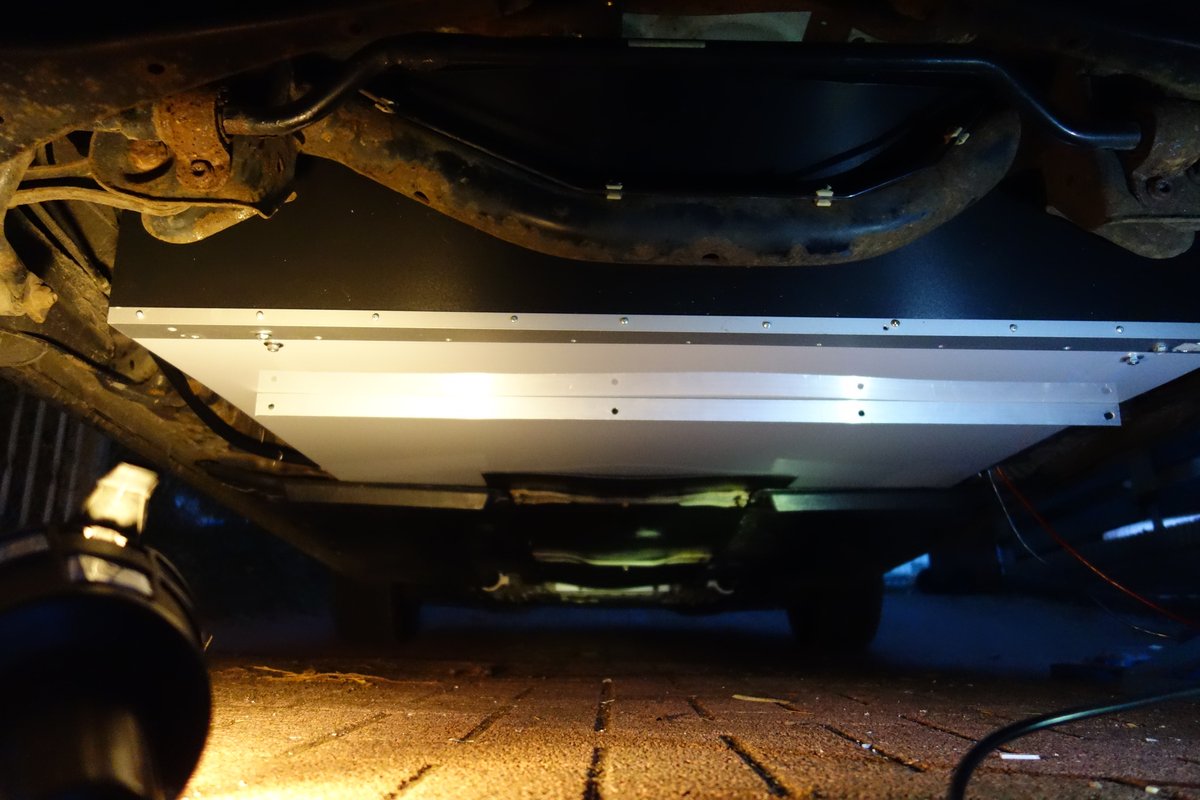

The car held up very well, only damage was the smashed battery under cover caused by a rock on a gravel road. I had some rapidgating problems when doing more than 2 full quick charges per day. Also while driving in heavy rain the LBC went crazy and suddenly commanded a 25 kW discharge and 13 kW charge power limit despite the battery not overheating. Not sure what exactly happened there but the problem went away after everything had dried.
Also poor mans charger died a couple of times limiting overnight charging.
I really have to do something about waterproofing and rock proofing my battery pack. Folded 1mm sheet metal is one idea. And I should add a fan to provide at least a bit of cooling. Not great, but least effort.

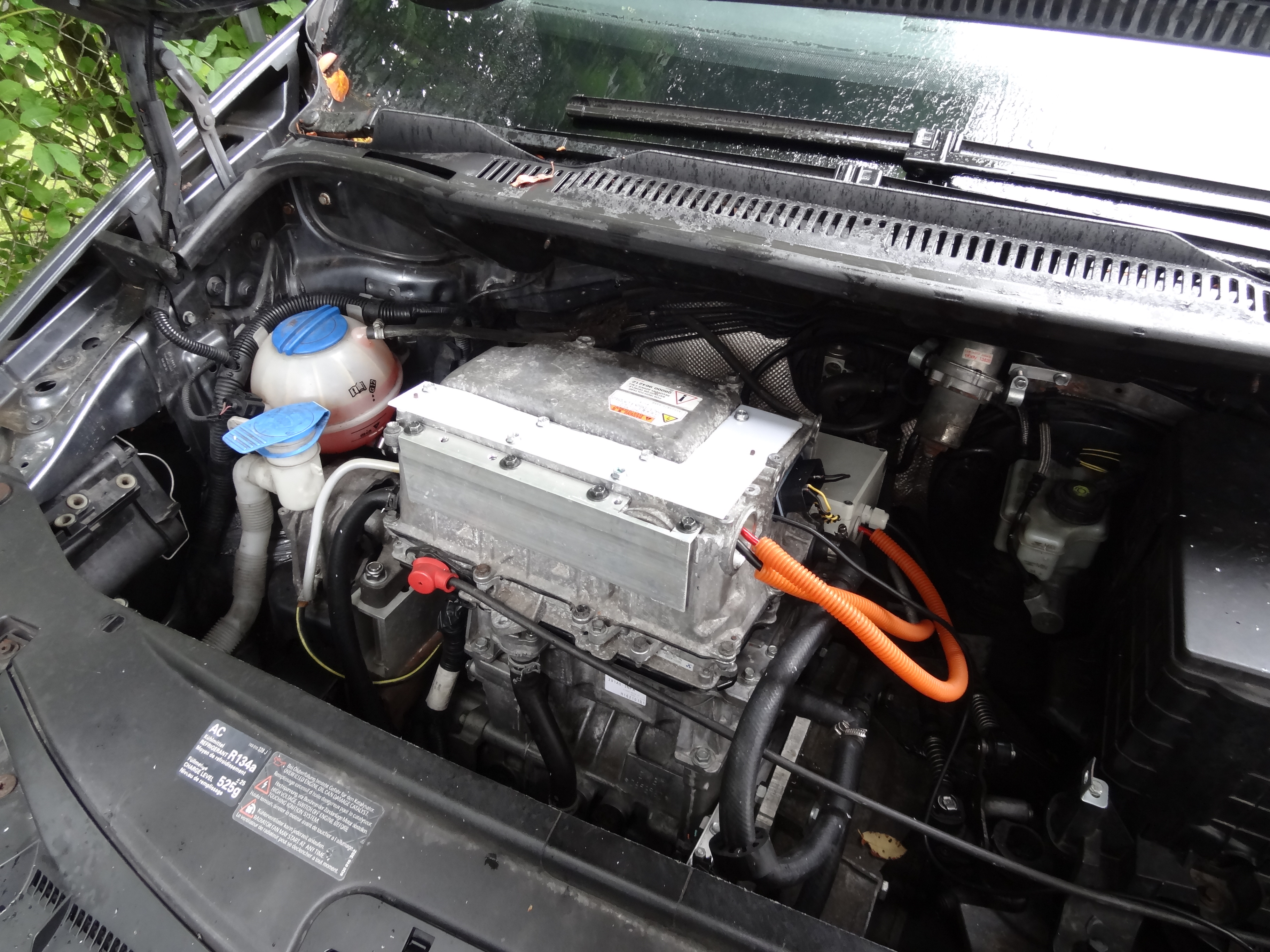

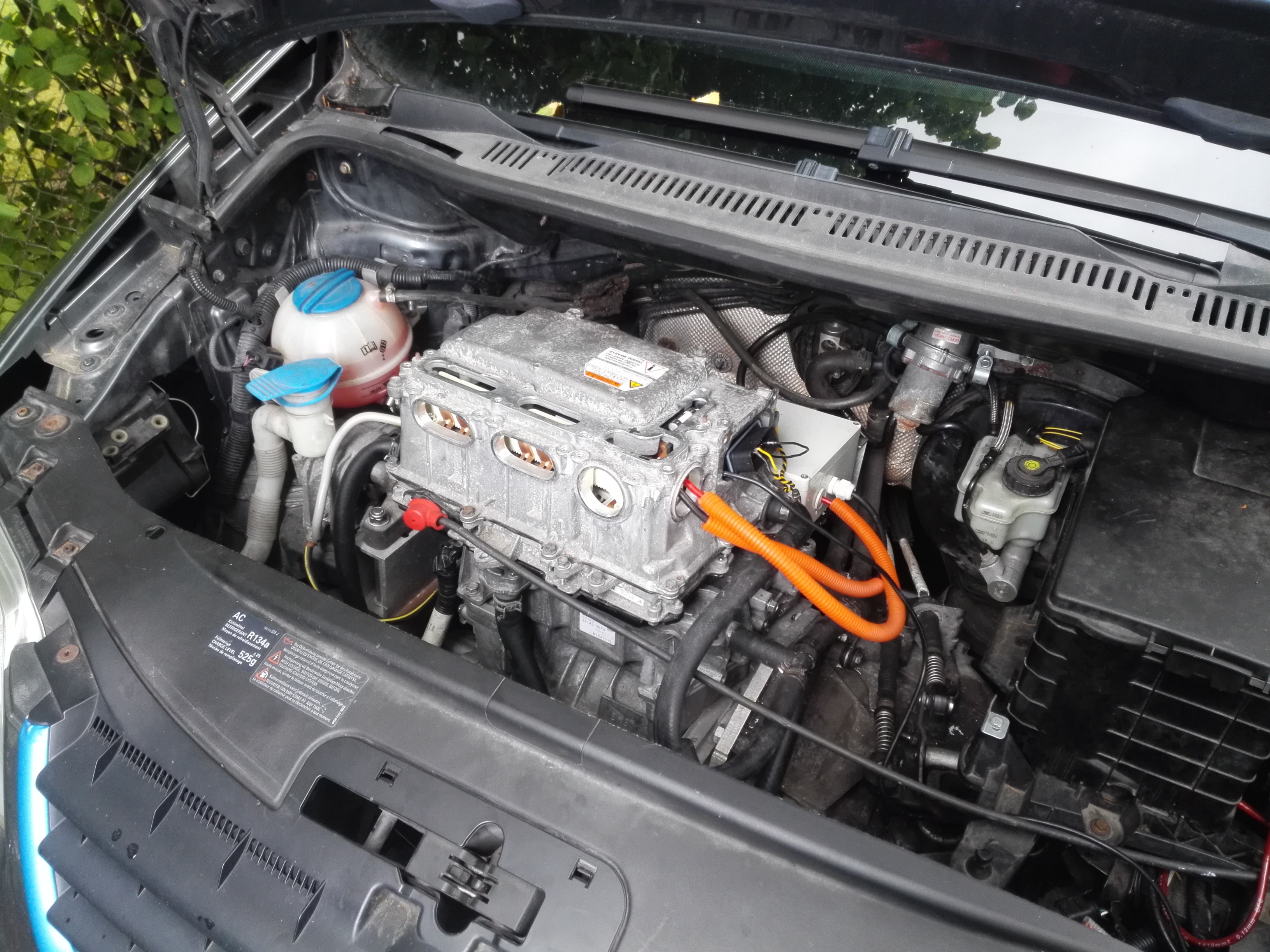

Mounted a Gen3 inverter on top of the Leaf inverter. Currently I'm only using the DC/DC converter but will use it for 3-phase charging and for providing 230V AC.
It runs a dual motor board that I modified a bit:
  • DC/DC converter voltage mod so it runs off 400V
  • Pulled up IGCT with 560R and pulling that down with the precharge pin, so DC/DC is enabled when precharge drops out
  • Soldered another CAN transceiver on top of the existing one to have MG2 CPU on the CAN bus (up until now I didn't realize it has no external connection)
  • Changed the firmware to enable precharge in the bootloader and to drop it out after some delay after entering run mode
Now I need to close off the various holes and mount the logic connector properly. Will probably use a much smaller one as I only need 12V, CAN and the EVSE signals.

Interesting. I would love to get my Prius Gen2 convertor to run MG1 and Mg2 AND do charging.. 😁

johu wrote: Sun Aug 22, 2021 9:37 am Mounted a Gen3 inverter on top of the Leaf converter. Currently I'm only using the DC/DC converter but will use it for 3-phase charging and for providing 230V AC.
You think we could also use Gen2 as a charger?
Been thanked: 1913 times
arber333 wrote: Sun Aug 22, 2021 11:28 am You think we could also use Gen2 as a charger?
Yes, just as well.
Running 2 motors AND do charging would require a separate rectifier

No it will be 3phase charging only application. Do you think it could be done solely with your control board? Or woud charging require more changes?
I am thinking of putting Gen2 inverter under the rear seats on the rght side where i had one of Outlander chargers now. It is of a good profile to fit under rear seats and mounting points are simple sheet metal which will allow me to fasten it in the same way...
Anyone have any outside measurements for Gen2 inverter? I dont have it here yet.
Any pics of this?

chrskly wrote: Sun Aug 22, 2021 3:42 pm Any pics of this?
No, forgot. Well next time I take the cover off. Removed some 0 ohm resistor and soldered a write to RX and TX. The transceiver literally sits on top of the existing one and connects to pins 2, 3 (power) and 6, 7 (canh, canl)

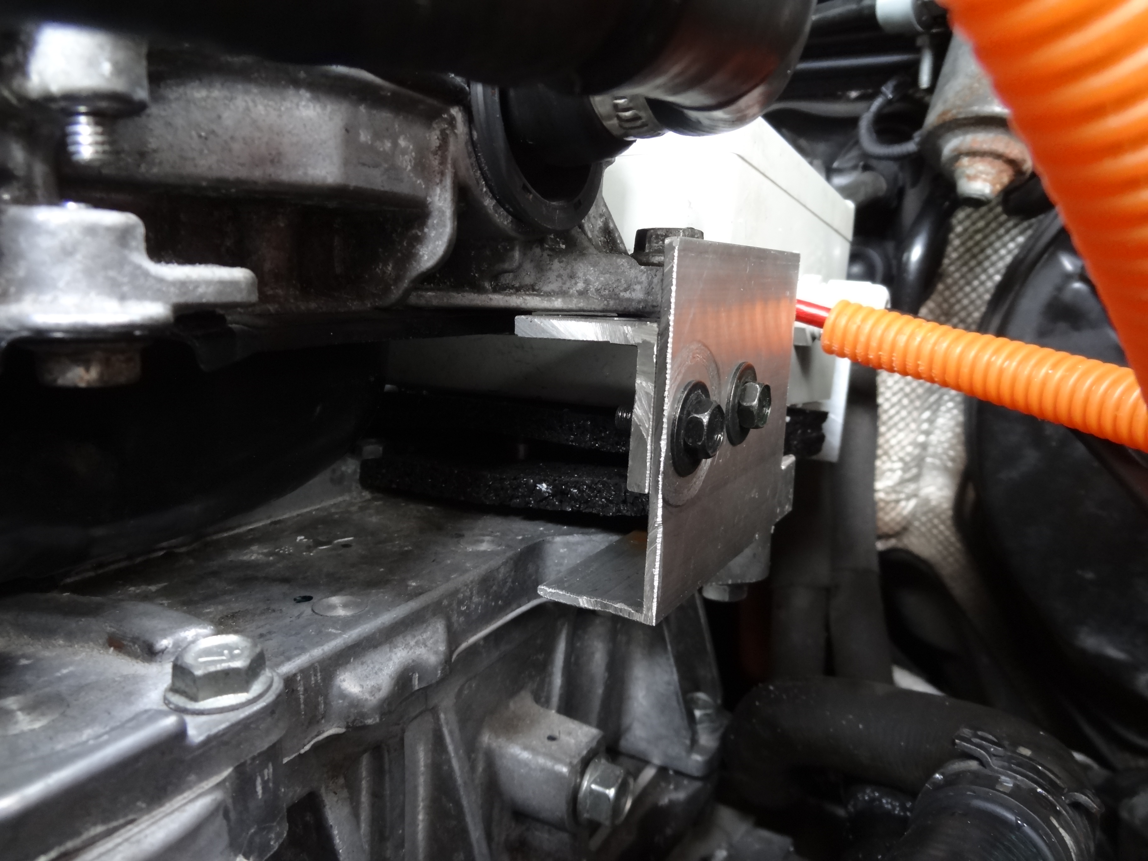

Made another bracket and closed off the connector holes. Will put cable glands in there later and some seals as it's not yet waterproof.
