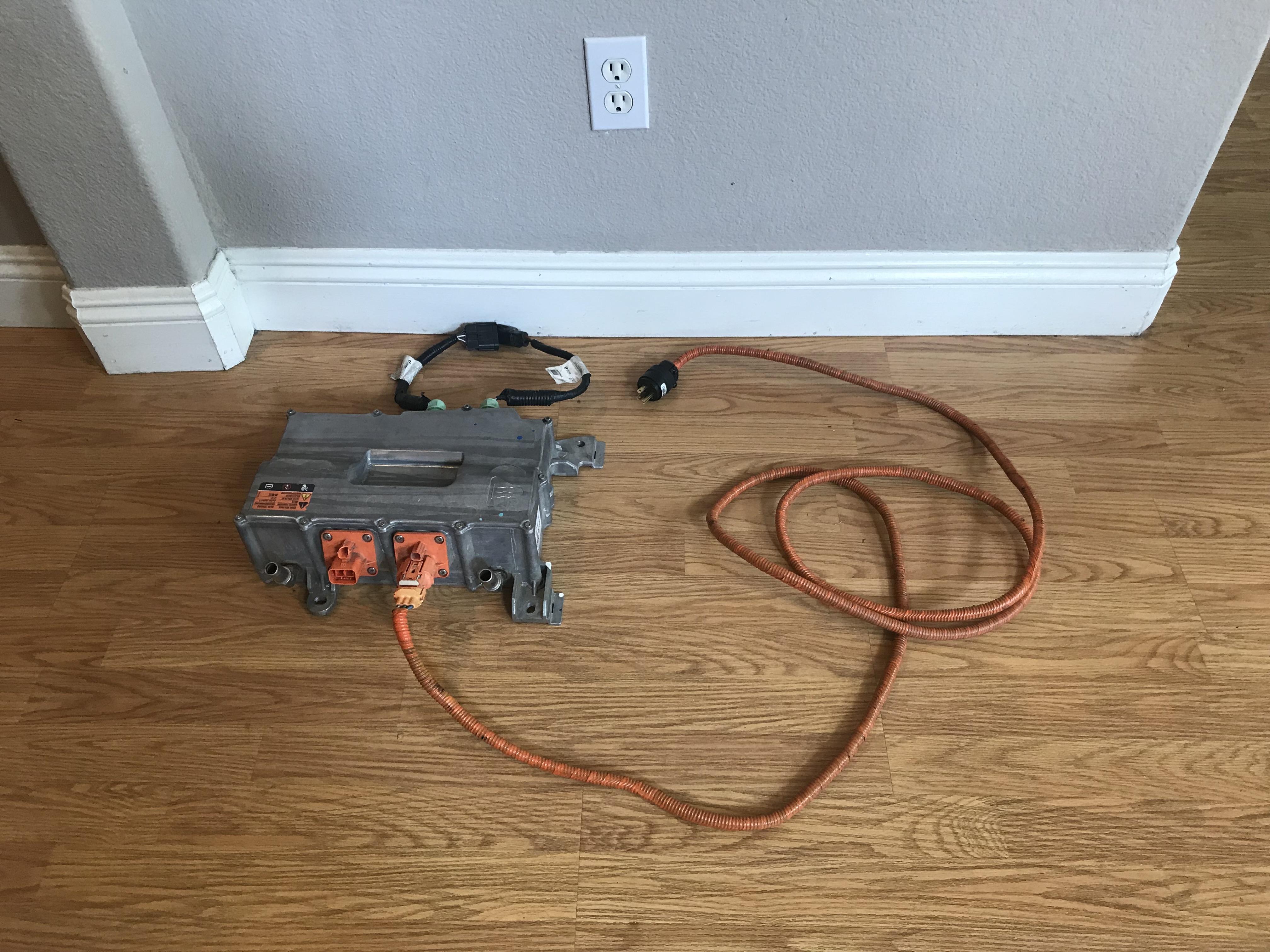

Posted: Mon May 02, 2022 6:55 am
by Gregski
and we got ourselves a dime a dozen regular US 120 volt (pronounced: "one ten") 15 amp power cord, perfect for some troubleshootin'
