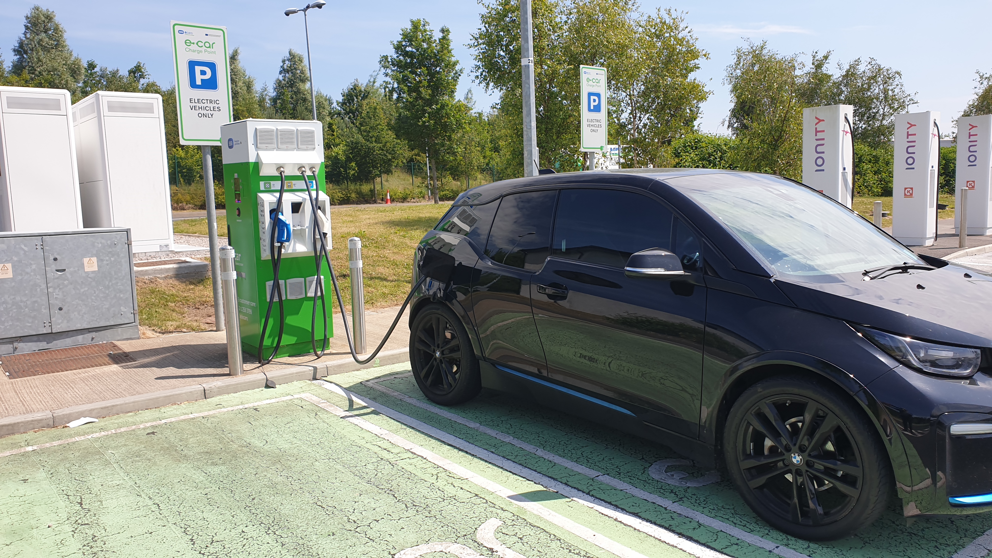

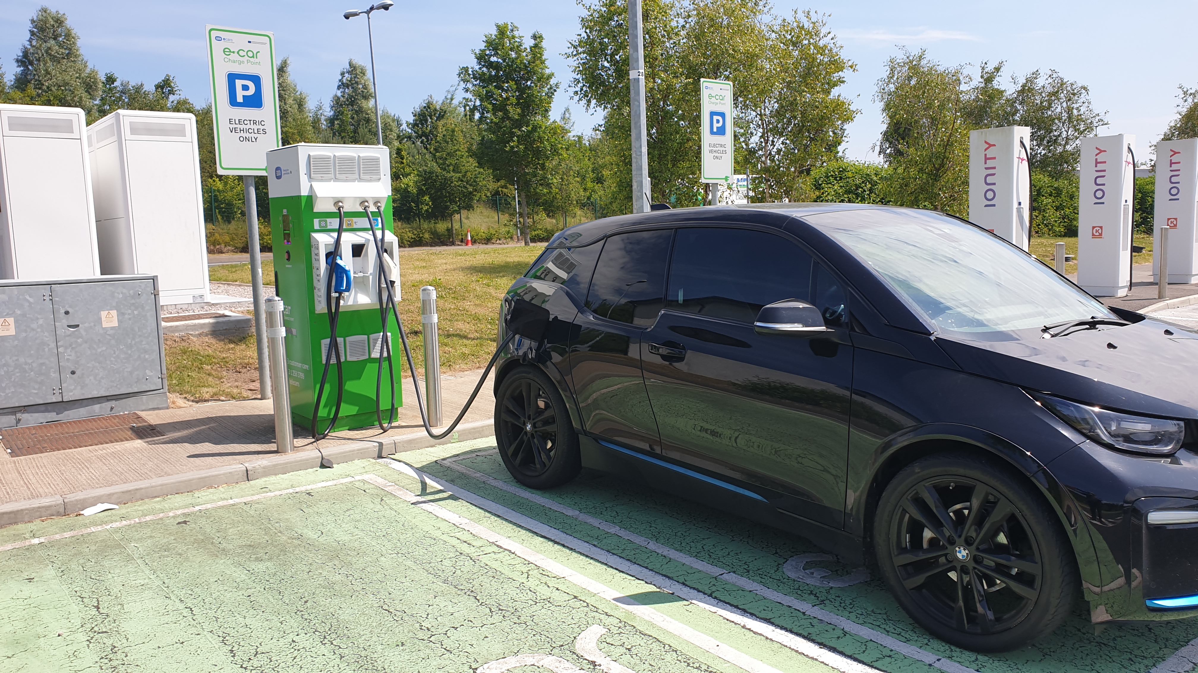

Yeah I've heard of that. PlugCharge I think its called. Thing is we never get to TCP comms on Ionity for it to even look for data like that. Here are the exact steps in the sequence.
1)open cp door
2)plug in. At this point car wakes, 5% not ready pilot is detected.
3)Authenticate with app or rfid tag
4)station displays "Charging will commence once power is available"
5)After approx 1 min station times out and pilot goes static. Station reports "comms error. Car must be switched off" pictured above.
If I open door and authenticate BEFORE plugging in it will go to the "Charging will commence once power is available" screen the instant the plug is inserted and times out as above.
tomorrow I'll feed the car 5% pilot here at home and see if anything pops up on spi.
1)open cp door

Here is the answer from ionity: (you propably have seen this...)Jack Bauer wrote: ↑Tue Jun 29, 2021 6:15 pm Yeah I've heard of that. PlugCharge I think its called. Thing is we never get to TCP comms on Ionity for it to even look for data like that. Here are the exact steps in the sequence.
1)open cp door
"Recommended action: Move the connector/plug up slightly and push it firmly into the car's charging port. Hold the connector/plug firmly in the car's charging port for a few seconds, until it gets locked. In case of a problem, please unplug the connector/plug from your car and return it to the charger. Restart the process."
Hint, until it gets locked.
(...But)
I have actually seen this type of "hold the cable" thing in Teslabjörns videos too, and IIRC there once was a brand new car he tested that had a problem that the plug had to be supported until it locks or it didn't start..
And I have a "dejavu" type feeling I have done this once on a Tesla supercharger quite recently when it didn't start at first, took off plug, retried with holding the plug slightly upwards and pushing in and then it worked.
May sound too easy, but doesn't cost to test of not done yet.
(I would think it may actually want a car side confirmation about power available on car side of the plug and it doesn't work if it has any contact issue?) It just sounds like that to me.

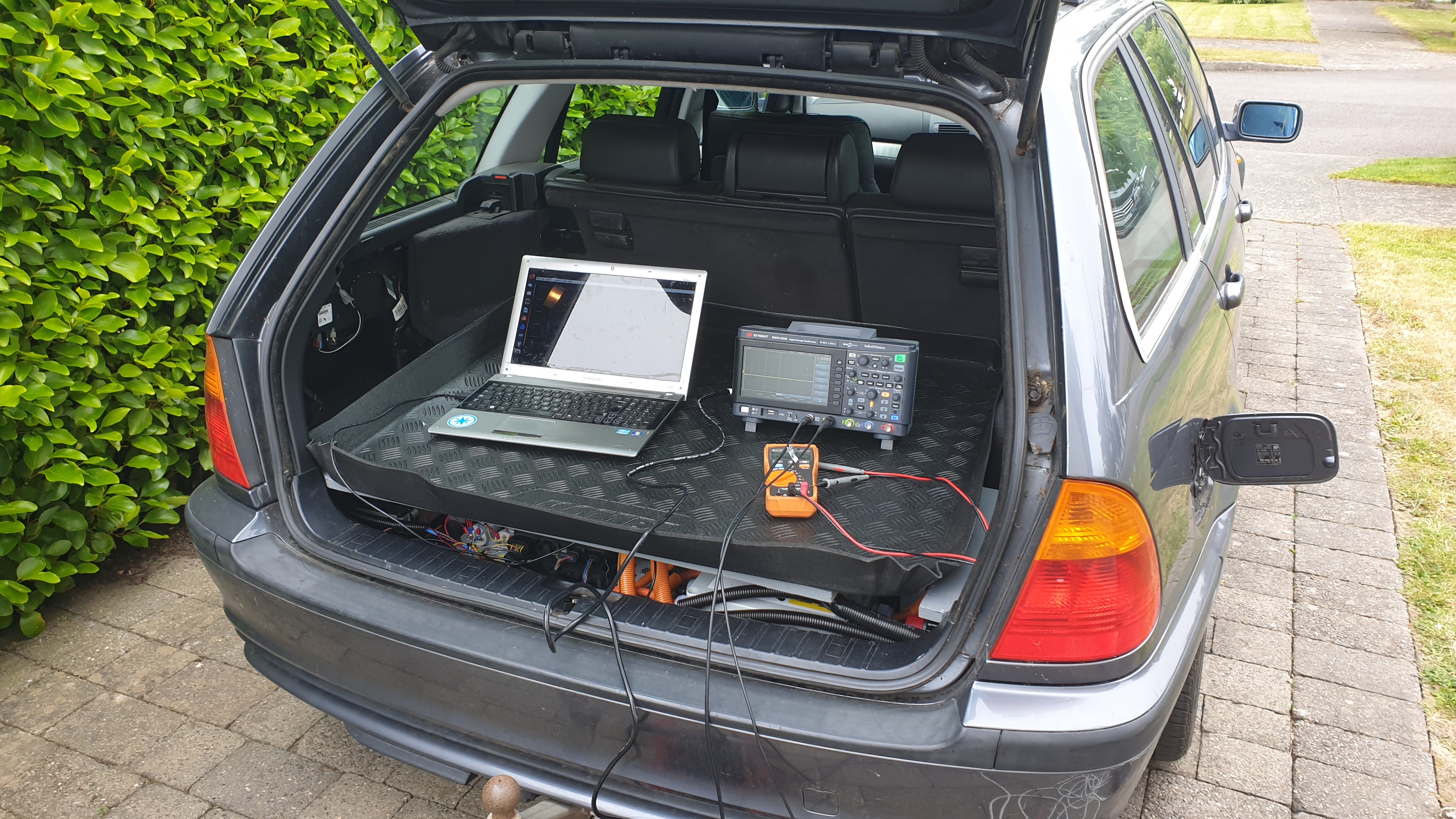

Logs now on the repo for the Circontrol Rapiton 50 with the 2019 i3 :
https://github.com/damienmaguire/BMW-i3 ... C-charging
- Posts: 3563
- Been thanked: 87 times
Hit the E46 with some 5% pilot. SPI cap here :
https://github.com/damienmaguire/BMW-i3 ... dc_e46.sal
- Posts: 216
- Has thanked: 15 times
- Been thanked: 38 times
Interesting. Had a squint at the capture and I see 3 CM_SLAC_PARM.REQ broadcast packets coming from the LIM. So it looks just like the beginning of the HomePlug/PLC startup sequence. The Ionity captures never get this far... So they are being out performed by a resistor and a signal generator. Weird.
