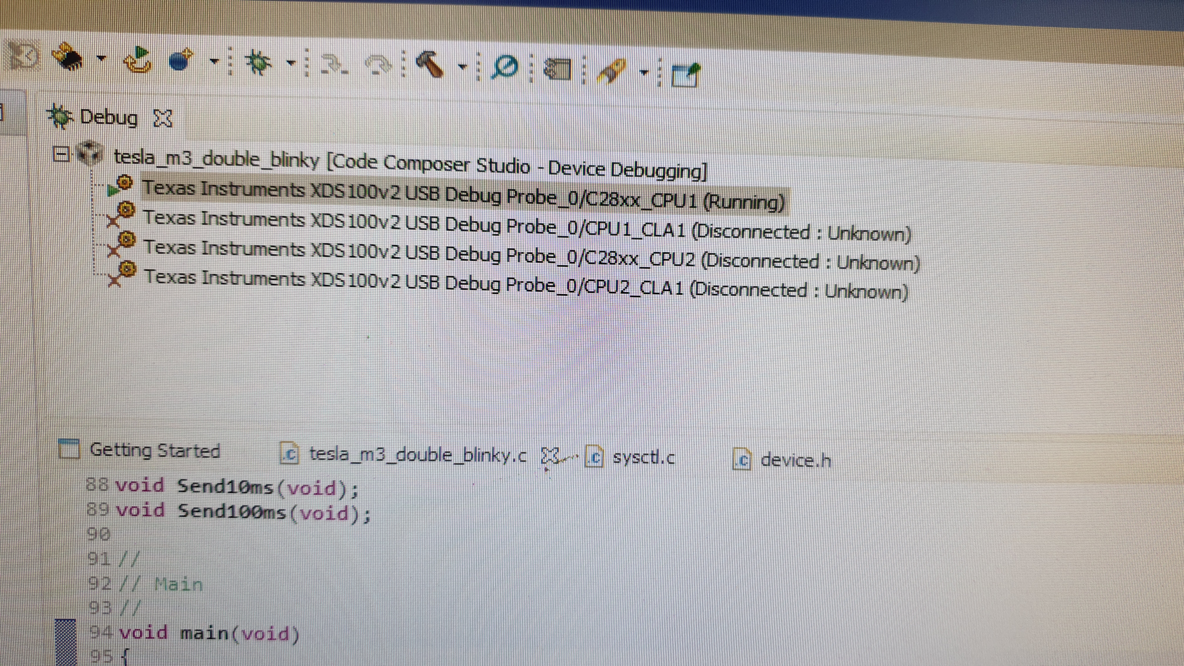

Good news : Harvested a FT2232 from a dev board, soldered to the jtag adapter, programmed and presto we are talking to Elon. Push fits perfectly into the horrible jtag socket.
Bad news : Design flaw! That 1k pull down resistor on ADBUS5? Should have been ACBUS5!! Gahhh. Anyway. Boards are fairly cheap from jlc without the ft2232 so I'll fix and order a fresh batch.

Jack Bauer wrote: Mon Oct 18, 2021 2:52 pm Bad news : Design flaw! That 1k pull down resistor on ADBUS5? Should have been ACBUS5!! Gahhh. Anyway. Boards are fairly cheap from jlc without the ft2232 so I'll fix and order a fresh batch.
Sorry about missing that when I reviewed. That was my design fix too... :(
Posts: 4005
Been thanked: 1129 times
No worries Dave:) new boards ordered. At least we know it all works other than that.
