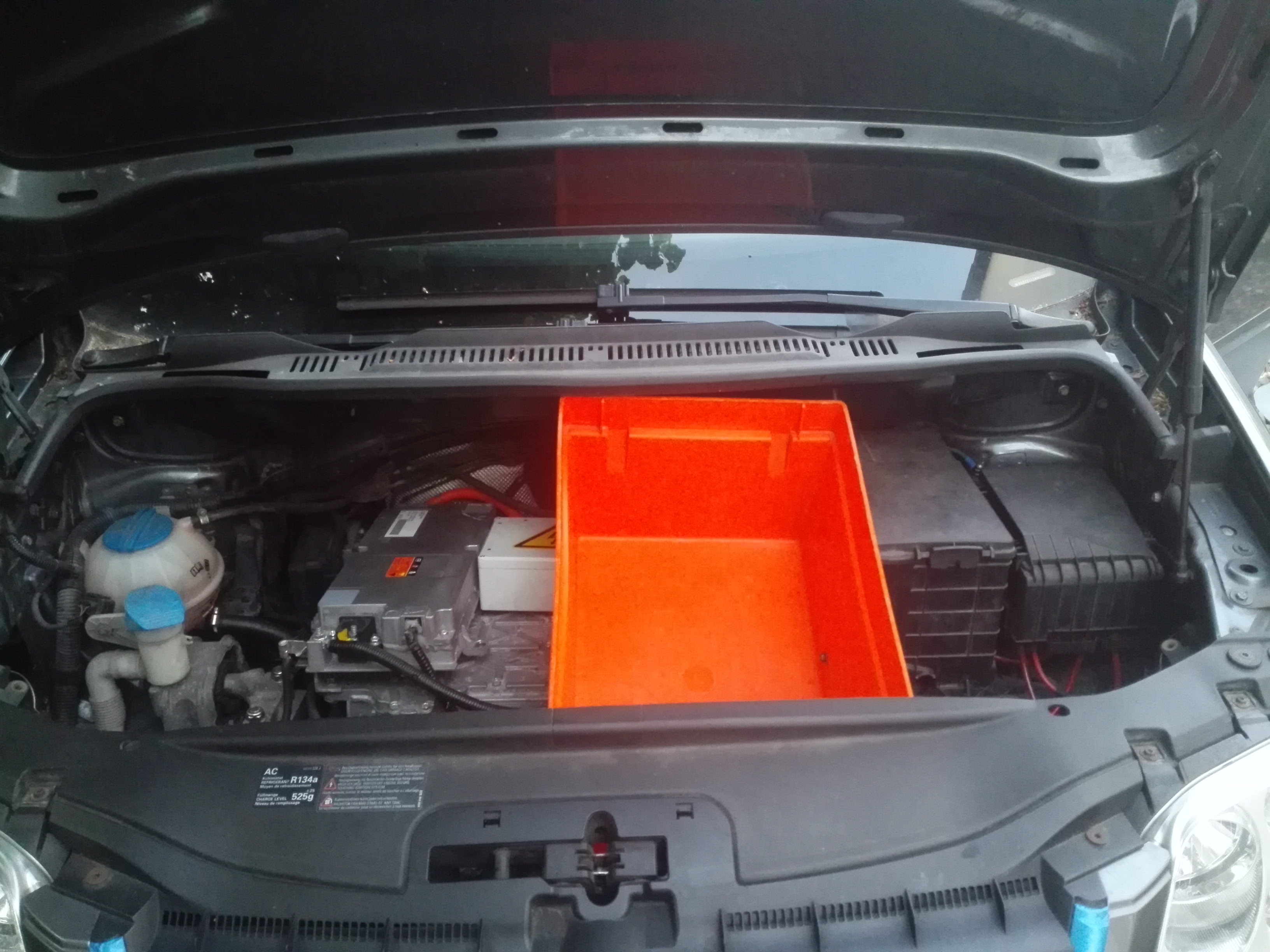

check out my frunk
Should take the charger & cables

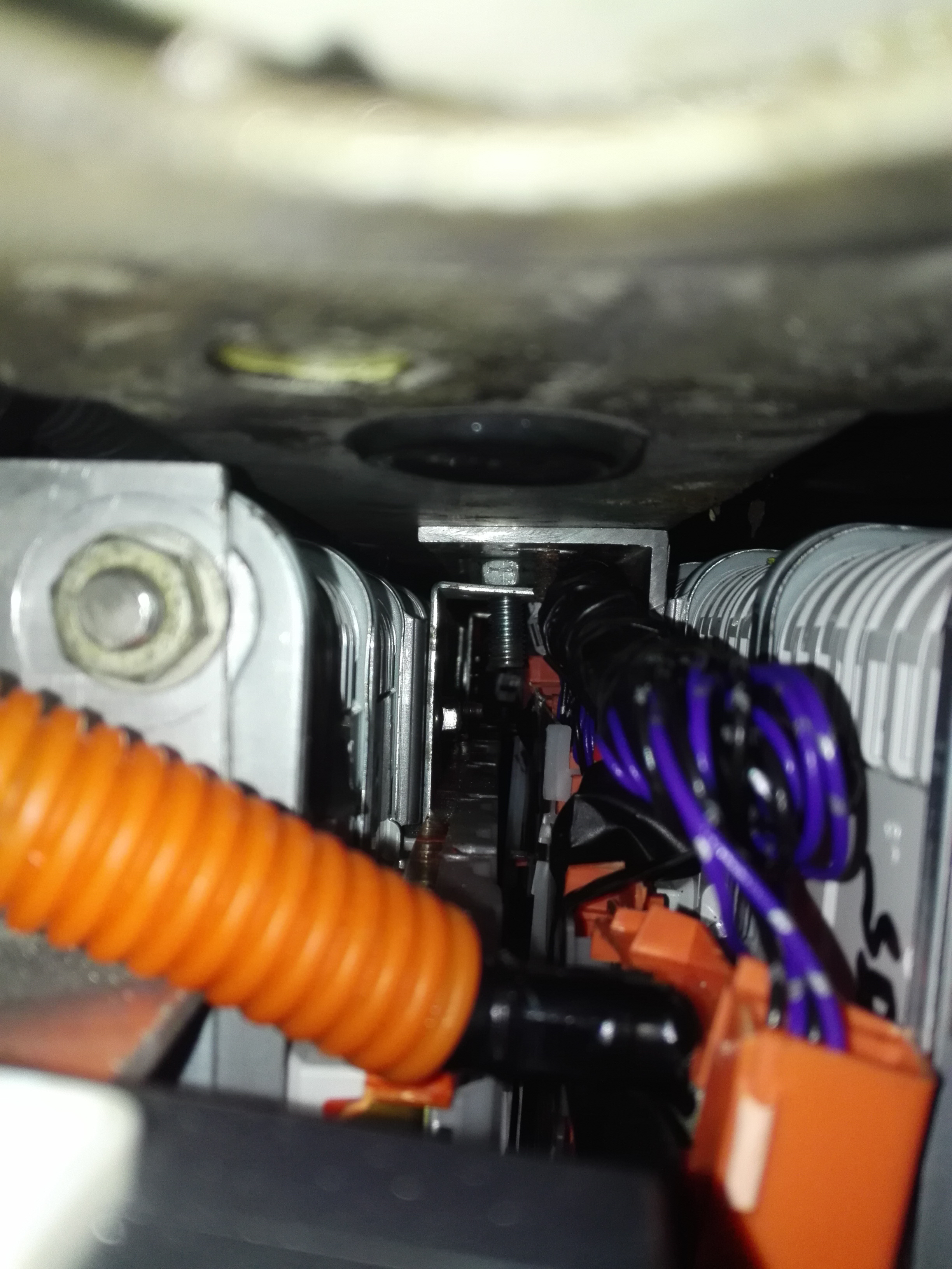

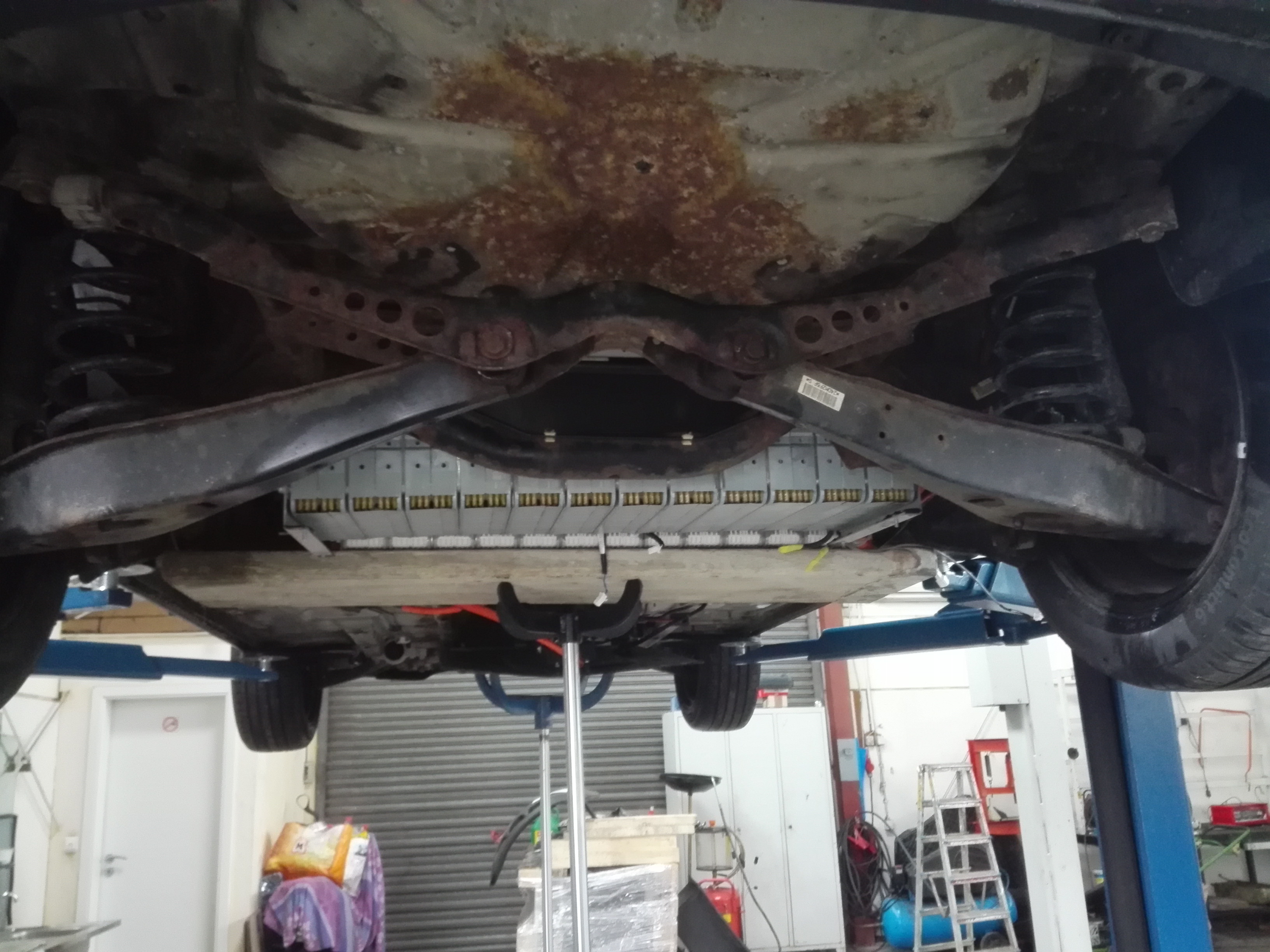

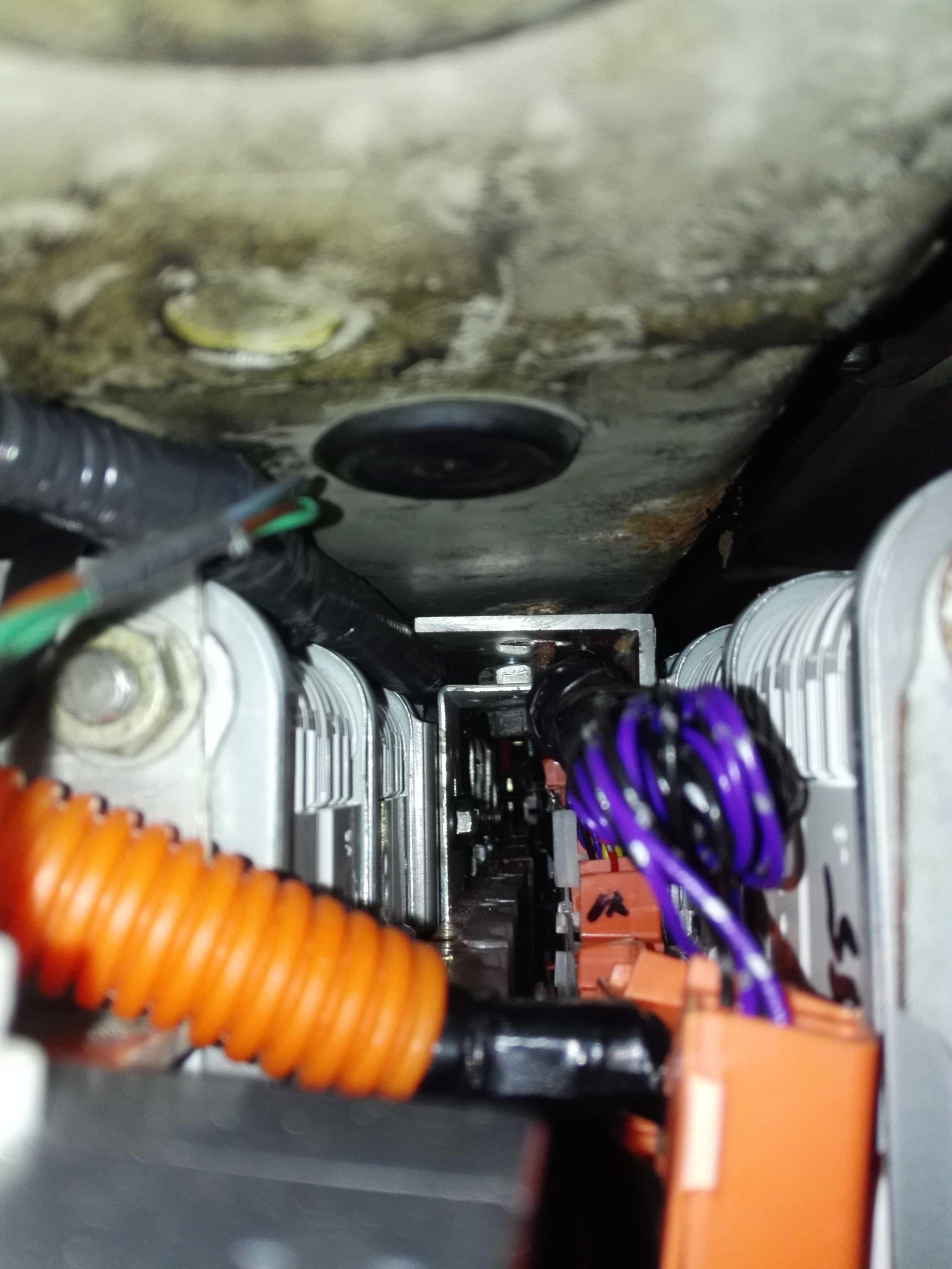

Oh no.... Actually I was going to drive down to Saarland today but after loading up the car with the former battery pack and checking ground clearance, I saw a noticeable imbalance from left to right.
And indeed, negligence got us.
I remember standing in the workshop with dad and wondering whether we should dismount the floor carpet to be able to counter the M10 bolts. And it seemed like we could tighten them sufficiently without countering.
We could not.
The trained eye sees a gap between the aluminium angle and chassis. And also the bolt is visisble with it clearly should not be.
So, drop the whole thing down again, do it properly and hopefully be done with it.
We could not.

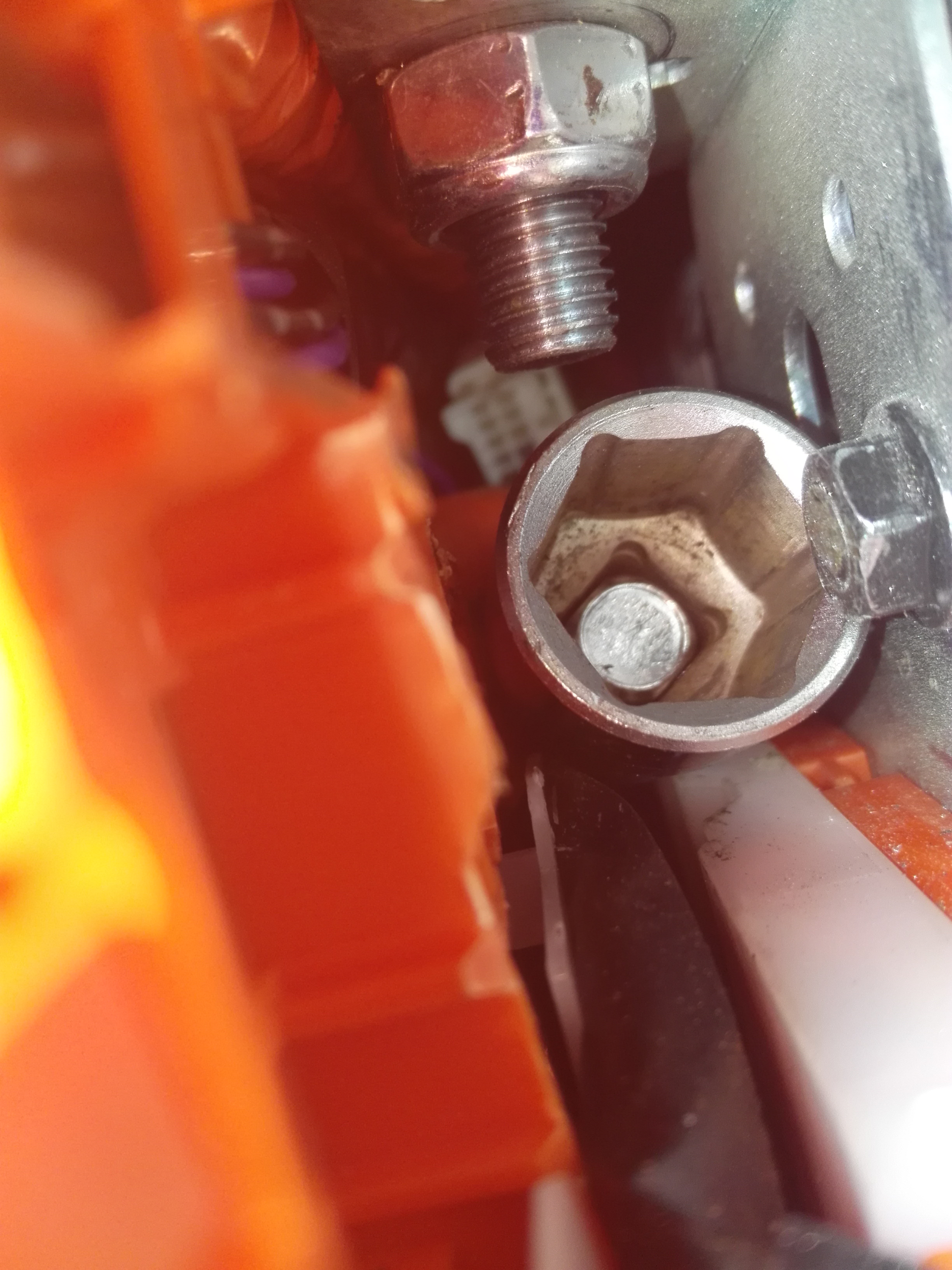

Another workshop day and the battery should now be in for good! I've developed some routine in dropping in raising it so it took only a few hours. 6 hours total with me checking ALL pole connectors again, doing minor tweaks, dismantling all covers and finally cleaning up after myself.
Now it sits flush again, compare against the picture in the post above
It still leans to the left a bit, but now I know that's fine.
Why is my tool stuck? Cell phone cam came in very handy. Getting the tool in and out is still the most complicated part.

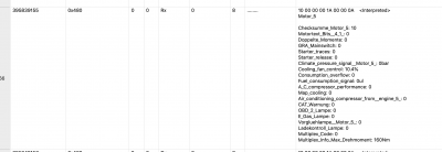

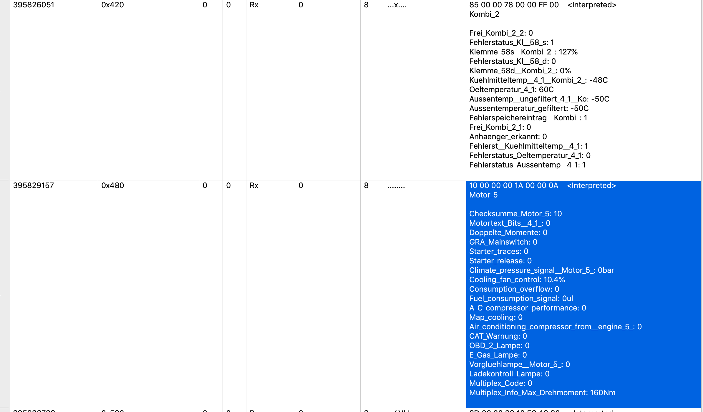

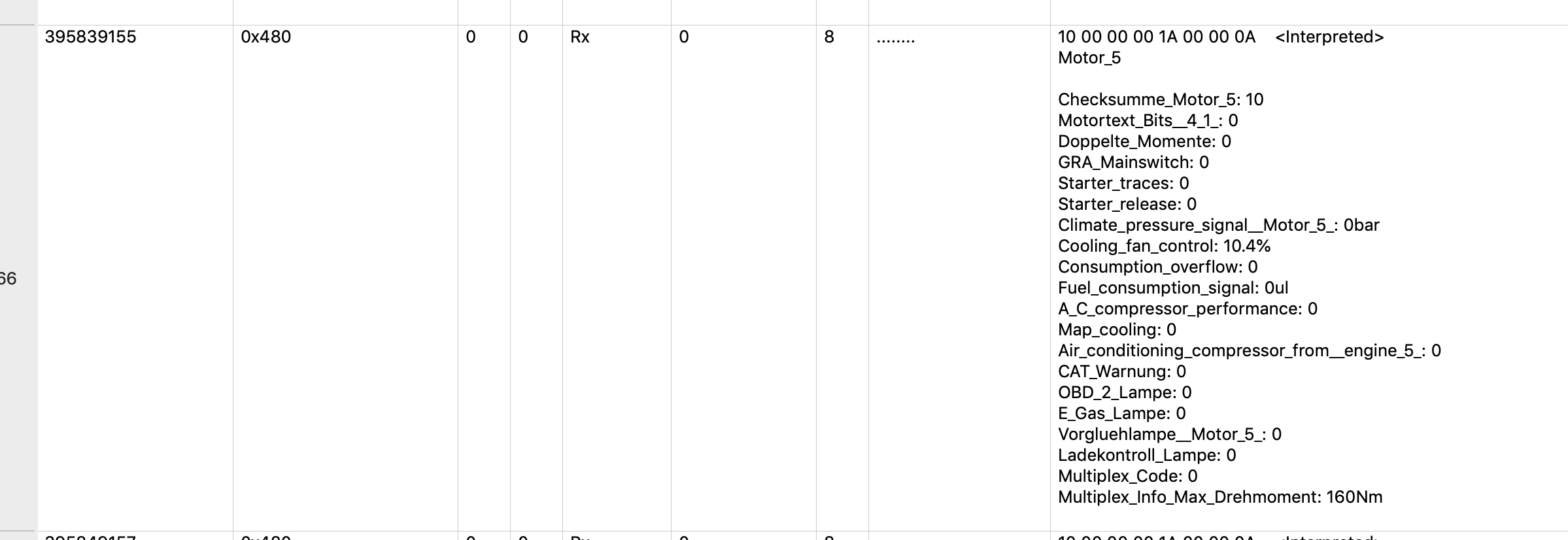

Do you know which messages turned off the ESP warning?
I'm broadcasting these messages (found a DBC file online, but it appears to be in German)Code: Select all
