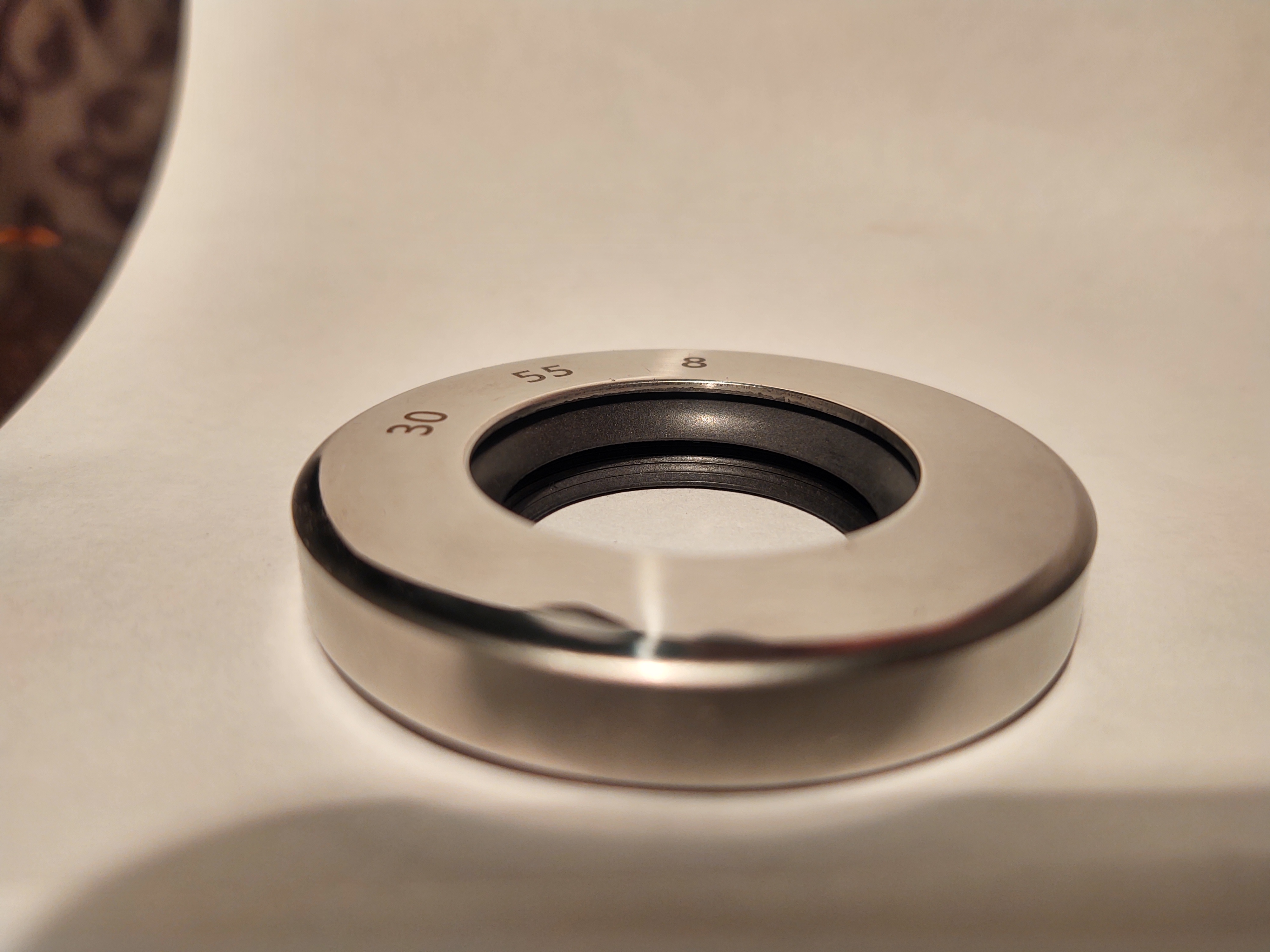

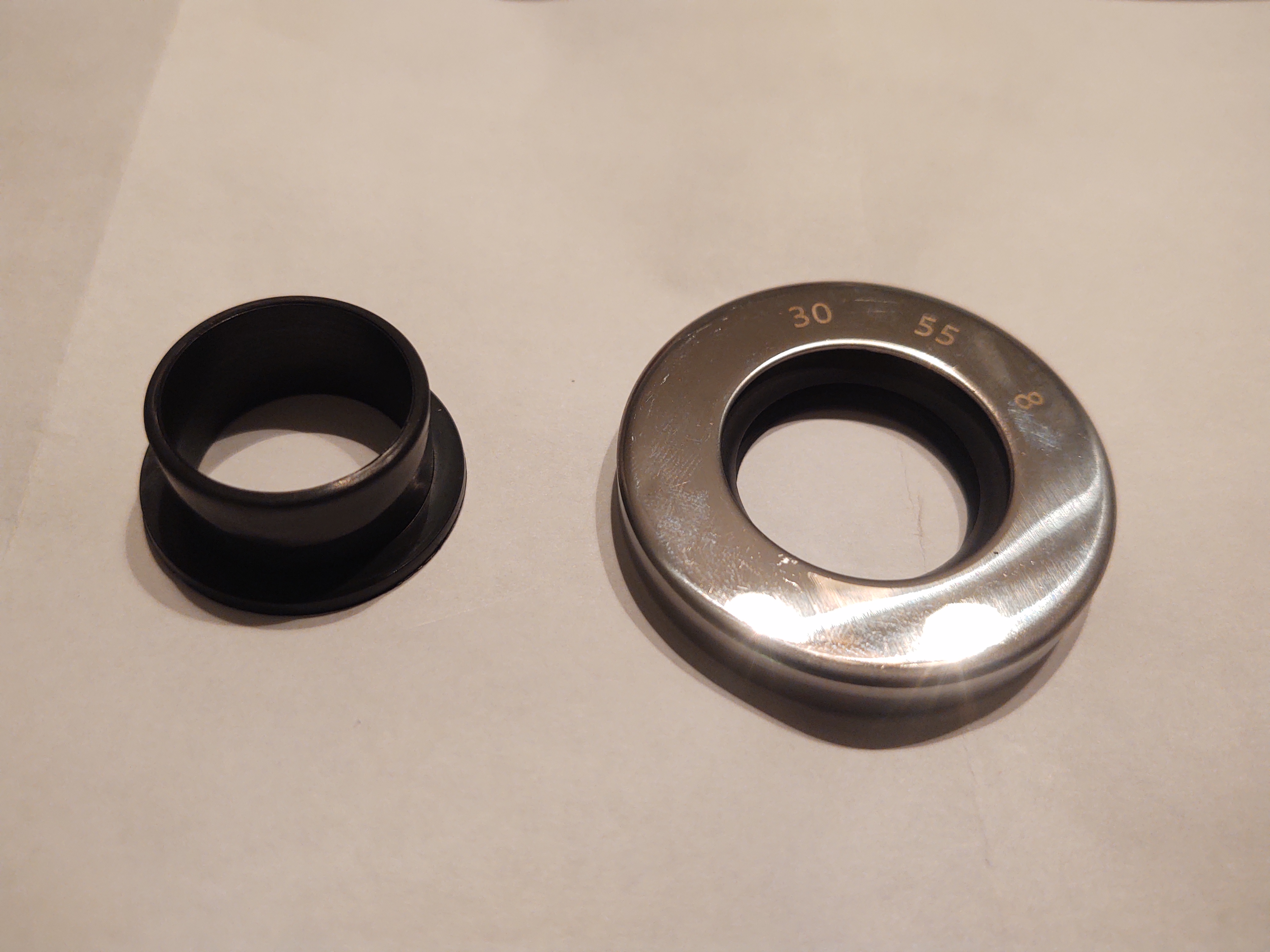

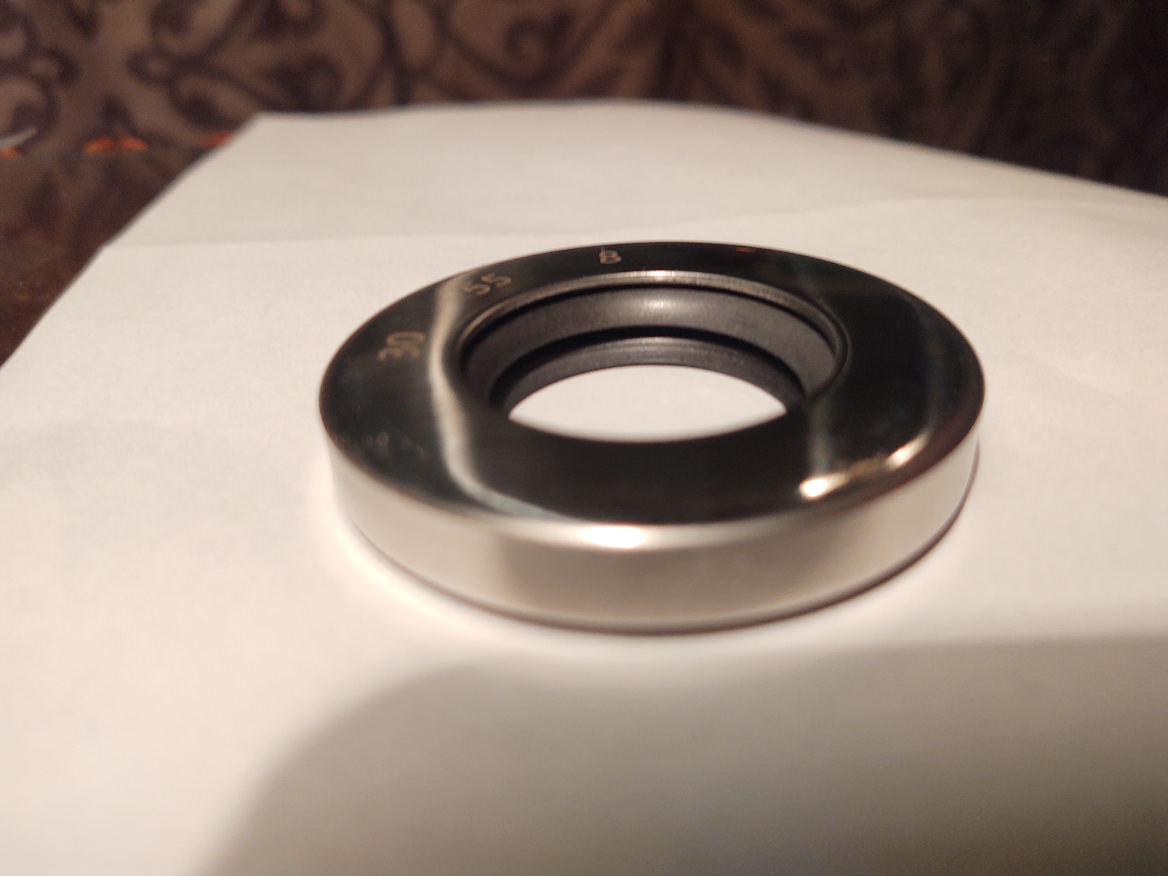

Ceimin triple lip seal cage is a lot stronger than original Tesla's single lip seal cage. Multiple stainless ring blocks pressed together and a lot heavier. Removal is much greater challenge than original seal but pretty easy this way (thanks to @Boxster EV)
- drill pilot hole through top stainless steel layer (closer to the outer edge as interior rings have larger ID and can be missed drilling at an angle), maybe 1/2 way through the 2nd layer of steel (slow speed with oil to cool, getting stainless hot only gets it harder) Drilling will be at a slight angle since the manifold pipe is in the way.
- screw in self tapping screw. Preferably one can turn and lock in tight with ratchet
- bite screw head on a vice, lever out the seal
Came out pretty easy. Ability to apply high leverage properly makes it easy.
Here is a better look at the seal interior. All PTFE seal lips intact, rust packed in between.
My best guess now is prior reman removed the protective plating and didn't reapply. My light sanding probably wouldn't have taken off the plating (unless of course I did take off whatever surface finish protectant). Fresh O2 is introduced via drain port. Cooling contracting volume coolant probably vacuum pulls air into the seal lip chamber from dry side sucking in fresh air. Can't prove any of this but seems most likely

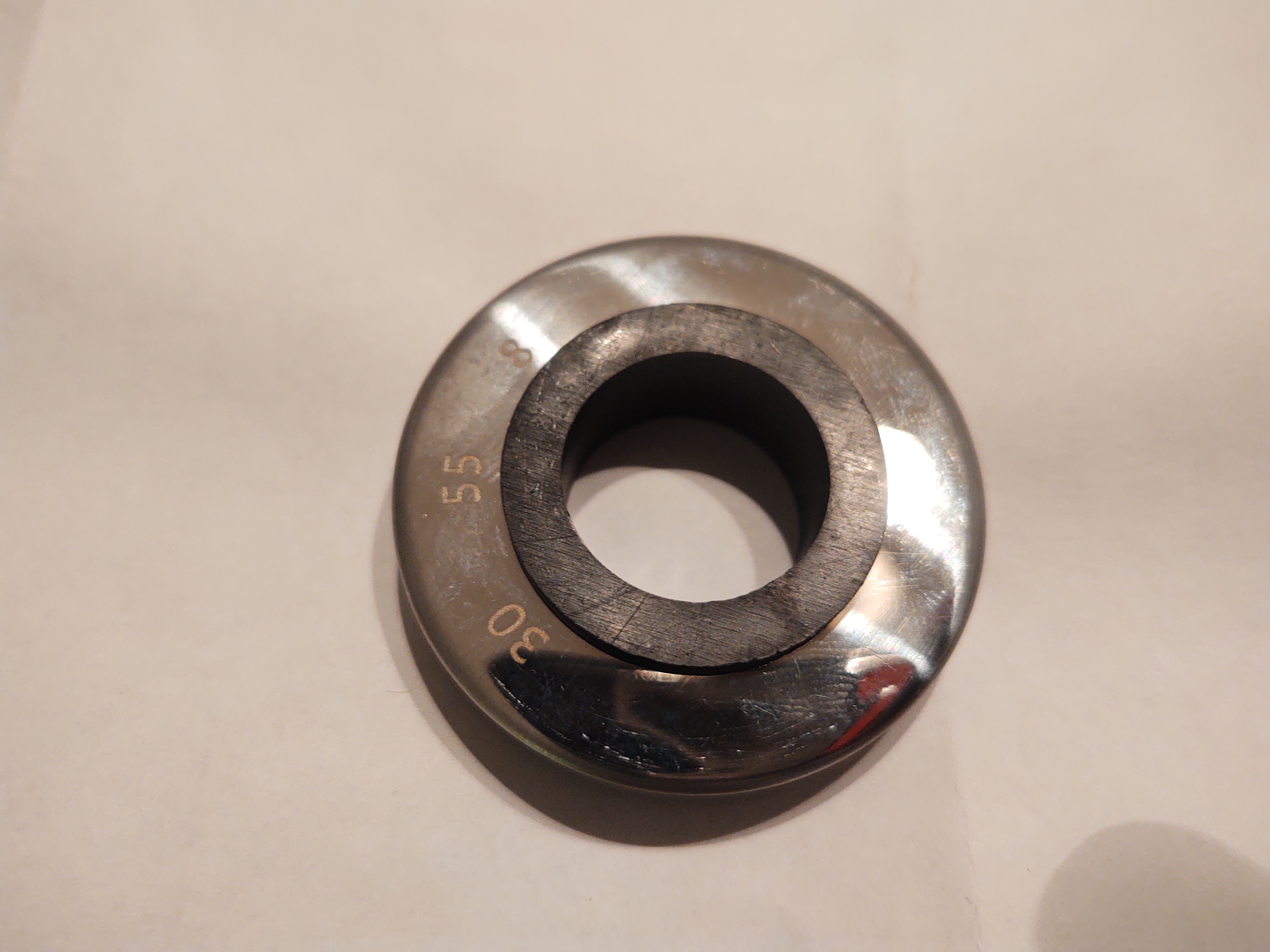

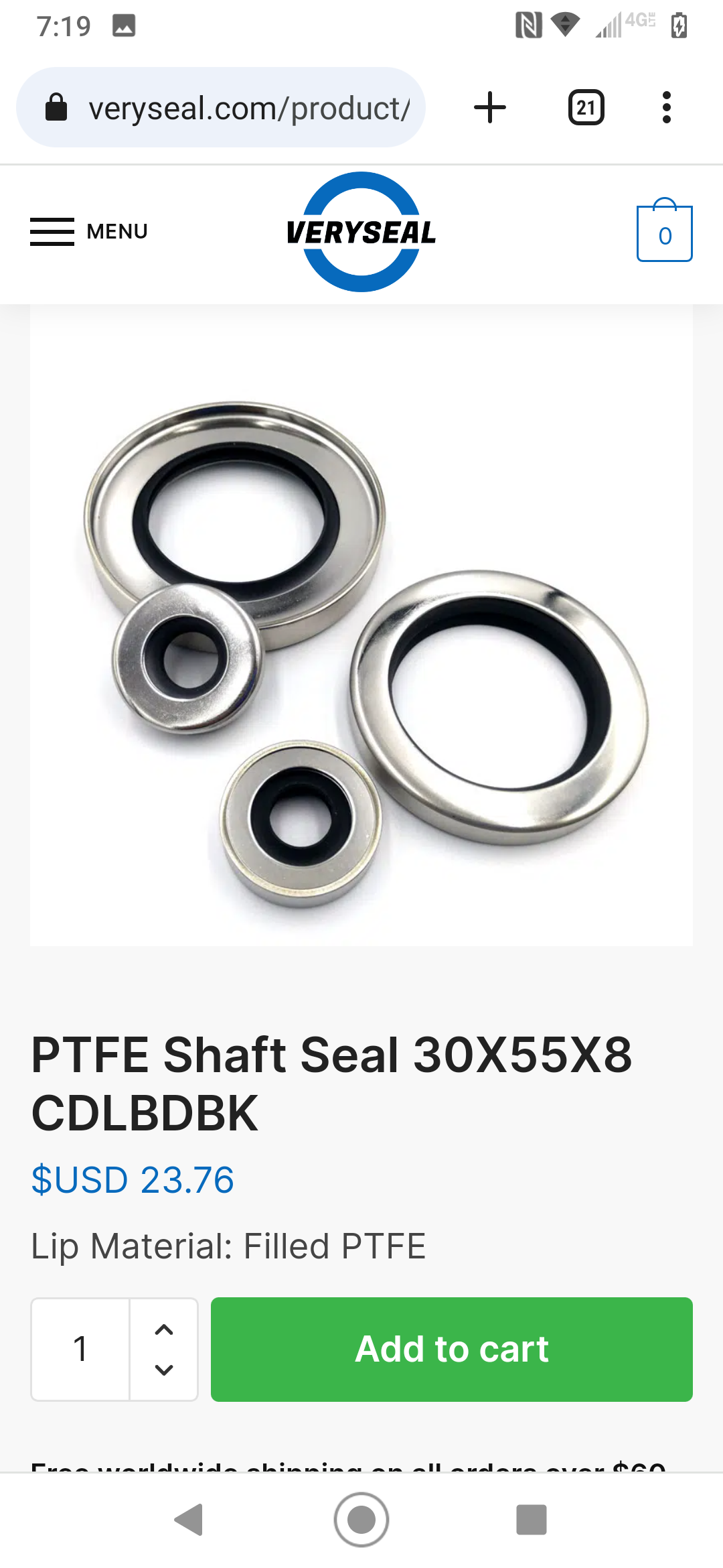

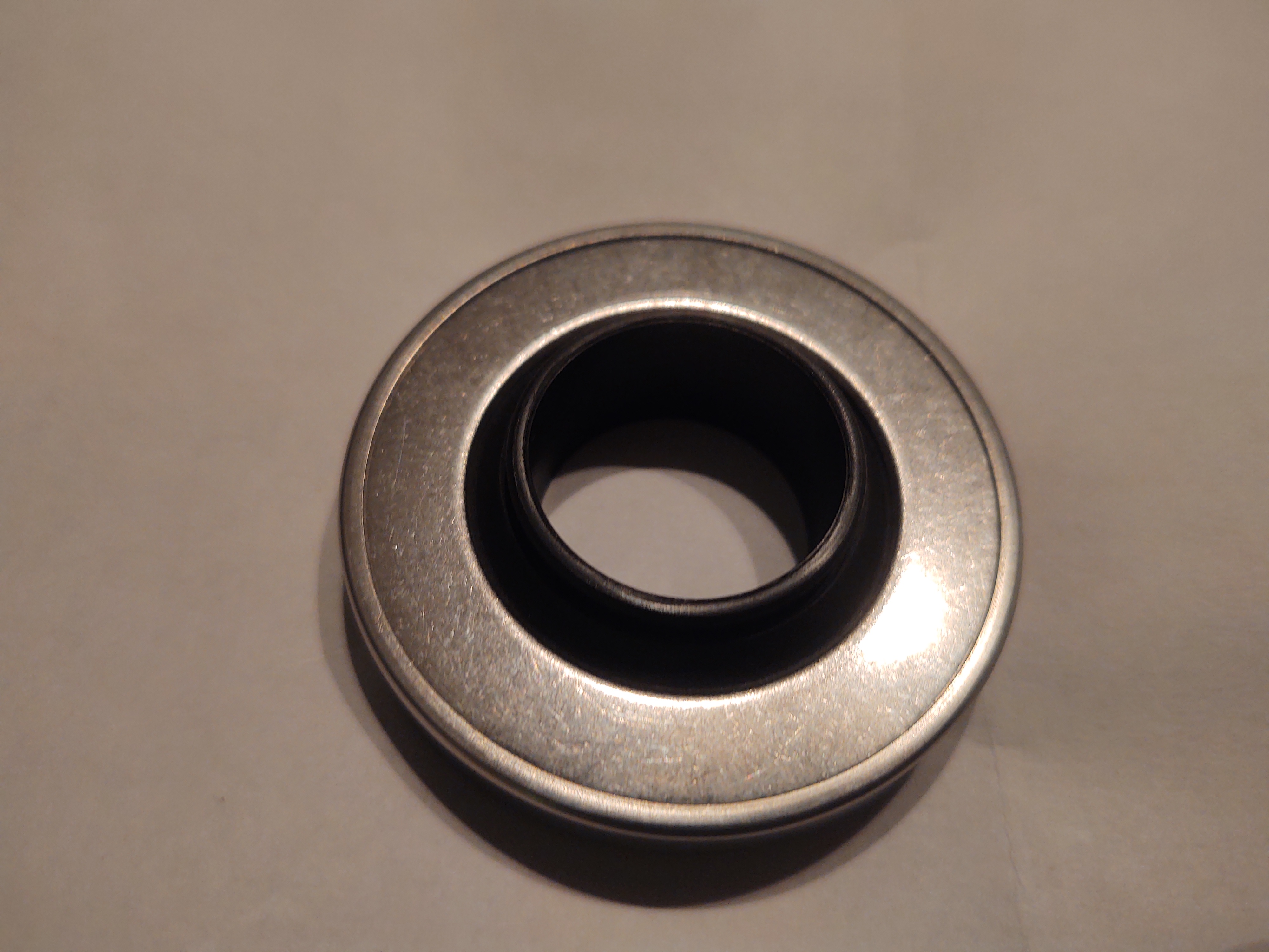

I'm going to try this 2 lip PTFE seal for my 2012 P85. It took 8 days to come in the US mail from New Jersey to the Chicago area. It ships with an internal collar spacer fitted to keep the seals oriented and stretched until installation.

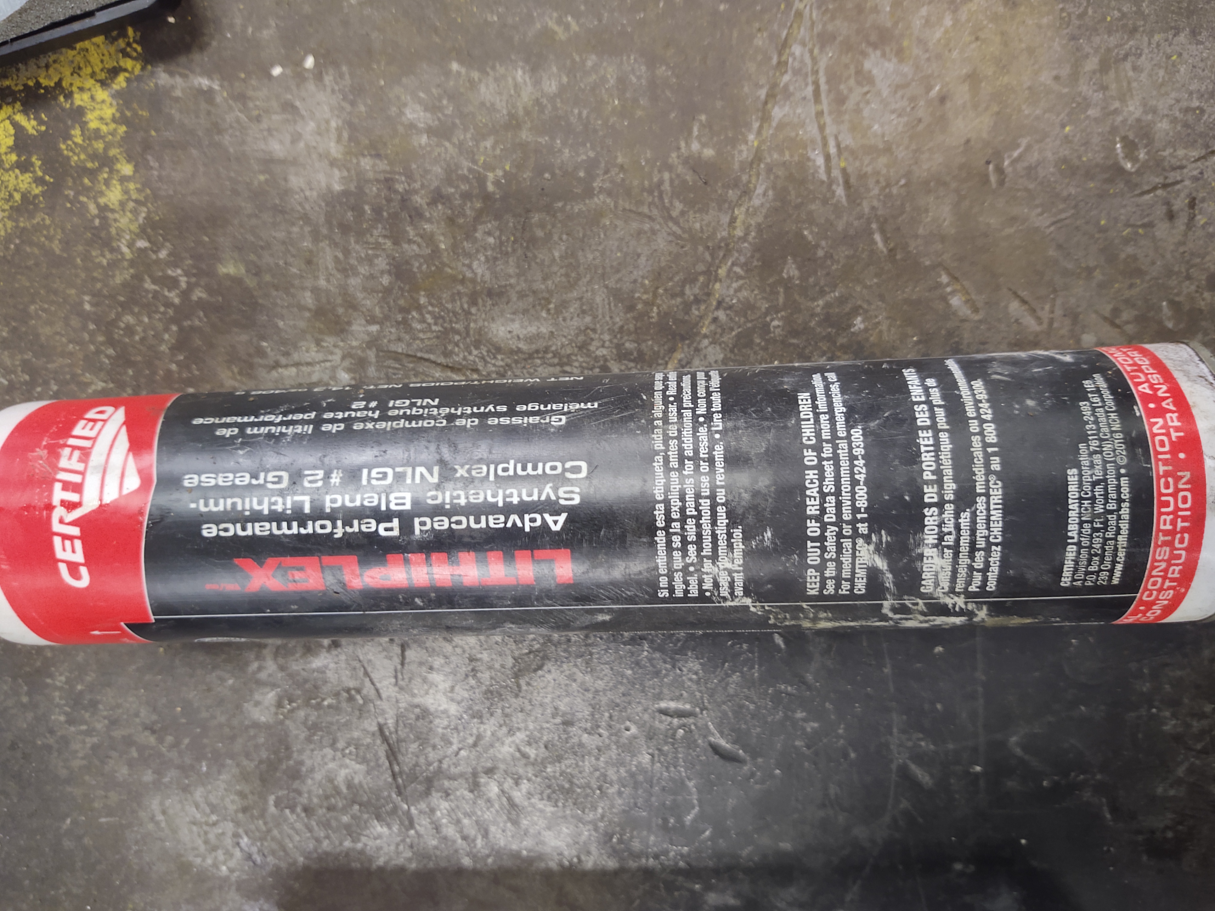

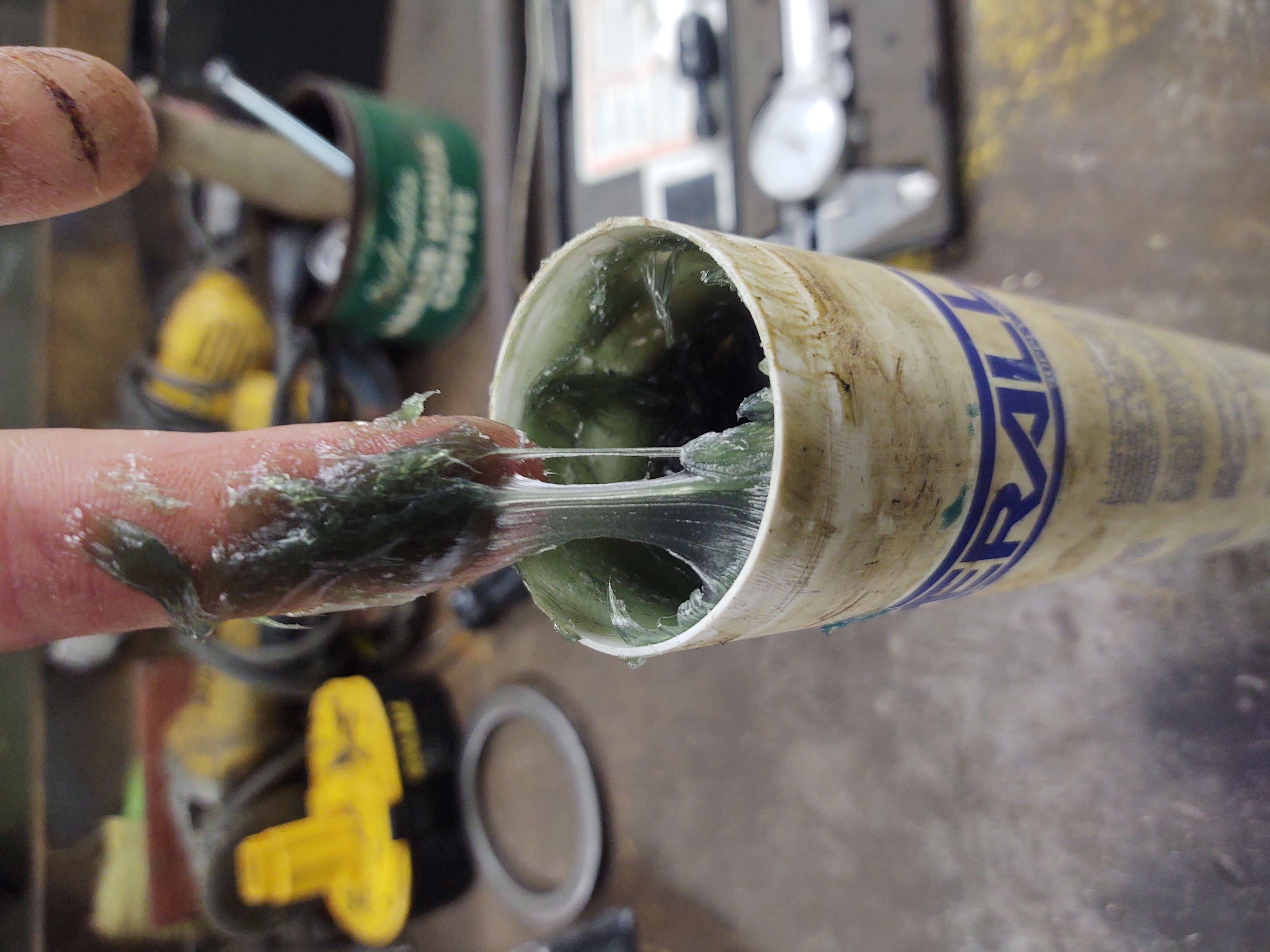

Howardc64 RE: Spline grease.
A good sticky grease used for propellor shafts is made by Overall Supply Inc from New Jersey. It is called "super grease" and is very sticky. It worked well on tug boat prop shaft bearings and seals. A couple other synthetic greases are made by Hydrotex and Certified Laboratories. I used the super grease on my rotor splines.

Another PTFE seal from China. Interesting. Pic shows both lips face coolant side (no excluder) so much easier to install over the beveled shaft opening without risk of folding the lips.2oldteslas wrote: ↑Thu Aug 03, 2023 12:45 am I'm going to try this 2 lip PTFE seal for my 2012 P85. It took 8 days to come in the US mail from New Jersey to the Chicago area. It ships with an internal collar spacer fitted to keep the seals oriented and stretched until installation.

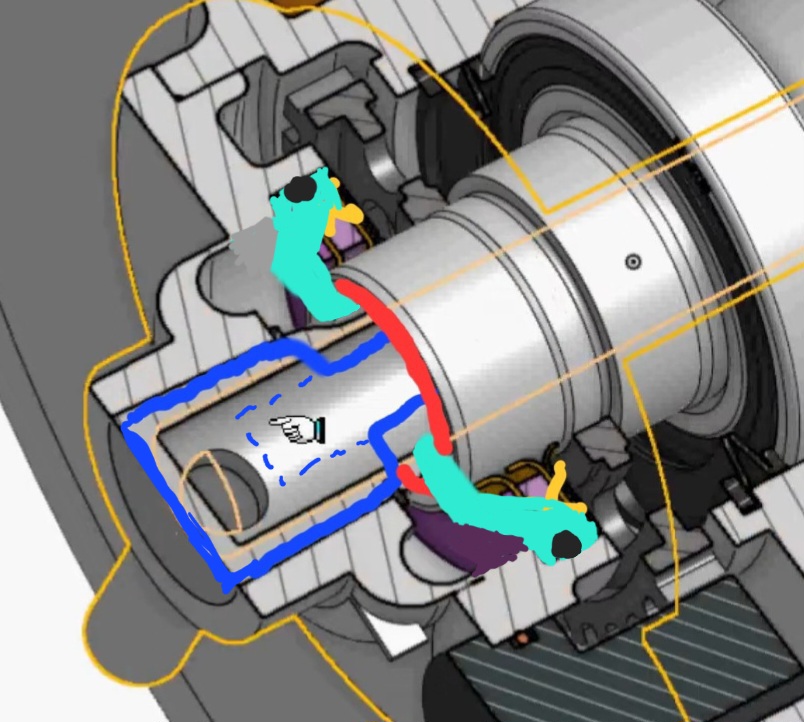

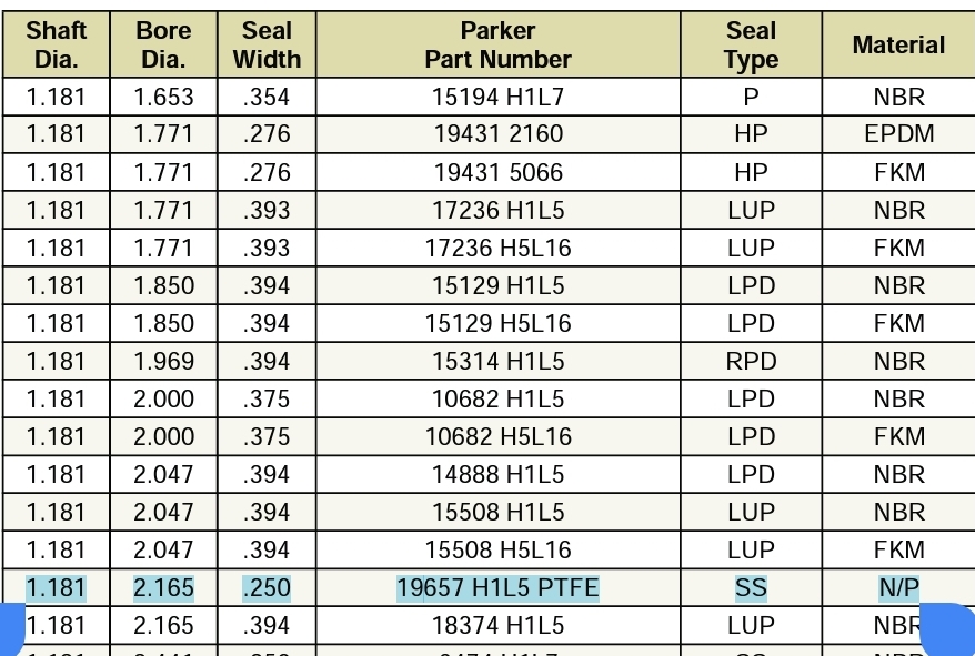

Has anyone looked at making a new coolant extension tube (blue) an adapter lip / flange (aqua green - black is an o-ring) that extends into an internal seal (red) in the motor shaft?
The coolant extension tube could be 2 pieces (at the dashes) to be a bit more cost effective.
Anyone have the shaft ID where the red is?
This would cut down on coolant flow somewhat. It would also give a smaller seal diameter / surface speed. Might give a bunch of seal options flipping it like this. The wear item would be the adapter lip / flange and should be easy to replace if needed.
Could also be a solution for motors with mangled sealing surfaces.
*edit, the seal lip would probably open from centrifugal force if one tried to use a seal pressed into the motor shaft as I drew. Probably would have to flip it to an external lip seal.*

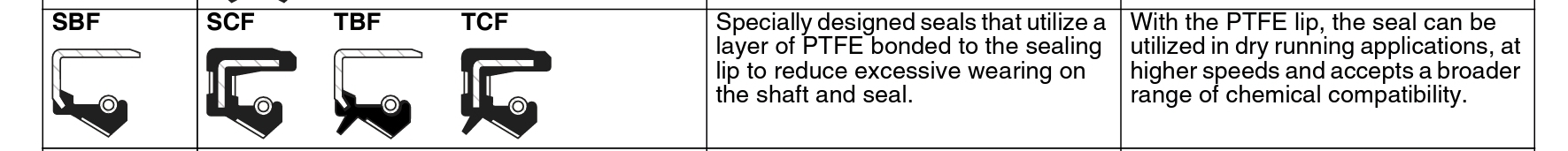

This is generic info but worth a read for people considering multi-lip seals. PTFE might be allowed to run dry but I wouldn't expect that to be the case at the speeds that these are spinning.
Trick would be to find a PTFE compatible lubricant that doesn't gum up when expose to g48.
under lubrication.https://www.skf.com/us/products/industrial-seals/power-transmission-seals/radial-shaft-seals/technical-specification wrote: For a radial shaft seal to seal efficiently over a long period, the sealing lip must be lubricated. This reduces friction and wear to the sealing lip and shaft. Dry running of sealing lips made of standard materials should always be avoided. To prevent dry running, coat the counterface surface with a suitable lubricant prior to seal installation.
The lubricant must not only lubricate the sealing lip to reduce friction and wear, but also dissipate heat generated by the seal. To promote heat dissipation, a sufficient quantity of lubricant must be able to reach the sealing lip from start-up.
Some rolling bearings, such as angular contact ball bearings, tapered roller bearings and spherical roller thrust bearings, as well as gears, create a pumping action by virtue of their design. This means that the sealing lip can either be starved of lubricant, or subjected to excessive quantities of lubricant. In either case, steps must be taken during the design stage to make sure that the proper amount of lubricant reaches the sealing lip, as too much or too little can affect seal performance.
To prevent lubricant starvation, lubrication ducts can be provided. If the seal is subjected to excessive amounts of lubricant, a flinger can be installed between the bearing and seal.
In applications where the sealing lip is not exposed to a lubricant, for example when two seals are installed in tandem, grease or oil must be supplied separately to provide lip lubrication. In some cases, it may be sufficient to provide an initial grease fill between the two lips.

Shaft ID at just behind the beveled (beveled on ID as well as OD) edge is 25.5mm +- 0.1mm. Hard to measure precisely.jrbe wrote: ↑Thu Aug 03, 2023 2:03 am Has anyone looked at making a new coolant extension tube (blue) an adapter lip / flange (aqua green - black is an o-ring) that extends into an internal seal (red) in the motor shaft?
One challenge to seal on the ID is potential lack of surface treatment. If these shafts were plated, probably OD and only where the seal contacts.

Thanks, that grease looks thick! haha2oldteslas wrote: ↑Thu Aug 03, 2023 1:04 am Howardc64 RE: Spline grease.
Few questions
- Did you mix it with the original grease?
- Any longevity data? I guess need to pull again to see for sure.. PITA haha
- Any thoughts on electrical conductivity characteristics?

-I cleaned off most of the old grease but not all so a small amount is mixed in with the super grease.
-no information on longevity or conductivity. Judging by experience it is a good heavy duty grease.

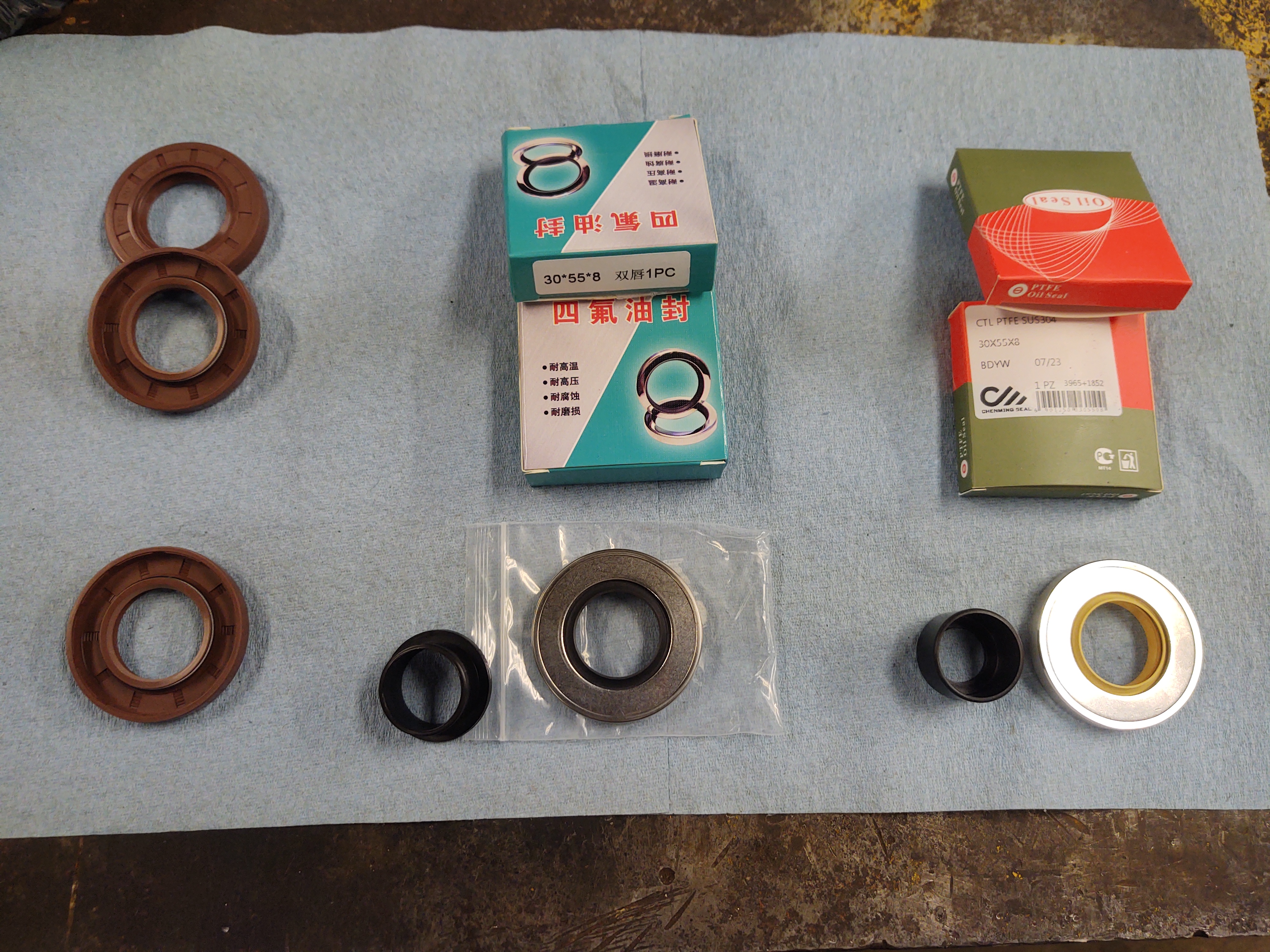

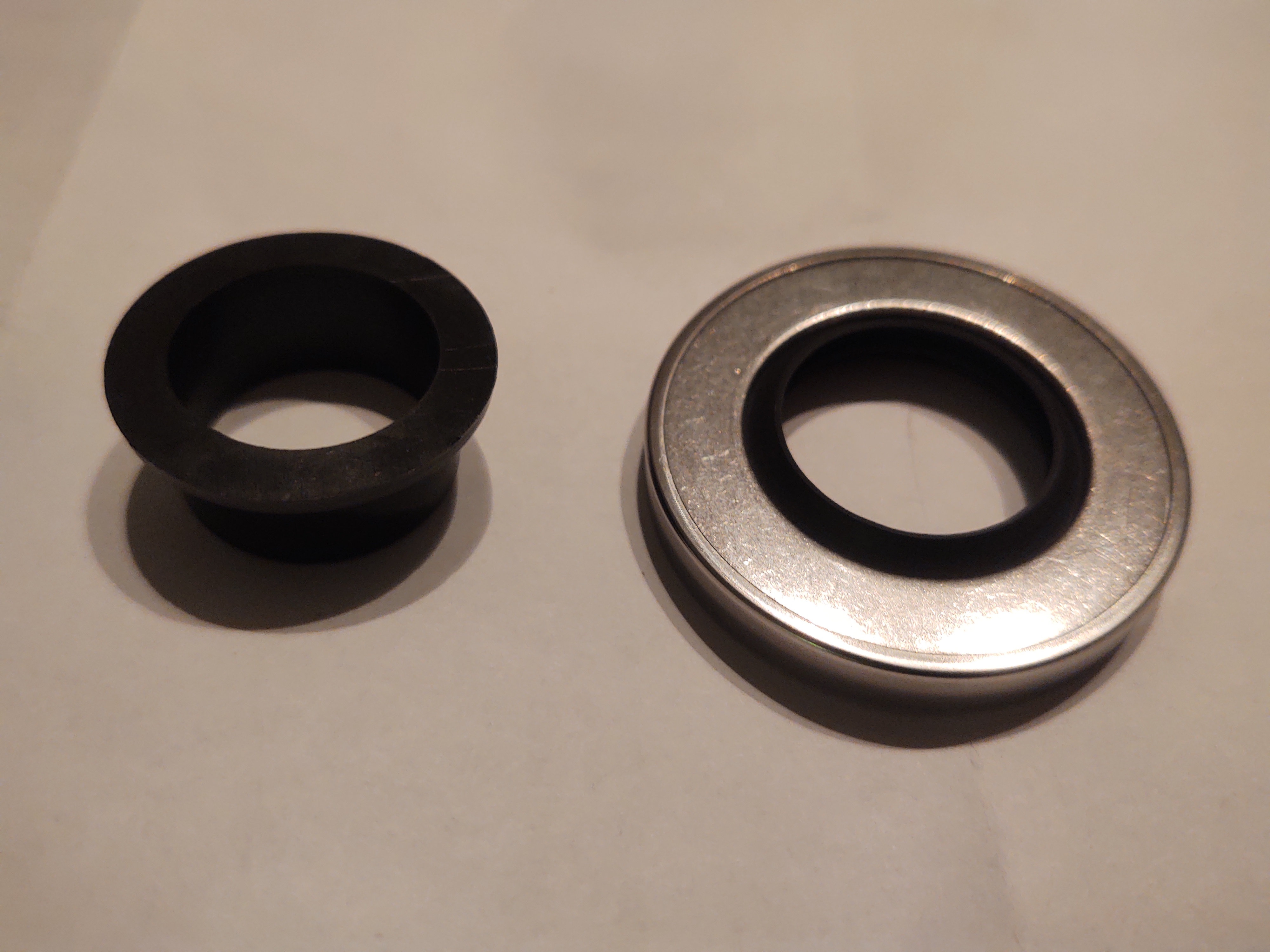

These are the 3 coolant seals I bought. Single lip, double lip and triple lip. Time will tell which works best.
2012 P85, 2013 85, 2013 85 parts car.
For the FKM seal, you can get better qualify SKF with and without excluder lip. ~$5 each at Acorn in UK (but $30 international 2 day DHL ship) so best to combine with bearing purchase.2oldteslas wrote: ↑Thu Aug 03, 2023 10:32 pm These are the 3 coolant seals I bought. Single lip, double lip and triple lip. Time will tell which works best.

While searching for spline coupler grease, found this newish PN on Tesla LDU catalog

How Much Cooling Does Rotor Get Anyway?
Here is the LDU coolant circuit diagram. Most of the flow rate is from Stator -> Inverter IGBTs/ATF heat exchanger. Flow rate on output of rotor coolant circuit has a 4.5mm restriction. Schematic here
So I wonder how much cooling does rotor require given this flow rate restriction?

Has anyone reached out to Parker Hannifin for a 19657H1L5PTFE seal?
I'm not sure why they couldn't list that as a metric seal.
Might be worth trying through motion industries or other reseller if they don't want to be bothered directly.
It's an ss style lip, My previous scribbles on this might not work out well as I first thought. I added an edit note to my post on that. With a seal in the shaft spinning, centrifugal force will probably open the seal lip. But they have a bunch of external lip seals if someone wants to experiment with flipping the sealing method inside out. With a sleeve pressed (and sealed) inside the hollow shaft it could give a decent surface for an external lip seal. They also have FKM seals with a bonded PTFE section to have the flexibility of rubber and a sealing edge / wear / friction surface of PTFE. Click on the image and zoom in, white rectangle is PTFE, But no off the shelf offerings for this that I saw in their design guide / catalog.
They also have seal designs with a molded in spring like section to allow for greater misalignment (some shown in the design style image above.) I don't think it's needed here though. Lots of interesting things in their 400 page design guide,
https://www.parker.com/content/dam/Park ... s/5350.pdf

Yes, I reached out to Parker and Saint Gobain custom seal divisions. Neither wanted to engage. Saint Gobain said the seal was proprietary in nature so didn't want to provide services. I'm guessing all these big manufactures already contacted by Tesla/Tier 1 supplier. Maybe some are past/current LDU seal manufacturers.jrbe wrote: ↑Sat Aug 05, 2023 11:57 am Has anyone reached out to Parker Hannifin for a 19657H1L5PTFE seal?

For clarity, 19657H1L5PTFE should be an off the shelf part. No need to go the custom route or even mention Tesla while trying to order some. It doesn't seem to be a thick sealing surface but that could be a good thing given the speed it can run at.

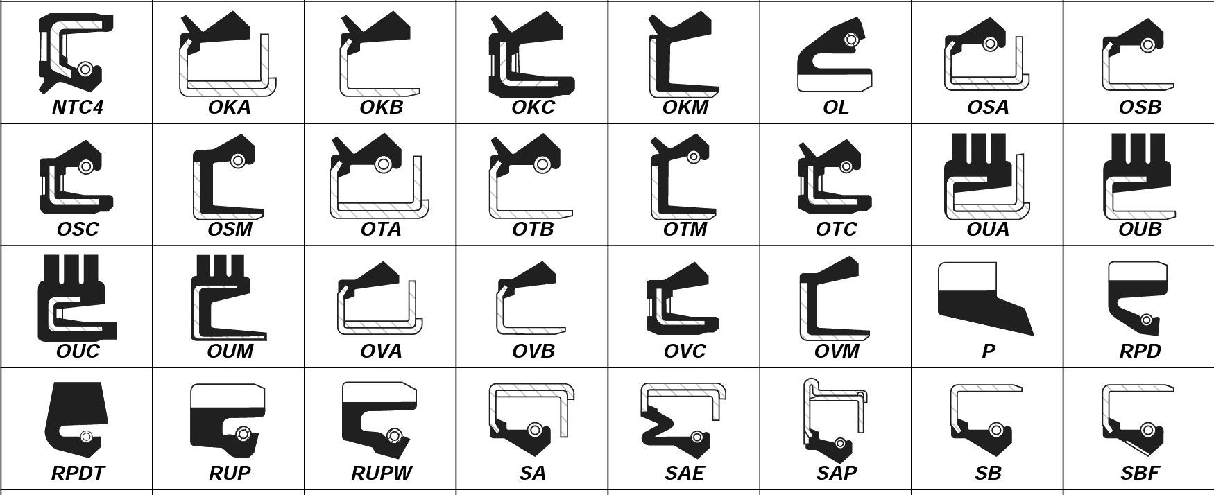

SKF PTFE Seal Installation Direction
https://www.skf.com/us/products/industr ... tions/ptfe
Reviewing SKF's PTFE seal installation. They clearly state PTFE seal is not an elastomer material (NBR, FKM) and easily damaged by any sharp edge. Since PTFE's material property is like a hard plastic rather than an elastomer, the sealing mechanism therefore is different. Thus the more precise requirement on shaft surface, installation method etc.
In LDU's blind seal install, it is not possible to use a tool to avoid sharp edges. Instead, the shaft and its chamfered edge has to function as an installation tool. The chamfered edge has to be smooth.
Using SKF's speedi-sleeve on LDU rotor coolant shaft is probably incompatible with ANY PTFE seal. Its not possible to avoid sharped edges during install no matter how well the sleeve's sharp edge is machined/dremeled. Elastomer seal can survive sleeve's micro sharp edge but any scratches on PTFE hard plastic like sealing lip will become a leak channel.
A custom sleeve with chamfered edge over the existing shaft edge will probably work. But of course require yet another custom fabricated item to source and manufacturer. Without this, a damaged shaft's surface has to be spray metal repaired and chamfered edge carefully polished if want to use a PTFE seal.

Got rotor back from flame spray shop today.
Spec
I provided the following spec
~50Rc shaft hardness. Based on PTFE seal shaft hardness research
~0.2um surface finish (or N4 or 8uin) Based on PTFE seal shaft surface preparation research.
They did the following
- machined down 25/1000
- Arc twin wire sprayed Stoddy 133 (chrome carbide) They said basically stainless steel. Inconel could only achieve 20Rc so not a candidate. Just going by what they tell me. Keep in mind these are flame sprayed on with porosity rather than melted metal crystals. I asked what was done to solve the porous surface, they mentioned filler of some kind. All non sprayed areas are masked off.
- Polished to 0.2um spec. It appears polish is all the way to the chamfered edge enabling this built-in PTFE seal install structure.
- Cost $300
Misc
This shop has 6-7 large machine lathe stations. Handles shaft repair for marine (I'm in Seattle), building equipment, and public busses with 12k RPM shafts (presumably hybrid bus) My $300 private consumer job is tiny compared to their other businesses so very much depending on their good will.
Next
Now onto LDU reassembly AND coolant seal lottery

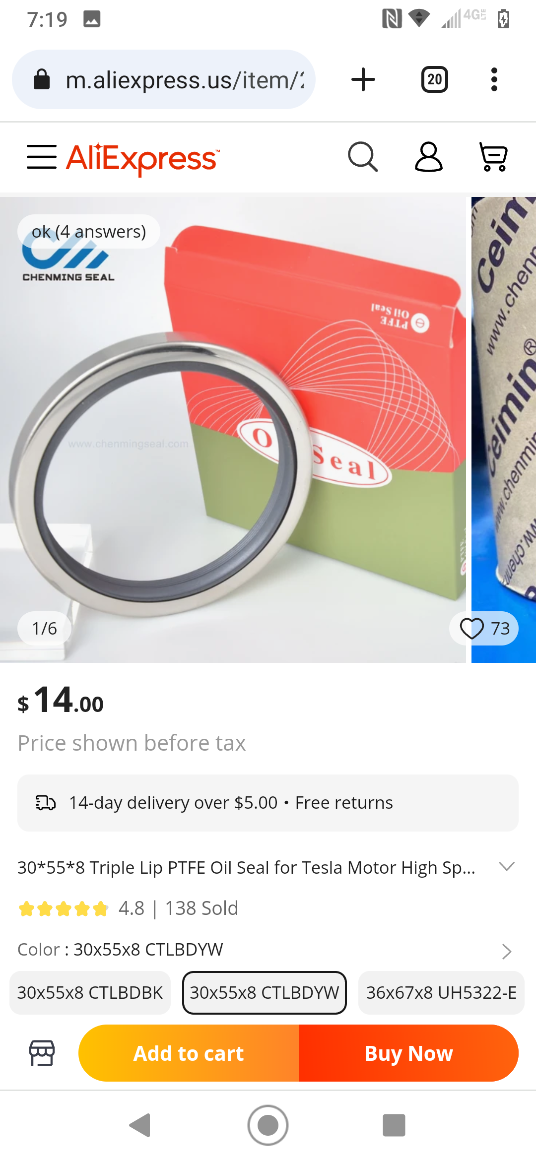

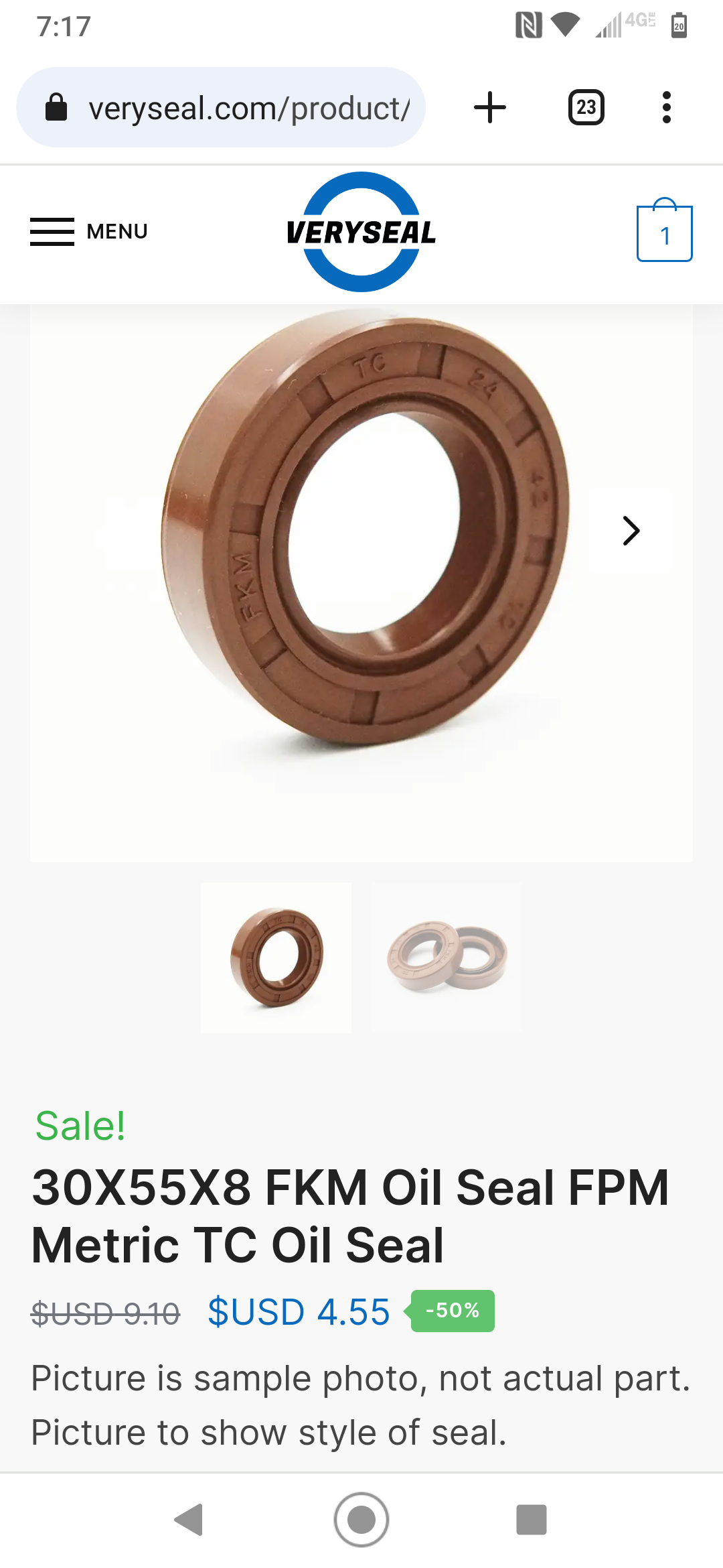

Have SKF FKM, NBR+PTFE coated, GFD single lip PTFE, Ceimin dual lip + excluder (commonly referred to as triple lip) Probably using a single lip this time.
