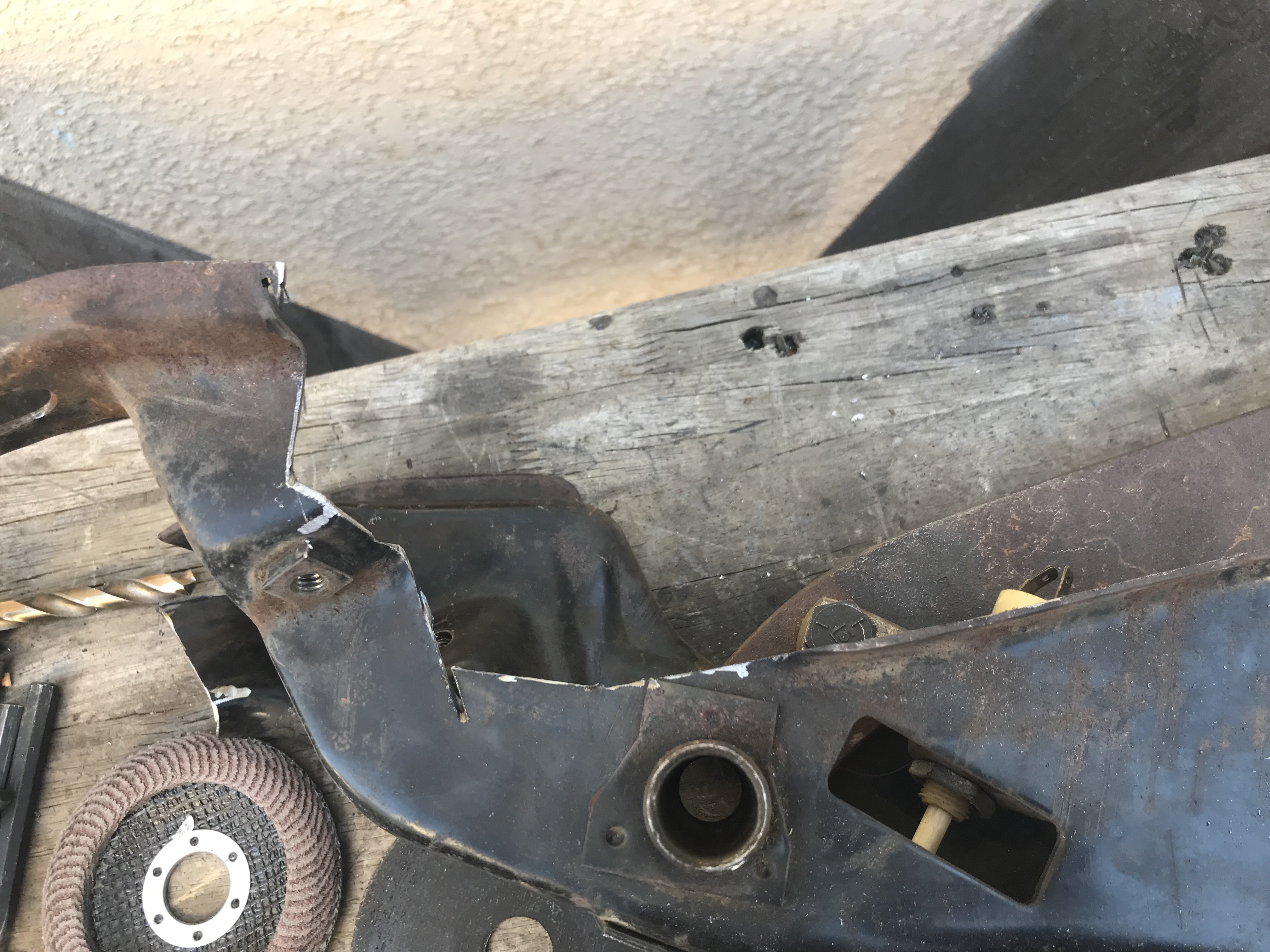

Post by Gregski »

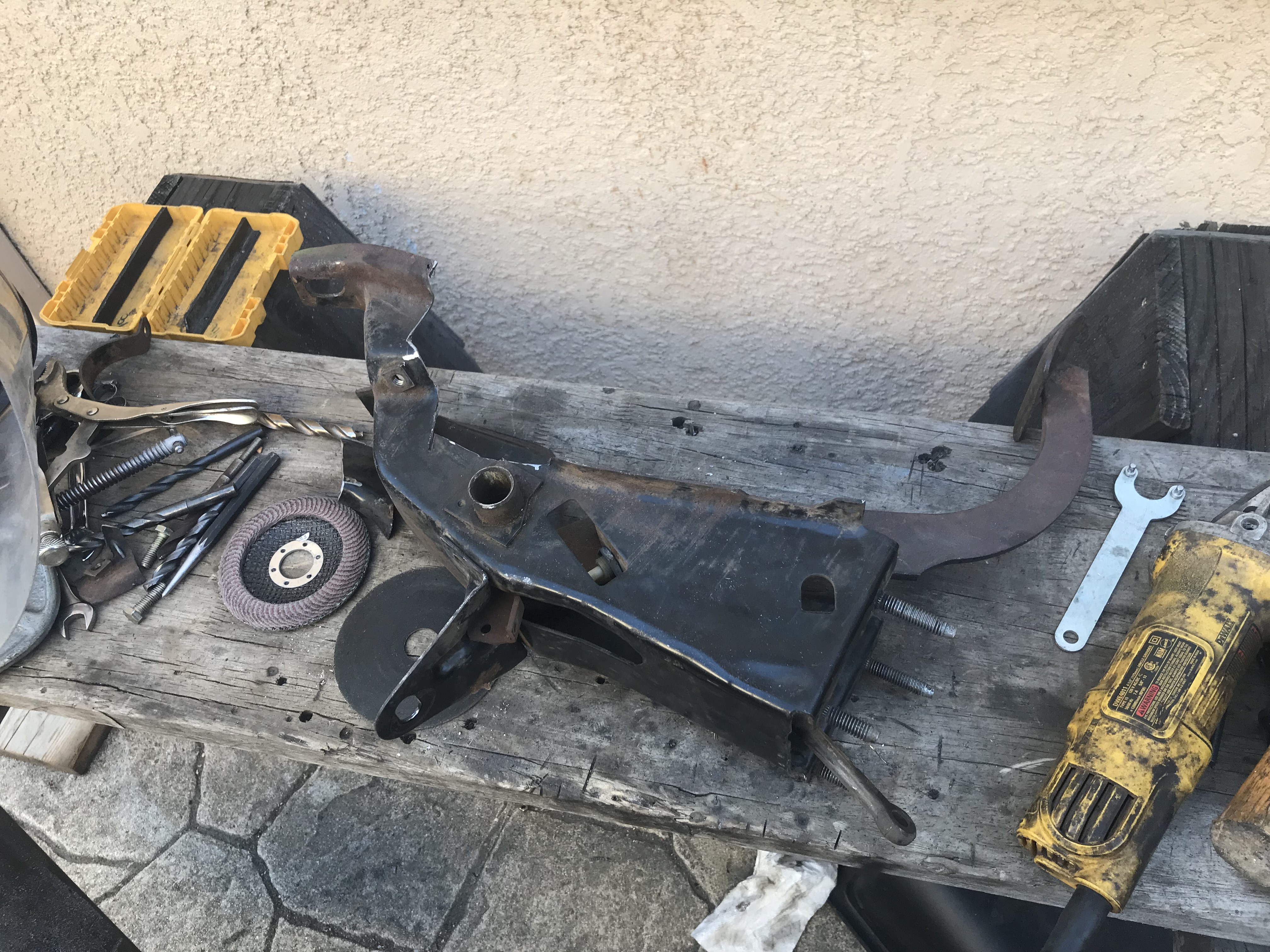

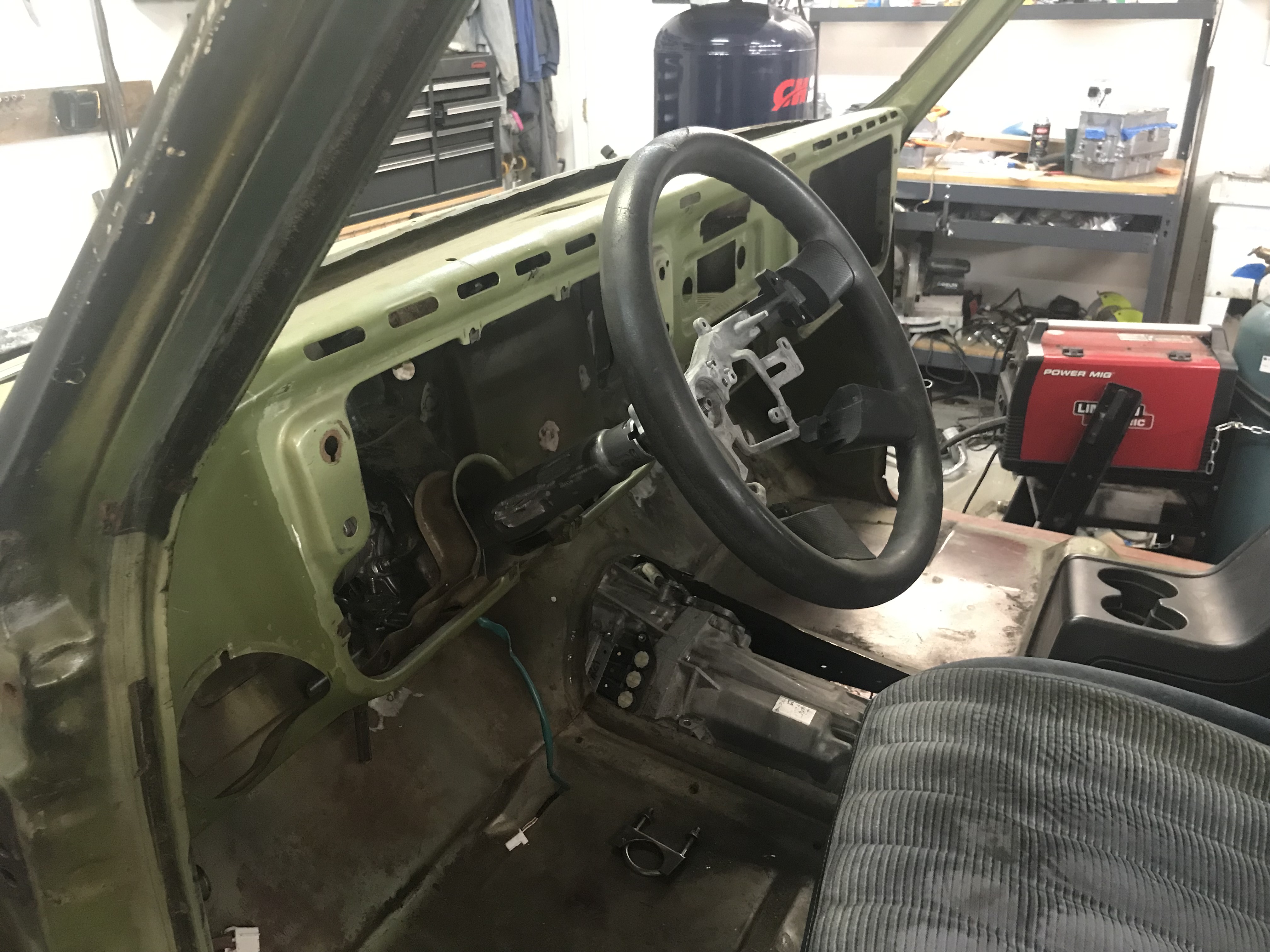

after that, things escalated pretty quickly and more carnage ensued
Gregski
Posts: 3157
Has thanked: 628 times
Been thanked: 1606 times
Post by Gregski »
I was spit ballin' using everything at my disposal for ideas (not all of them good ones)
Gregski
Posts: 3157

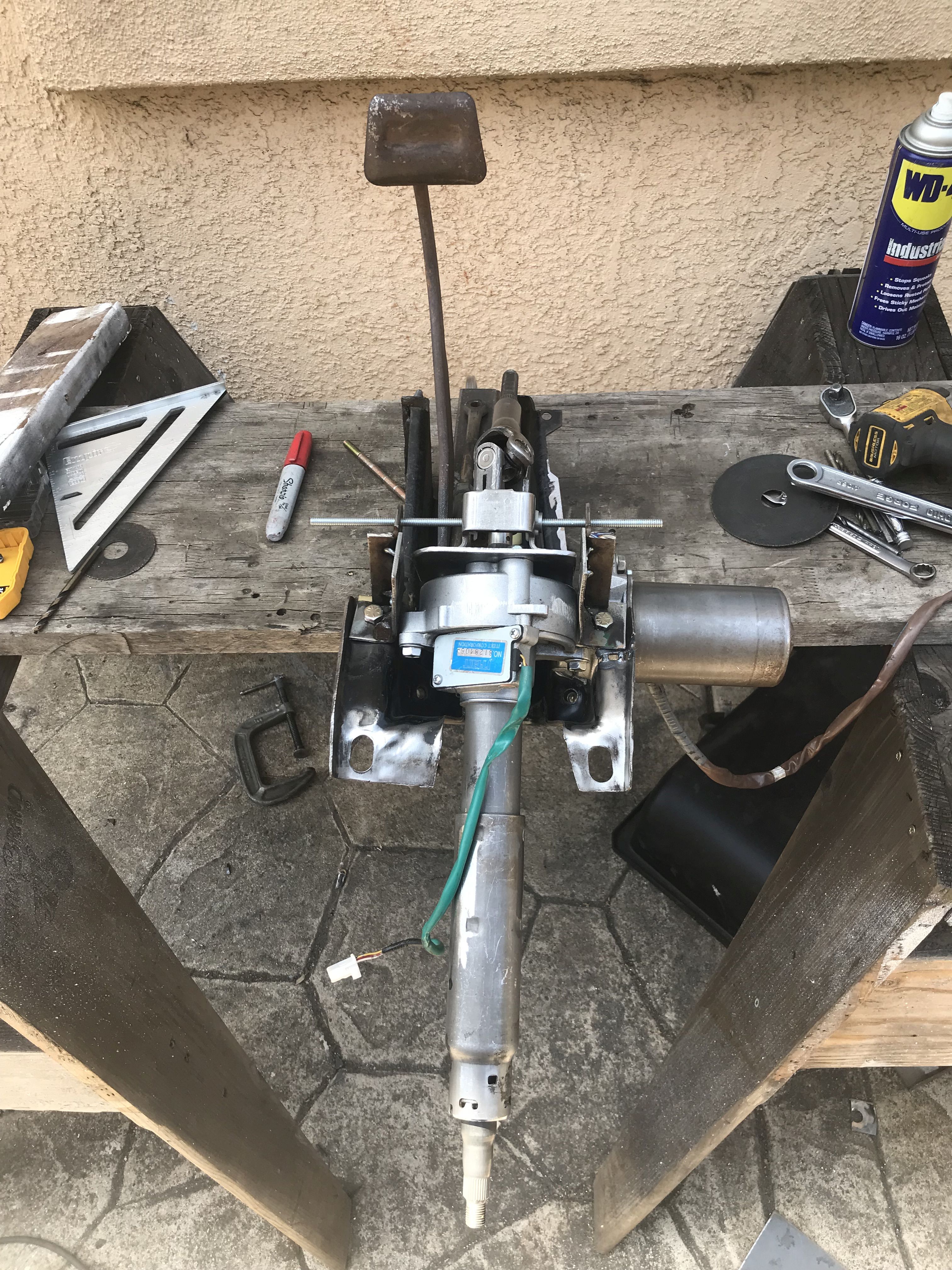

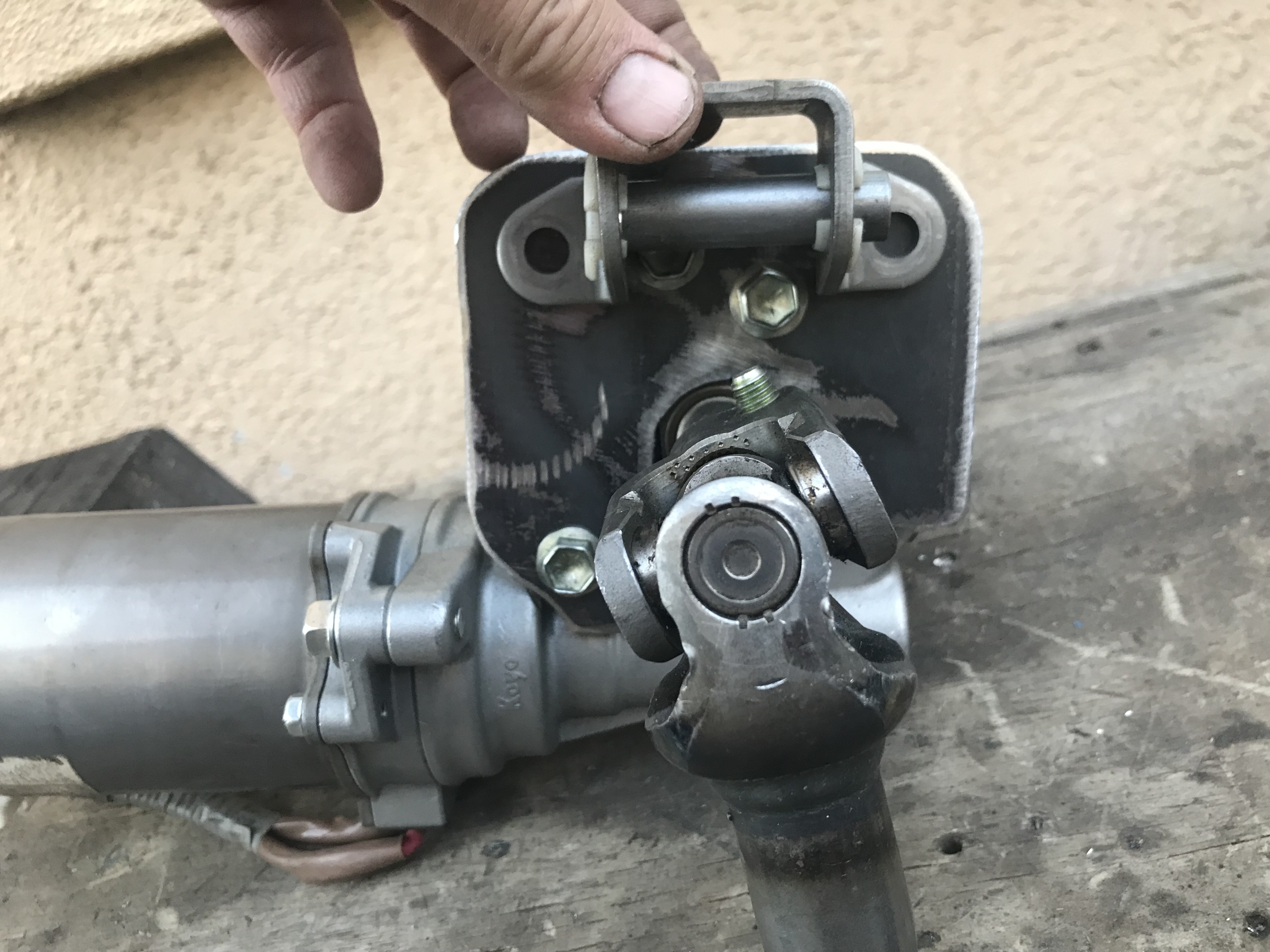

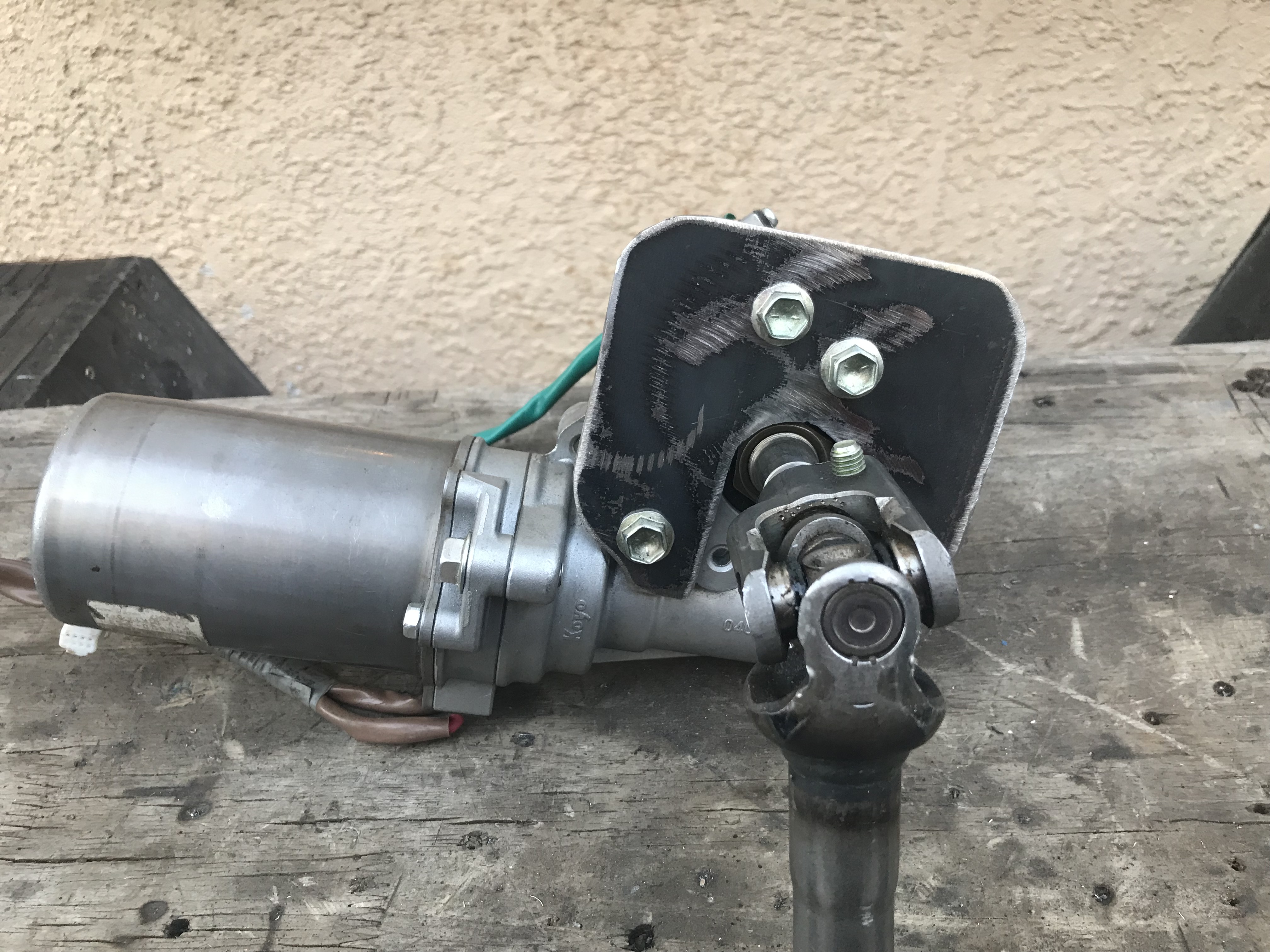

Post by Gregski »
finally settling on making a plate to re clock the pivot bracket (not for tilt per say but to help get the angle during mounting) something to hang it up with sorta speak

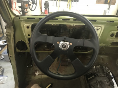

Post by Gregski »

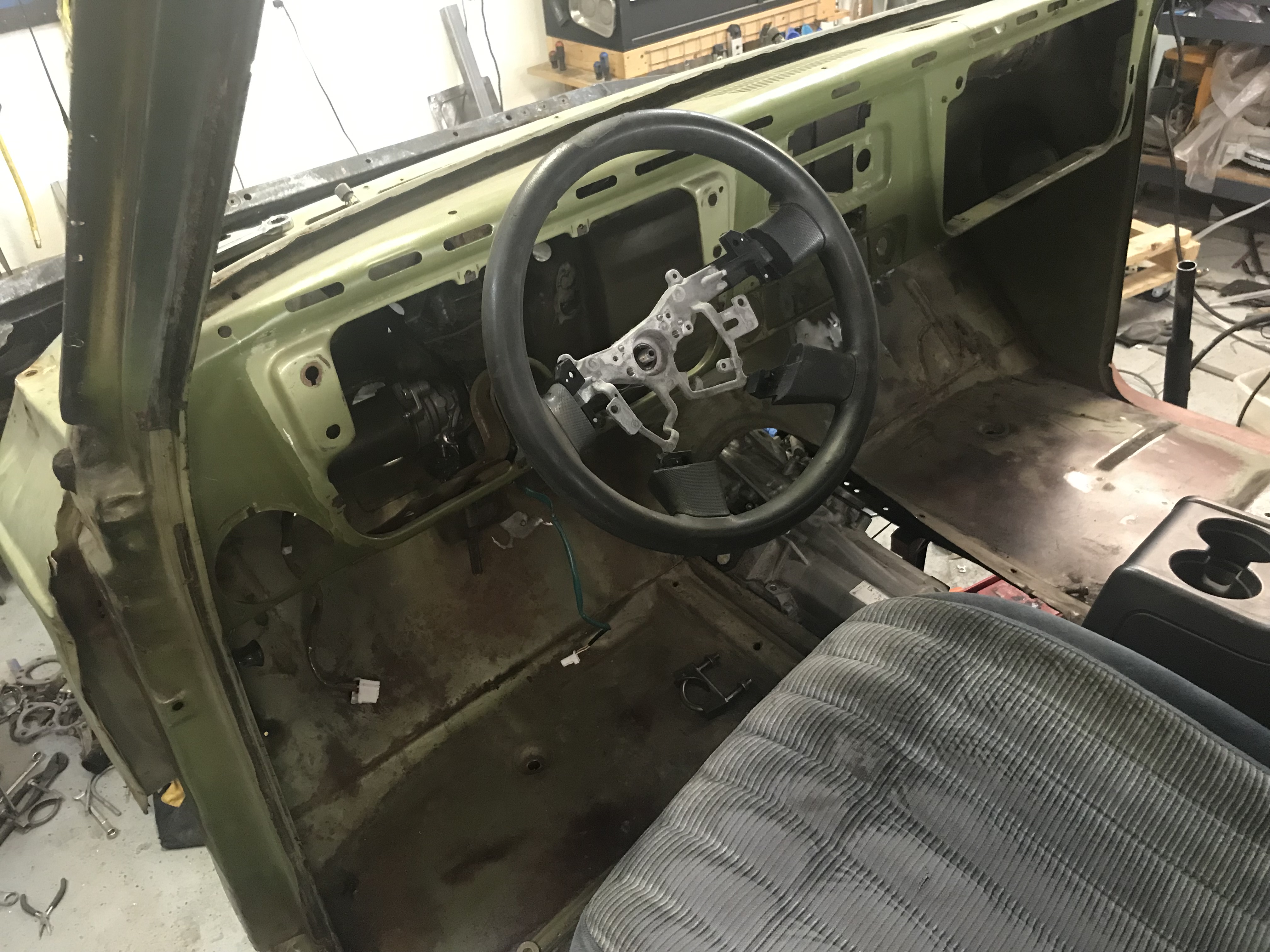

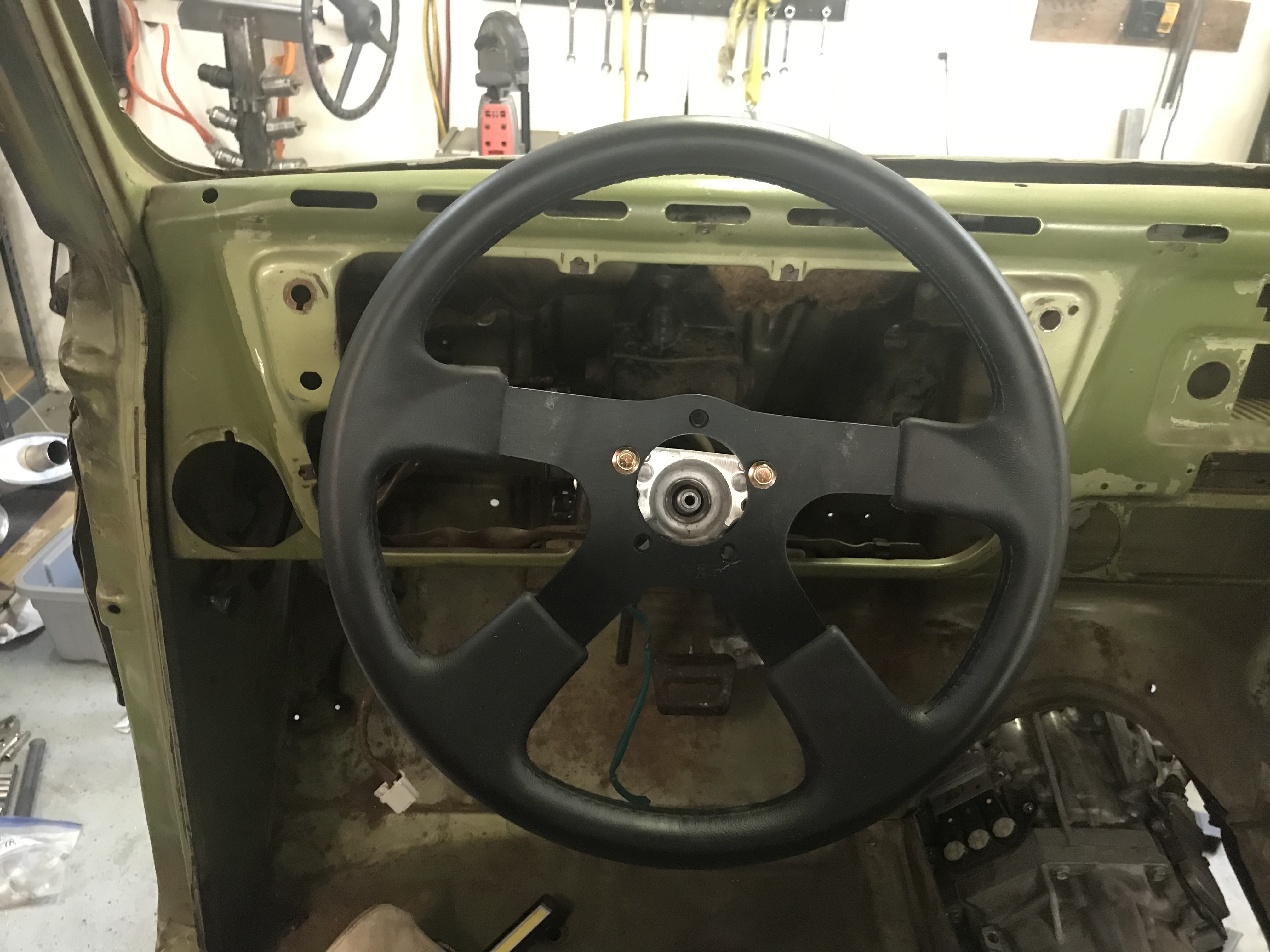

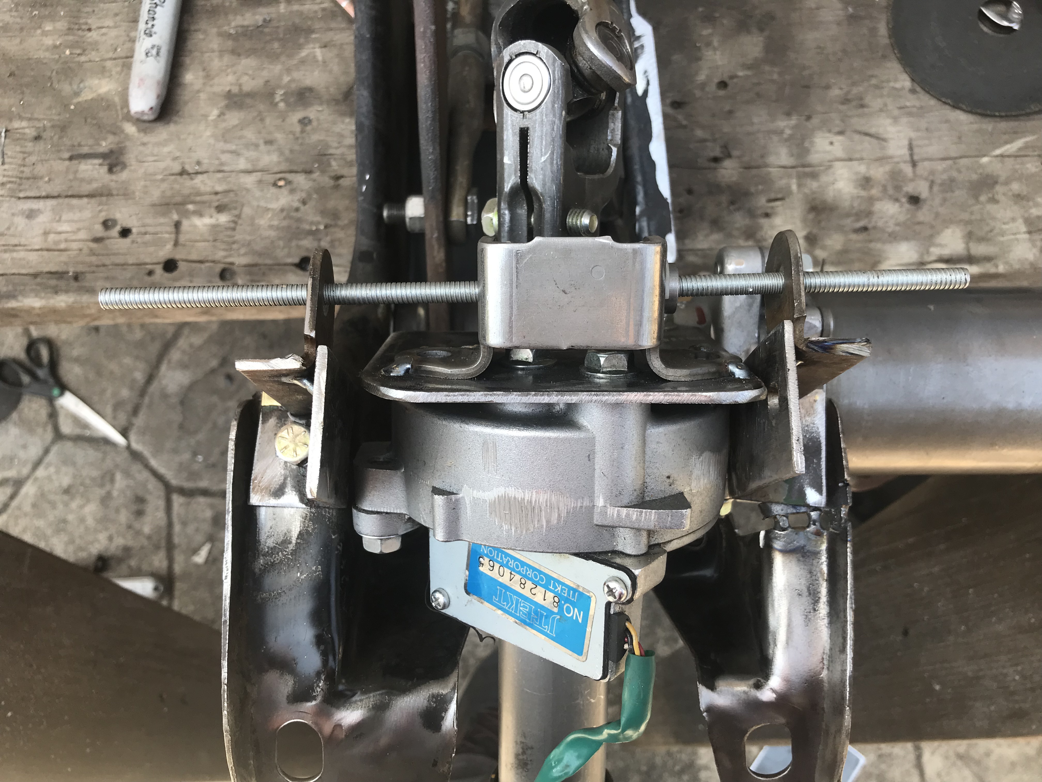

Captain's Log
it has been 857 Earth days since we landed on planet EPAS, and what started out as a standard recon mission has lets just say escalated
the threaded rod is for photo opp only
we aint really gonna run that fugly PRIUS steering wheel, it's just there as a prop
Gregski
Posts: 3157

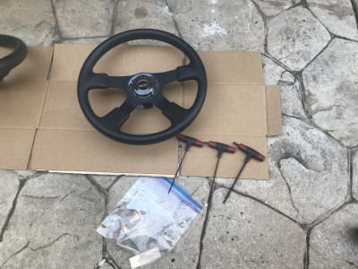

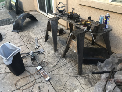

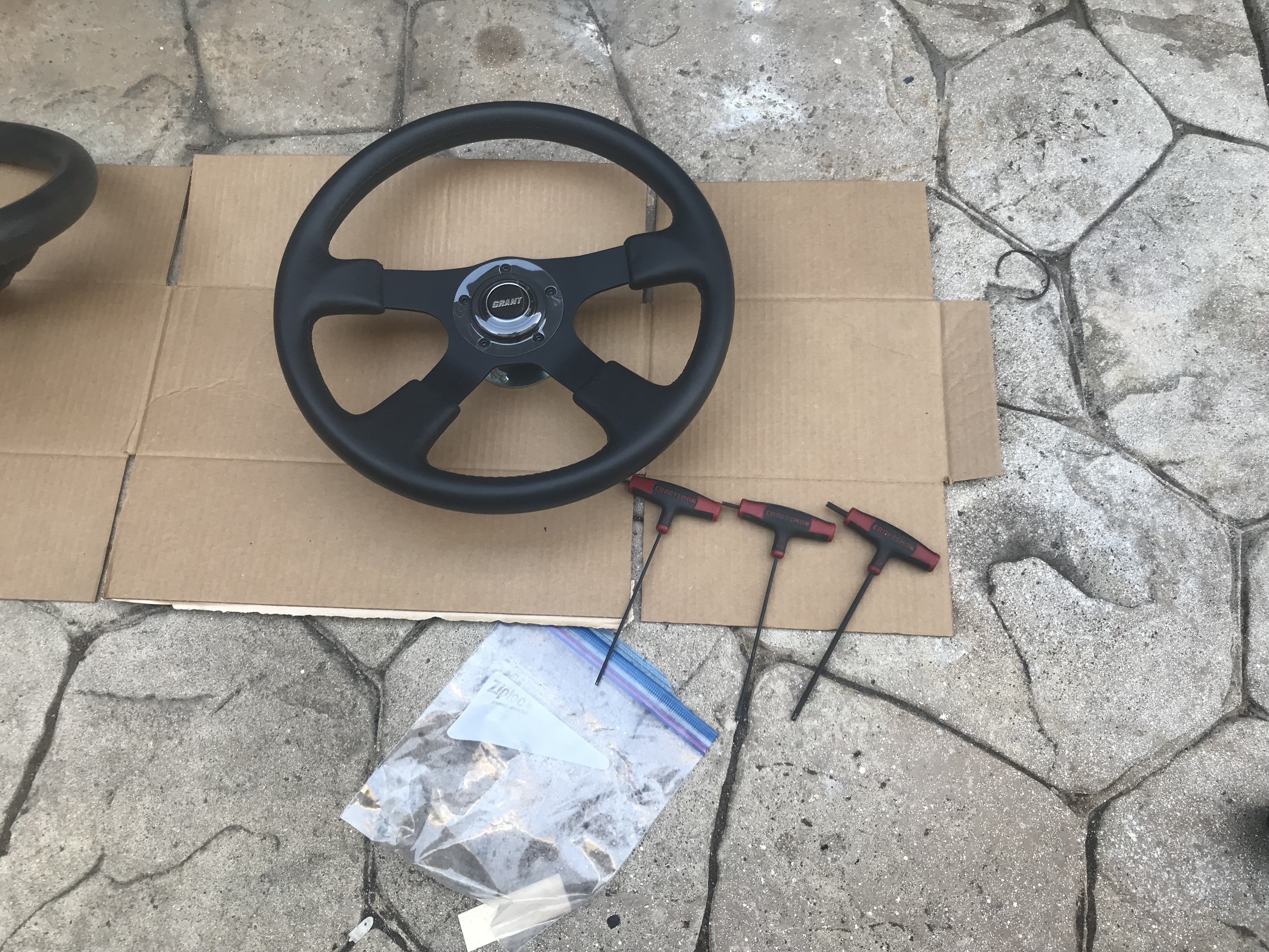

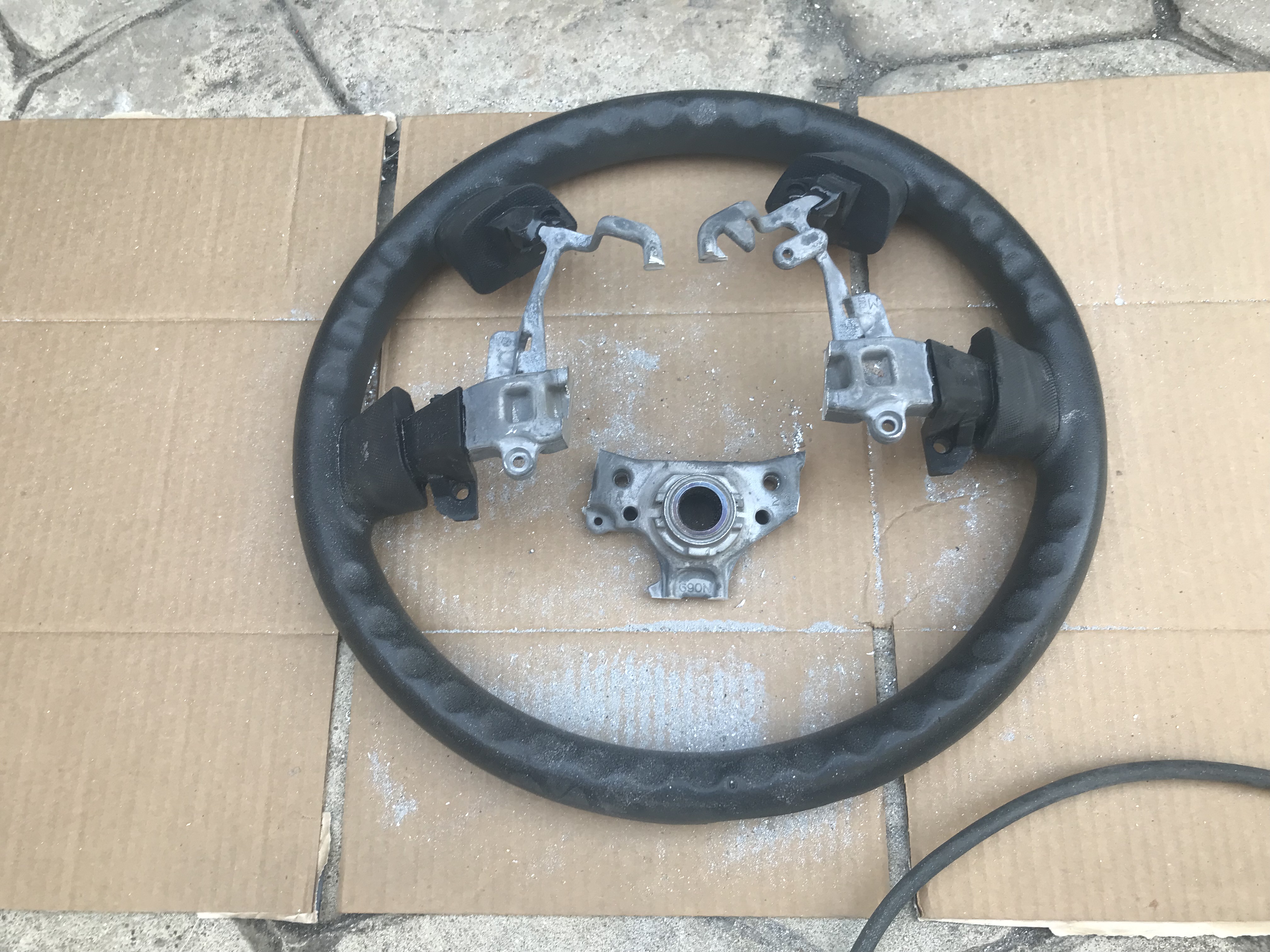

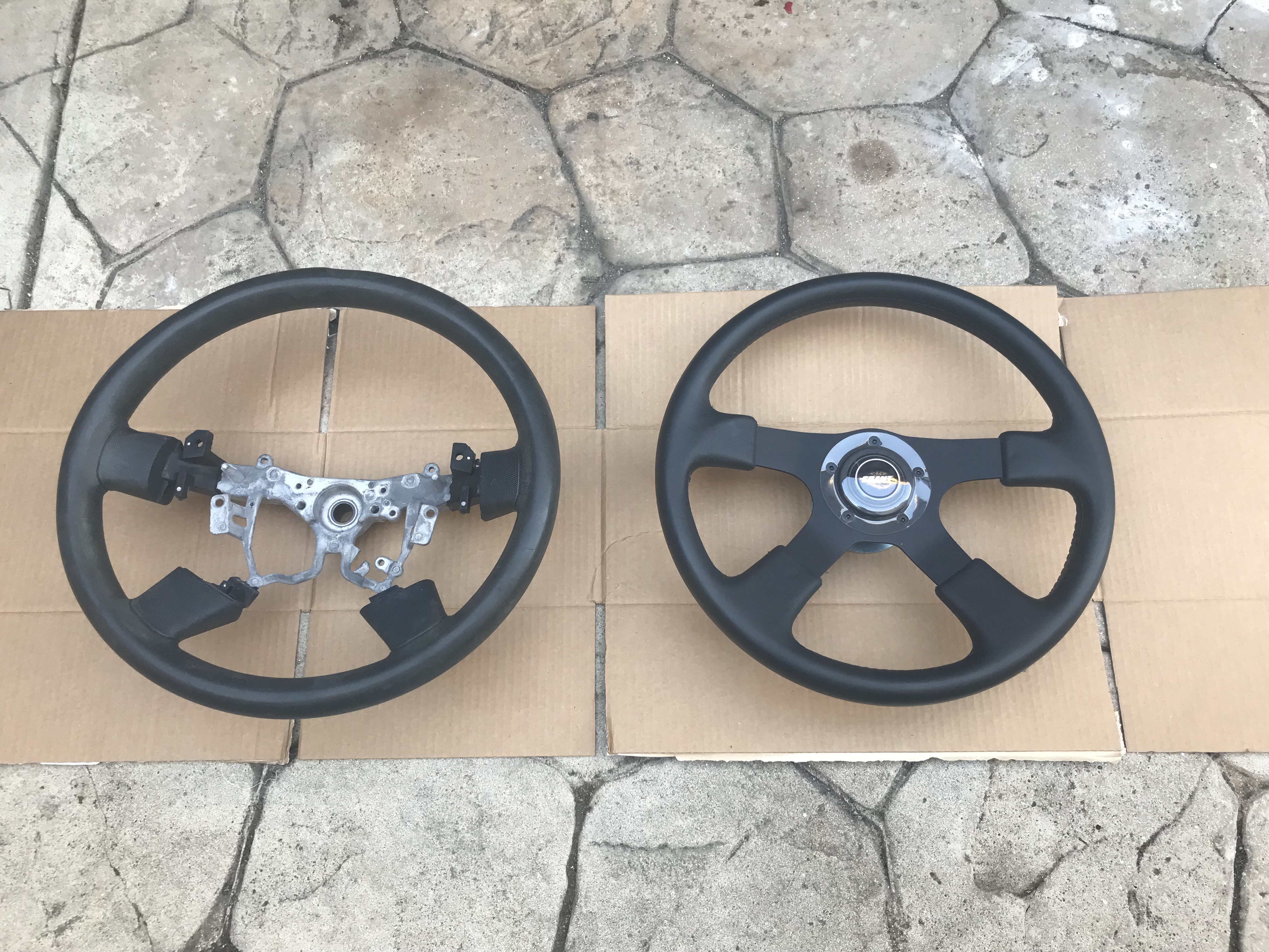

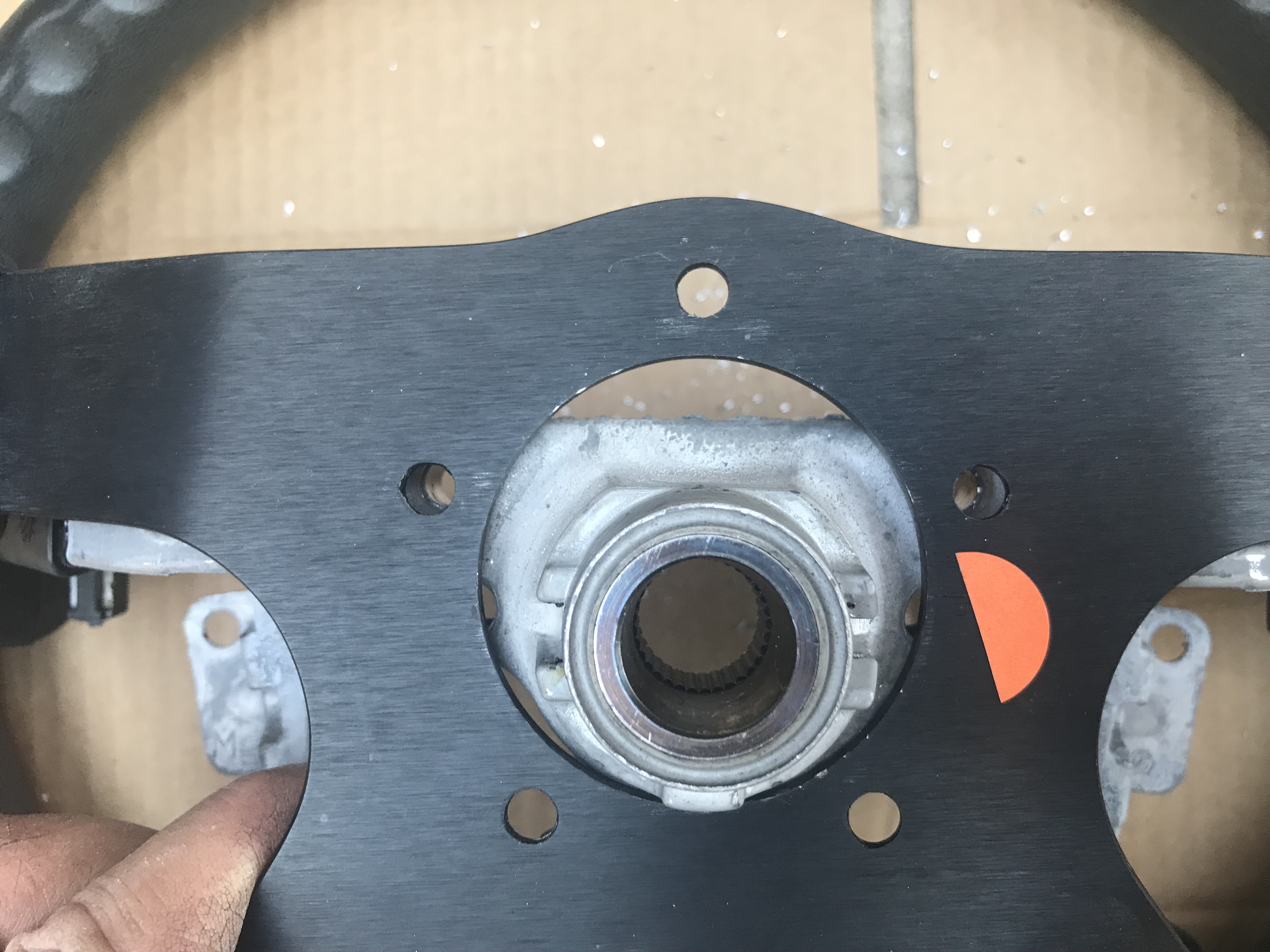

Post by Gregski »

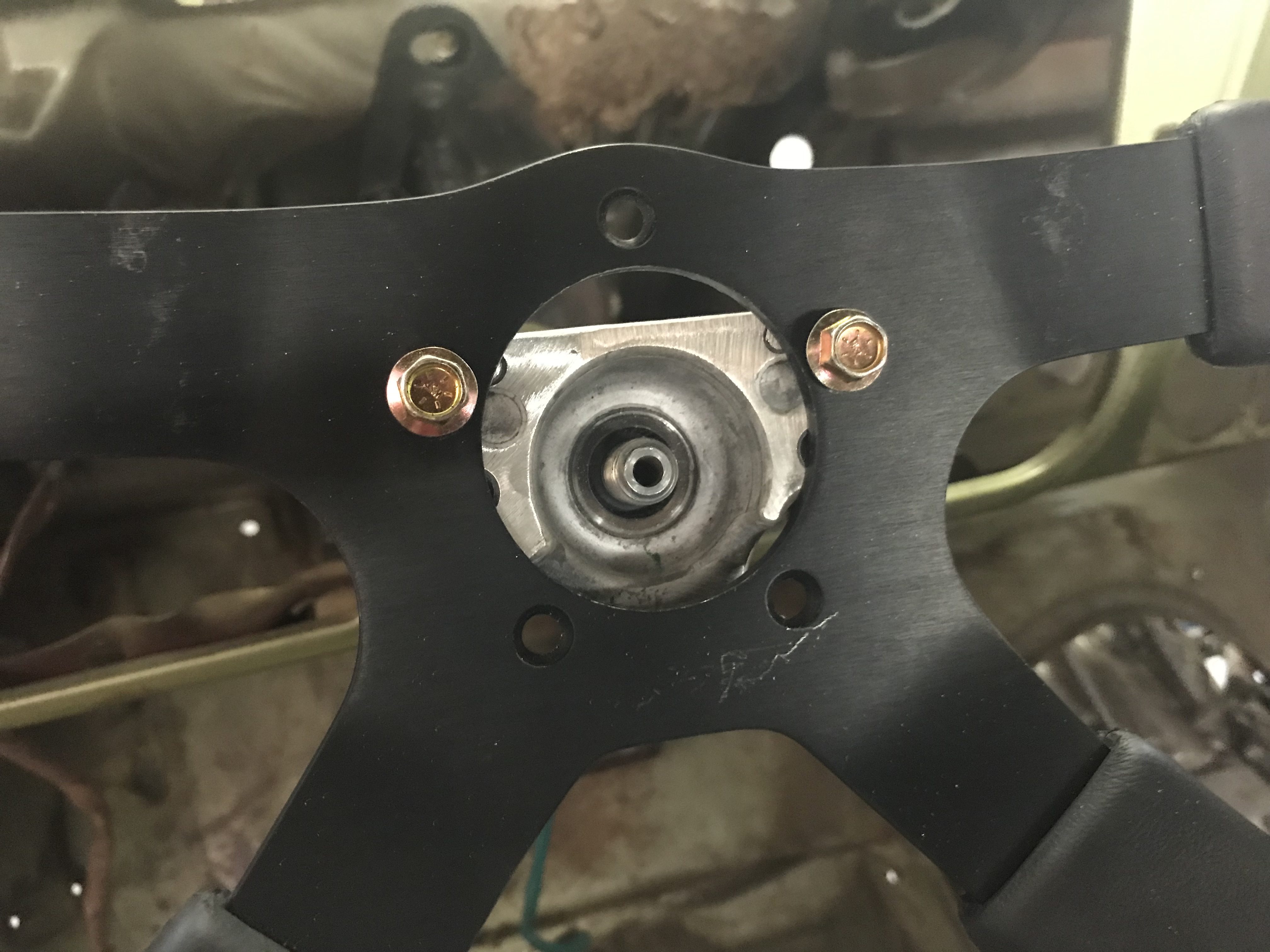

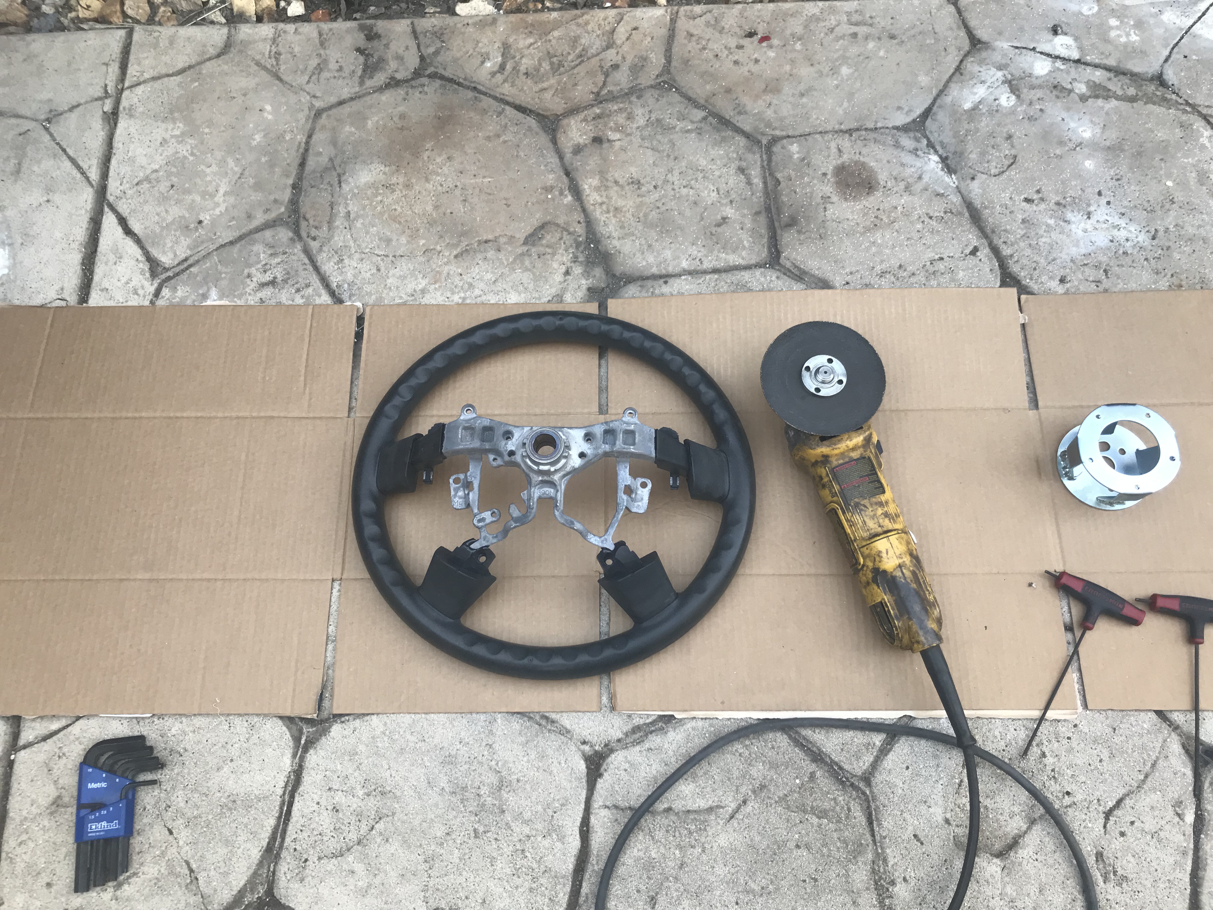

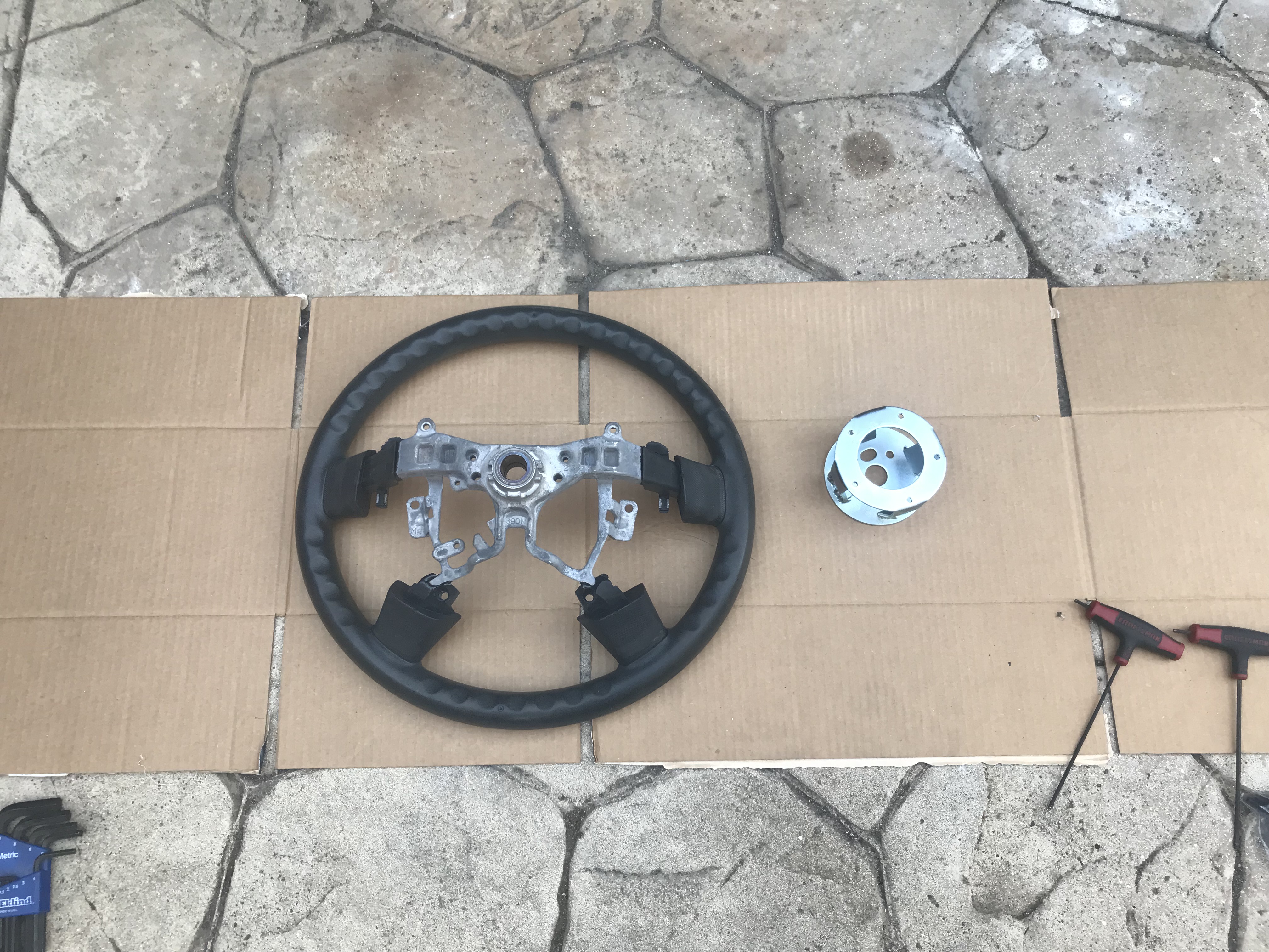

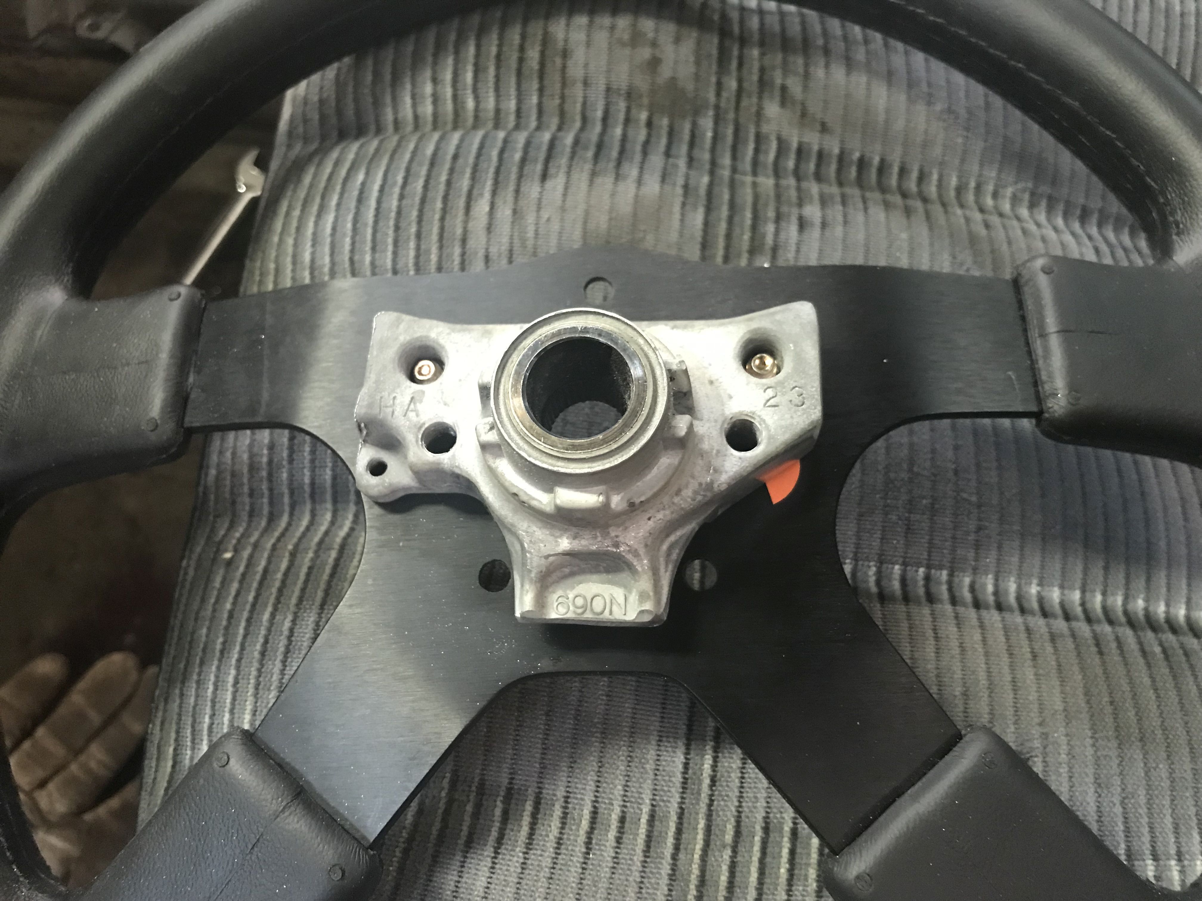

so let's adopt this to that, as I am sure Grant makes an adapter for their Hot Rod wheels to a Prius for sure, but going that route would be cheating
I know right?! four spokes, chics luv four spokes!
oh that's cute, Grant is using metric hexeseseses so my 'merican ones don't work, great!
so how do we adopt this to that?
hmmmm, two holes align...
time for the plasma cutter
like a surgeon

Post by Gregski »
ah, it's temporary

Post by Gregski »
and the problems kept on coming
my rod was too short [where have I heard that before?]
this is just a mock up

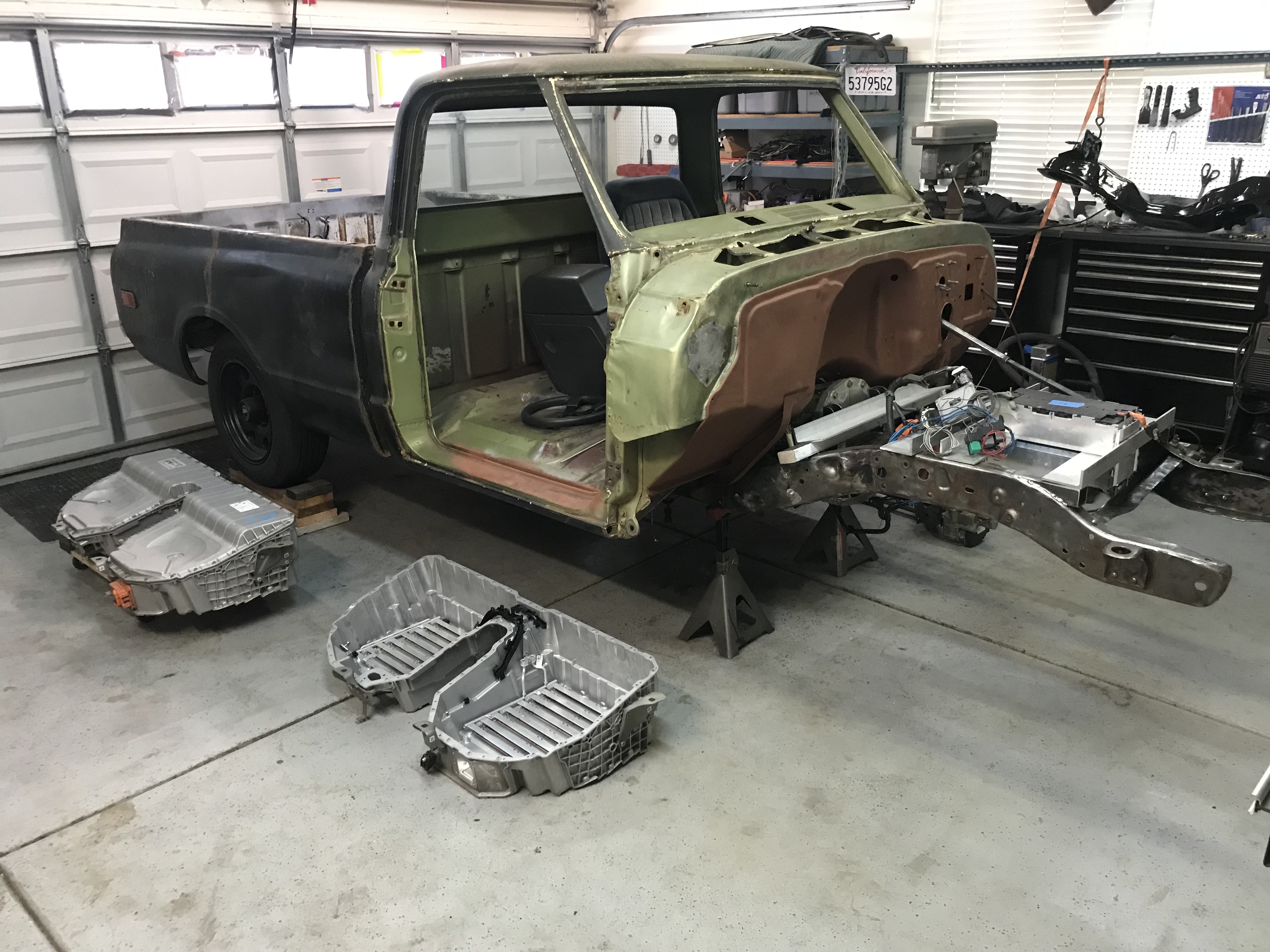

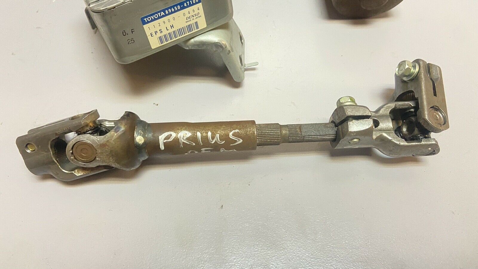

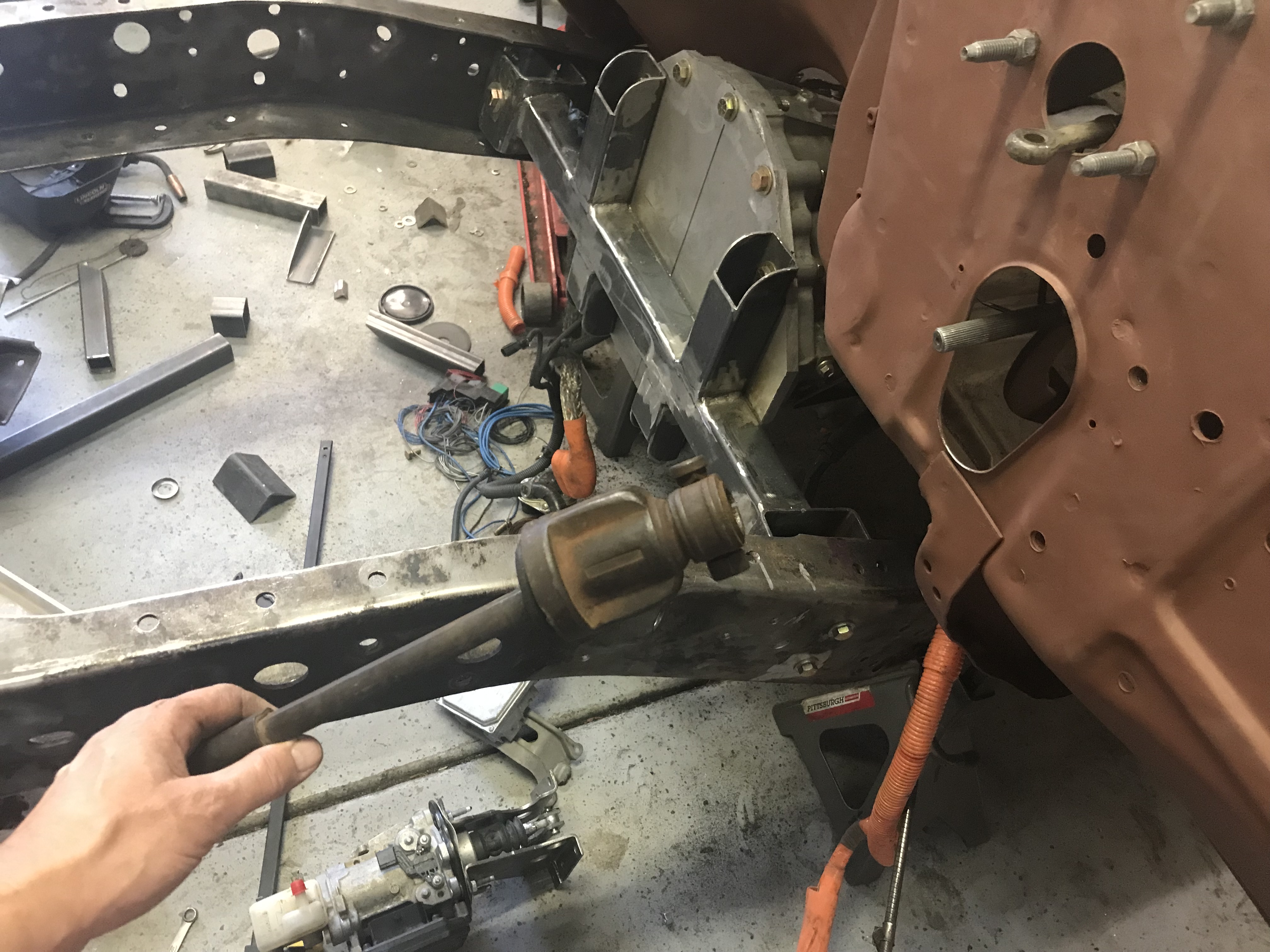

Post by Gregski »

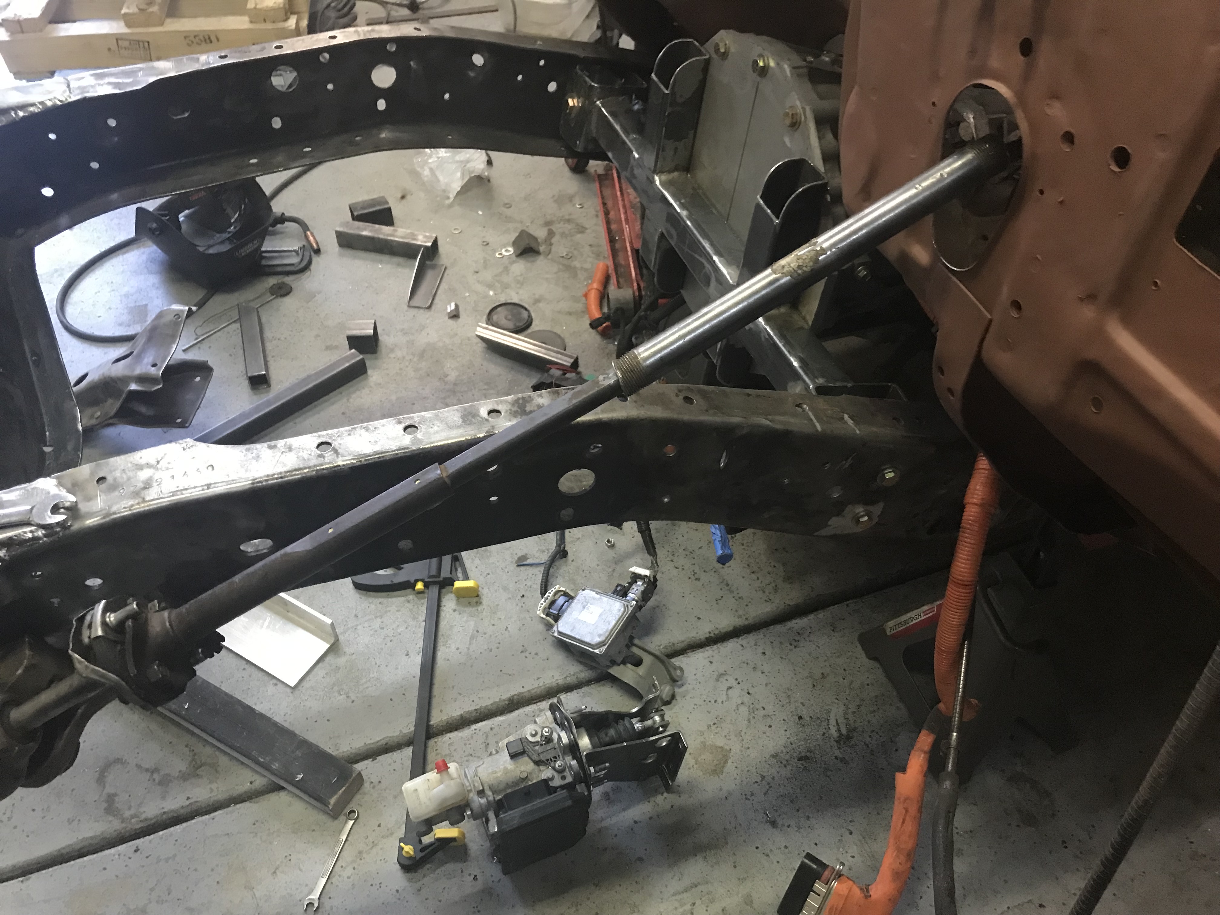

one of the challenges I'm facing with the steering in a truck is the sheer length of the steering shafts, think of the Prius as a pug and my truck as a Borzoi wolfhound (yes that took seconds of Googling dog images to find - you're welcome)

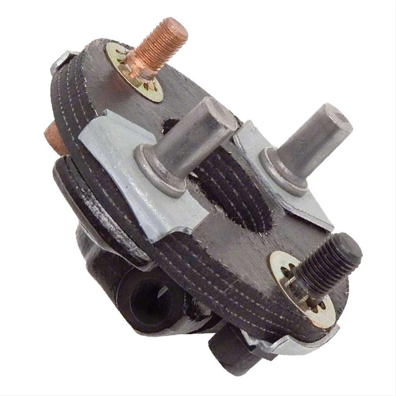

Post by Gregski »

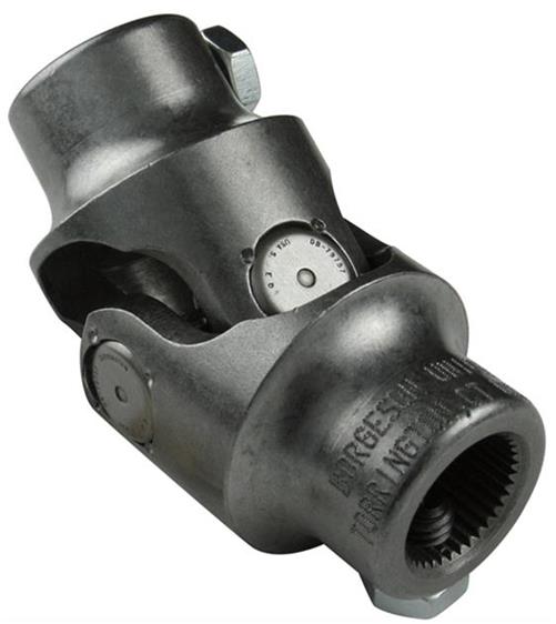

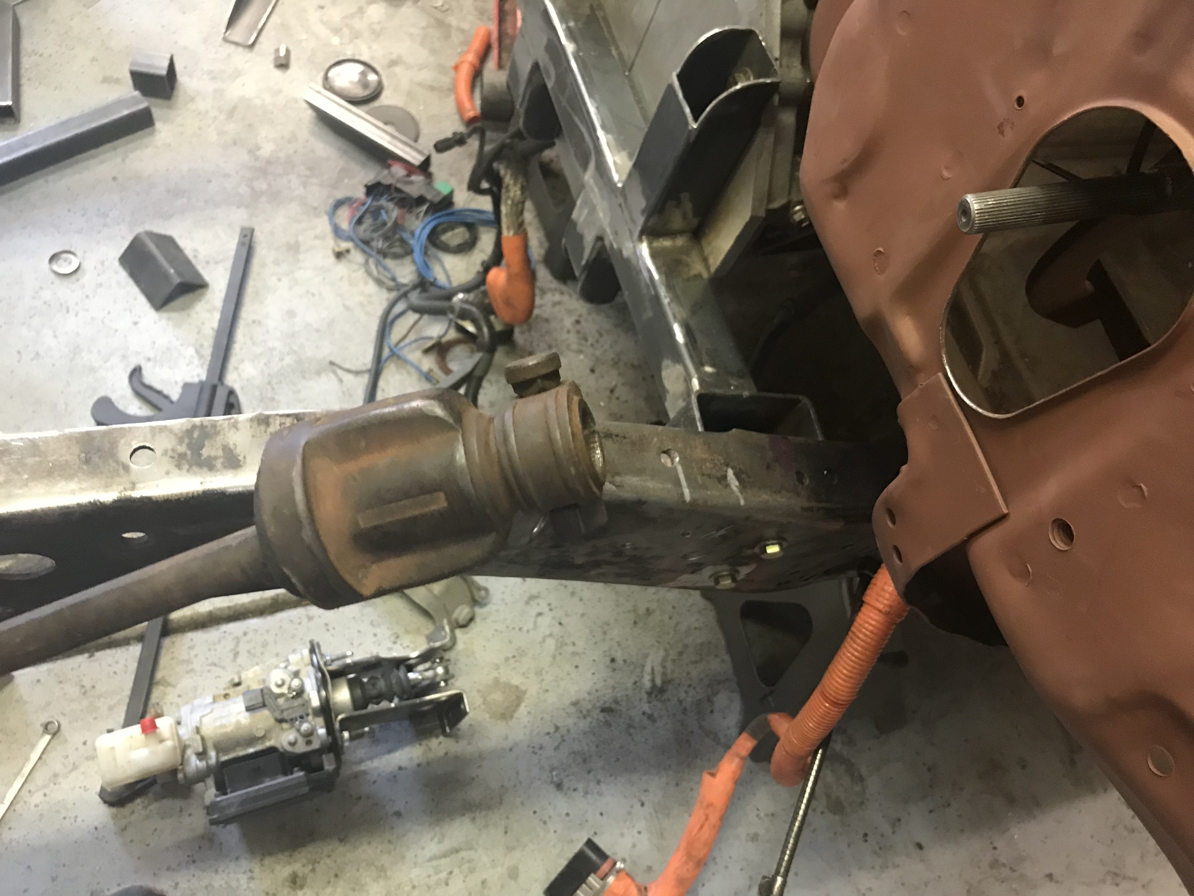

so the long steering rod connects to the steering box using something called a rag joint (you can't make this stuff up folks) basically a round piece of an old tire, ha ha that's supposed to absorb some of the vibrations as the farmer goes down the dirt road in one of them trucks, folks these days replace them with U joints (defeating their original shock absorption purpose) and I may do the same (but probably not)
Gregski
Posts: 3157
Post by Gregski »
the long "intermediate" steering shaft that runs from the rag joint on up to the steering column inside the firewall is really made up of two pieces, designed to slide inside each other incase of a head on collision allowing the driver to be decapitated by the hood (ahem bonnet) instead, so I am keeping that rod and will just have to extend it 6 inches, or I may replace the Prius "intermediate" shaft with one from her sister car a Corolla
so much math

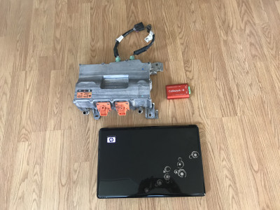

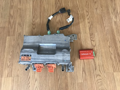

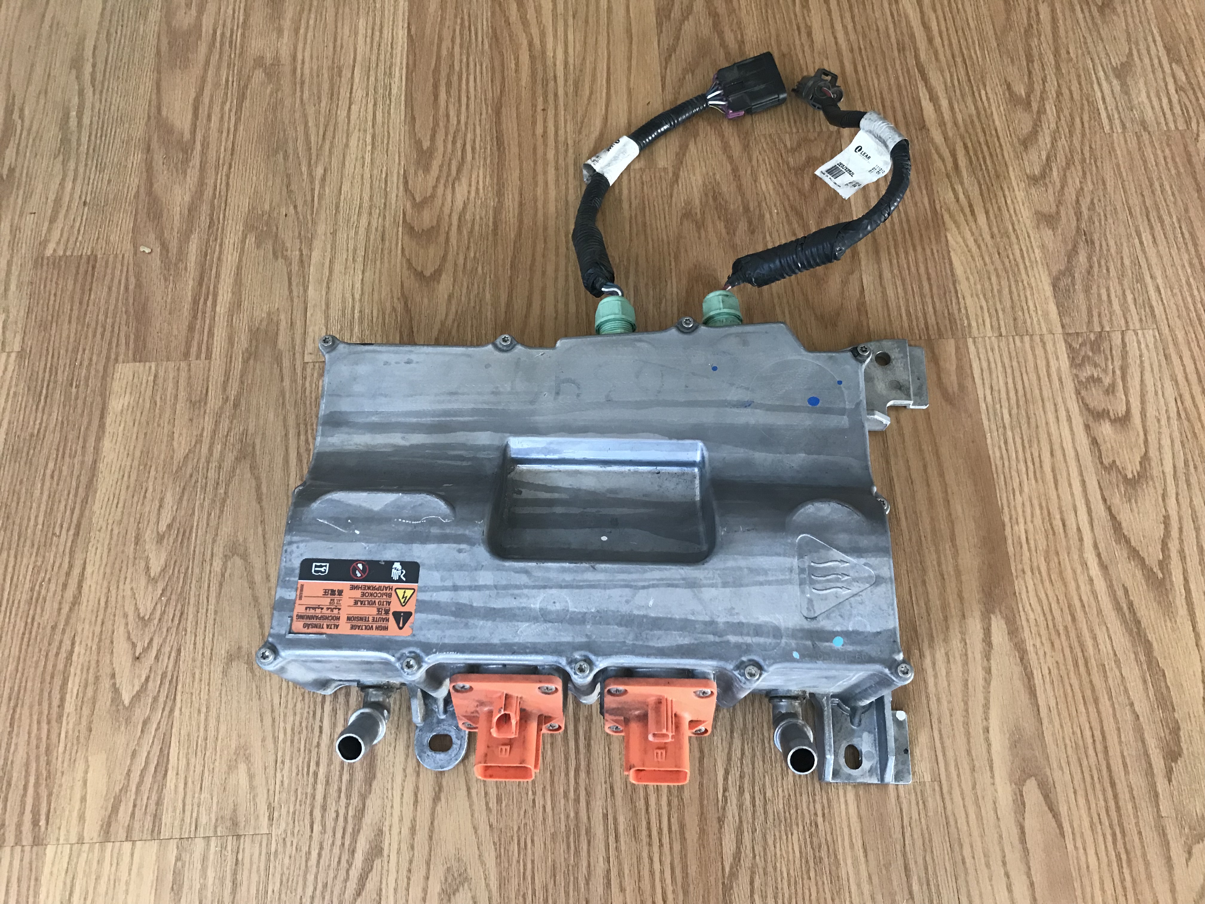

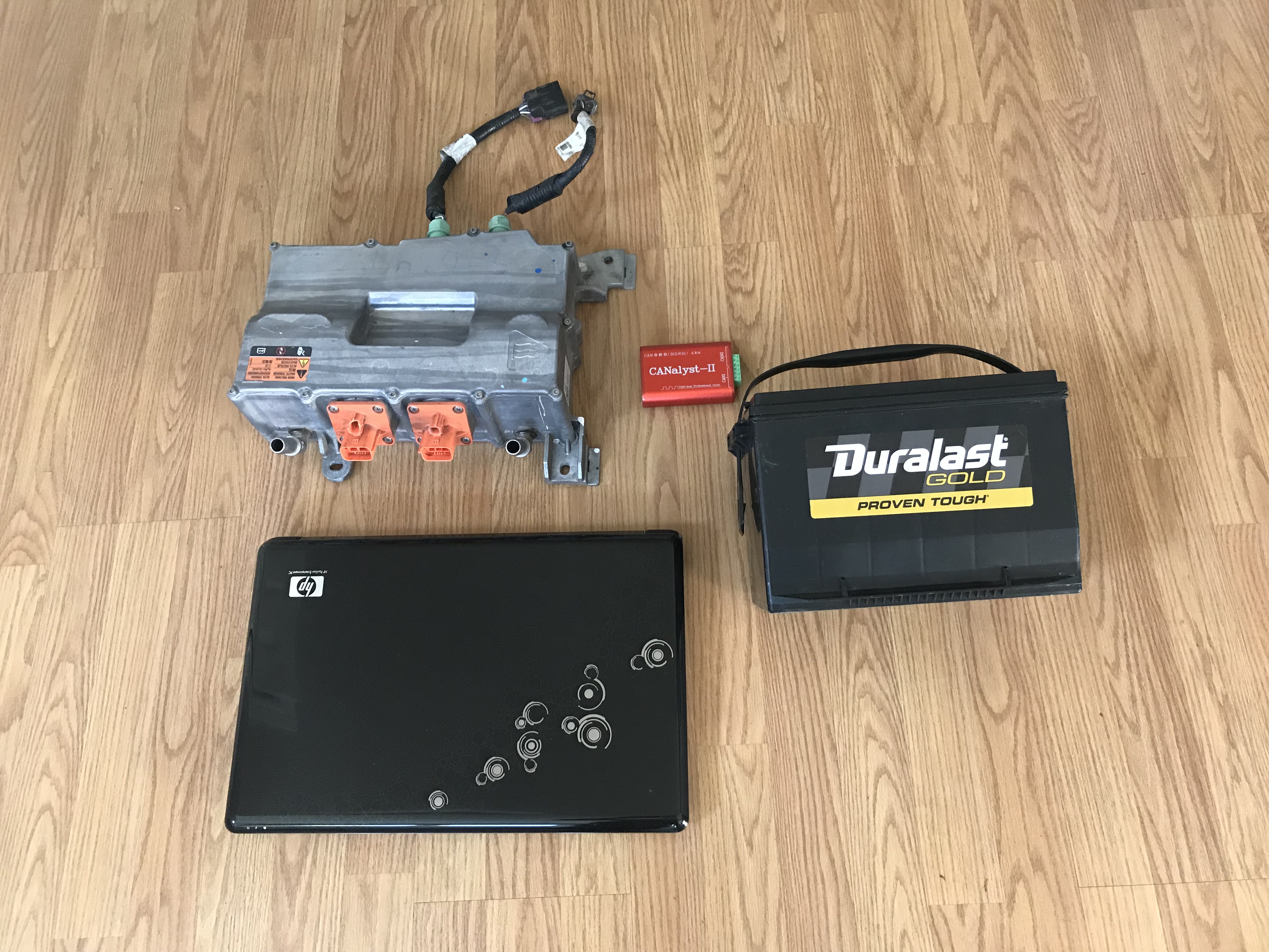

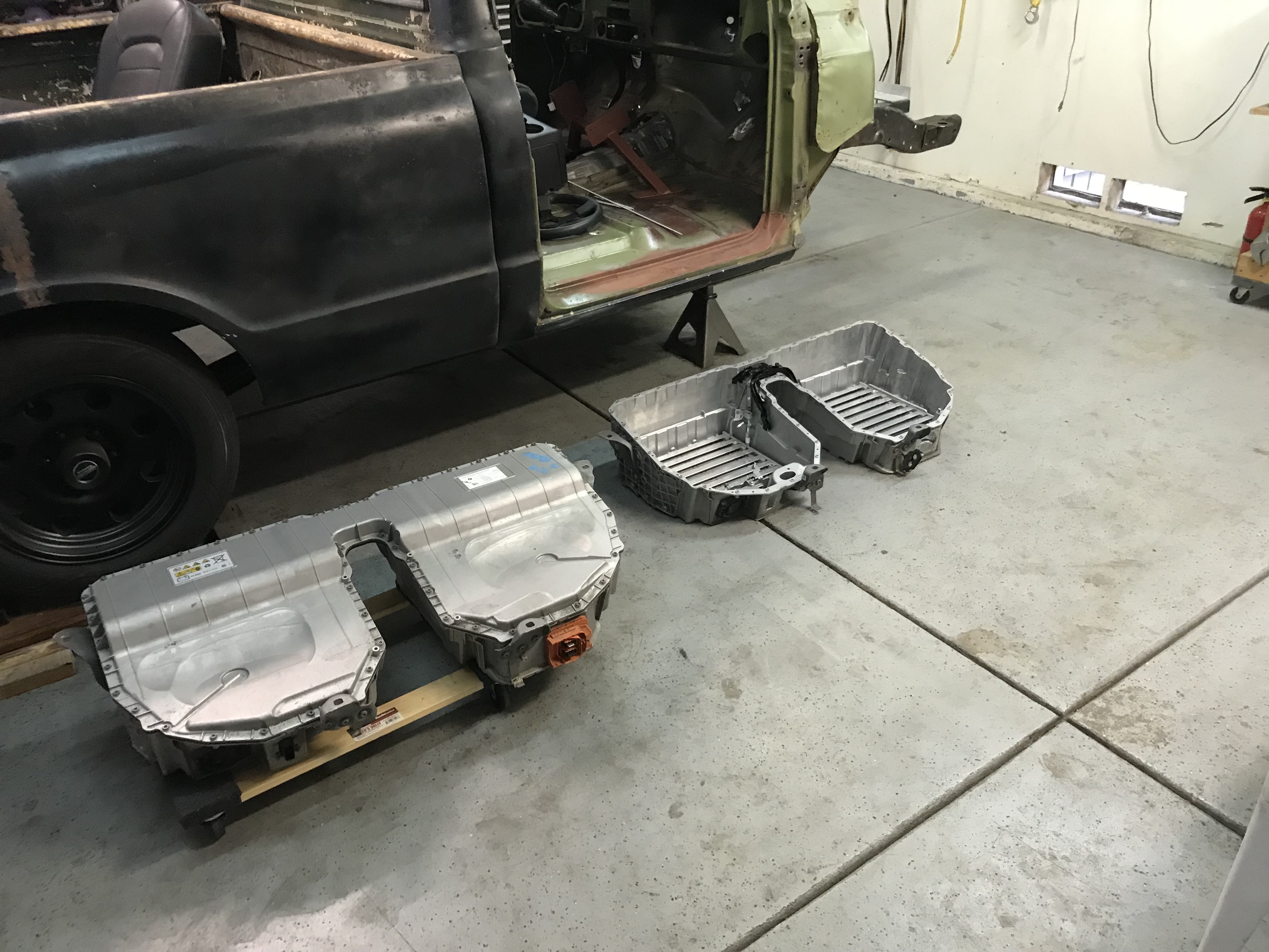

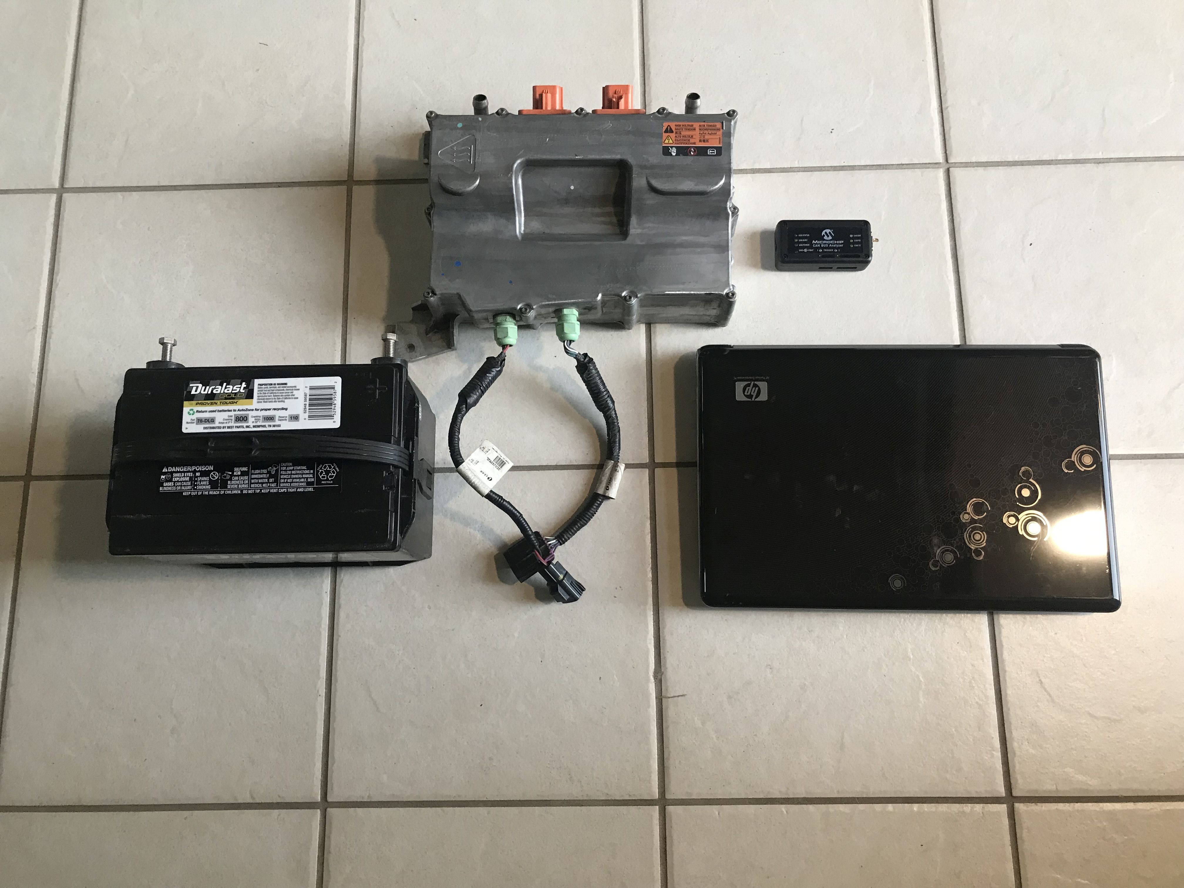

Post by Gregski »

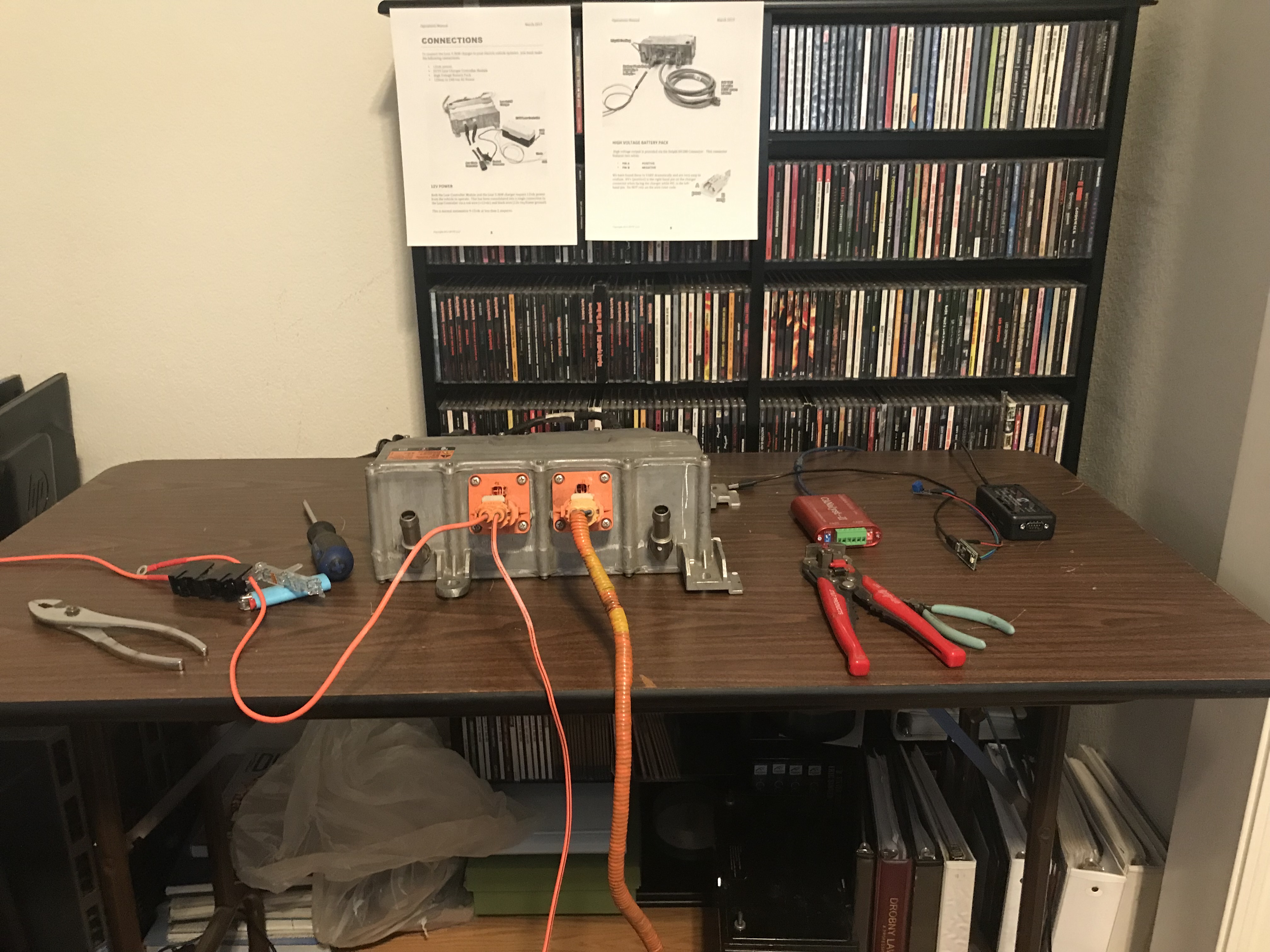

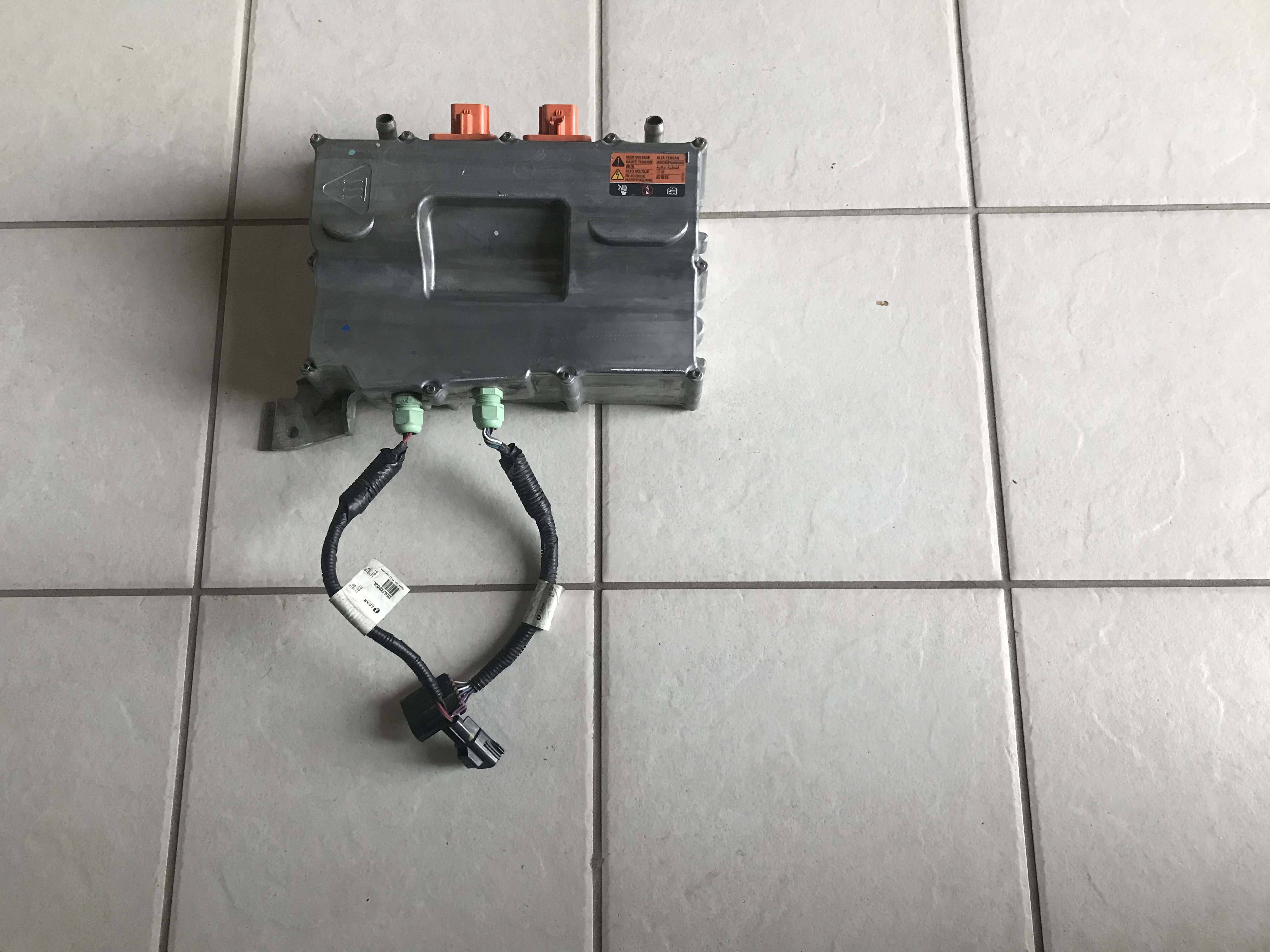

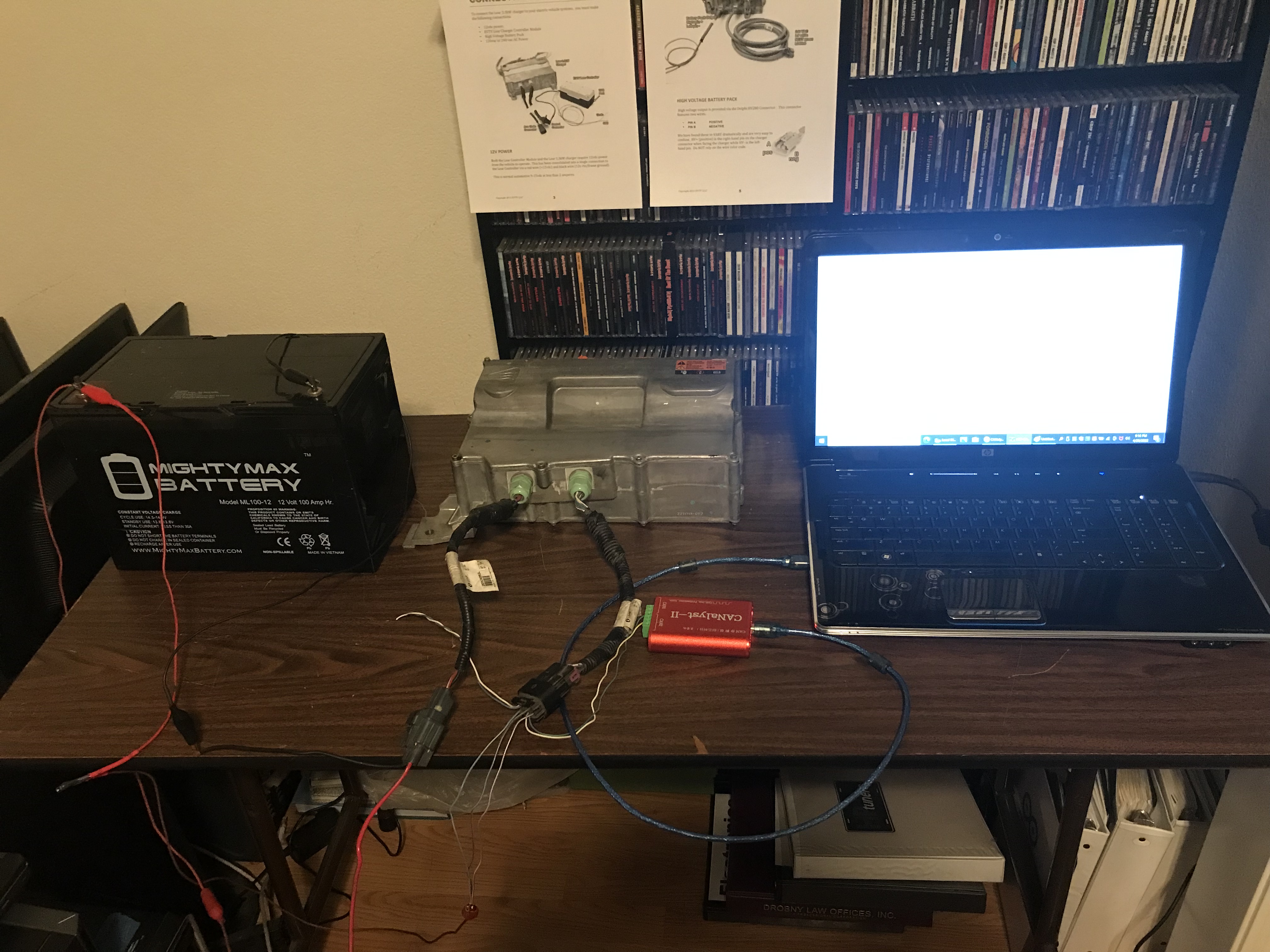

so since our son is home from Uni for the weekend I am using that as an excuse to stay quiet and clean this whole weekend so no cutting, drilling, or grinding
so it's time to fandangle with the Chevy Volt onboard battery charger, I put it off long enuff
my logic went like this, hey you're converting a Chevy truck, wouldn't it be cool to use some electric Chevy parts on it...

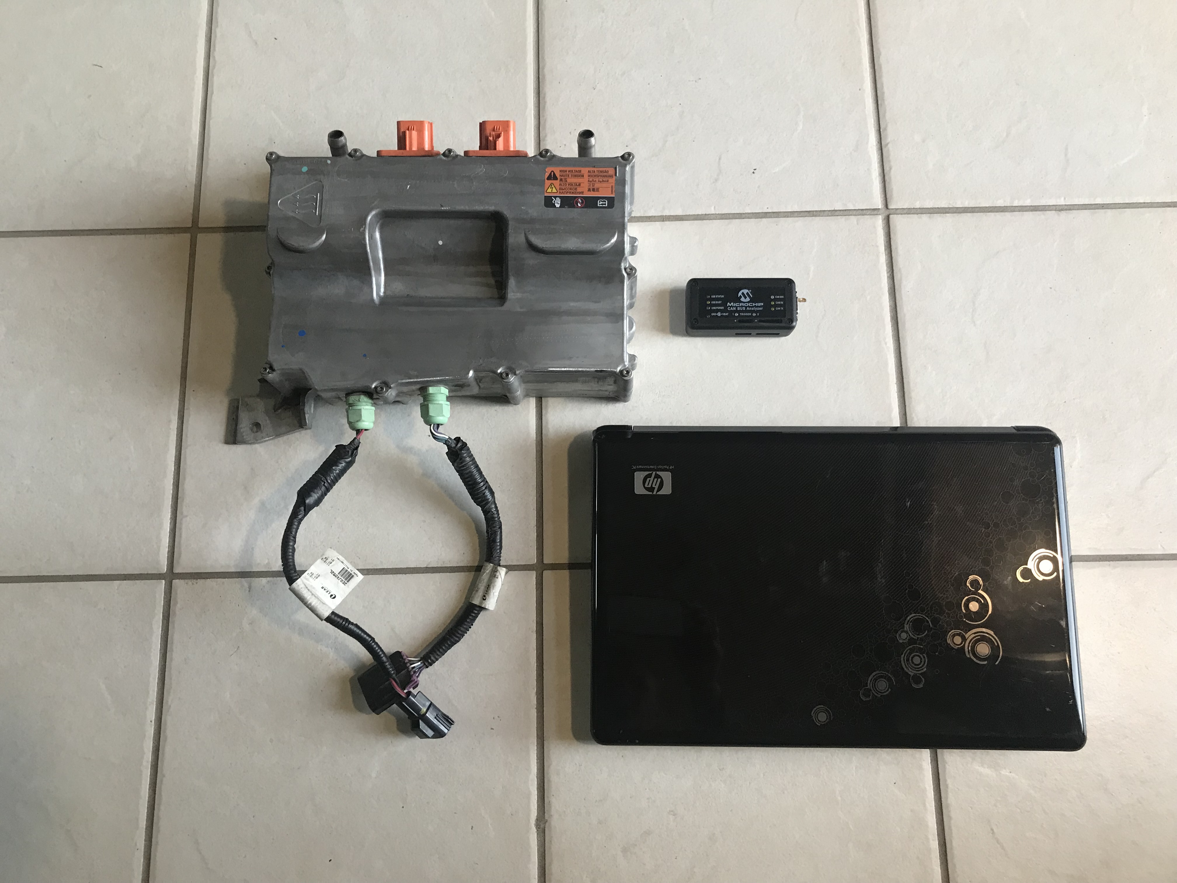

Gregski
Posts: 3157

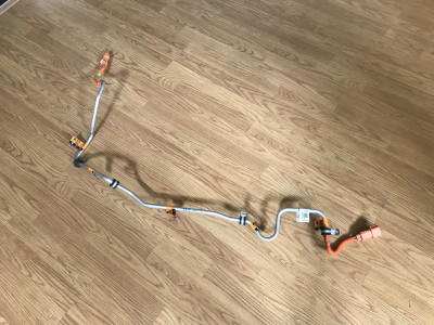

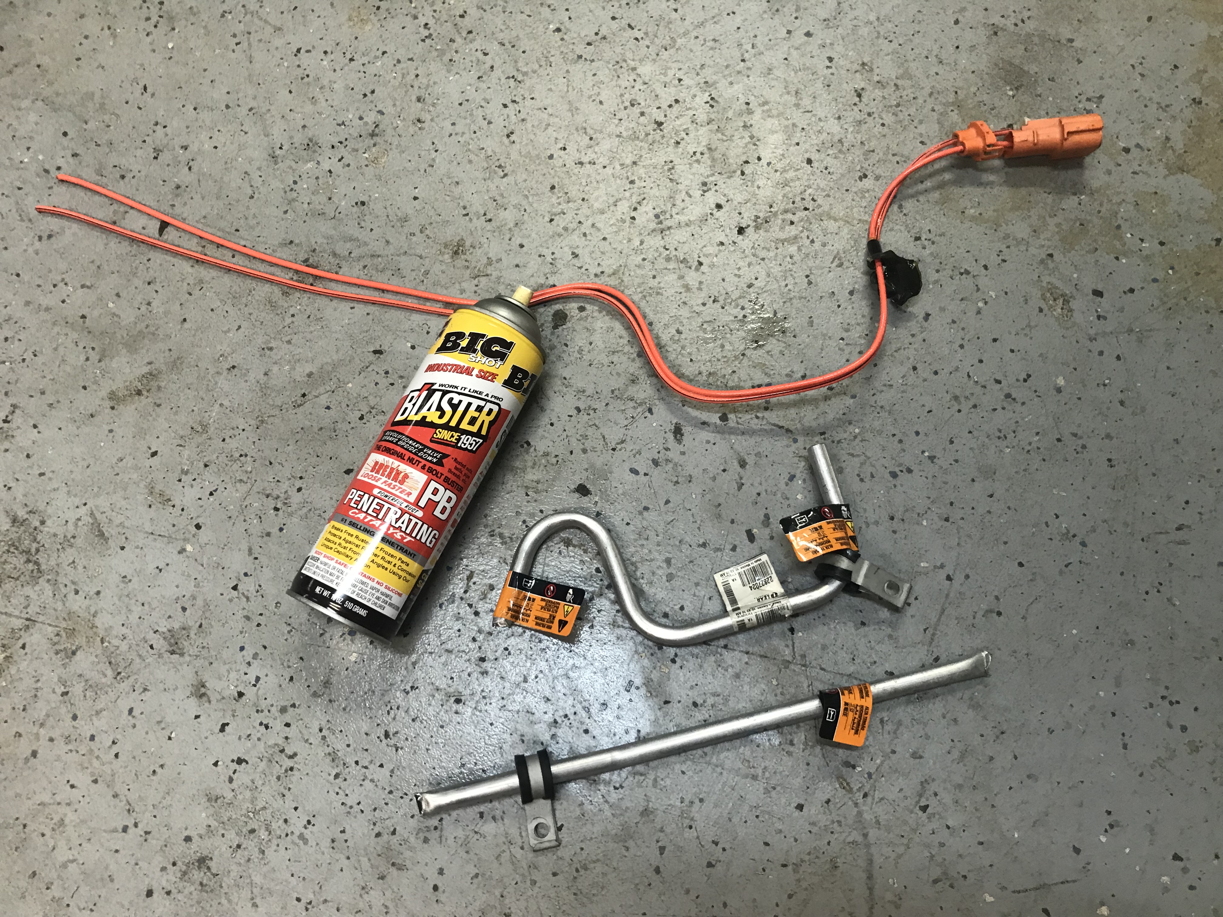

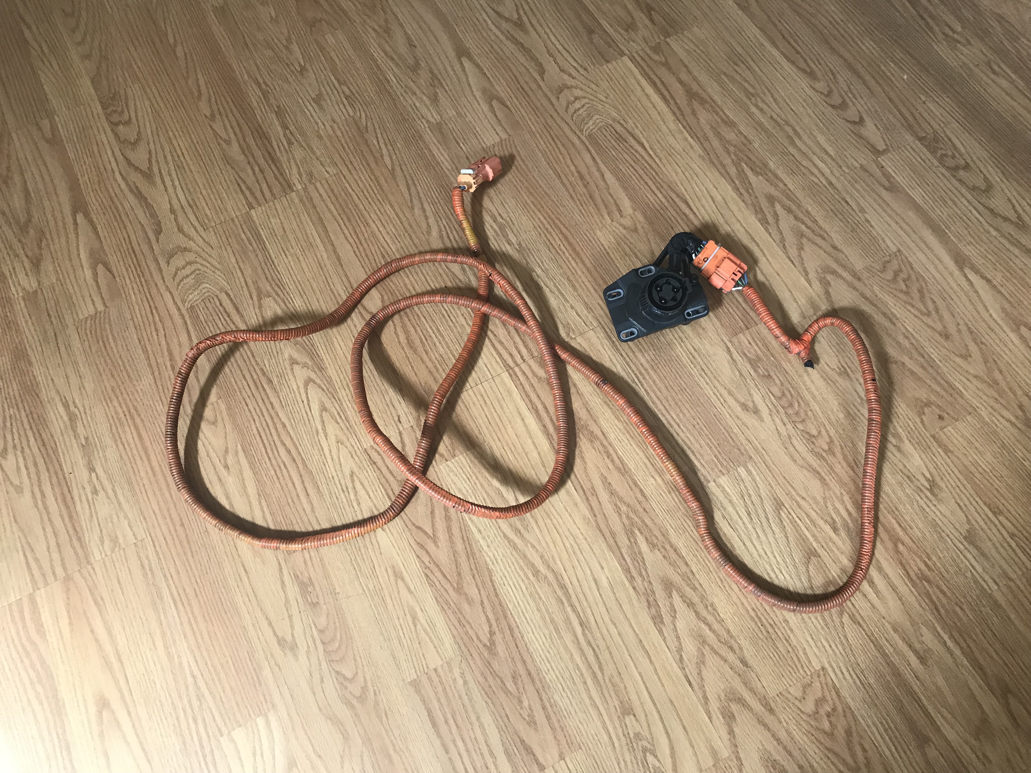

Post by Gregski »

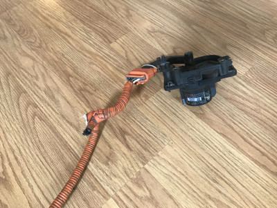

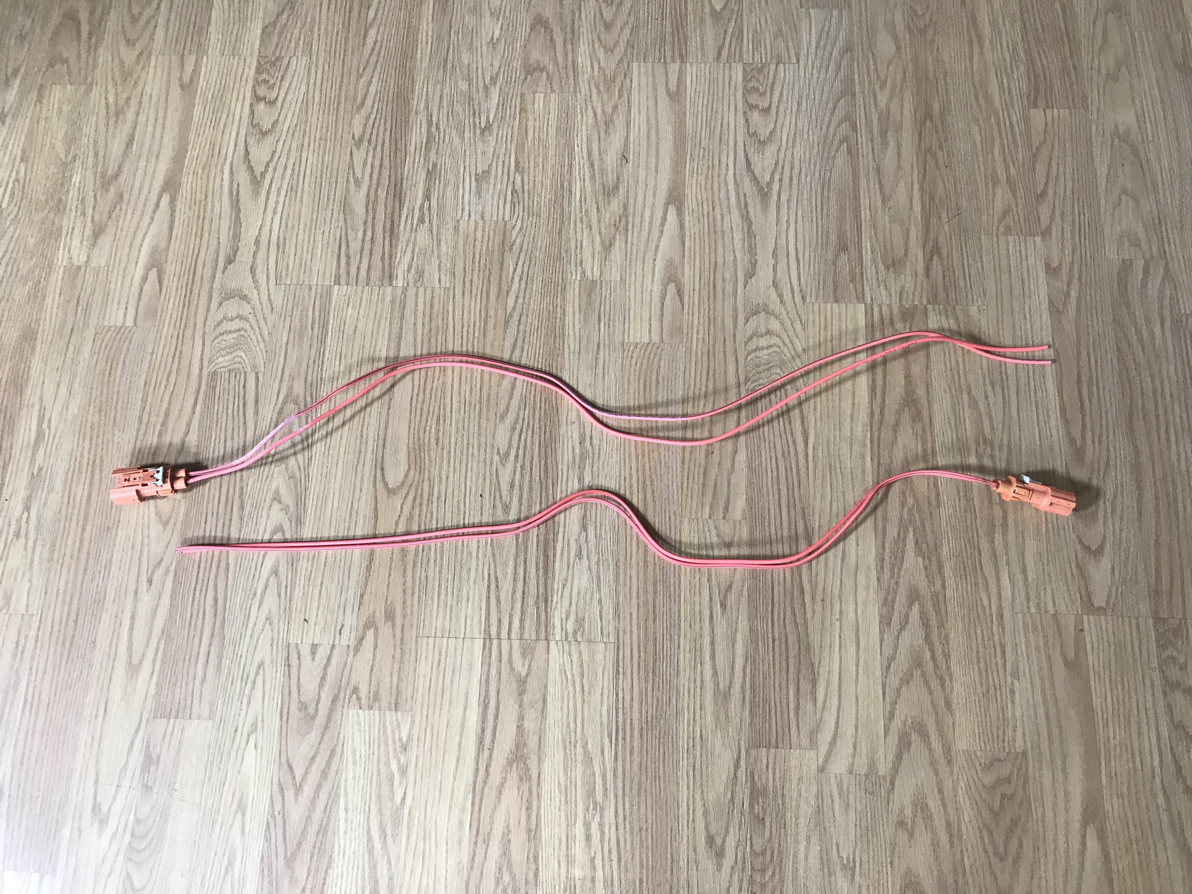

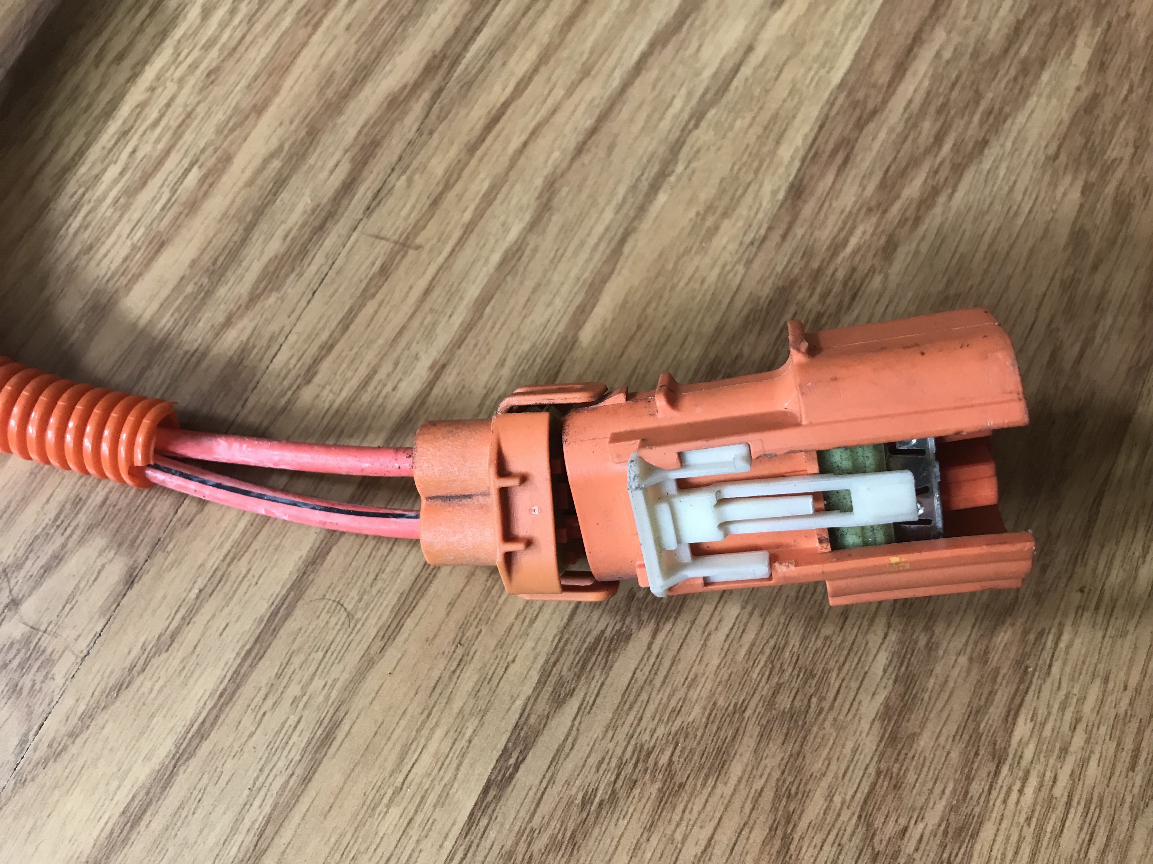

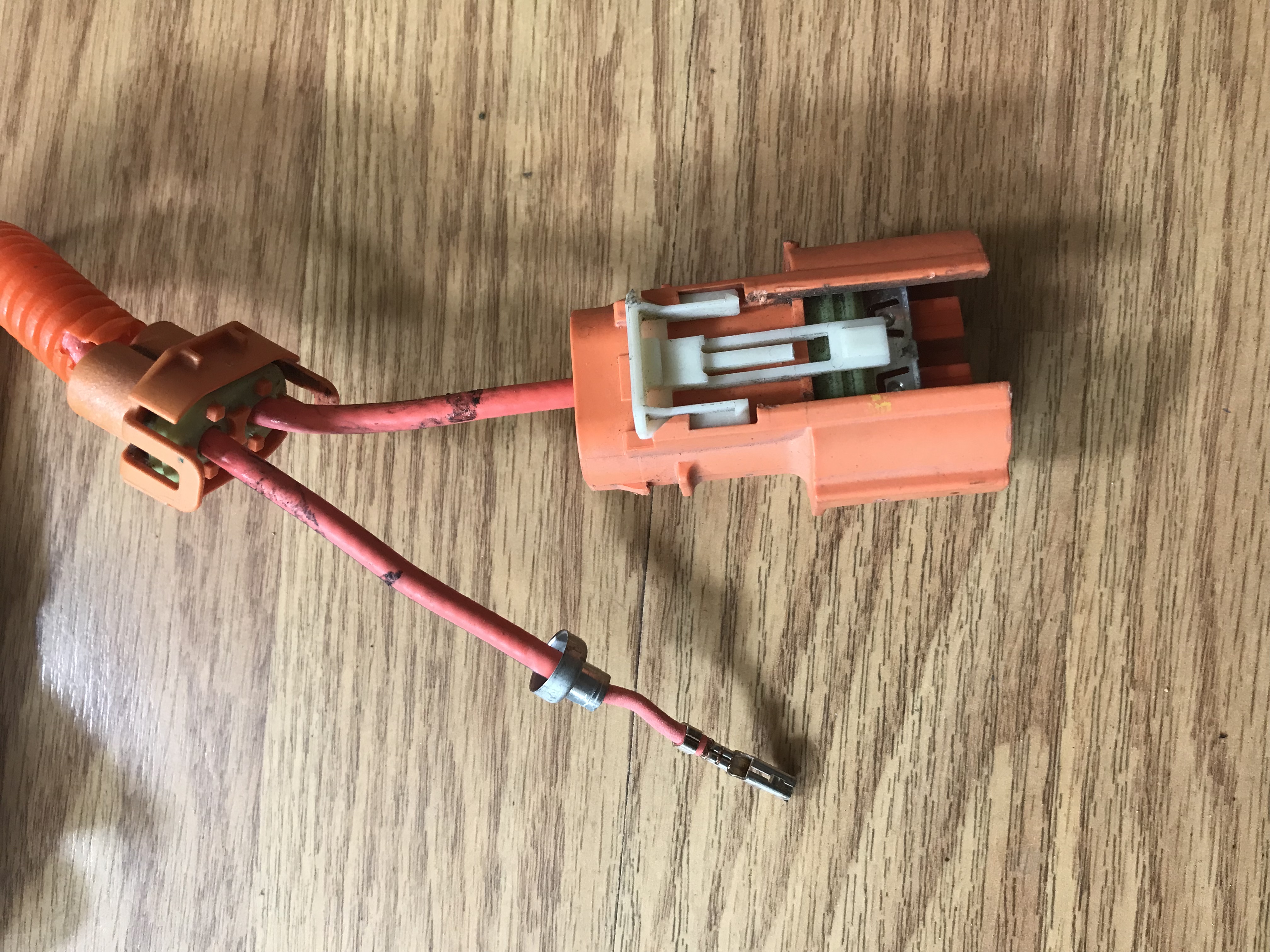

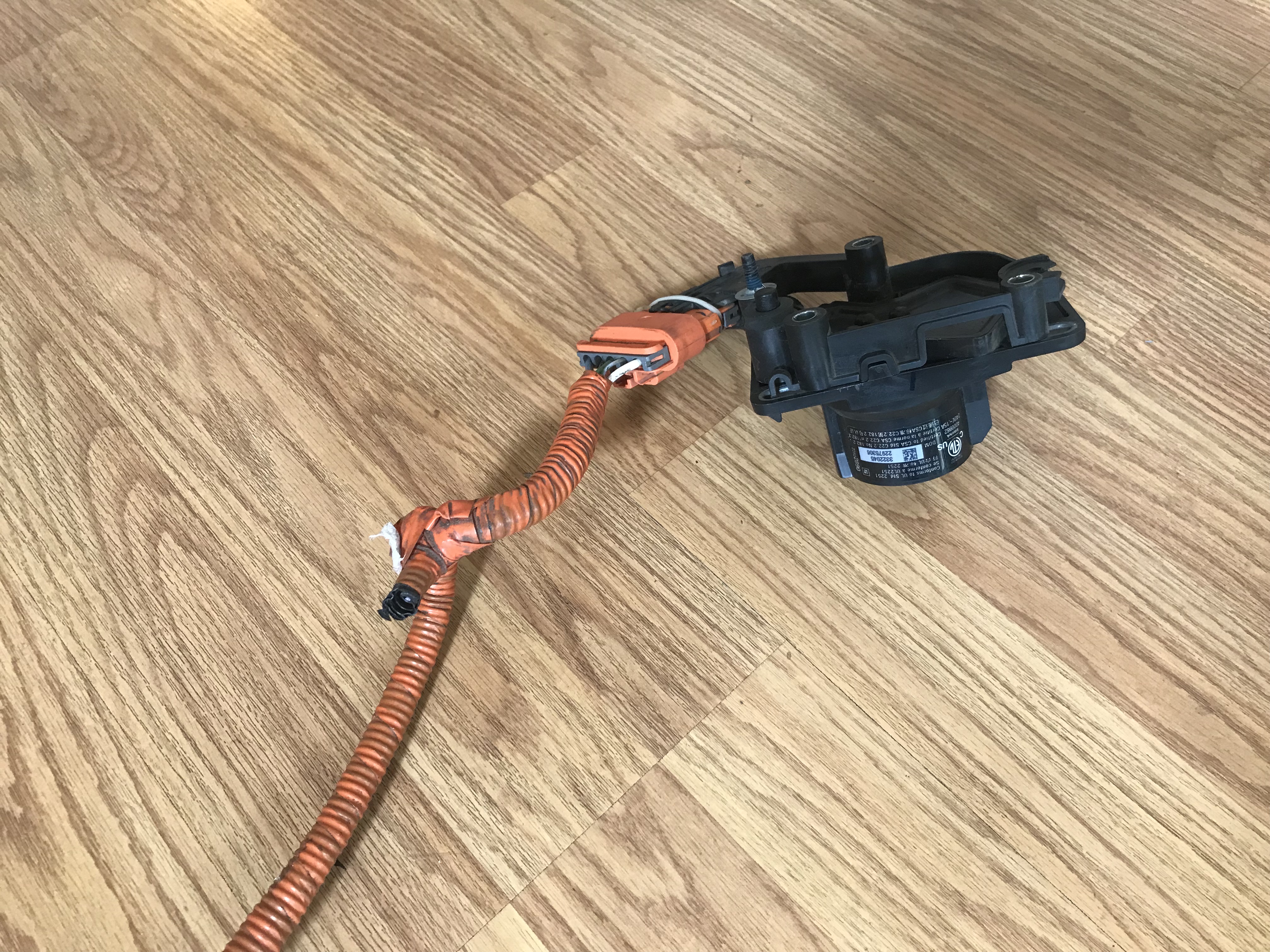

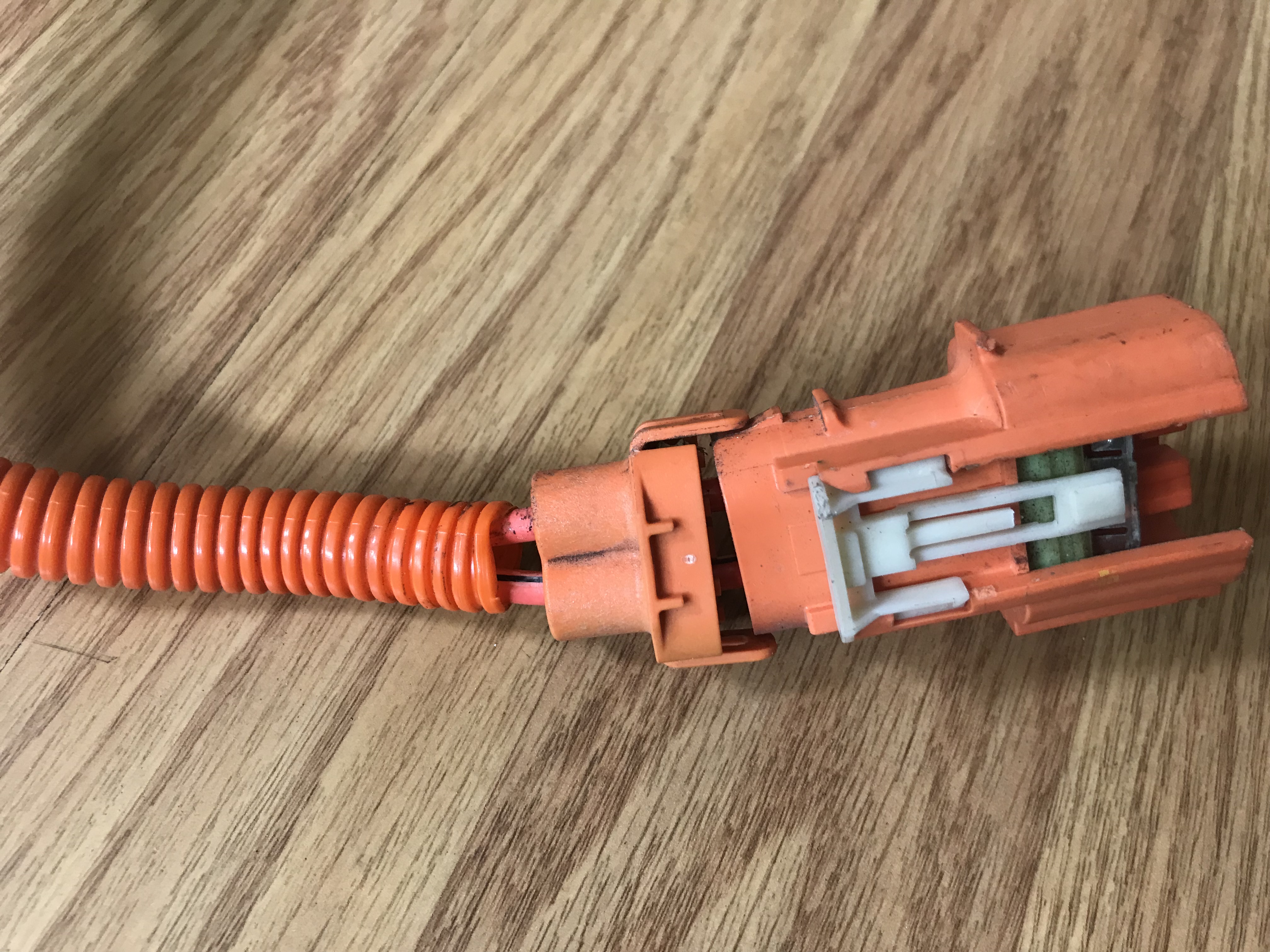

this thing has more tantacles than a Syberian octopus, so we start with the one that runs from the onboard charger to the "traction" battery
traction is just a fancy way of saying the big high voltage battery pack
this thing is incased in an aluminum pipe for you know Armageddon

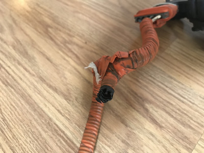

Gregski
Posts: 3157

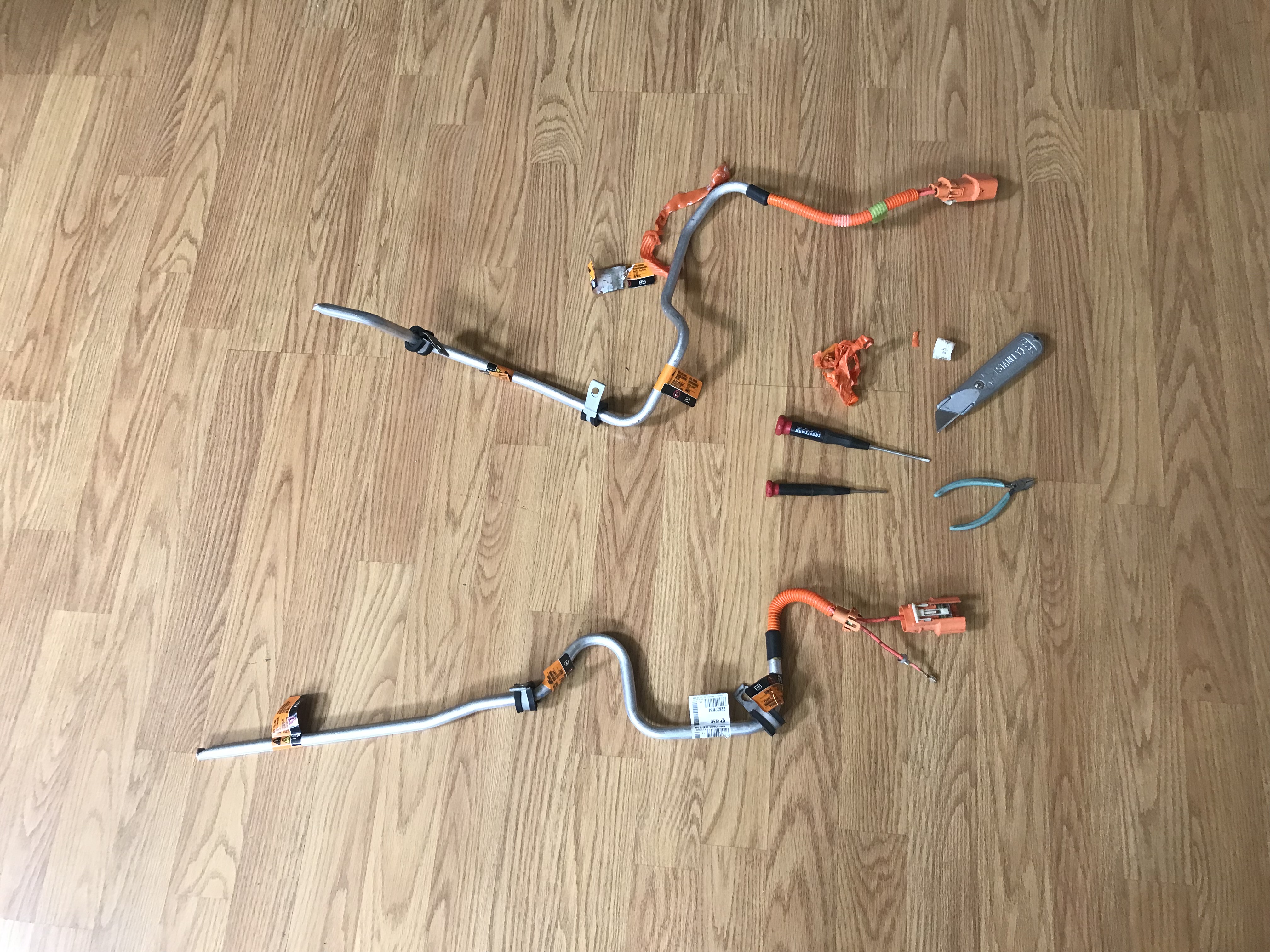

Post by Gregski »
I wasted many a beers trying to unpin that thing, as it proved futile, so I cut it in half and will offer 50% of the cable to the highest bidder, or the best dirty joke muszyngr at yahoo dot com

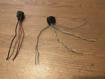

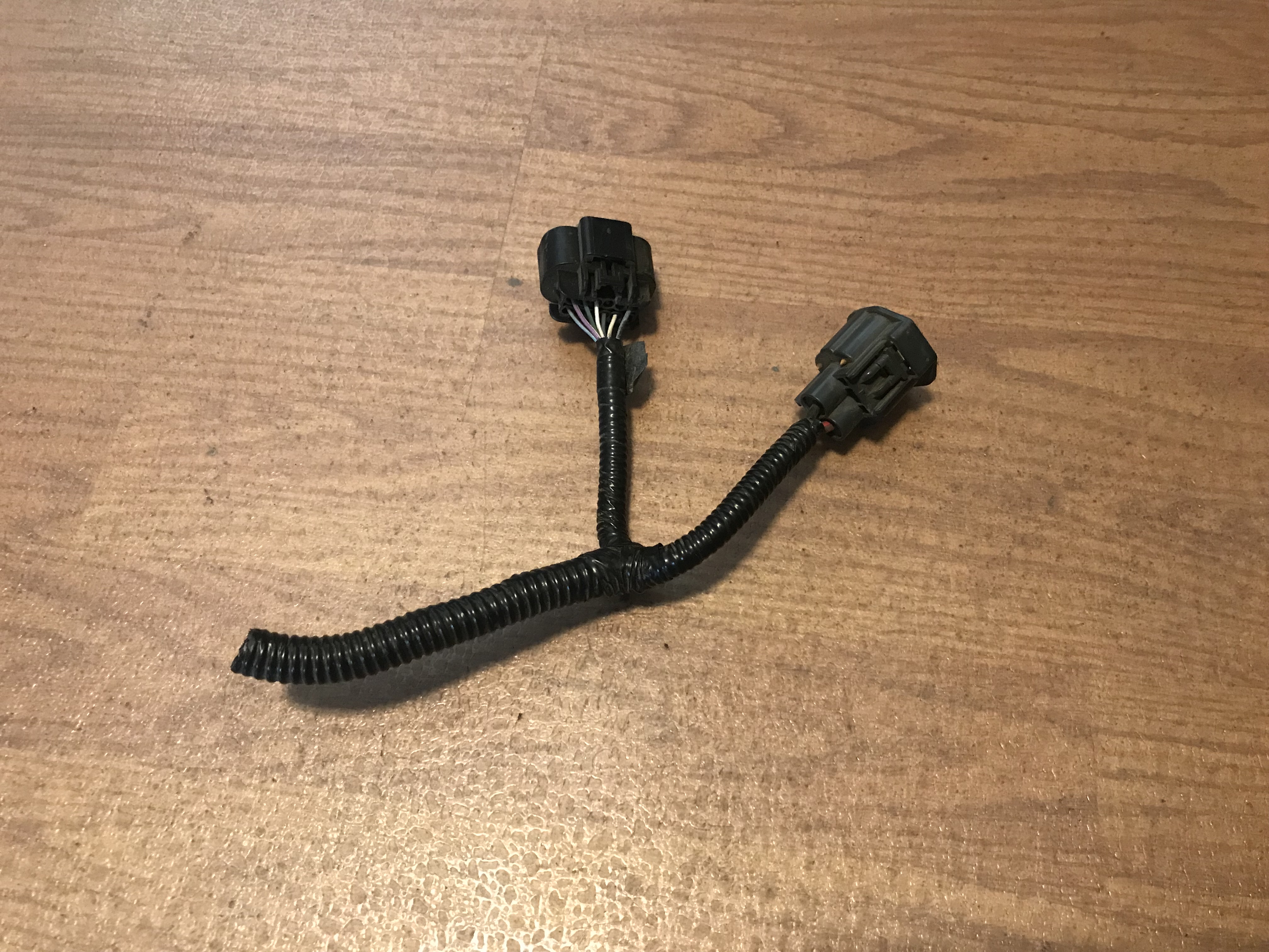

Post by Gregski »

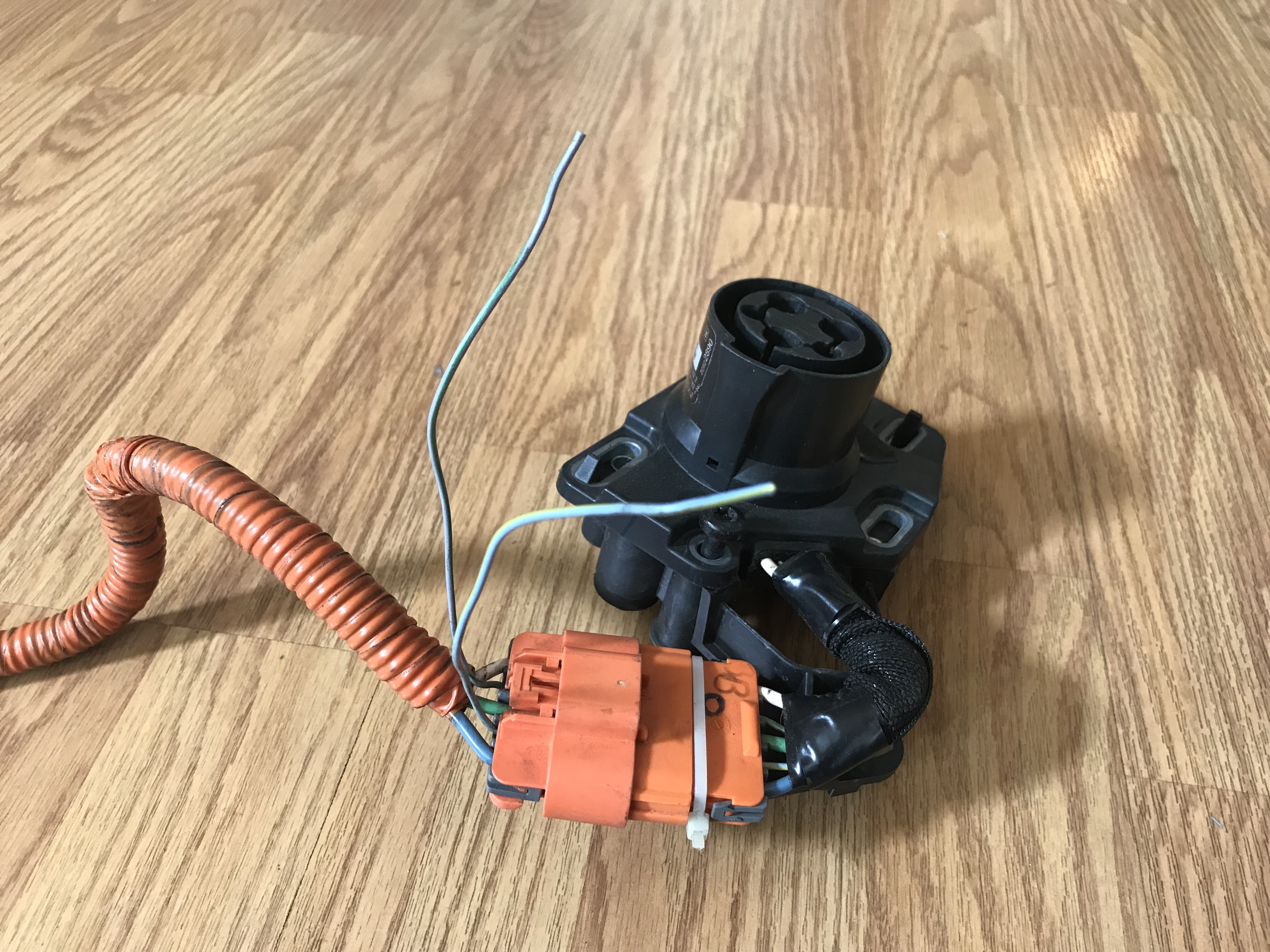

looks like the Barberians cut the proximity wires from the charge port, so I chased those down
Gregski
Posts: 3157
Post by Gregski »
and lastly I divorced the 12 volt battery leads from the CAN control side wires
Gregski
Posts: 3157

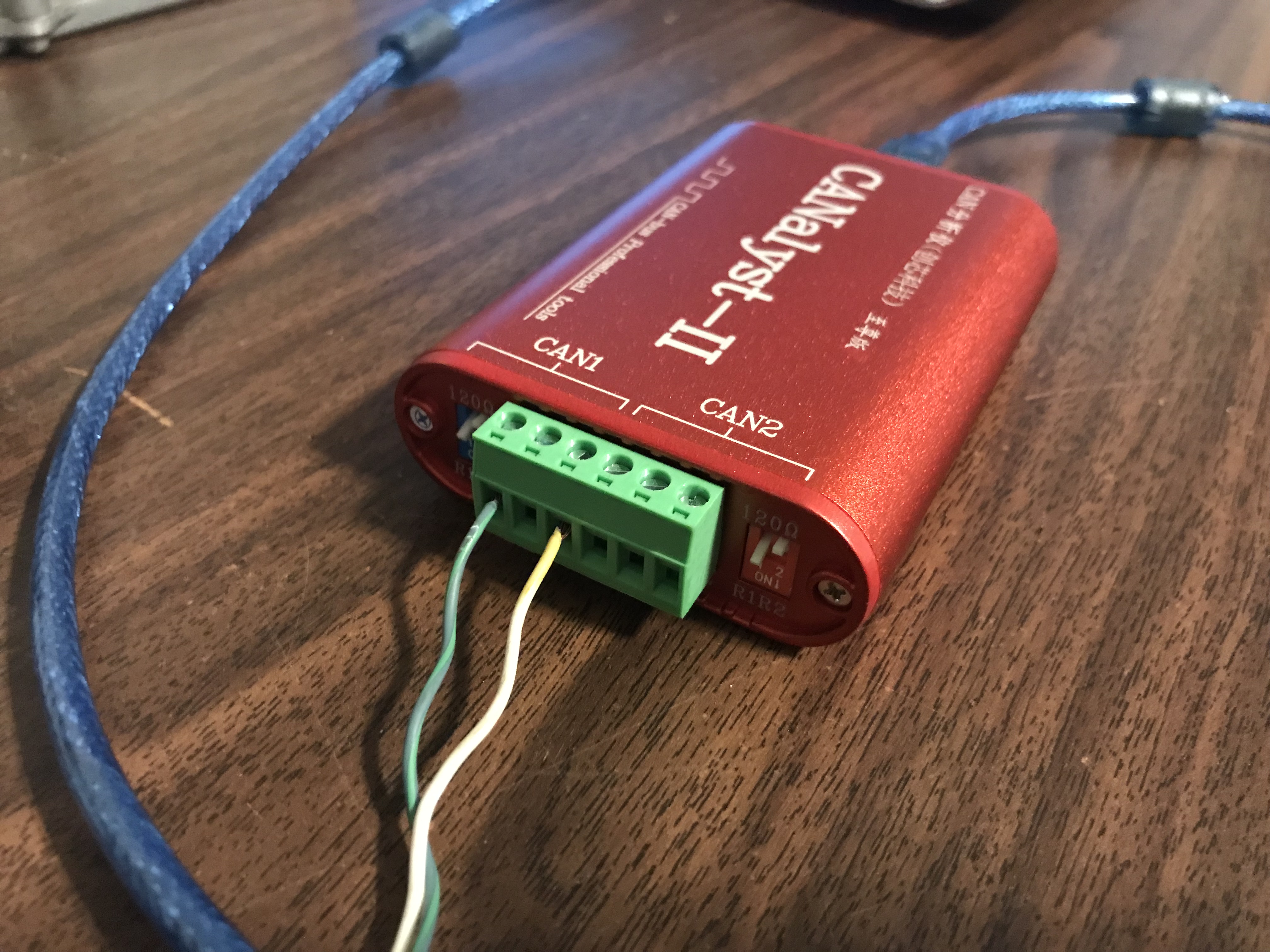

Post by Gregski »
so then I hooketized it all...
Gregski
Posts: 3157

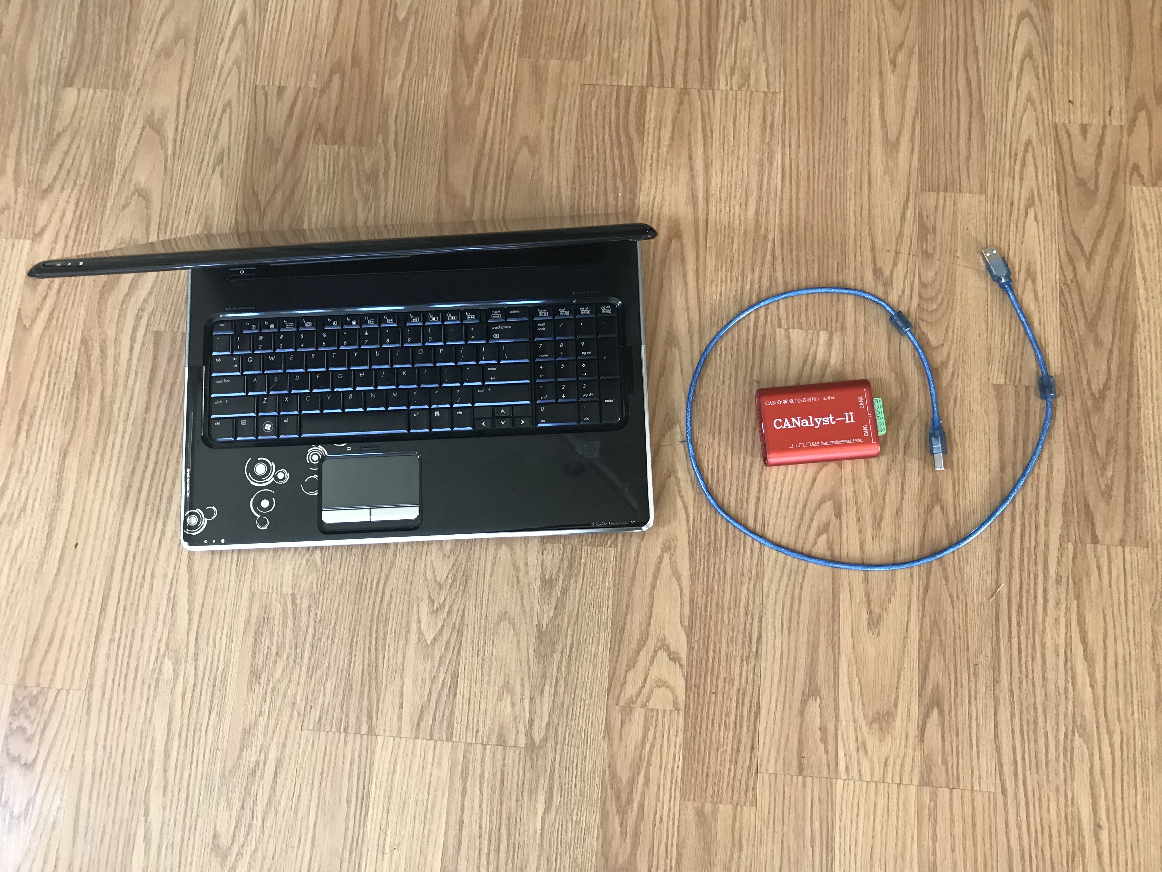

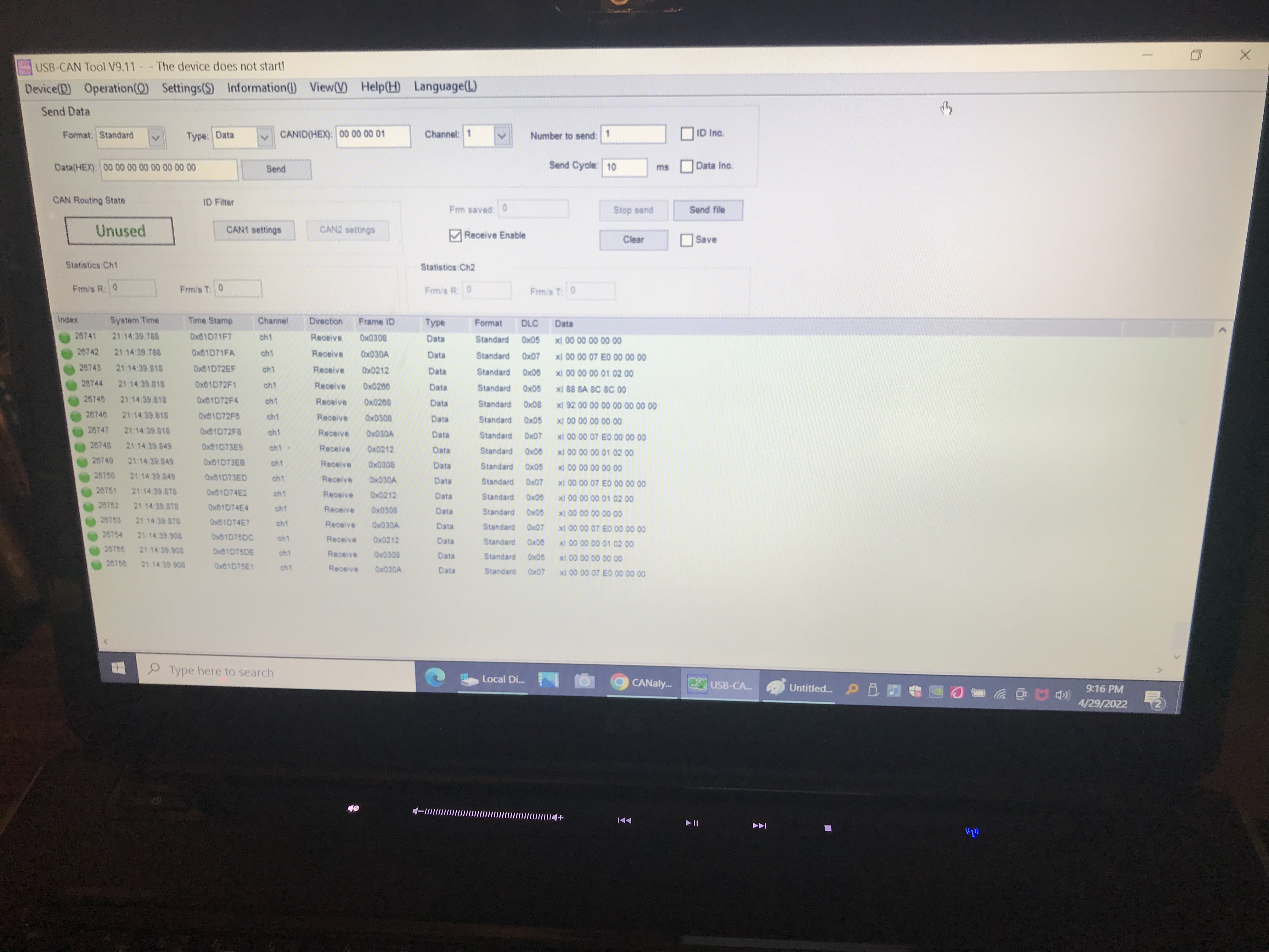

Post by Gregski »

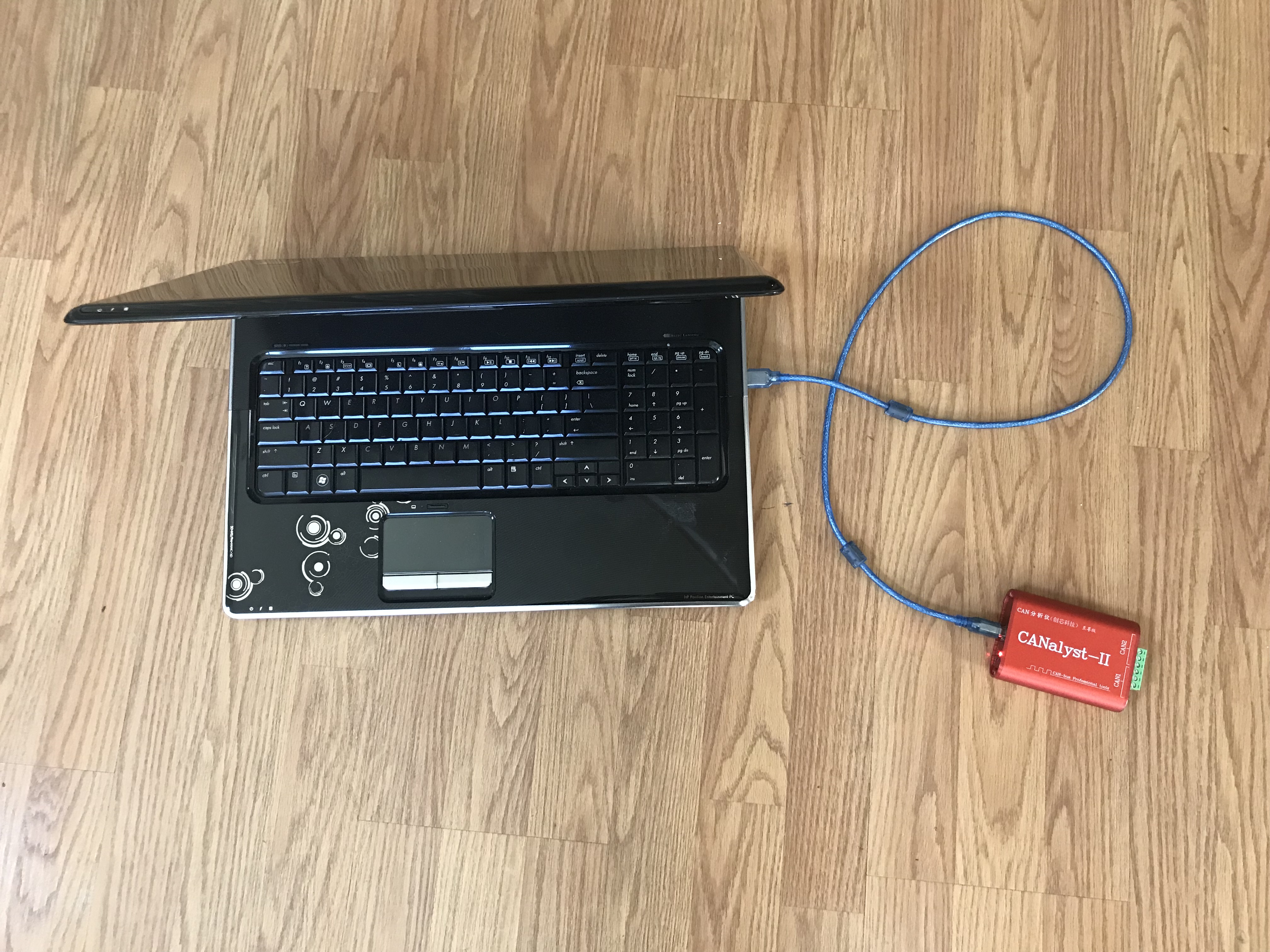

and quickly learned that my trusty and very pink CANalyst-II gizmo CAN Bus reader tool is NOT the tool for the job to control aka send CAN Bus commands to the charger, yes it reads them, and yes it can pretty much send one command at a time, but not multiple ones at once type of thing
File that under Lessons Learned
Gregski
Posts: 3157
Post by Gregski »

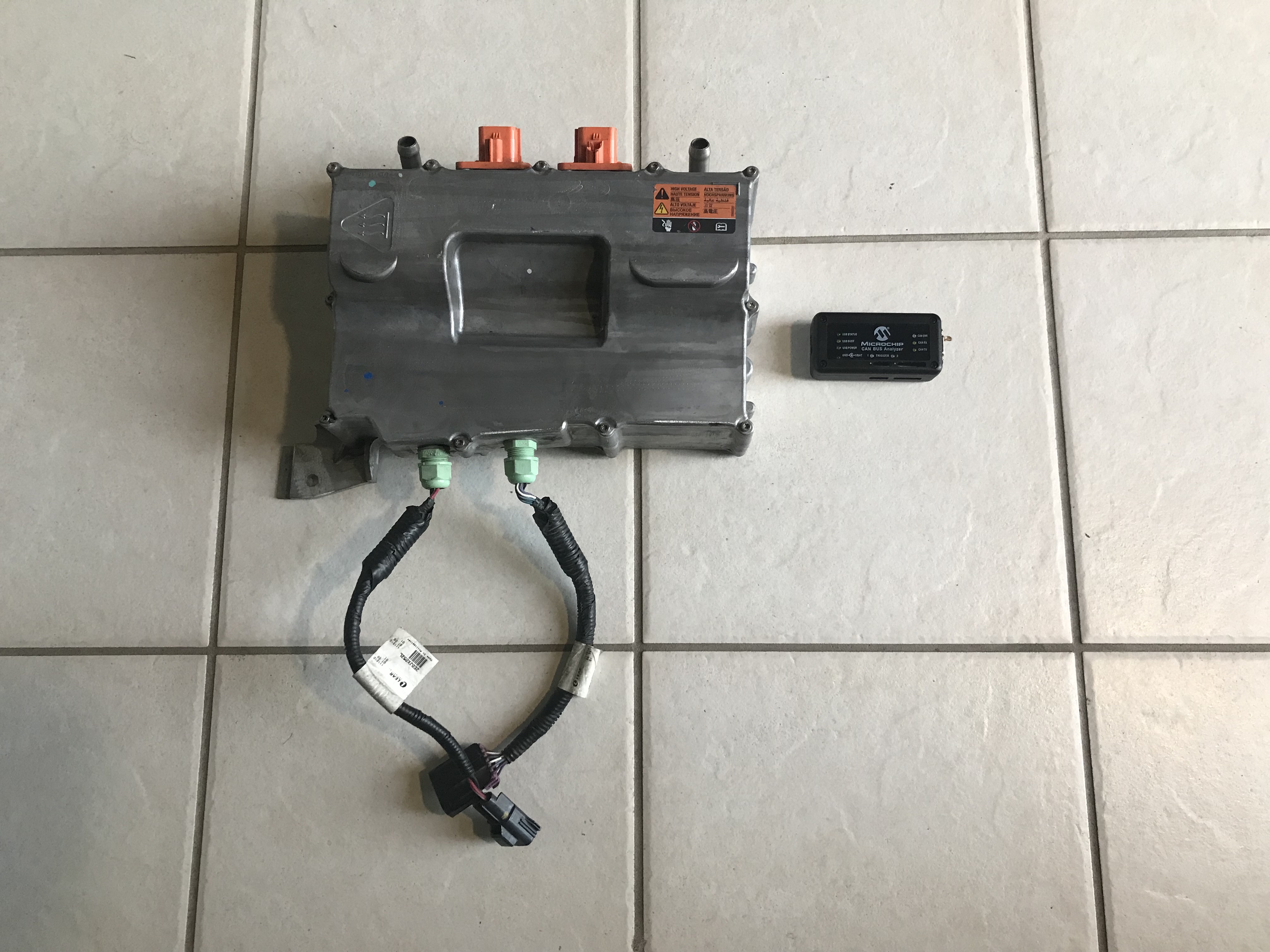

at this point I was having so much fun I decided to do a little tutorial write up where I document my failures in public in a thread entitles: I think I CAN, I think I CAN...
Gregski
Posts: 3157
Post by Gregski »
armed with another CAN Bus analyzing tool, let's see what this MICROCHIP can do, it's black so it's gotta be good
