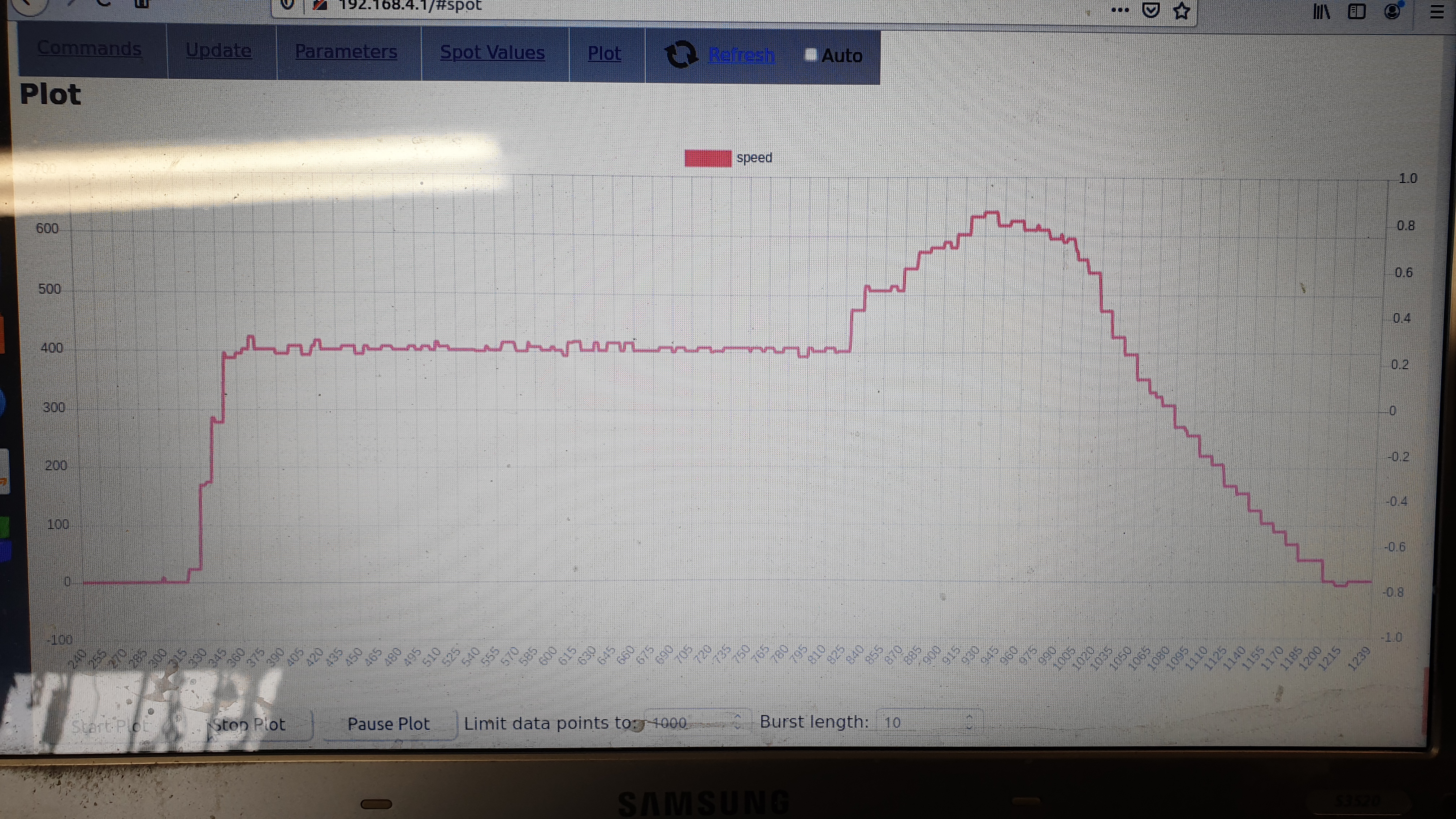

Ok so over speed like that wouldn't be unusual for one of these motors, so we need to command a negative torque to bring it back to rest on the bench, rather than zero torque, provided we can take back current. OK so maybe we should look at decoding more of the MTH return data and maybe get the RPM indicator working on the ECU, so we can see the real speed. I've been looking at the mth data, bytes 38-39 and 40-41 appear to be MG2 speed if we want to map either of them back for monitoring.Jack Bauer wrote: ↑Mon Feb 01, 2021 8:08 am Dilbert, No I don't think so. The control loop would be designed to see some resistance from the car and as we had no regen dialed in it just kept spinning would be my guess.

Yeah that makes sense. I'm gonna run some more tests this morning just with the stupid power supply. At least we know the issue with mg2 hunting was just the power supply hitting a limit.

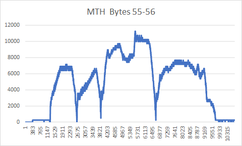

Bytes 55-56 in the MTH data look interesting (power in watts?)
- mth55-56.png (11.4 KiB) Viewed 6033 times
Ahhh, that makes sense. I see some memory address stuff that needs to change. Ill try bludgeoning my way through some changes in an effort to better understand the stuff and use whatever posted as a fall back in case of failureJack Bauer wrote: ↑Mon Feb 01, 2021 8:08 am Jon, Yes ota works but you need a specific bootloader for the 105 and a specific wifi firmware also. Will pop them up later today.

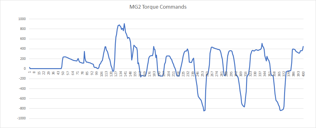

OK I captured a good bit more data from the Auris today while it was driving. The data capture and processing worked fine. I've added a feature to the python script so I can downsample the data to speed up processing and graphing.
The graph below shows MG2 torque during a drive cycle and the re-gen values which are seen.

Off the throttle seems to be about -100, then when the brake is applied it applies a variable torque proportional to the braking force required.
I have the MG2 speed also from the HTM frame on the same graph, so if we want to mimic how a toyota hybrid drives that should be no problem. I'll post up the full graph. We should also be able to see the MG2 speed that the system will regen down to.
I'm kinda undecided if we should include the gear selection in any algorithm for regen, or just do it like the simple algorithm above, which is based of MG2 direction of travel. I'm thinking if the vehicle rolls back might it correct in the wrong direction
