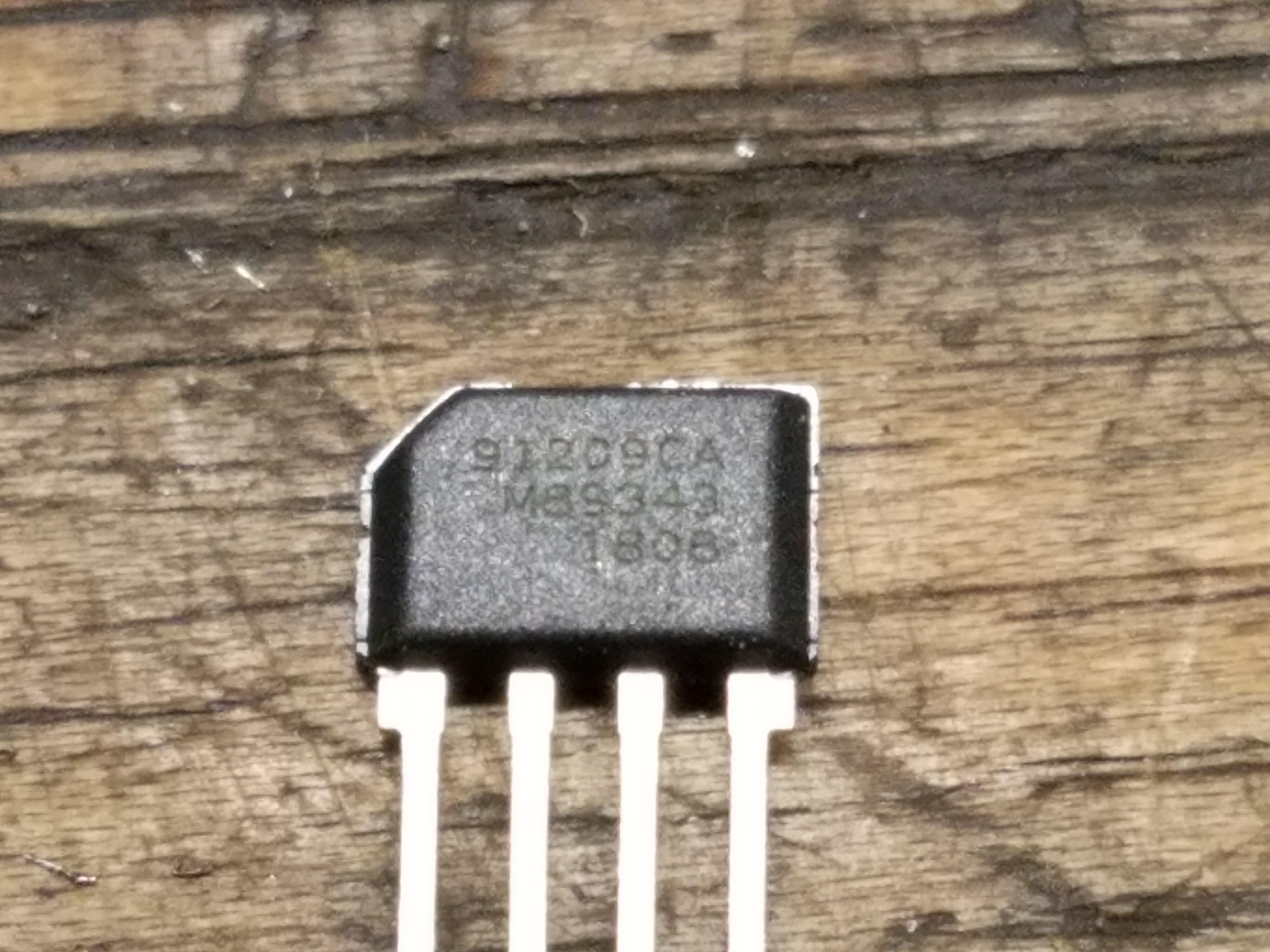

Just busted my current sensor
and if you can't tell from my question then I'll say it explicitly. I'm a noob.
My replacement current sensors will be getting here in a couple of days. Do I just pull out the old sensors from the "goo" and drop the new ones in? or is there something more involved?
Thanks!
Thanks!

Re: Tesla Small Drive Unit Support Thread
Yes they go back into the goo. Just be aware of the orientation mark on the device.
when I replaced the sensor I took a few pics . This is how the 2 sensors are oriented in that camel snot . lol
Lee
Thanks!
Got em in. Should we refill the void in the "camel snot" left from pulling out the old sensors? The new sensors seem pretty secure as is.
