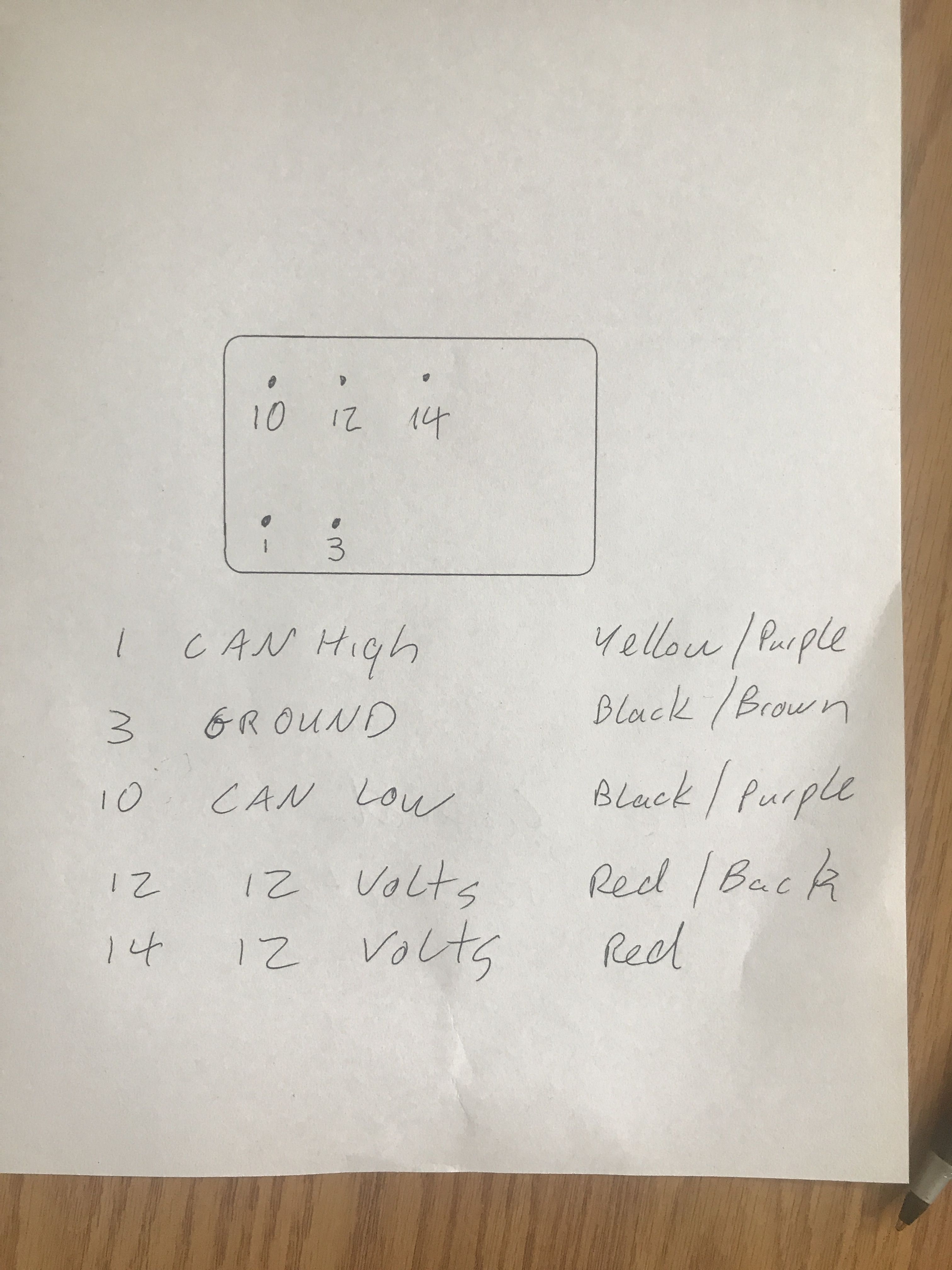

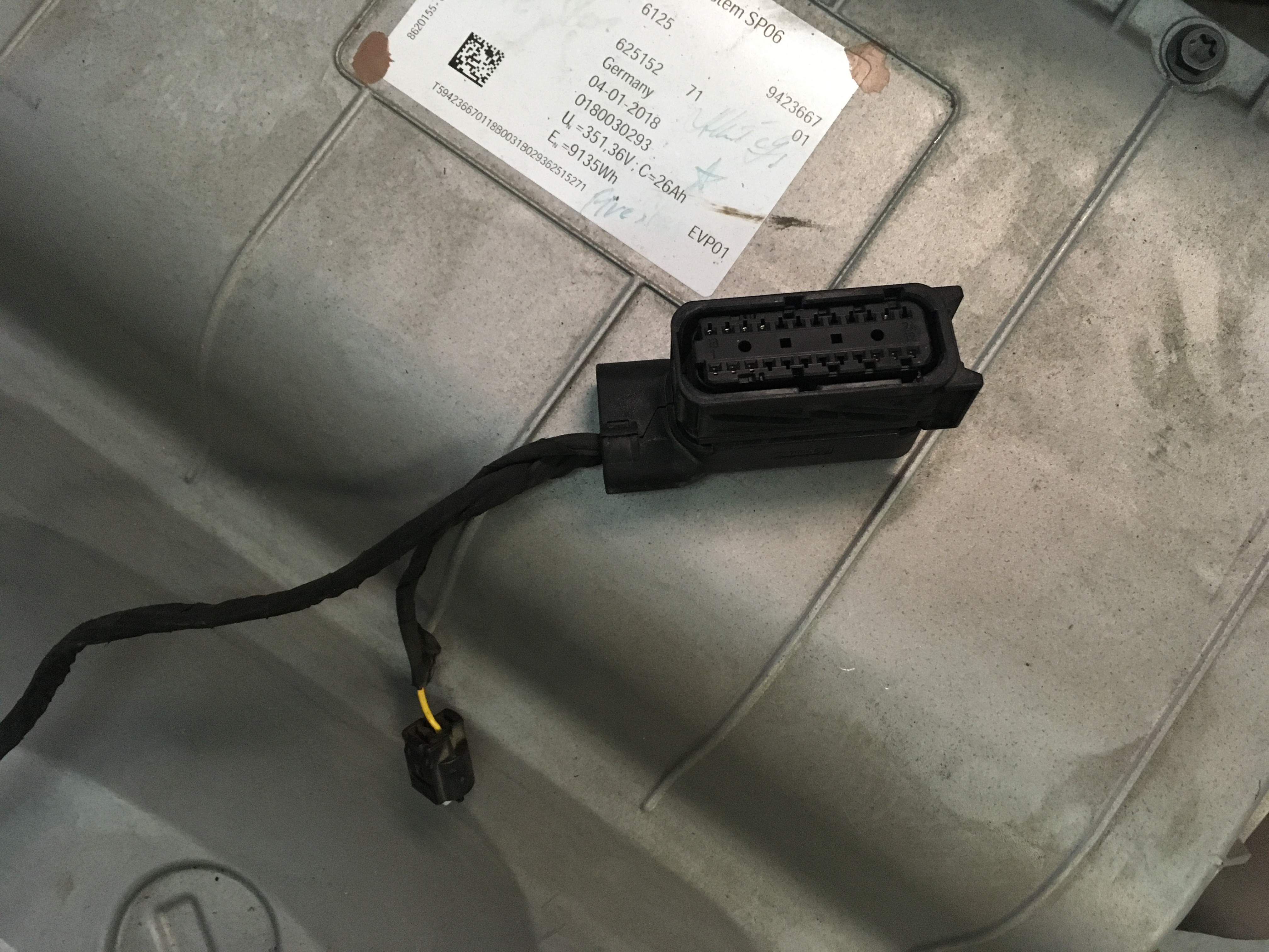

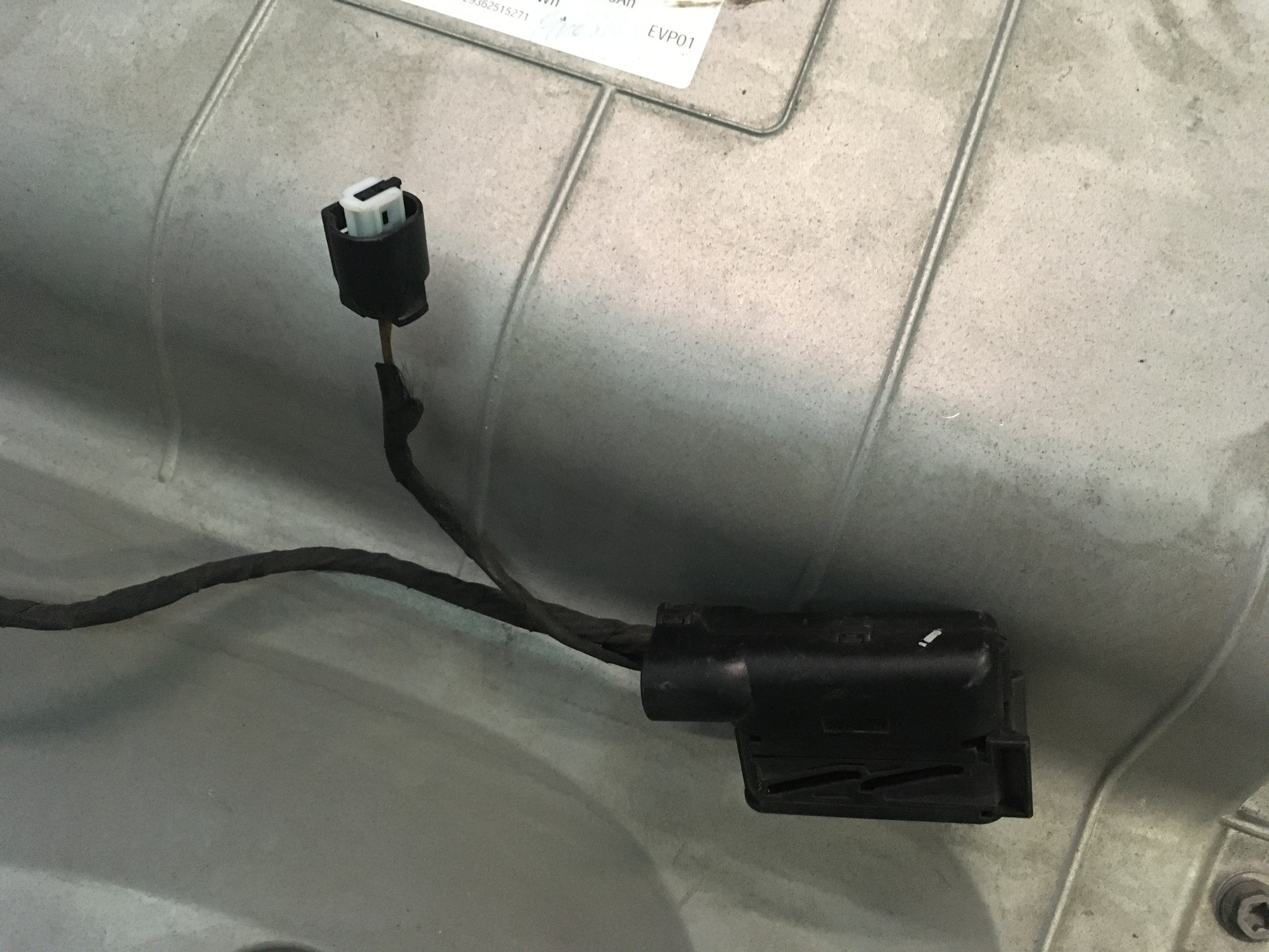

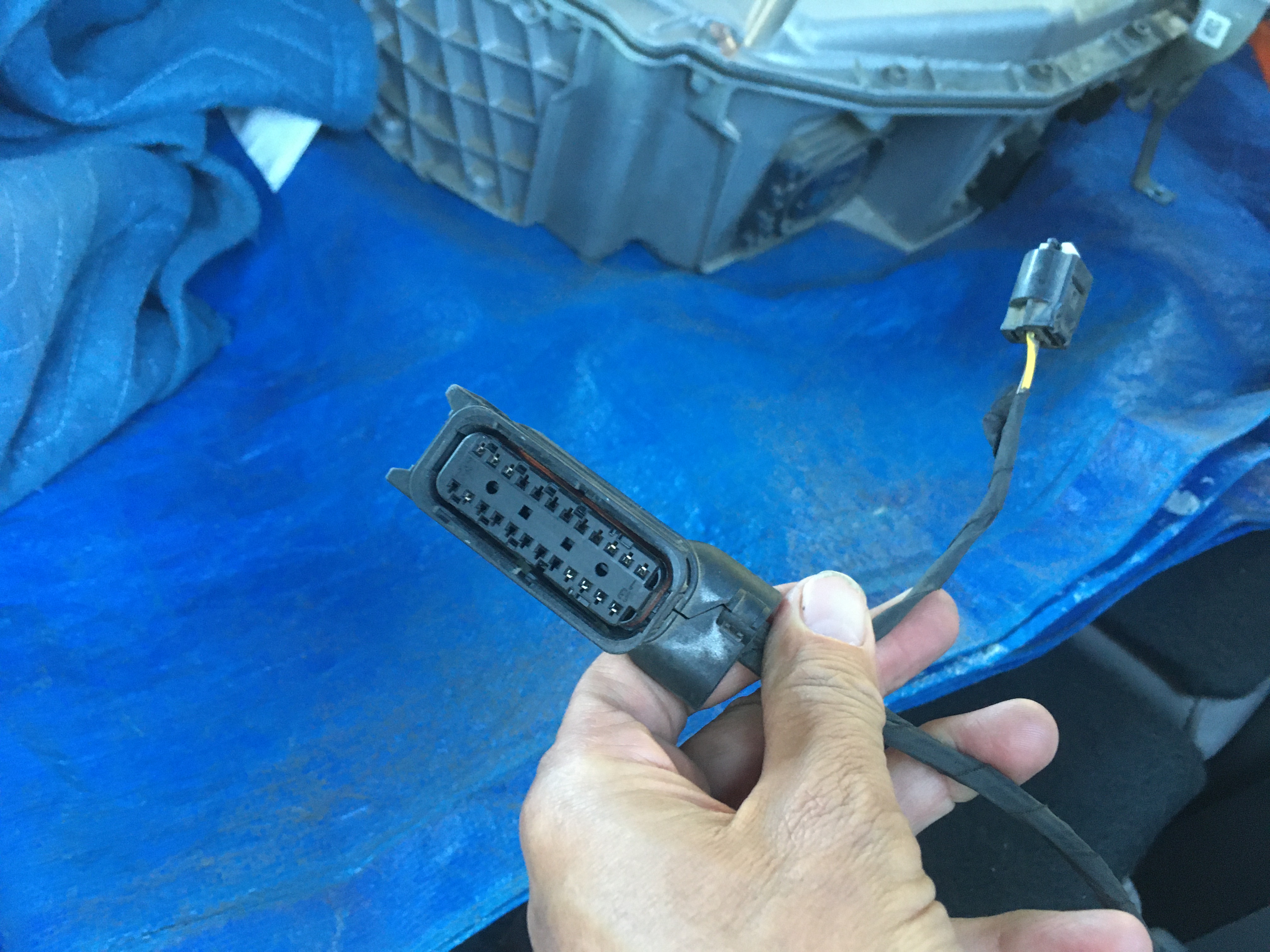

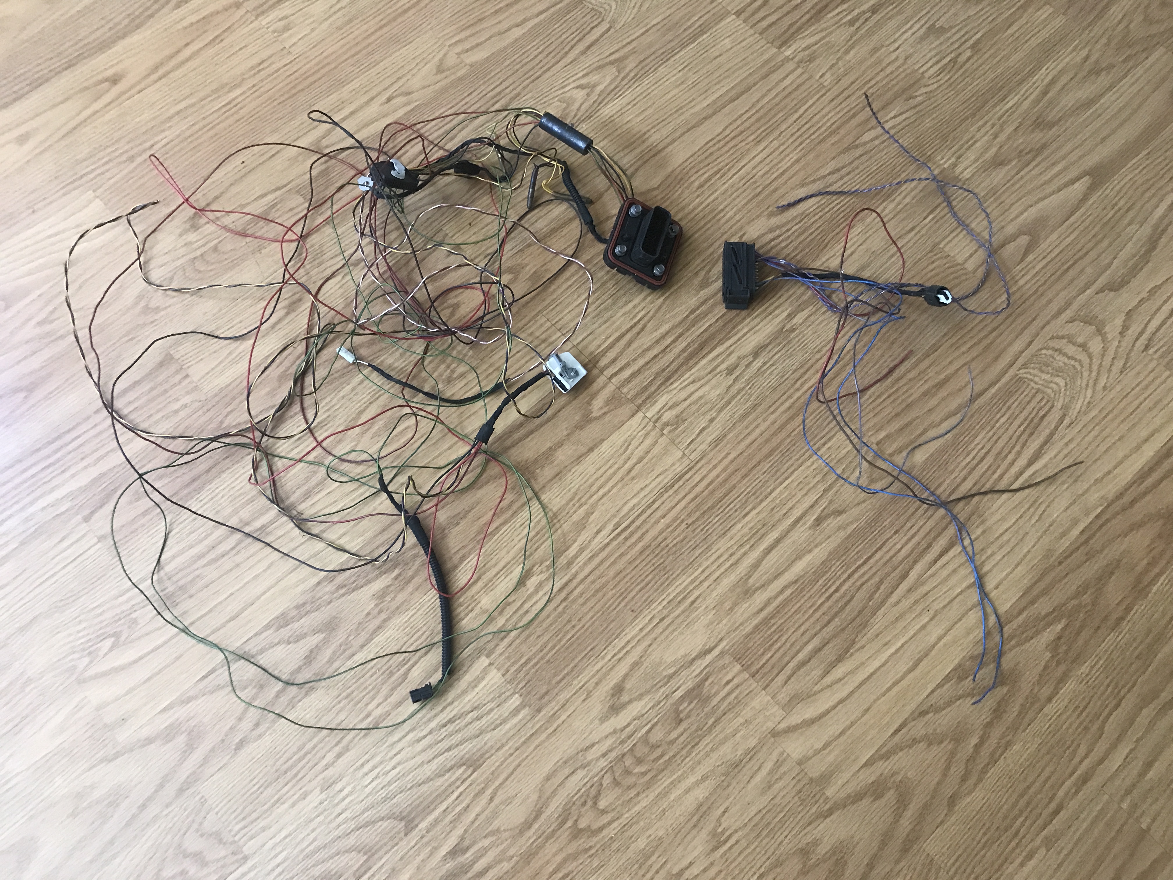

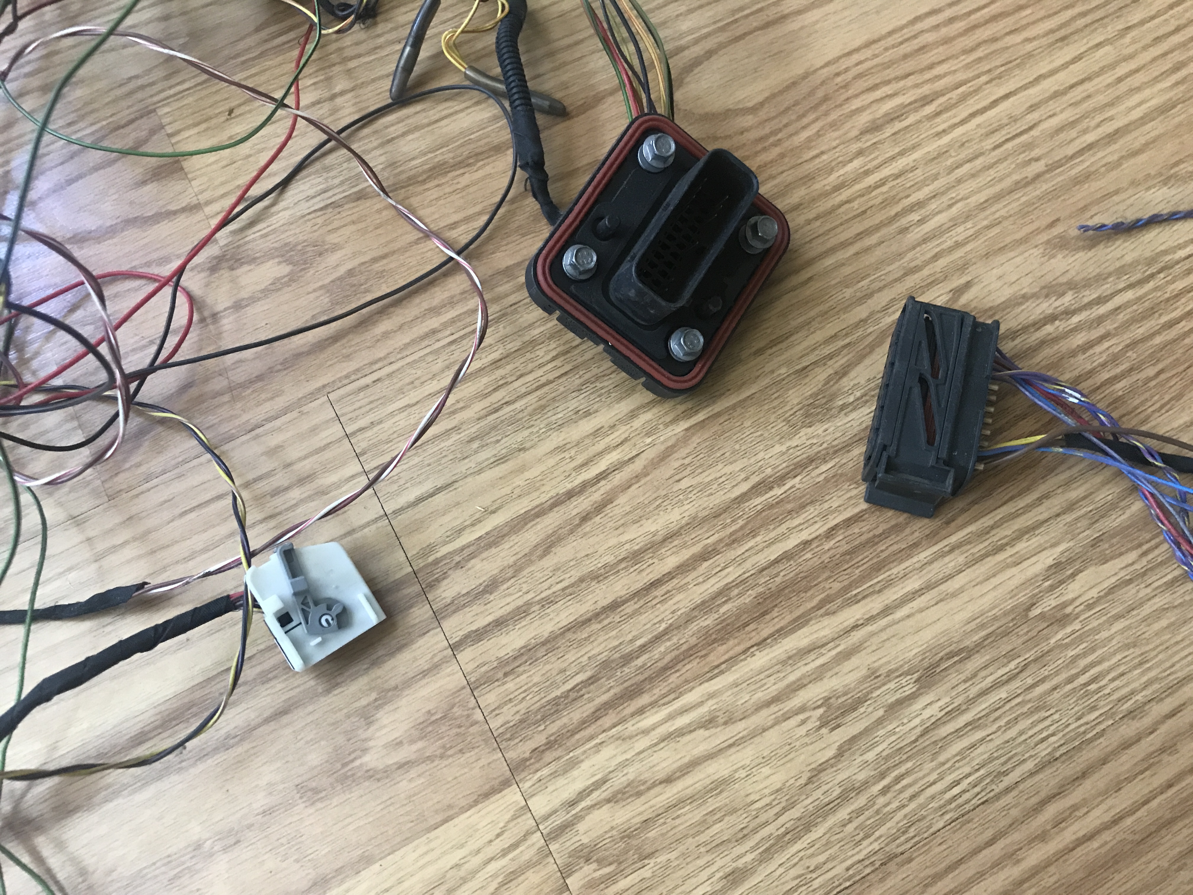

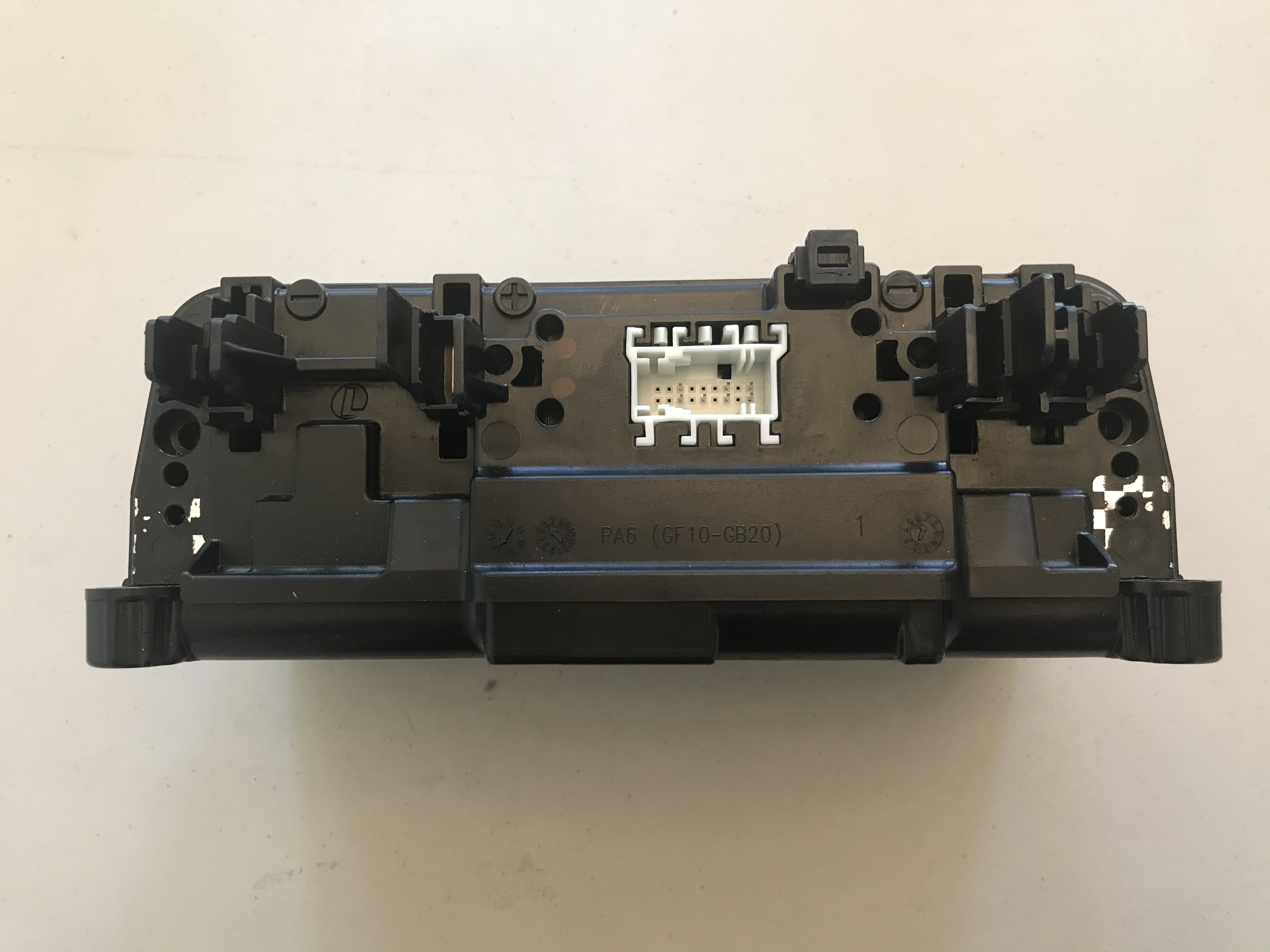

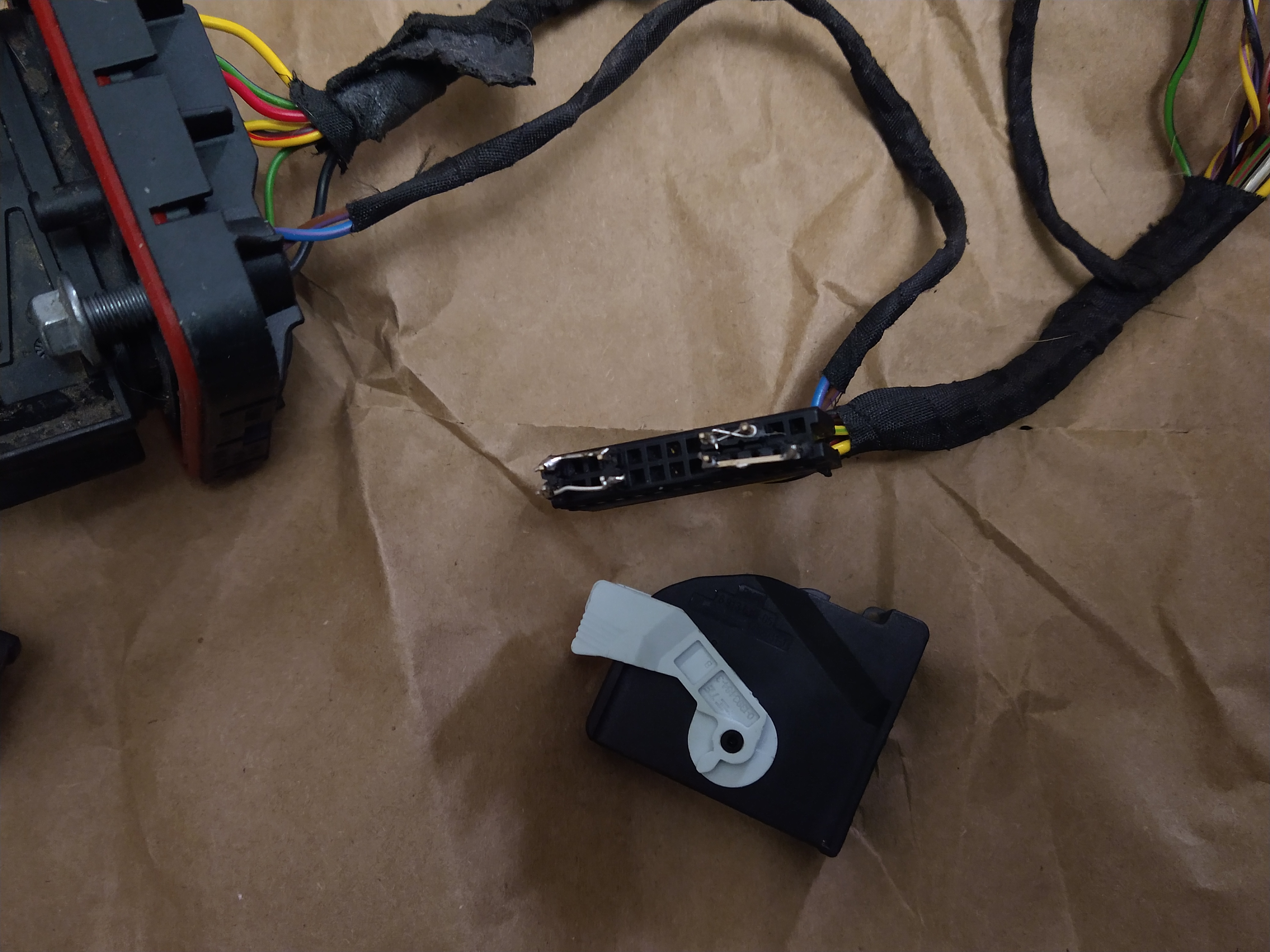

well I tried to see if we can follow the wires from the Safety Box white 18 Pin connector to the external 24 Pin connector but no dice, I think all but one red wire go to the BMS master module first where I assume some VooDoo takes place before they head back out to that external connector (as mentioned in this thread years ago)
this is just the white connector pin out on the BMW white safety box connector as pointed out on Damien's Git Hub page
royhen99
Posts: 265
Location: N. Wiltshire. UK
Has thanked: 22 times
Been thanked: 134 times
Post by royhen99 »
It needs four links on the black connector 10 - 13 CANH, 23 - 26 CANL, 16-18 0V and 1 - 5 12V. On the external wiring loom red and grey/purple are 12V and brown is 0V.
Gregski
Posts: 3157
Has thanked: 628 times
Been thanked: 1606 times
Post by Gregski »
royhen99 wrote: Sun Jun 18, 2023 2:57 pm It needs four links on the black connector 10 - 13 CANH, 23 - 26 CANL, 16-18 0V and 1 - 5 12V. On the external wiring loom red and grey/purple are 12V and brown is 0V.
thank you so much I appreciate that, seems like we have to open up that coffin to do this though so might as well just tap into the Safety Box directly, unless I am missing something ?

Post by royhen99 »
I did this just to avoid cutting the cable for now. I can still connect the BMS master and log CAN messages etc.

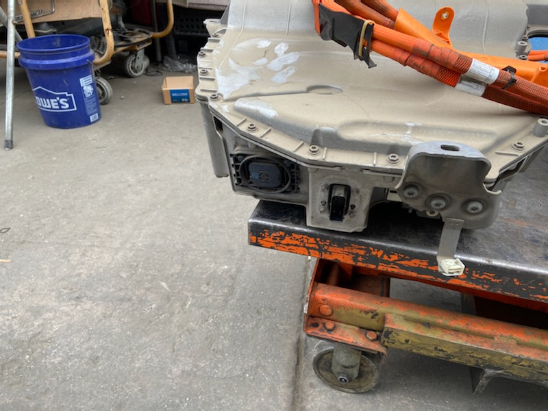

I am also using a 9kw BMW pack. I dismantled it and mounted each of the packs along with its CMU module separately and i pickup can direct off the blue connector as i ditched the contactor box before i realised it could be handy.
I have some working code to read all 96 cell voltages cribbed some stuff on the web, but the code i found wasn't so clear on balancing.
It looks as if message id 0x80 is involved but its not clear to me how this works exactly.
Do you know how to make the balancing aspect activate ?
Retired - (E46 touring, Phev rear motor, OEM inverter cabin heater and charger,BMW 9kwh & 12kwh packs)

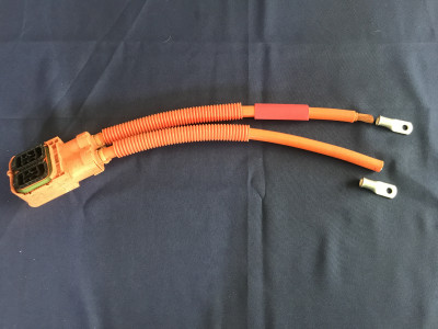

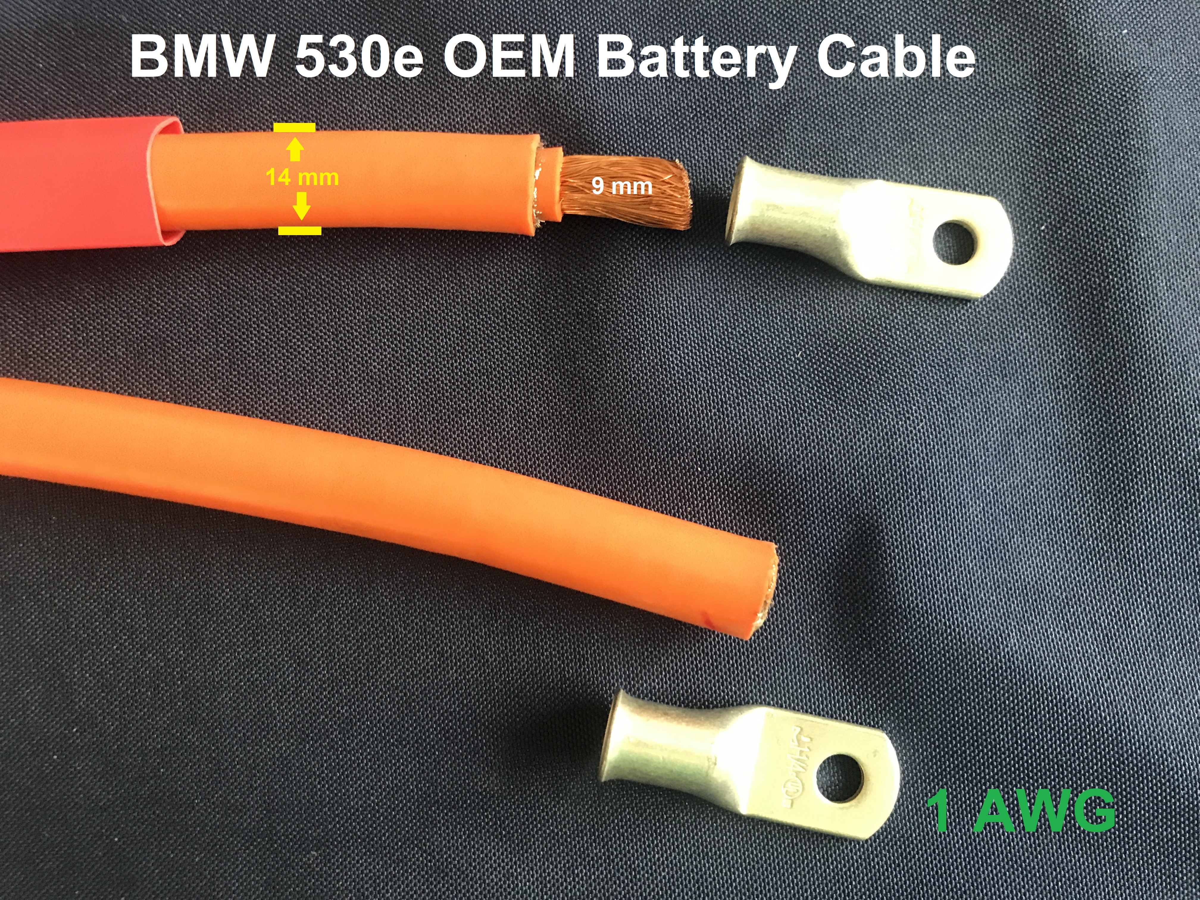

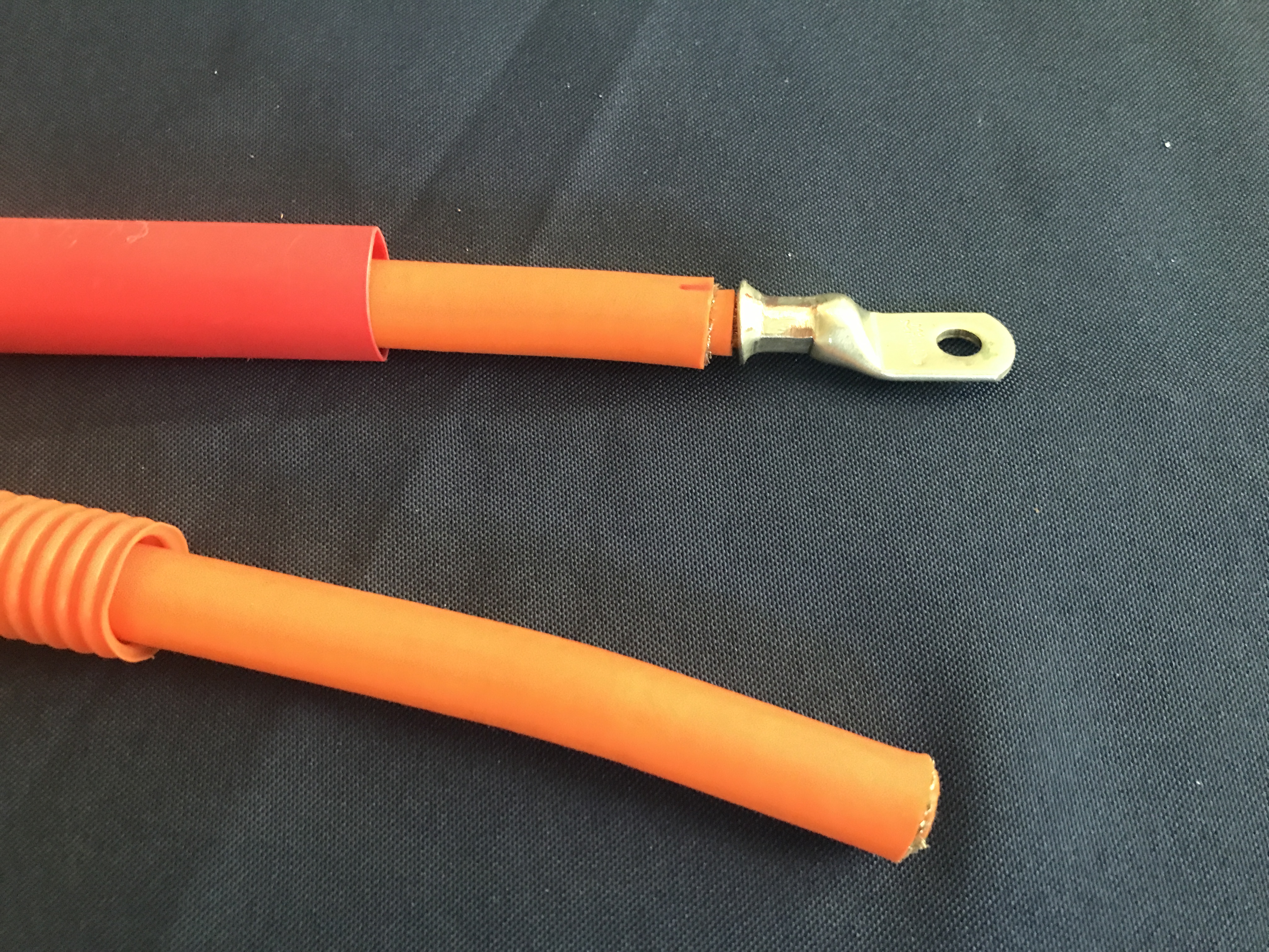

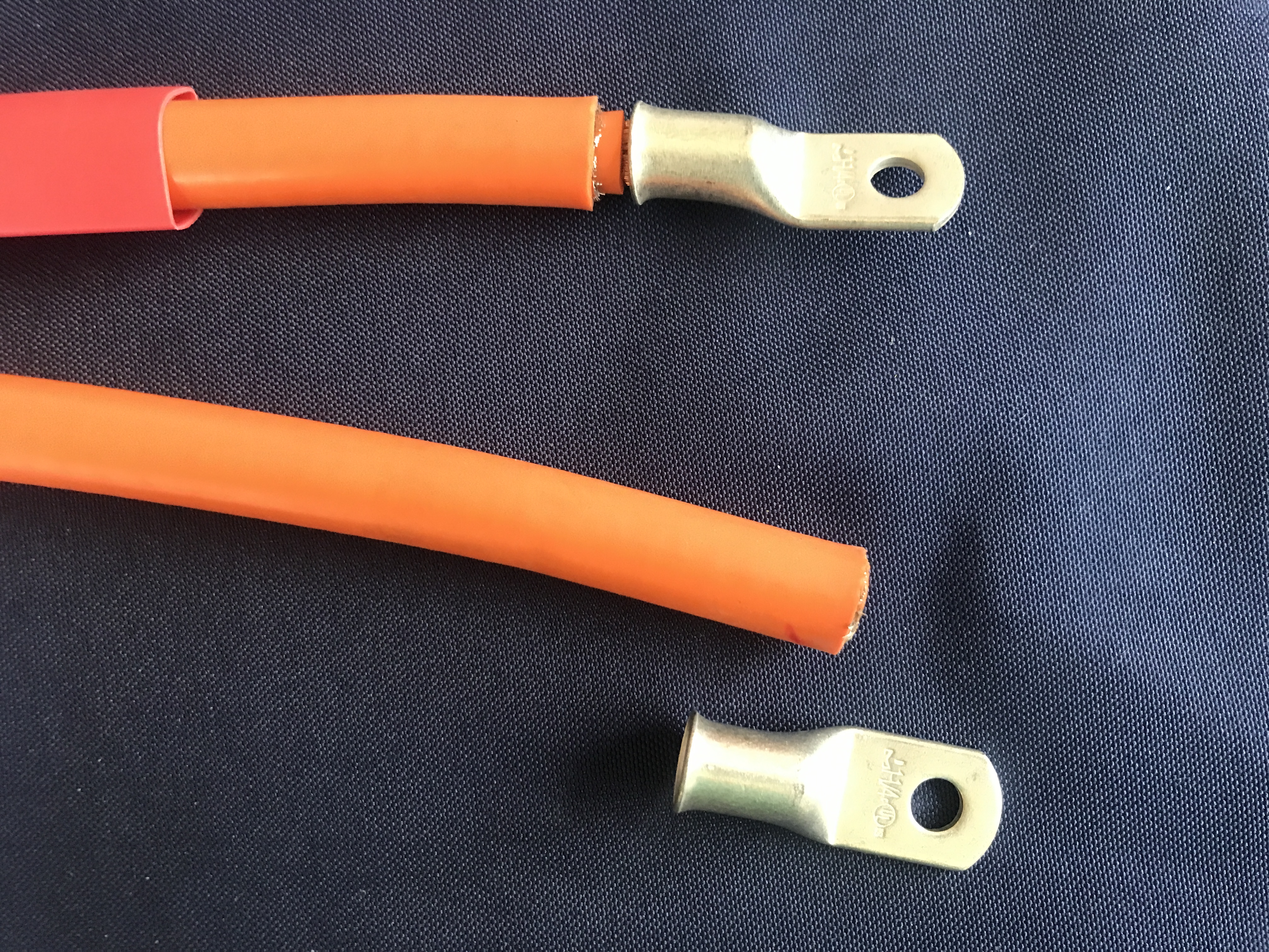

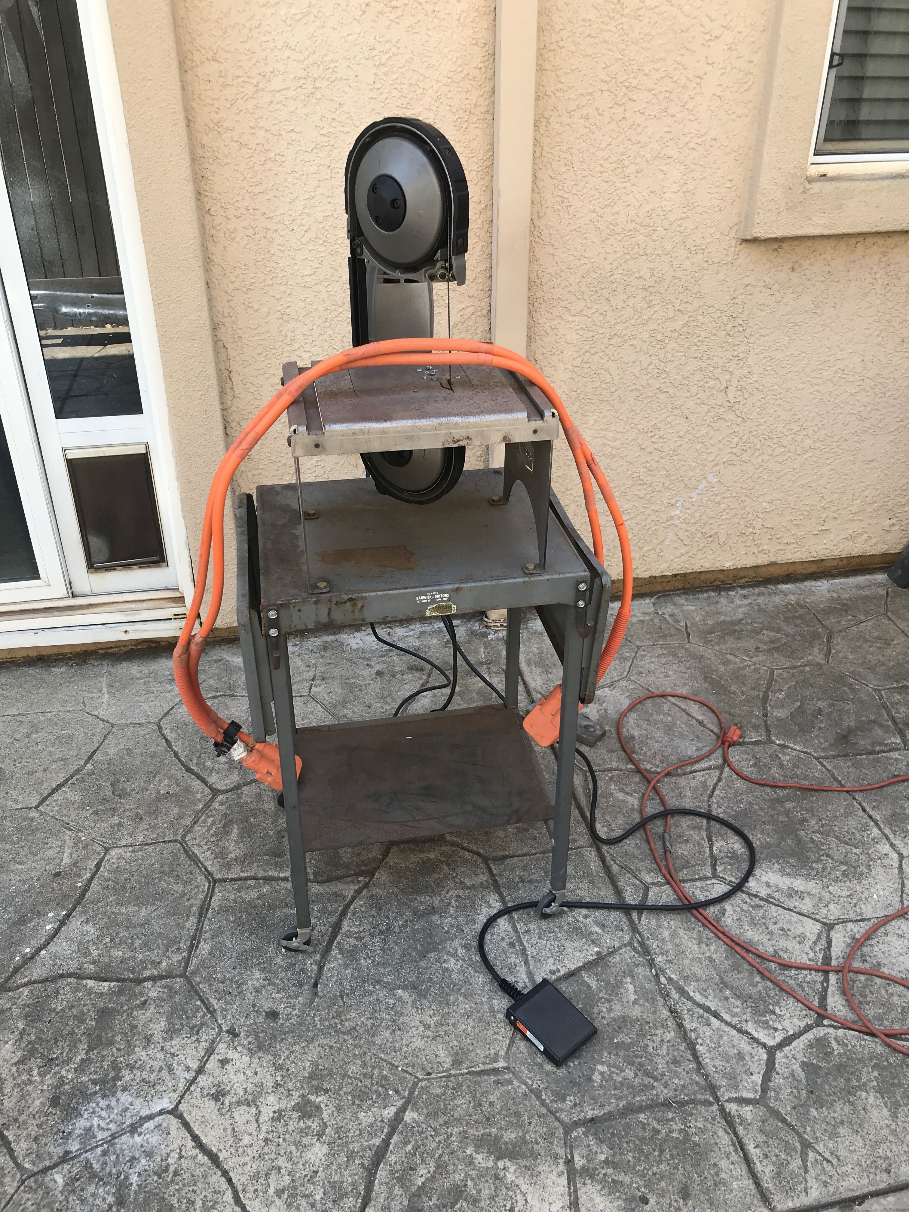

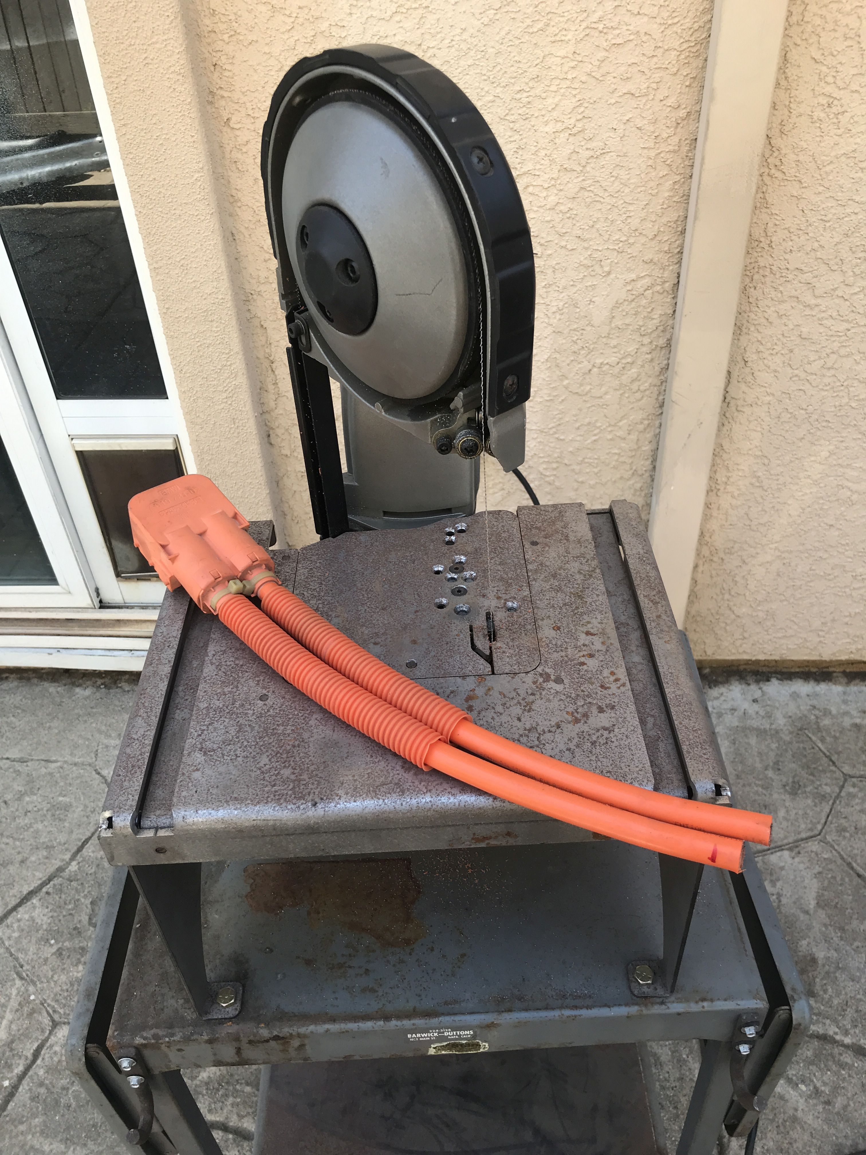

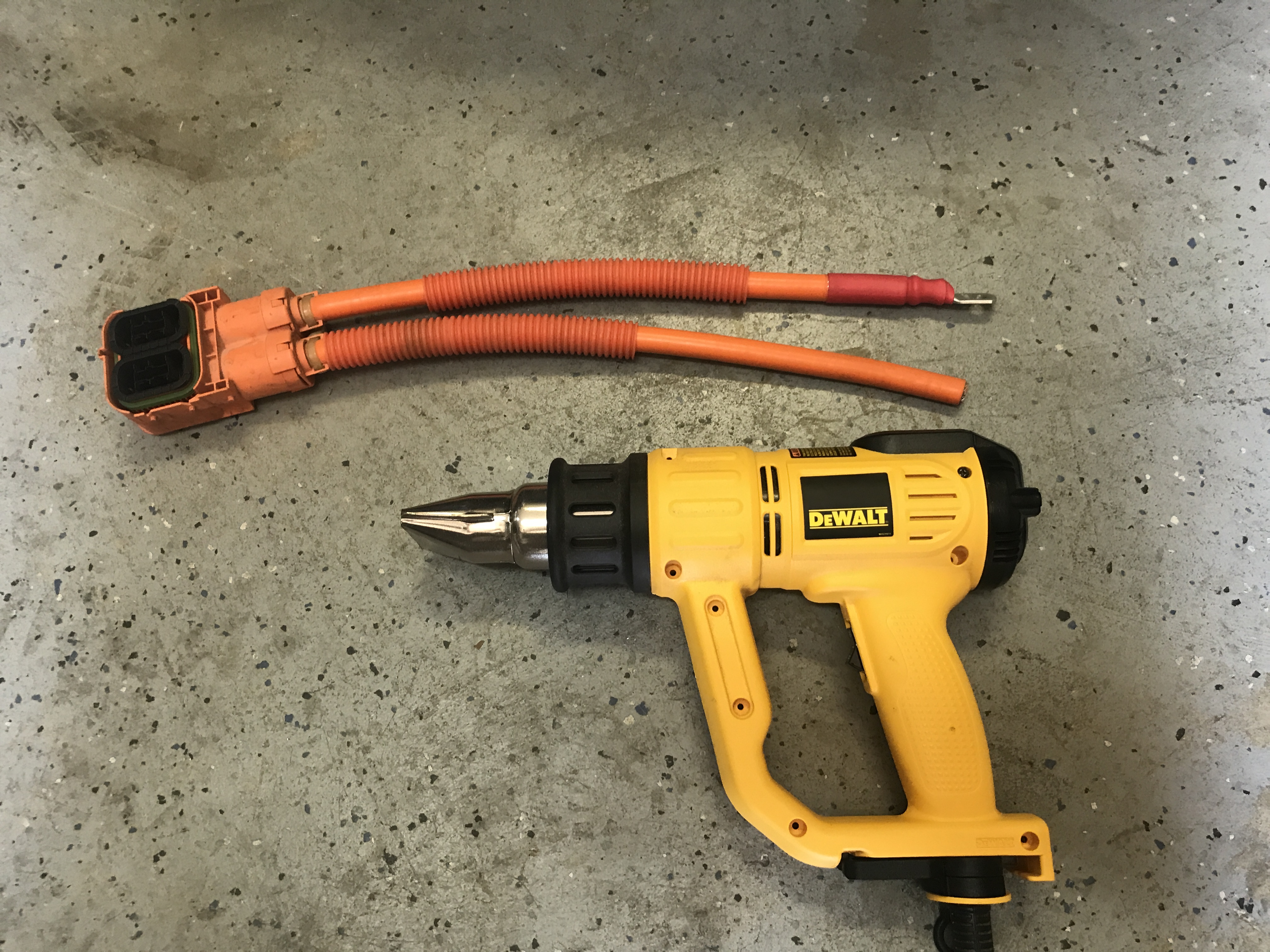

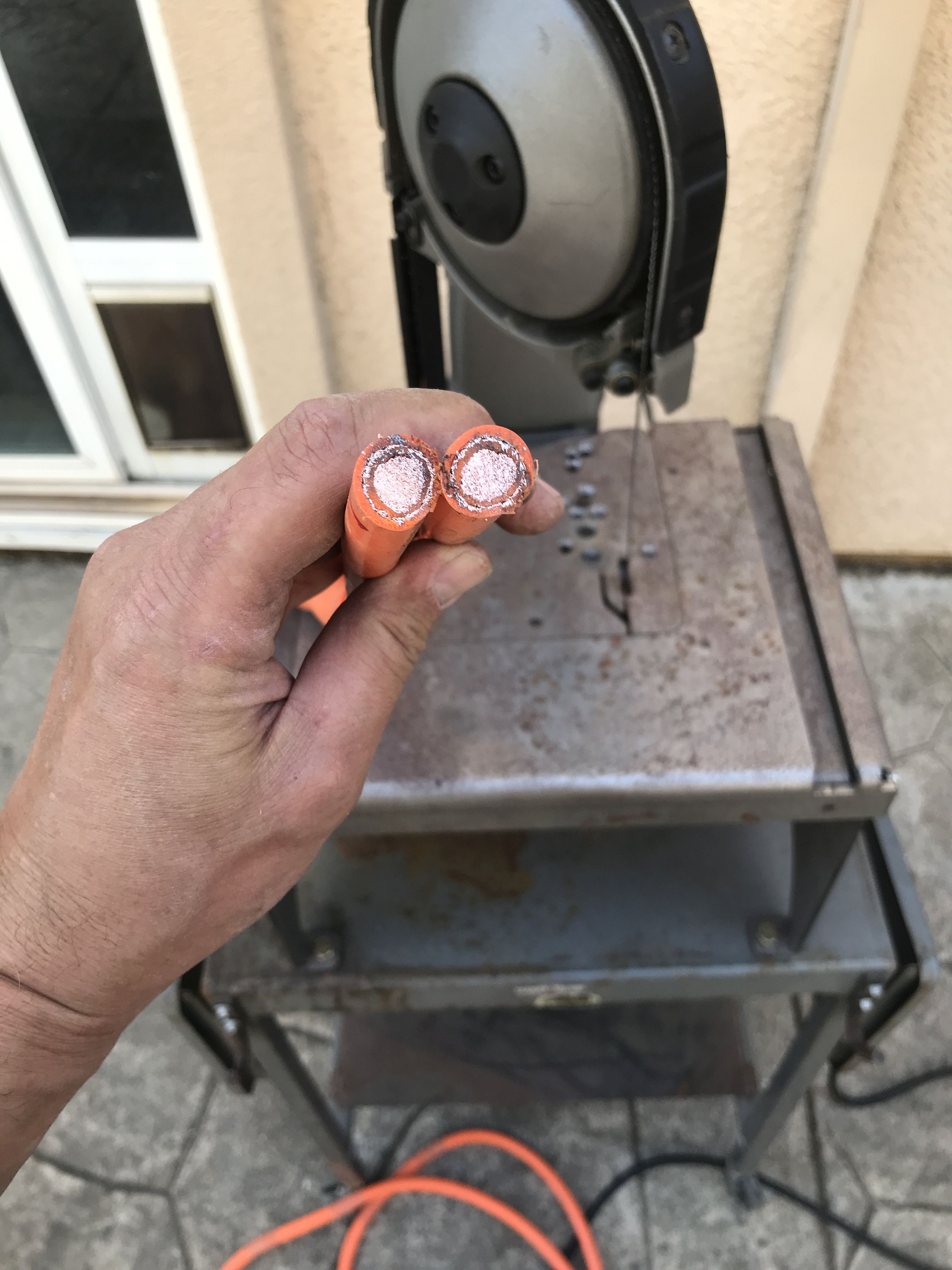

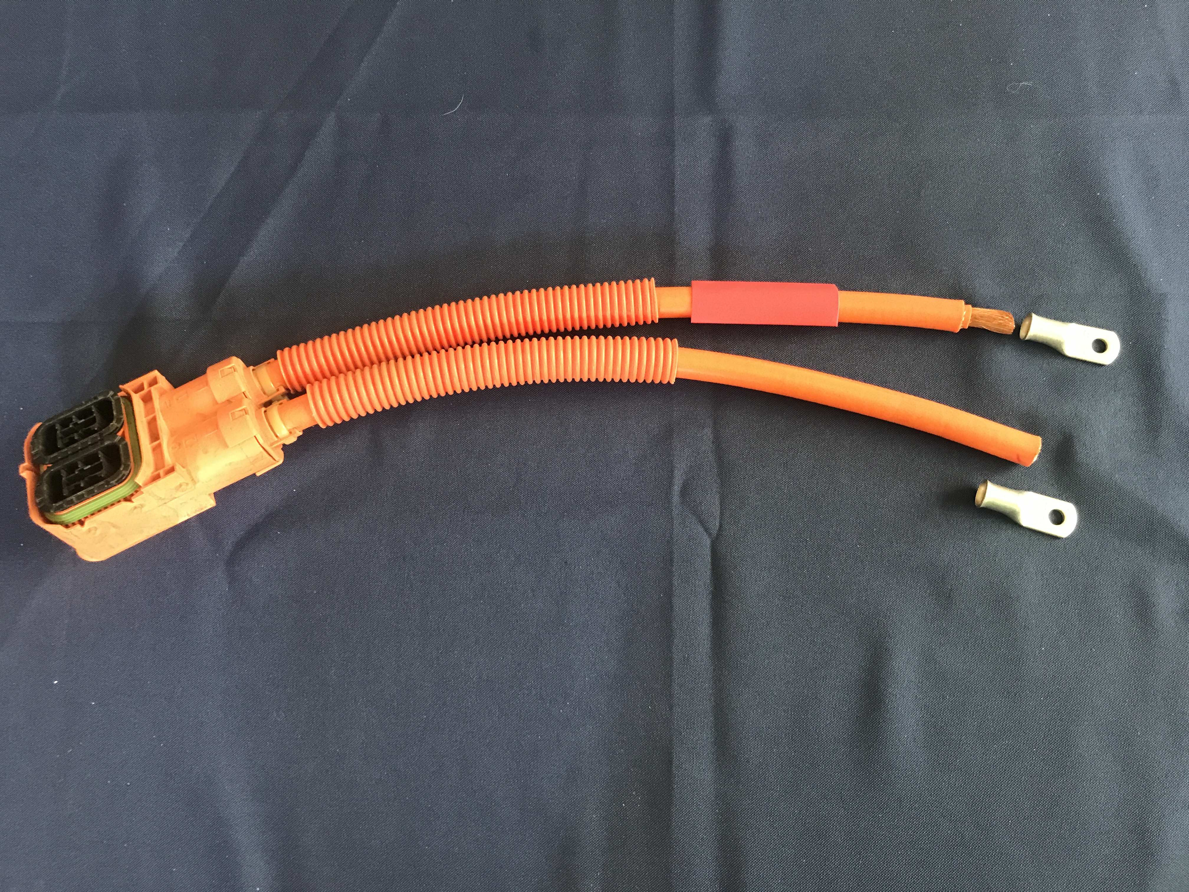

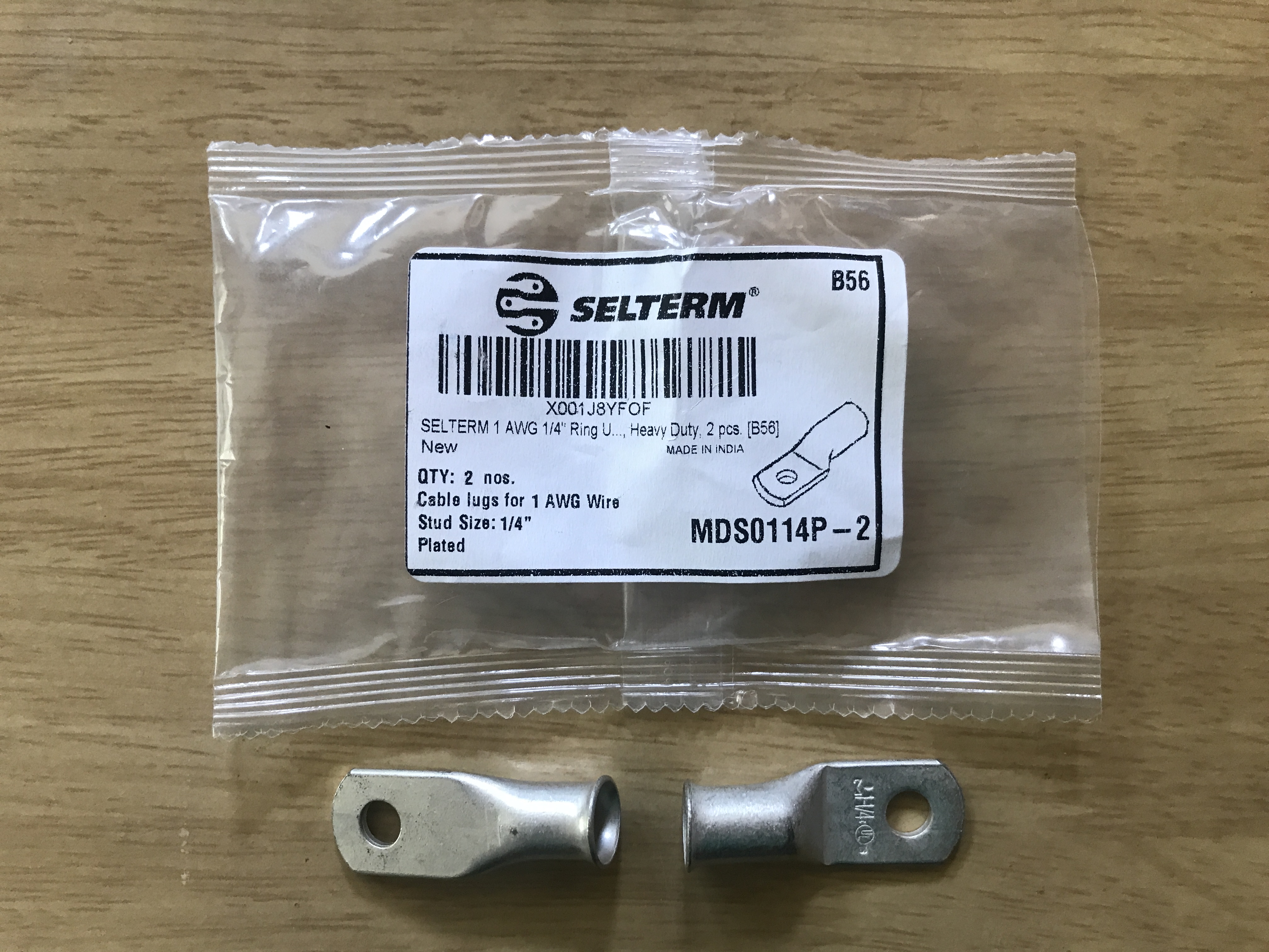

I just wanted to share this in case anyone is planning on using the OEM BMW 530e battery pack cables
the core appears to be about 9 mm
Gregski
Posts: 3157

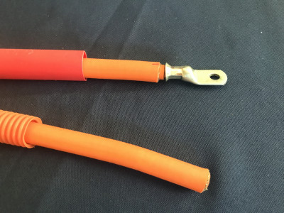

Post by Gregski »

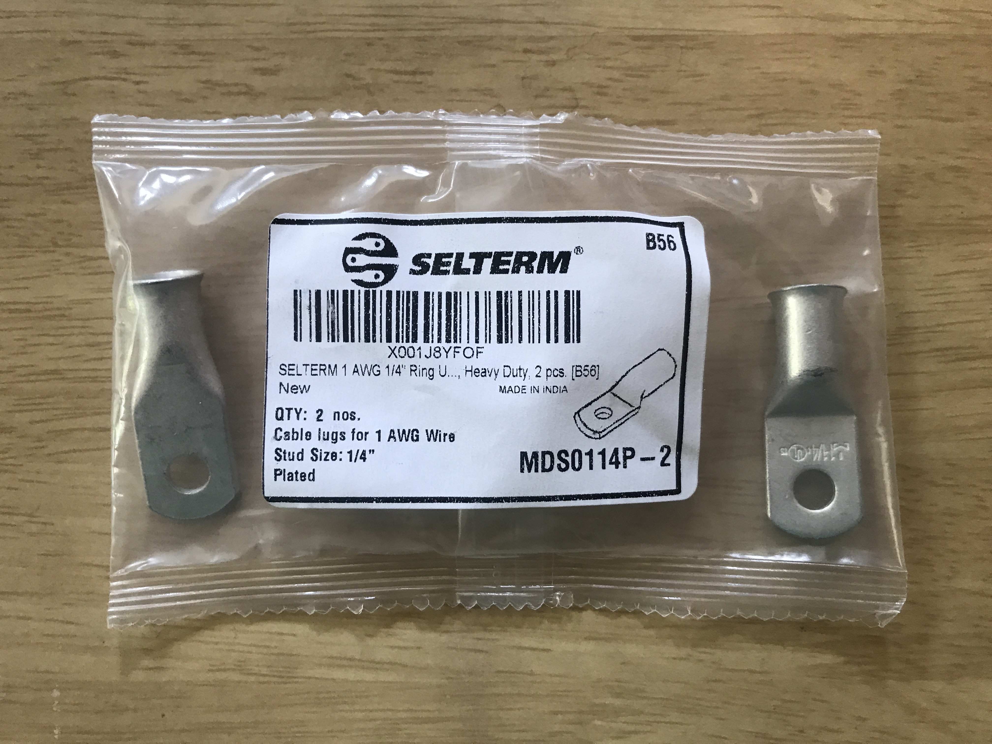

I tried a couple different AWG sizes and think 1 AWG fits the best
Gregski
Posts: 3157

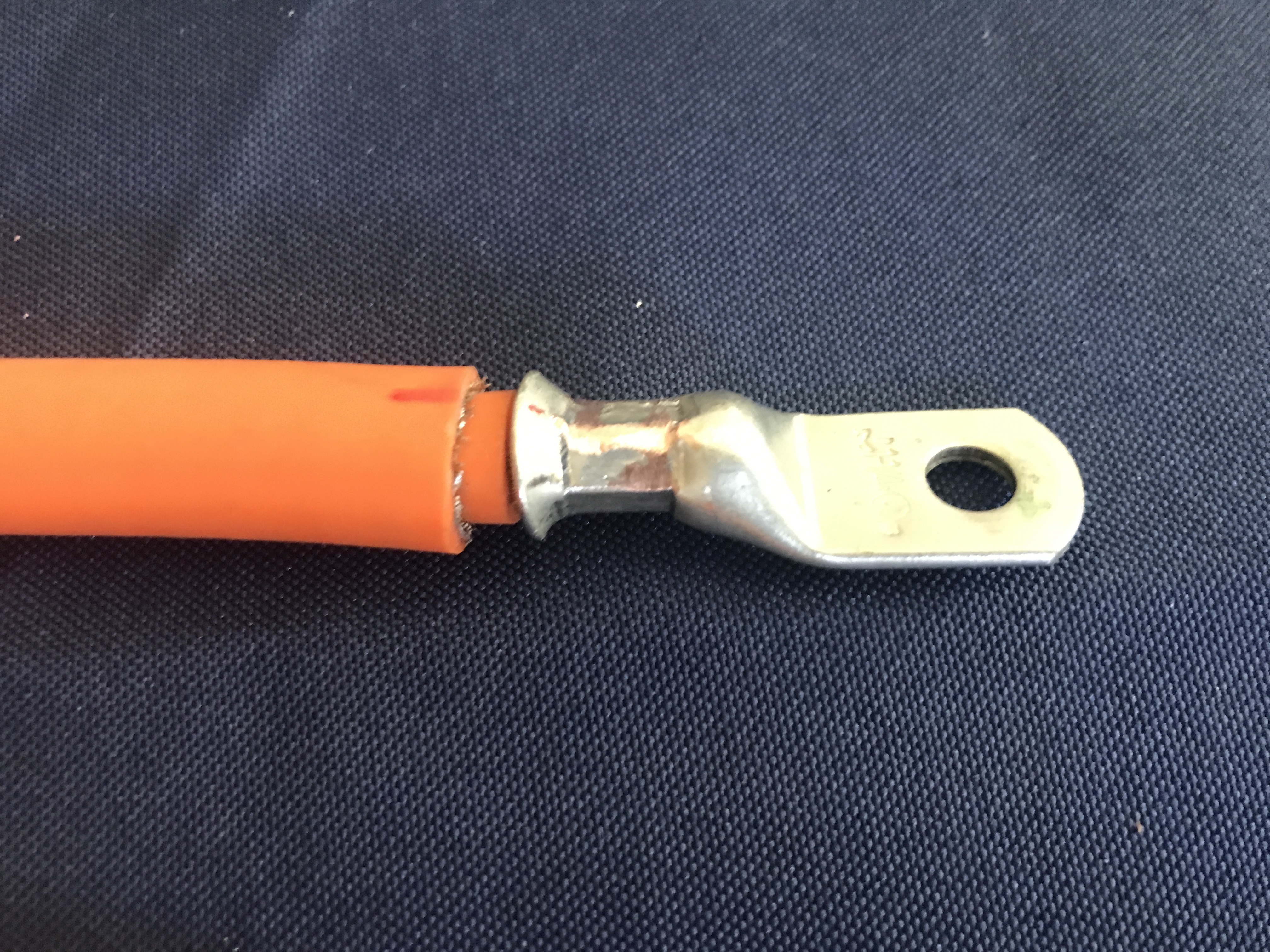

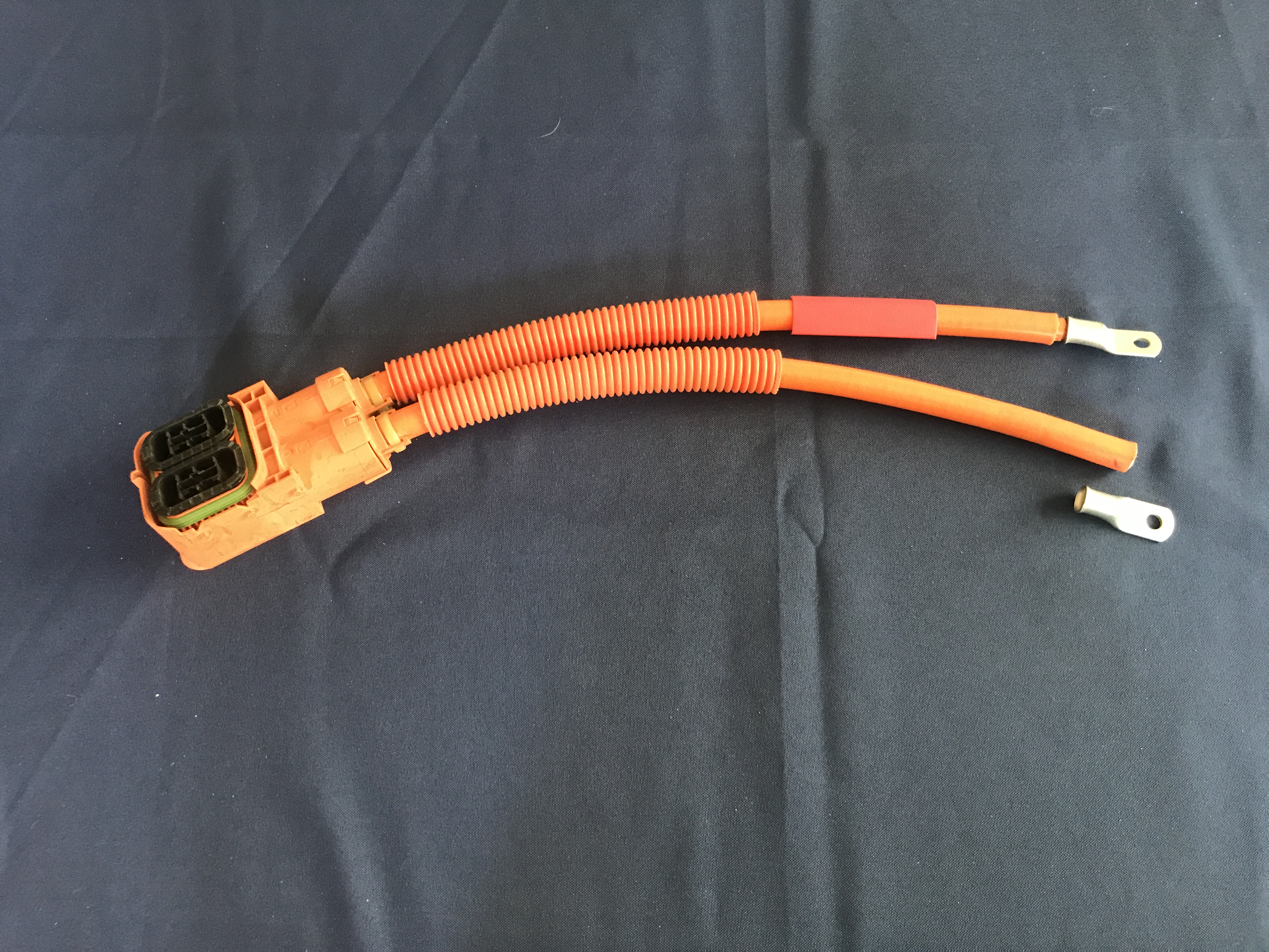

Post by Gregski »

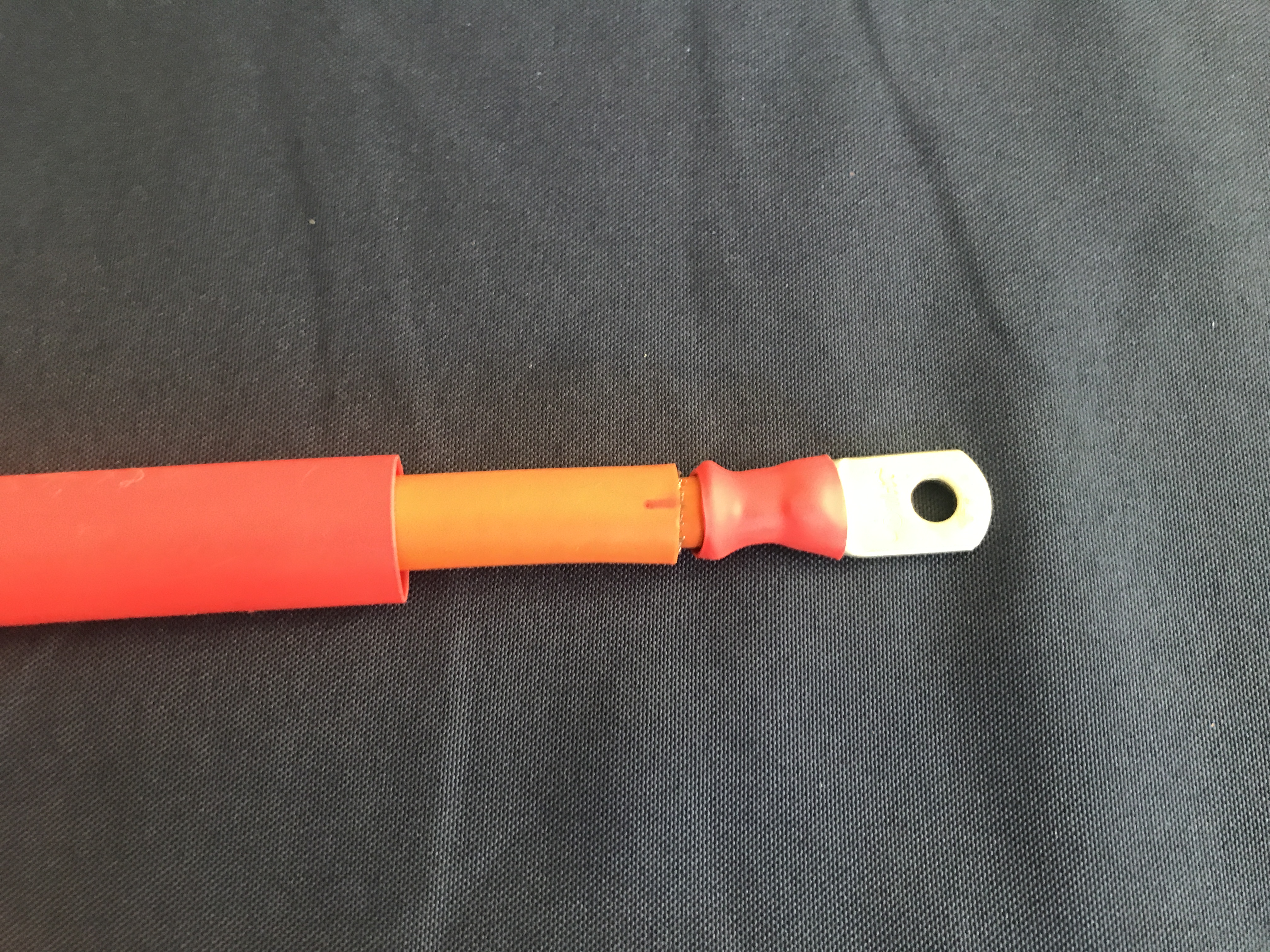

and here I am about to crimp them on
Note: 1/2" heat shrink is too small I think here I am using 5/8"
the outside fatness of the cable is 14mm and the inside core of copper is 9mm
Gregski
Posts: 3157

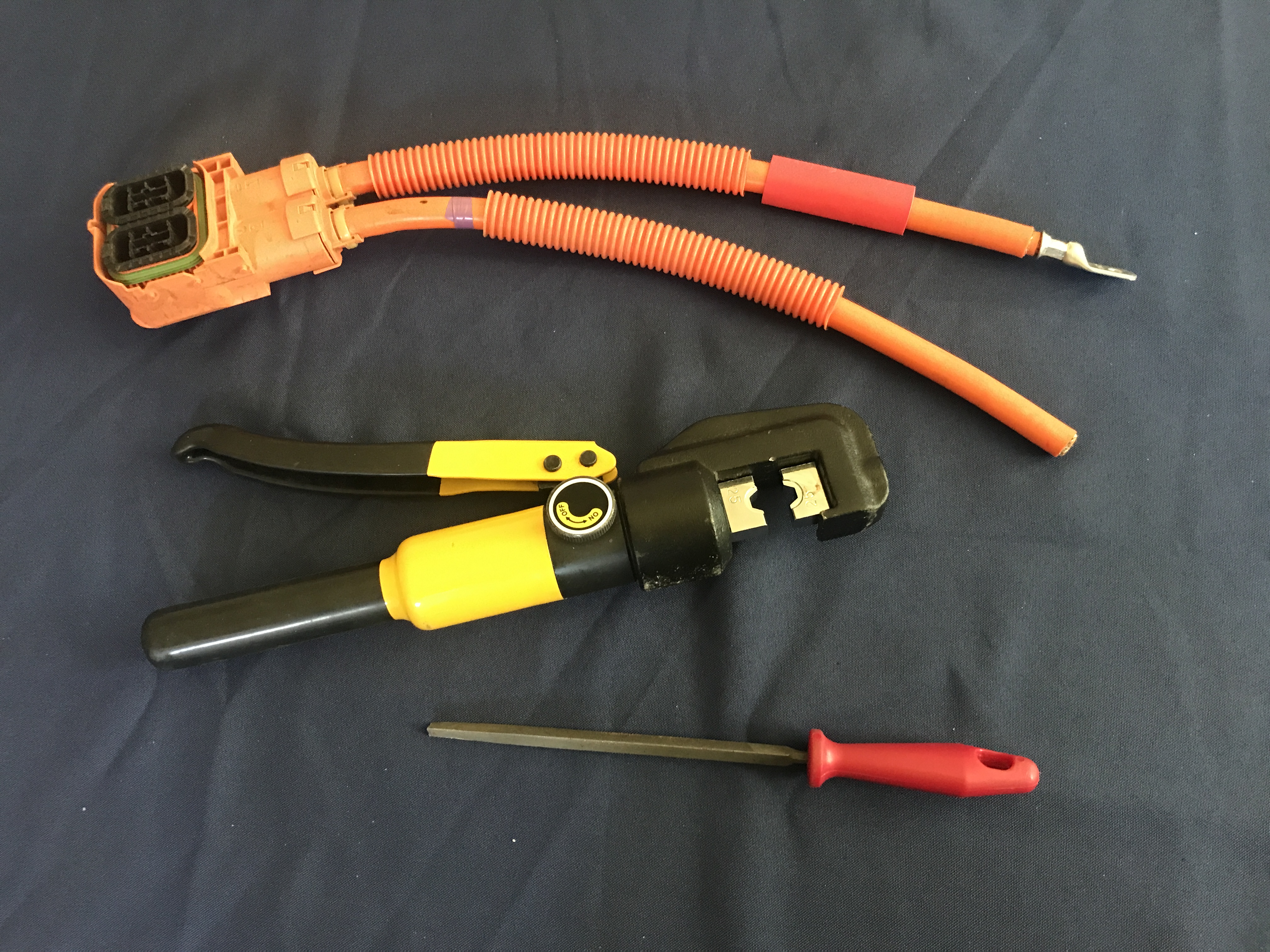

Post by Gregski »

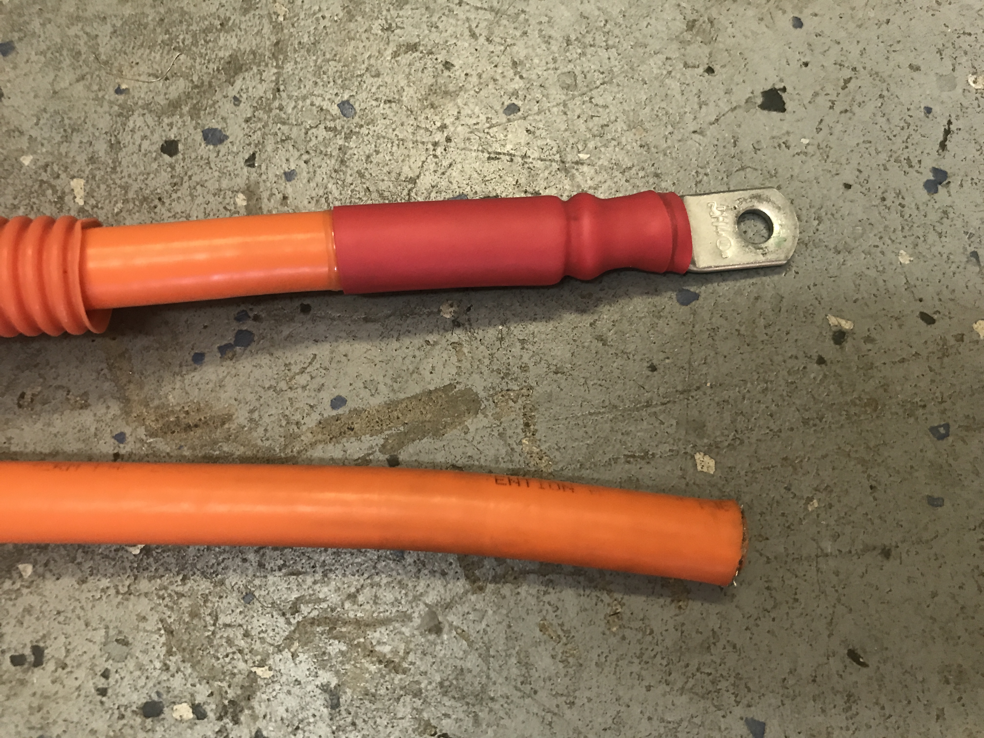

I figure with the popularity of the sport we may have folks of different skill levels so it don't hurt to share some basic stuff like crimpin'
so this crimper aint the best, it leaves sharp edges, hence the file, now if you crimp in two steps, using something like a 35mm jaws then go down to 25mm ones you can sort of minimize the sharp edges, but if you just use the 25mm jaws you get a razer blade like edge to file away
I did this 3/4" mini heat shrink to ensure the metal is all covered up and to give it the same thickness as the rest of the cable or close to

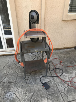

I was left unsupervised so I made this

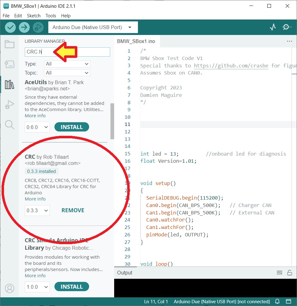

Nice work, I was wondering if you have the "CRC.h" library available as I "believe" I found and downloaded the other required libraries but failed to find the CRC one.

Mhs wrote: Tue Jul 04, 2023 6:38 pm Nice work, I was wondering if you have the "CRC.h" library available as I "believe" I found and downloaded the other required libraries but failed to find the CRC one.
I recall missing one library but in true seasoned programmer fashion I neglected to document which one, however the way I got it was first I was on the newest version of Arduino 2.x something which today already updated again to 2.1.1
anyway I went to Tools \ Manage Libraries and just typed CRC.h and installed the one with some dudes name next to it, and whalla that worked
sorry about the basic graphic below its not intended just for you but newbs that may come along with the same issue

Post by uhi22 »
Nice, but I have a small dought: The orange cable has a copper shield, and I guess this shield is (or should be) grounded. In the pictures above the distance between the "hot" metal part and the copper shield seems quite small, even with the heat shrink it feels risky to me, that isolation is too bad. Just thinking what happens if you move out from the underground parking into hot, wet summer air. Condensate everywhere. Not a nice thought ;-)

Post by robertwa »
uhi22 wrote: Tue Jul 04, 2023 7:45 pm Nice, but I have a small dought: The orange cable has a copper shield, and I guess this shield is (or should be) grounded. In the pictures above the distance between the "hot" metal part and the copper shield seems quite small, even with the heat shrink it feels risky to me, that isolation is too bad. Just thinking what happens if you move out from the underground parking into hot, wet summer air. Condensate everywhere. Not a nice thought ;-)
I thought shielding is for EMI reduction purposes? What would grounding the shield do to reduce the impact of condensation? What would you propose to do differently?

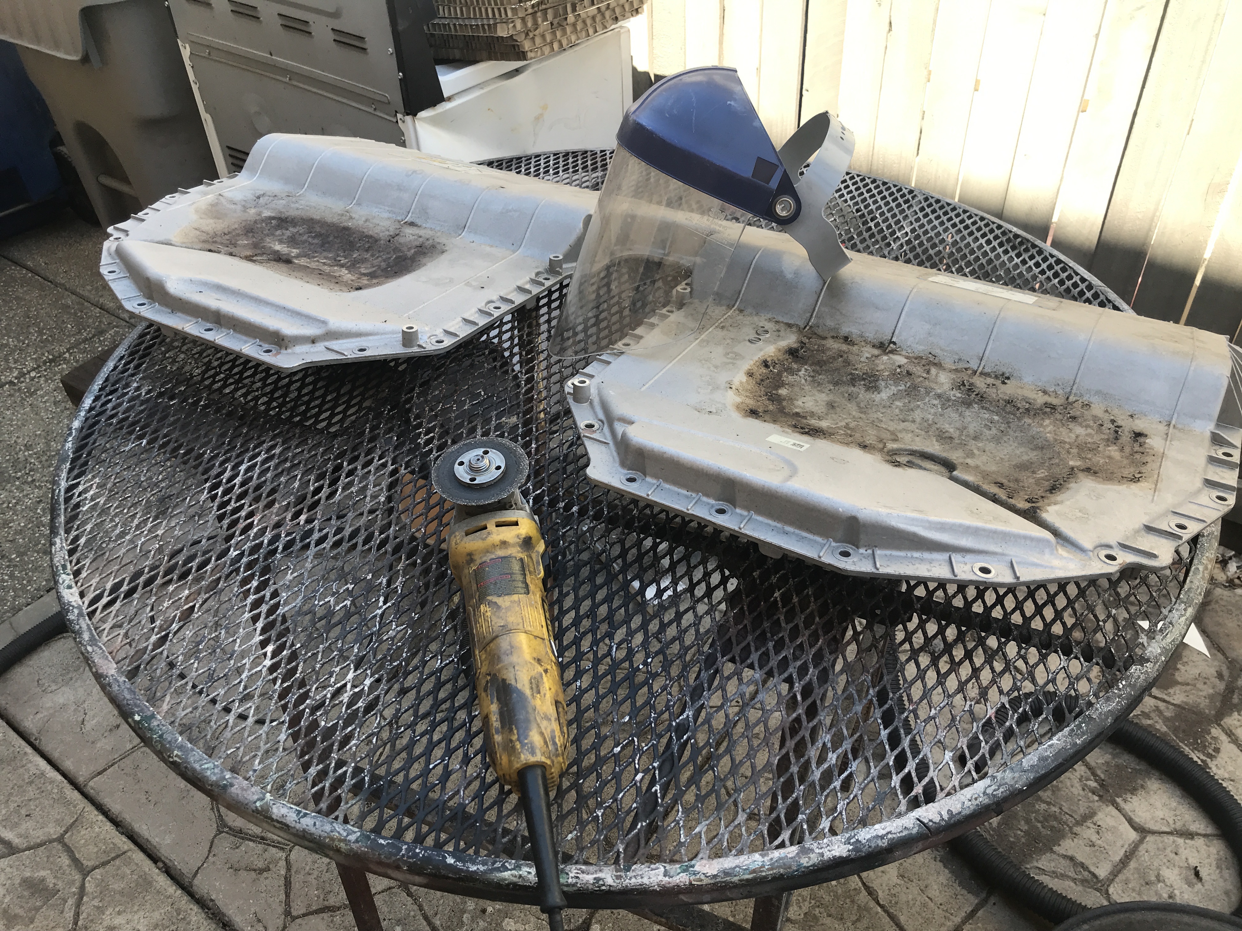

Post by Gregski »

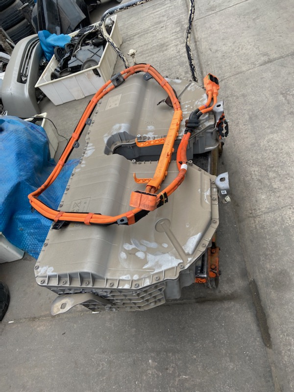

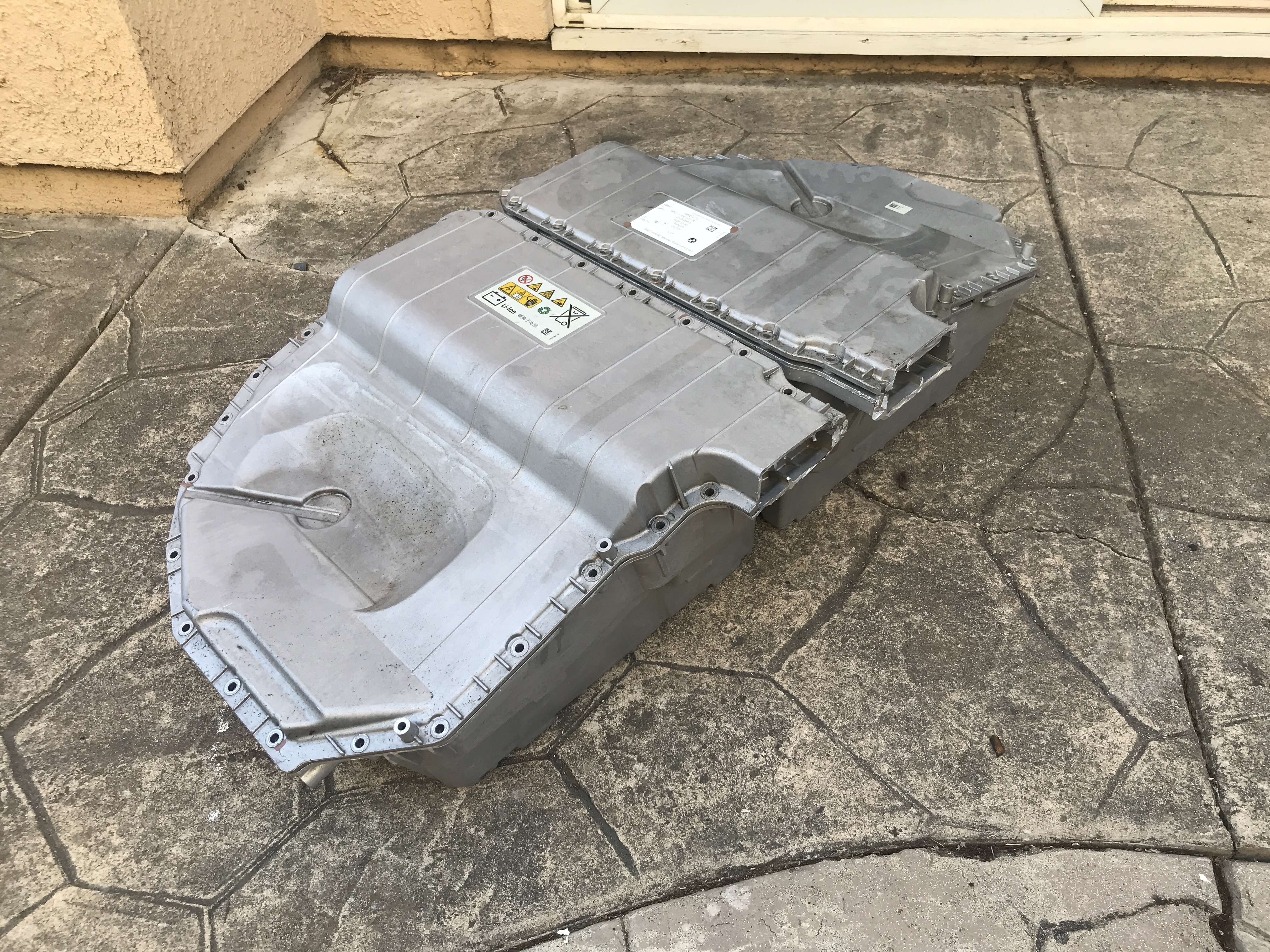

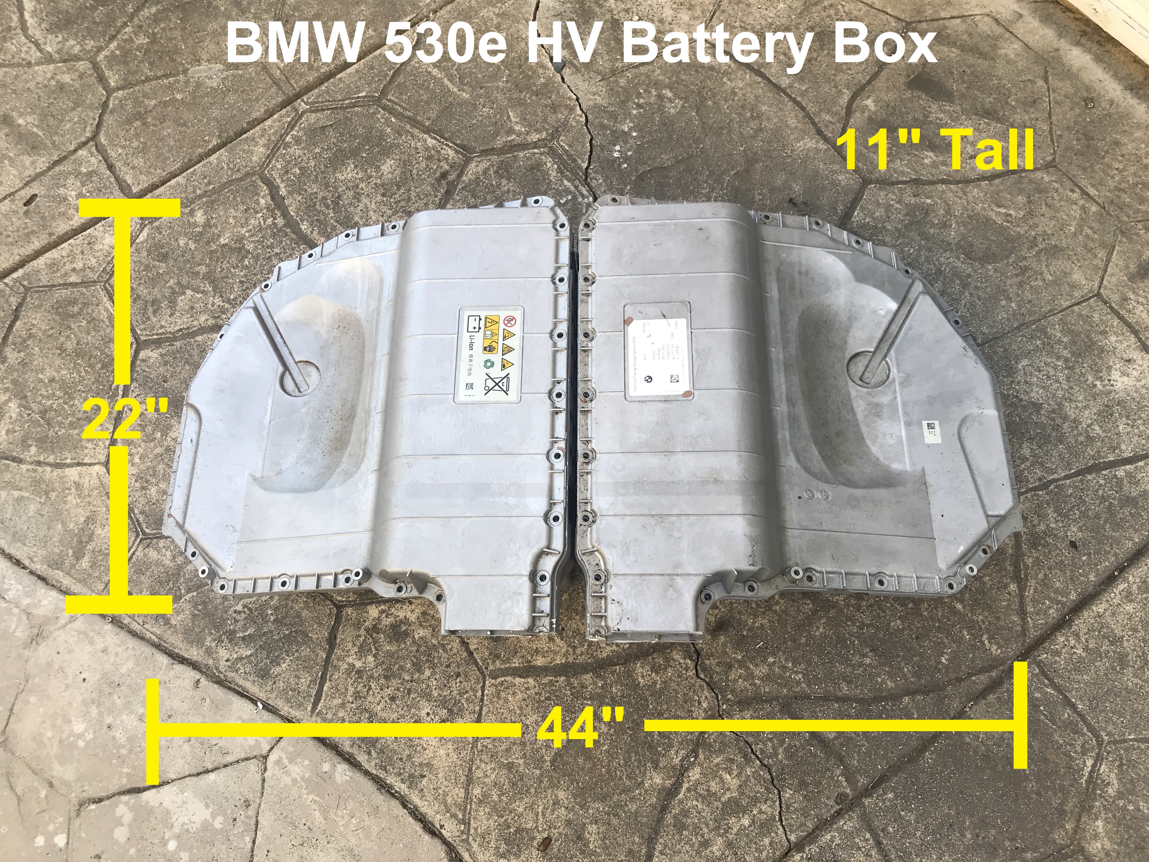

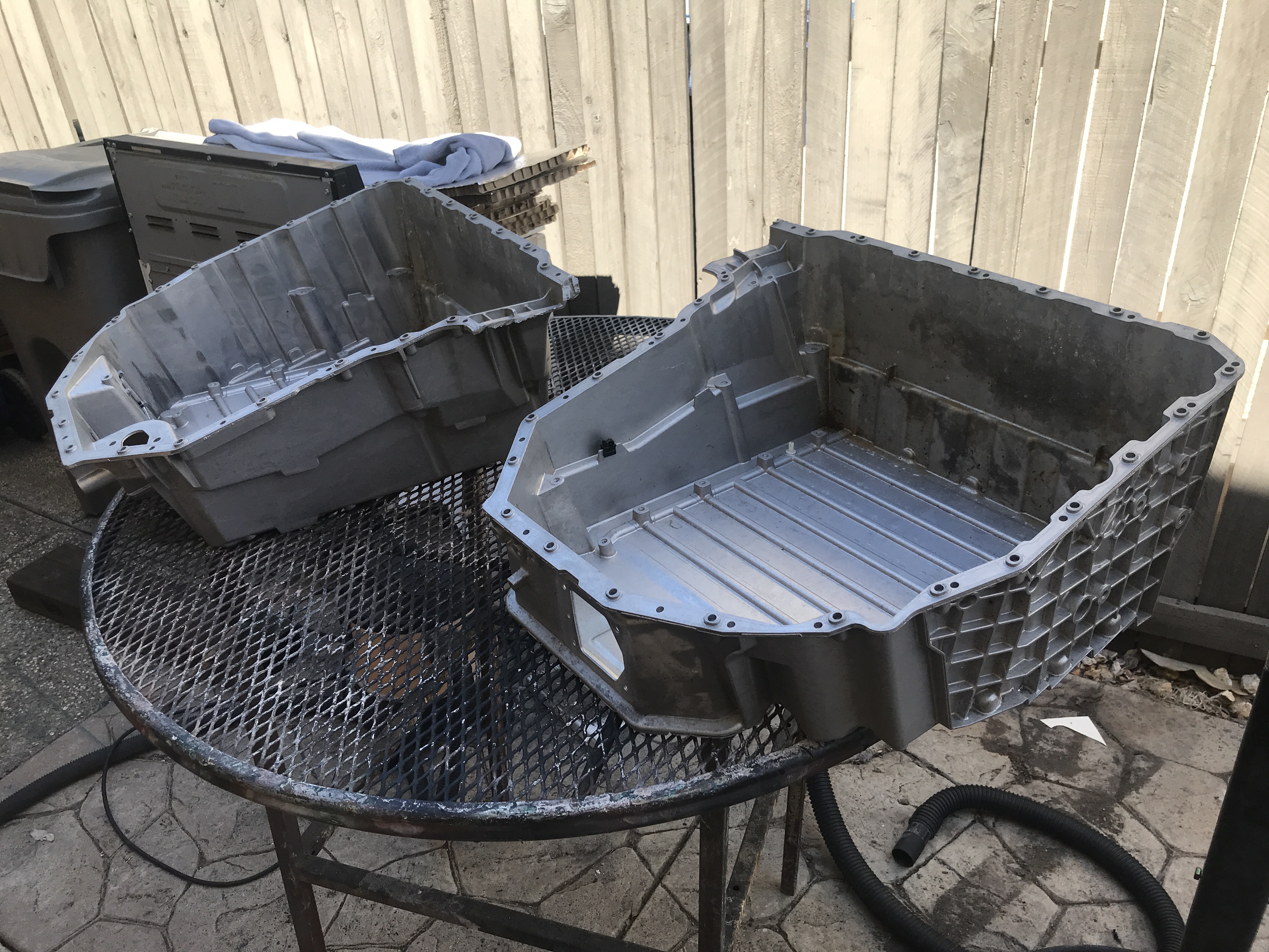

I was thinking outside the box today trying to figure out how and where I can mount a third battery pack on my truck and I think cutting the pack in half and rearranging it like so makes it narrower and more of a box, this could potentially work on some vehicles behind the rear axle in lieu of the fuel tank, especially now that we can control the Safety Box inside of it, I envision running the stock BMW 530e cables from the stock connector along the frame rail to the front of the vehicle

robertwa wrote: Fri Jul 07, 2023 12:40 am I thought shielding is for EMI reduction purposes? What would grounding the shield do to reduce the impact of condensation? What would you propose to do differently?
Yes, the shielding is for EMI reduction purposes and also reduces the risk that a marten-bite leads to exposed HV, instead the grounded shield is exposed and the isolation test has a chance to detect the issue.
The grounding does not reduce the condensation. I was talking about the fact, that if there are only 4mm space between the HV and the grounded shield, with no seal in between, the condensate makes path for the current, and the isolation test fails. The better solution should make sealed border between the HV and the shield. I have never seen how this looks in real life. At least I would remove the shield at at least 2cm, and use a heat shrink with inner glue, which seals the path between the HV and the shield, at a length of 1 or 2 cm.
