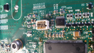

Good news on the hardware front. The Harwin M40-3100545R arrived from Mouser and is a very nice press fit on that silly jtag socket.

Great, how about the connectors, so you plan to include them on the JTAG board kit?
davefiddes
Posts: 416
Has thanked: 206 times
Been thanked: 256 times
Post by davefiddes »
This connector goes on the bottom of the PCB of the JTAG adapter. It just plugs in to the inverter board, hook up a USB cable and away we go. A very neat solution!
JaniK
Posts: 404
Has thanked: 101 times
Been thanked: 15 times
Post by JaniK »
Yes, I know how it connects, I just wanted to know if Damiens kit will have all parts or just the PCB with SMT parts on board.
So we don't run into hastily ordering duplicates..
Posts: 4005
Been thanked: 1130 times
All parts will be supplied in the kit. I should have boards and FTDI chips this week for testing.
