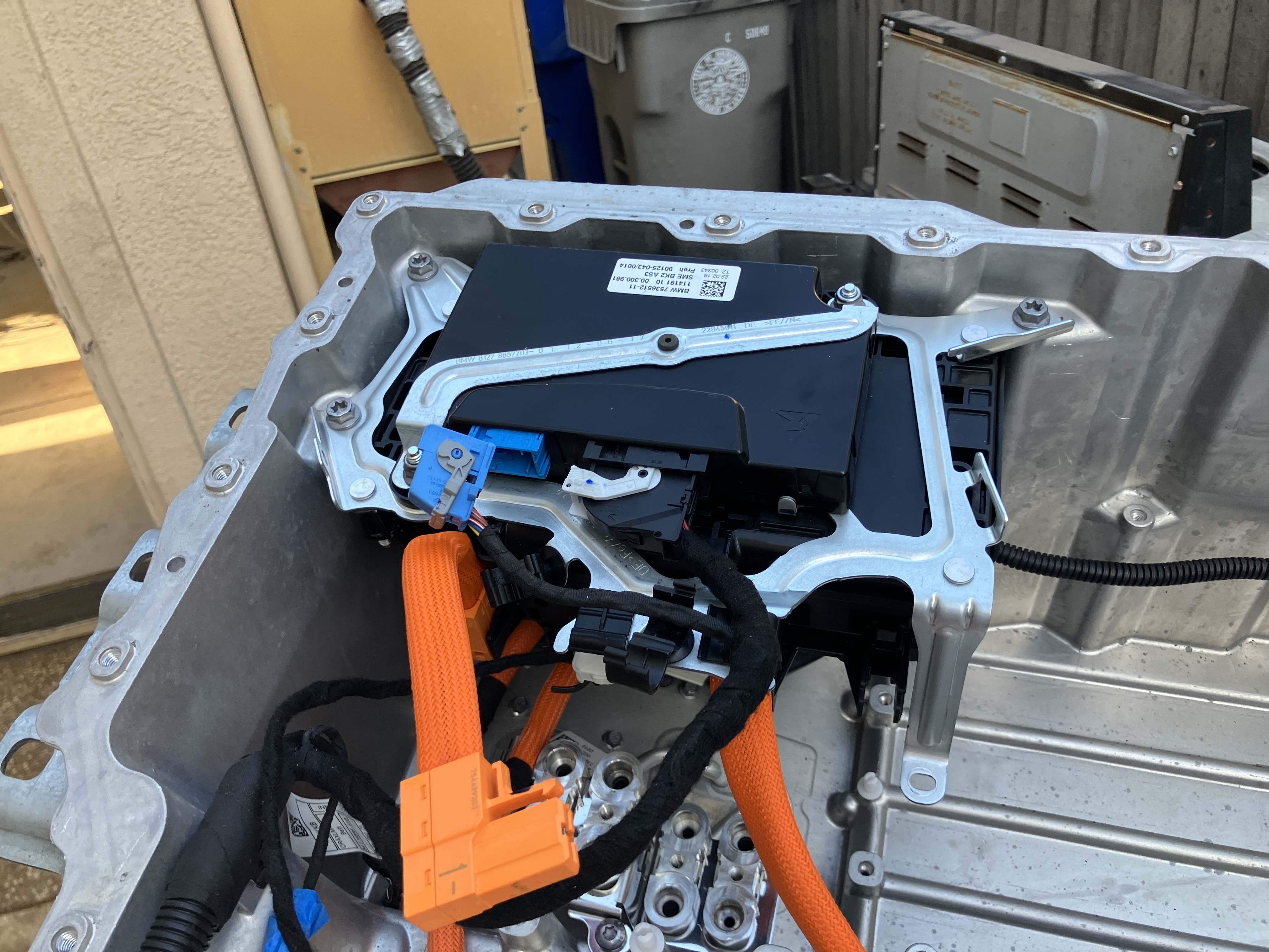

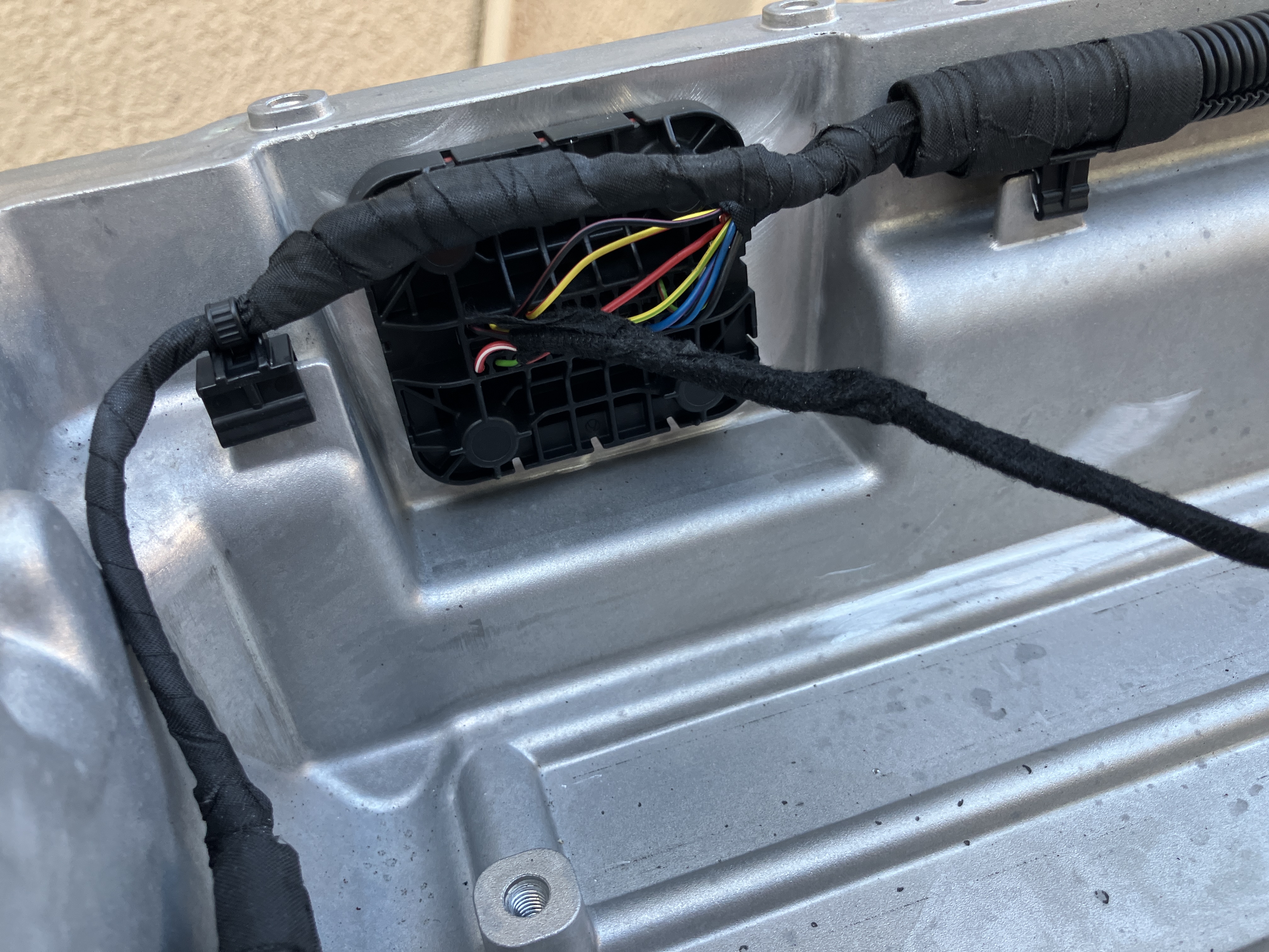

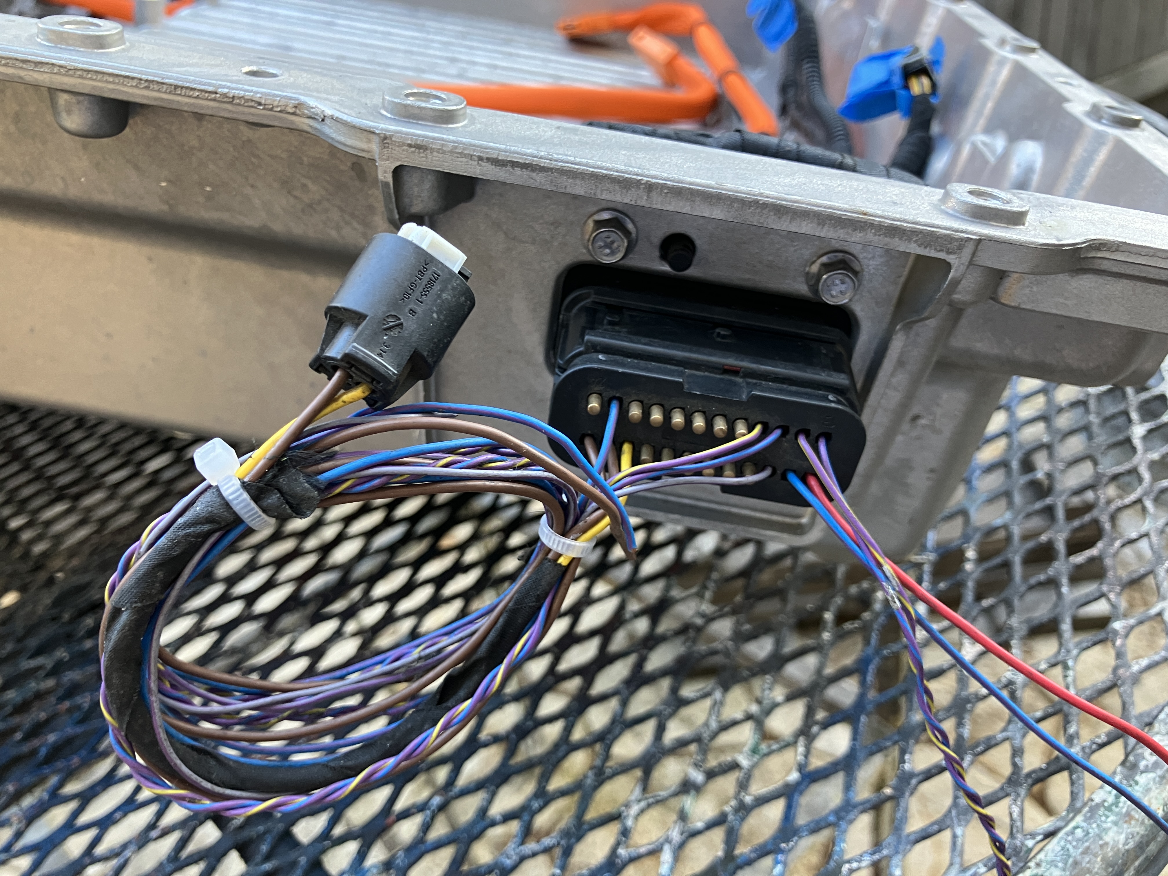

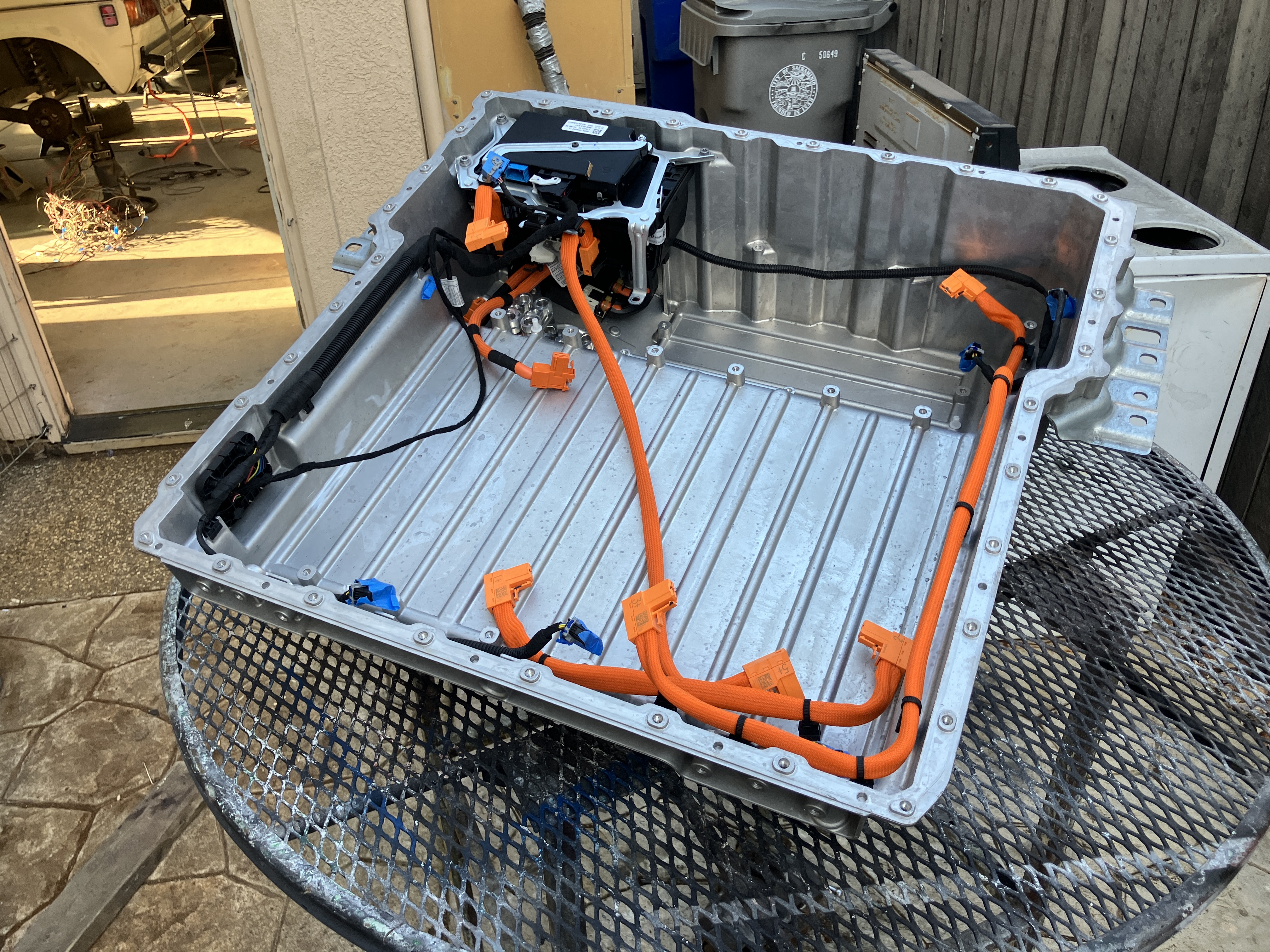

BMW 330e External Connector
if we gonna use the OEM BMW battery box we might as well use the OEM low voltage pig tail
things escalated quickly

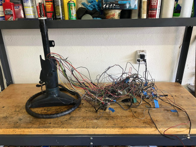

- Spent 3 days converting to good ol' manual brakes, yes the rears were seized!

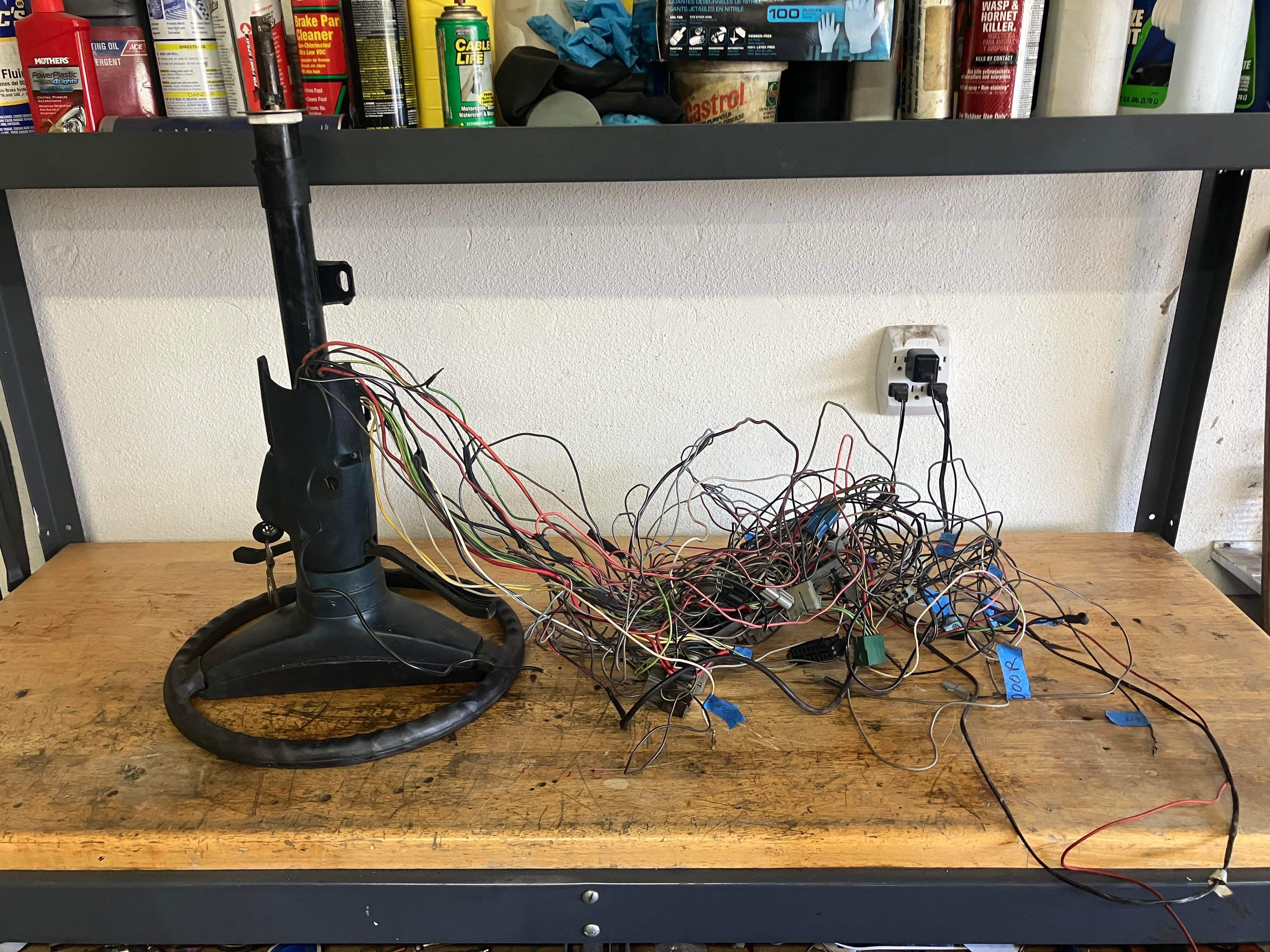

- Spent 2 days repairing the OEM steering column - I'm looking at you lower bearing!

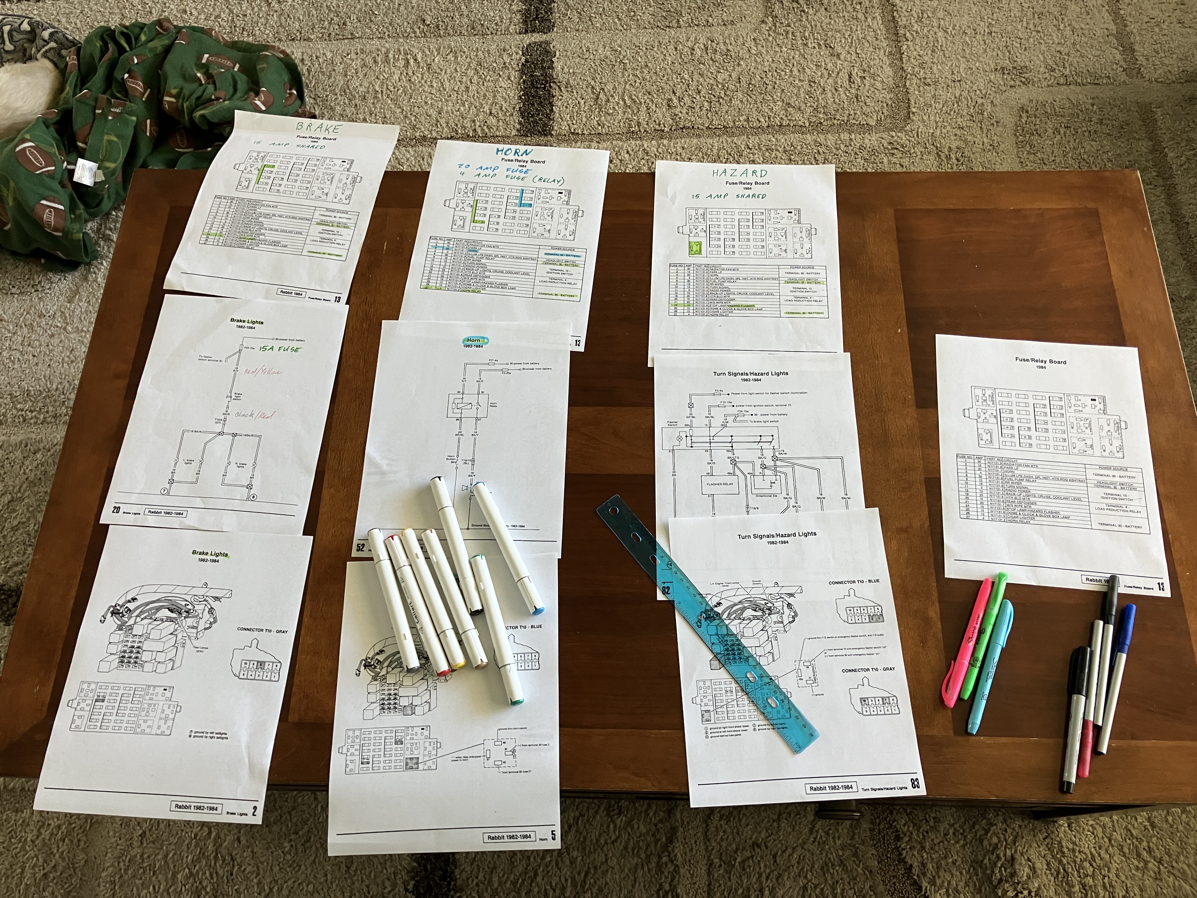

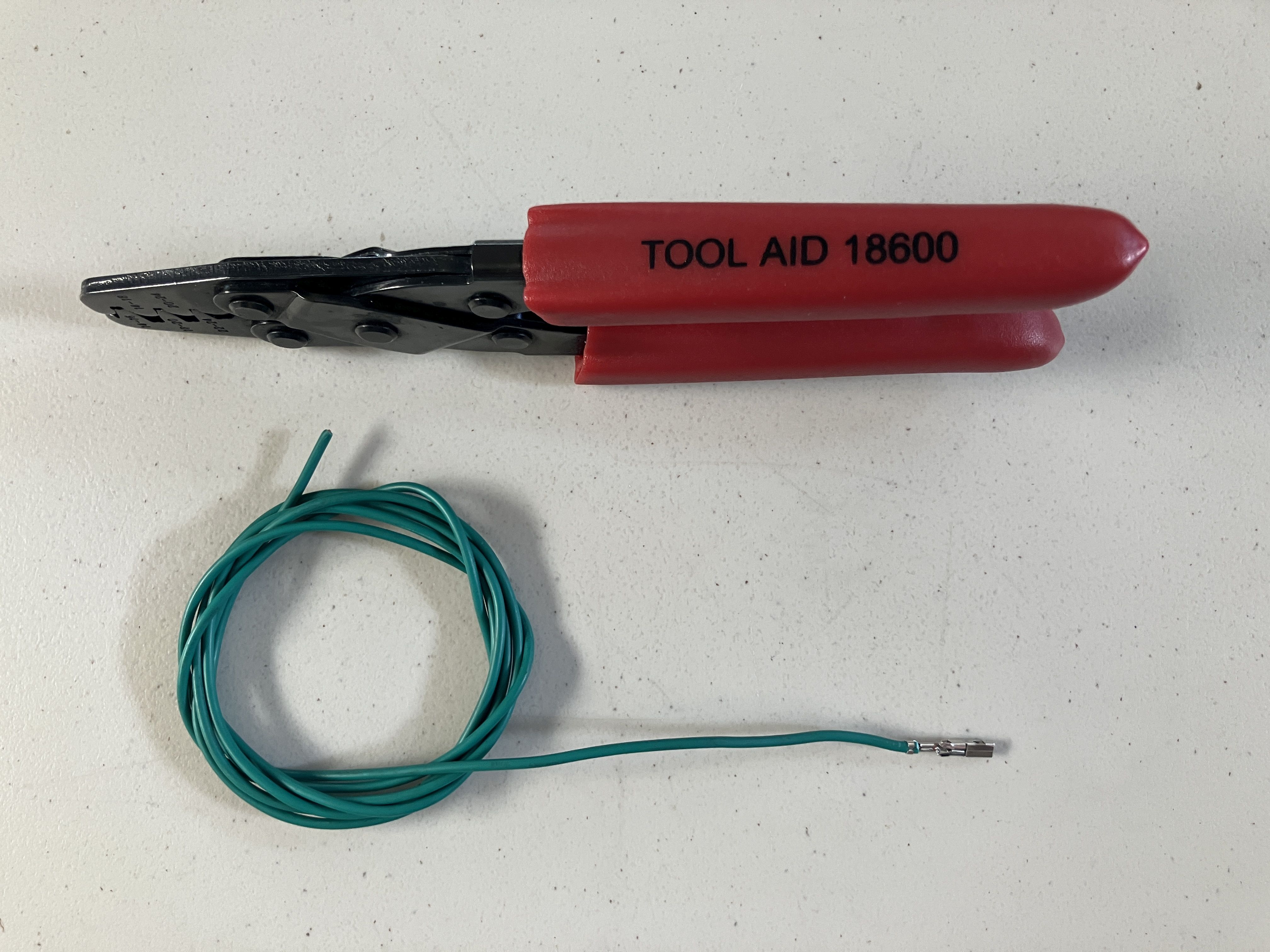

84 VW MK1 Rabbit DIY Wire Harness 1 - Roll Your Own Fuses & Relays 1
so from this:
to that:
KISS: Keep It Simple Stupid
so from this:
to that:

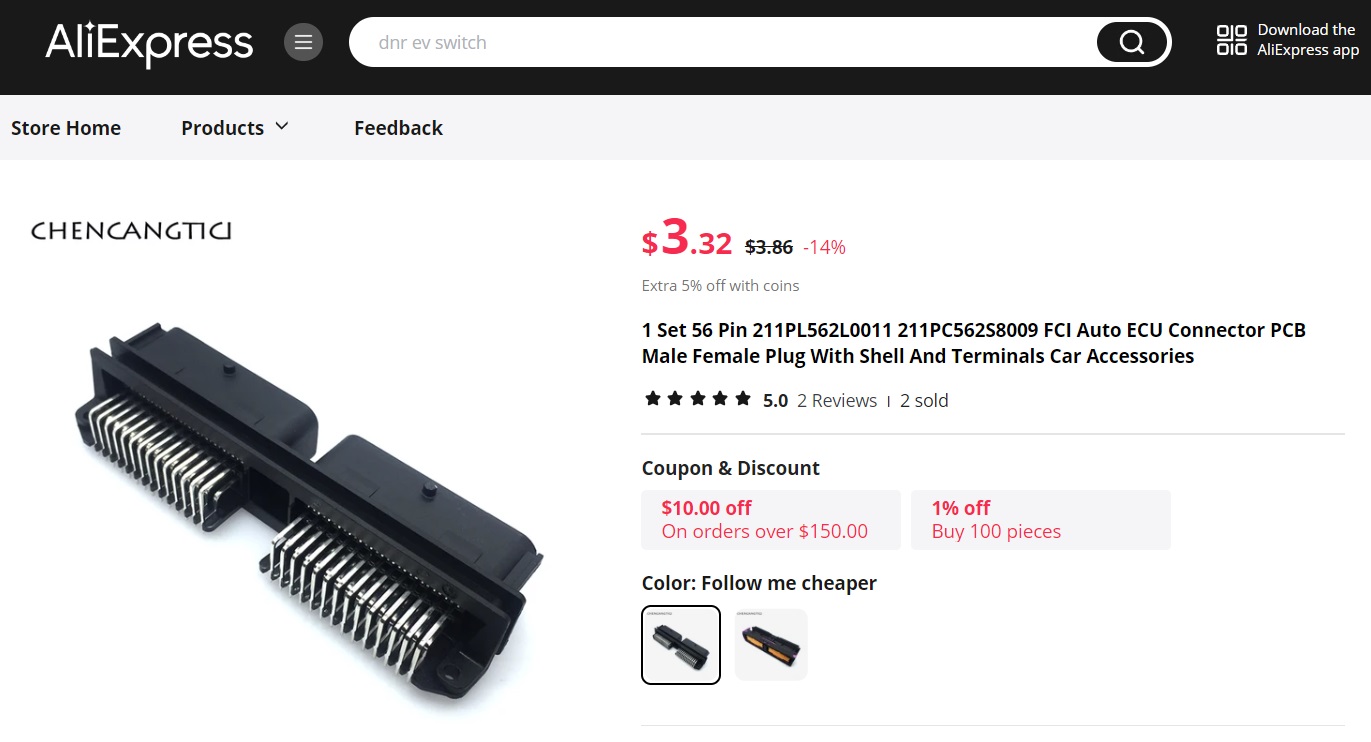

EVBMW ZombieVerter VCU Header, Connector, Wire Harness
- Gregski
- Posts: 3170
- Has thanked: 635 times
- Been thanked: 1610 times
56 Pin Header (Male) - Part # 211PL562L0011
https://www.aliexpress.us/item/2255799870142865.html]
56 Pin Connector (Female) - Part # 211PC562S0009

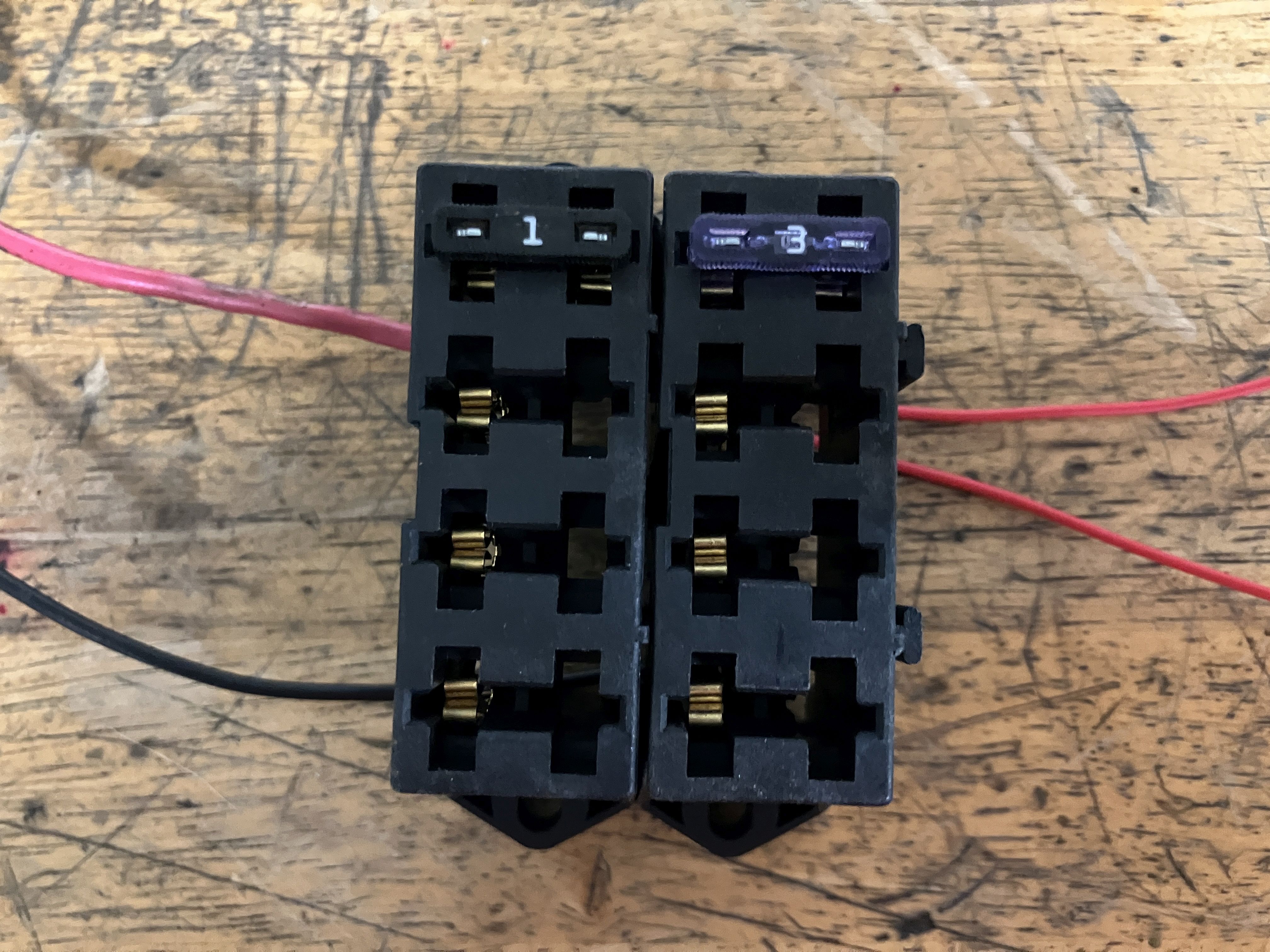

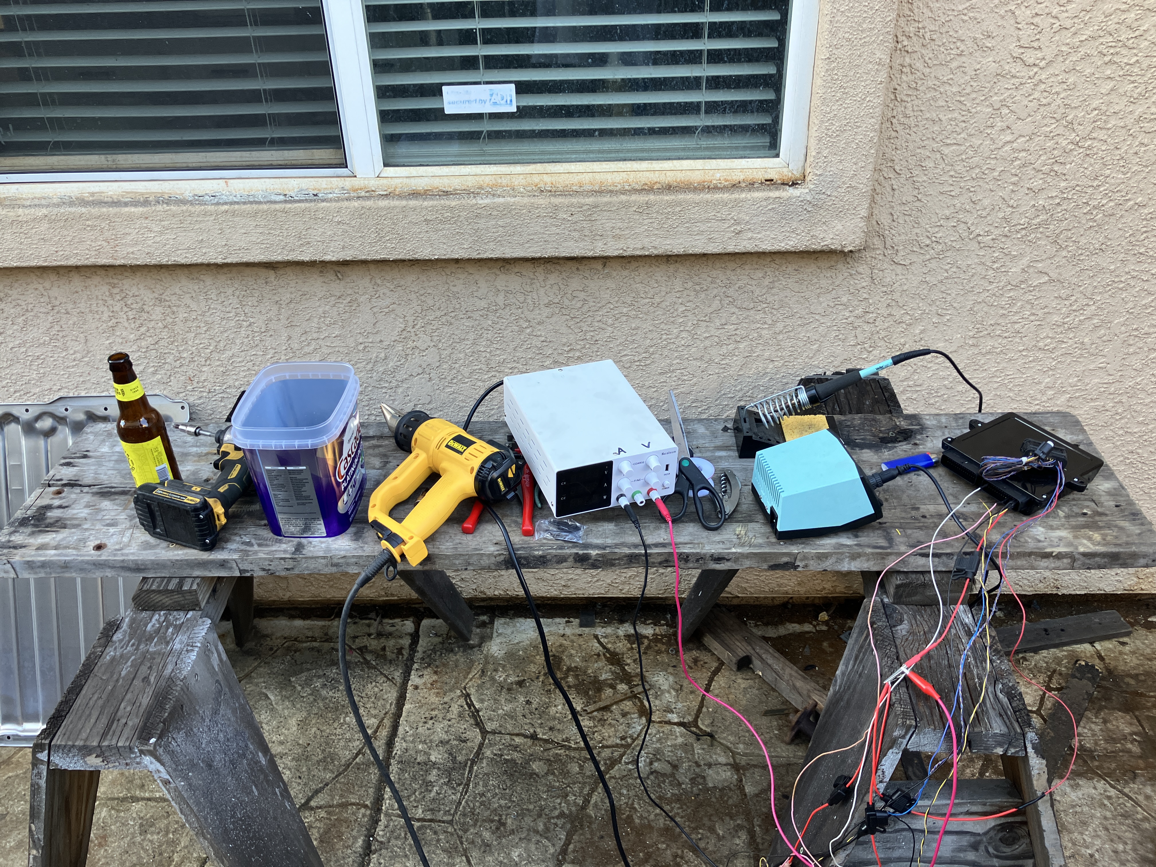

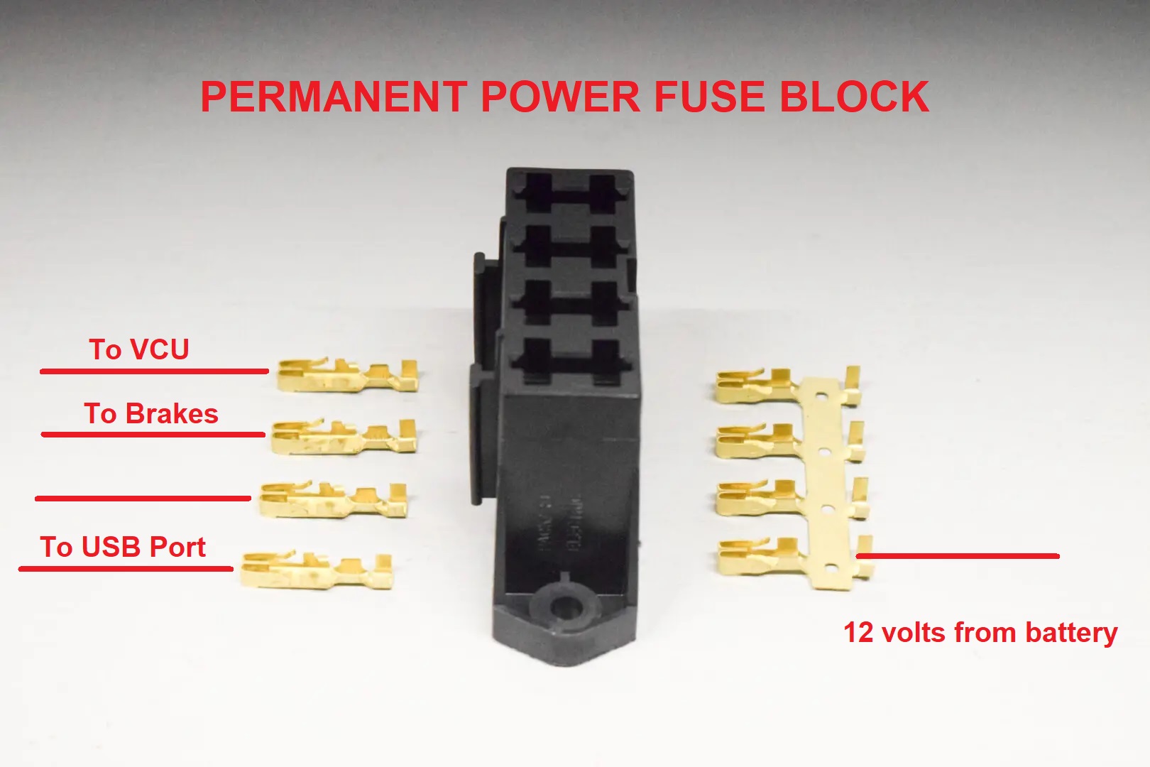

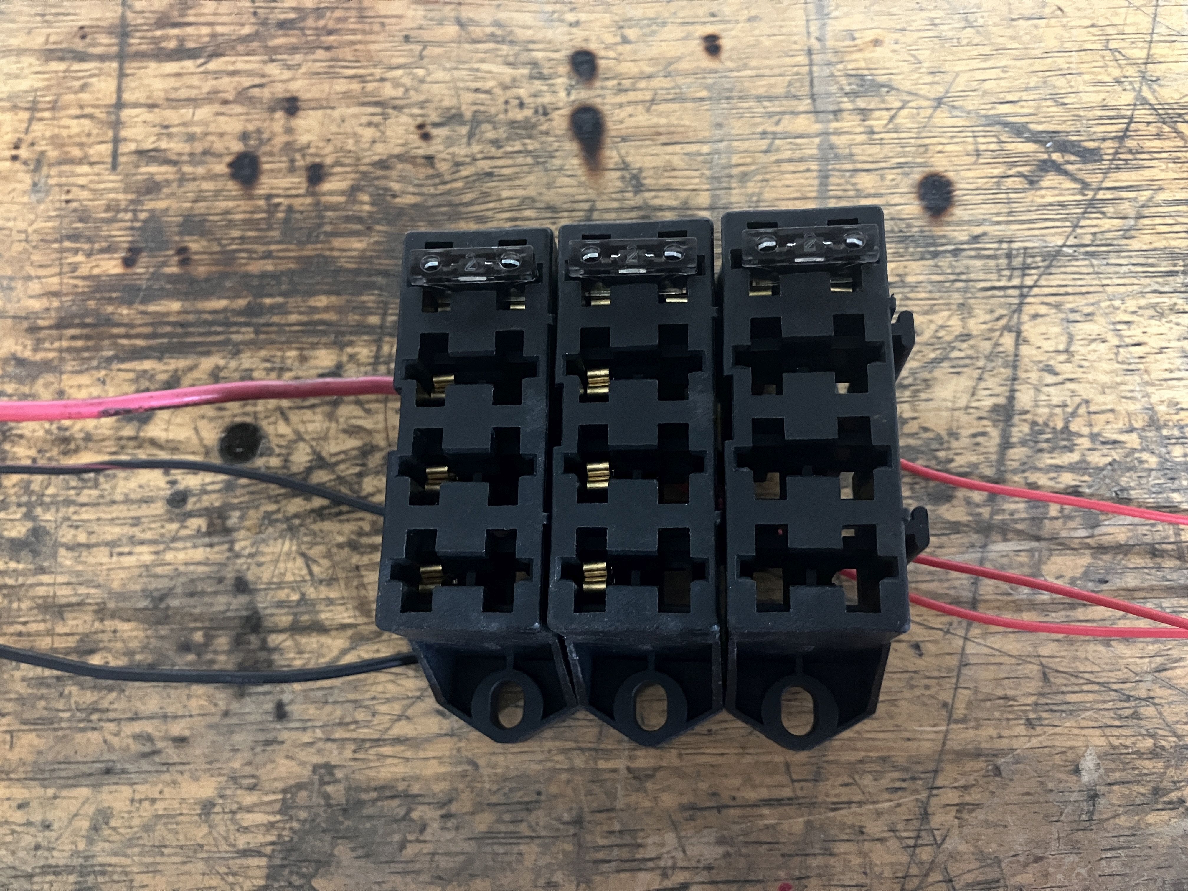

84 VW MK1 Rabbit DIY Wire Harness 2 - Permanent Power Fuse Block
here we add a four fuse block for anything that will require permanent power like the ZombieVerter VCU and brake lights

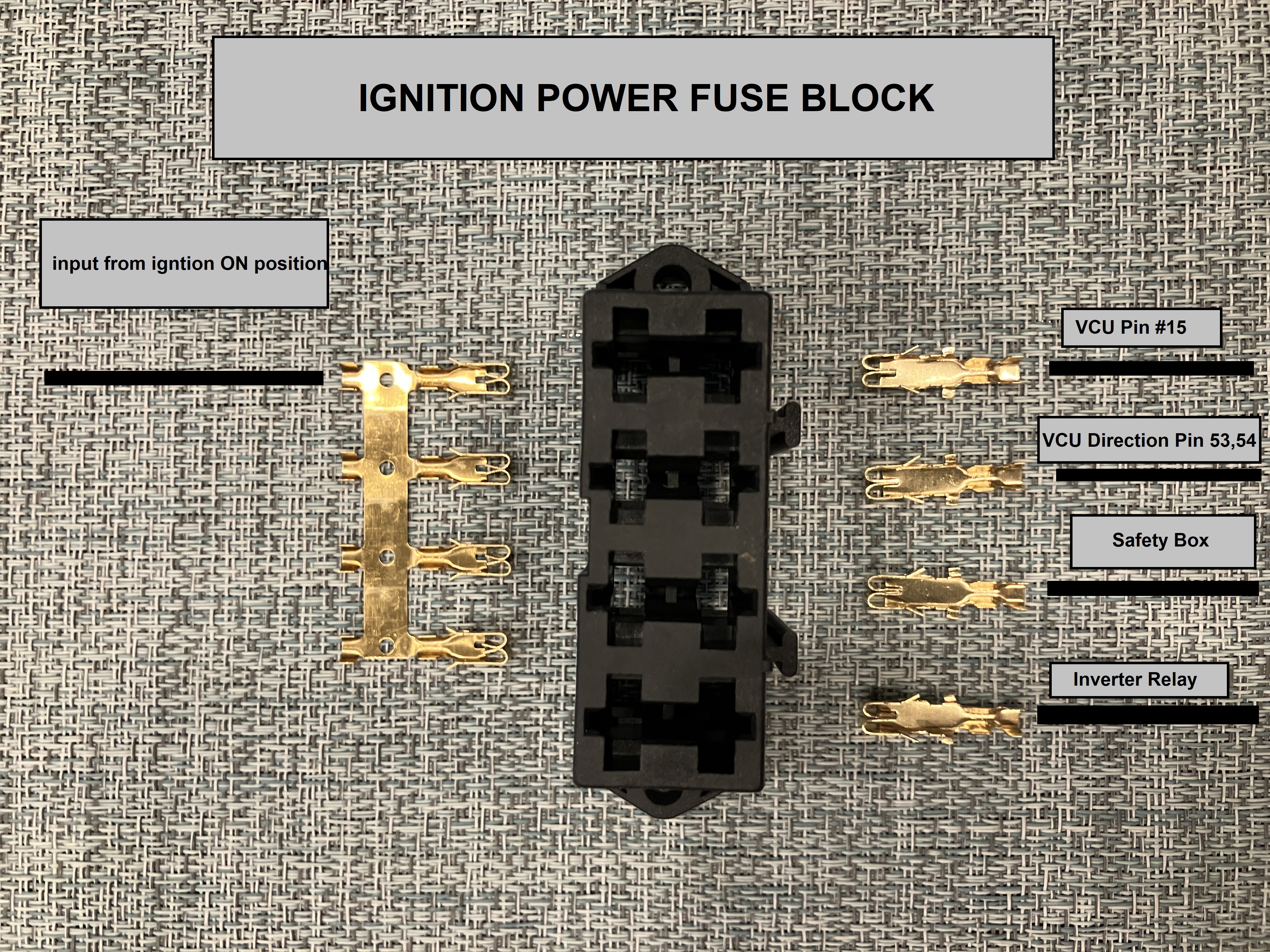

84 VW MK1 Rabbit DIY Wire Harness 3 - Ignition Power Fuse Block
the one where the Greg adds a second four fuse block, this one gets it's power when you turn the key in the ignition to On
The man responsible for the ZombieVerter tells us about Pin #15

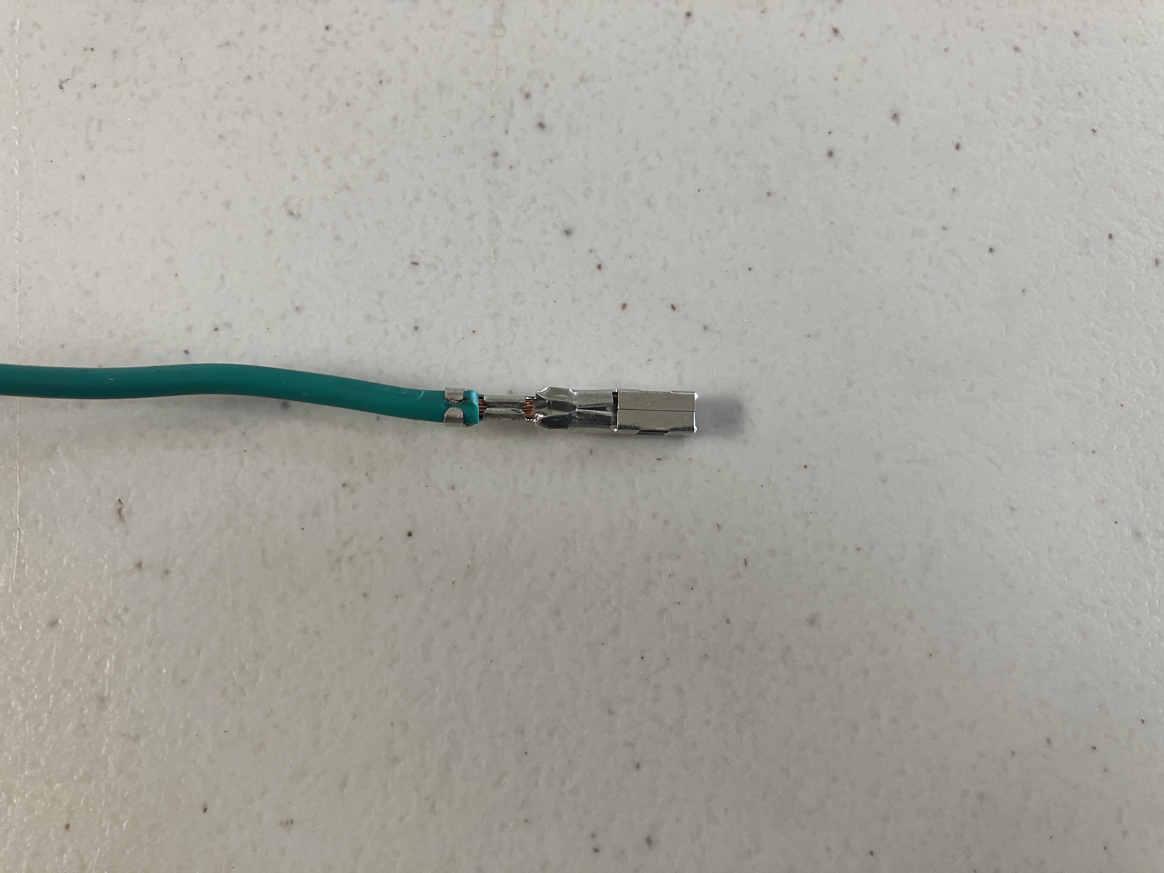

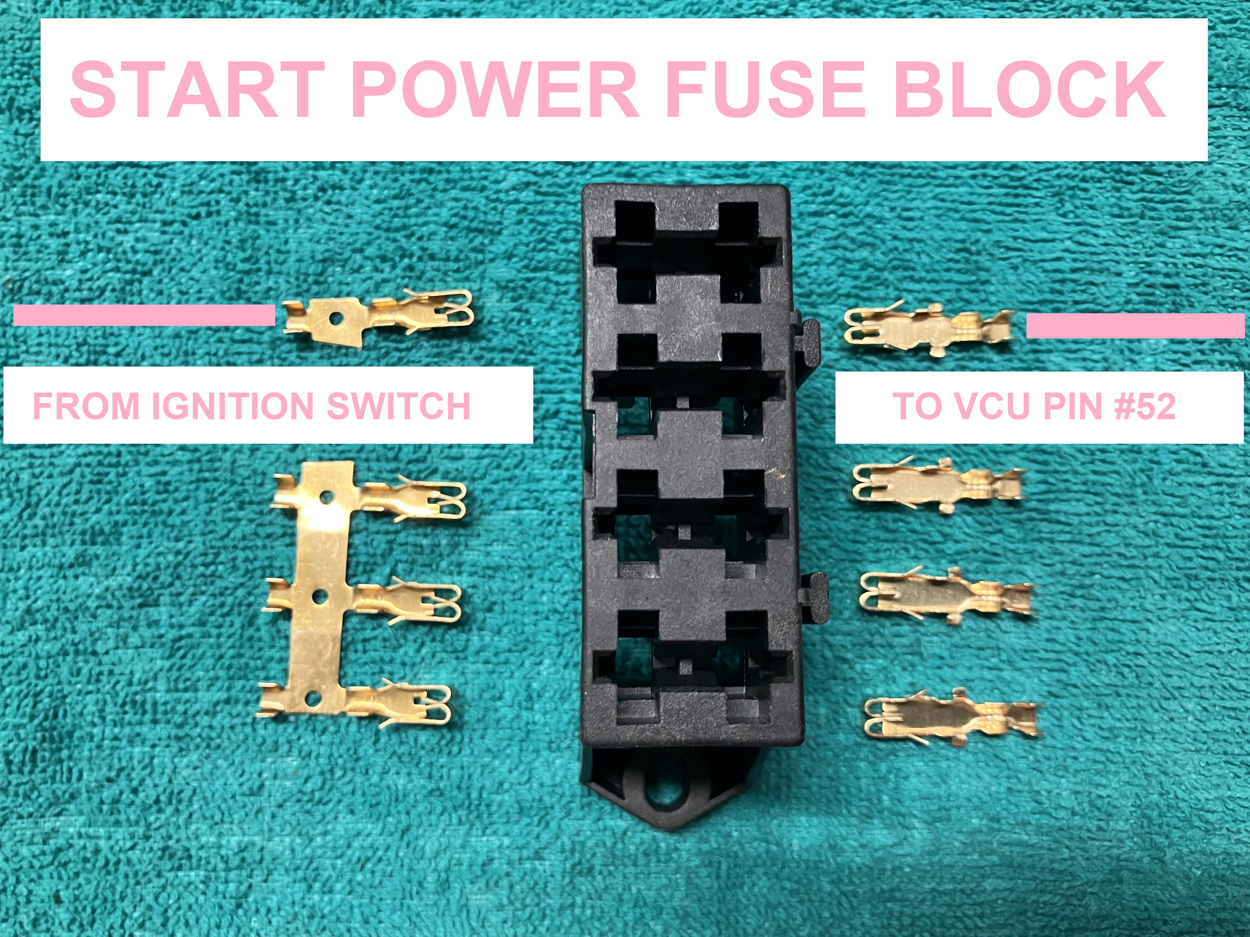

84 VW MK1 Rabbit DIY Wire Harness 4 - Start Power Fuse Block
The guy who invented the ZombieVerter tells us about Pin #52

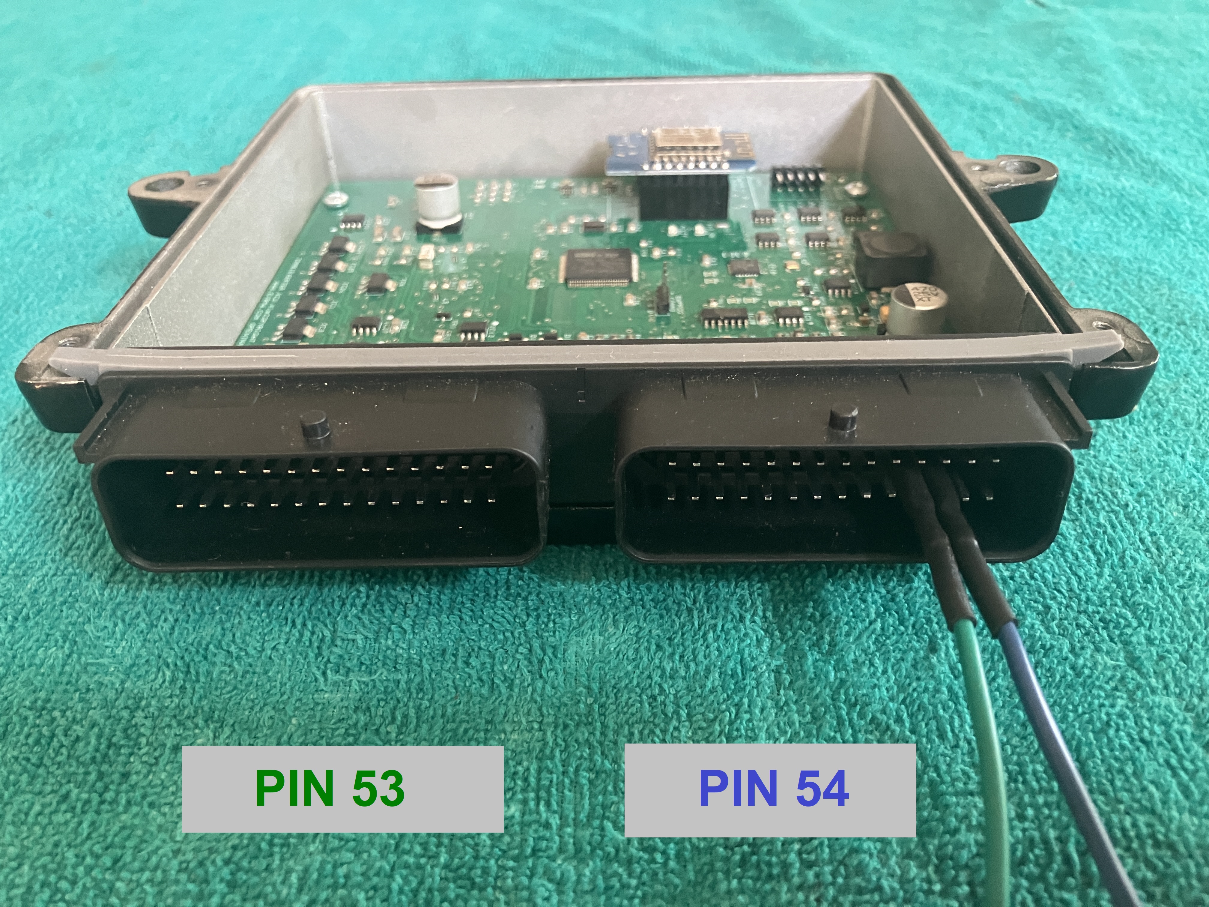

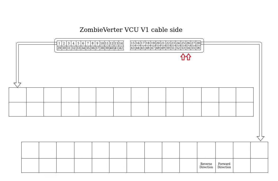

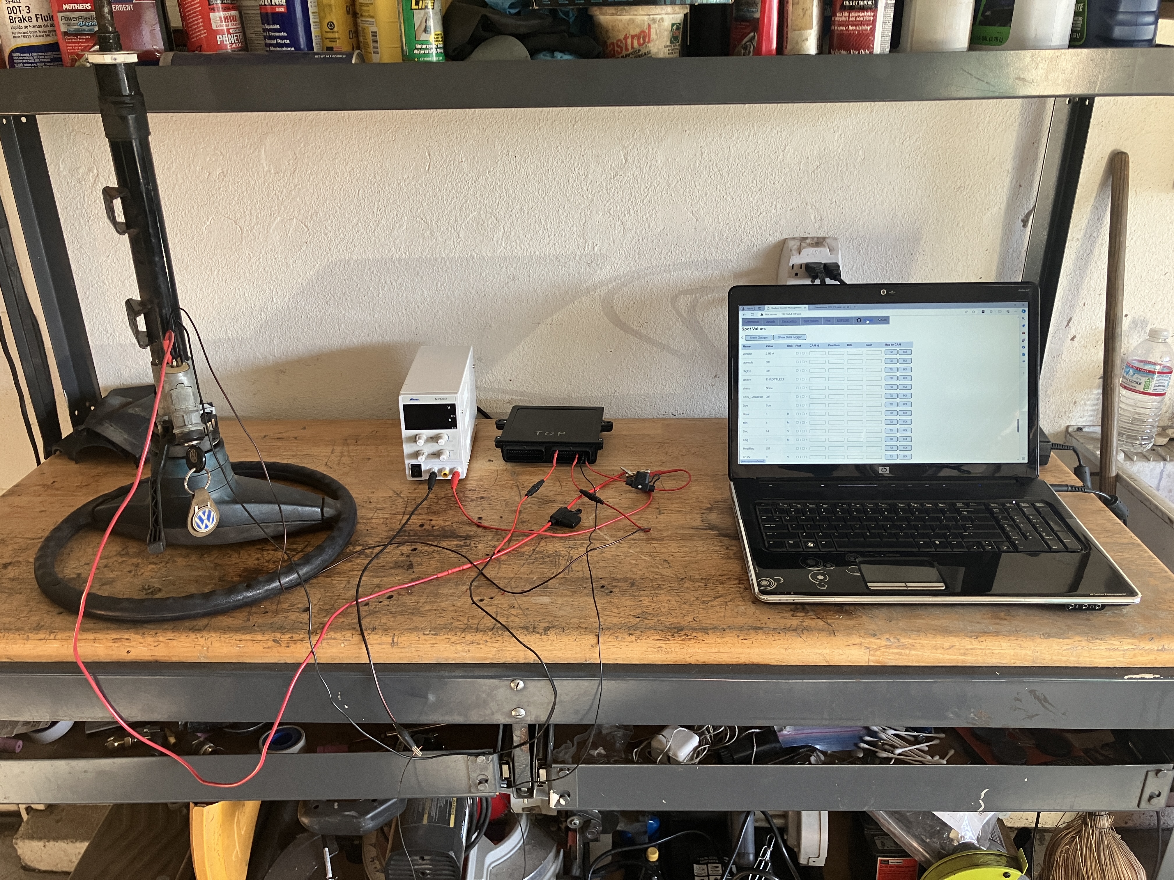

ZombieVerter VCU Forward & Reverse
These two pins are used to set Direction
- Pin 53 - Reverse
- Pin 54 - Forward
- Gregski
- Posts: 3170

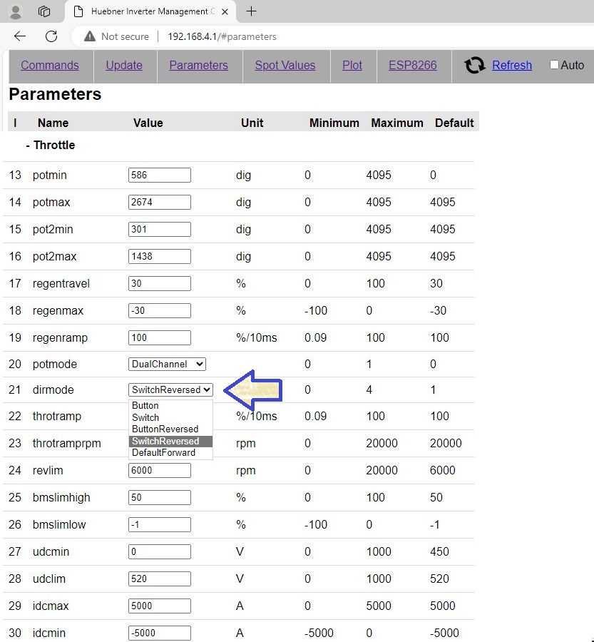

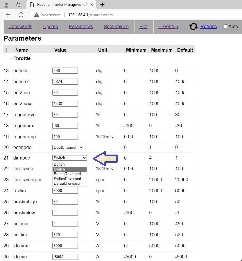

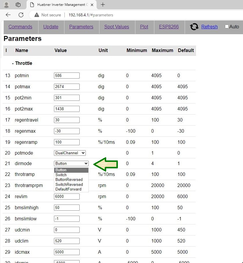

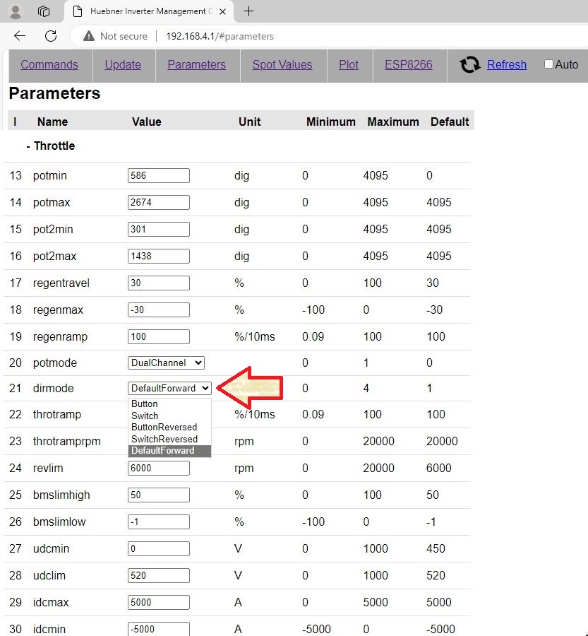

just want to share some screen shots with those who are still waiting on their Zombies to arrive
we find the dirmode [direction mode] under the Parameters aka "Settings" section in the Open Inverter web interface for the ZombieVerter VCU accessible via WiFi
Button is our first choice. This option is designed for one or two momentary press buttons to put your car in either Drive aka Forward direction or Reverse. The way this works is you press a button and you are in that mode until you press the other button
- Gregski
- Posts: 3170
Switch is our second choice.
- Gregski
- Posts: 3170

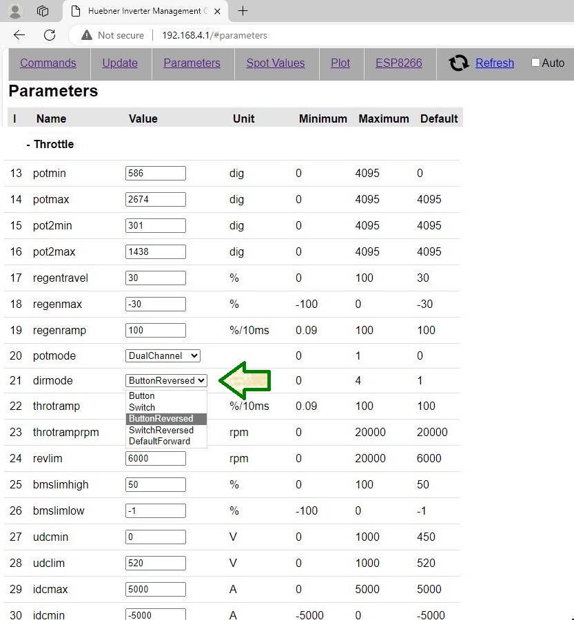

ButtonReversed is our third choice. You would use this if say you took a rear motor from an OEM vehicle and flipped it to install it in the front of your new vehicle. The default forward direction would now spin your wheels backwards, so ButtonReversed takes care of this situation.
- Gregski
- Posts: 3170
SwitchReversed is our fourth choice. You would use this if say you took a rear motor from an OEM vehicle and flipped it to install it in the front of your new vehicle. The default forward direction would now spin your wheels backwards, so SwitchReversed takes care of this situation.
- Gregski
- Posts: 3170
DefaultForward is our fifth choice. This setting tells the VCU that as soon as we turn the key to the Run position we are ready to Drive, without any signals, buttons, switches going to Pin 53. This may be all you need for the Lexus GS450h rear wheel drive transmission as it has a traditional internal reverse gear inside the transmission so you just use the floor shifter to manually put it in Reverse. The motor still spins forward but it is the counter gear mated with the reverse gear that makes the car go backwards. So no wire on pin 54 needed to go in Reverse.

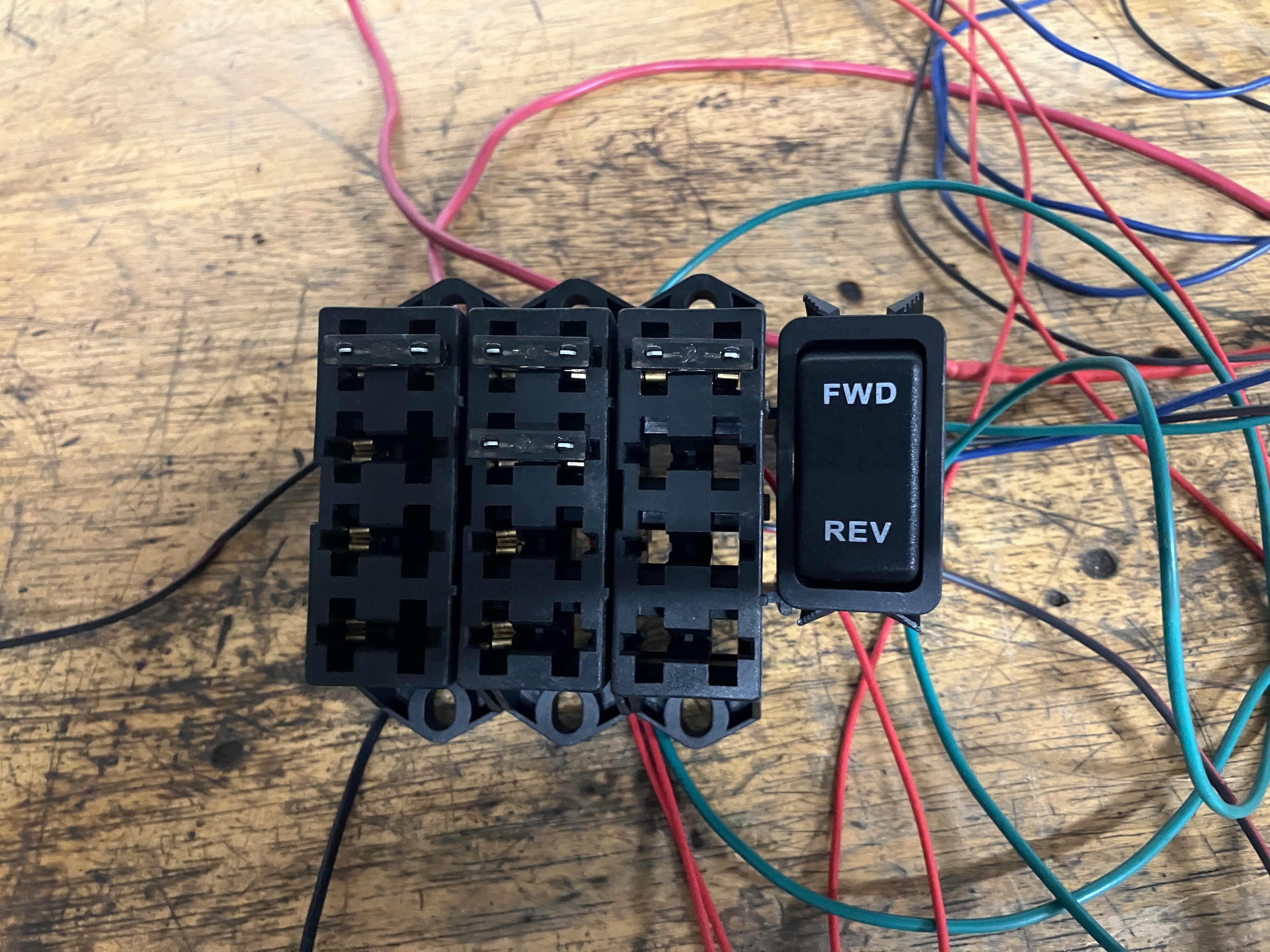

- Gregski
- Posts: 3170

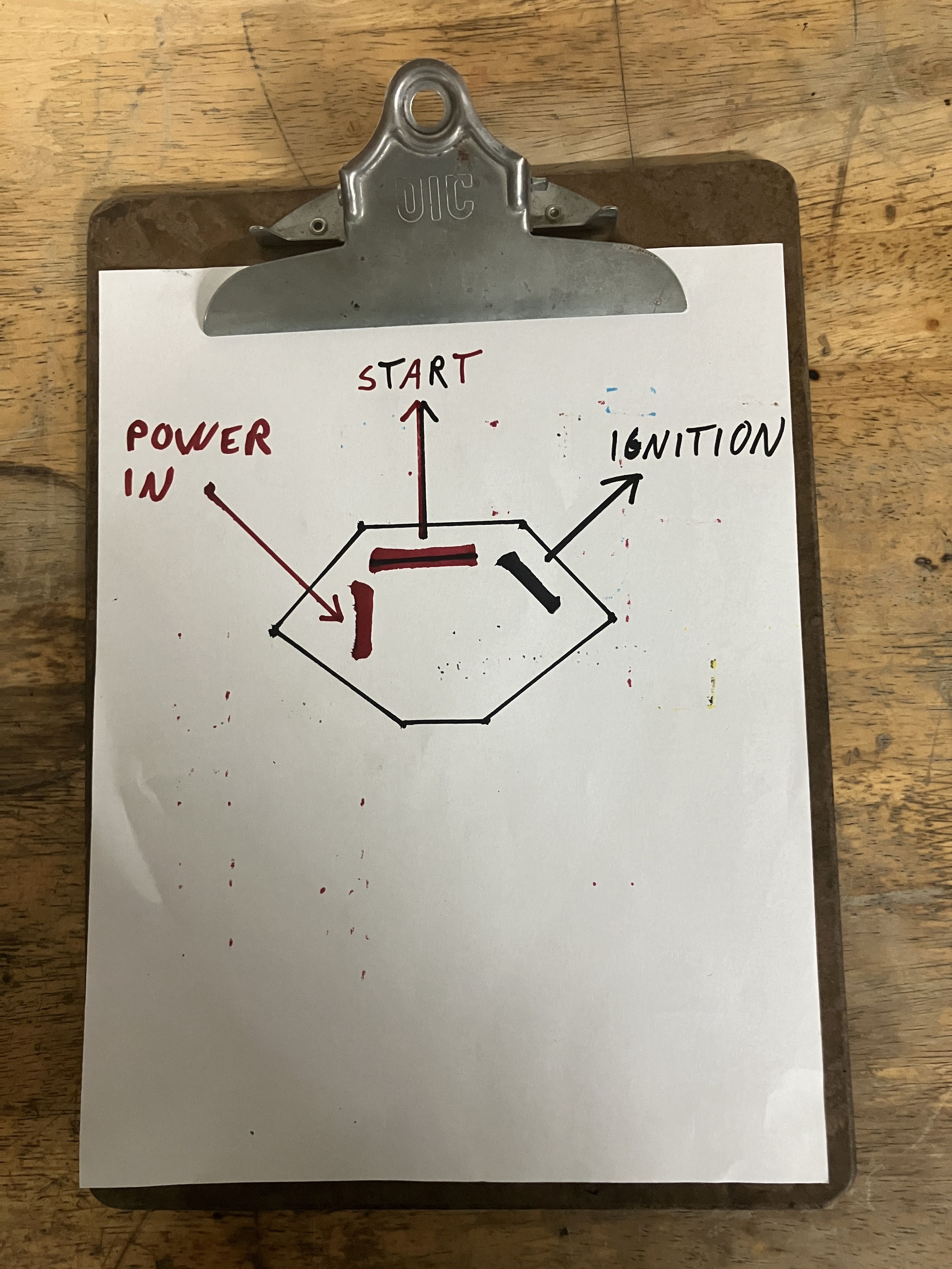

84 VW MK1 Rabbit DIY Wire Harness Forward & Reverse Switch
these are the two pins needed for the Forward and Reverse Switch, but there are many ways to skin this cat
the switch is hugging the fuse block just for the photo opp, that's not where it will be permanently mounted

I presume you know this, but the reason the pins on a switch are counterintuitive, is because the switch has a pivot in the middle. Like a teeter totter, when one side of the lever goes up, the other side goes down. So the back end of the lever that actually does the switching, points to the opposite side of the enclosure and connects those contacts.

- Gregski
- Posts: 3170
MattsAwesomeStuff wrote: ↑Thu May 02, 2024 10:03 pm I presume you know this, but the reason the pins on a switch are counterintuitive, is because the switch has a pivot in the middle. Like a teeter totter, when one side of the lever goes up, the other side goes down. So the back end of the lever that actually does the switching, points to the opposite side of the enclosure and connects those contacts.
Speaking of switches...
What a dreadful naming convention from Damien. "Button" vs "Switch". They're both switches, one is momentary the other is latching. But I have button-style switches that latch (like clicking in the end of a pen, say, like, the power button switch on most cheap tabletop computer speakers), and I have momentary toggle switches that don't latch.
thank you Matt I can say with 97.2% confidence that half the time I have no idea what's the Difference between button and switch
Many switches masquerade as buttons, and vice-versa. This is fine, when appropriate, and a matter of design choice.
A starter button in a car, for example, is a switch masquerading as a button.
The button that closes an elevator door is a button. The buttons that select floors, on the other hand, are smart switches.
