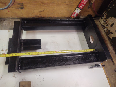

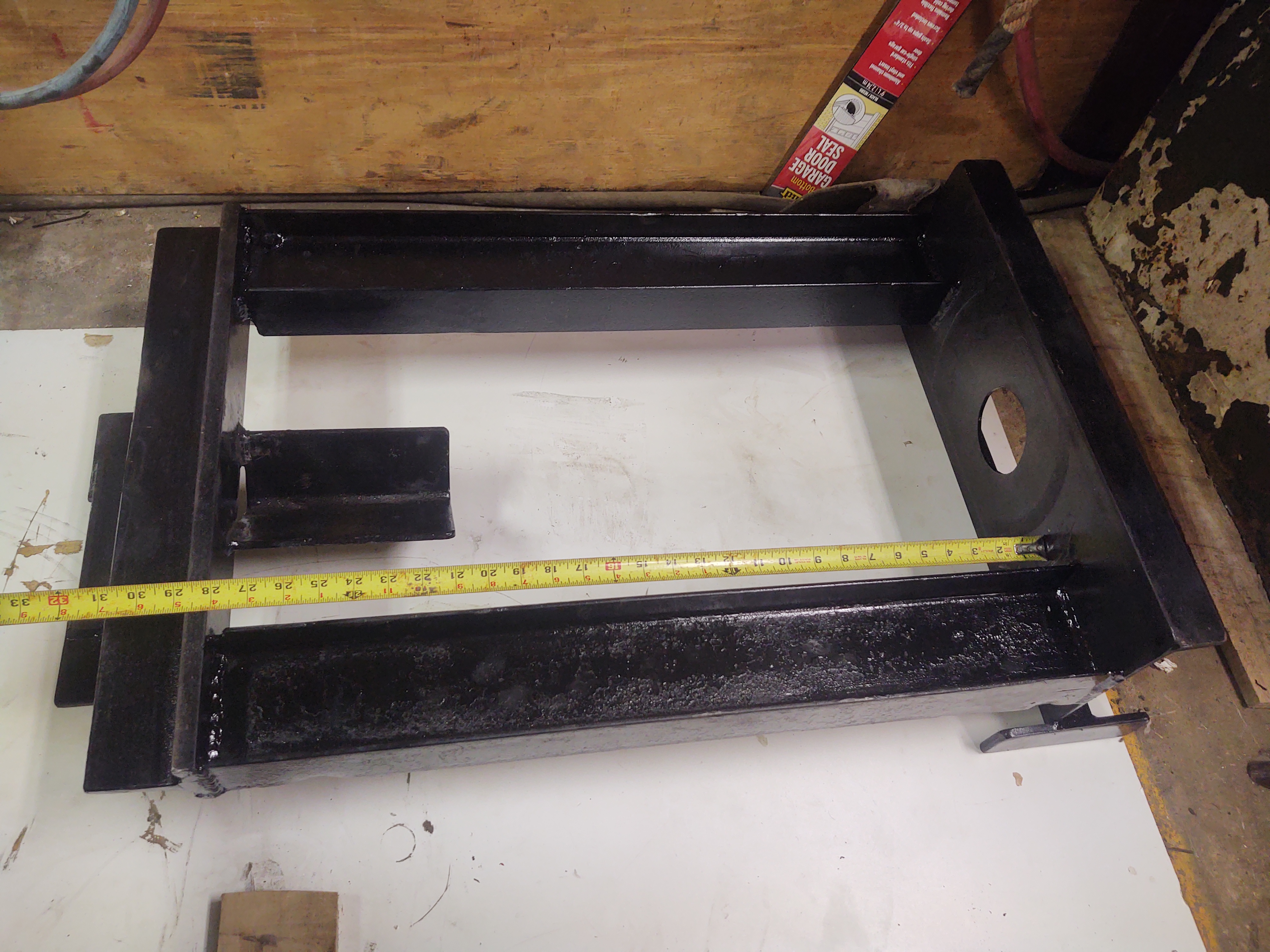

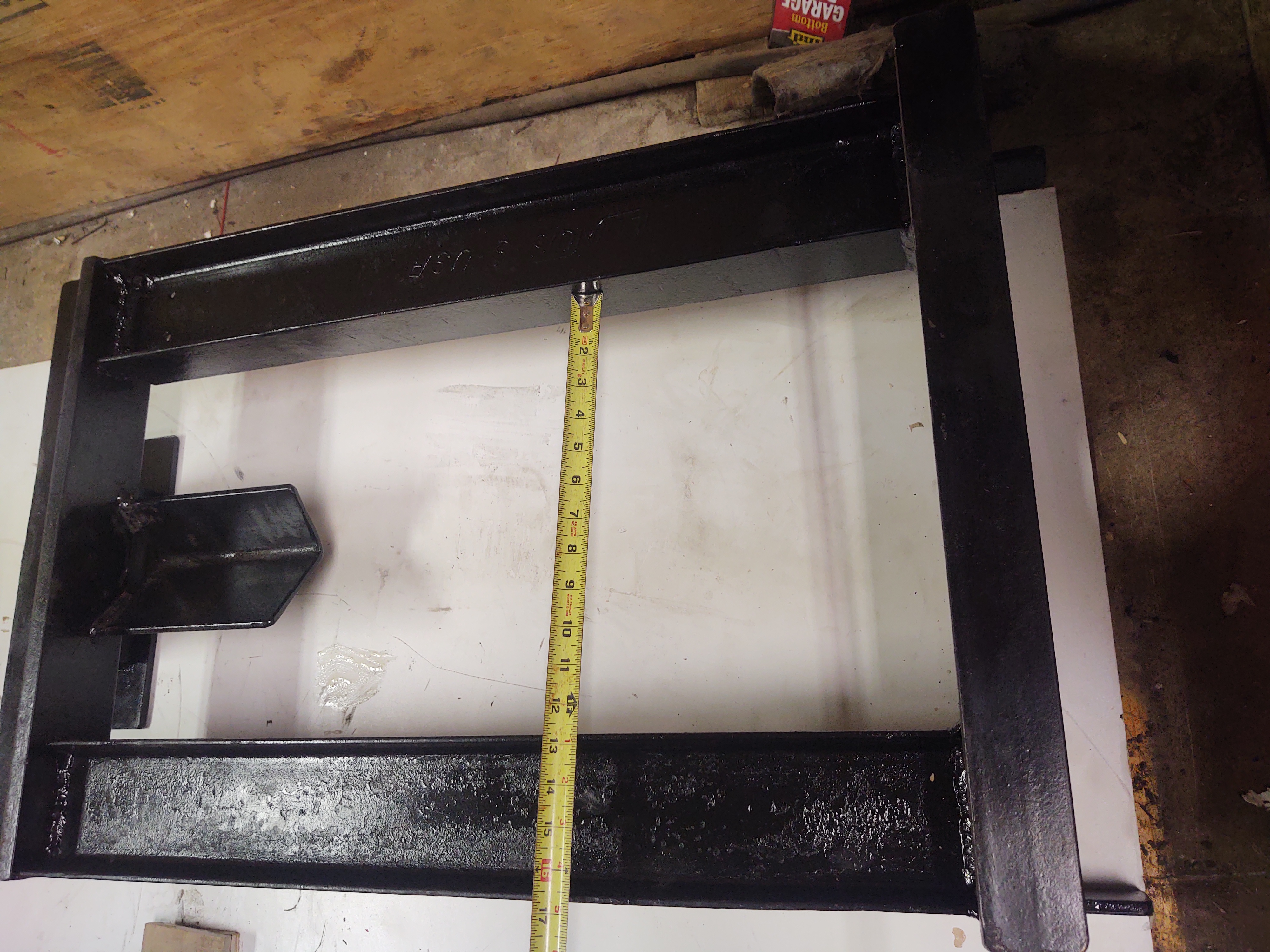

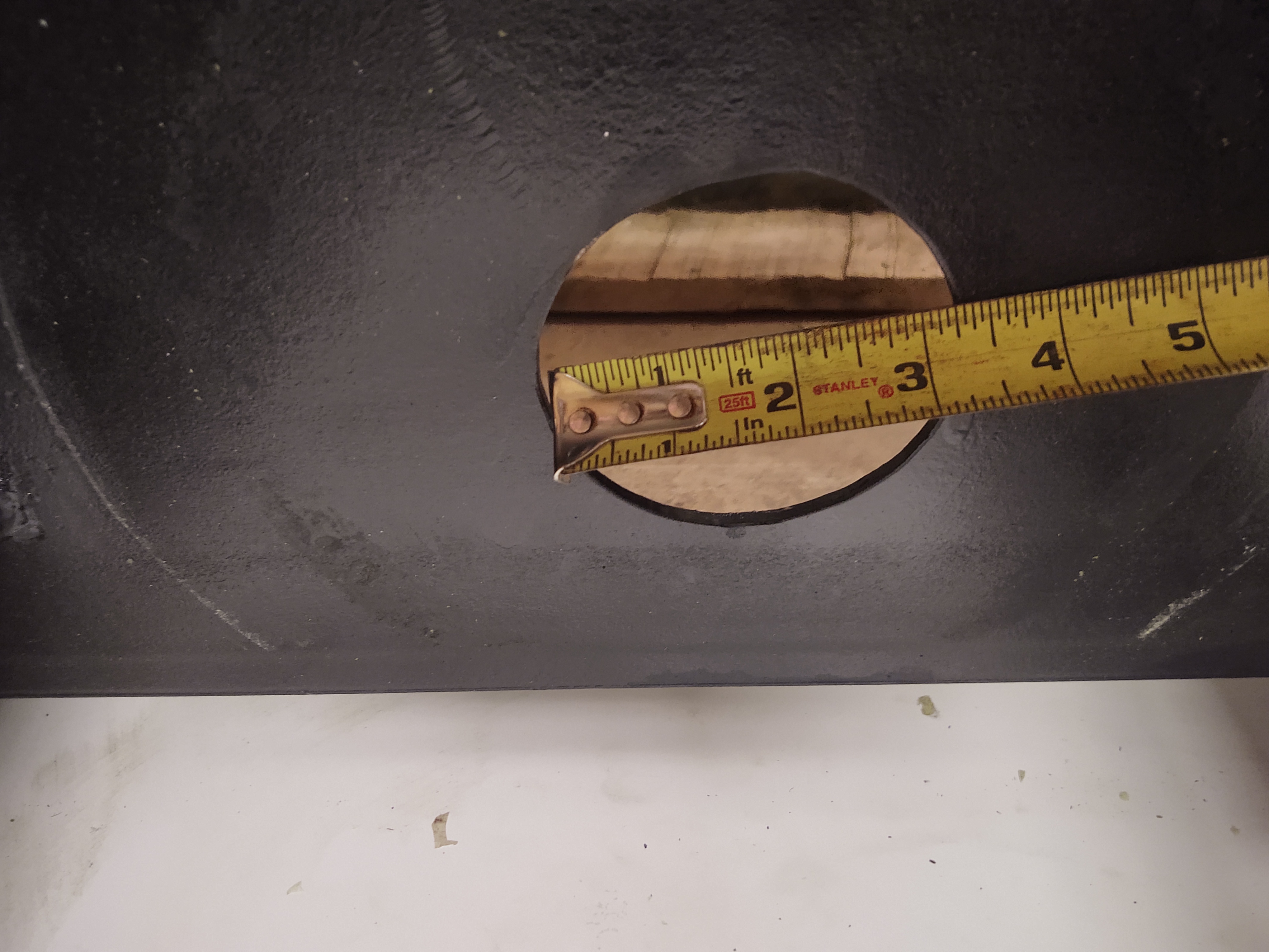

If anyone is interested here are the dimensions of my home made from scrap iron press to remove the rotor from the case. Inside dimensions: width = 12.75", length = 28", hole for rotor shaft and bearing = 3.25", height of bottle jack cradle = 2.25", length of cradle =7". This press was designed to be used horizontally on the floor or a bench. The LDU must be turned so the gearbox faces up. Shims can be added to the case end to prevent the windings from contacting the face of the press. The height of the bottle jack centerline is matched to the 5.5" centerline of the rotor splined shaft. Your jack height may vary depending on what jack you use. It takes very little force from the press compared to a hammer to remove the rotor and it is much more controlled. I have not yet tested the press to remove the inner rotor ceramic bearing but I suspect it will be just as useful once the pinion shaft is removed.
2012 P85, 2013 85, 2013 85 parts car.

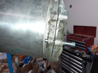

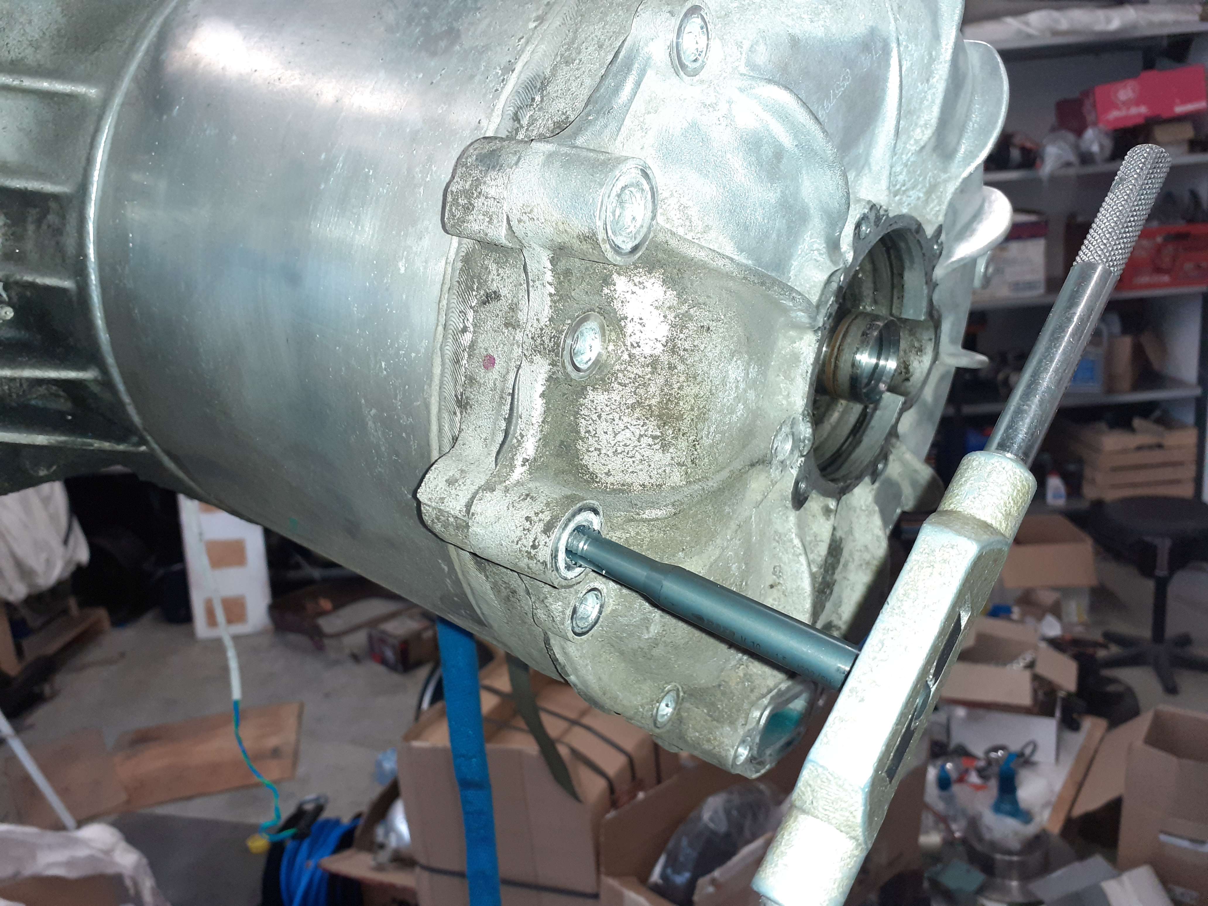

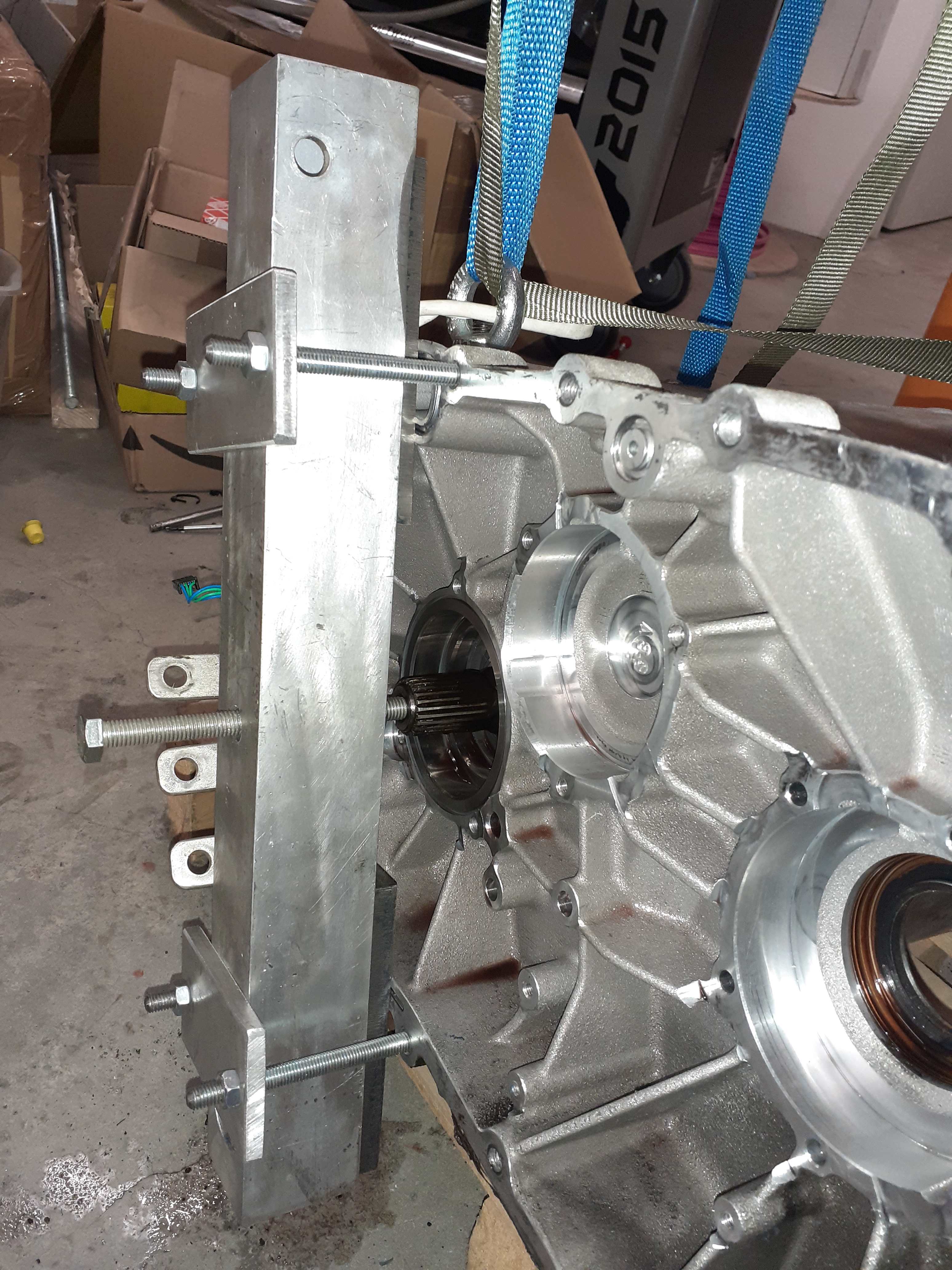

Disassembly Notes:
I cut an M10 thread into the through hole and screw in a screw. Then I press from the opposite side with an M8 screw. For blind holes I use self-made push-out screws. Also works with the case halves. The last picture shows how I push the rotor out. No hammer needed and won't destroy paint on nicely made engines.
jrbe
- Posts: 766
- Has thanked: 365 times
- Been thanked: 249 times

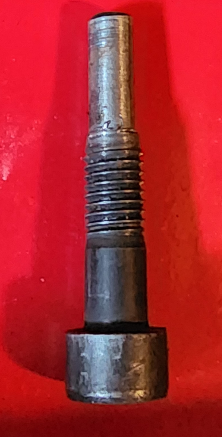

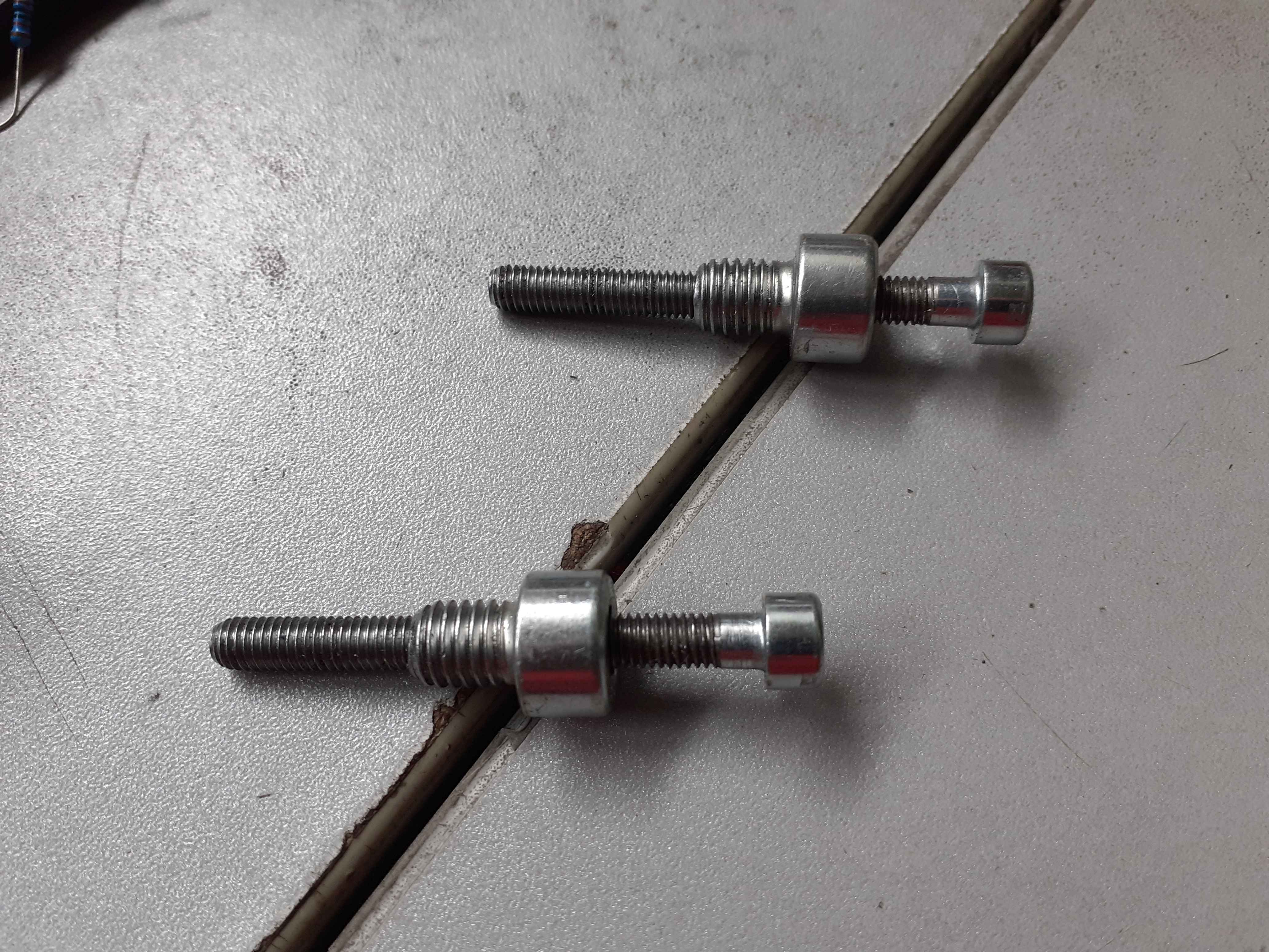

Are the self-made push out screws dog pointed bolts or the threaded collar ones you showed?muehlpower wrote: ↑Sat Jul 29, 2023 8:44 am Disassembly Notes:
Could also probably be made like this but likely stepped down more than this image shows.. That's an old Audi I5 timing belt idler "puller".
It's too bad Tesla didn't do this from the factory. Nice solution muehlpower!

I use Allen screws DIN 912. With your one-piece design, the depth of the blind hole is important, with the two-piece design, the large screw can be screwed in completely and the small screw can be adjusted or simply be very long.

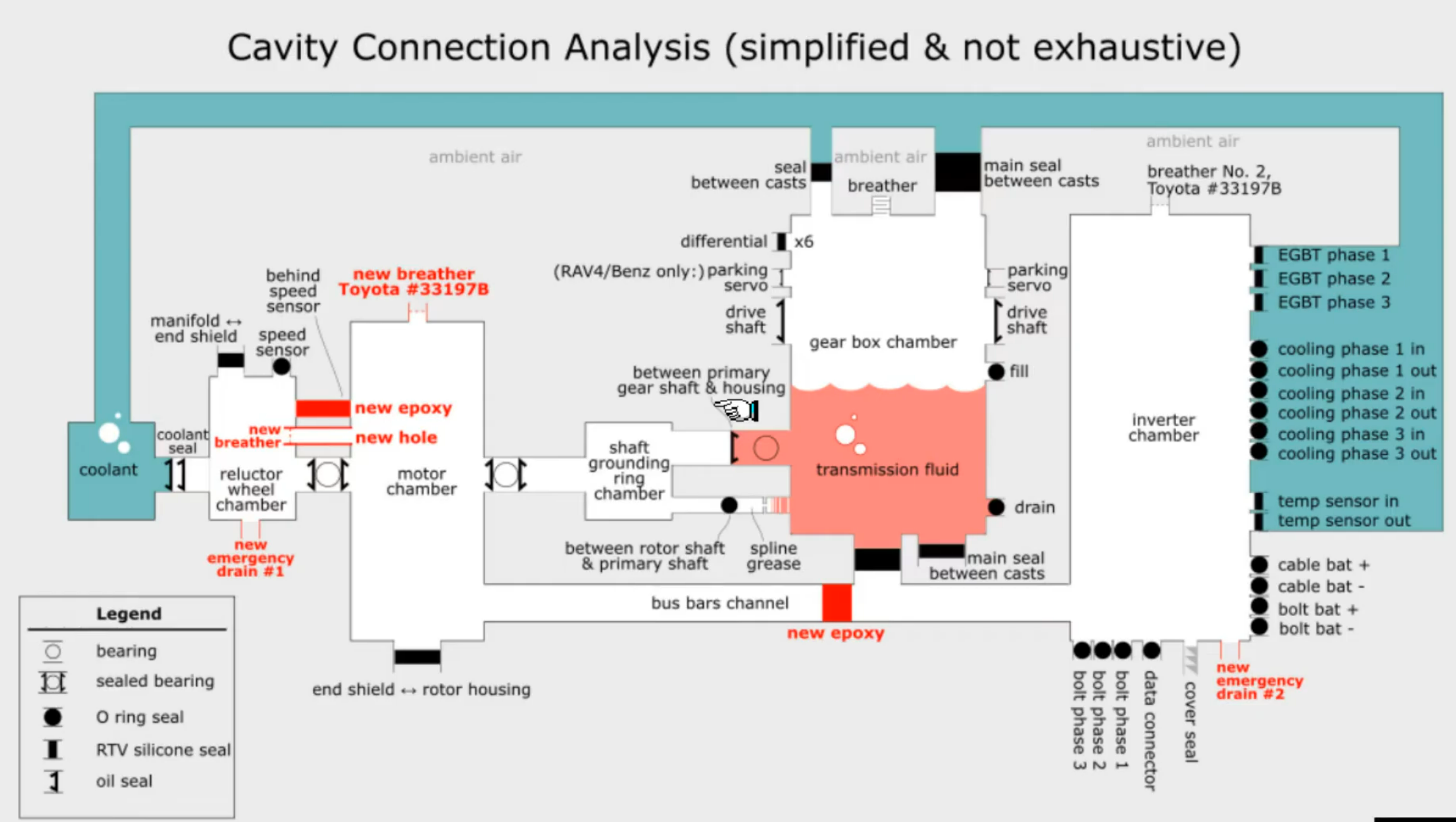

Heat signature inside coolant tube where Seal rides on the outside.
There is heat signature inside of the coolant shaft where the PTFE seal rides. All of these shaft will show a whitish coating inside the hallow shaft. There is a band inside where PTFE seal rides on the outside. Don't think its so much heat the steel blued. Rather, probably just heat so the whitish coating doesn't form. Note the rust has been mostly cleaned off in the pic.
Found a pic from the prior rebuild 3k miles ago. Didn't focus in on this area but also appears to have a heat signature although maybe less prominent? (leaking single lip PTFE seal) Note the pic was to illustrate re-greasing the ceramic bearings so shown with the bearing seal removed.
Leak will enter stator even with coolant manifold drain
My outer ceramic bearing was stuck to the end plate. The rusty liquid leaking from the multi-lipped seal chamber got behind the o-ring in the bearing bore (at the lowest spot) rusting the bearing in place. At this point there is no blockage to the stator.
Also found tiny bit of coolant residue on lowest spot on inverter + casing. I thought I had cleaned it pretty well on rebuild 3k miles ago. While it was impossible to clean off all the corrosion marks on the casing. I likely would have cleaned the inverter controller connection pretty well. Just more residue than I was expecting. Perhaps the stator still had moisture from prior leak when assembled on prior rebuild. Maybe latest rusty shaft coolant seal leak is the contributor. Don't really know. It isn't very much corrosion but tiny bit. I didn't put epoxy to seal off bus bar tunnel on prior rebuild.

Did you use a vacuum to fill the system? I wonder if there's a bunch of air pockets in these areas.
For the the added drain hole, is there a way for air to enter above a leak to avoid vacuum holding any leaked coolant in there?IMG_2802.jpg
Also, the drain hole should be large enough in ID to avoid meaningful capillary action - holding the liquid in.

Drain hole
This is on the dry side and has probably 2+mm ID with a clear drain line and see rusty residue in it. So pretty sure its draining. However, it appears the likely thicker rusty liquid doesn't drain as easily
- All around the reluctor chamber as it spun the rusty liquid all around.
- bottom of speed sensor chamber
- bottom of outer ceramic bearing race on the stator side of the o-ring
- In between the coolant seal of course
On the question if any air can enter above leak. It would have to go through the seal. I suppose air is even thinner than coolant and since we tapped a drain port, ambient air pressure will enter the reluctor chamber (I didn't seal the end of drain line, maybe should have? This is probably source of O2 as @asavage was wondering where it came from). If any vacuum pressure exist on the wet side (when coolant is cooled?), seems like air can get pulled in.
Another reference point is @dzolotnyuk ( post link viewtopic.php?p=46191#p46191 ) effort. He didn't RTV the manifold (pulled it many times, reasoned with drain port, no use sealing it. @Johan did suggest helpful in case of flooding) He is on speedi-sleeve + SKF FKM seal (HMSA10 V - single coolant V shaped lip, excluder lip sized to not touch speedi-sleeve) and hasn't reported any problems in the 1 year since rebuild. So even O2 entering reluctor chamber likely not an issue for single lipped seals (I don't count excluder lip that has air gap to shaft surface a sealing lip)

That's what's really nice about using vacuum on a coolant system to fill it. All the air is gone, you can check for leaks before filling it. Then if it doesn't leak air in while in vacuum, it uses the vacuum in the system to suck the coolant in and leaves no trapped air. As long as there's a single path through the coolant it will get where it needs to be.(vacuum coolant system before fill)
Didn't do this because Tesla's multi pump + valve design makes it a mystery on how to bleed the coolant system without their security locked diag tool.
There is a danger of the vacuum destroying something though (usually about to go anyways though.) I'm not sure if it's an issue to use on Teslas or not.
A few things here. A 2mm drain can cause capillary action that can hold a shallow puddle of coolant up. Also, where the drain hole is, it looks like the centering lip of the water manifold blocks a lot of the hole which could be more of a restriction, might kick off the start of the puddle.Drain hole
This is on the dry side and has probably 2+mm ID with a clear drain line and see rusty residue in it. So pretty sure its draining. However, it appears the likely thicker rusty liquid doesn't drain as easily.
Might be worth doing an experiment with only the motor cover and coolant manifold bolted together with the drain assembly in place and oriented as it would be in the car. Add coolant where it should drain (dry side as you call it) and see how much you need to add until it dumps. I think the results will be surprising (more liquid than you'd expect.) This also isn't including vacuum in there that could further up the level until it dumps.
The air I asked about was to allow coolant to drain out. Meaning that trigger wheel void area is able to easily suck air in from above the coolant that you want to drain. If the water manifold is siliconed in, it likely can't get air in the dry side unless it shares a breather / passageway. The vacuum of the coolant trying to drain can also hold the coolant up further, especially with a small drain ID.On the question if any air can enter above leak. It would have to go through the seal. I suppose air is even thinner than coolant and since we tapped a drain port, ambient air pressure will enter the reluctor chamber (I didn't seal the end of drain line, maybe should have? This is probably should of O2 as @asavage was wondering where it came from). If any vacuum pressure exist on the wet side (when coolant is cooled?), seems like air can get pulled in.
The other trapped air was in the cooling system which could allow hot spots.
You want the drain line open or the leak can't escape.
The HMSA10 V (SKF) seal is a fluoro rubber and has a 3480 rpm rating (surprisingly low because of the large diameter / high surface speed.) There's likely some safety /wiggle room above that but it's well above is rated rpm here. It might work well for a while but I doubt it would do 80k+ or survive many high rpm cycles.

The assembly has a vent, though it's on the inverter side. Howard didn't seal (RTV or other compound) the inverter-to-stator passage, so the dry side has a path to the outside via the case vent, and no vacuum is formed in the area where the rotor shaft leaks.jrbe wrote: ↑Tue Aug 01, 2023 5:26 pm The air I asked about was to allow coolant to drain out. Meaning that trigger wheel void area is able to easily suck air in from above the coolant that you want to drain. If the water manifold is siliconed in, it likely can't get air in the dry side unless it shares a breather / passageway.
Johan did a great job of explaining the venting:
In any case, I'm guessing the reluctor chamber drain port is easily the best source of new oxygen.
