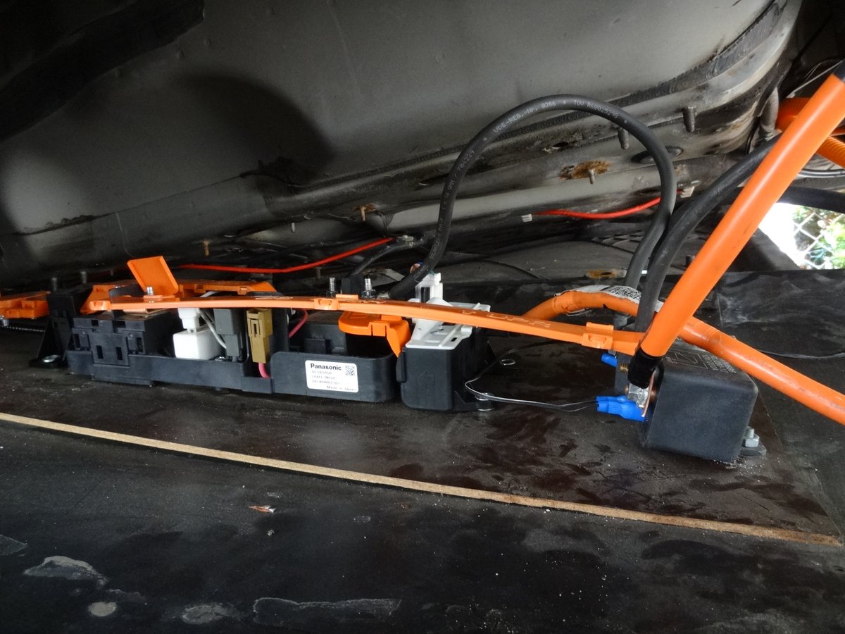

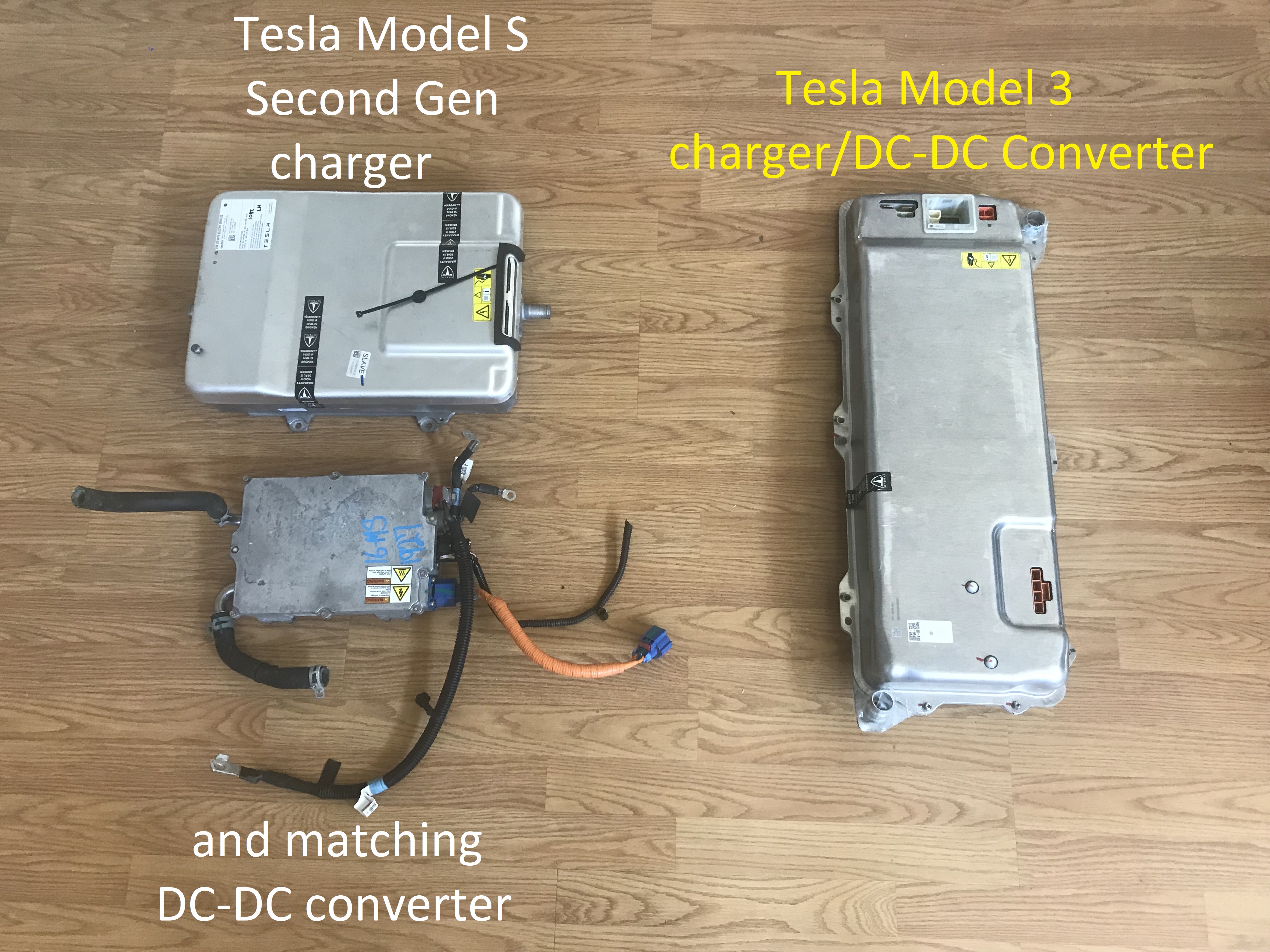

so is it going to be A or B as I have not decided on an onboard charger and or DC-DC converter yet?
on one hand I have modified the Tesla Model S Gen 2 charger already, wrote it up here I bought a Tesla Model S Gen 2 Charger - Now What? and even made a video for it that nobody watched:
on the other hand I have the All-In-One charger and converter combo, less wiring less space, which I know nothing about ... yet

Gregski wrote: Sat Apr 23, 2022 3:36 pm I am also entertaining shoving it under where the oil pan used to live there may be just enough of a cavity to bolt it up to the battery tray from underneath, for that German like impossible to get to to troubleshoot feel
Referring to that special somebody who put contactors in the exhaust tunnel? Mhh yes, wise decision. But I USED THE SPACE :D
Gregski wrote: Sat Apr 23, 2022 7:22 pm so is it going to be A or B as I have not decided on an onboard charger and or DC-DC converter yet?
A - proven and thus very boring
B - might not work if on the wrong OEM firmware - so very interesting! (Or have you test run it?)

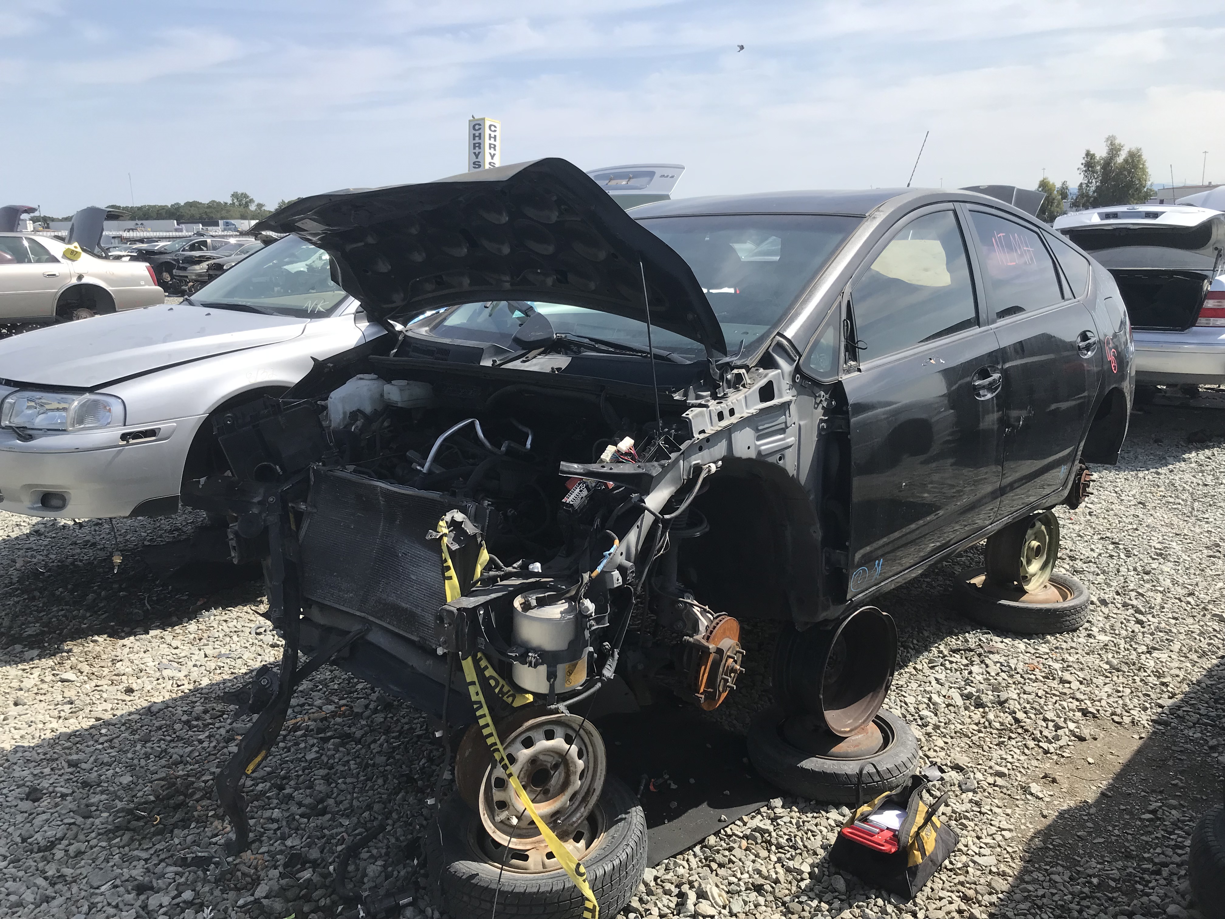

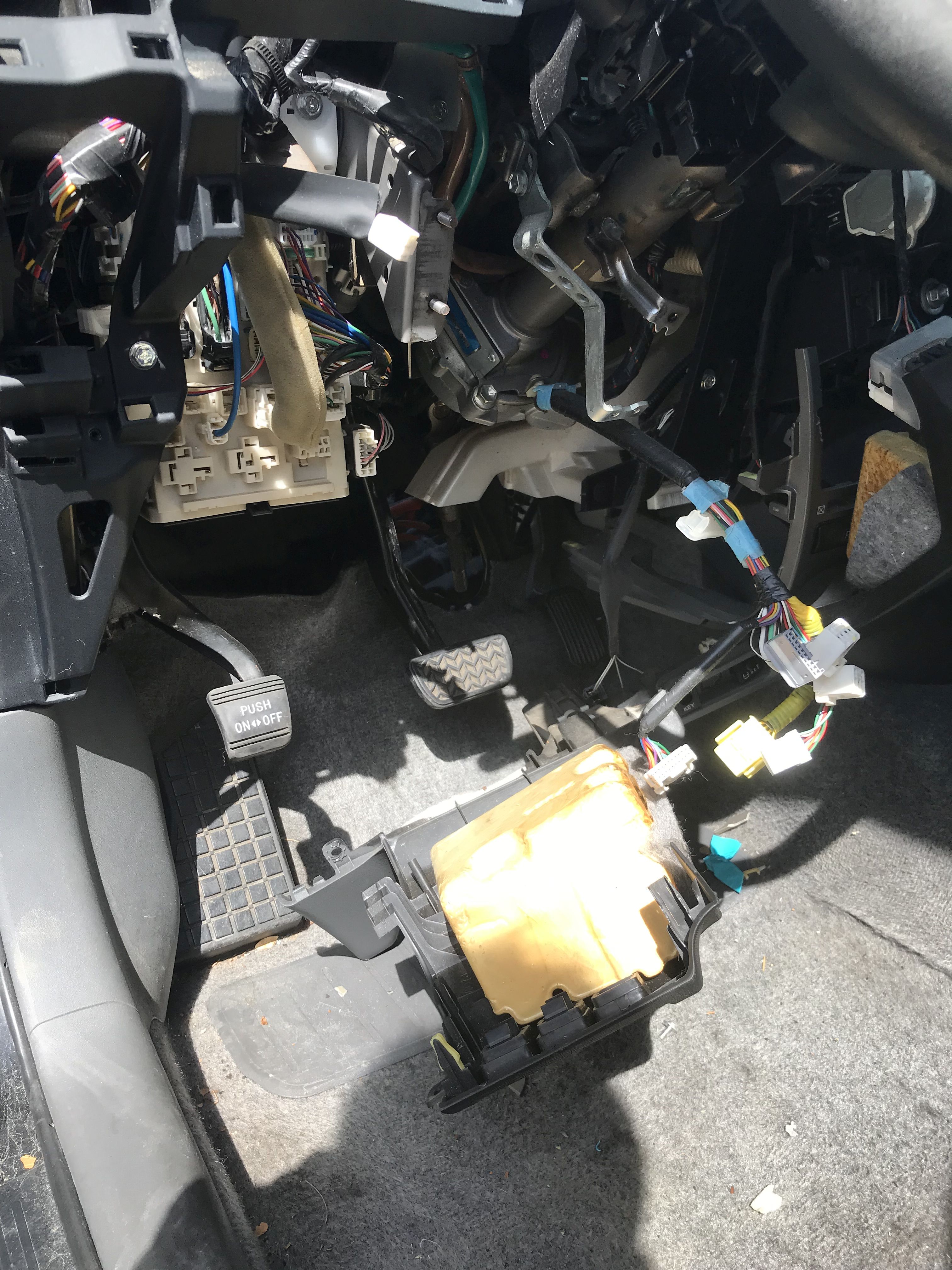

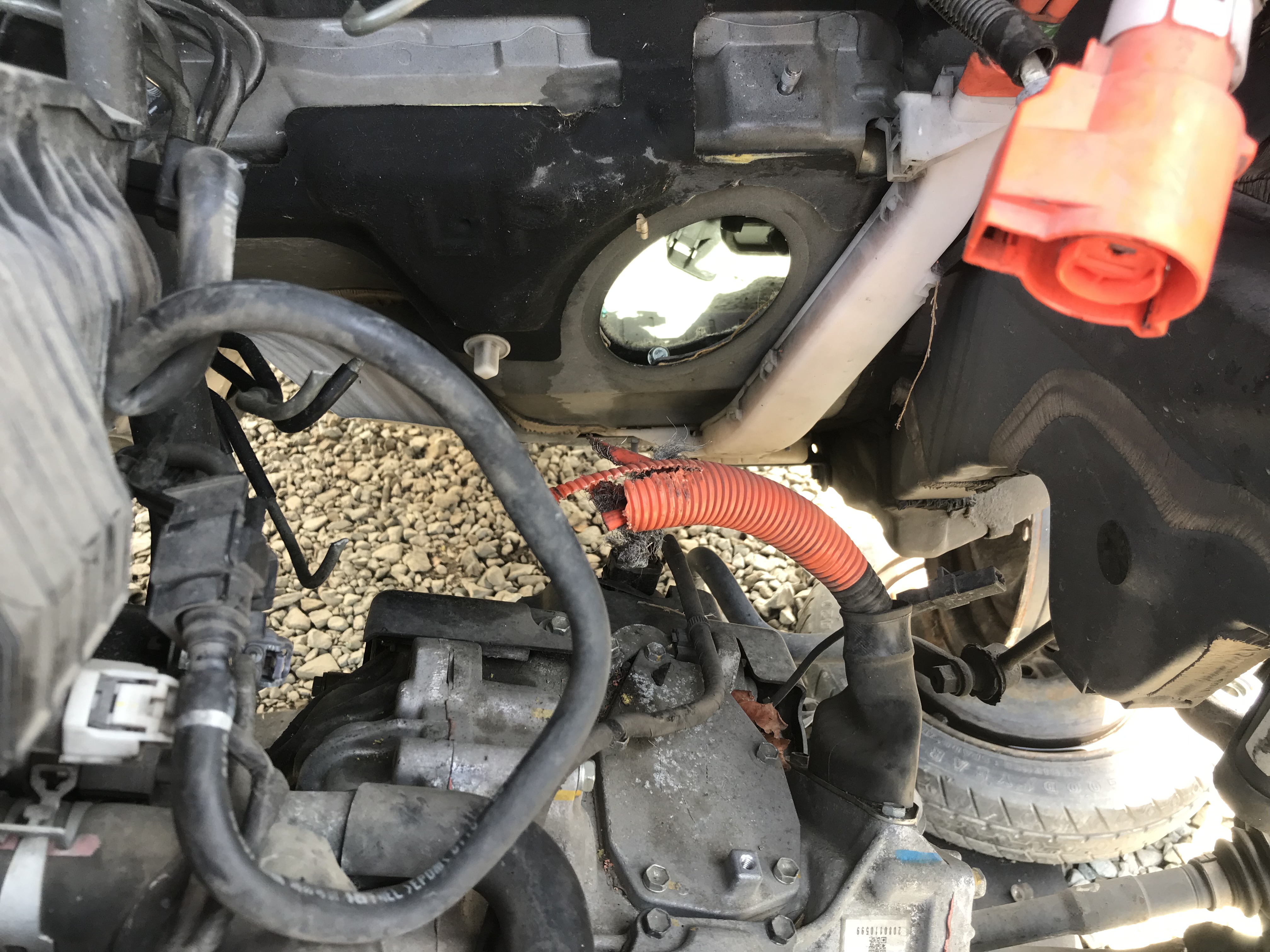

Fishing! why are we going fishing?

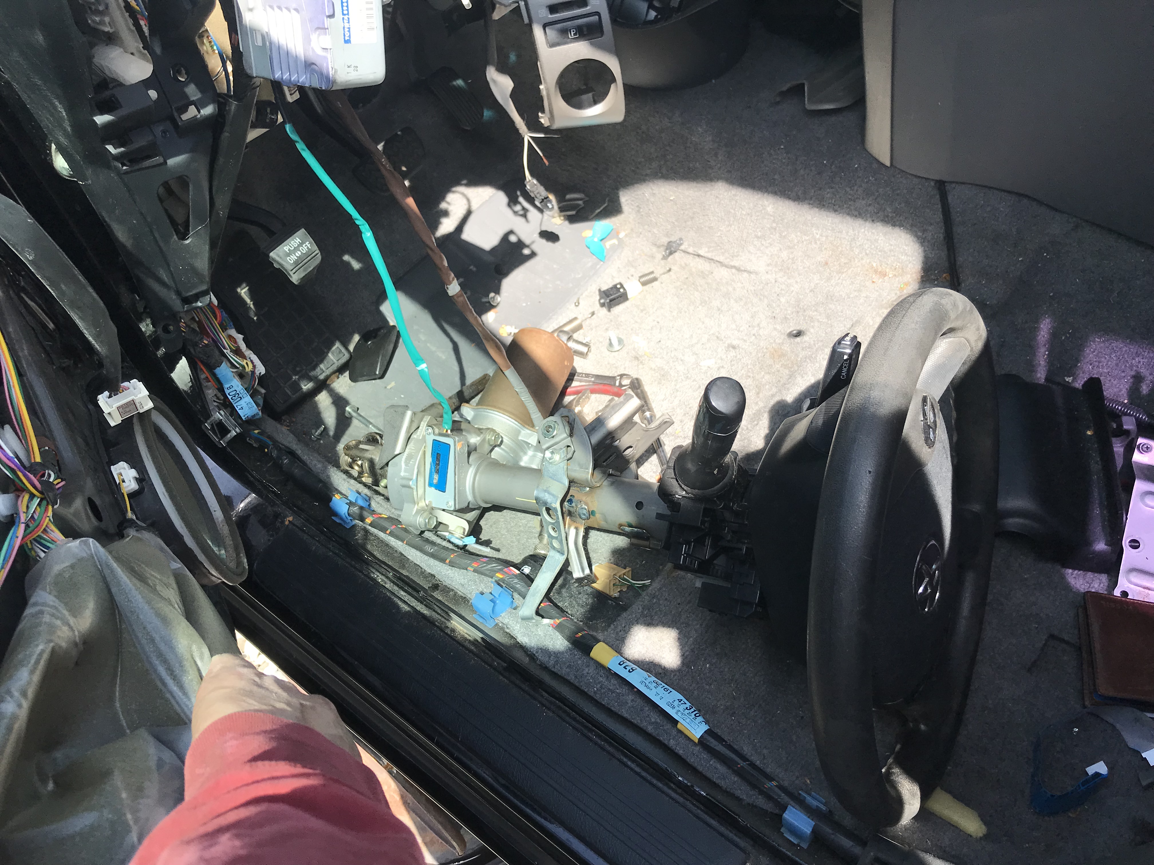

Second Gen 2008 Toyota Prius Electronic Power Steering EPS
one of the grounds
apologies for the bad lighting, my light crew had the weekend off
Gregski
Posts: 3164
Has thanked: 633 times
Been thanked: 1610 times

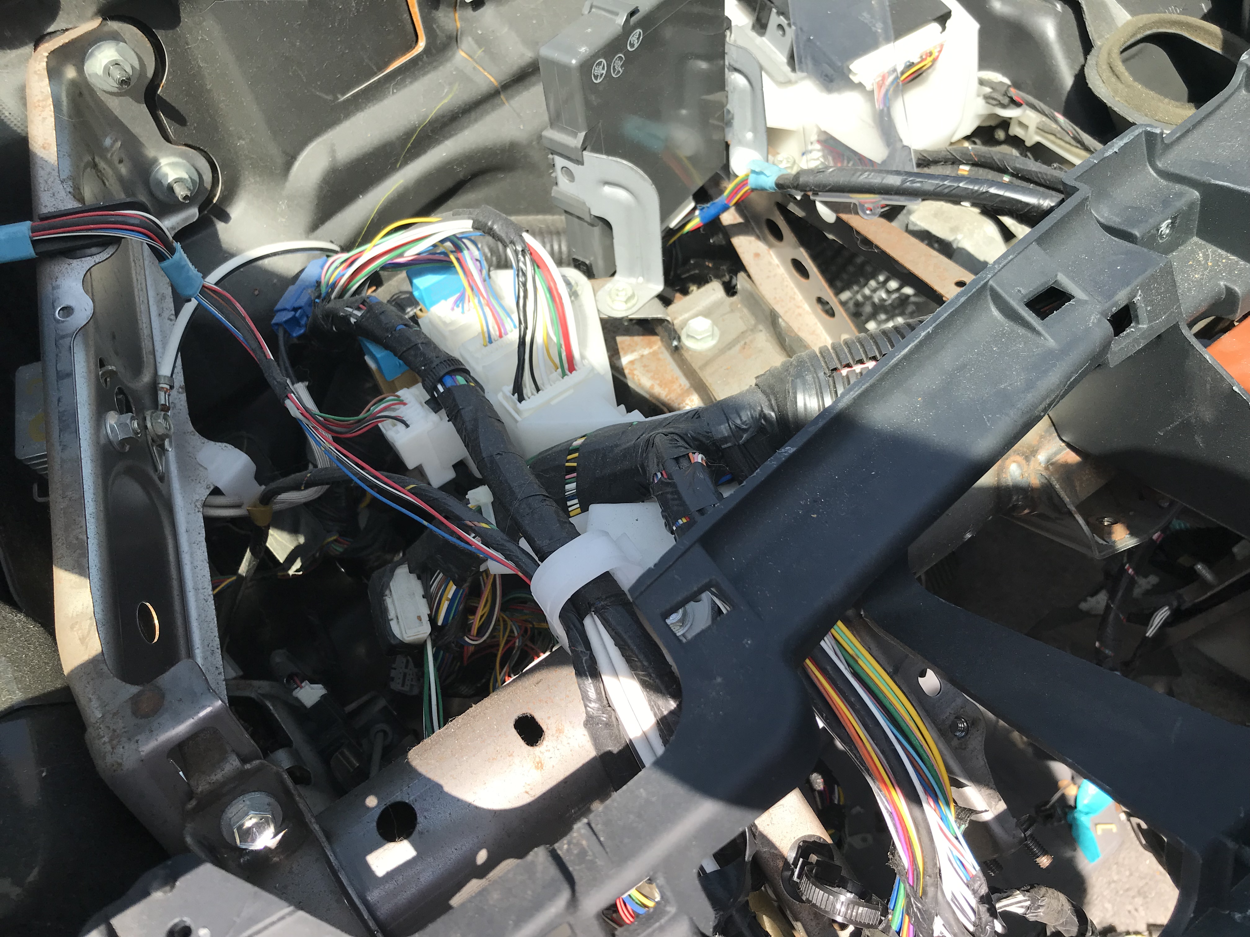

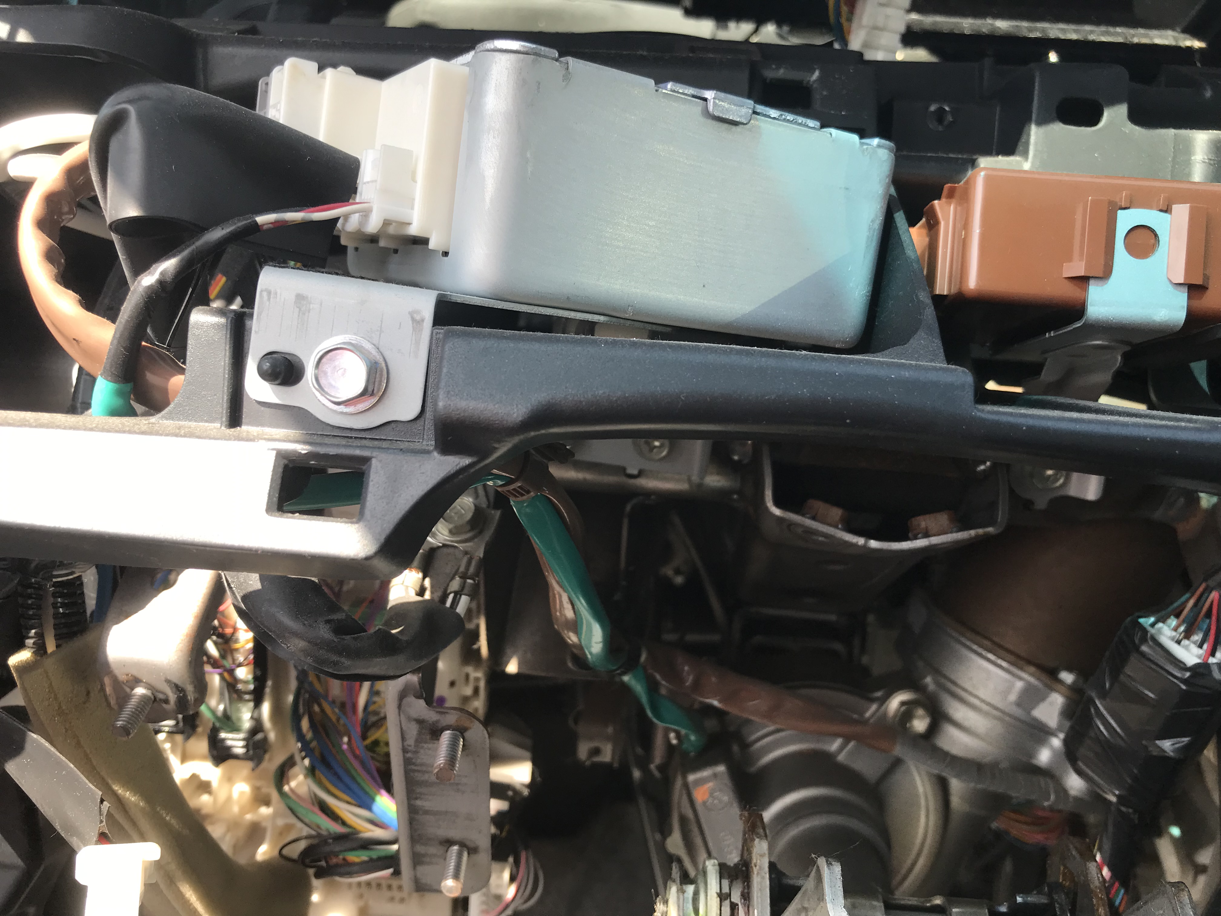

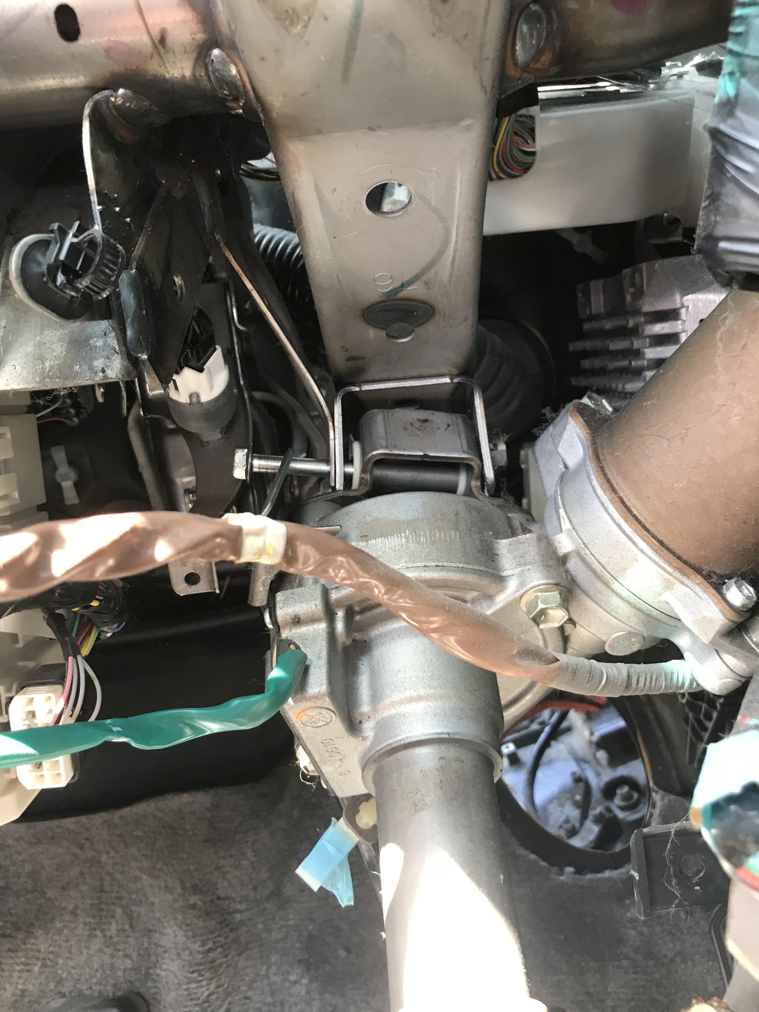

Post by Gregski »

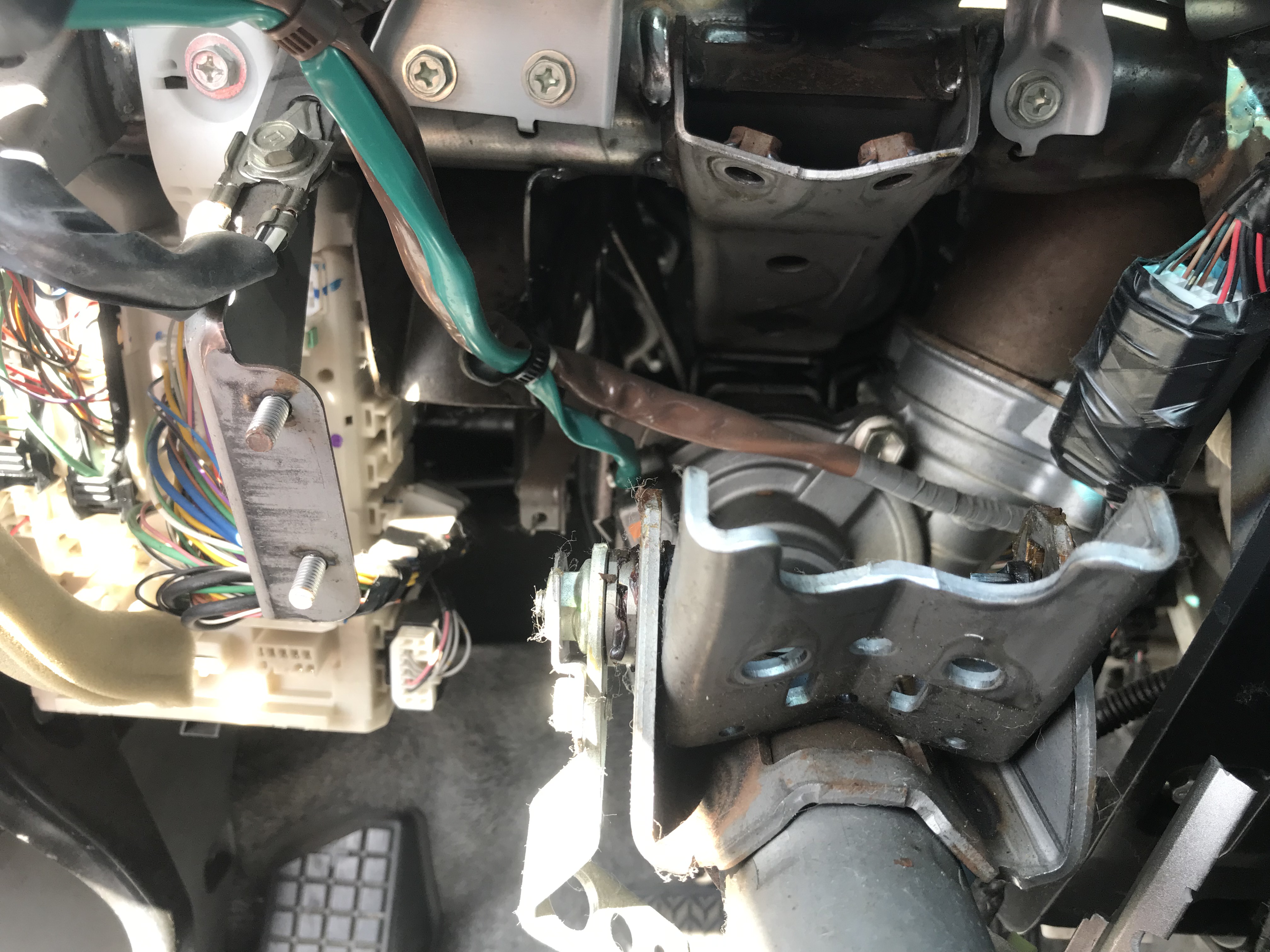

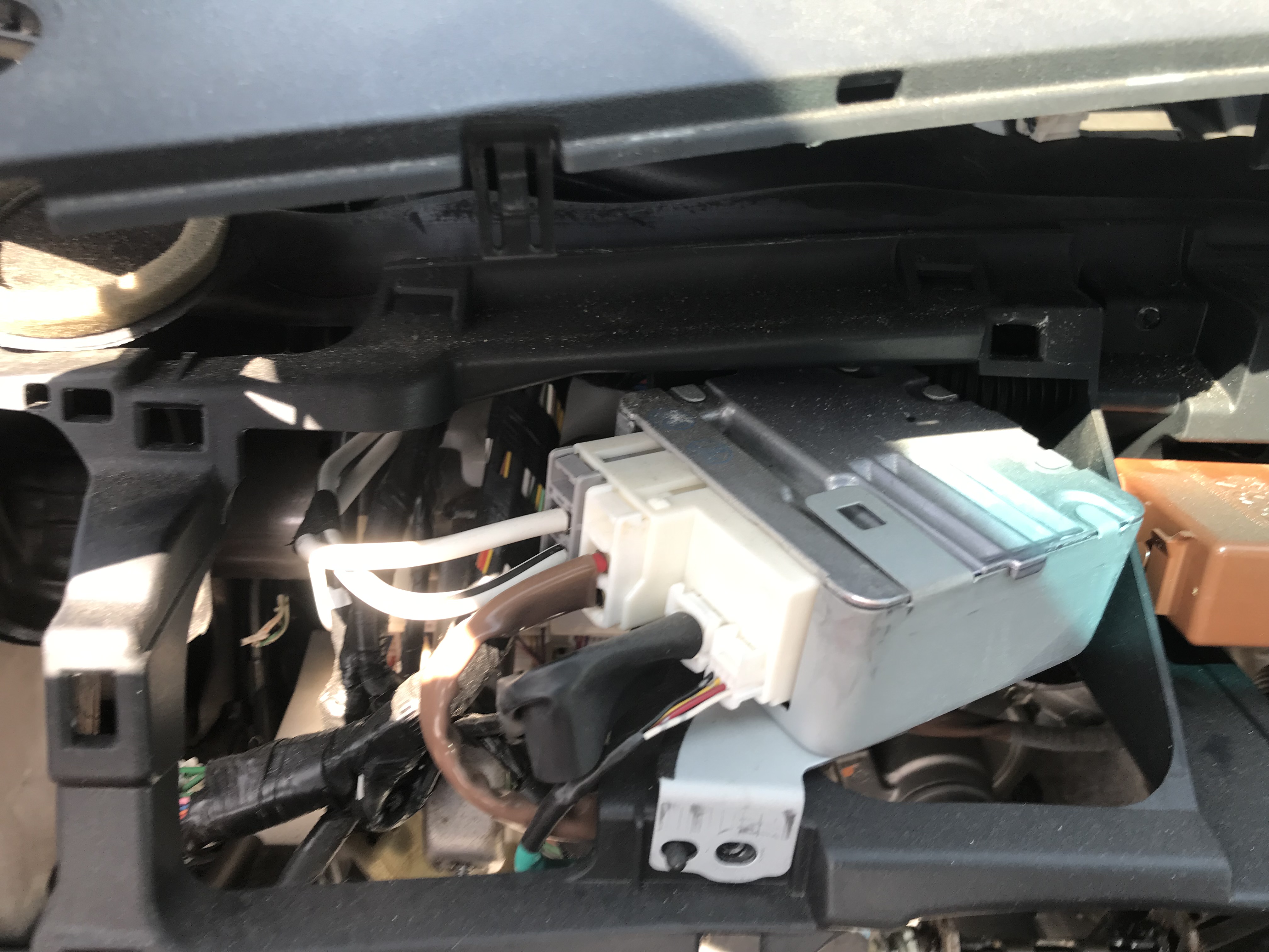

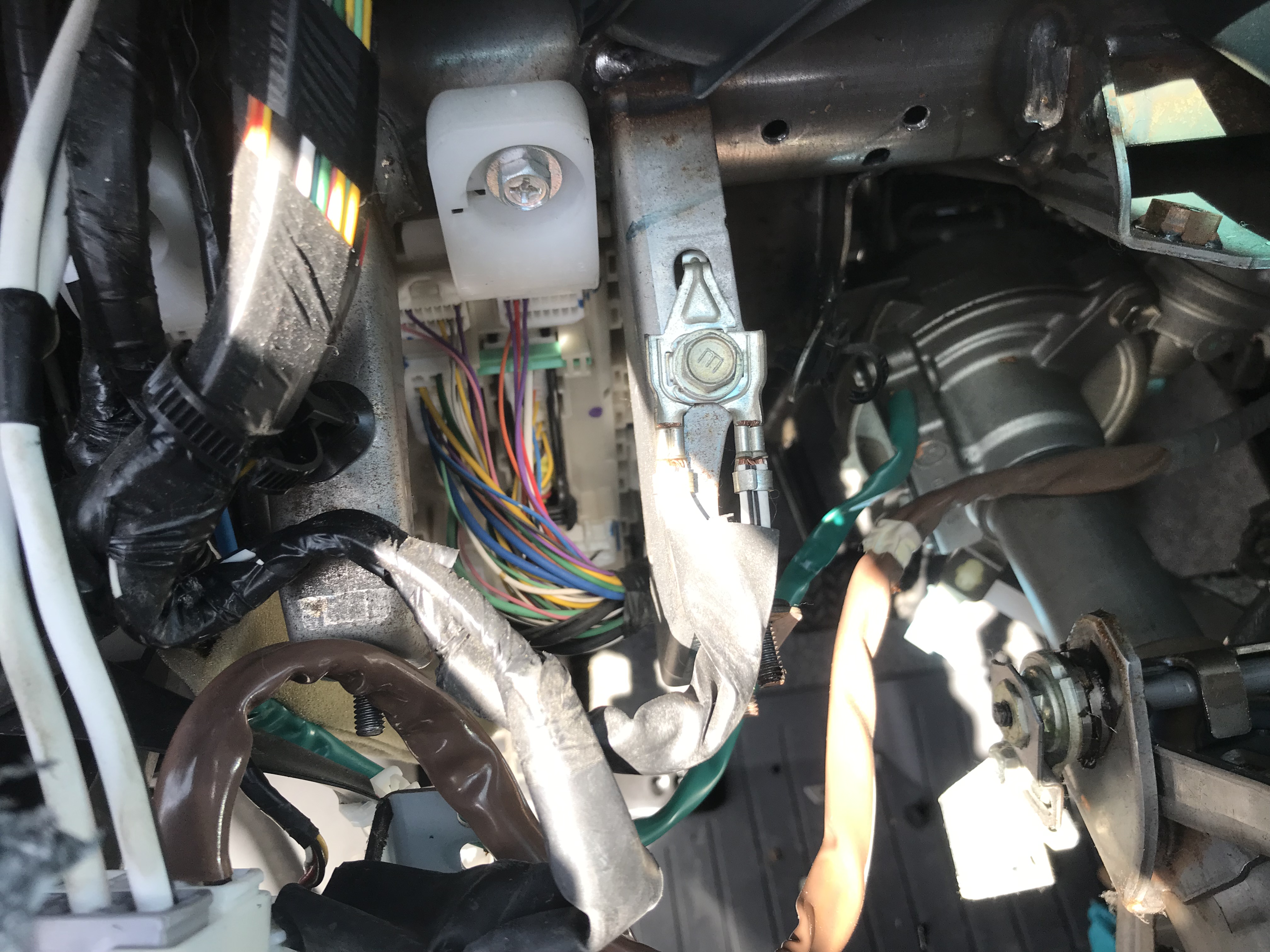

the brain aka computer or control module call it what you will sits way up high under the dash pad
Gregski
Posts: 3164

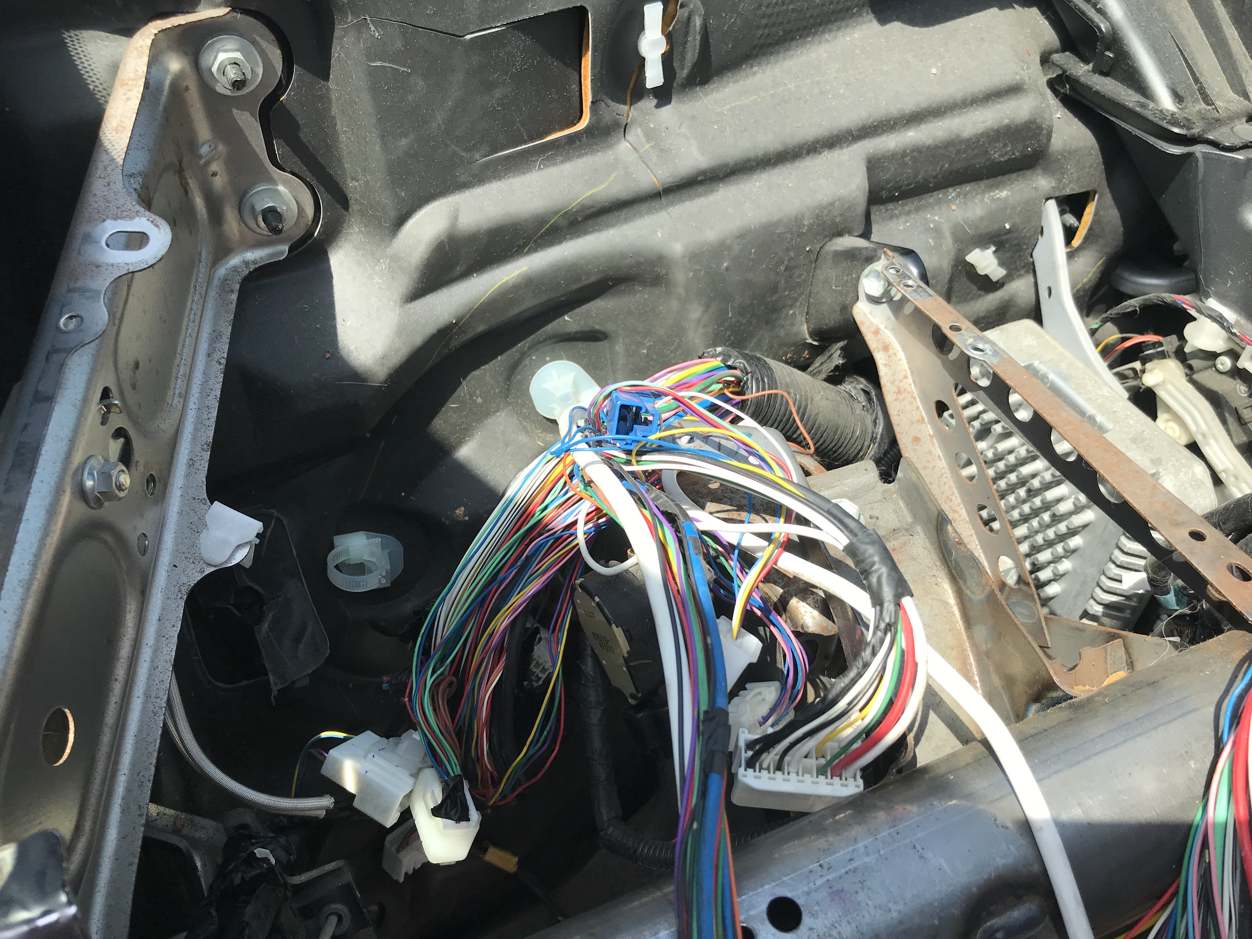

Post by Gregski »

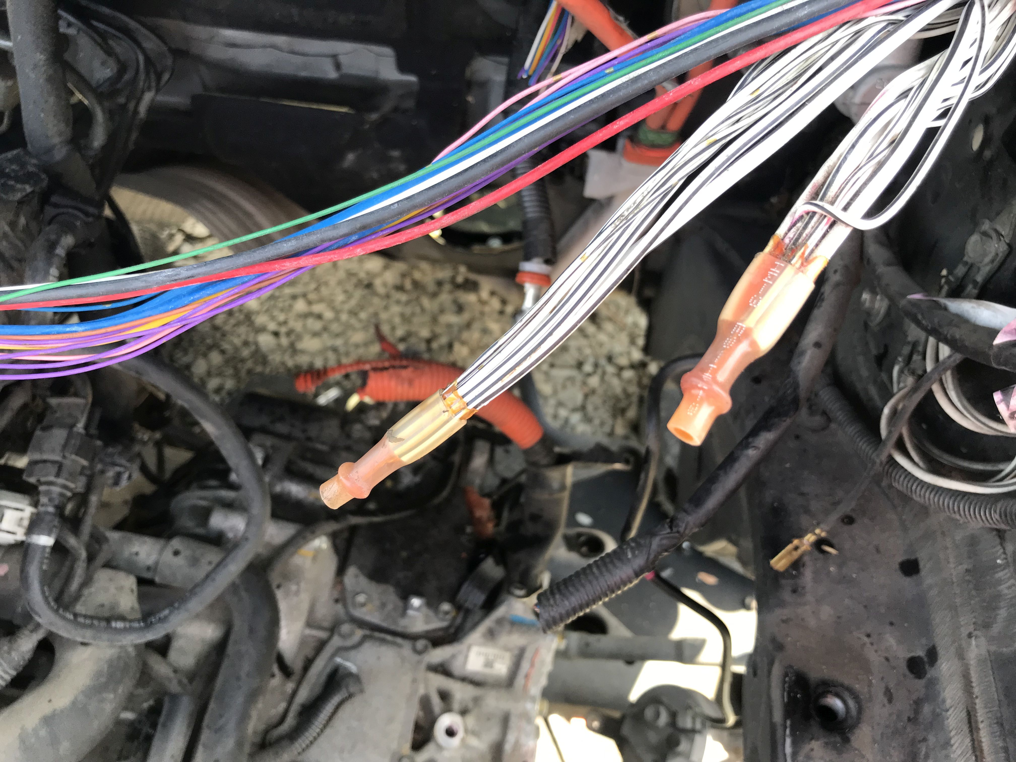

since I did the pull myself I decided to take my time and not cut it all out with a machete
this is one of it's 17 ground connectors (the car itself has 863 grounds)

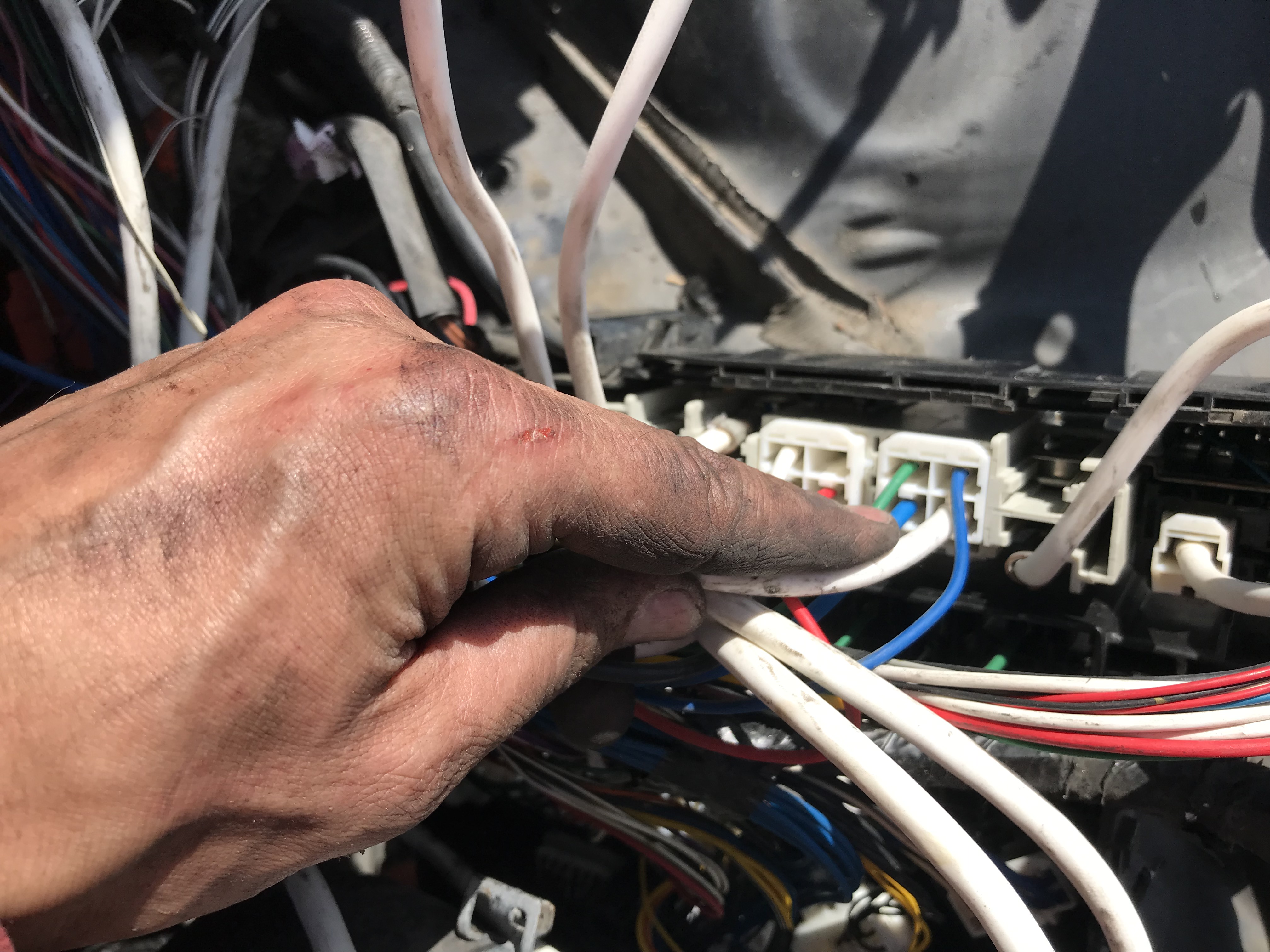

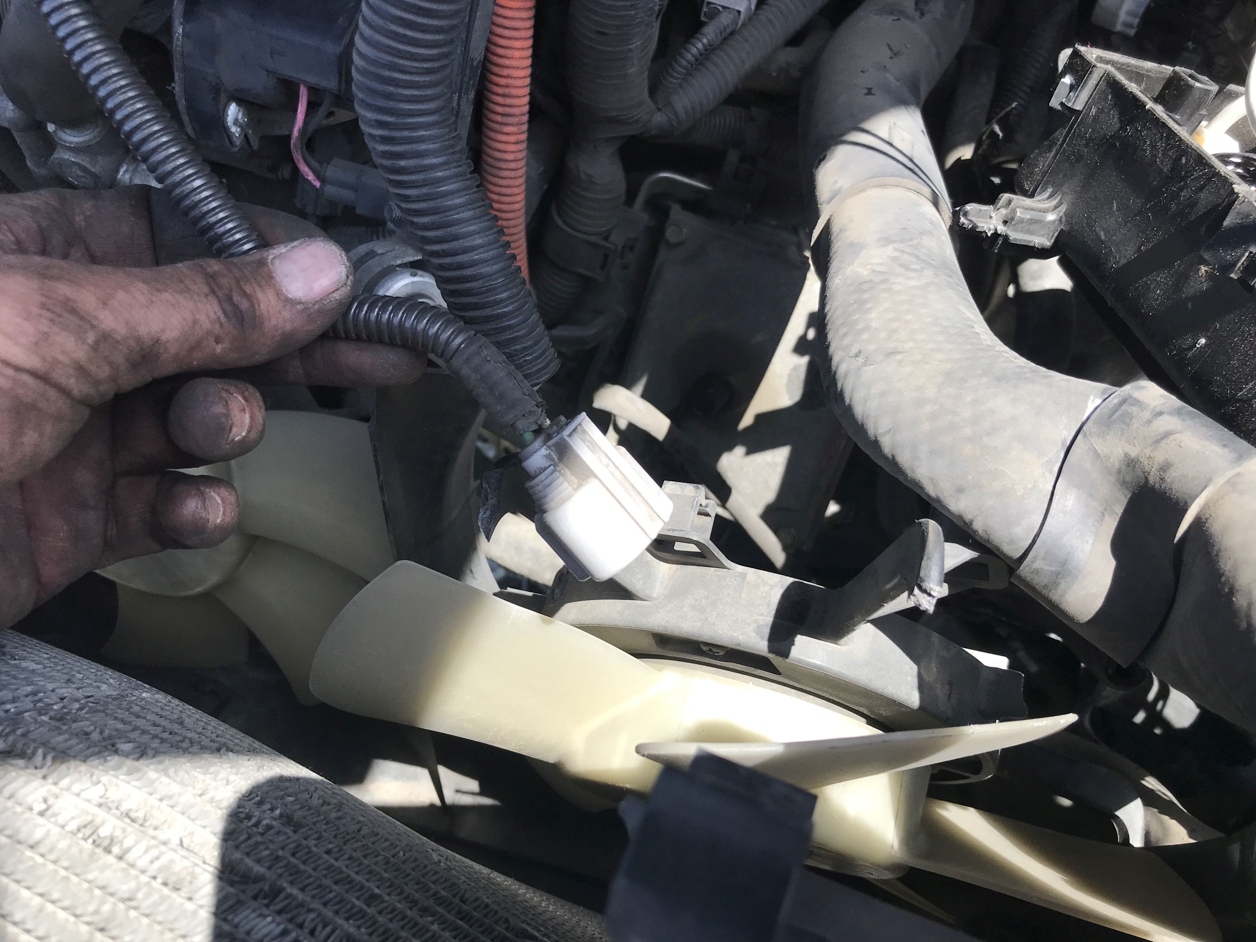

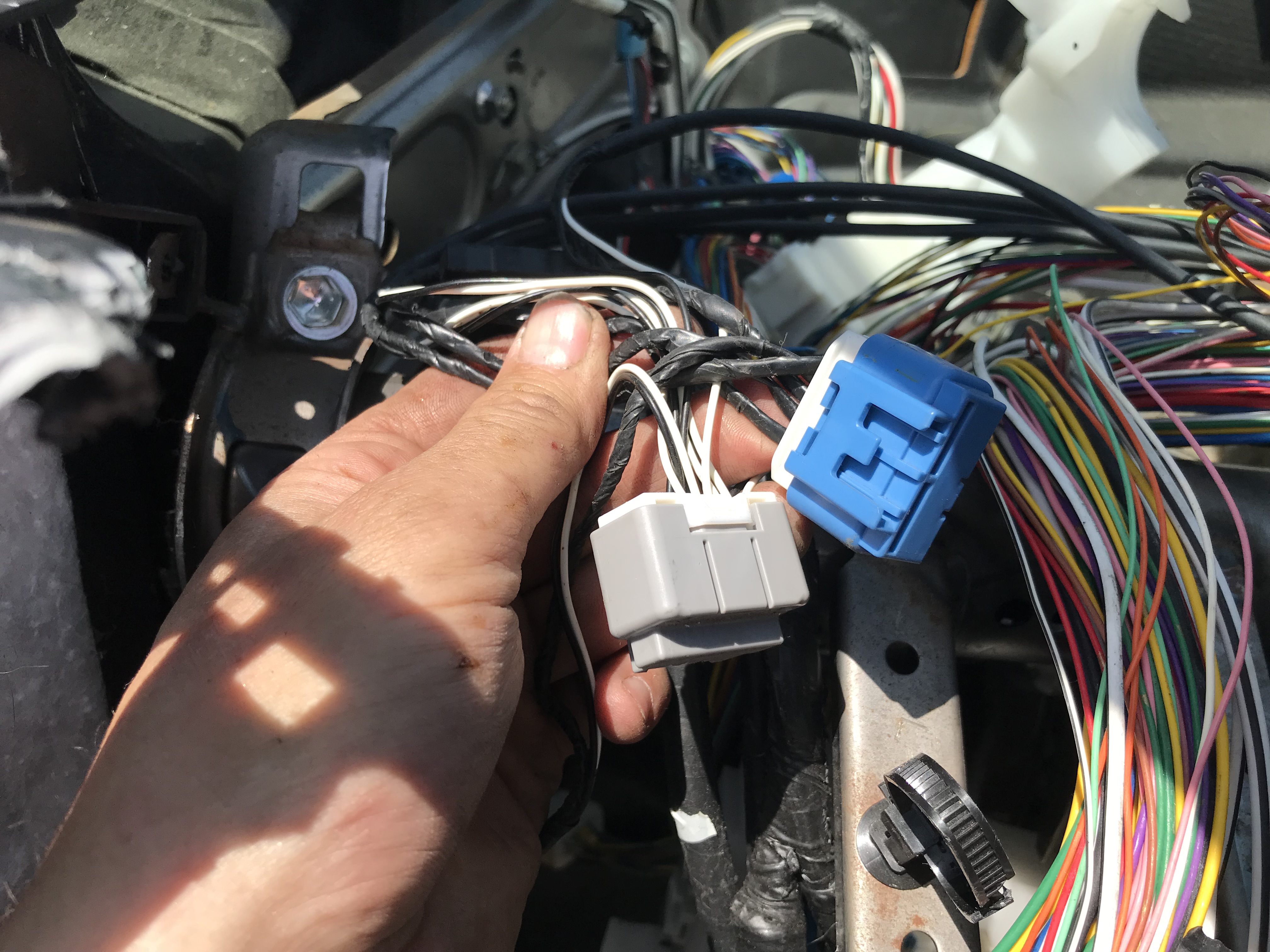

Post by Gregski »

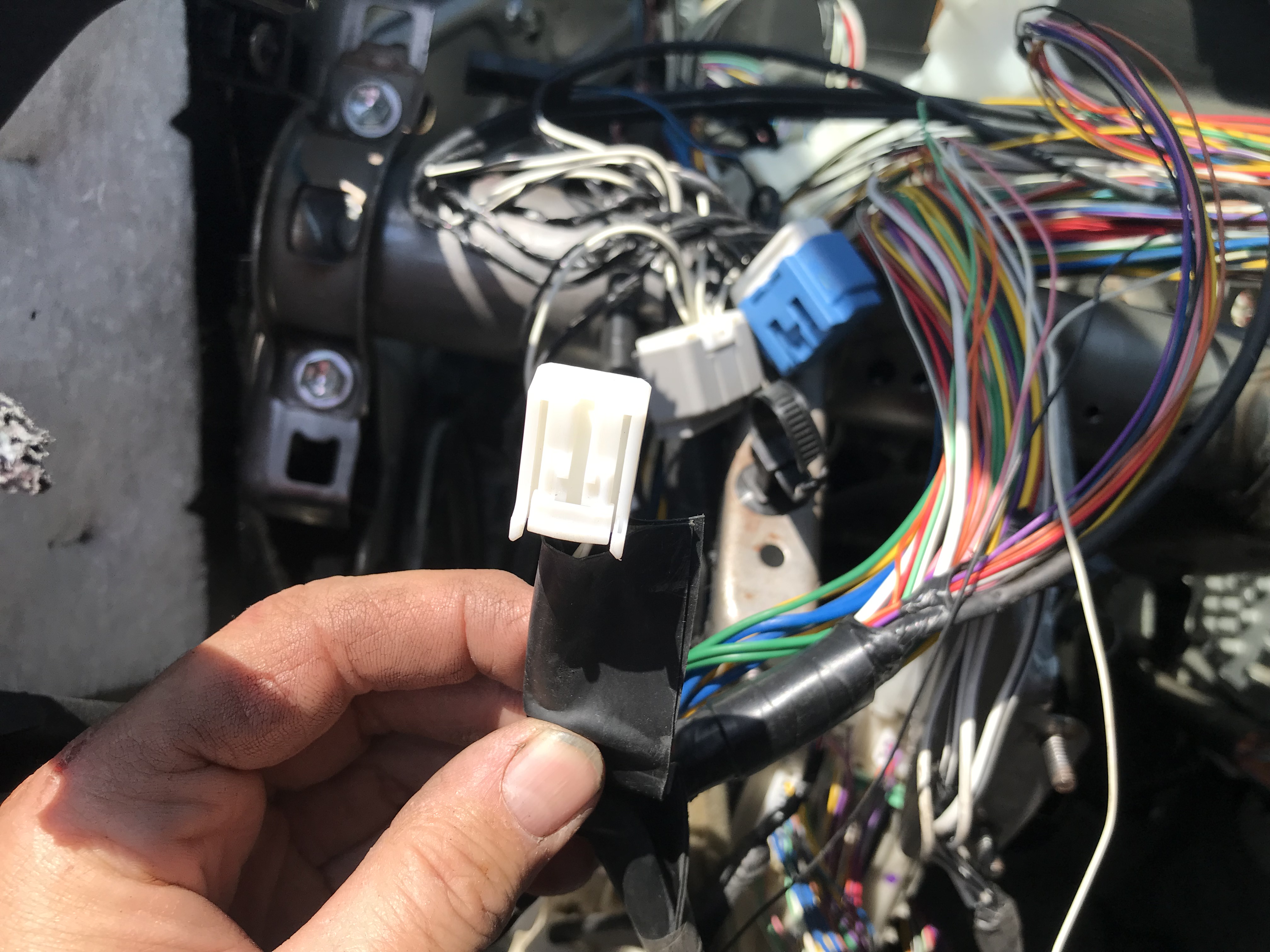

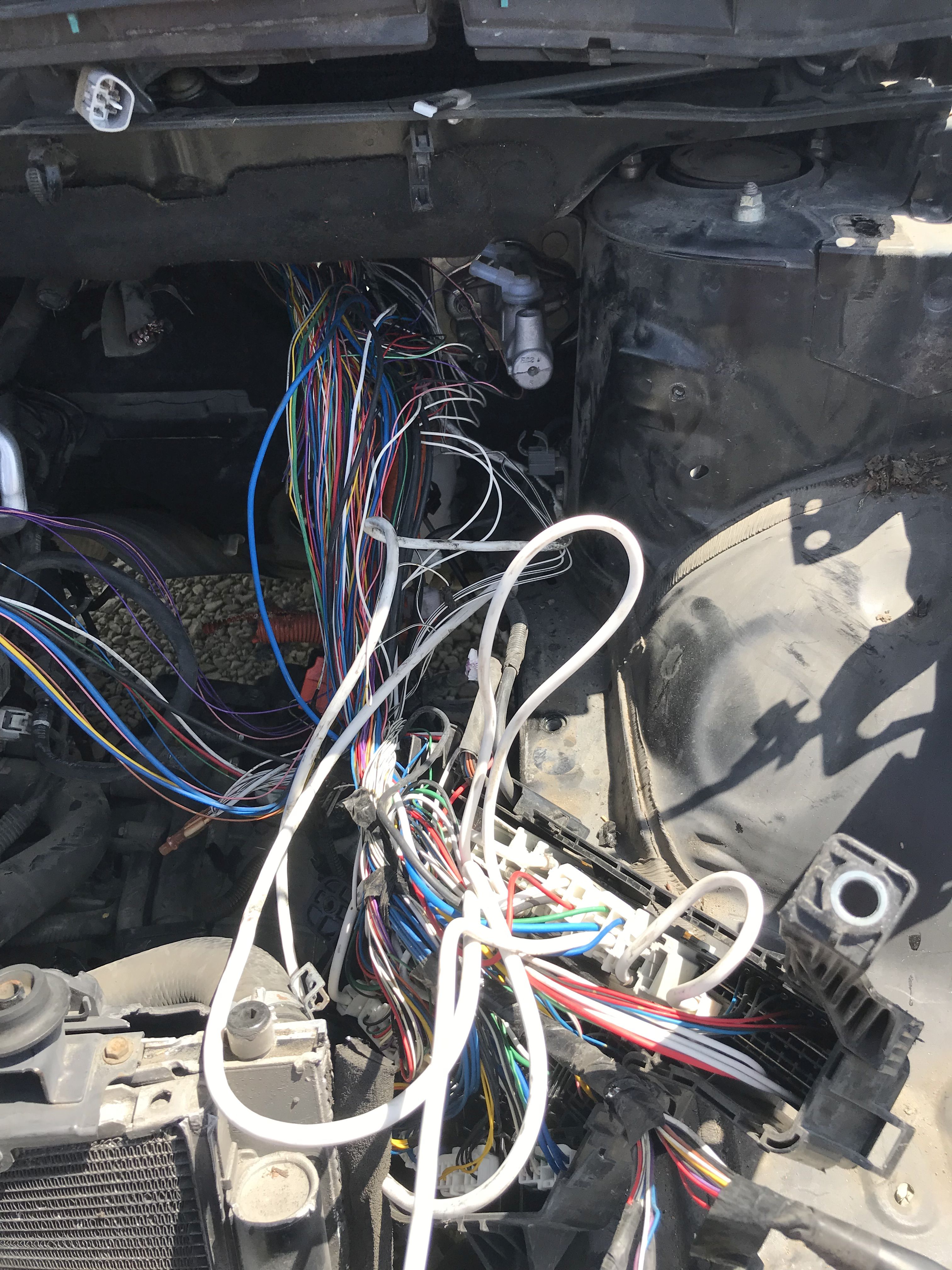

I honestly pride myself on this pull, I pulled all home runs, from the plugs on the steering column computer all the way to the fuse box in the engine bay, I even yanked the relay sub block, which is a siamese with the electric radiator relay on the other side, BONUS! so I pulled those wires to the plug in the rad fan as well (for future use)
more grounds
where the fat white ground wire disappears into the fuse box

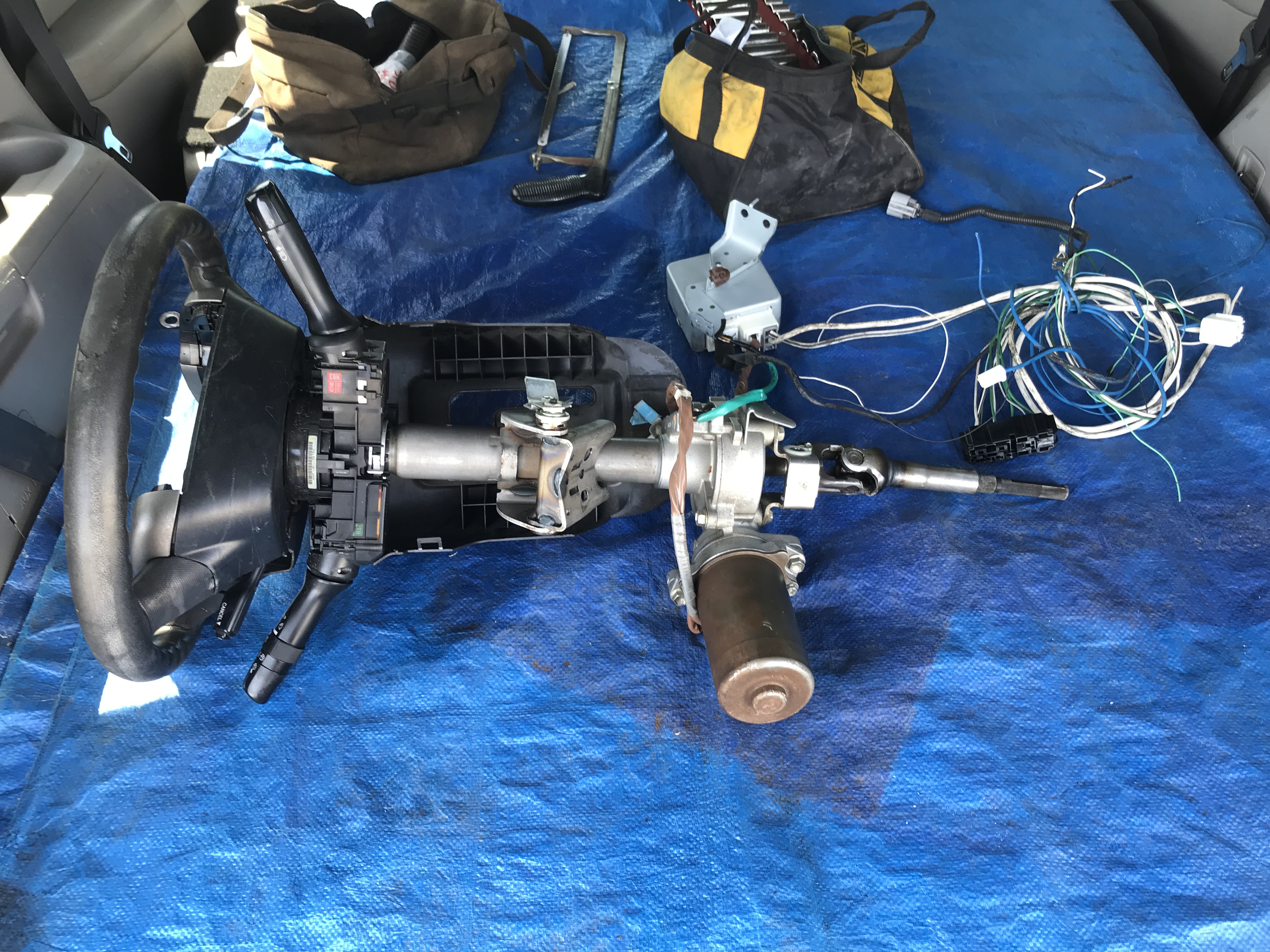

Post by Gregski »
three short sunny hours and $62 bucks later, we had ourselves an electric power assist steering column, with the controller, and the wire harness
Fun Fact: they wanted additional $65 for the sleeping bag, so I yanked it at the cash register in their lobby, ha ha (not on my watch)

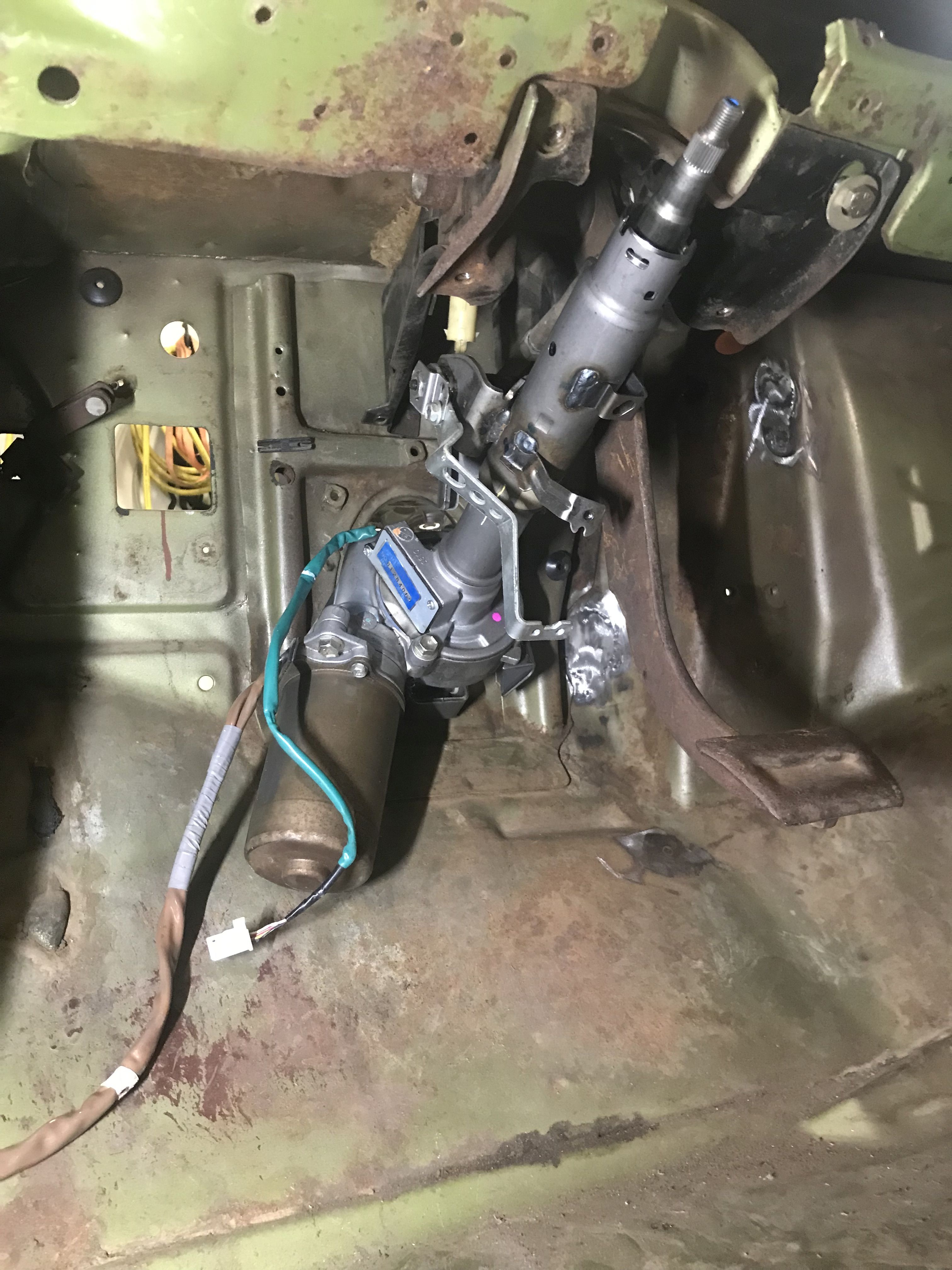

Post by Gregski »

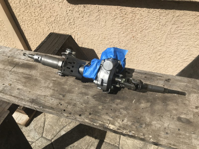

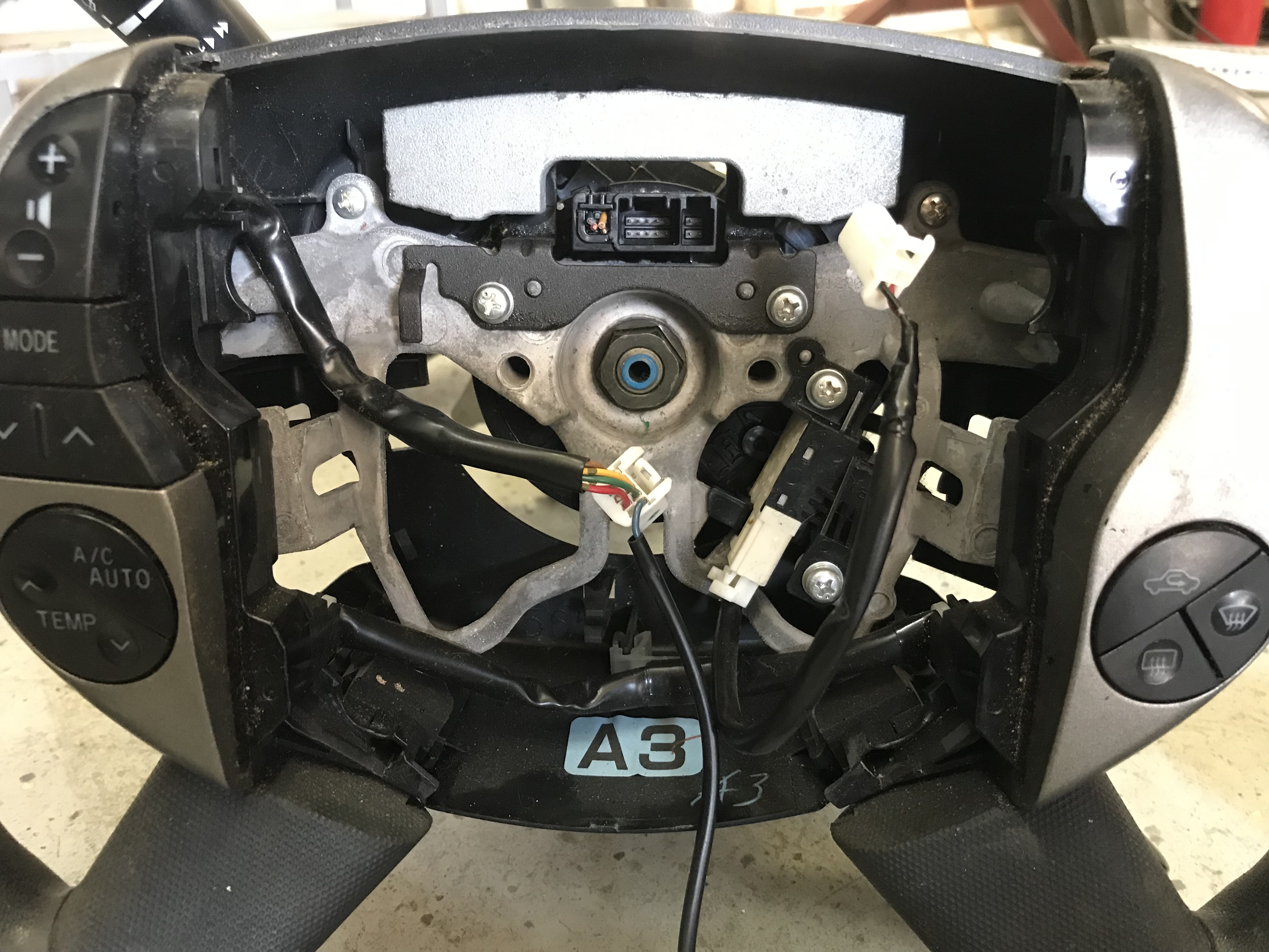

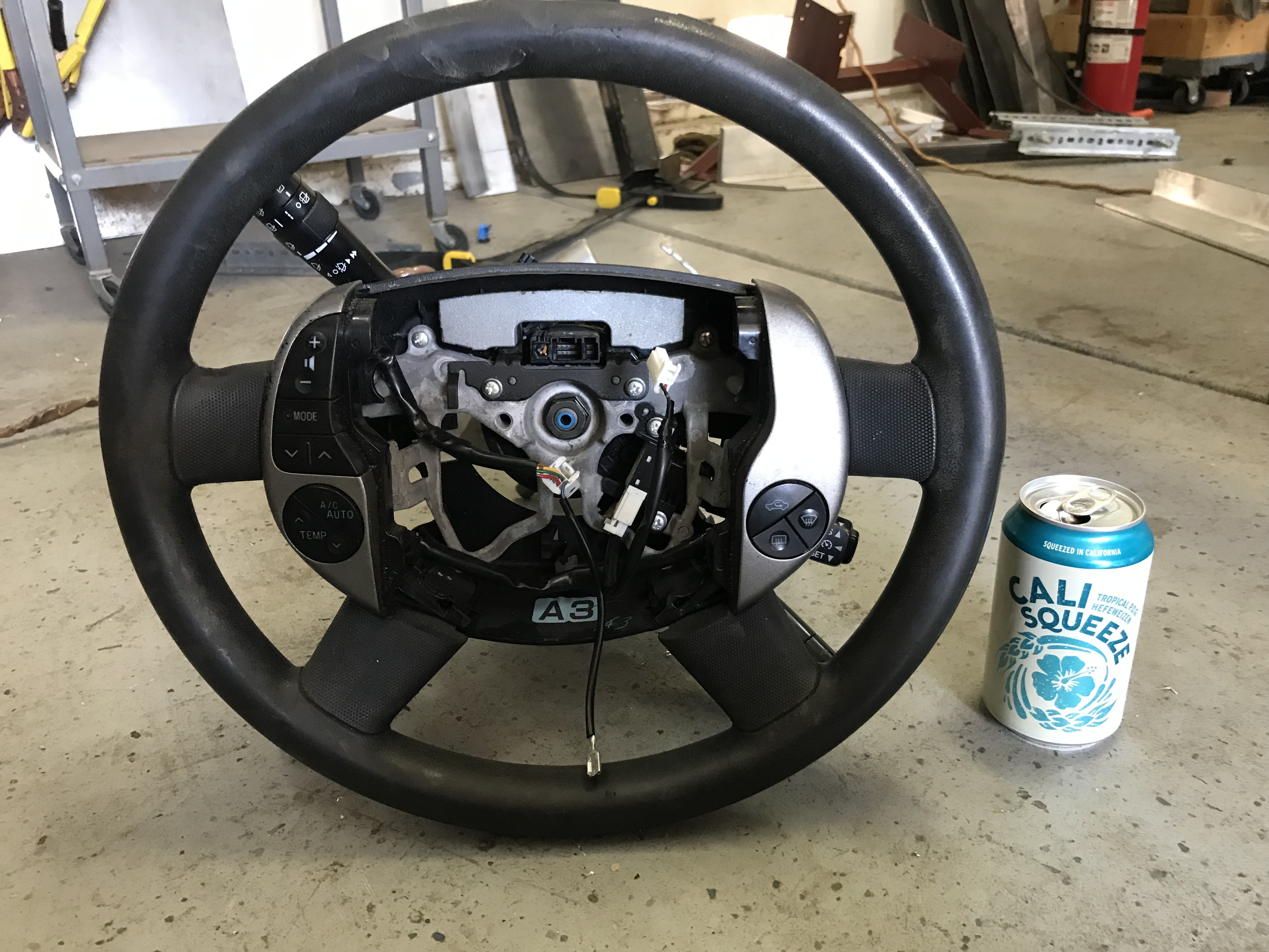

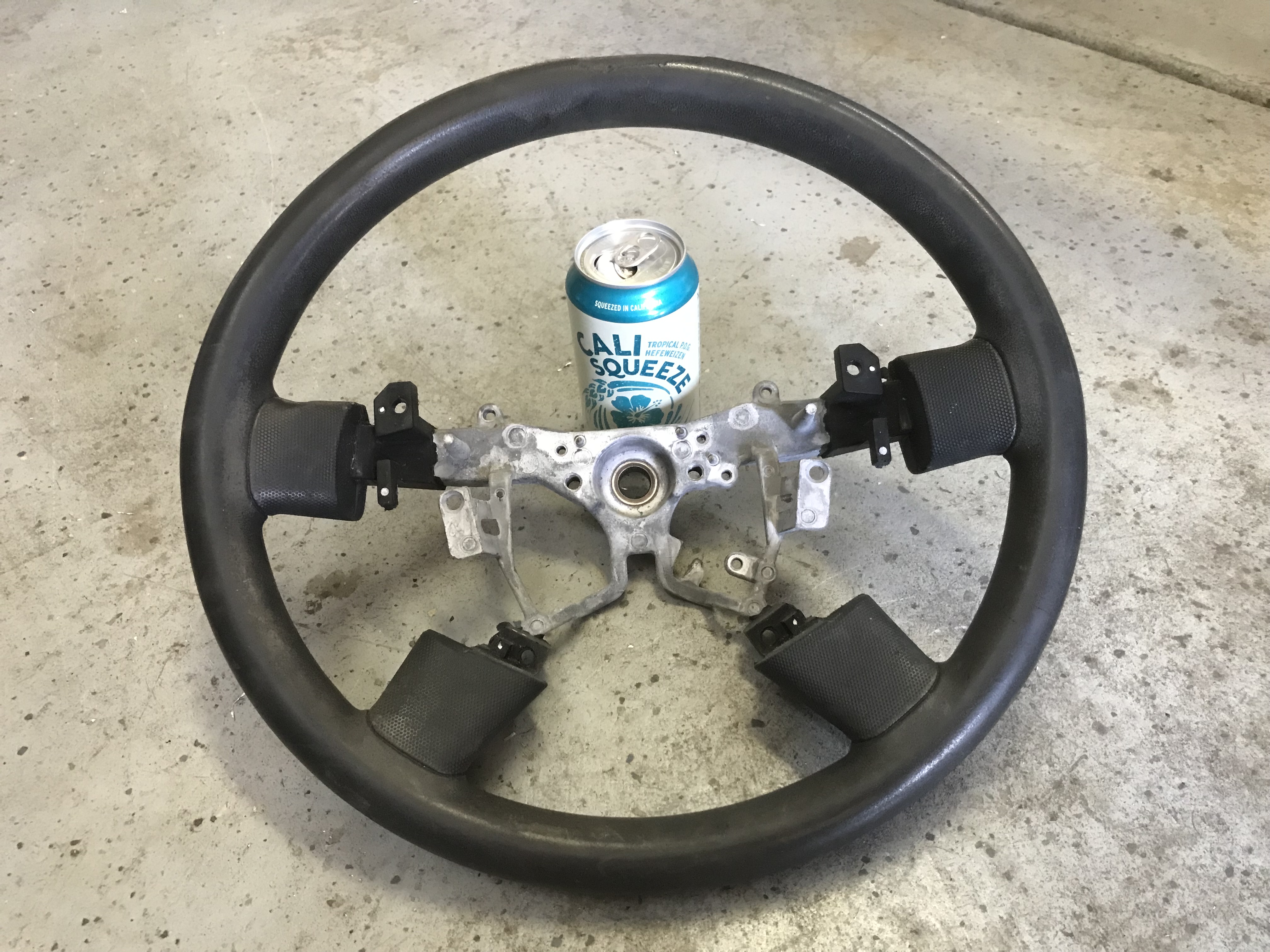

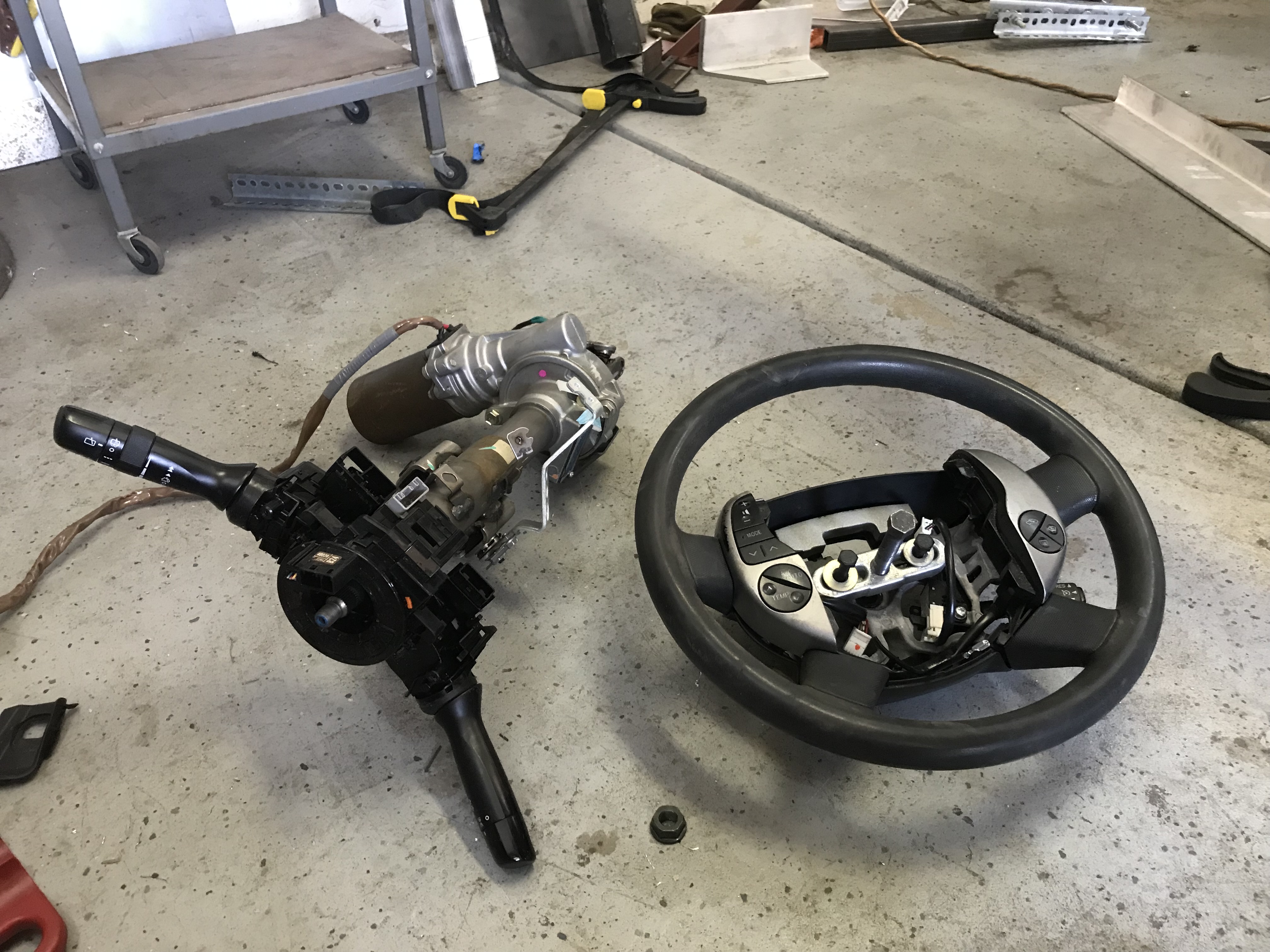

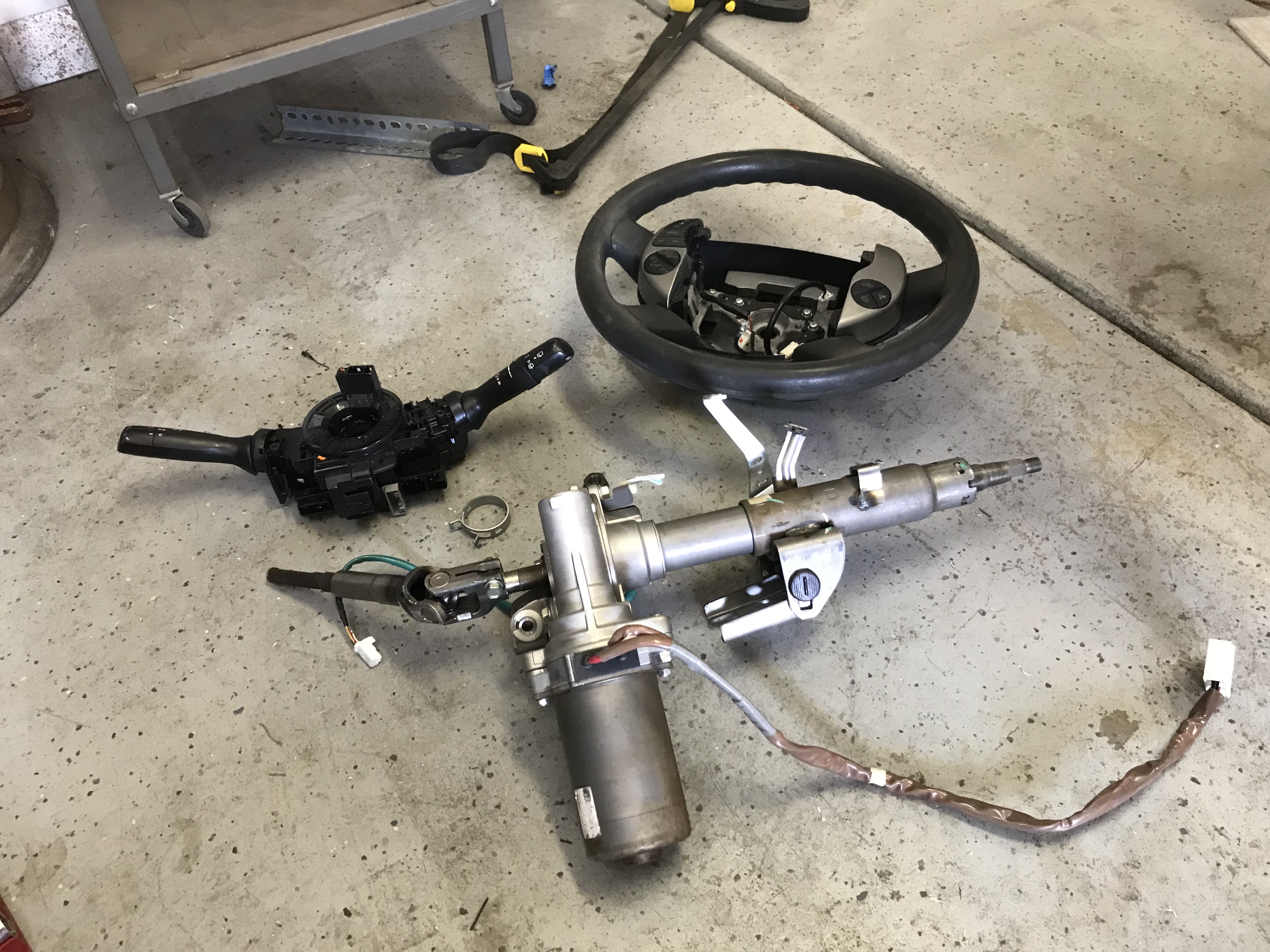

although I treated myself to Jimobys tacos on the way home, shout out if you have been, it's a Cali think I think needless to say I was pooped, but I was determined to give her one try at fitting into Dusty

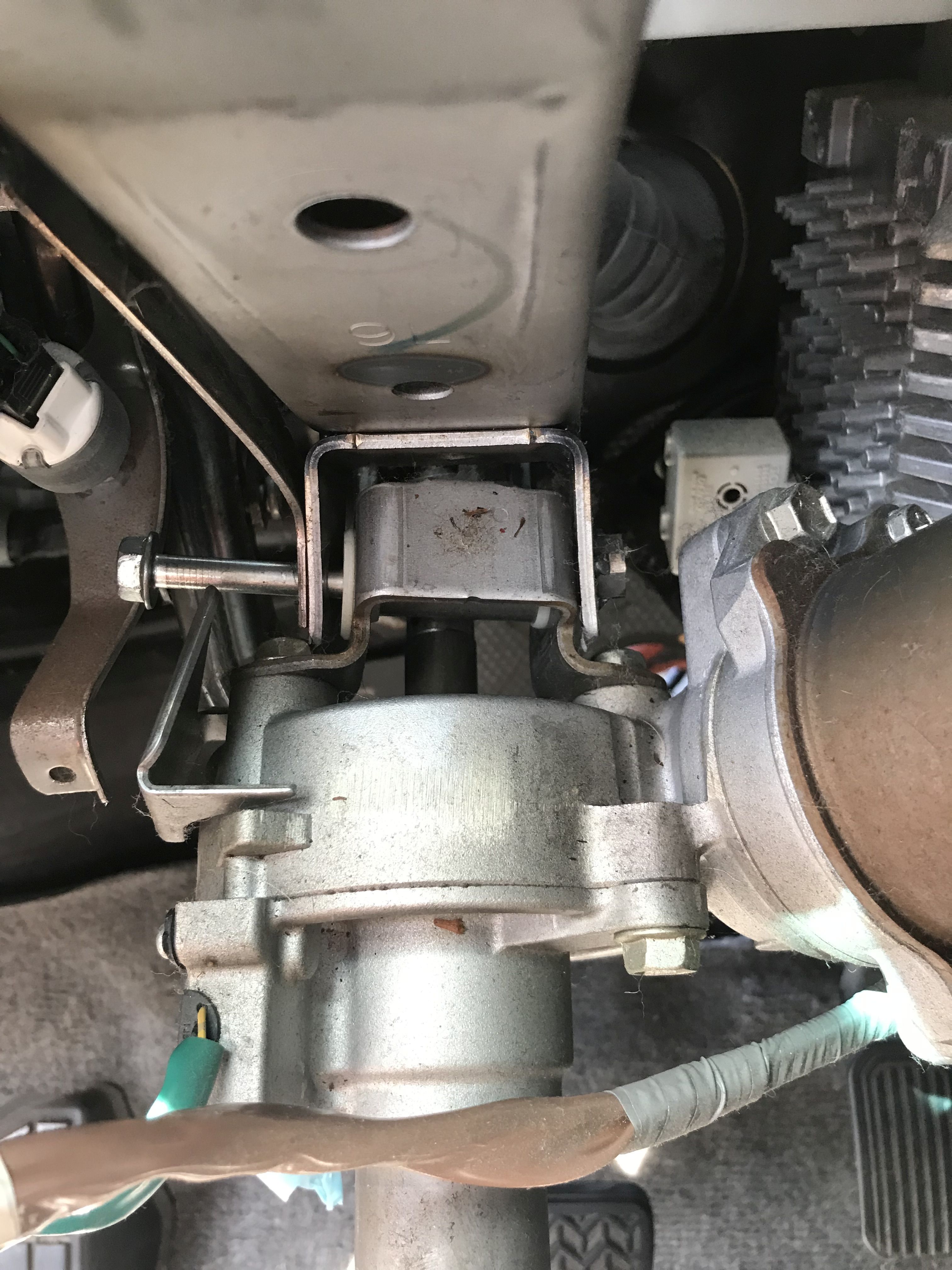

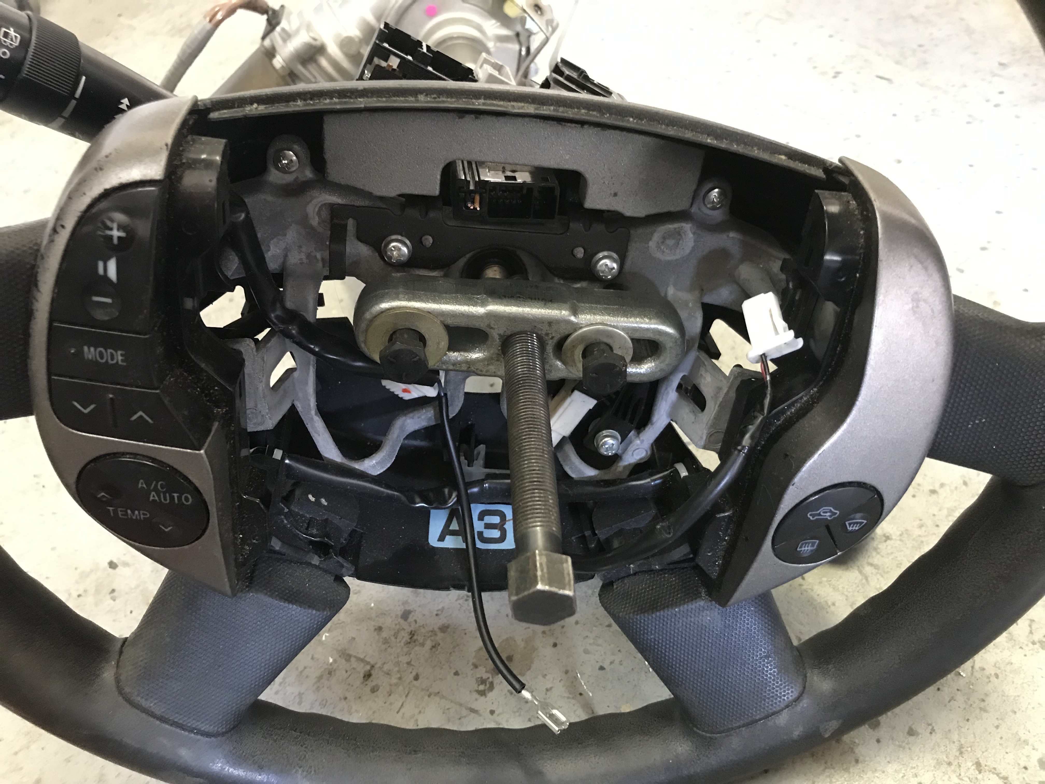

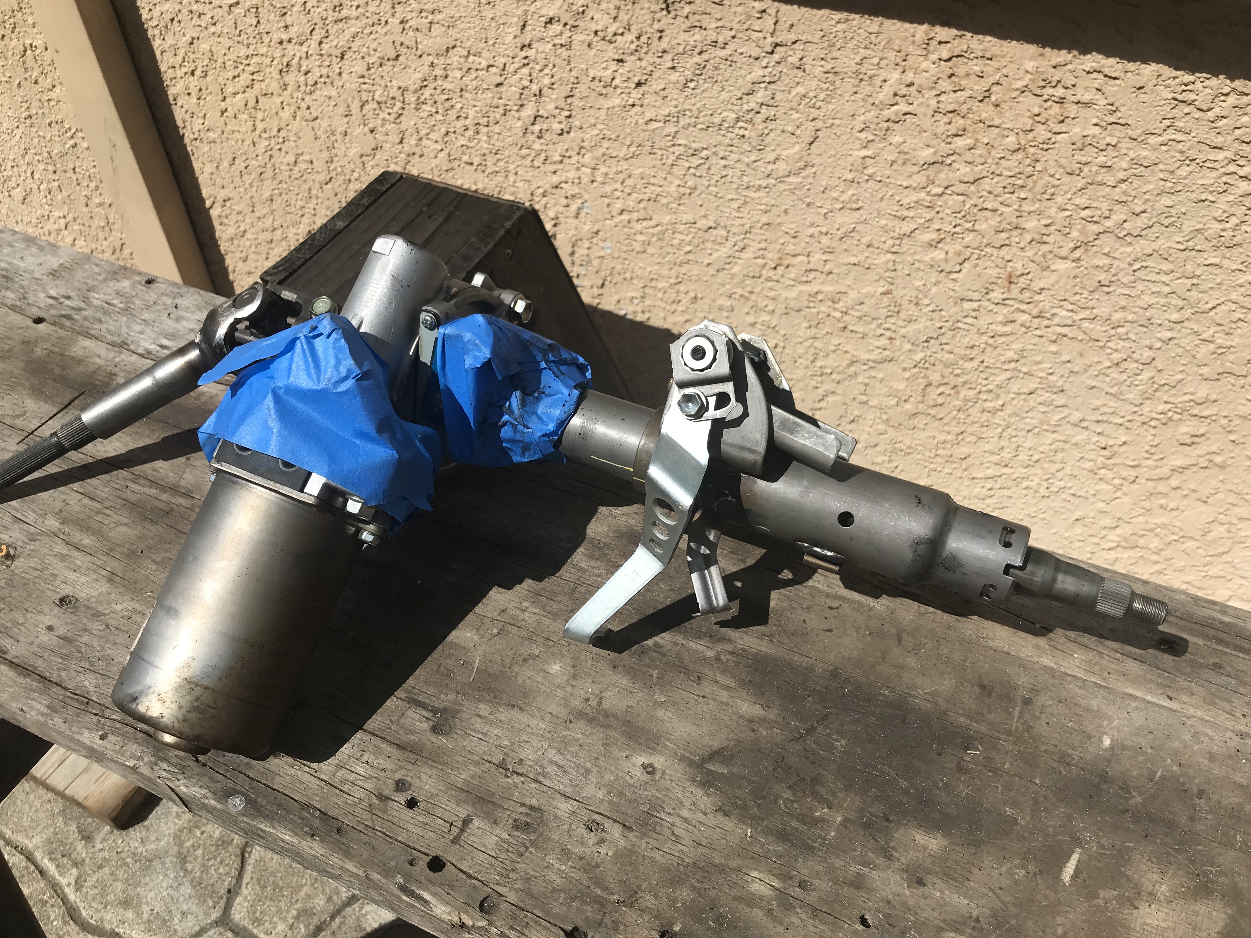

first the fugly steering wheel had to come off, it's a two bolt puller one beer job
Gregski
Posts: 3164
Post by Gregski »
Confession Time: I hate Priuses, they are the slowest vehicles on the planet, and if you are stuck behind one with an Uber sticker forget about it, you are going to be late, and God forbid they have both Lift and Uber, might as well pull over and wait it out, but, but, but...
the engineering is brilliant, honestly, the Lexus engineers should really cross the aisle and chat with the Toyota gals, cause they know how to build a fuse block and steering column/wheel, this thing comes apart like magic
this weight on the steering wheel explains why they only get 7 miles of range per battery pack
and one track ready Prius steering wheel

Post by Gregski »

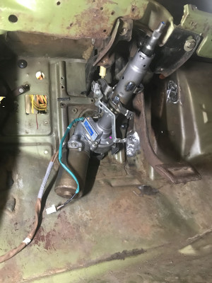

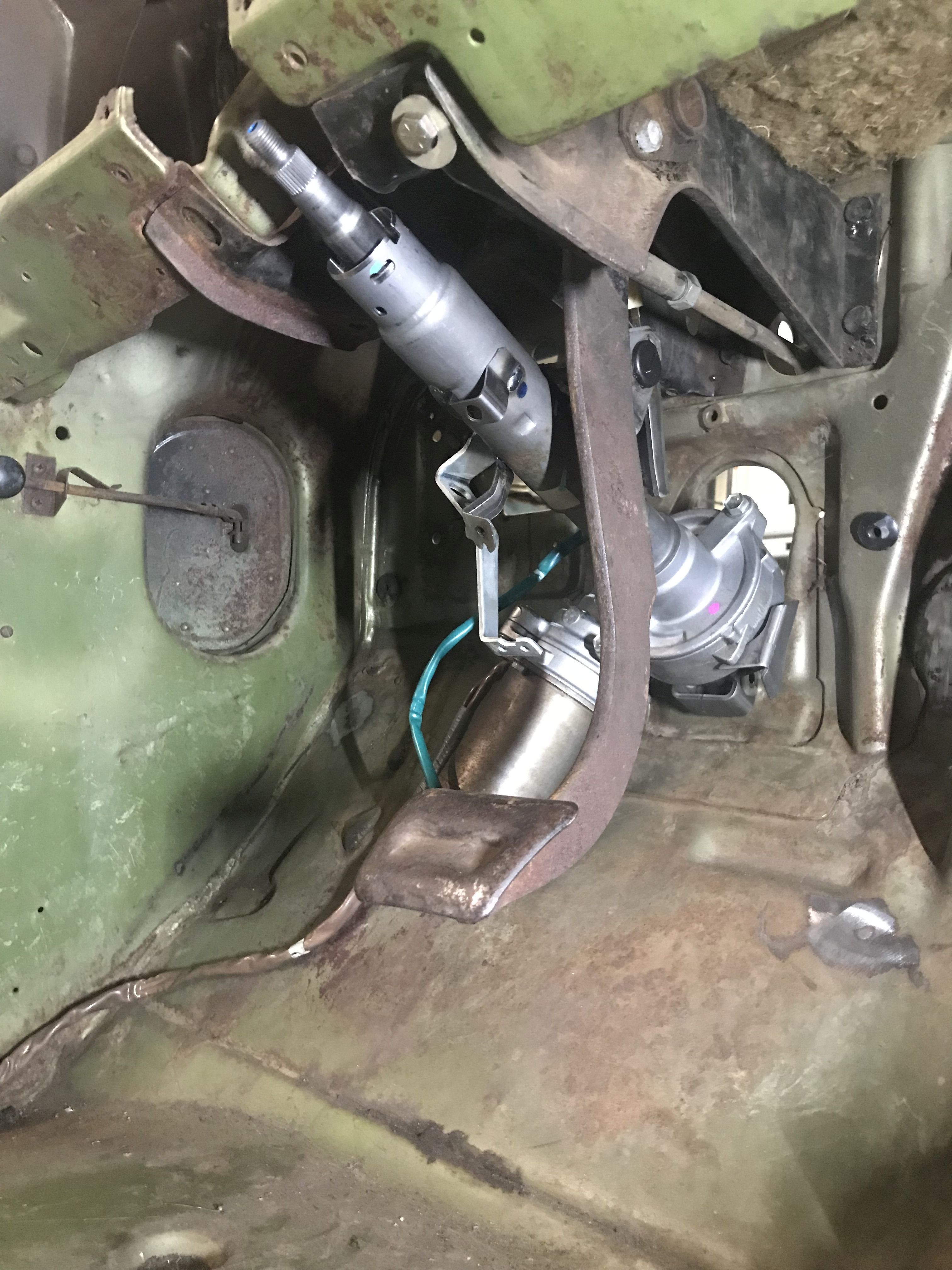

wait a minute, this 2008 Toyota steering column is NOT a direct bolt on to my 1969/71 Chevy GMC ??? may I speak to a supervisor please
Gregski
Posts: 3164

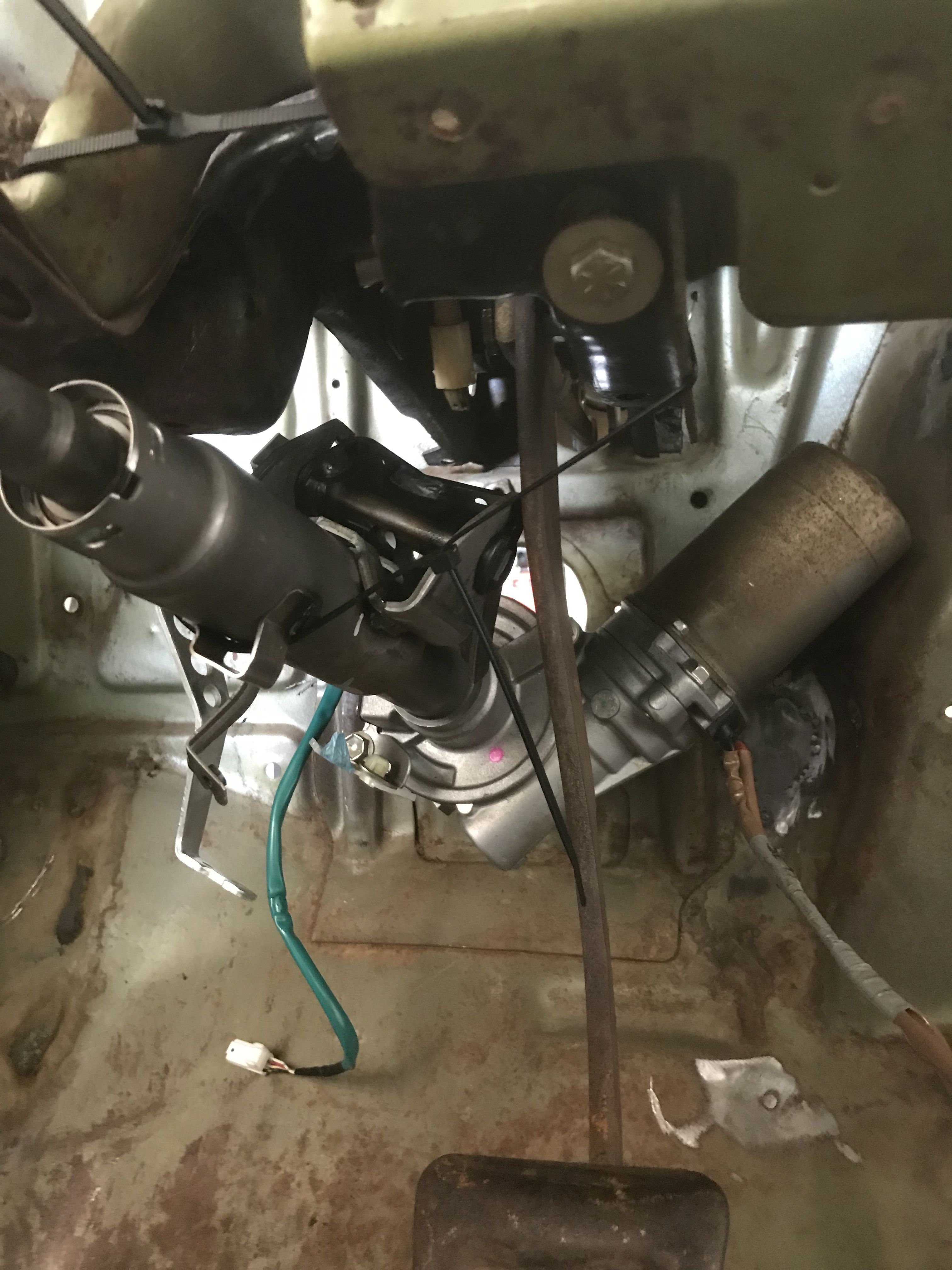

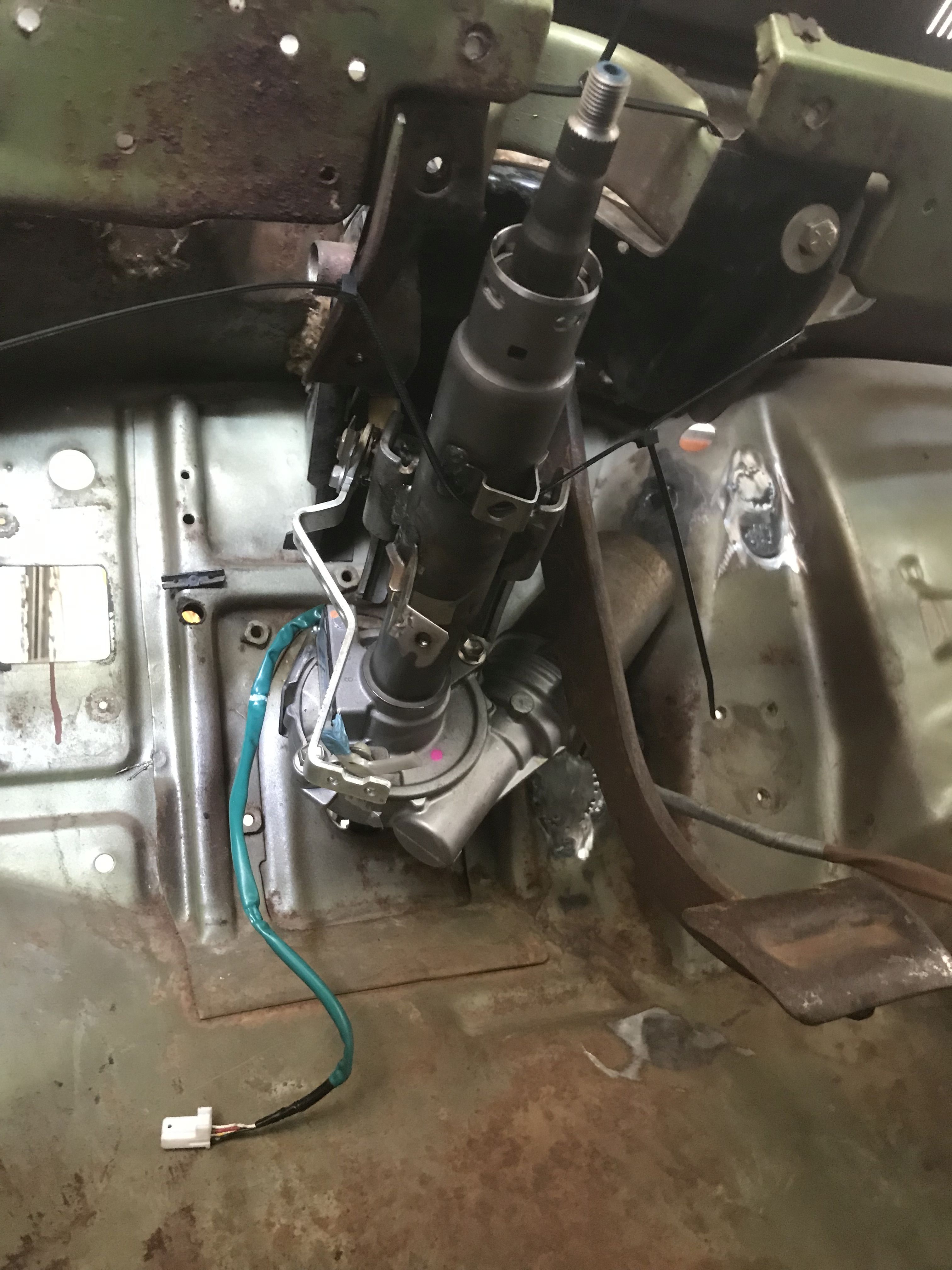

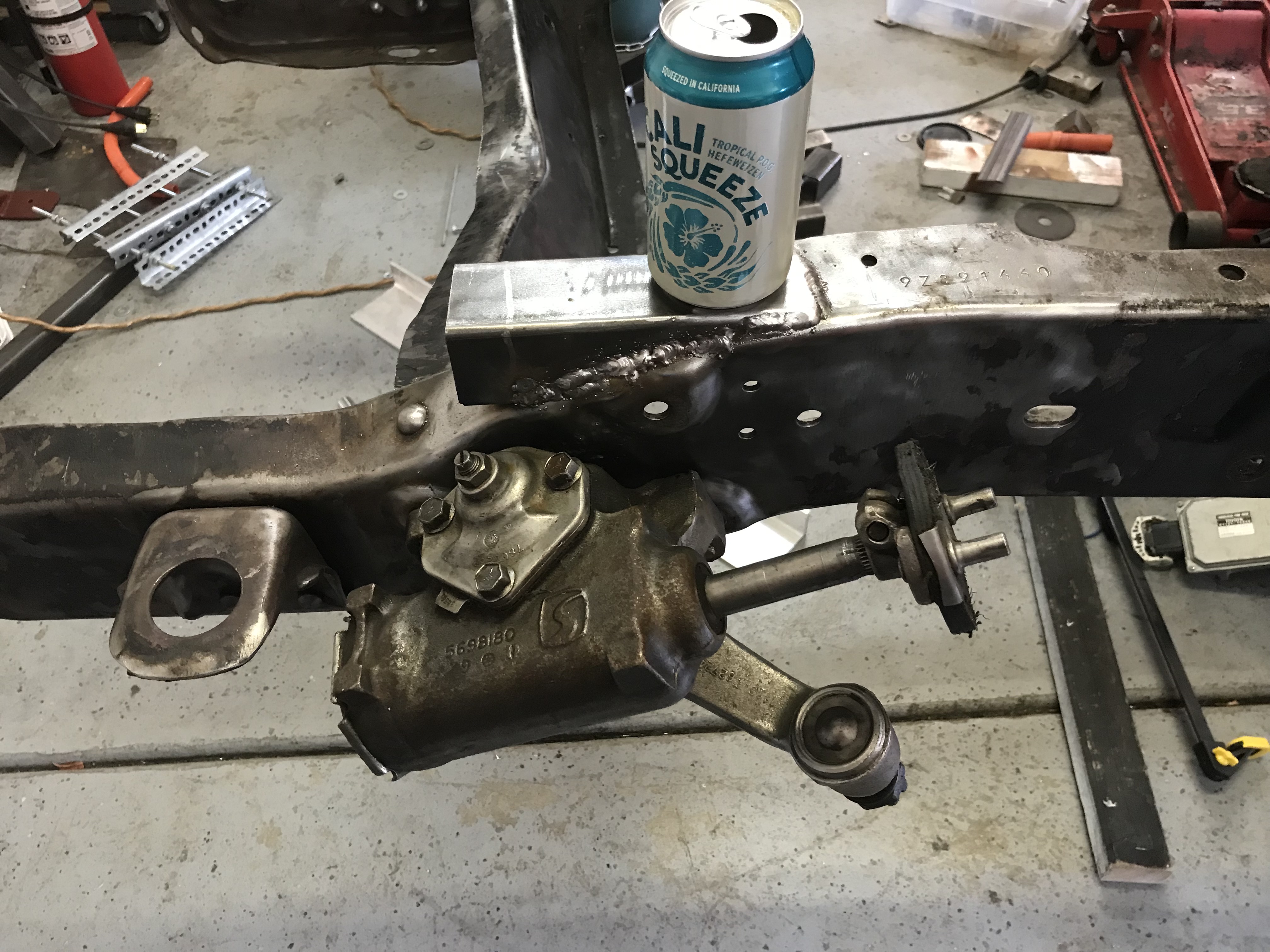

Post by Gregski »

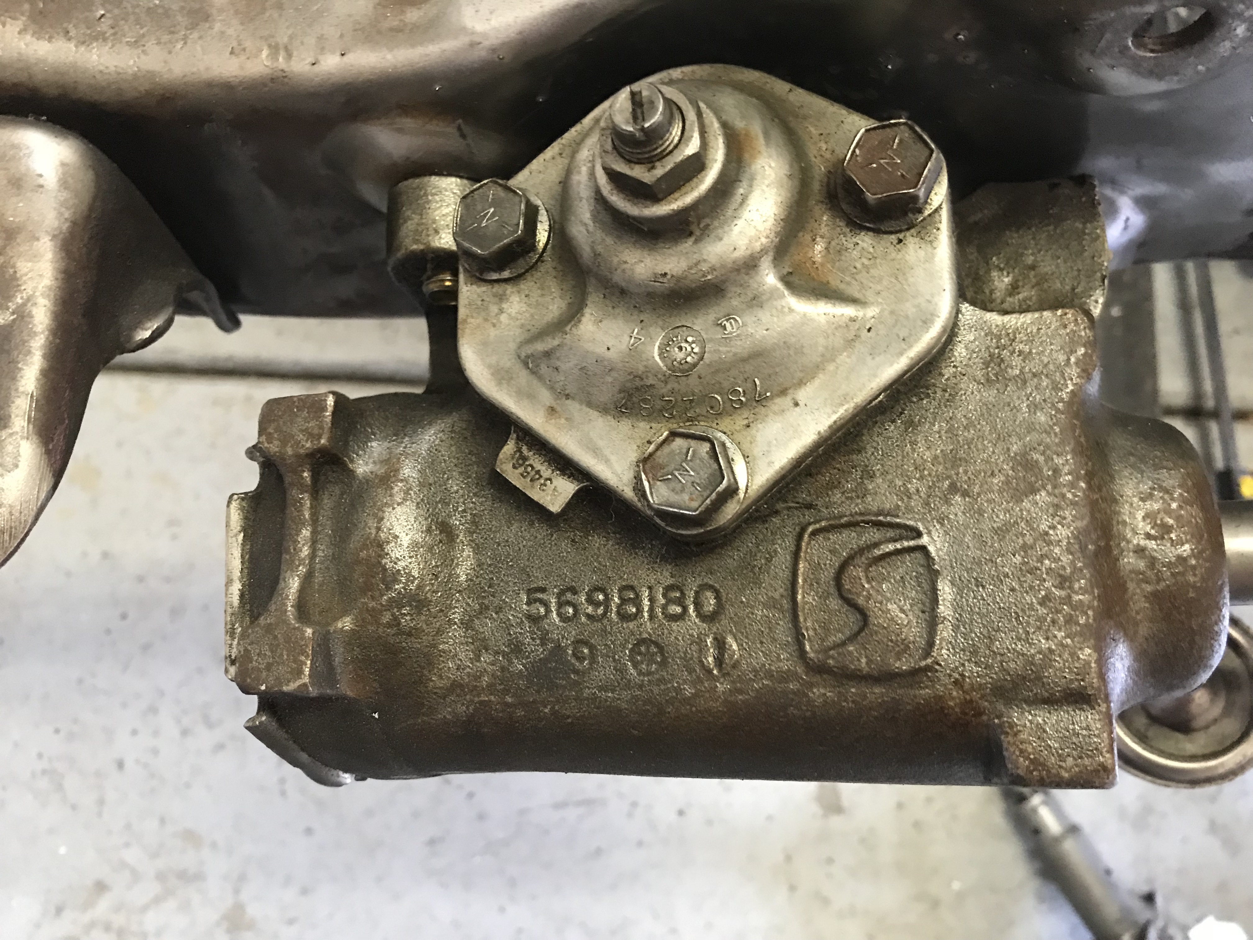

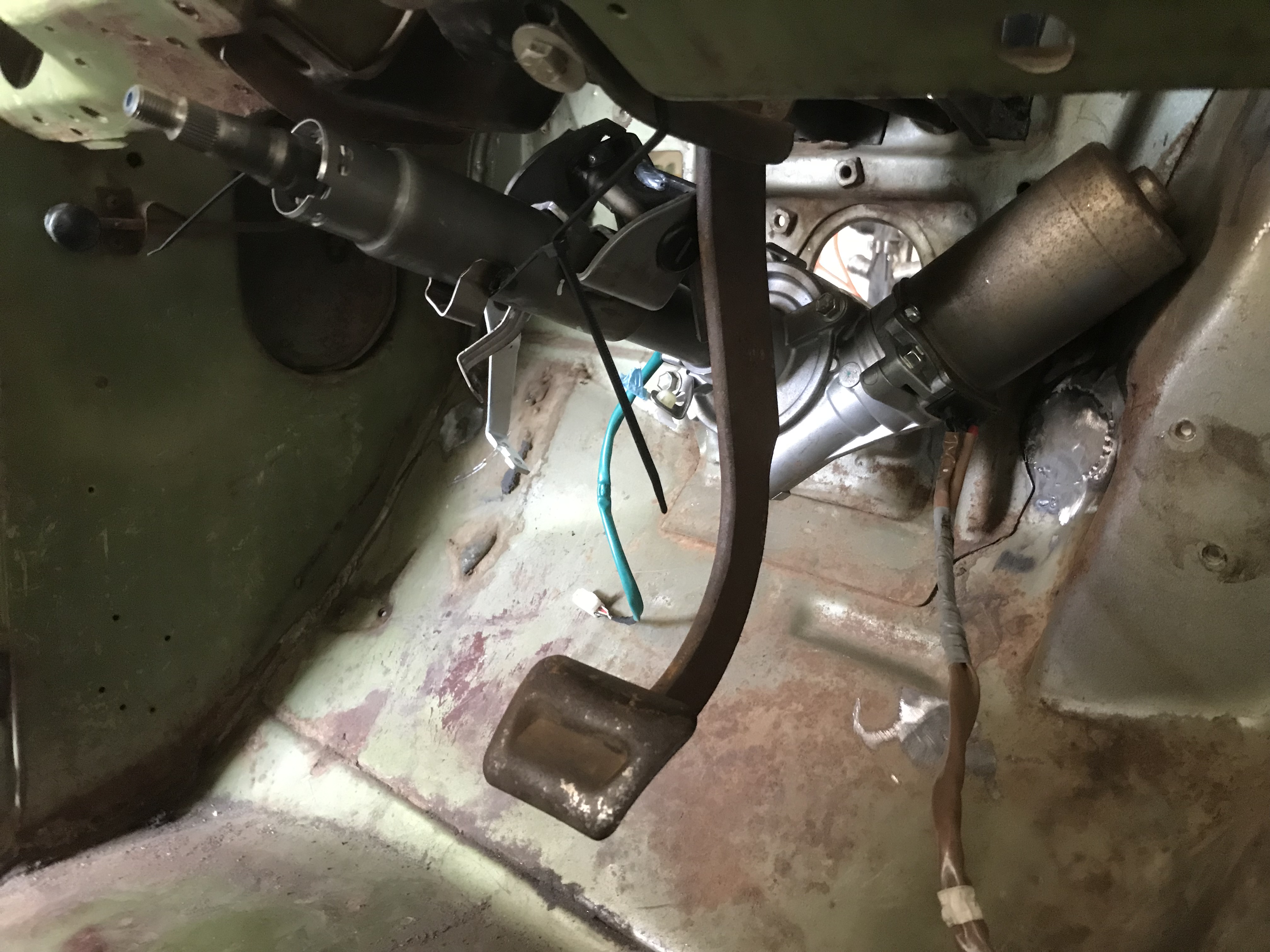

so I bolted up the manual steering box (yes manual, as they come with a more forgiving 6.5 end to end turn ratio than the automagical ones) and yes a box and not a rack, some call it arcane, I believe the General prefers "proven" technology
the reason I swapped out my power steering box for this manual is because this Prius jobbie is not technically power steering as the force is applied above the box, so it's essentially power assist if you will

Post by Gregski »
TheSilverBuick wrote: Mon Apr 25, 2022 3:17 pm Excellent steering work!
thanks, zip ties for the win! and don't worry they will hold, that's why I used three of 'em lol

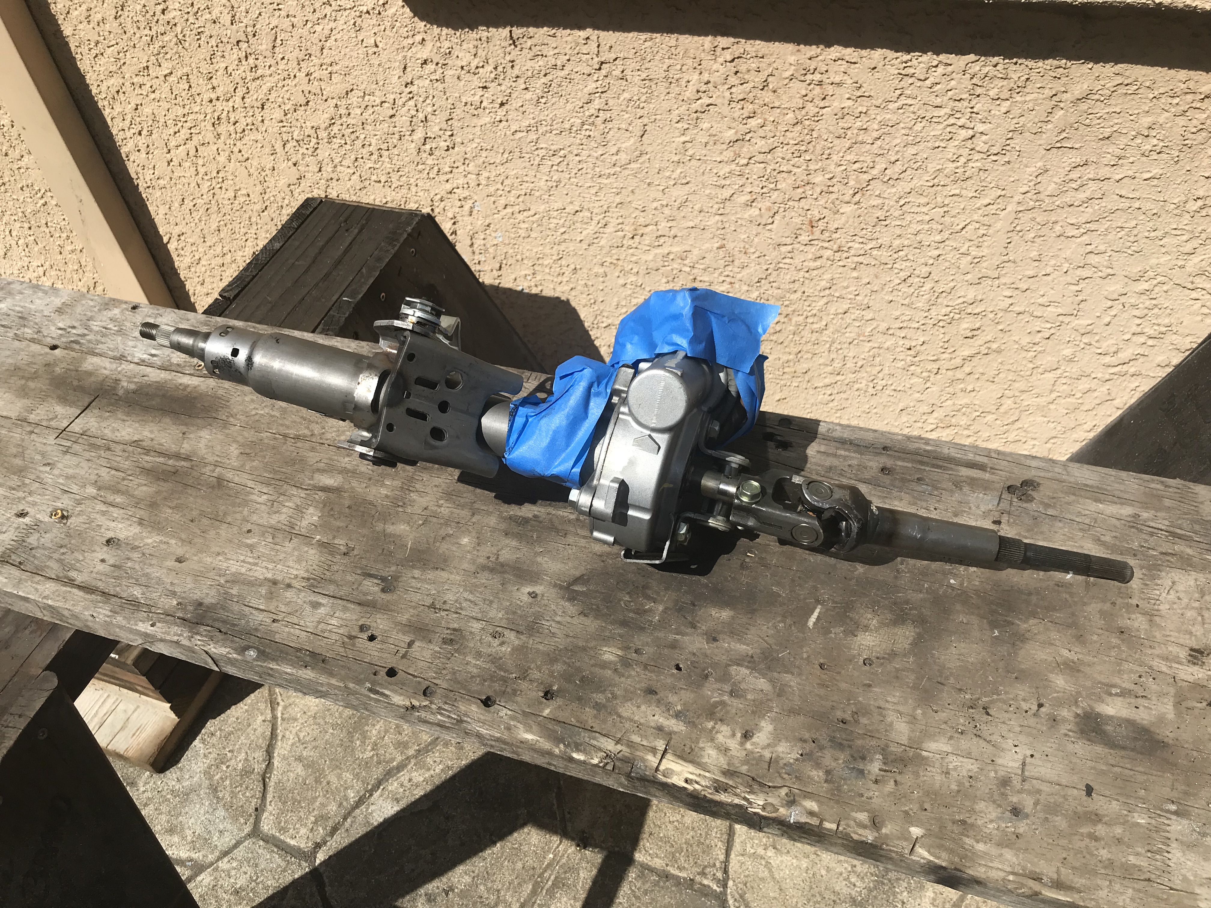

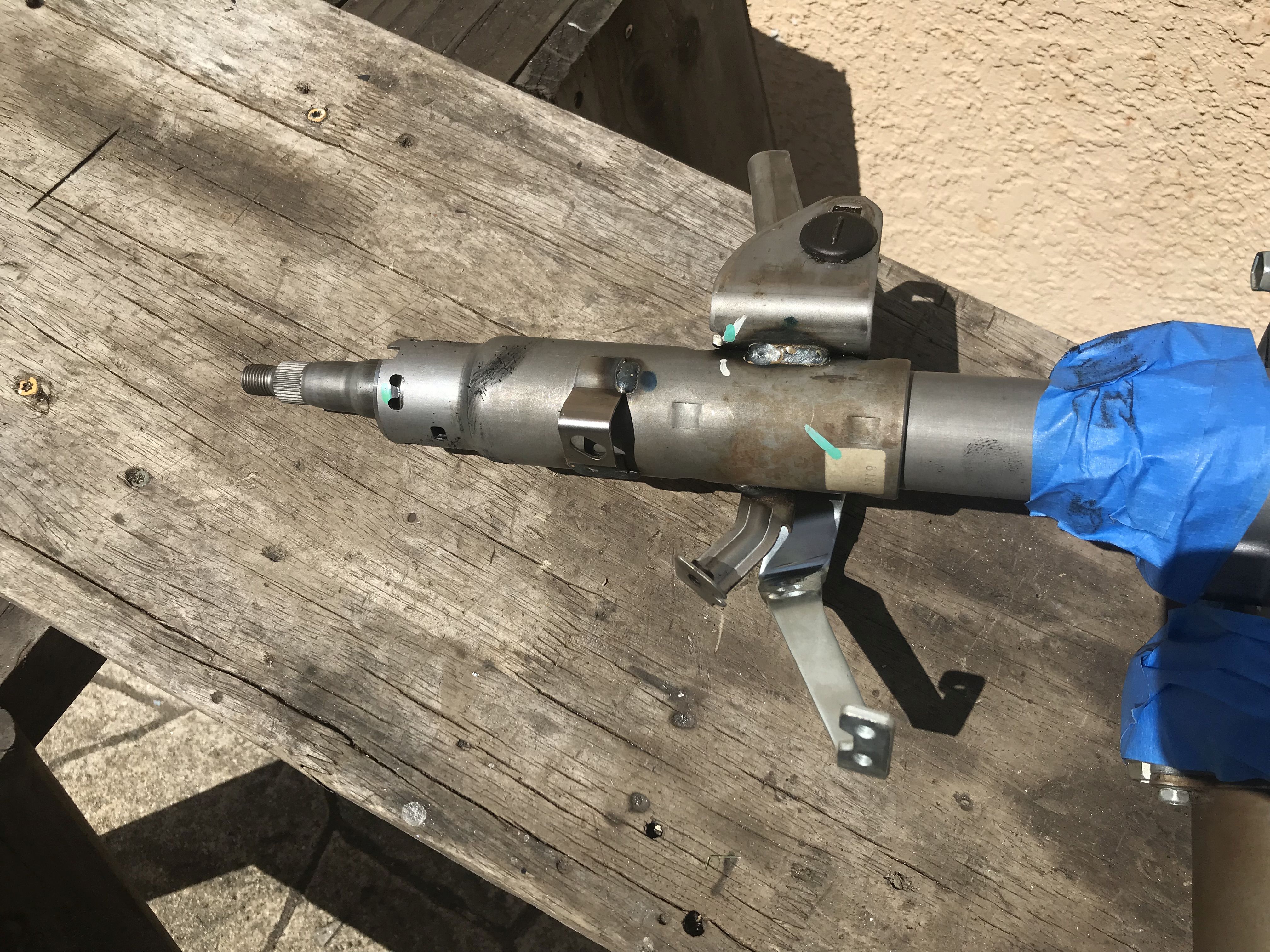

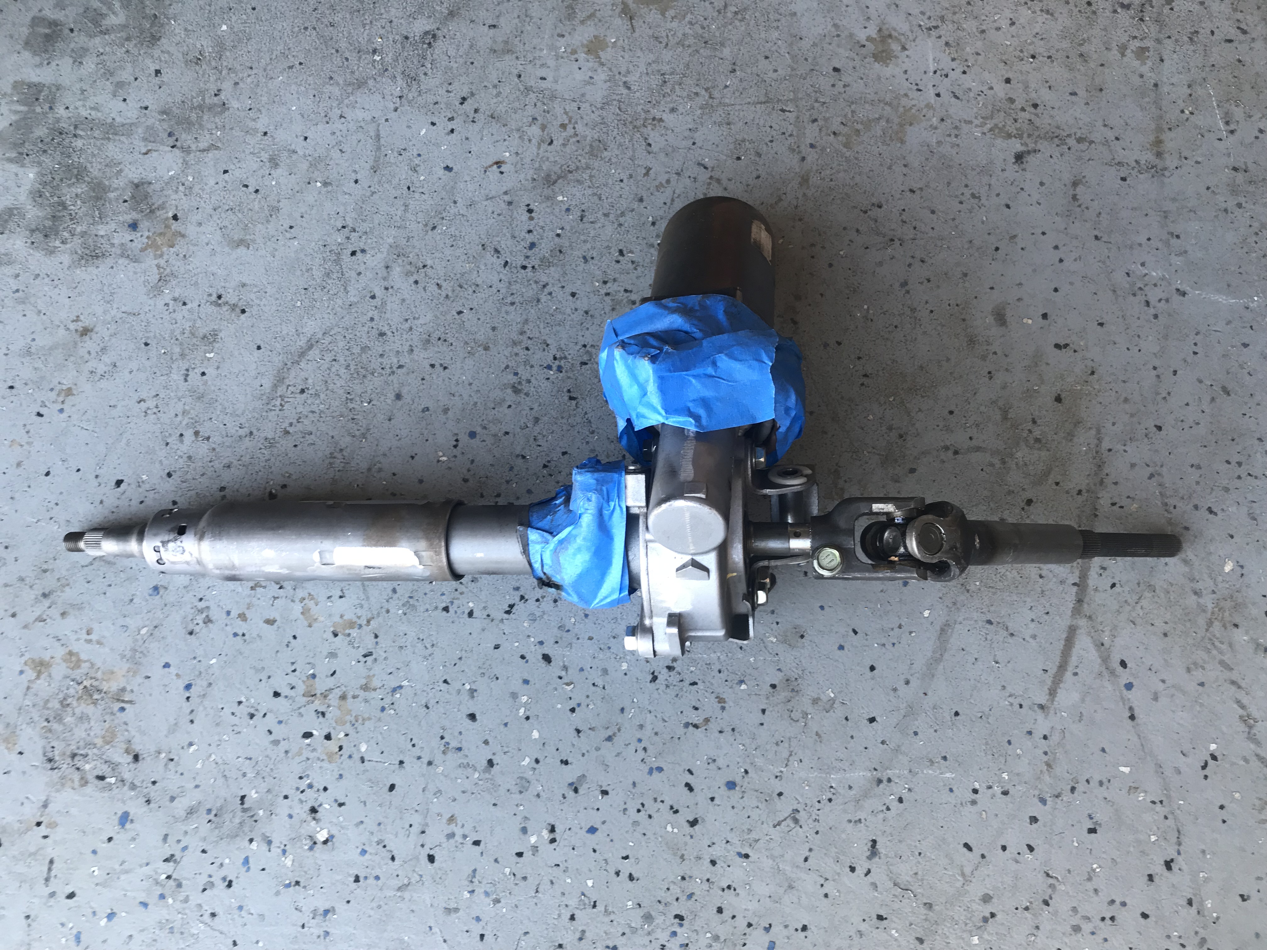

but seriously I need to figure out if the Prius steering column can be re'clocked ie spun / twisted around so that the motor points due North West instead of North East as it does now
any help/assistance is greatly appreciated, this job ain't gonna botch itself

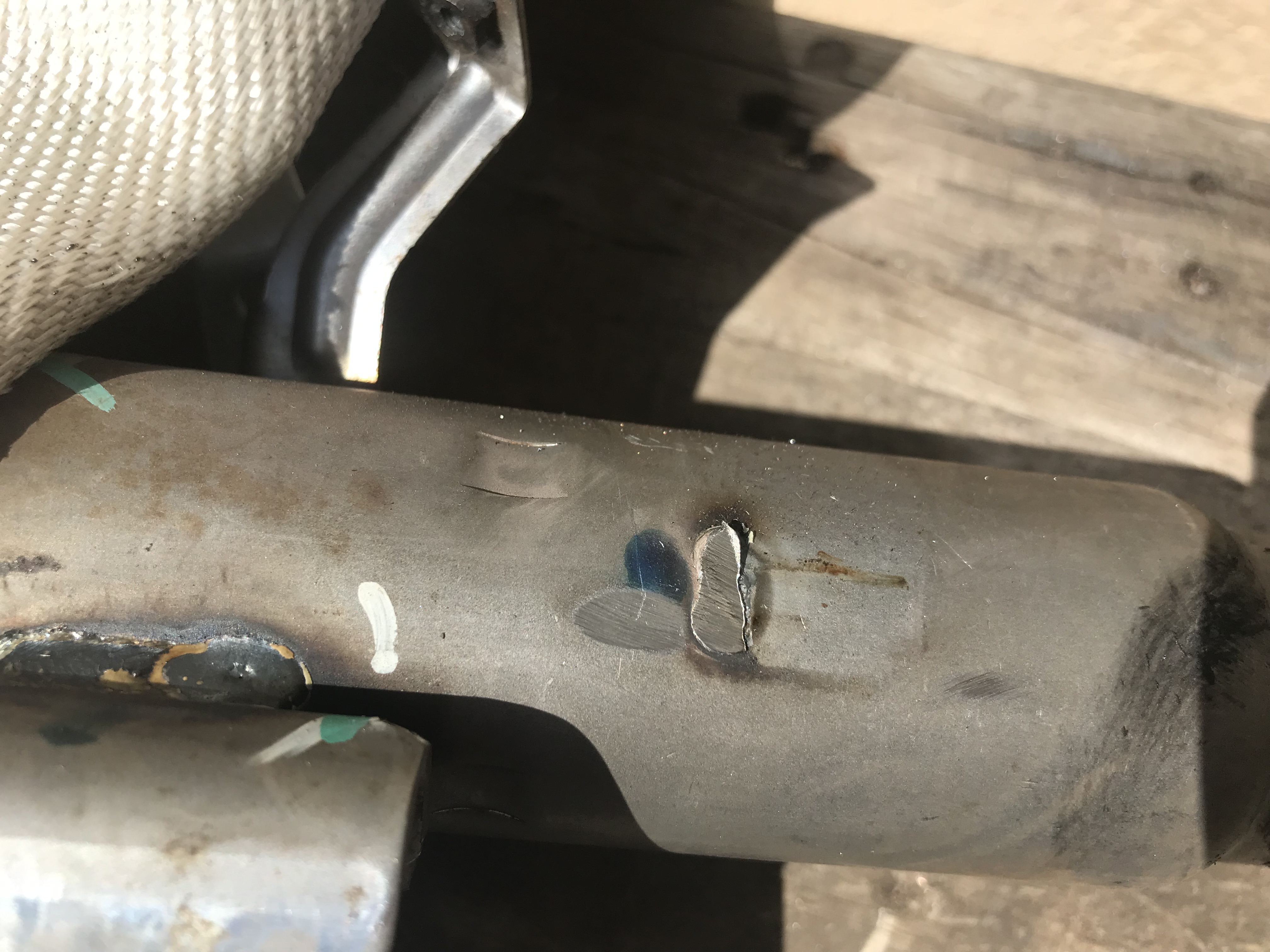

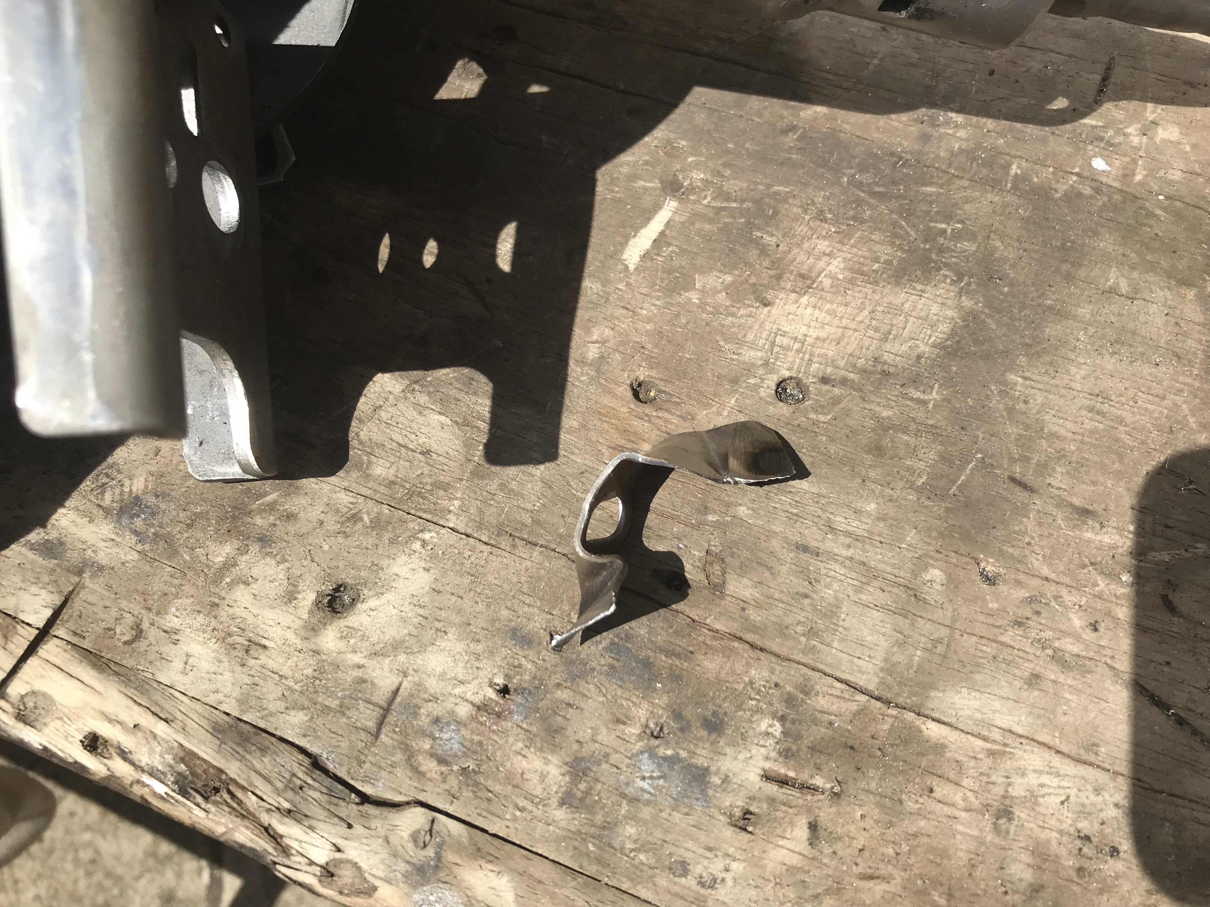

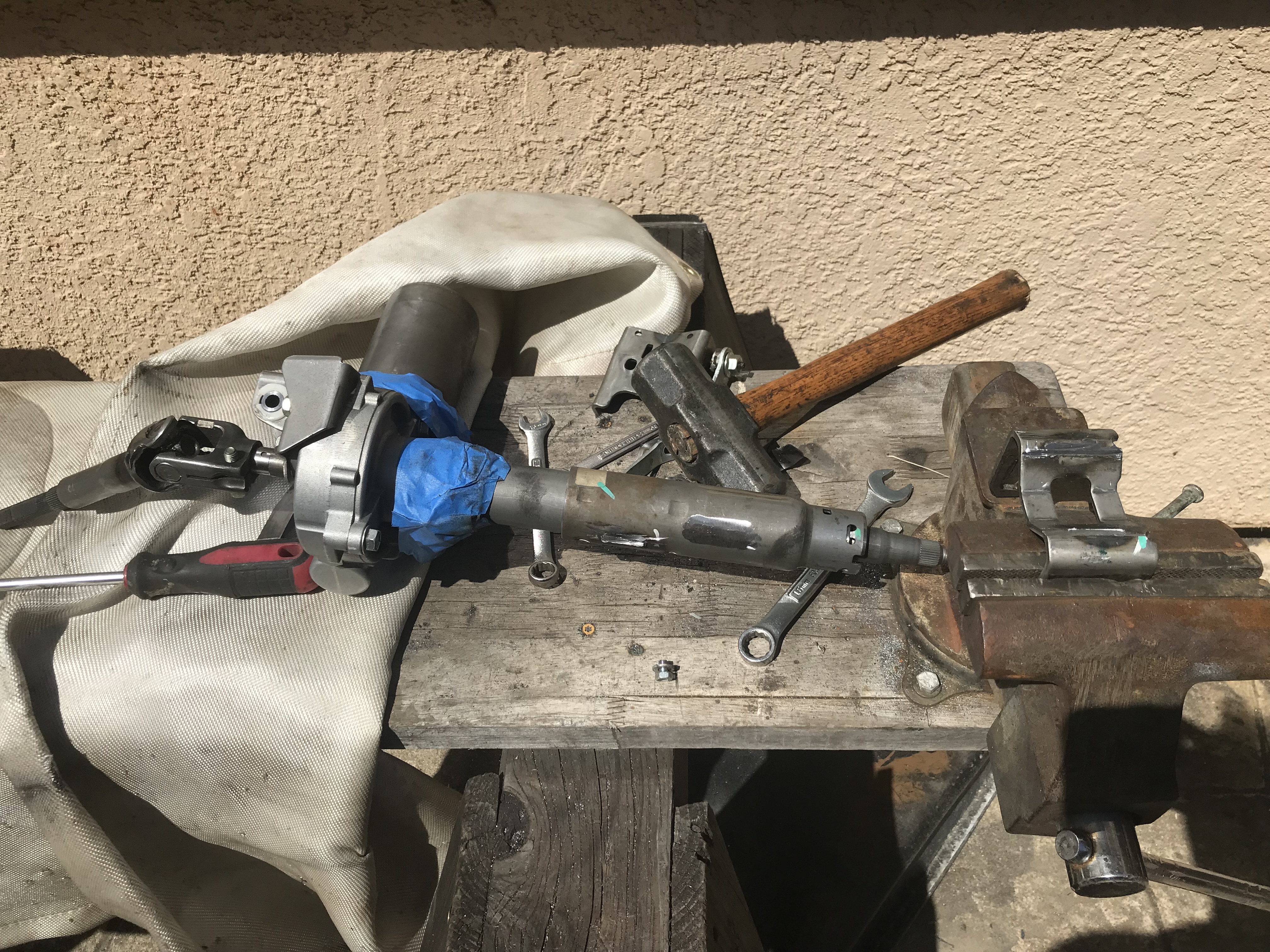

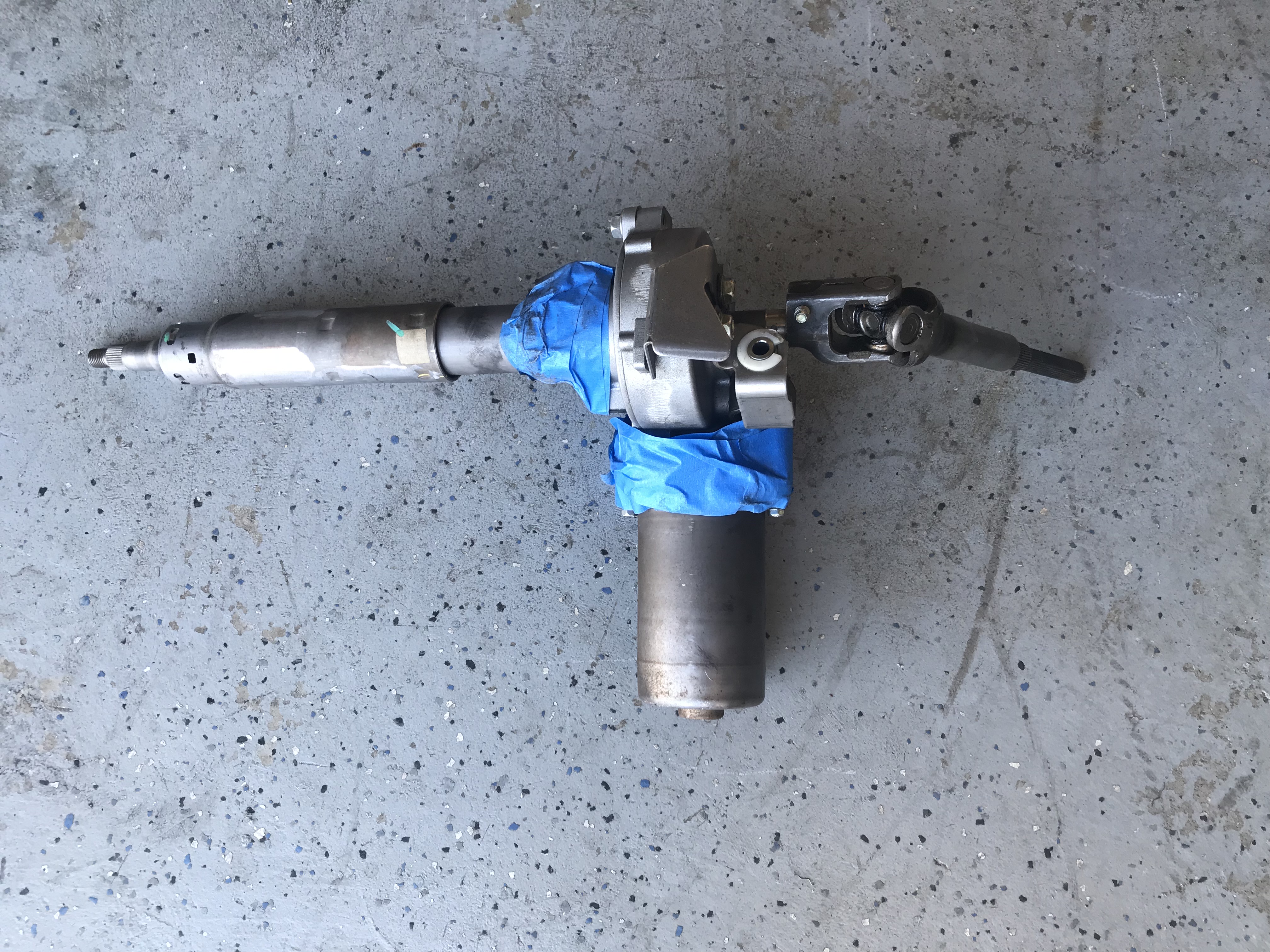

well looks like reclocking is pretty easy, just two bolts
Gregski
Posts: 3164
Post by Gregski »

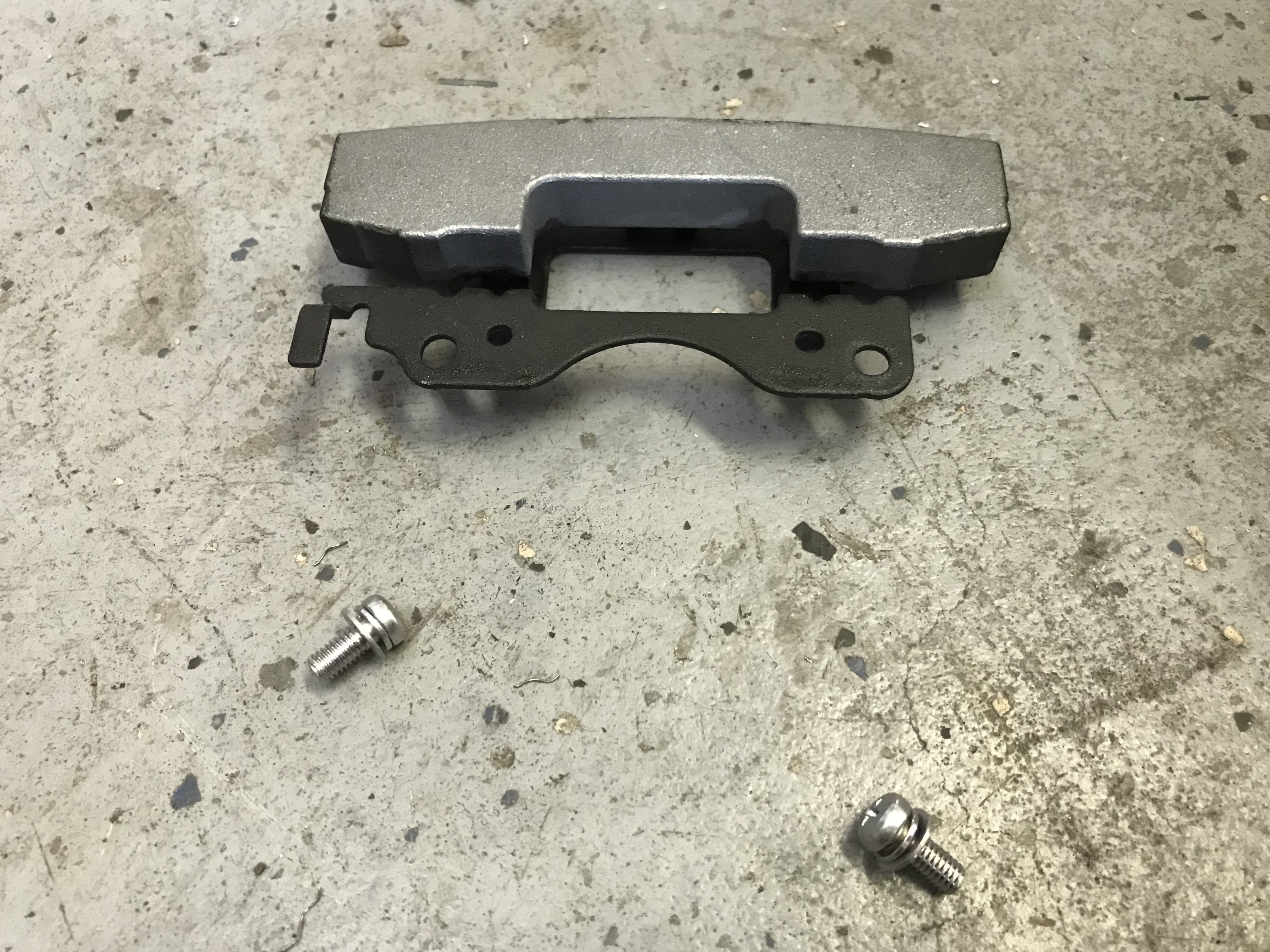

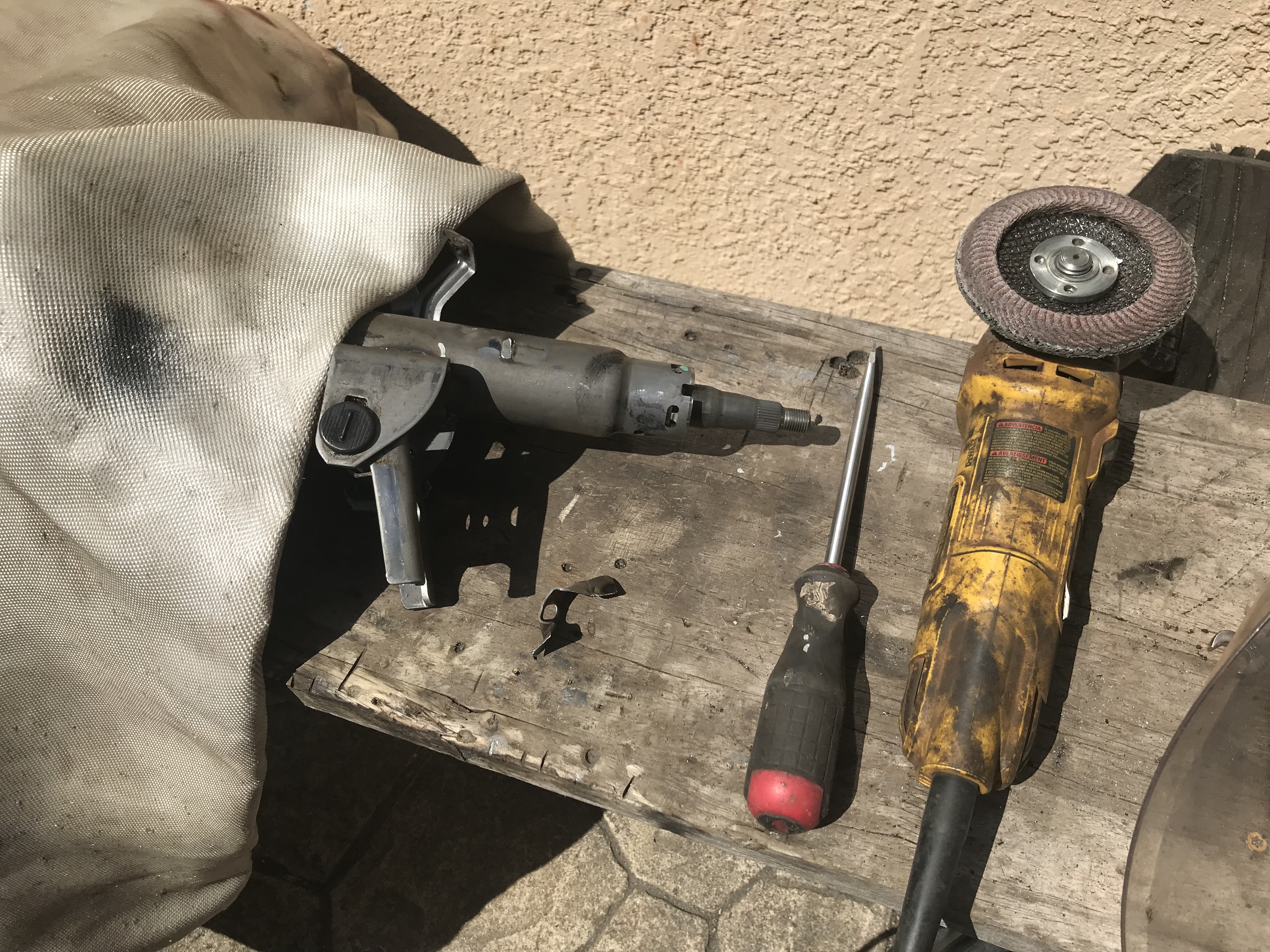

then it was time to give her a little shave
Gregski
Posts: 3164
Post by Gregski »
and another
Gregski
Posts: 3164
Post by Gregski »
Operation Kojak complete
