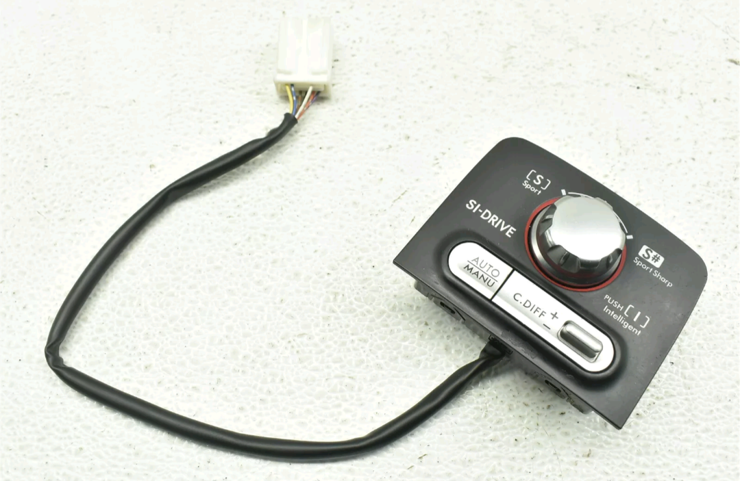

Re: ZombieVerter VCU Support
I want to integrate manual torque distribution in an AWD setup. Therefore I need 2 digital inputs.
Which ones can i use for this?
Also of course forward will be pin 53 and reverse 54, but as my switch is not permanent in the position, i would need a input for Parkimg, also. So für example if i move the button to the left once it's forward, to the right once them it's reverse and if i push the button, it's parking position where the gears are locked.
So I would need 3 digital inputs
-parking
-more torque in front
-more torque in rear
Which pins could I use?
-parking
Can you explain again what problem this refers to and how you fixed it? I don't think I have that issue.paaa wrote: ↑Sat Mar 12, 2022 1:28 pm The pwm for oil pump already worked for me , the inverter power relay doenst though. In other news that throttle mod listed above seems to work. Just playing with ramp settings now that car is moving. Streber or et0 are you able to roll my change into your pull or will I do a seperate one?
We have seen the "it can stick on full throttle in reverse" bug which I'm hoping is resolved before we try driving it...
Which drive are you talking about? The GS450H for example has a mechanical lever to move for park position.Zapatero wrote: ↑Tue Mar 15, 2022 7:58 am I want to integrate manual torque distribution in an AWD setup. Therefore I need 2 digital inputs.
-parking
I think you could write code to use pin 50 "GP 12V input" to select neutral, change the forward and reverse commands to be latching direction, and add a control from Analog 1 in. to be a potentiometer joystick to add extra torque (or just wire it in parallel to the thottle inputs).
There switch would be this one which doesn't remain in the positions: The buttons to move torque to front and rear aren't analog, so more digital inputs would be helpful. Of course I could add a resistor ladder, but first i would like to try to go with digital inputs of they where available.et0 wrote: ↑Tue Mar 15, 2022 10:39 am
I'm using two outlander motors with gearboxes.
Well, it's out of my knowledge because I never heard of the Outlander motors being used with this project before...Zapatero wrote: ↑Tue Mar 15, 2022 3:53 pm The buttons to move torque to front and rear aren't analog, so more digital inputs would be helpful. Of course I could add a resistor ladder, but first i would like to try to go with digital inputs of they where available.
But in general, there aren't many spare pins on the VCU so you would have to make do with what is there (use analogue as digital for example).
Would it not be more effective to use a dial rather than switch much like the subaru DCCD worked. Could be analog in high is torque to rear only ,middle both front and rear and low is front? Also would need some tweaking to code as you will probably need to repurpose the can normally used for vehicle integration as both inverter can live on same can network without a can bridge readdressing one.Zapatero wrote: ↑Tue Mar 15, 2022 3:53 pmThere switch would be this one which doesn't remain in the positions:et0 wrote: ↑Tue Mar 15, 2022 10:39 am
