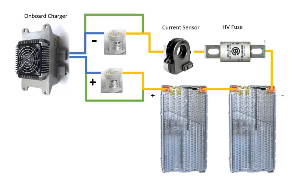

Hello, folks.
Love the SIMPBMS! I was looking through the manual and found that it can be configured based on the different setup of the contactors.
I was planning to put my contactors (+ve, precharge and -ve) inside the battery box and drive them with the Demien's openinverter Tesla SDU controller. Reading this made me realise I need to somehow engage the contactors for charging. Is anybody else driving the main contactors from different sources - inverter, BMS, etc.?
Also, do you know if I need to go through the pre-charge stage when charging?
Thanks in advance.

Re: Simp BMS
if you are counting your charger and inverter threw the same contacts, then yes you'll need precharge for the inverter. you can never directly connect hv to a power stage without first precharging.alexbeatle wrote: ↑Mon Jan 10, 2022 11:27 pm Also, do you know if I need to go through the pre-charge stage when charging?
but i would not recommend you have your charger wired with the inverter. your power stage would be "on" when charging.
you could have the charger negative connected to the negative contactor, and the positive to the positive end of the battery(with or with out a additional contactor.) this way theres no hv at the inverter when charging.alexbeatle wrote: ↑Mon Jan 10, 2022 11:27 pm I was planning to put my contactors (+ve, precharge and -ve) inside the battery box and drive them with the Demien's openinverter Tesla SDU controller.

So my charger is actually a 6kWh charger + DC/DC combo - Elkton TC. The DC/DC will provide the 12VDC to the system, which is why now think that I should let SIMPBMS control the contactors, but use enable signals for the charger and the drive, to select one or the other.Bratitude wrote: ↑Tue Jan 11, 2022 12:32 amif you are counting your charger and inverter threw the same contacts, then yes you'll need precharge for the inverter. you can never directly connect hv to a power stage without first precharging.alexbeatle wrote: ↑Mon Jan 10, 2022 11:27 pm Also, do you know if I need to go through the pre-charge stage when charging?

As long as the the inverter is controlling it’s own contactsors. if something else where to switch the main contactors off during drive, there’s a high Possibility of the inverter blowing up.alexbeatle wrote: ↑ let SIMPBMS control the contactors, but use enable signals for the charger and the drive, to select one or the other.

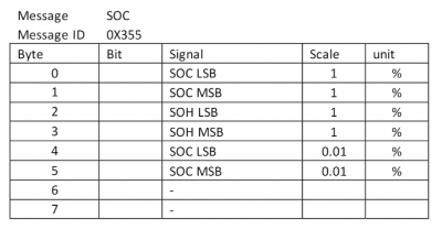

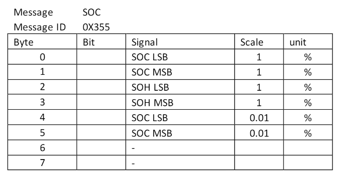

- RandallATX
- Posts: 9
- Joined: Wed Aug 25, 2021 1:57 am
Re: Simp BMS
I'm asking Polykup to add support to their MCU for Simp, but in order to do that, they asked the following question:
What is the proper byte for SOC? From the manual it looks like there are multiple Also, what's the difference between LSB and MSB?
- EV_Builder
- Posts: 1205
- Location: The Netherlands
- Been thanked: 37 times
Re: Simp BMS
Easy...RandallATX wrote: ↑Mon Jan 31, 2022 11:28 pm I'm asking Polykup to add support to their MCU for Simp, but in order to do that, they asked the following question:
SOC = State Of Charge.
Grab the 0.01% one.
Byte 4 and Byte 5.
Together they make a 16 Bit INT with 0.01% resolution.
Couldn't Polykup come up with this?
