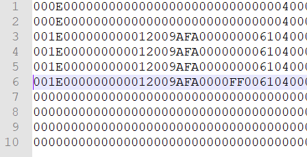

Looking at it now, that graph is weird.
In one direction the Blue/Grey graphs match, in the reverse direction the Grey/Orange match...

OK I had a look at the 3 graphs this morning, so here's something to try, to see if we can get reverse/forward working. The old code never set byte 30&31. This can just be slotted in where we break up the MG2 torque value.
Would it be worth zero'ing the MG1 torque value till we figure out MG2? as we don't want them fighting each other? so just comment out where we set bytes 75,76,5,6,11,12. In fact maybe do this before putting in the change below, to make sure we are running on MG2 alone.

Is it responding to the throttle pedal?
Does it turn in reverse direction in both forward and reverse on the ecu or does it stop.

Ok so 3 sets of captures. All from a powered off stat.
1: power up with no hv and no torque request.
2:Power up, apply approx 62v hv , pause, shutoff psu hv decays.
3:Power up, apply approx 62v hv, put vcu in run, issue torque, motor turns, set torque to zero, switch off hv psu, hv decays, power off.
- bench_data_run.zip
- (227.81 KiB) Downloaded 201 times
OK, had a quick look at the HTM data, what's happening is due to that memcpy command not running, its not initialising htm_data[ ] array, so that's going back to all zeros after the first 6 frames.
So we either need to get the memcpy to work, or initialized the htm_data struct, with the last line from the 2D array.
- htm_no_init.PNG (8.37 KiB) Viewed 4769 times
So where htm_data is defined we can add:-
unint8_t htm_data[100]={0,30,0,2,0,0,0,18,0,154,250,0,0,16,0,97,0,0,0,0,0,0,200,249,56,6,165,0,136,0,63,0,16,0,0,0,63,0,16,0,3,128,0,0,0,0,0,0,0,0,0,0,0,0,0,0,0,0,0,0,0,0,0,0,0,0,0,4,0,0,0,0,16,0,75,12,45,248,21,6,0,0,16,0,0,0,202,0,211,0,16,0,0,0,134,16,0,0,130,10};
The reason memcpy is not working is probably due to one of the pointers being bad, so it might be a copy and paste error by me.
