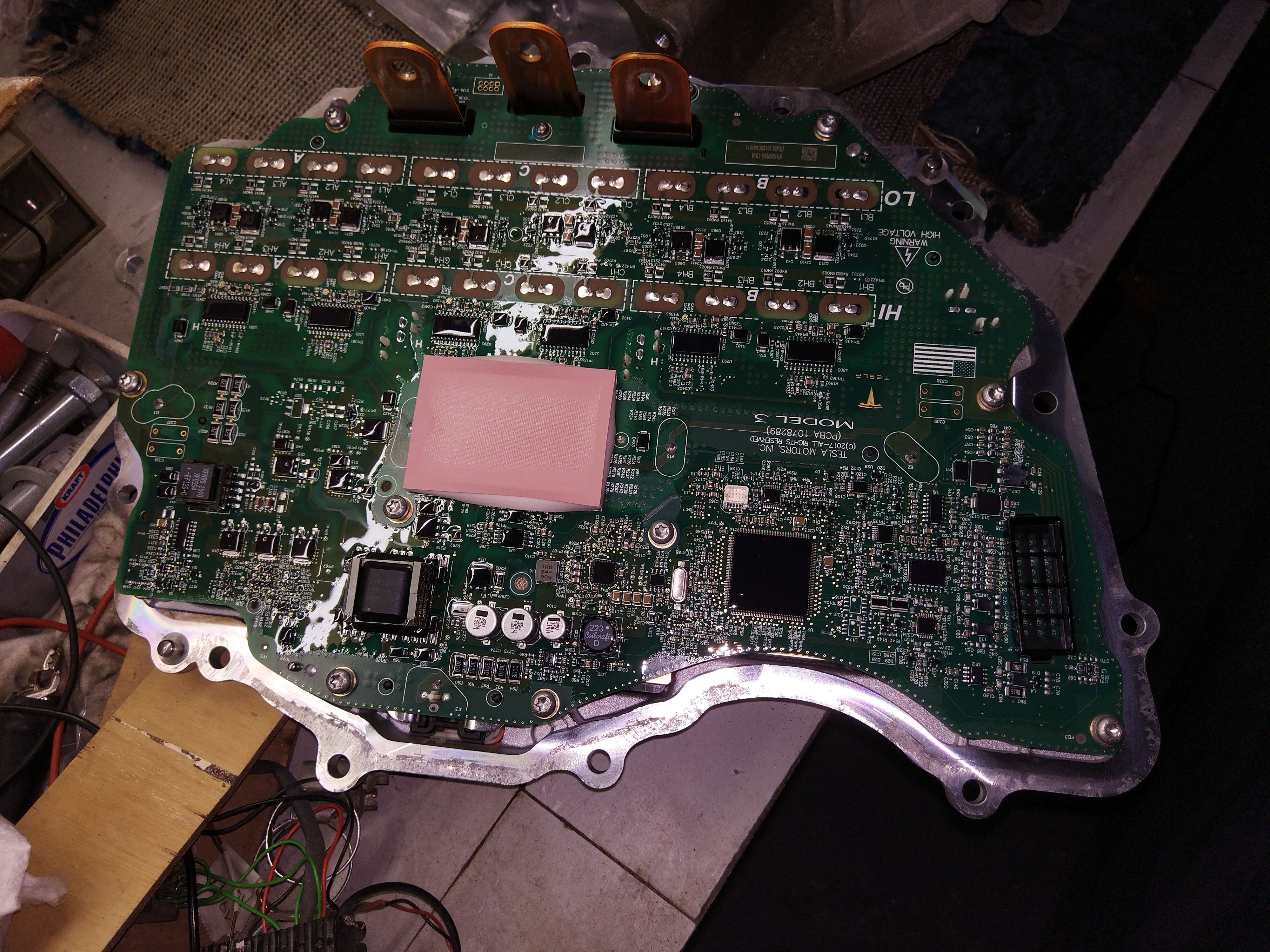

Managed to get myself a second dev board this week.
Along the way I discovered the existence of Torx Plus® and that this is different from regular external Torx®. This is important for getting at the inverter without damage. :facepalm:
Still to source a wiring harness. Was going to try to replicate some of Damien's work interrogating the Musk Brain then try and fill in some gaps in my understanding of how Tesla use the TI chip. Any discoveries will come in PRs and wiki updates obvs.
Kicking myself for not grabbing a genuine TMS320F28377 from a distributor. Due to the semi shortage they're all gone for now. Eyeing up AliExpress listings warily...

Trying to understand why it is necessary to change the processor if Ingenext can reprogram the inverter?
“Take the best that exists and make it better”
- Bratitude
- Posts: 1156
- Location: Canada
- Has thanked: 246 times
- Been thanked: 469 times
being that you send your inverter to ingenext to be “reprogrammed” they may as well be replacing the telsa lockd Texas Instruments processor with a reprogrammed generic one.
Unless they have figured out a back door threw Tesla’s lock down
mikeselectricstuff
- Posts: 120
Looking at the datasheet, once secured, the chip is protected by a 64 bit password.
Not clear what Ingenext are doing - could be they've figured out how Tesla updates firmware over CAN, found/hacked the password, or maybe they're swapping the chip.
Maybe someone could ask him?
- JaniK
- Posts: 404
- Has thanked: 101 times
- Been thanked: 15 times
If I have understood the inner workings, they could emulate (replacement) motor pairing and pair the motor to their controller instead of reprogramming it fully. Hence need for original model3 pedal and brake switch..
- If replacement of the processor, why need for original accessories?
So the motor would have a original Tesla software running, but just think the new control box is the car original control unit, VCU if you prefer. (Like if a motor would be replaced in warranty etc.)
I could be also completely wrong. But it looks like it to me.
Maybe the protection is too hard to crack, in order to rewrite the TMS320 fully..
Not perhaps totally impossible task to write openinverter software without removing The TMS320, but very hard..

They may have found a way to recreate the security matching procedure and their module is effectively a matched setup like a key is to each vehicle.
At least they give the rear motor loom part number
1067968-01-E
1067968-01-E

No need to ask him, another video I found explains most of how to get said password.mikeselectricstuff wrote: ↑Fri Sep 24, 2021 8:19 pm Looking at the datasheet, once secured, the chip is protected by a 64 bit password.
Tesla use the same firmware password on all their TI Microcontrollers, it's hidden inside their "toolbox" software.
As per usual with Tesla hardware, people with said password/software aren't sharing it, so fat lot of good it does us.
In theory it should be easy:
1) Get something with a Tesla locked C2000 MCU, ideally a TMS320F28377D.
2) Get said password, as don't need the hassle/liability of the entire firmware/software library that comes with Toolbox.
3) Get devboard to suit said C2000 MCU, so it can be re-programmed. Or at least an isolated JTAG.
4) Plug said C2000 chip into a PC to wipe the Firmware locks.
None of this is exactly easy, but has been made harder than it should be.
1) Yeah I don't have the money to buy Tesla hardware, so short of finding something in a bin and mailing it to me, not an option.
2) Secret Tesla Hacker business actually get your hands on this, to keep anyway.
3) isolated JTAG I have, proper devboard requires sucking up to PCBWay some more (or just more money).
4) Actually easy for once.
Long term idea would be to make some closed source dedicated JTAG programmer, wipes the password, installs new firmware and gets returned in the mail.
