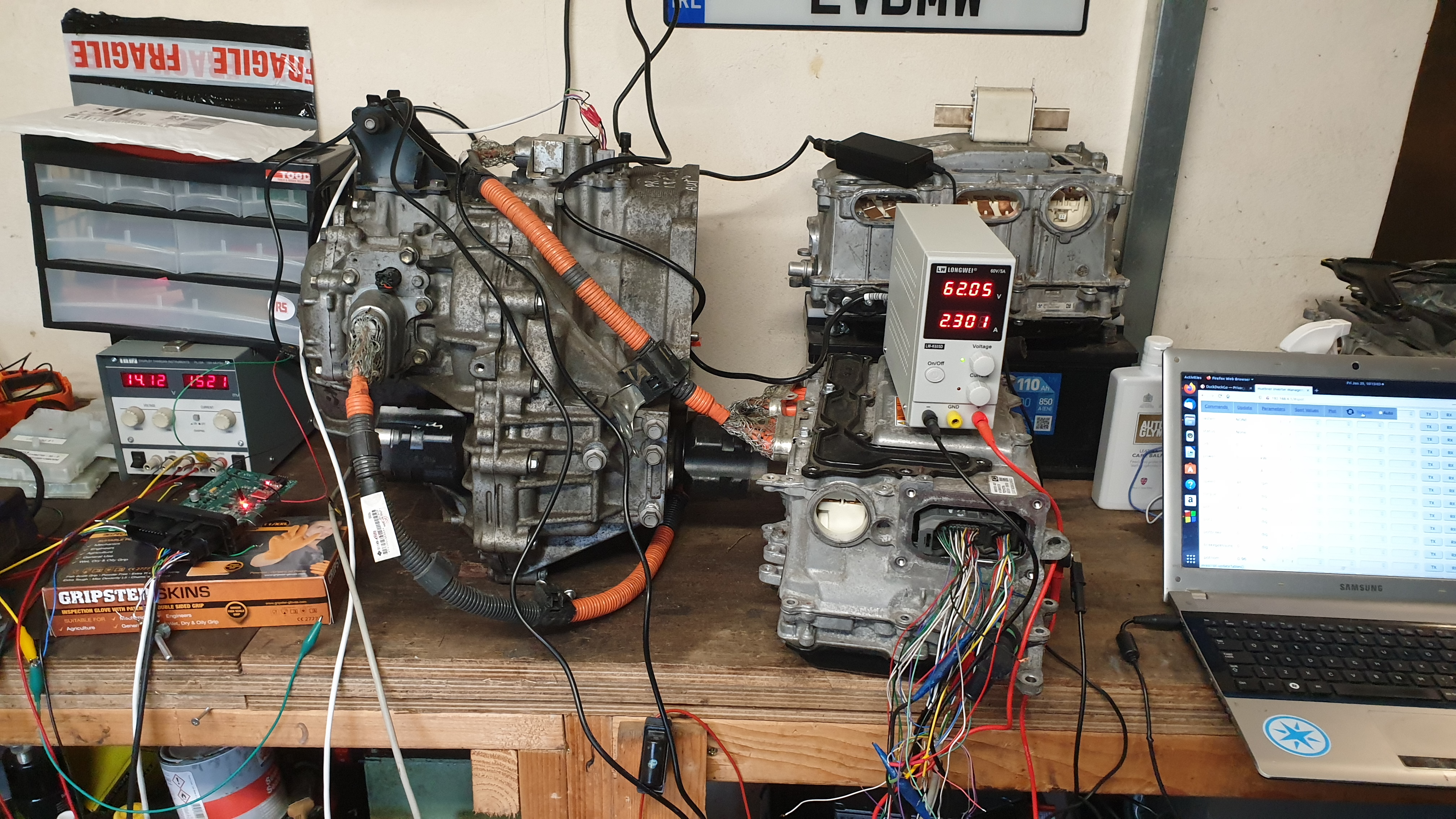

OK on the 100 byte HTM frames, i can recover valid data from all 4 of them. 3 had an extra byte at the start, but once that is taken out the data looks good.
On the MTH frames it seems to repeat after 120 bytes which is good, but i'm still looking at it now.
OK all frames now check out, both MTH and HTM. There was a shift of 1 or 2 bytes at the start of some of the MTH frames, but once i removed that all of the checksums and data look good. Also knowing about the heart beat counters made it easy to identify the checksums etc...
Frame formats for MTH look to be similar across all the boards which damian tried this morning, which is a good sign too!
I've attached a zip of the data in CSV format if anyone is interested.

I've also had a quick look at the HTM data, we know some of the values need tweaking but it also looks good.
In the htm_prius_bench3 and htm_prius_bench4 i can see byte 94 operating as the heartbeat counter, incrementing every 2 frames as i would expect. It also wraps around to 0 after 512 frames too. That doesn't seem to be happening in the htm_prius_bench2 file, there must be a reason for this, possibly an older version of software was used to generate it.

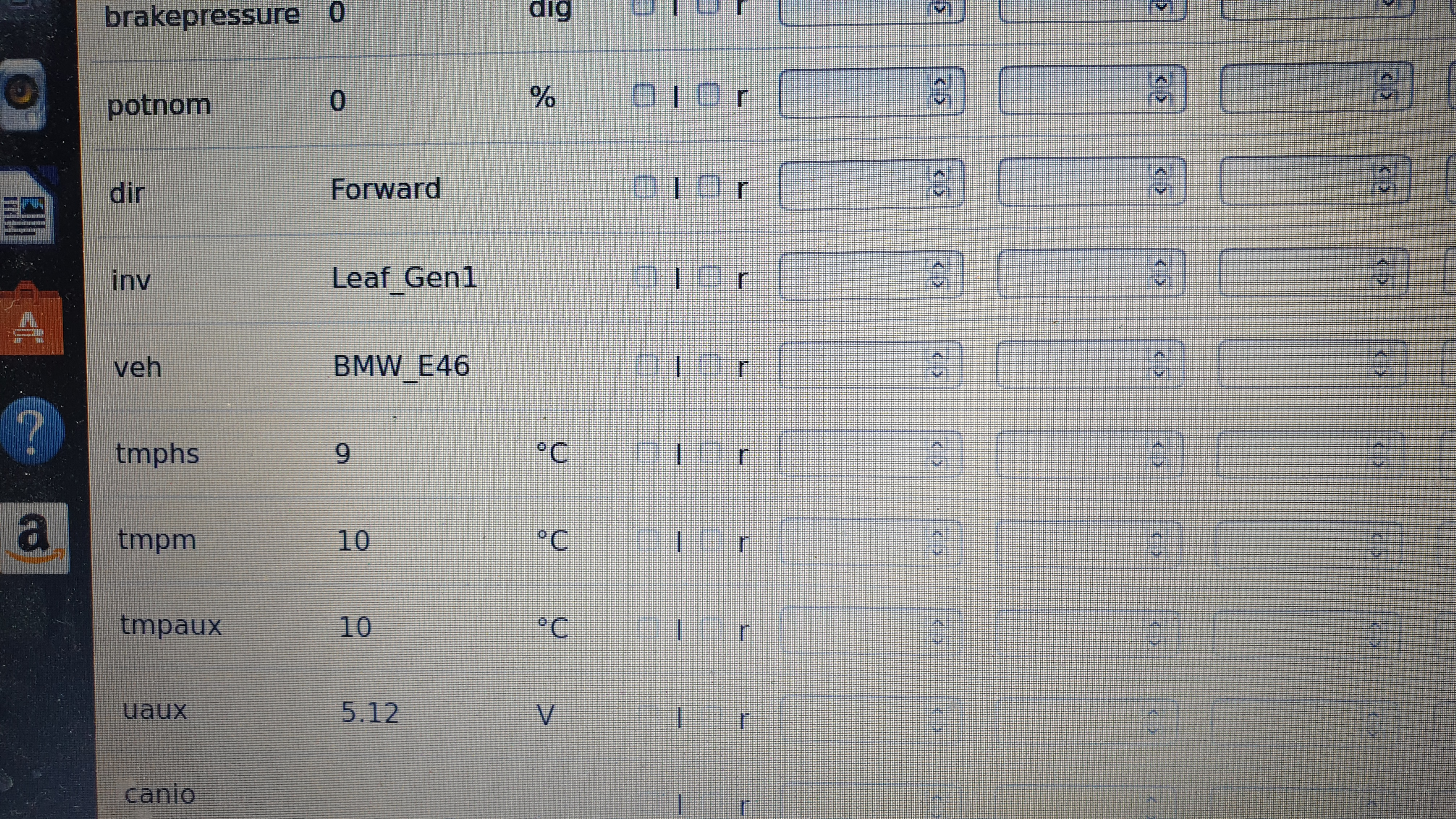

So on the E46/Leaf front we are precharging and switching and sending torque commands to the leaf inverter. Sadly its not responding as I'm sure I have screwed up the messaging somewhere along the line. Good news is we are receiving valid data from the inverter. I have pushed a few updates to the repo :
-Display pot and pot 2 in off mode to allow throttle calibration
-using the digital inputs to indicate ignition on/off (t15) status for startup and shutdown.
-fix v2 and v3 voltage readings from the isa shunt.

Edit : fixed isa shunt v2 and v3. its was the Damien classic : signed value in an unsigned variable.............

OK i flipped back to look at the HTM data again, and i done up a difference spreadsheet between when i just started the car and didn't drive and when i drove it in EV mode. This highlights what needs to change to make MG2 go!
I've taken the top 7 rows of the HTM data from the Auris, i believe only the first row is init data (but it seems to be sent twice) and put them into a 2D array, along with some code mods. hopefully this will bring the inverter to life and we get some inverter whine!
//set inv_status = 0
inv_status = 0;
uint8_t htm_data_init[7][100]={
{0,14,0,0,0,0,0,0,0,0,0,0,0,0,0,0,4,0,0,0,0,0,0,0,0,0,0,0,0,0,0,0,0,0,0,0,0,0,0,0,0,4,0,0,0,0,0,0,0,0,0,0,0,0,0,0,0,0,0,0,0,0,0,0,0,0,0,4,0,0,0,0,0,4,0,25,0,0,0,0,0,0,0,0,0,0,136,0,0,0,160,0,0,0,0,0,0,0,95,1},
{0,30,0,0,0,0,0,18,0,154,250,0,0,0,0,97,4,0,0,0,0,0,173,255,82,0,0,0,0,0,0,0,16,0,0,0,0,0,0,0,0,4,0,0,0,0,0,0,0,0,0,0,0,0,0,0,0,0,0,0,0,0,0,0,0,0,0,4,0,0,0,0,0,4,75,25,60,246,52,8,0,0,0,0,0,0,138,0,0,0,168,0,0,0,1,0,0,0,72,7},
{0,30,0,0,0,0,0,18,0,154,250,0,0,0,0,97,4,0,0,0,0,0,0,0,0,0,0,0,0,0,0,0,16,0,0,0,0,0,0,0,0,4,0,0,0,0,0,0,0,0,0,0,0,0,0,0,0,0,0,0,0,0,0,0,0,0,0,4,0,0,0,0,0,4,75,25,60,246,52,8,0,0,0,0,0,0,138,0,0,0,168,0,0,0,2,0,0,0,75,5},
{0,30,0,0,0,0,0,18,0,154,250,0,0,255,0,97,4,0,0,0,0,0,0,0,0,0,0,0,0,0,0,0,16,0,0,0,0,0,255,0,0,4,0,0,0,0,0,0,0,0,0,0,0,0,0,0,0,0,0,0,0,0,0,0,0,0,0,4,0,0,0,0,255,4,73,25,60,246,52,8,0,0,255,0,0,0,138,0,0,0,168,0,0,0,3,0,0,0,70,9},
{0,30,0,2,0,0,0,18,0,154,250,0,0,16,0,97,0,0,0,0,0,0,200,249,56,6,165,0,136,0,63,0,16,0,0,0,63,0,16,0,3,128,0,0,0,0,0,0,0,0,0,0,0,0,0,0,0,0,0,0,0,0,0,0,0,0,0,4,0,0,0,0,16,0,75,12,45,248,21,6,0,0,16,0,0,0,202,0,211,0,16,0,0,0,134,16,0,0,130,10}
// put into case 6
if(inv_status>5)
if (dma_get_interrupt_flag(DMA1, DMA_CHANNEL7, DMA_TCIF))// if the transfer complete flag is set then send another packet
dma_clear_interrupt_flags(DMA1, DMA_CHANNEL7, DMA_TCIF);//clear the flag.
dma_write(htm_data,100); //HAL_UART_Transmit_IT(&huart2, htm_data, 80);
else
dma_write(&htm_data_init[ inv_status ][0],100); //HAL_UART_Transmit_IT(&huart2, htm_data_setup, 80);
inv_status++;
if(inv_status==6){
memcpy(htm_data, &htm_data_init[ inv_status ][0], 100);

Cool:) Will test this morning. So i overwrite what is in case 6 with the above and likewise htm_data_init?
Yea i think the old init data was in an array called htm_setup, which isn't used anymore....

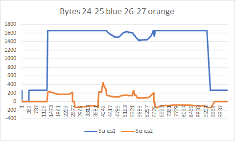

I've also found some interesting data that gets sent just before the vehicle starts to drive, i believe when it comes out of park. It is sent right beside the torque command for MG2, see attached graph. The hybrid control module also sets this variable for one cycle at row 3, but i think that might be a bug in their code.
- htm_drive_1.png (11.17 KiB) Viewed 5538 times
I wonder could the blue line indicate some sort of limit value, as my foot was probably on the brake when it drops down.
On that drive cycle, i went back and forth in the drive a few meters, then went out of the driveway onto the road and reversed back in.

ok, well the bad news is when i uploaded the firmware with the mods it locked up the processor. My eagle eye had spotted the memcpy instruction earlier so on a hunch i commented it out purely to see if it let the processor bootup. It did...AND THE INVERTER IS NOW AWAKE AND WHINNING AT ME!!!! No response to a torque command as yet but its alive! Dilbert, you sir are a steely eyed Toyota man:)
- Posts: 4000
- Been thanked: 1115 times

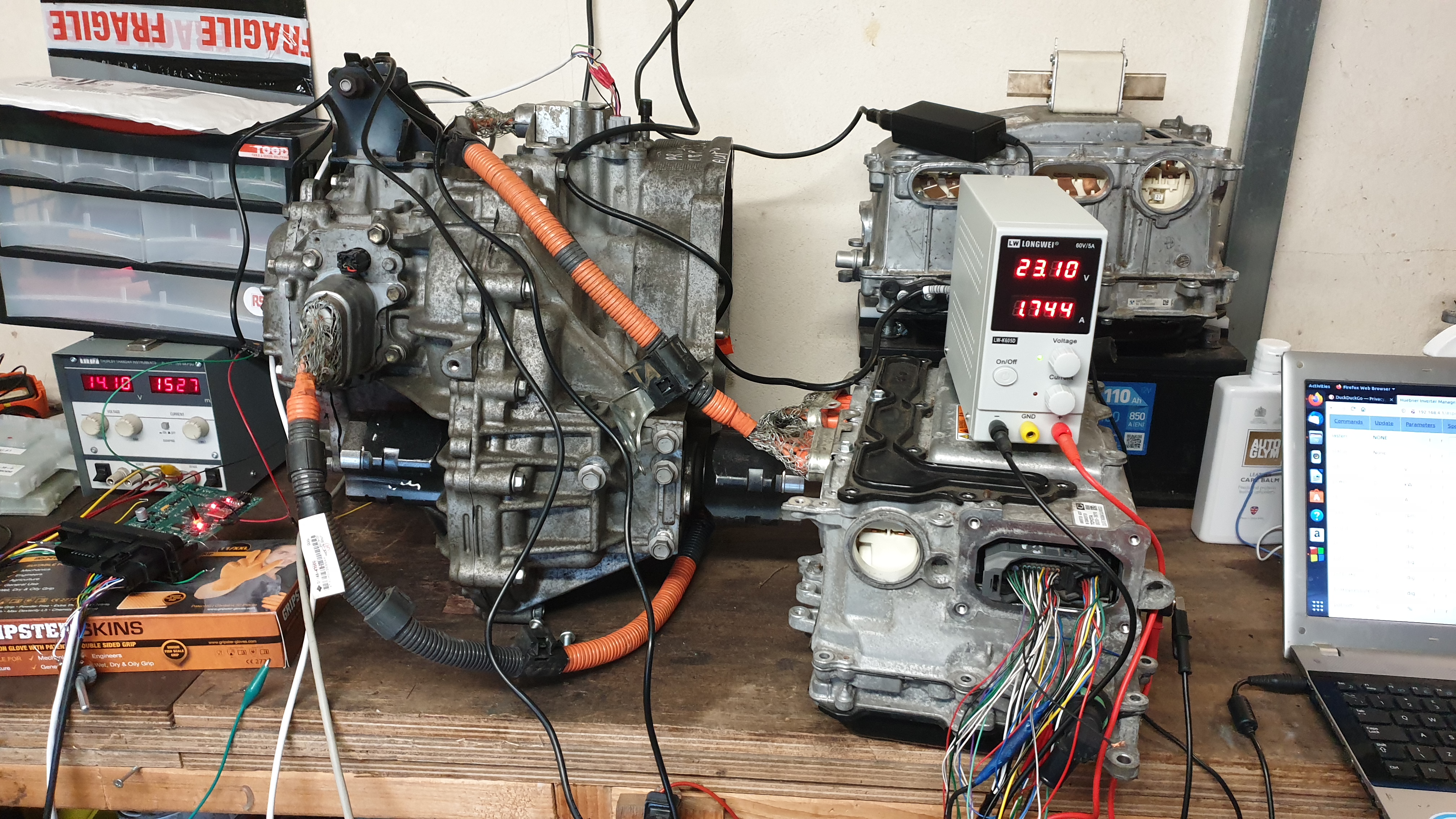

Scratch that its turning!!!! I didn't have the vcu in run mode!
ya can't beat a replay attack!
A few more things to figure out in the HTM and MTH data streams, but its looking good.
I want to put the MTH return data which Damien grabbed yesterday into an excel file, so we can see if they all send the return info in the same places
Its interesting that it worked without the memcpy in there, we could just put the last row of data from the 2D array in as the htm_data default values.
- Posts: 4000

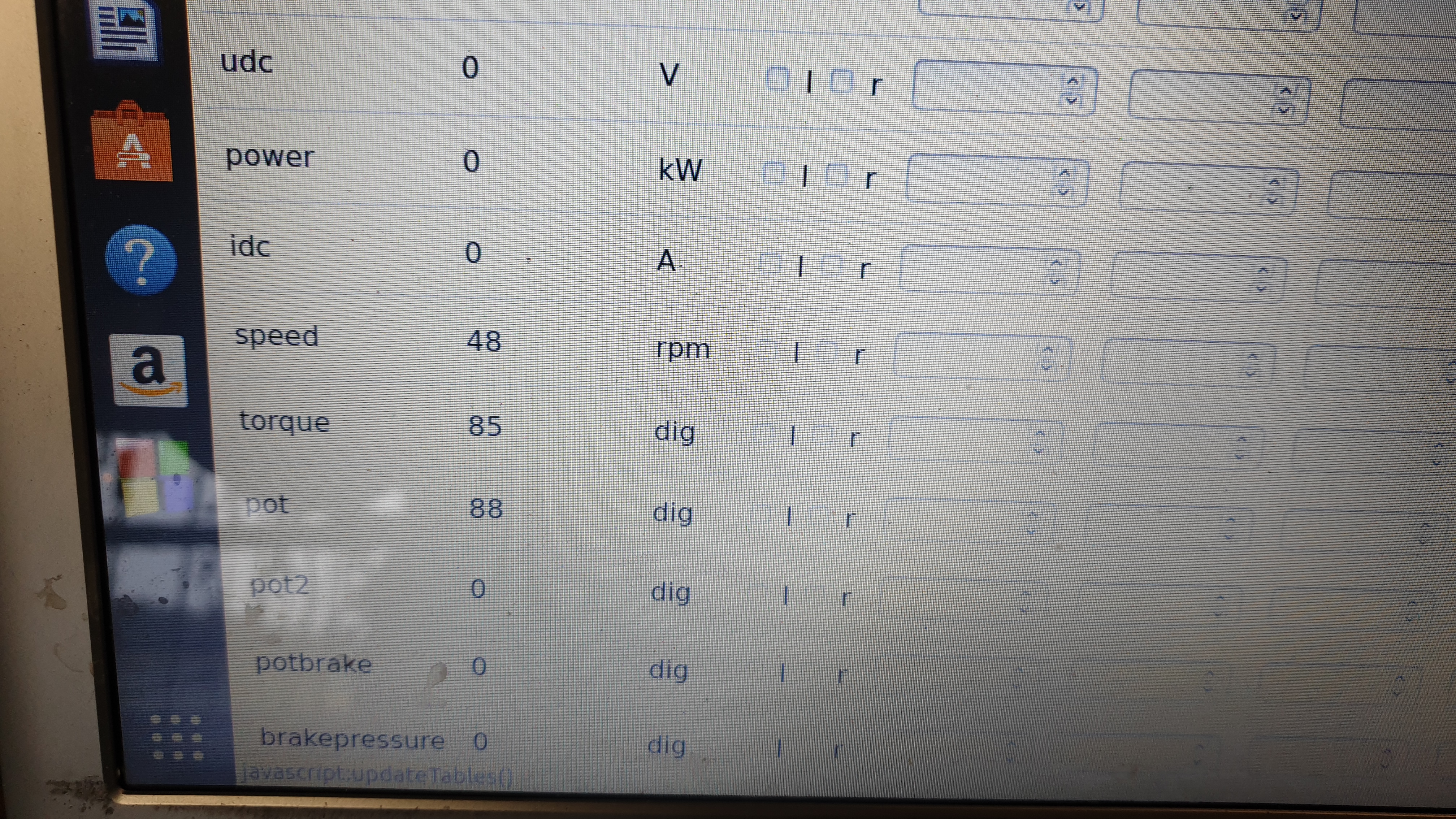

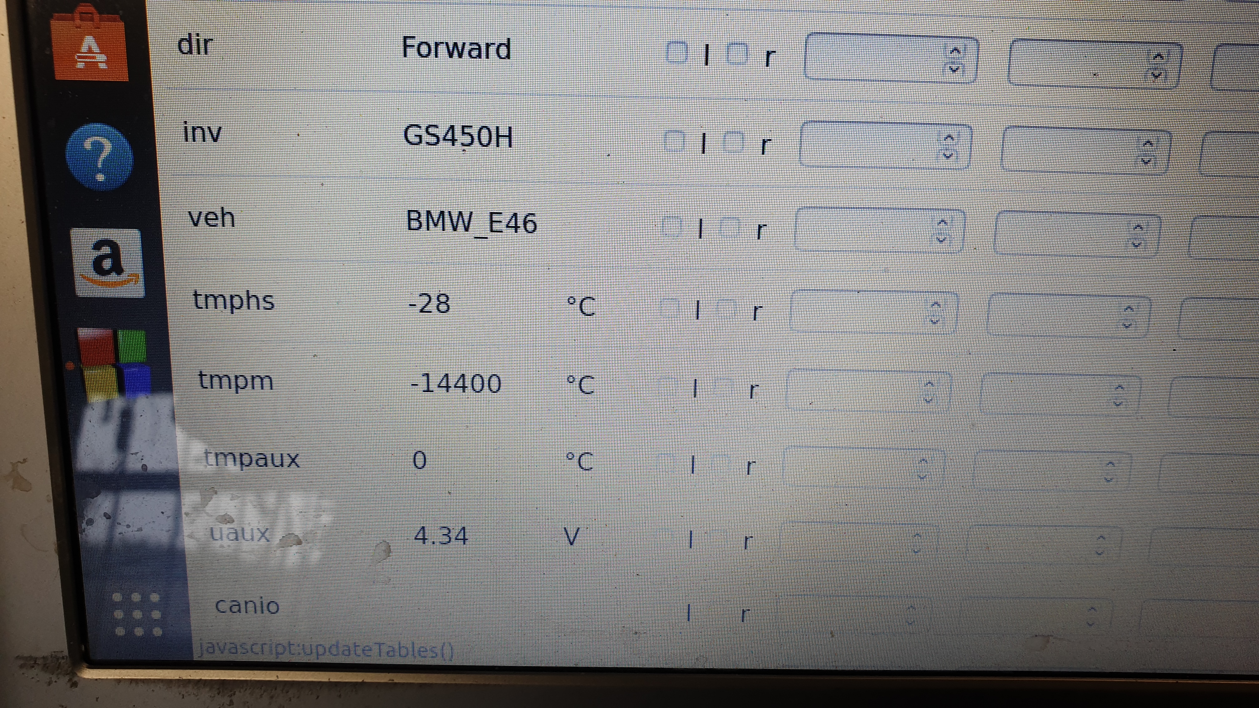

Yeah its running away on the bench like it was all in a days work:)
Few quick notes :
-like the gs450h it doenst care about dc bus voltage
-it also doesnt care about any of the interlock wires. just give it 12v and sync serial and its your pal.
-rpm seems stuck at 48 for now likewise heatsink temp reading wrong buts thats all small fry.
Few quick notes :
- Posts: 4000

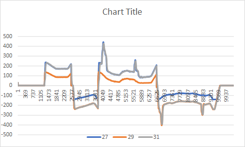

So we are running in what would be reverse in the vehicle and it doesnt respond to "reverse" torque. Also worth noting this transaxle has a welded psd so mg1 is being turned also.
I've plotted the torque values for MG2 and they seem to be sending the same value 3 times. One of them seems to be 1/2.
