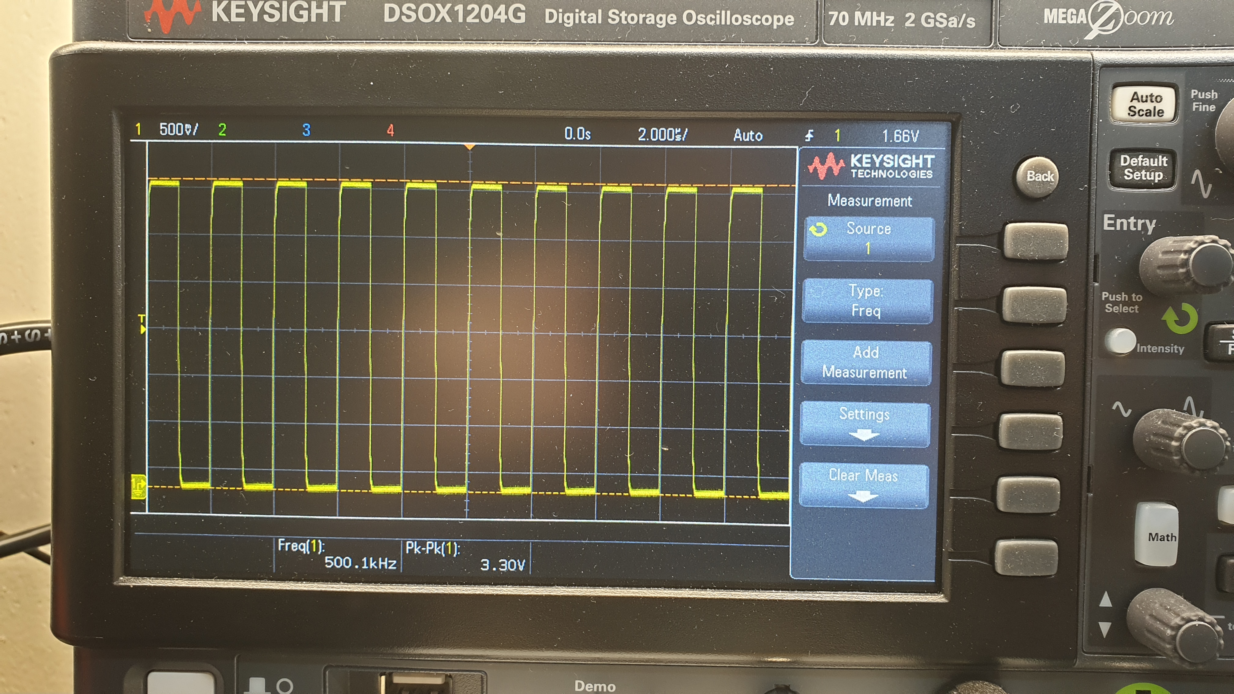

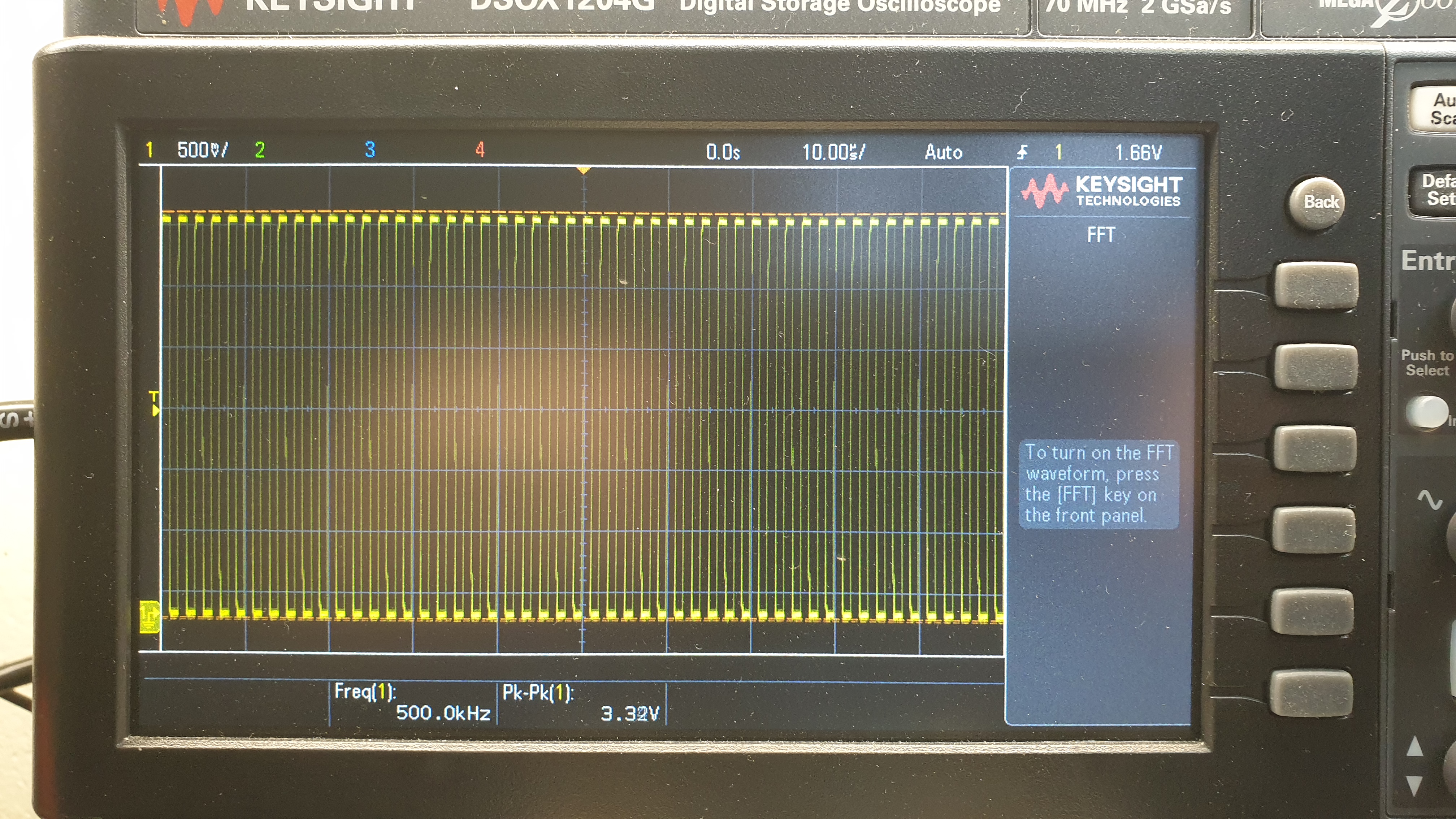

I think that possibly the transfer clock of the FTDI cable and VCU aren't exactly matching. I know on the VCU here i did scope the CLK pin and saw 500KHz (or very very close), i'm wondering is that clock slightly off and we are getting a few extra bits received. Maybe measure it with a scope and set the FTDI baud rate based on that.

About as close to 500khz as we can get I reckon. Scope is calibrated so should be accurate.

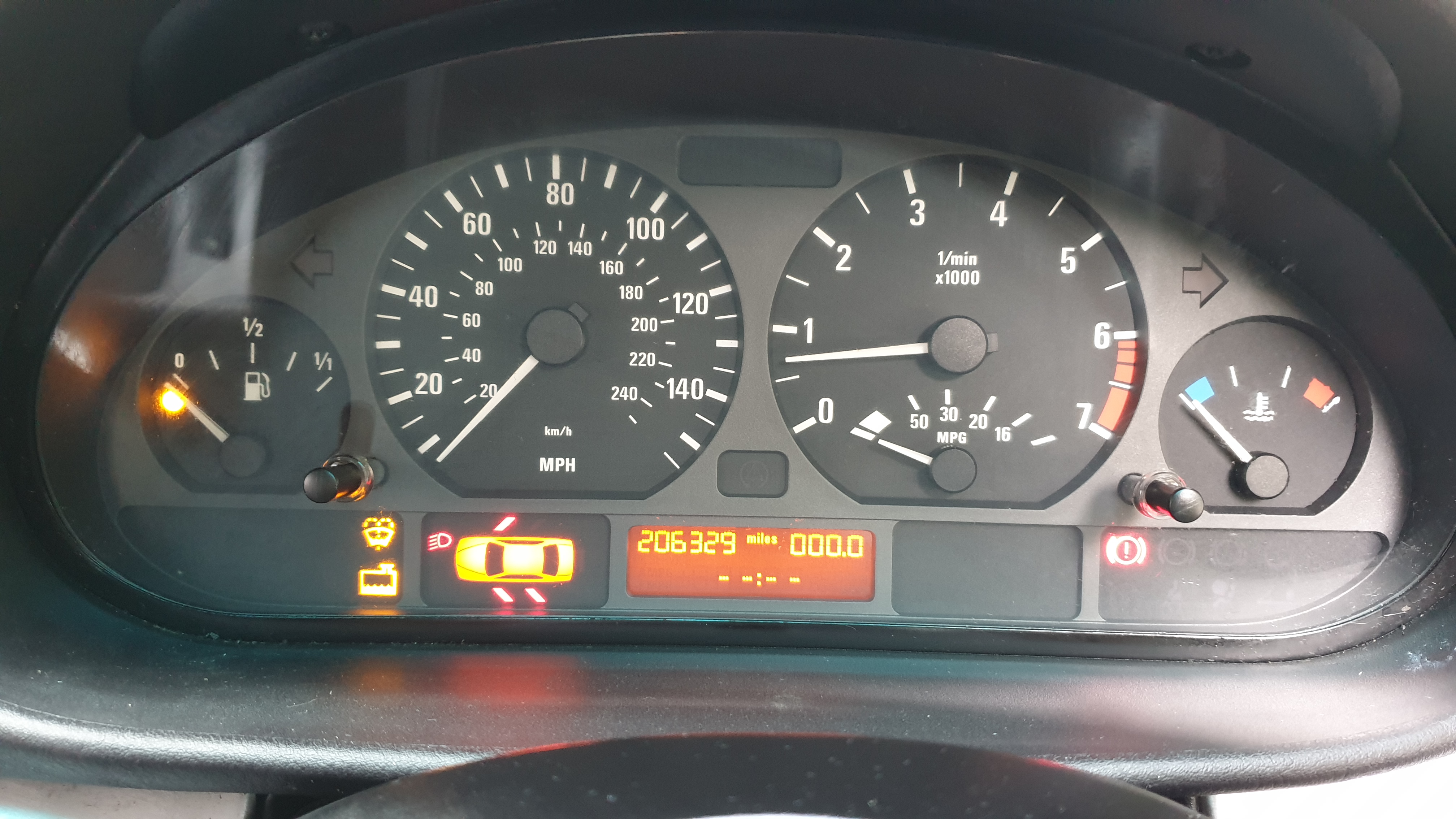

First power up in the E46. Good news is vehicle side can seems to be working well. Bad news : I'm outta gas :D
