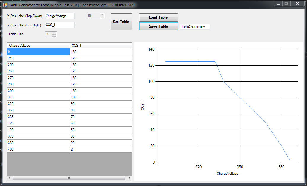

Ok lets start first with a Simple 2D one.
GUI app is done.
Now the C++ Class which will be fed with this data :).
This can be used for all sort of mappings/tune-ings not only charging so i kept it Universal. (so maybe a move to the VCU section is better?).

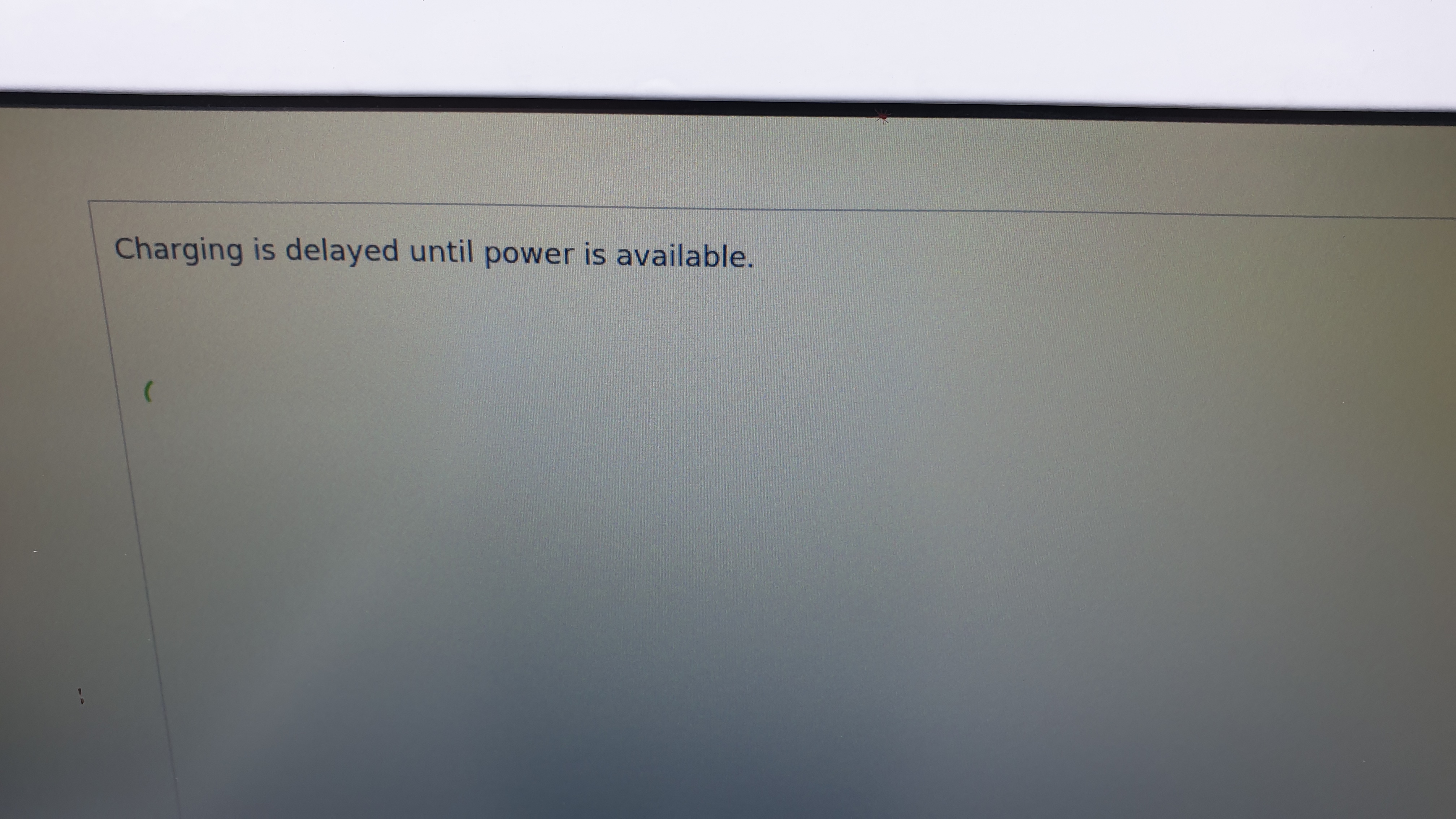

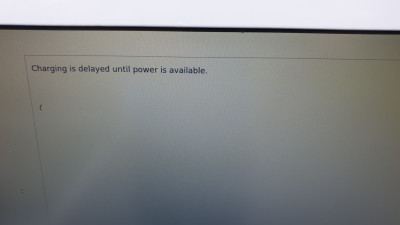

Found some flags in LIM can messages for :
Current limit reached,
Voltage Limit reached,
Power limit reached,
Battery fault,
Charger fault.
Also I have a contact in the company who run the Tritium units and go this response re yesterday's 8 amp issue :
I have just reviewed the status of your charging attempts and the following error message is being received 'the voltage which defines the control pilot state is incorrect - vehicle side suspected to be at fault'.

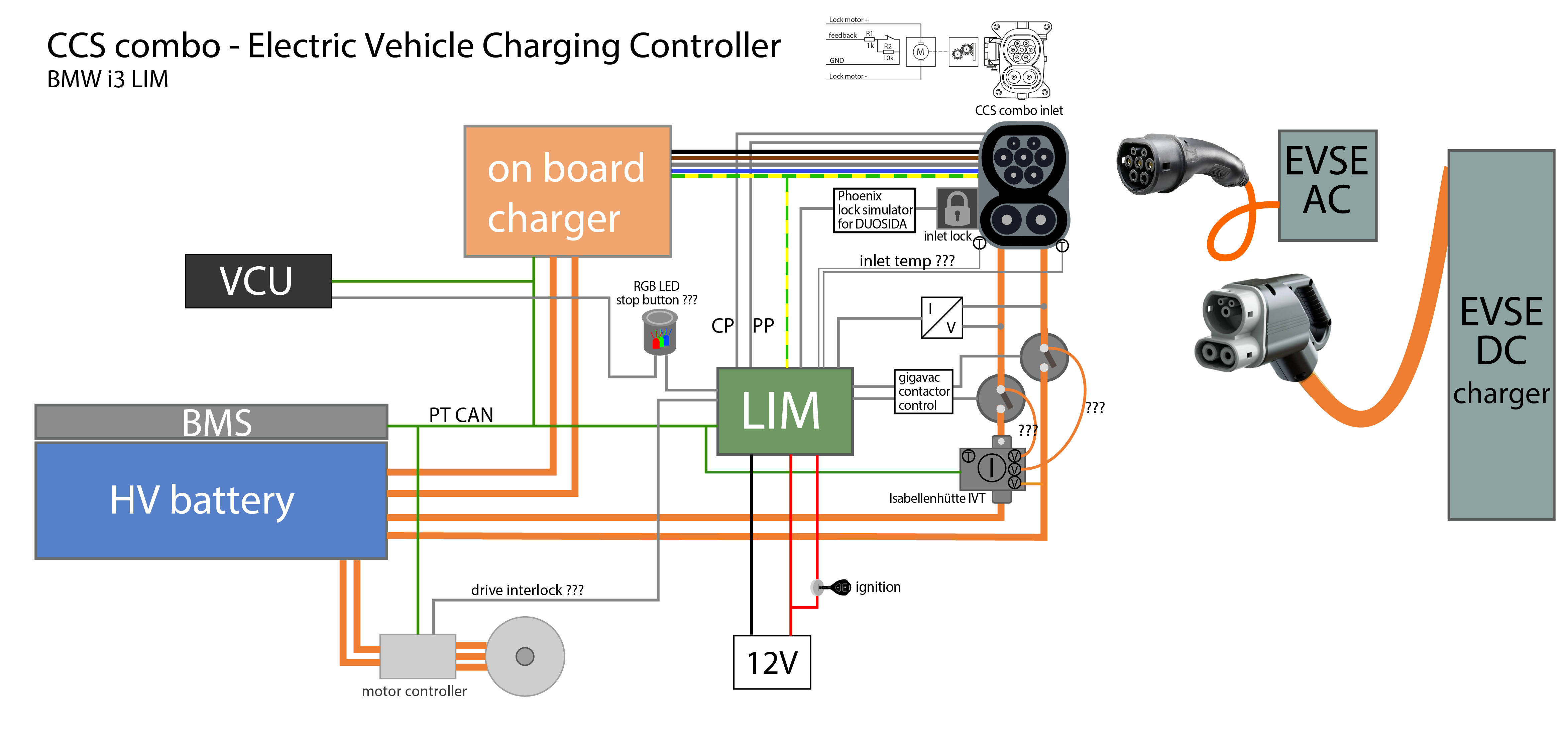

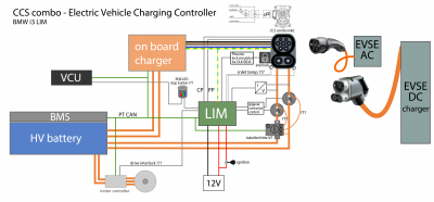

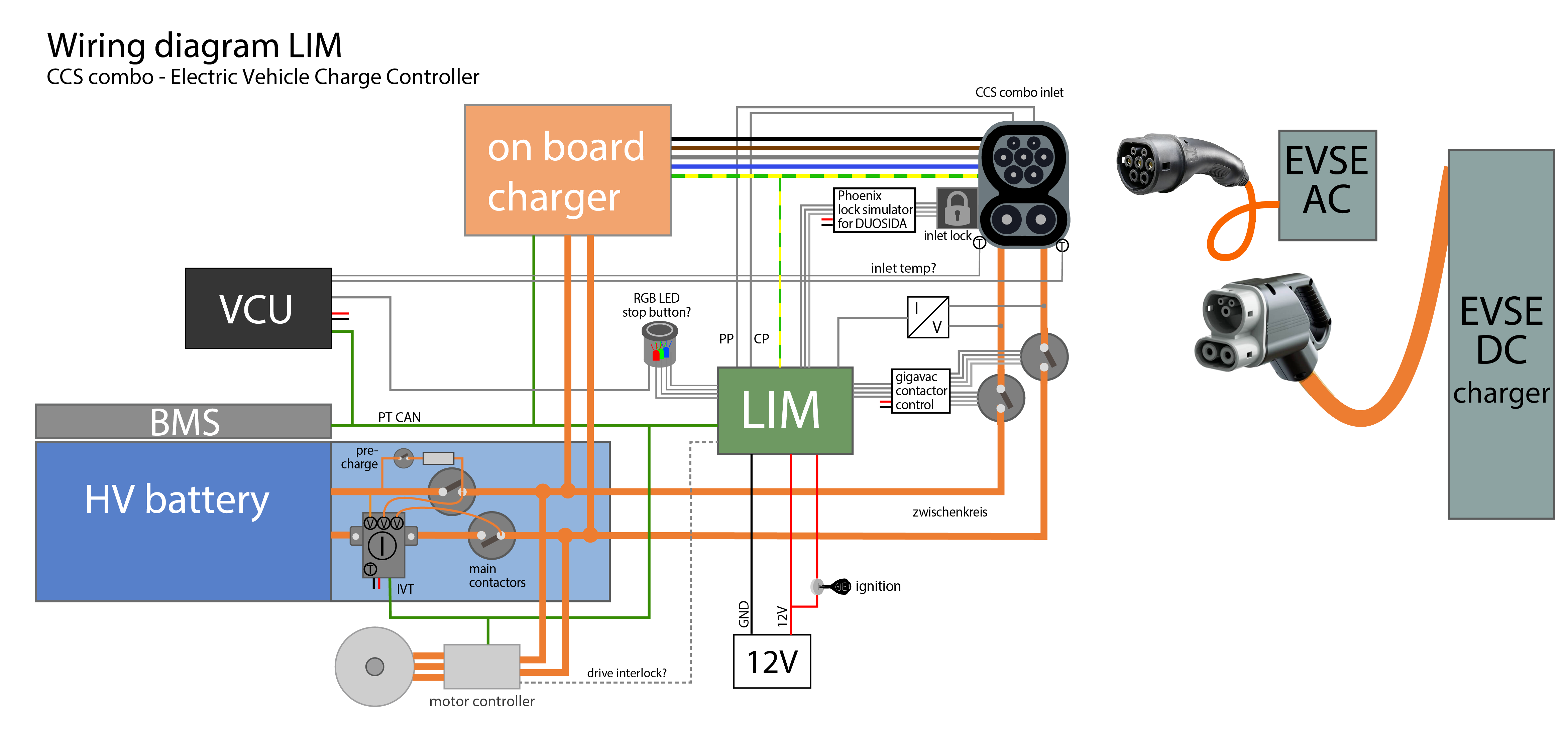

Post by bitterandreal »
I have a few questions:
- Has someone tested to directly control the DUOSIDA servo lock with the LIM?
Is it enough if I add the two resistors to the lock feedback?
- How about the RGB LEDs? Can I wire it without additional series resistors? How much current can the LIM deliver?
- Since there is no stop charge input on the LIM, could we wire the stop charge button to the VCU and terminate the session over CAN?

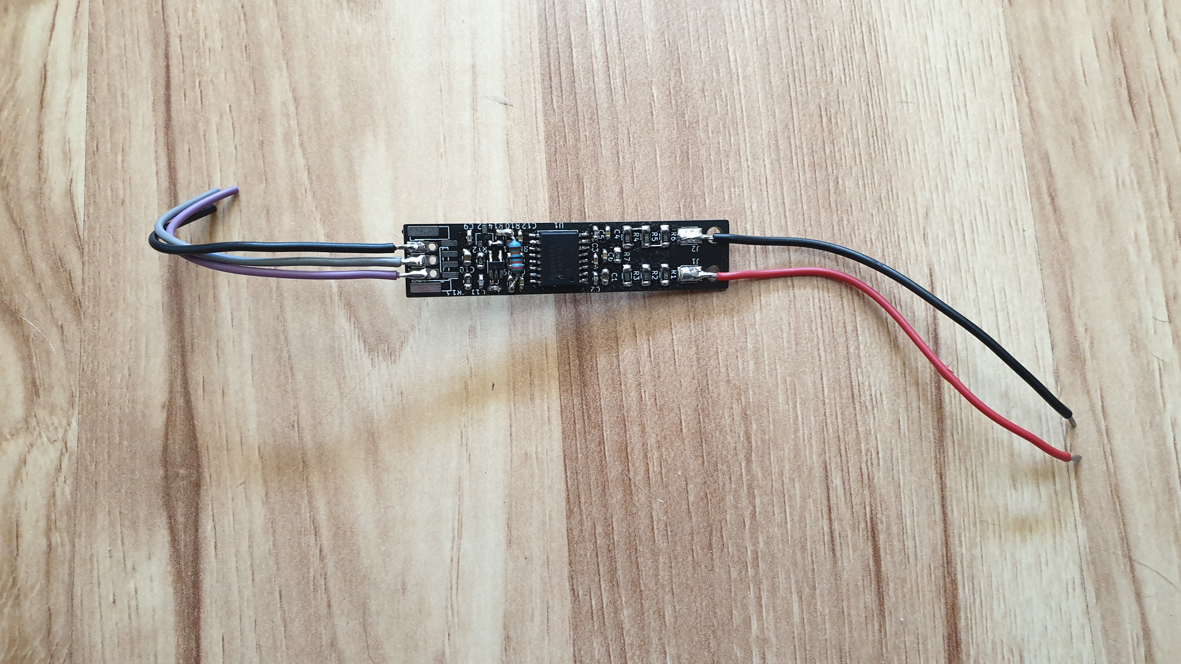

- @muehlpower how far is the design of the voltage sensing board?
We could also measure the inlet voltage with the Isabellenhütte IVT and generate the current signal from the information on the CAN bus if we want.
- Are you using the Gigavac contactor feedback signals to emulate contactor failure?
- Does the i3 measure the CCS inlet temperature? Are there any thoughts about it?
- Are there any ideas about a 12V drive interlock signal?
Attached a basic schematic CCS setup with the LIM.

muehlpower
Posts: 807
Has thanked: 18 times
Been thanked: 186 times
Post by muehlpower »
your graphics are good and almost correct. You should also add the main contactors. Make the voltage inputs of the isa shunt between the main and DC contactors and the third voltage input directly to the battery. The main contactors must also be controlled including the pre-charge relay, e.g. from the VCU. On the charge port only the voltage is detected, no amps. On my LIM 1B-1 and 1B-2 are not connected (not populated on the LIM PCB) 1B-14 is in the LIM connectet to GND. 2B-6 is on US models (CCS-1) connected to PP (2B-2).
bitterandreal
Posts: 56
Joined: Fri Jan 15, 2021 2:30 pm
Location: Netherlands
muehlpower wrote: Wed Jun 16, 2021 12:42 pm your graphics are good and almost correct. You should also add the main contactors. Make the voltage inputs of the isa shunt between the main and DC contactors and the third voltage input directly to the battery. The main contactors must also be controlled including the pre-charge relay, e.g. from the VCU. On the charge port only the voltage is detected, no amps. On my LIM 1B-1 and 1B-2 are not connected (not populated on the LIM PCB) 1B-14 is in the LIM connectet to GND. 2B-6 is on US models (CCS-1) connected to PP (2B-2).
Thanks for the corrections. I changed the pinouts in the wiki.
Sure the main contactors need to be closed with a pre-charge first. Could be done by the VCU or by the BMS. Depending on the setup.
But does that matter for the LIM?
In which state is the LIM expecting the battery voltage on the zwischenkreis?
Is the timing when the main contactors are closed very critical?
All CCS setups I saw used the IVT to measure the voltage on both sides of the DC charging contactors. No additional voltage measurement was necessary.
As I understand the LIM has the voltage measuring board in the KLE and does expect both the battery and "zwischenkreis" voltage on the CAN bus. I changed the diagram.
Do you actually have the IVT on the battery side of the main contactors?

muehlpower
Posts: 807
Now it looks good to me!
In my opinion, it doesn't matter what the main contactor controls. It's not time-sensitive either. The LIM needs the analog signal for the voltage from the charge port to work, it is not enough to send something over CAN. It need also the feedback from the Charge port door on the right pin, simulatet or real. It only carge with open door and does the weld test only at closed door.

Can log time from the E46 at various charge points.
Efcaec QC45. Works perfectly : https://github.com/damienmaguire/BMW-i3 ... harge1.csv
Ionity ABB : Fails at init stage and display as per attached pic : https://github.com/damienmaguire/BMW-i3 ... _e461.2csv
Circontrol Rapiton 50 : Starts up, closes contactors, faults out. Now tested on 3 of these units they all do the same :
https://github.com/damienmaguire/BMW-i3 ... _fail1.csv

Jack Bauer wrote: Thu Jun 17, 2021 10:31 am Ionity ABB : Fails at init stage and display as per attached pic : https://github.com/damienmaguire/BMW-i3 ... _e461.2csv
That might not be the lim here!
I have seen that charging delayed message about 2weeks ago with Model 3 on a 50kw ABB unit when I started from the app. App showed it didn't start. Then after short while I tried again to start from the app and it said it cannot start because it is allready charging and indeed it started while app didn't seem to have a clue what is going on.
Did you start with app or tag?
Posts: 4000
Been thanked: 1114 times
I used the app and yeah had all sorts of problems. Interesting. Thanks for the heads up. Jesus, imagine if petrol pumps worked like this!

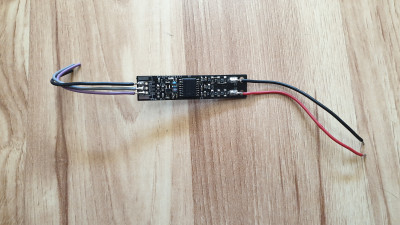

Posts: 4000
Voltage sense board just arrived thanks to muehlpower :D

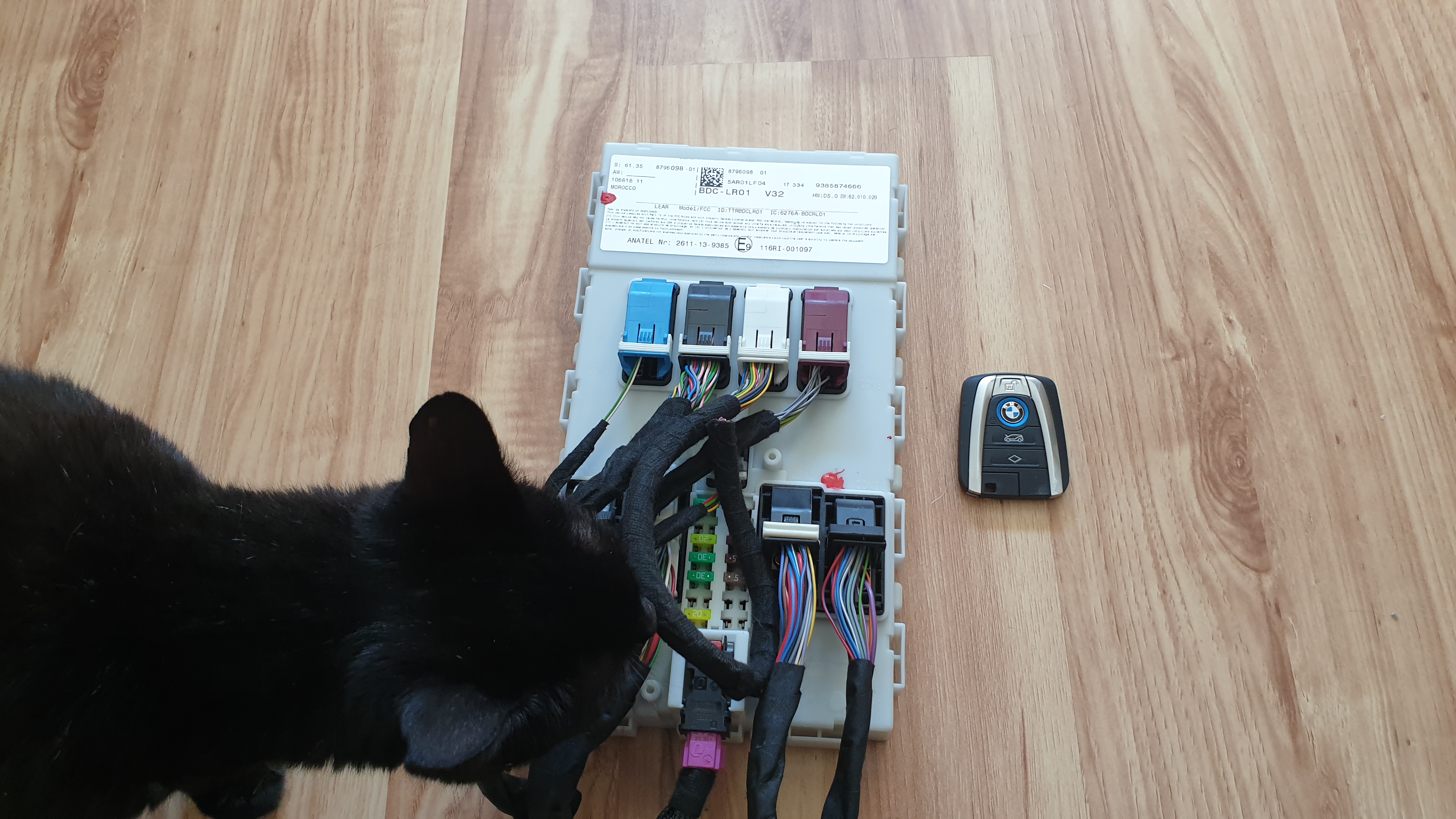

Also got the keys to my i3 ....and a bdc...
