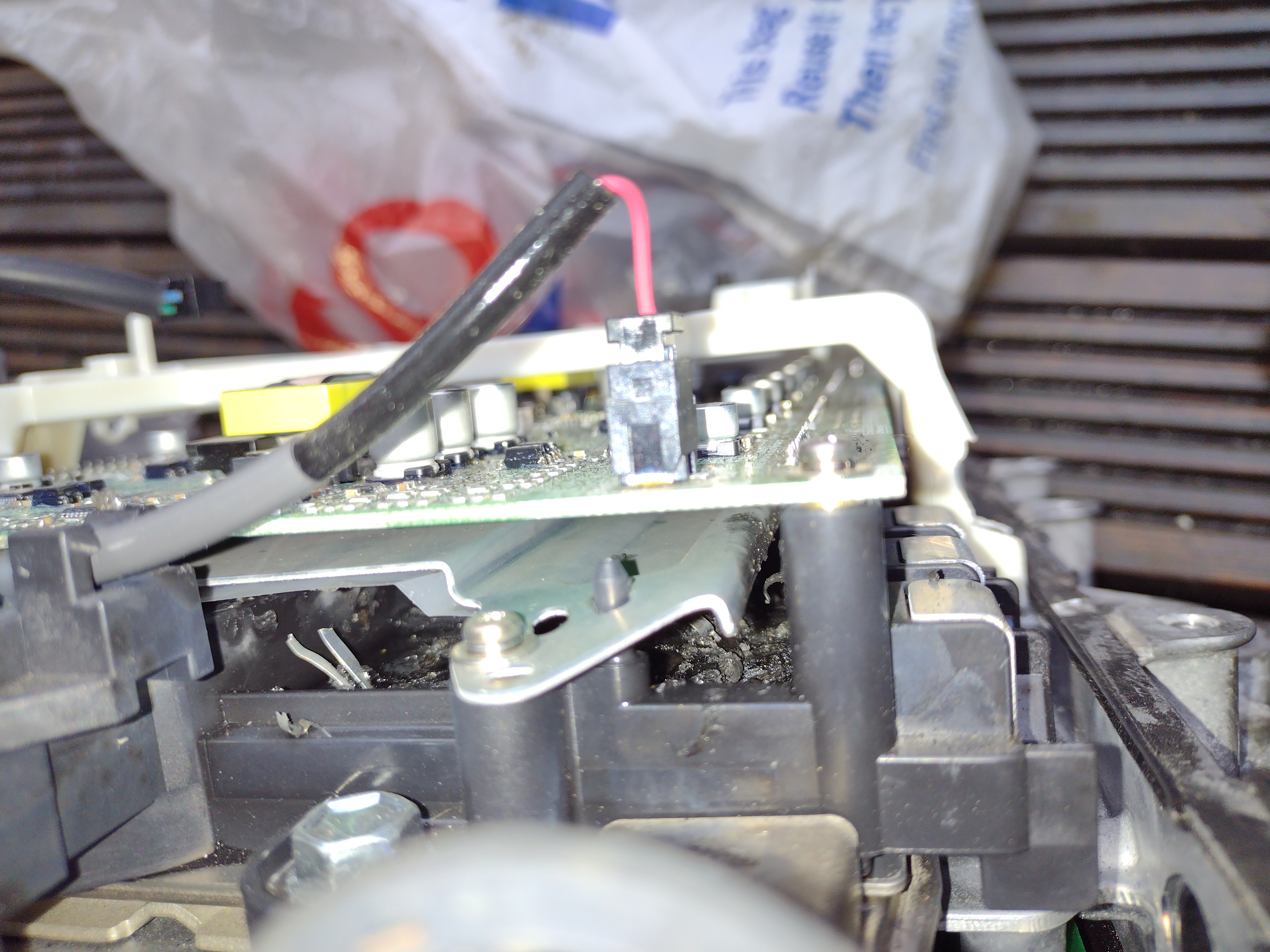

Re: [DRIVING] VW Beetle 2003
Cars been running great all year, had a weekend away, multiple DCFC and destination charging, faultless.
Went to my mothers and tried to get up her very steep driveway. Boom, Prius inverter RIP. Had to do a roadside inverter swap.
Why would a steep driveway kill the inverter?
Surely it sees far more current at full throttle accelleration on the road?

I've no idea. Full throttle on the road is fine but on the drive, it didn't have the umph and so was a stalled motor at full throttle maybe the 4.5 throtcur (450a) isn't possible on the motor while it's spinning with the back EMF?

The main difference between standstill and moving torque is the time peak current is conducted. While moving we constantly swing between peak current and no current and the average current across one phase leg is 0.7 times peak or something. In standstill full peak current flows through just 2 phase legs for a longer time.
Still would have thought the hardware limits catch that.

It usually does, the car has always struggled to get up her drive in reverse, sometimes I could make it up with a bit of a run up, othertimes the hardware protection cut out.
