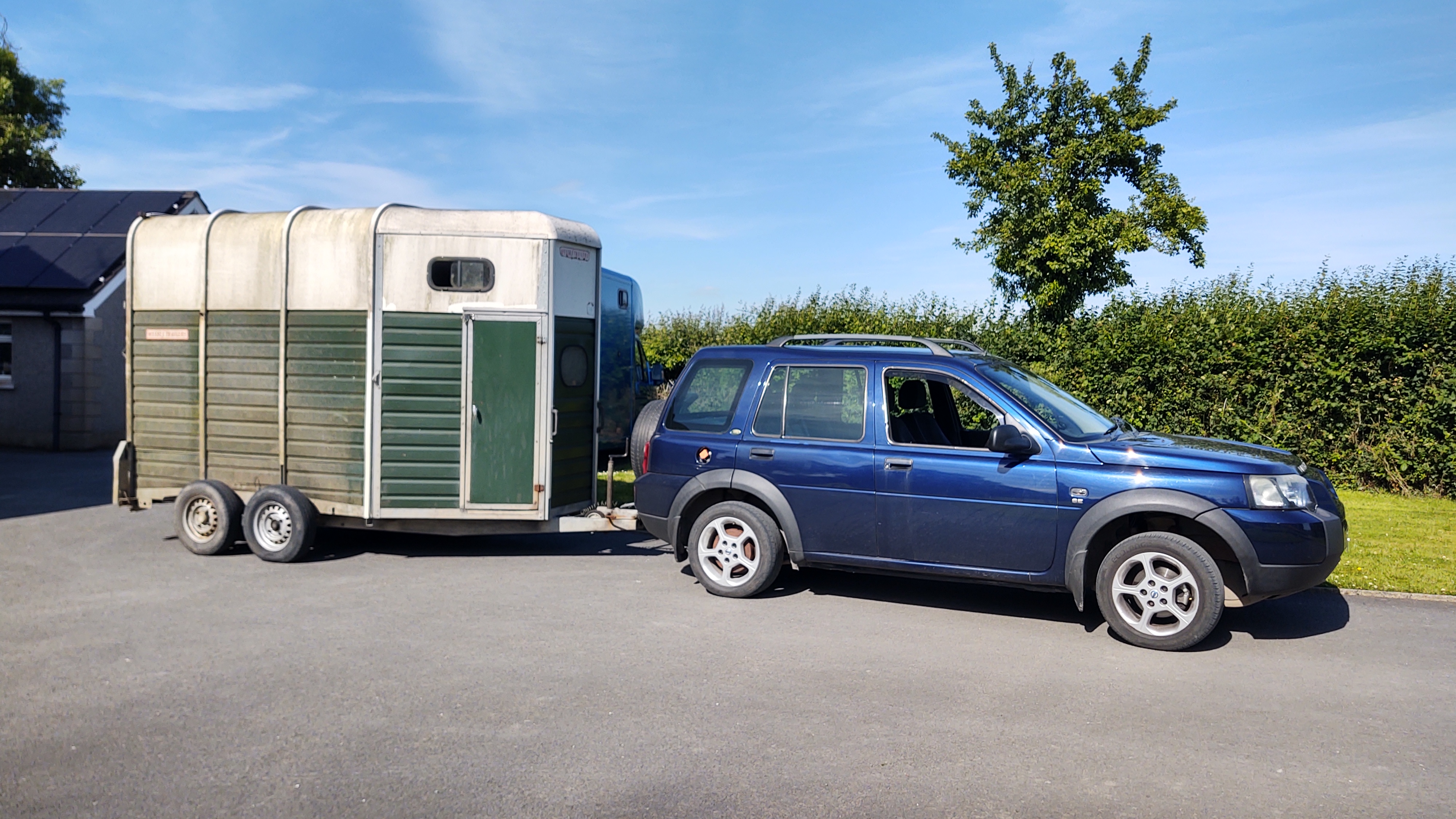

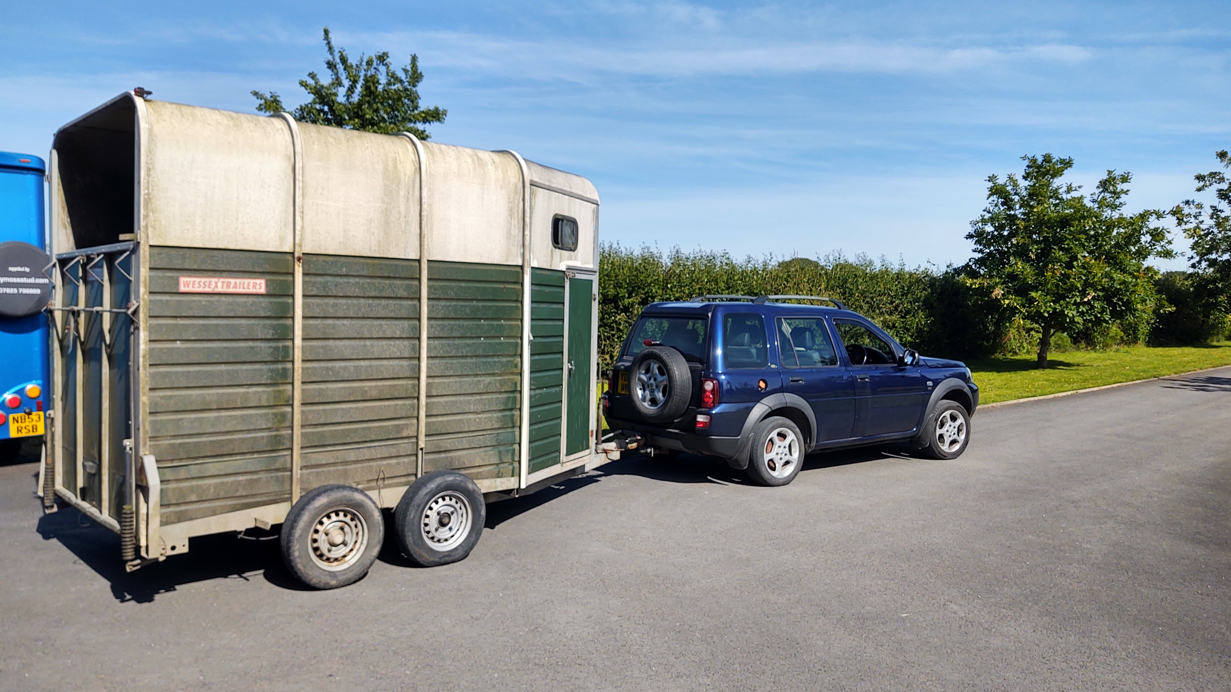

Used the car again for the sort of jobs I built it for.
Yesterday I drove to the airport to pick up my Mrs and daughter, and today I borrowed an old horse trailer and used it to bring home two large round bails of hay.
The trailer is stupidly heavy and the wifes Ford Kuga really struggles to tow it as it's clutch is on it's last legs and the engine hasn't much torque.
Normally in the Freelander I don't use first gear as it isn't necessary but when towing this trailer I use first to get moving and cross roads quickly. Pulling through slow traffic was a breeze however I don't like pulling up long fast hills with the constant high current load. Maybe I'm being silly but I was glad to get it back to it's owner.

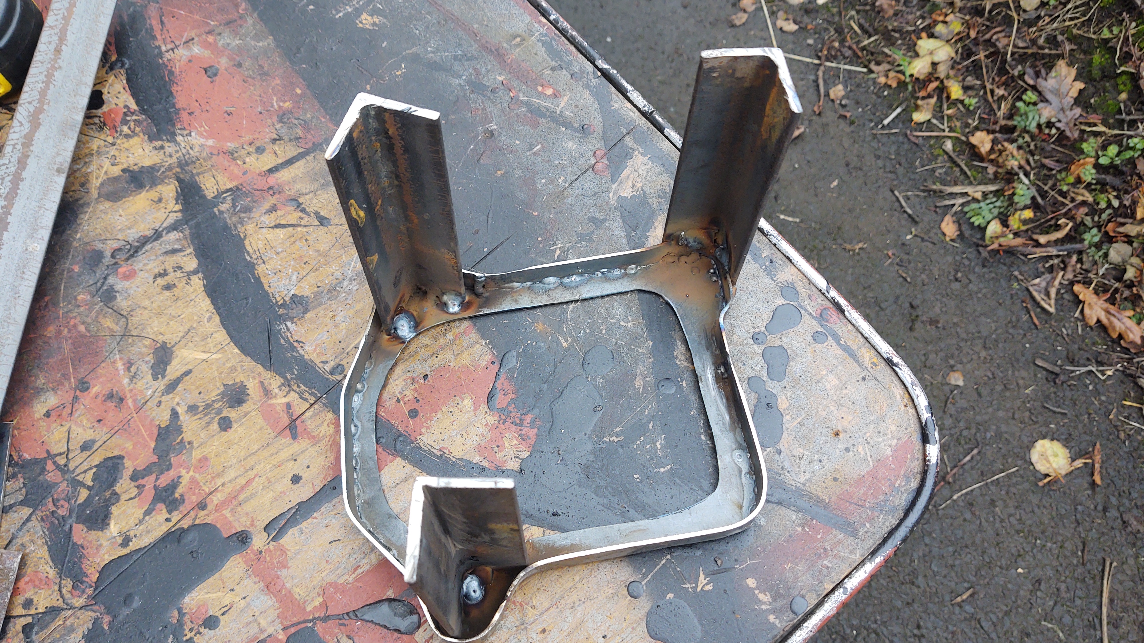

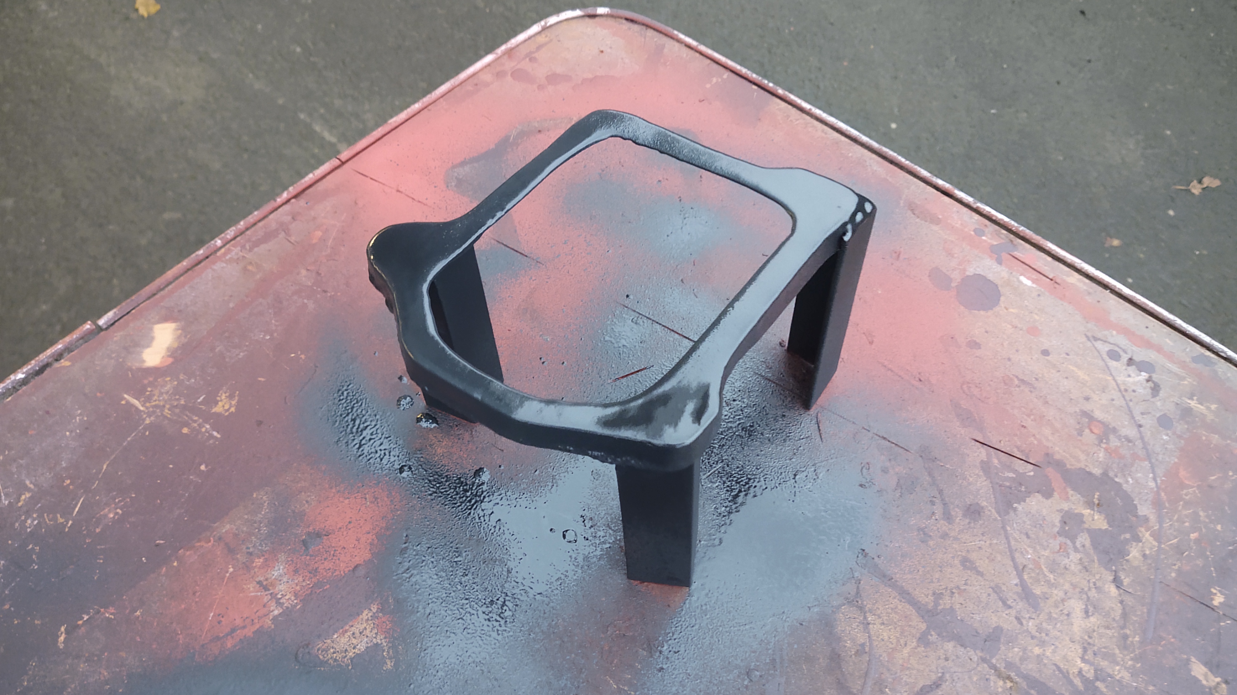

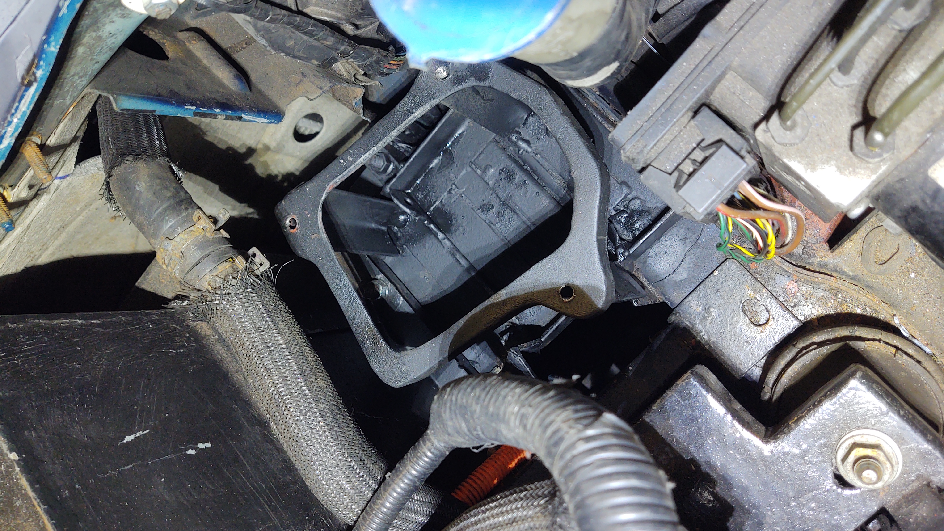

So this week I decided it was time to secure my power steering pump properly instead of just jamming it in with foam packing.
I never got a photo of it installed like this but this is the foam I was using. It worked surprisingly well for a couple thousand miles. 😋
So I started by cutting a hydraulic pump shaped hole in a bit of 1.5mm steel then welded a lip onto it.
Before grinding my Fugly welds.
Then I welded on some angle supports.
Before final grind and paint
I then drilled and tapped holes to secure the pump and welded it into position. It is welded to my battery bracket, not to the car so no issue with DVLA
Nice and solid now.
I'm really pleased with how it turned out but I currently don't have any rubber mounts holding it. I just used M8 bolts and washers so I find it much louder then it was before. Hopefully with rubber bushings it will be a bit quieter but I need to figure out a way to make them as they didn't come with the pump.

The PAS pump is much quieter now with these, I think they're called bobbins but they make a big difference.
https://ebay.us/IgouJS
Not quite as quiet as the foam but not as bad as bolting in directly.

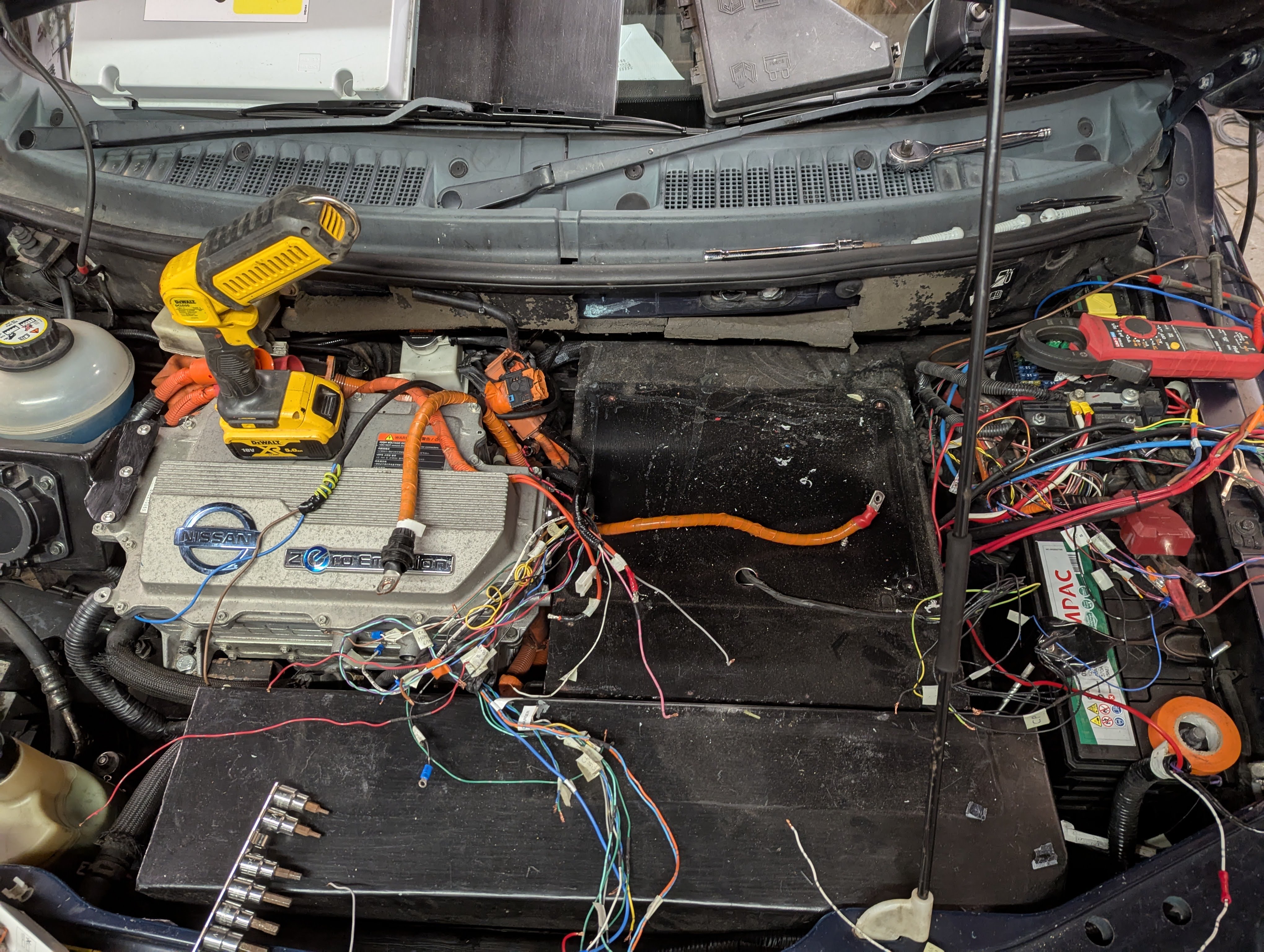

Last few days I've been playing with the VCU firmware trying to figure out if it was possible to have regen.
It should hopefully help improve the range a bit but even more important it should take some pressure off the brakes.
At the moment the brakes are great but probably over worked without any engine braking so a little regen should help.
The reason I done this before is when it comes to Arduino coding I'm thick! My Mrs would say I'm thick in many ways but that's another story.
Anyway I recently watched a video where a Youtuber was using AI to generate Arduino code so figured it was worth a try.
So finally after several days playing with it I've finally got regen working.
There are two ways regen works in EV's, first when you lift off the throttle and second when you press the brake pedal. In my case I can't easily have lift off regen because I need to lift off to change gear. In theory I could rig up a switch to stop the regen as I change gear but that's a lot of complexity. Maybe some day.
In the meantime I use the brake light switch to trigger the regen by just touching the brake pedal, it stars low and ramps up over a set time which is currently 850 milliseconds, provides fairly strong retardation and I've seen up to 100A going back into the batteries.
It probably needs a bit more tweaking but for the moment I'm happy it's working so I'll get back to setting up a timer to start charging at 2am for the cheaper leccy.

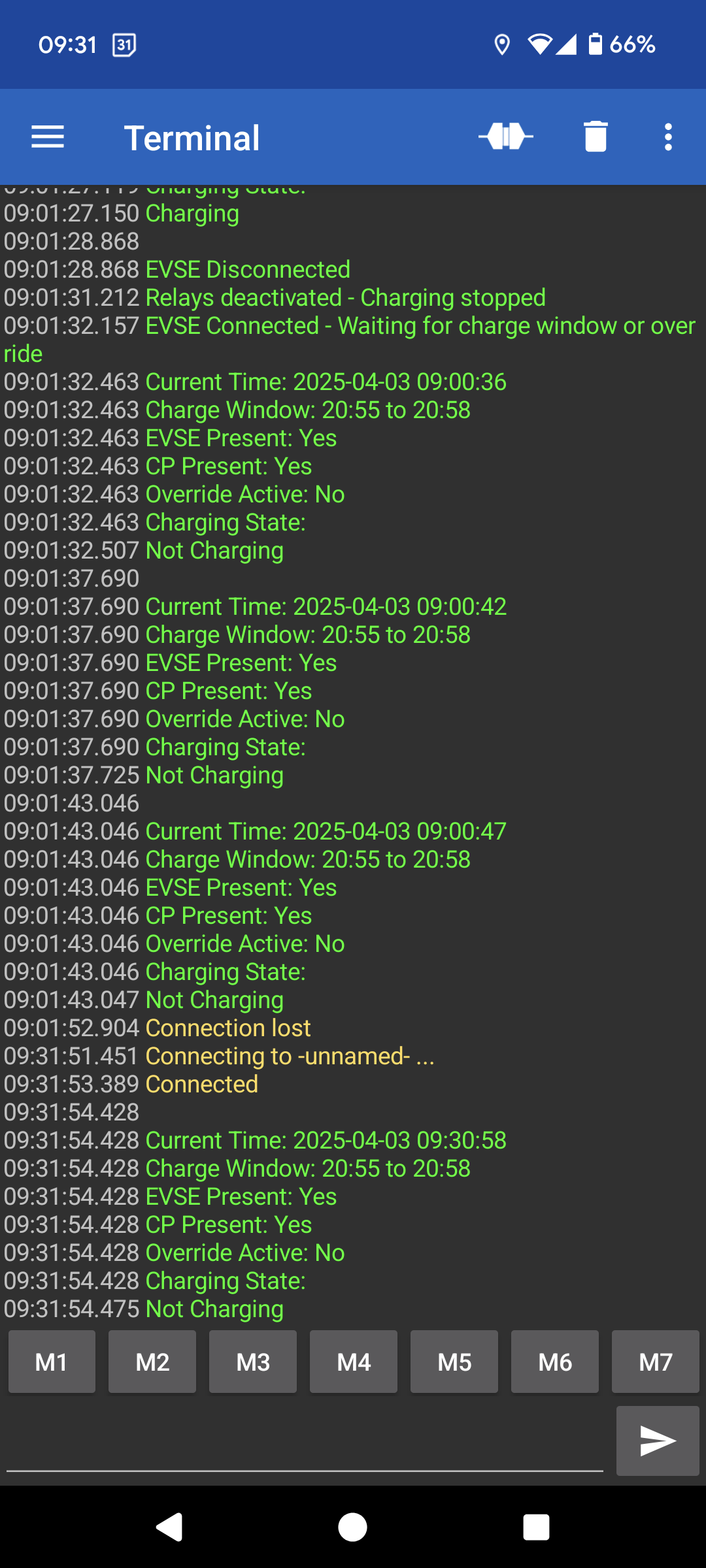

Posted: Thu Feb 27, 2025 8:16 pm
by Alibro
Several hundred miles later, after making a few changes to the code above I'm happy to report I have regen working reliably. It's not perfect and is dialled back to help keep things smooth but is working well enough for me to move on to something else.
And that is charging.
Up to now I have been plugging the car in during the day, turning on the ignition and setting a timer for the approximate time charging should finish. This is partly to check the charging had stopped as it should but mainly to turn the ignition off again. It has worked for over a year but is a tad suboptimal.
So for the last couple of weeks I've been working on automating the charging process and today I finally got the last part of the puzzle sorted that will allow me to install it.
The first thing I did was build a circuit to detect when the charging plug was shoved in.
This is from a post in another thread.
viewtopic.php?p=79533#p79533
Alibro wrote: ↑Mon Feb 03, 2025 2:39 pm So after a bit of messing about I came up with a circuit that works well enough to turn on the relays when the charger plug is inserted and turn off the relays when the catch is pressed on the J1772 handle so that I can't pull the handle out with the current still flowing.
In my case the J1772 socket already has a 2.7k resistor going to ground built into it so I took that out of the circuit.
I also found that with 3.3k resistor in the voltage divider circuit from 12V to pin 2 the relays were on all the time even without the cable plugged in. I tried changing the 2.7k resistor but couldn't get the circuit to trigger when the catch was pressed so changed the 3.3k resistor instead. I used a POT fo figure out what the ideal resistance was and it ended up being 255R. I didn't have a 255R resistor have so used a 240R and 13R in series which was close enough.
The relay module I'm using is a 12V 8 way block that can be set to trigger on a neg or pos signal.
https://amzn.to/4hroiOX
This is it on some strip board and so far it's working so now I need to work out how to implement it.
Next step was to ensure I had a backup or failsafe to prevent over charging so I made some changes to the VCU code. I never used O/P 3 to power up the inverter as it was originally intended so it's now providing GND to the charger. If the pack exceeds a preset voltage which is 2 volts higher than it the default max it will power off the charger which basically crashes out of the over charge situation, in fairness I should have done this earlier and my only excuse is it was less of an issue as I always set an alarm.
Now the charger will turn off when the Charge Control Arduino Due sees the pack reach a preset voltage from the shunt.
And if it fails to stop charging for any reason the VCU uses the Inverter voltage to turn off the charger at a preset voltage
So now I have a circuit that detects when the charger plug is in I needed to figure out how to implement it. I wrote a list of everything required for charging and spent a few nights wiring in a 6 way relay module I intend to use.
To get my head around what was required I wrote it out.
Current Setup
Plug in the cable
Turn on ignition to power up all devices.
The VCU sends GND to the charger to power it up
An Arduino Due checks the voltage from an Isabellenhutte shunt using CAN. If the voltage is within a preset range the Due closes the CP line using a relay (CP Relay) to allow charging to begin. This Arduino Due also sends Voltage, current and power info to the Android head unit over WiFi.
When the Due sees the voltage above a certain level it turns off the relay which disconnects CP and stops charging.
A backup safety is provided by the VCU which will power off the charger if it sees an over volt situation.
New Setup
Scenario 1 - Charging starts and completes
Plug in the charger cable.
LM393 detects EVSE present from PP and sends GND to a relay (ChargeEnable) and PIN8 on the Nano.

I've spent a bit more time on this and now have a working setup but instead of a Nano I'm using an Arduino Uno R4 Wifi.
This sends the serial monitor output via Bluetooth to my phone so I can monitor and control it remotely.
I've had to change the sequencing as I had got it wrong in the previous post but by simplifying a bit everything is working as planned.
I'll do more testing to ensure the charging stops correctly but so far so good.
Here is a photo of the bench testing and some screenshots from my phone.
In this photo I was using a DS3231 RTC module as I was using the same setup that was previously on the Uno R3 but I later took it away and am now using the onboard RTC.

Even worse I've ripped out the old HV and LV junction boxes to try and sort out the unholy mess that the old ones were.
This is the new layout for the HV JB and not a 12V relay module in site. :D
I needed another two contactors in the HV JB for Chademo charging so it made sense to take the opportunity to remove all the 12V stuff that shouldn't have been there in the first place. I won't pretend it's pretty or optimal but I tried as best I could to follow the HV JB design in the Wiki so it should be better than before.
Hopefully I will need fewer Arduino's now I have a Zombie so there should be more room in the LV JB but I took the opportunity to redesign it as well.
CAD prototype
I'll probably regret the decision to build it from the most brittle material known to man.... acrylic :cry:
The box base is now finished so I'm busy extending dozens of 12V wires so that they all enter from the right. This is to make it possible to move it out of the way should I ever need to get into the front battery box.
