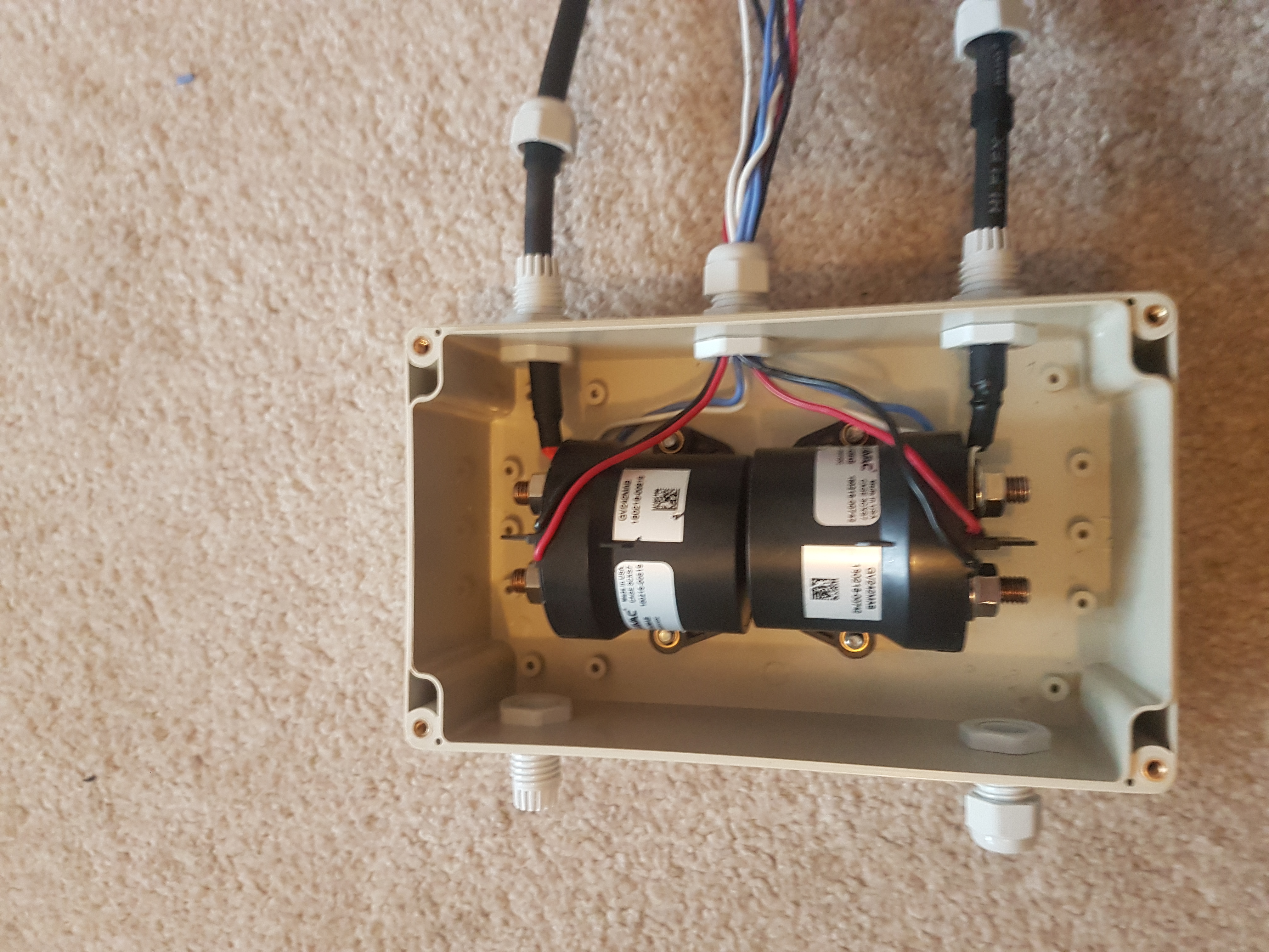

I'm using the Chevy Volt contactors that are not economized, I tested them for a couple hours and the heat rise was not that significant. I've thought about using another relay to trigger them, and/or using a fuel injector driver as an economizer (yes I'm aware that economizers are not terribly difficult to build, but I'm trying to find solutions I can get in a week)Bratitude wrote: ↑Sun Jan 23, 2022 10:40 pmcontactors are switched via one of the relays on the board.P.S.Mangelsdorf wrote: ↑Sun Jan 23, 2022 9:49 pm How many amps can the board provide the contactors? I have a feeling mine are drawing too much.
PCH-112L2MH,000
5amp 12v
Do the contactors have a econimmizer ?

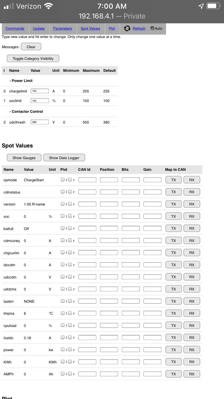

Ok I got some logs:
First, a log turning on the ISA shunt (disconnected from controller) and then re-doing the initialization.
Second, after the reinitialization, I power cycled and logged without the controller connected to the bus.
Third, I logged with the controller connected to the bus.
Also attached is a screenshot of the controller interface. The car was not plugged in (pins were jumped to turn on board). BMS (not connected to this bus) was reporting 15% SOC. As you can see, the controller was reporting 0%.
Isaac96
- Posts: 656
In the powerup without controller:
Looks like voltage reading is close to zero (0F and then a very small negative, so in the millivolt range).
Ah reading is also zero.
So this seems to be the correct configuration.
Controller SOC wouldn't change unless you put power through the shunt, no?

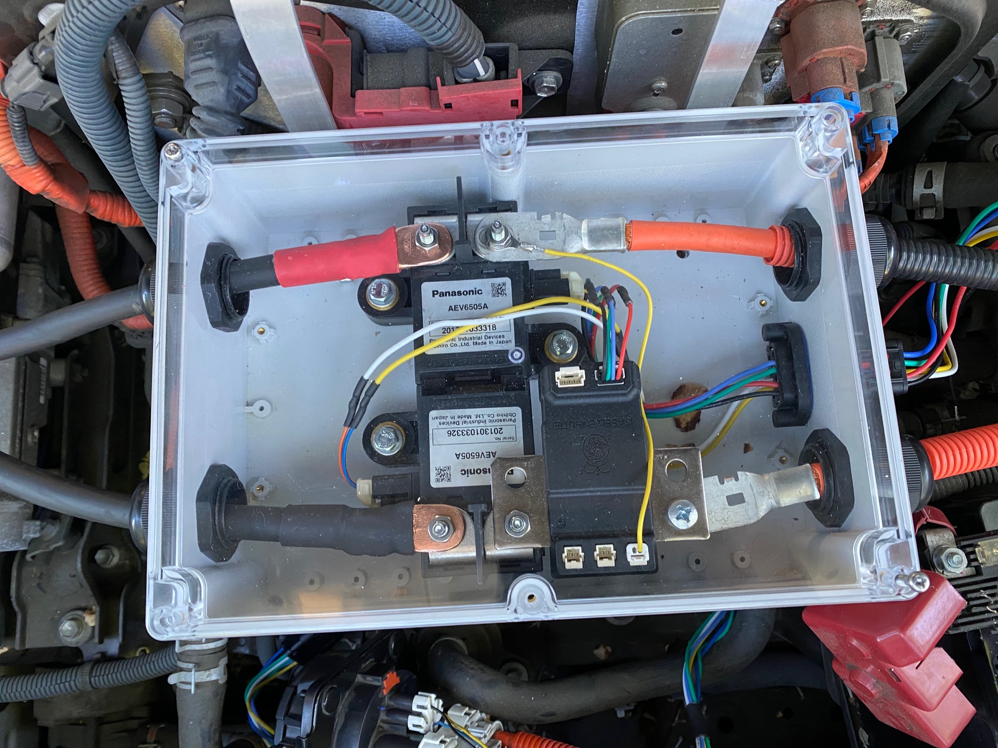

This was a quick test with the inverter on, while I was on my way out the door this morning. I'll do a longer test and log this evening.
The shunt ended up sticking out of the box after I flipped it around to the correct orientation. Safety/emergency contactor is above, cables out to the inverter and charge contactors are below. (note: when placed inline, the image is upside down, but if you click on it, it will flip right side up. no clue why)

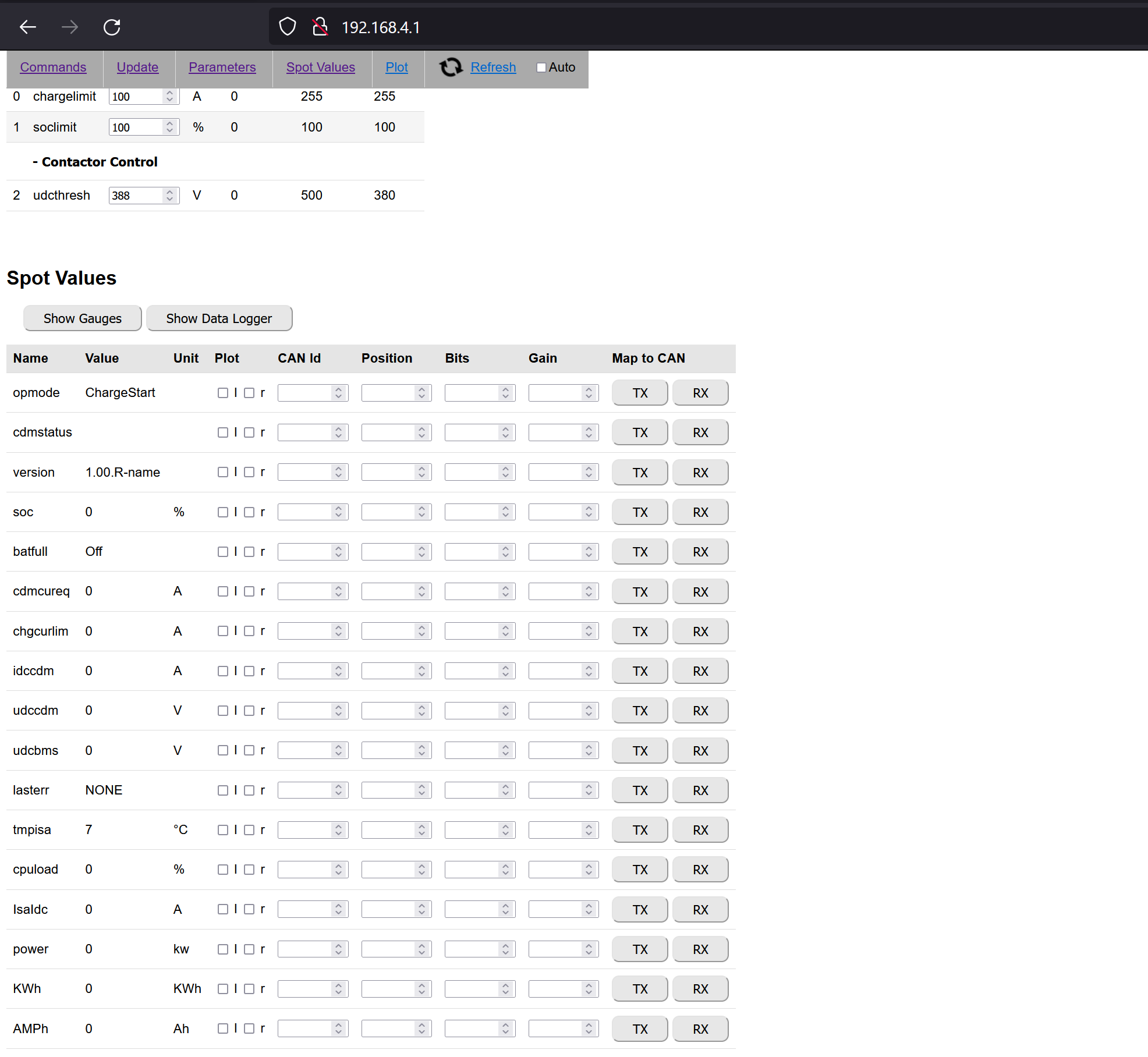

I found part of my problem, but still no sucess charging.
I realized that the shunt and station communications are the same bus, so I had an extra termination resistor. I pulled that out, but still had issues.
I also double checked the soldering on the relays, and made sure they were connected.
This attempt was at an Electrify America station. I got all the way through the process right up to delivering power, and then it failed.
I got a CAN log and a screen capture, but for some reason its not letting me add the screen capture.
The web interface is still showing 0% SOC, which I think is the error. I did have the shunt installed backwards for a while. Could I have damaged the shunt, where it is still communicating but not measuring properly?

Isaac96
- Posts: 656
Backwards installation shouldn't cause damage.
Looking at your picture: I don't see a voltage sensing connection?
One of the 2-pin connectors needs to be connected to the opposite side of the HV bus (if shunt is on negative then connect 2-pin to positive).
Here's how I had mine hooked up (this is in a RAV4 EV). Pack wiring is on the left, chademo power comes in on the right (orange wires).
EDIT Note that there are three voltage sense connectors; sensor 1 is used for power measurements and has highest priority, not sure which one is read by the Chademo VCU (since all can be accessed via CAN).

Well I'm an idiot. I misread the data sheet and assumed they were only needed to measure sub pack voltages. I'll get them wired up next weekend and see if that solves it.
