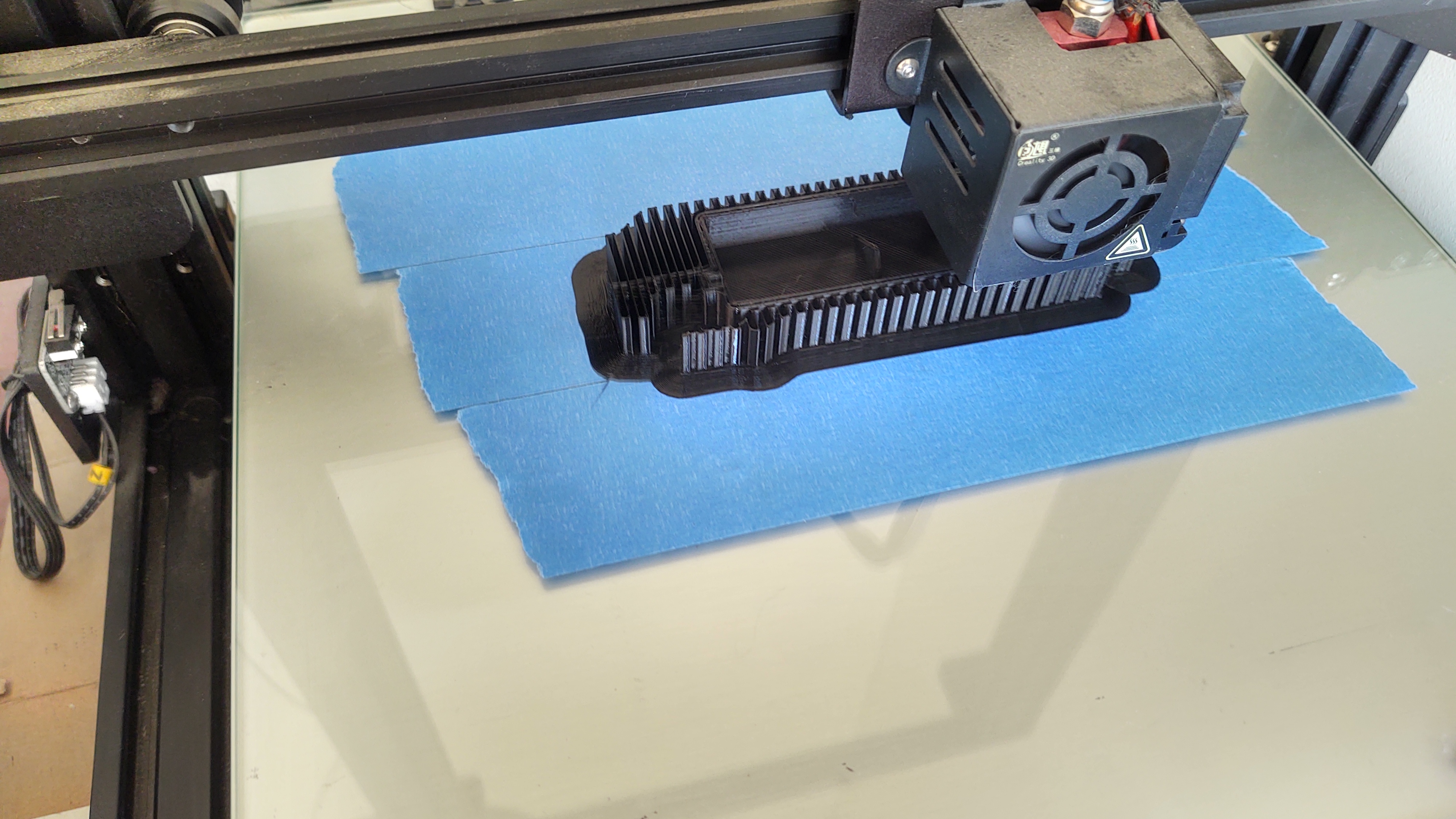

Re: Leaf Gen 1 Inverter Board
Posted: Thu Sep 28, 2023 9:07 am
by Alibro
Either I'm doing something wrong or there is an issue with the STL files I generated as in Prusu Slicer it is building this as a solid object, filling interior but even worse it seems to screw up parts of the design as well. Once again it looks OK until I slice it.
Like I said my CAD knowledge begins and ends at Tinkercad so I don't know how to fix this.
Posted: Thu Sep 28, 2023 8:31 pm
by Bratitude
molex-memx-enclose.STL
(1.62 MiB) Downloaded 903 times
heres an stl of the box
Posted: Thu Sep 28, 2023 9:58 pm
by Alibro
Bratitude wrote: Thu Sep 28, 2023 8:31 pm molex-memx-enclose.STL
Thanks mate, I'll have a go at printing it tomorrow. :)
Posted: Fri Sep 29, 2023 9:19 am
by Alibro
This STL file works a treat, no glitches or unwanted infill so it'll take around 26 hours to print but still way better than forking out nearly £30.
Thanks again. :)
Posted: Tue Oct 03, 2023 10:00 am
by Alibro
So a massive thanks to Bratitude for posting the STL file for this case. I printed it out over a couple of days and this is the result.
The last photo shows it after I removed all the supports but if you look carefully you can see a line half way up where I had to turn off the printer over night. I have a Creality CR10S which can restart a print after power off but it is not perfect and so restarted slightly off line but it's not a big problem as the VCU still fits fine.
I could have tried printing without support which would have been much quicker but didn't fancy waiting 10 hours or more to see if it would be OK.
