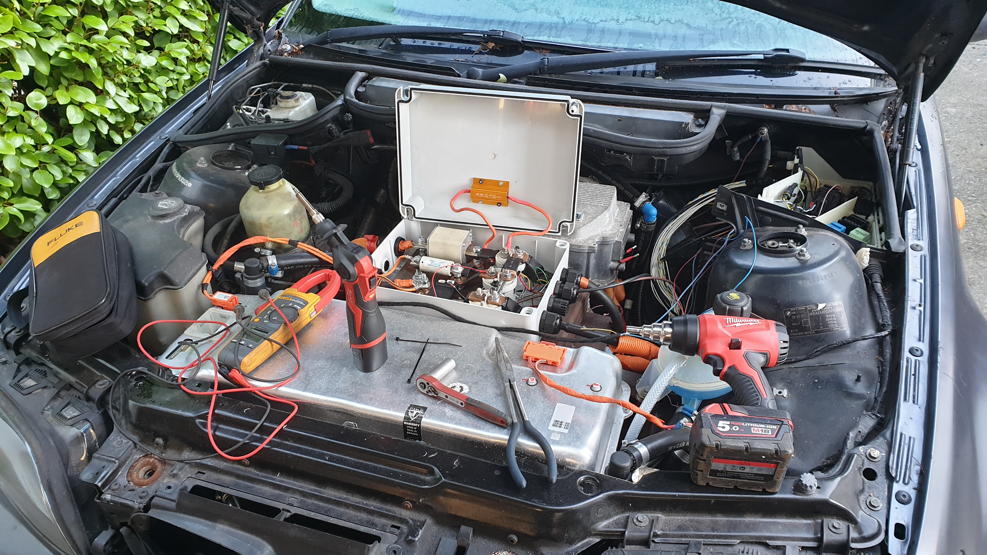

Thanks again Matt and everyone on here. I did get some work done the E46 today:)
