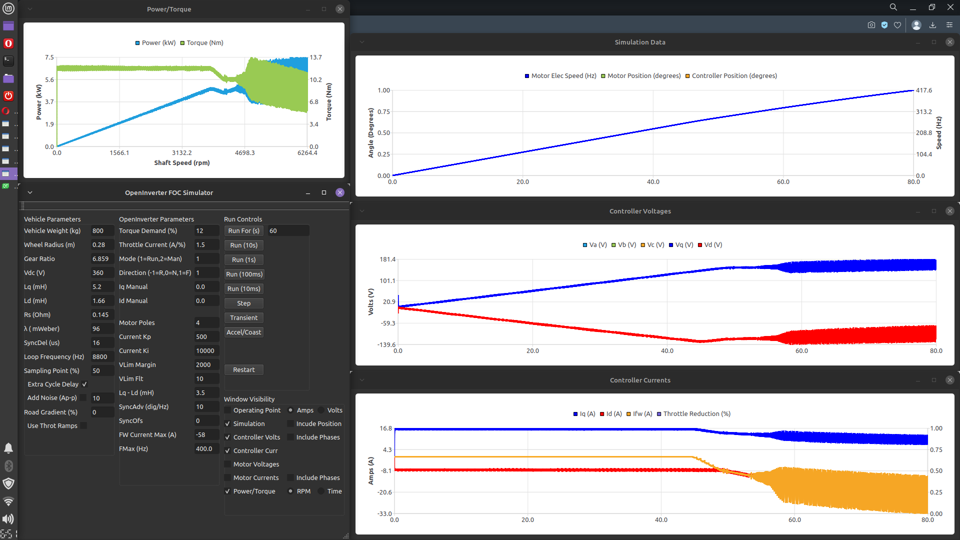

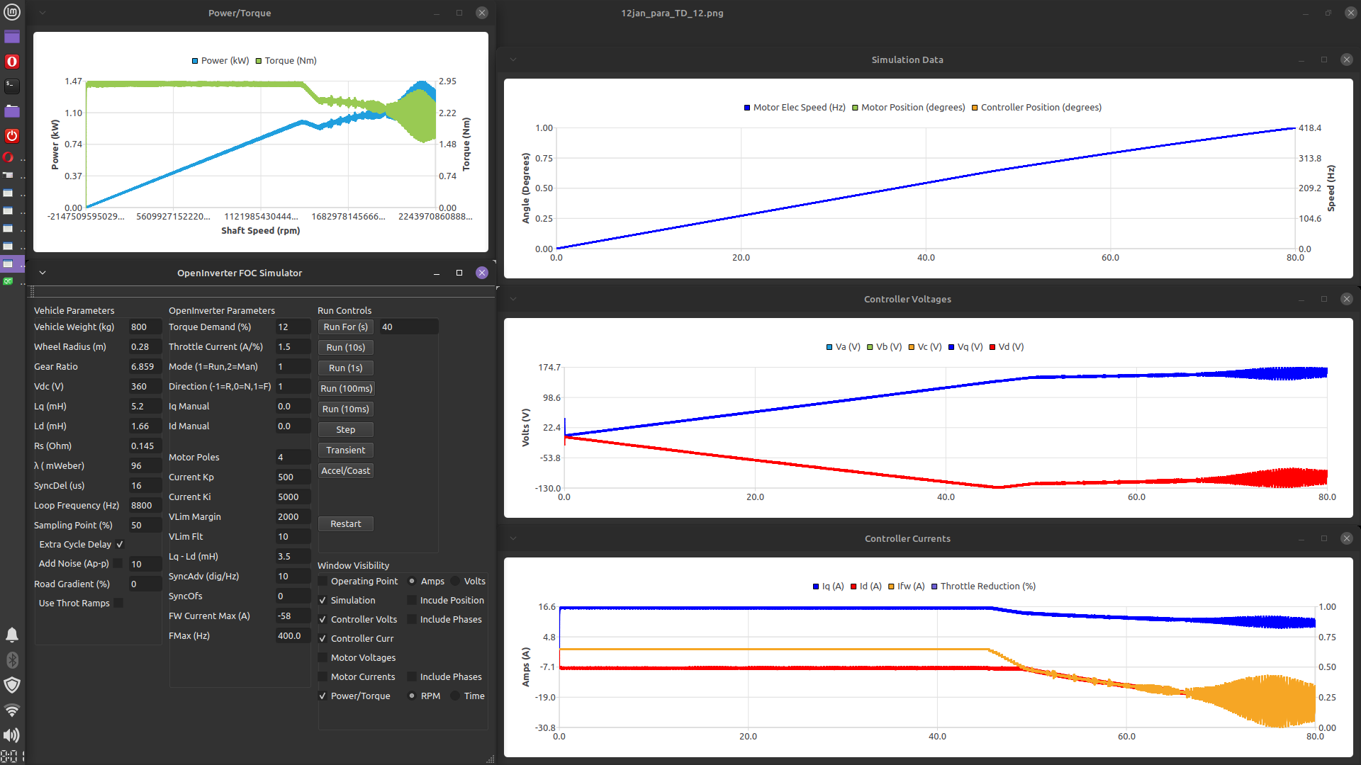

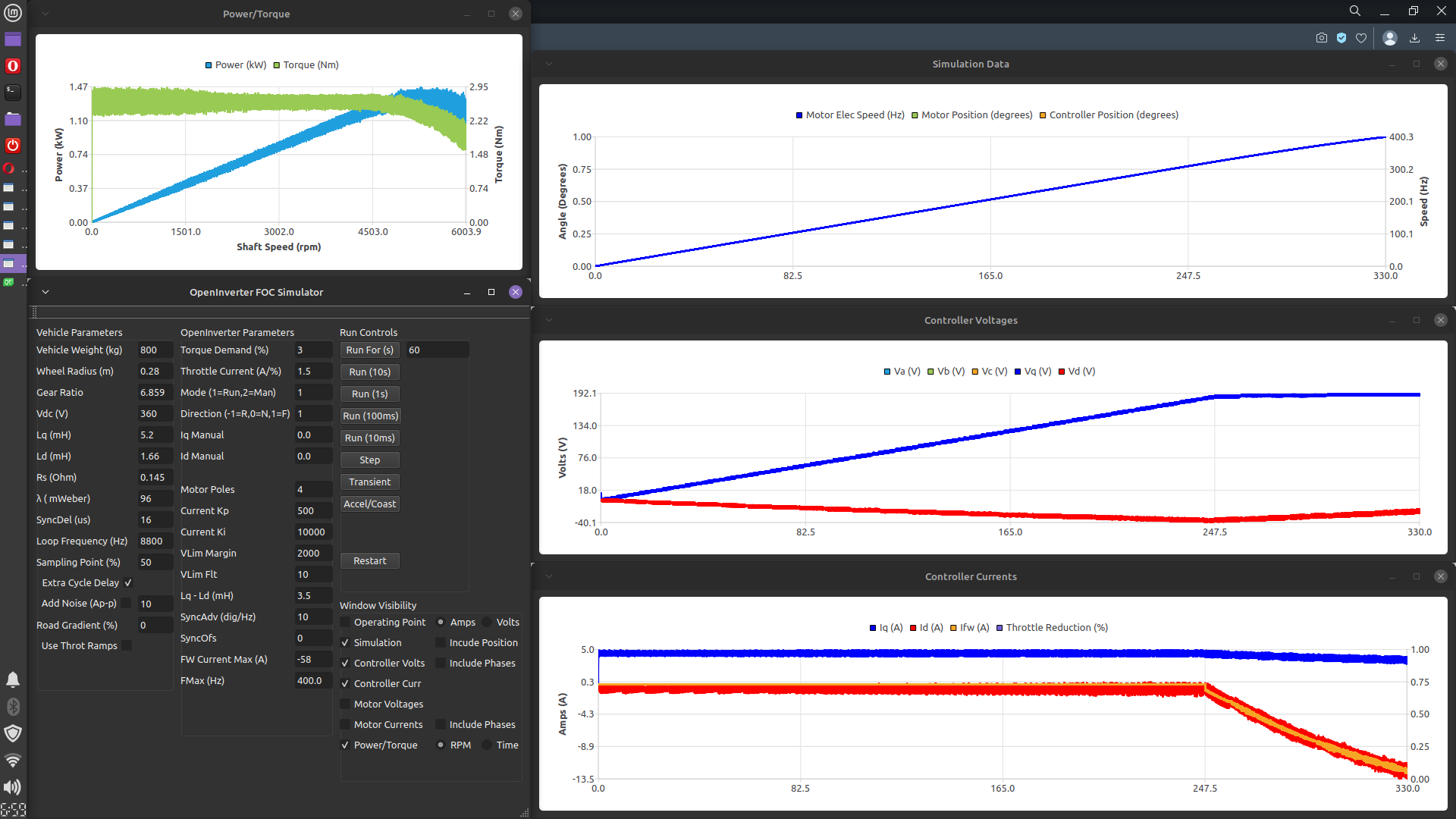

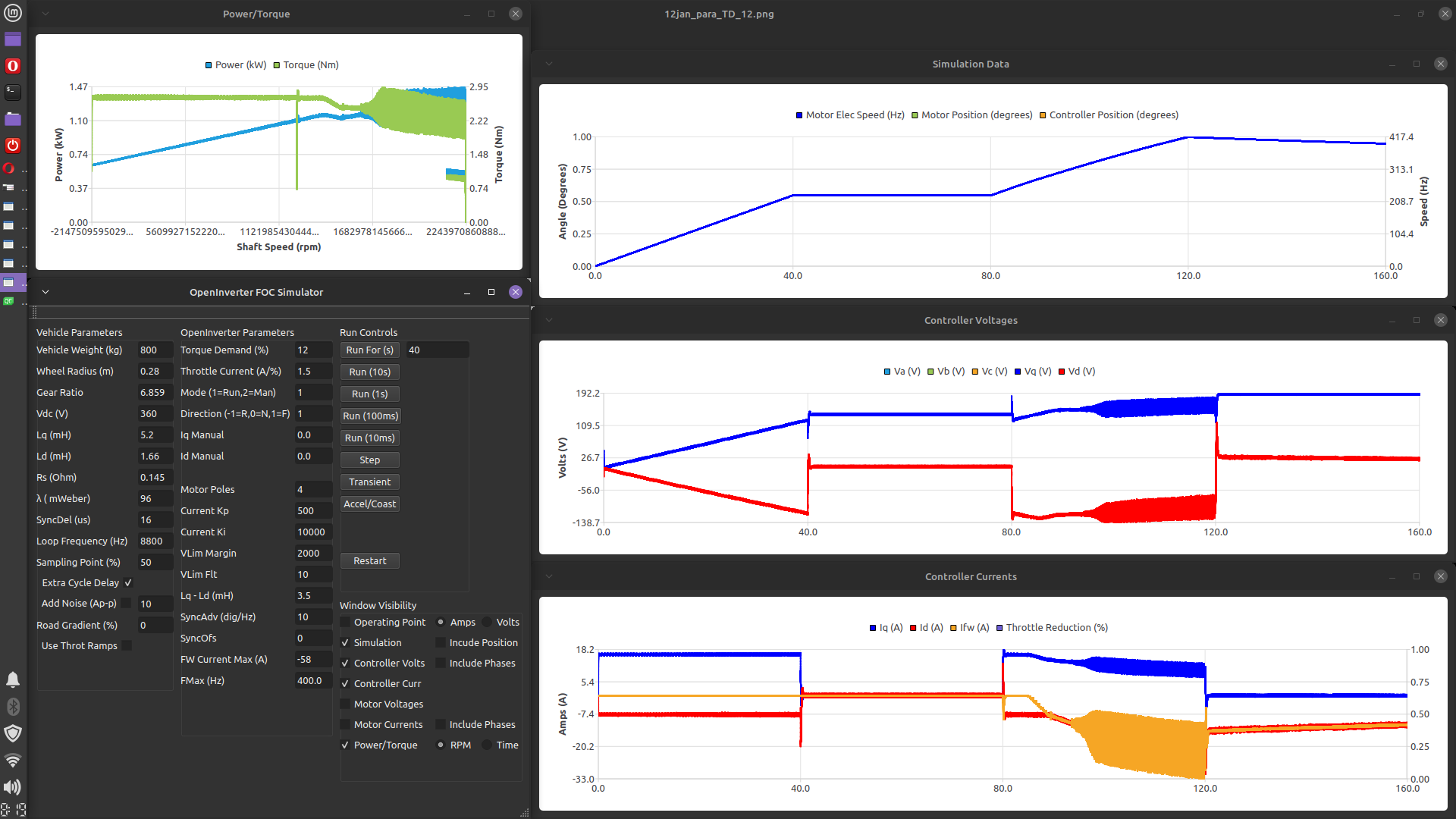

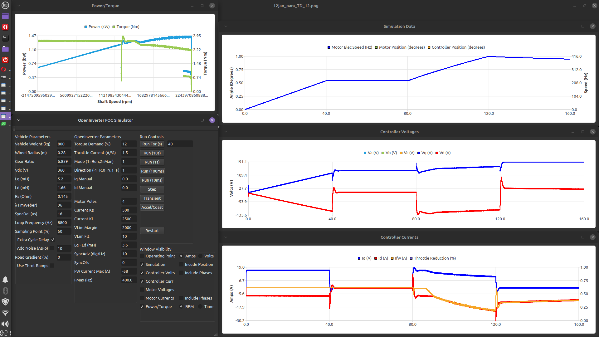

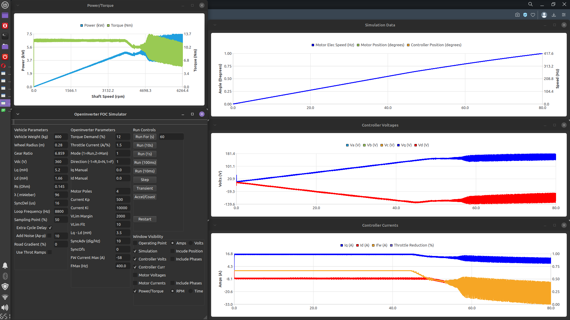

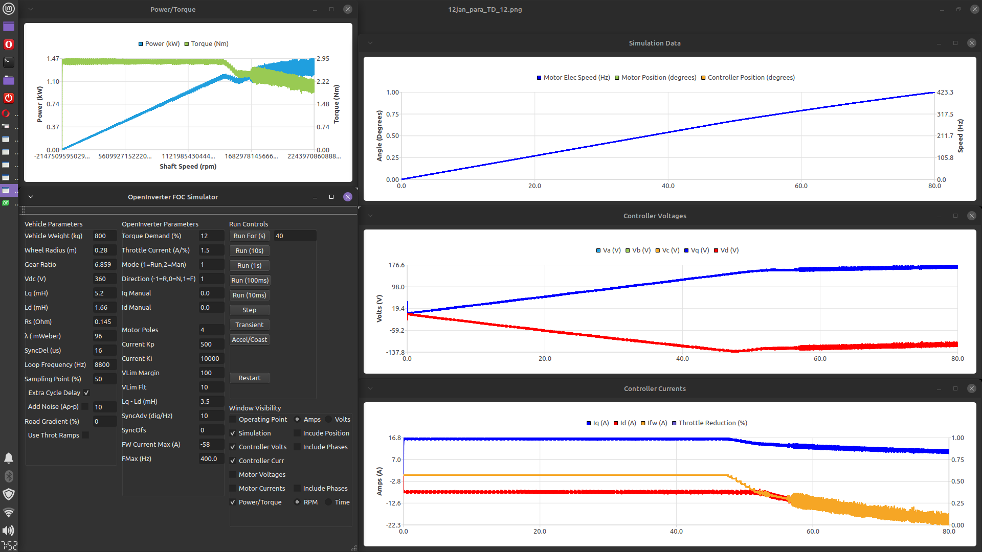

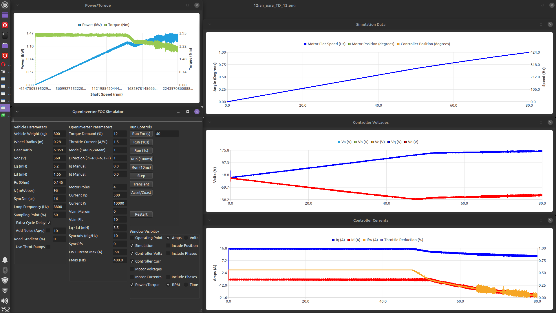

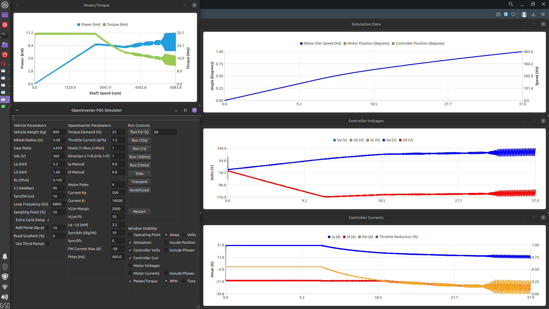

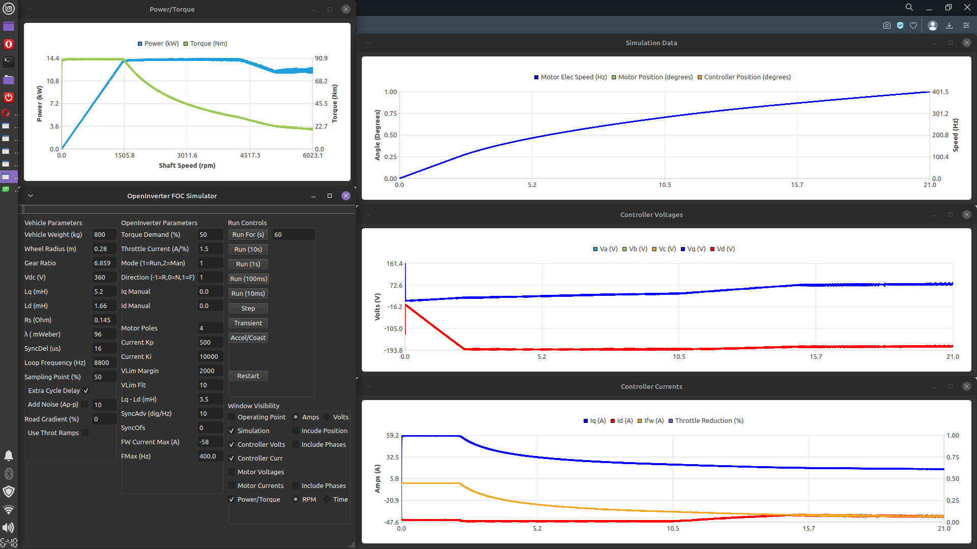

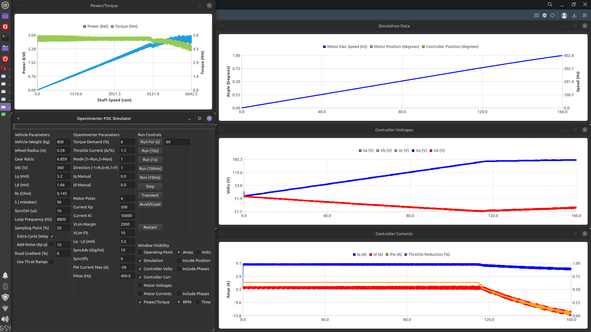

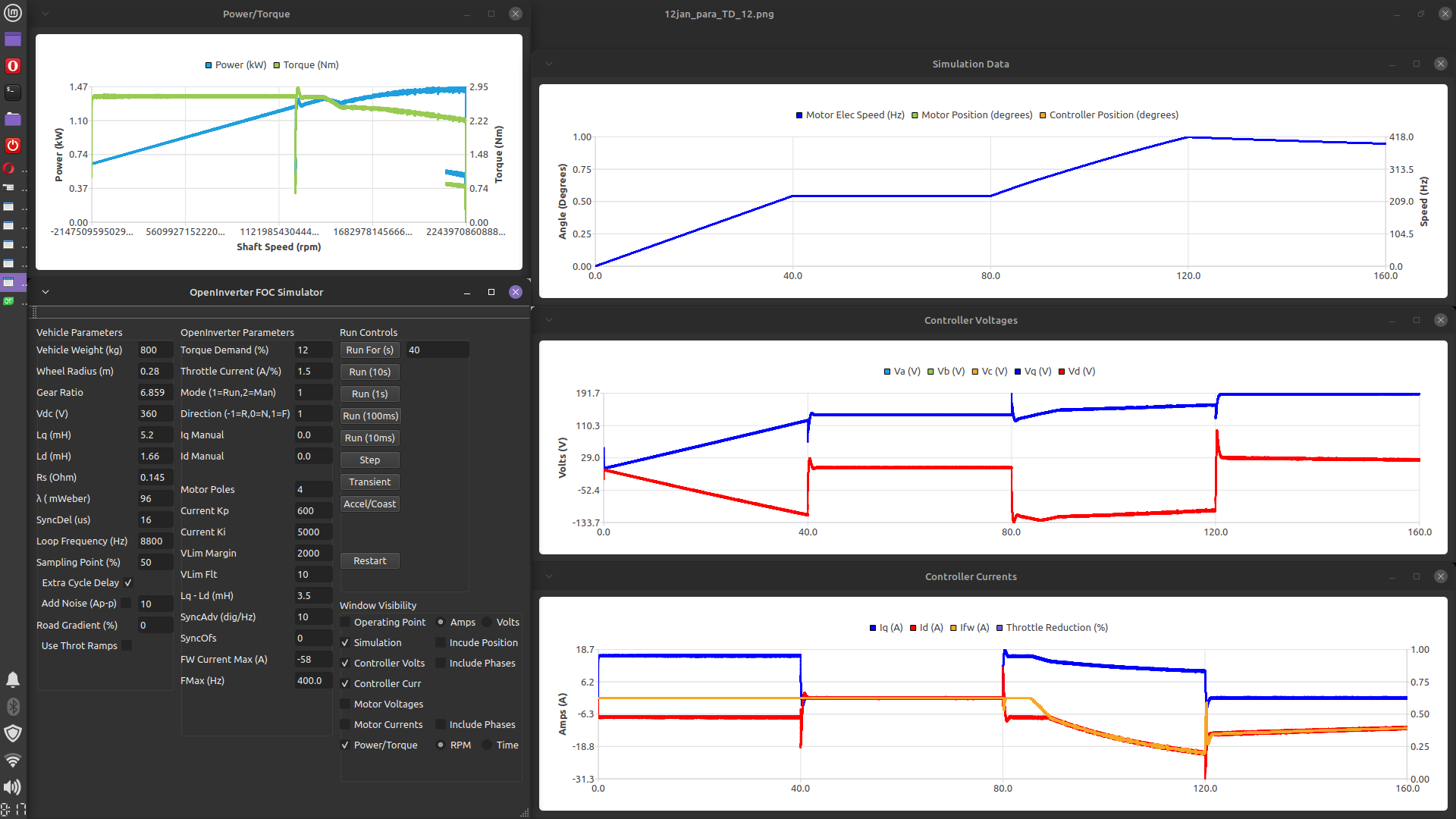

Was out driving yesterday and noticed that there are quite some oscillation when at 65-70km/h (280-310Hz) cruise or slightly lower torque request.
Tries to tune it by increase kp which helps reduce the phenomena but it also gives unwanted regen with kp at 800.
Adjusted other parameters as well but without desired effect.
Started the simulator and tested with less than 100% tourqe demand and I can see a oscialltion here as well for 25% and 12% torque demand.
Torque demand 100%
Torque demand 100%
Torque demand 50%
Torque demand 50%
Torque demand 25%
Torque demand 25%
Torque demand 12%
Torque demand 12%
Torque demand 6%
Torque demand 6%
Torque demand 3%
Torque demand 3%
The conclusion I can find is that when |Vd| is close to |Vq| the control loop start oscillating?
I will continue testing in the sim. Any suggestions on what to do is very welcome.

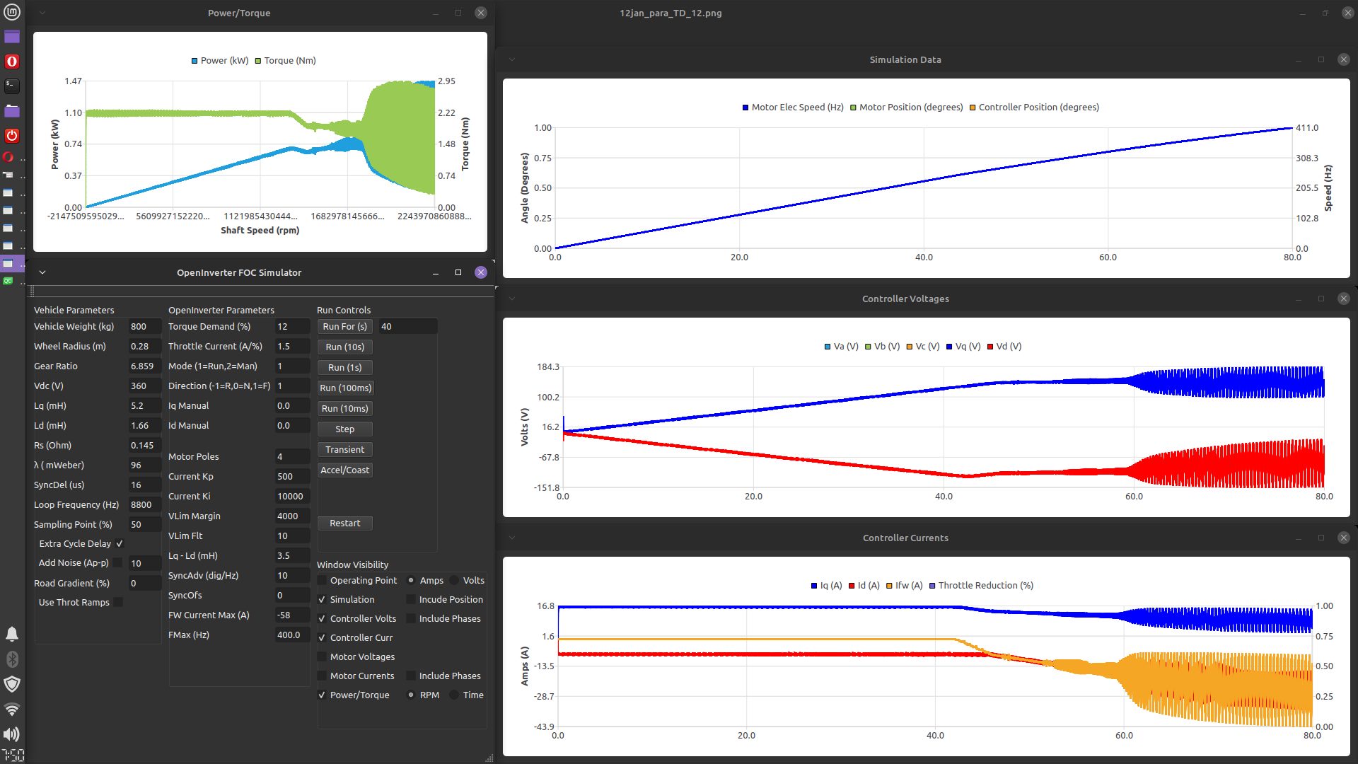

Reducing VLimMargin seem to reduce the problem but I'm not to keen on reducing the IRL, might cause other problems.
All plots with 12% Torque demand, VLimMargin is normaly set to 2000.

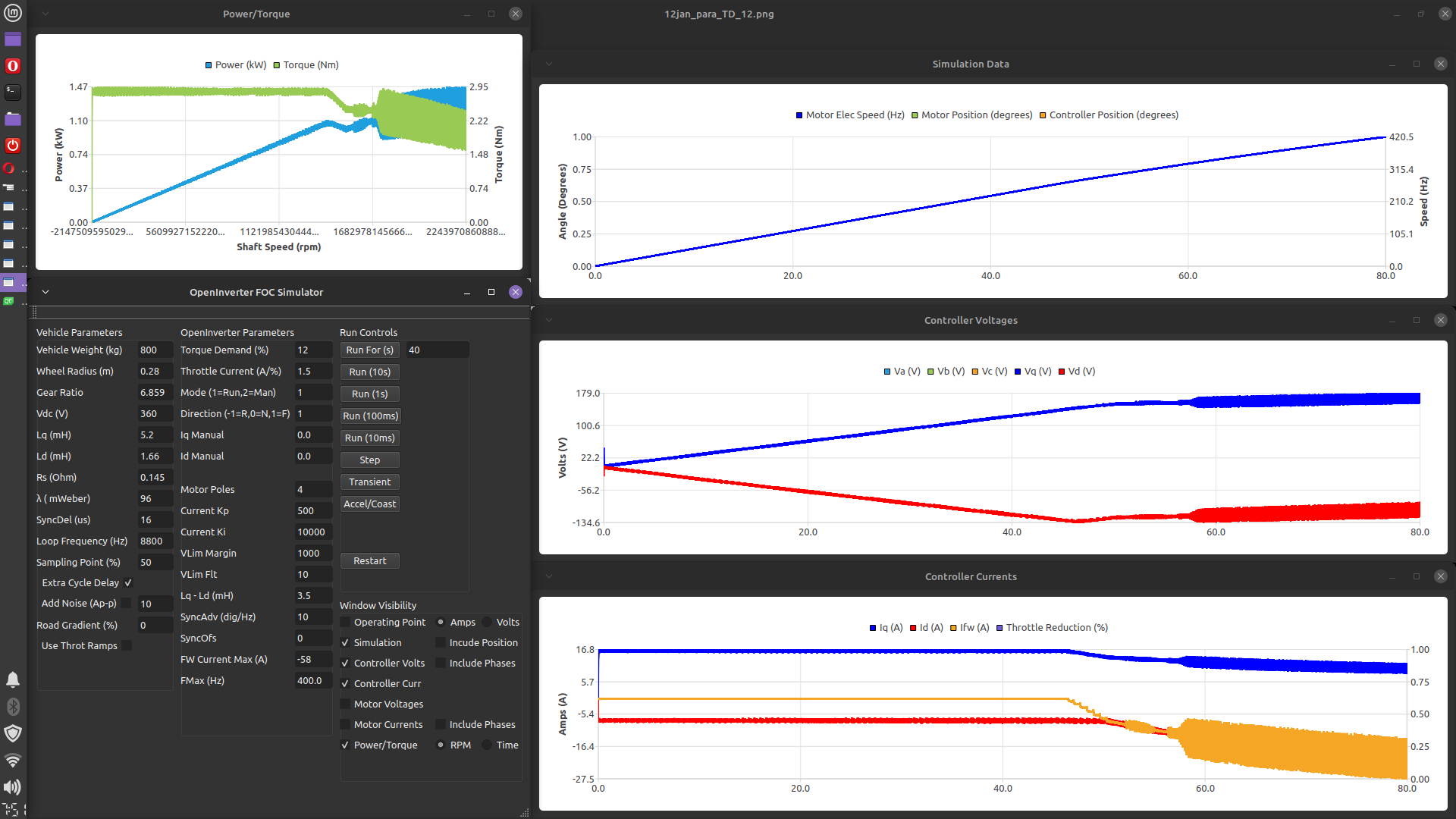

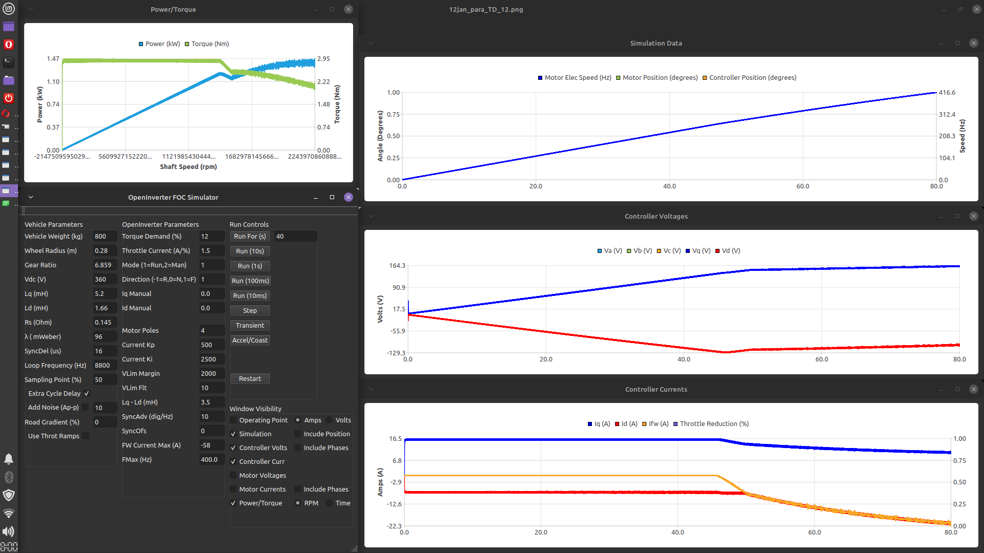

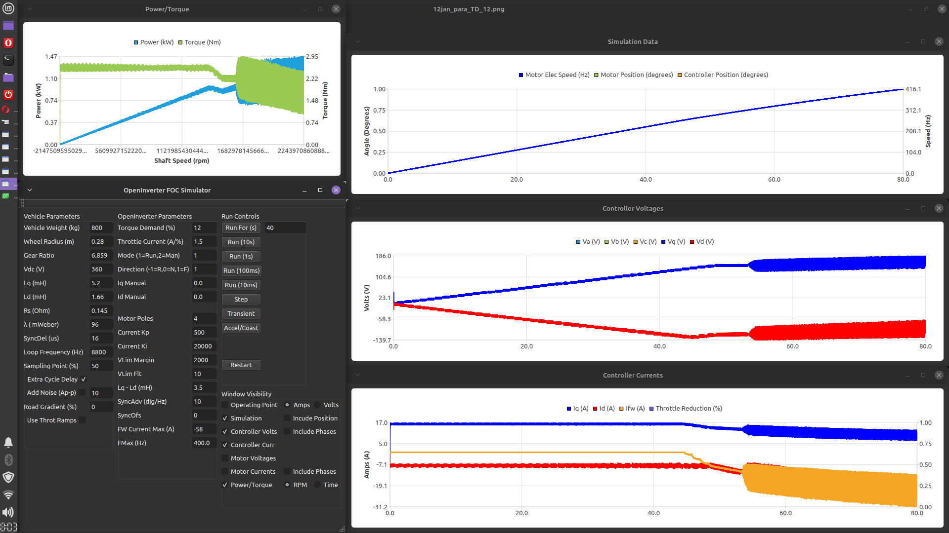

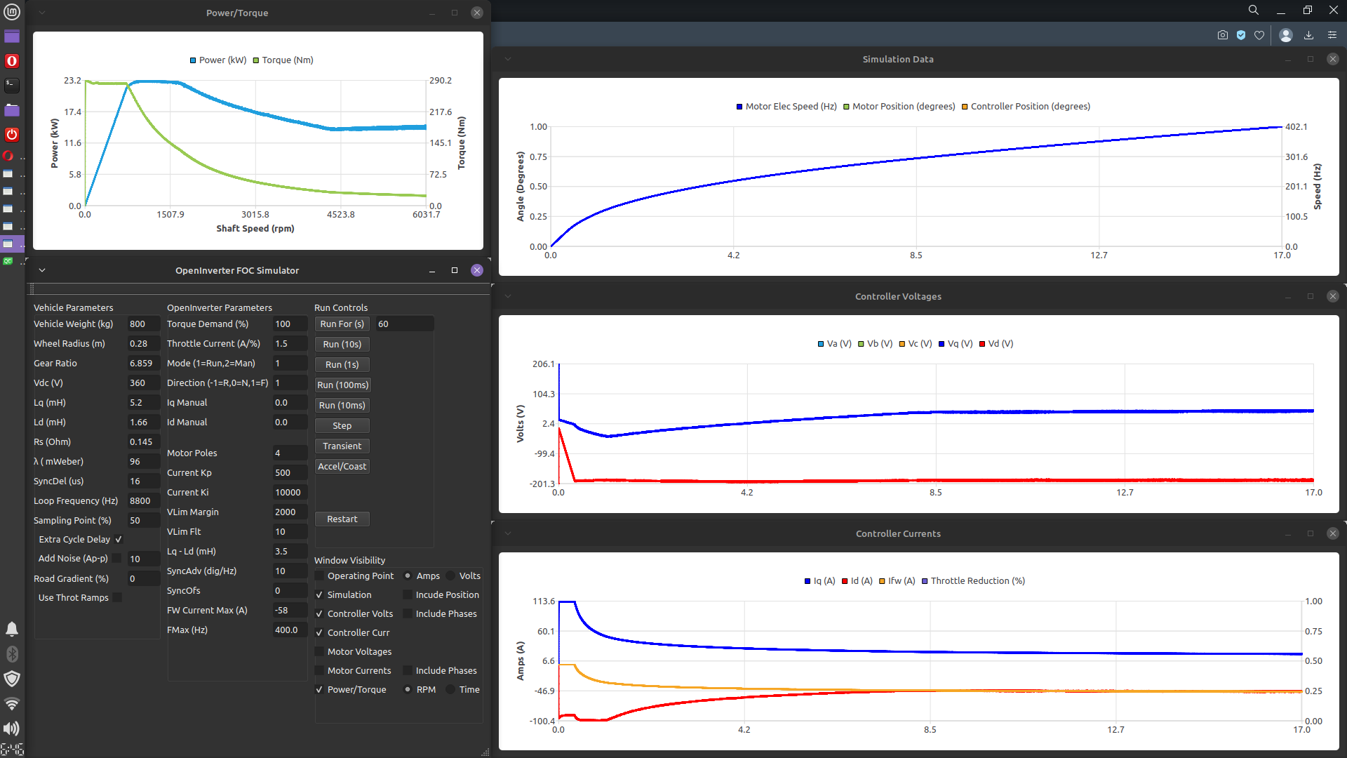

Reducing Ki also seem to reduce the issue.
All plots with 12% Torque demand.
Kp 500, Ki 10000
Kp 500, Ki 10000
Kp 500, Ki 5000
Kp 500, Ki 5000
Kp 500, Ki 2500
Kp 500, Ki 2500
Kp 500, Ki 20000
Kp 500, Ki 20000

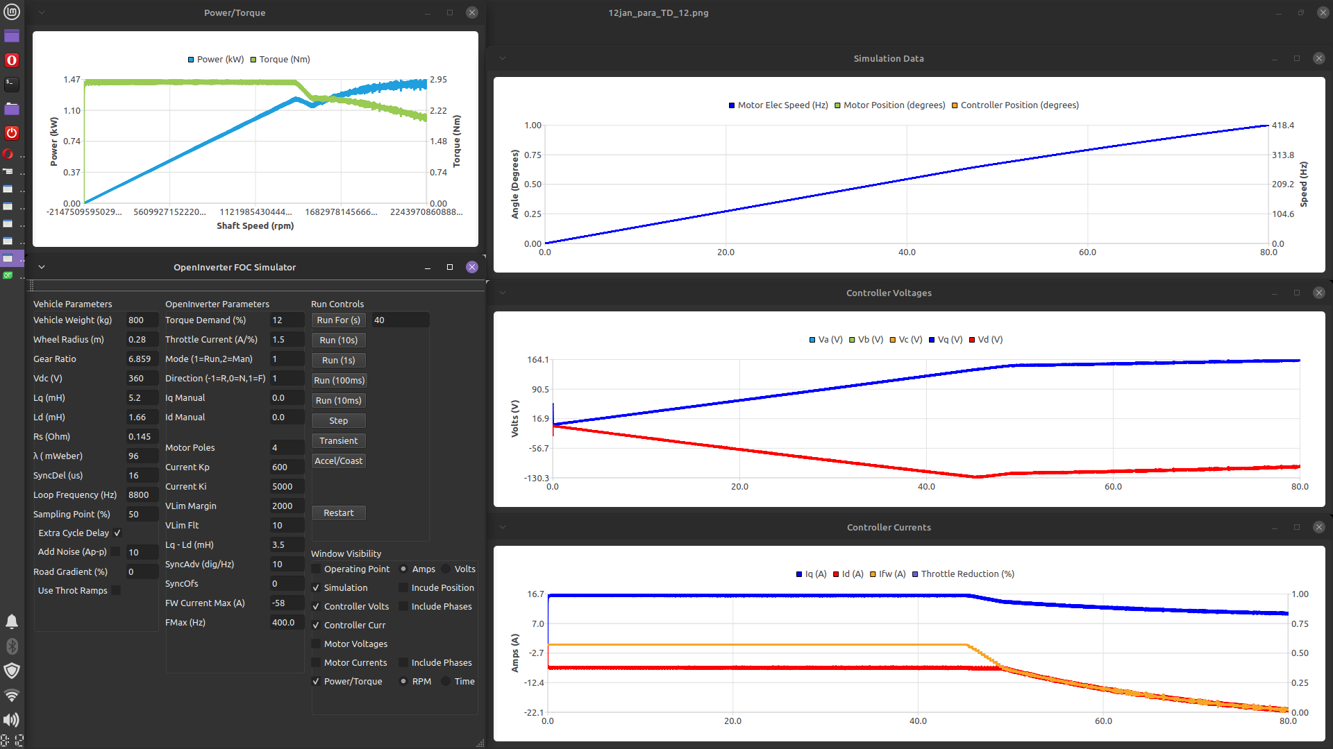

Then decrease Ki and slightly increase Kp
Kp 600, Ki 5000
Kp 600, Ki 5000
Looks promising, needs testing in car.
Did som Accel/Coast as well to see how it will respond to step changes. There is a slower respons with lower Ki, as expected.
Kp 500, Ki 10000
Kp 500, Ki 10000
Kp 500, Ki 2500
Kp 500, Ki 2500
Kp 600, Ki 5000
Kp 600, Ki 5000

My guess is that if you push ki too high the control loop becomes slightly unstable and its oscillations then start to interfere with the vlim loop. The two then fight each other. By reducing the margin you are effectively turning off the limiter, best stay at 2000 or above to make sure it has enough headroom. Reducing ki looks like the best approach here.
There were a couple of bugs in the old PI controllers (now fixed) that were partially masked by using high ki and I still wonder whether that is why such high values became common practice?
Edit - Ev8, 500 does sound a bit low but then its results that matter :), could you share your parameters, if I have time I'd like to have a look at how that works on the sim. Also what speed do you rev the motors to (higher speeds may need higher ki)?
Edit2 - the worst voltage component that the ki term has to deal with is the wLI term (both for d and q). The higher the speed (w), the higher the throttle (I) or the higher the motor inductance (L) the bigger it is and so the bigger ki needs to be. Once you find a value that works well with the 12% current demand check that it still gives good results at full throttle and high speeds as the lower value may be a little marginal there (worst case is when coming off the throttle at high speed as there is a large and rapid change in I which ki needs to keep up with).
