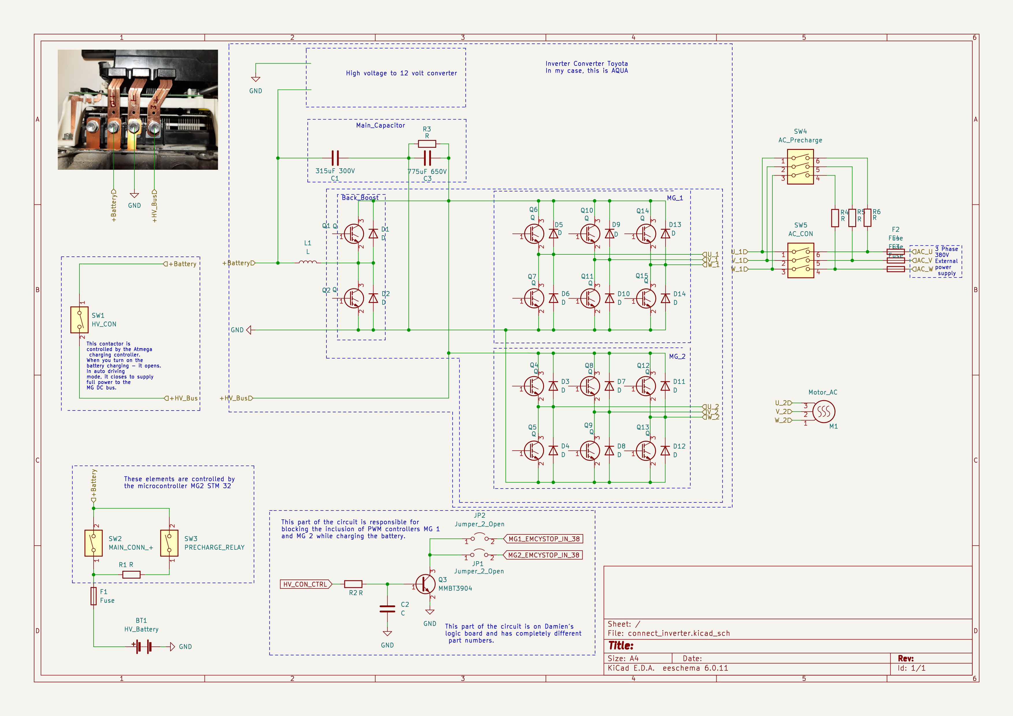

2nd question: Wiring diagram - did I do everything right?
HV _CON - Resistor required in parallel? Did I understand correctly?

Q1) If I remember correctly, adjust offset, with zero voltage present, until you read 0V. Then adjust gain (v/bit) with voltage present until ypu read correct voltage.
Q2) Looks correct. No resistor required in parallel with HV_CON.

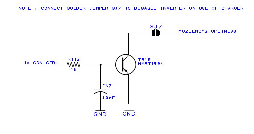

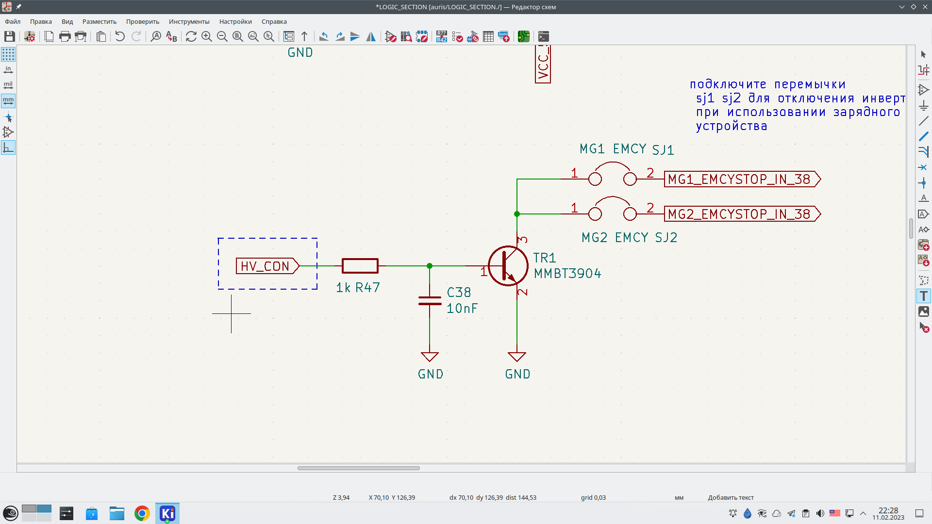

What are your options for controlling the main contactor "MAIN_CONN" ?
With a transistor (on my diagram below) - also a question: It opens when HV_CON is turned on and pulls EMCY_STOP to 0, which blocks PWM generation for the motor. Or I misunderstood something?
Well, in fact, in the debugging and configuration mode, I run it all through the arduino console. And how best to manage this charger?

Yahha777 wrote: Fri Feb 10, 2023 6:39 pm What are your options for controlling the main contactor "MAIN_CONN" ?
I don't understand your question? The main conctactor is controlled by the inverter. It will activate when you send "start" signal (via CAN or direct on start pin) if dc bus voltage is above "udcsw". There are no other options to my knowledge.
Yahha777 wrote: Fri Feb 10, 2023 6:39 pm With a transistor (on my diagram below) - also a question: It opens when HV_CON is turned on and pulls EMCY_STOP to 0, which blocks PWM generation for the motor. Or I misunderstood something?
No diagram attached to your post but I guess you refer to this section:
I never used that part but I agree, it's not good to activate "EMCYSTOP" when HV_CON is on as that is the driving mode. This function should be inverted, i.e. controlled by "HV_CON" and not "HV_CON_CTRL".
Should the charging current go through it? Right? And it is controlled by the STM-32 controller. Or make an external control of MG2_DCSW_OUT_2 or send a START signal to MG2_START_IN_58.
Yes that's right. HV_CON shorts the low side of the voltage to the high side. And when it is active, the STM-32 controllers should generate PWM for the motor. And in this version they are blocked. Do you suggest connecting the base of the transistor to the HV_CON pin?
Thanks a lot for the replies! I will try.

Yahha777 wrote: Sat Feb 11, 2023 10:22 am Should the charging current go through it? Right? And it is controlled by the STM-32 controller. Or make an external control of MG2_DCSW_OUT_2 or send a START signal to MG2_START_IN_58.
Yes, I ran it with all current going through it, controlled byt the STM32.
Yahha777 wrote: Sat Feb 11, 2023 10:22 am Yes that's right. HV_CON shorts the low side of the voltage to the high side. And when it is active, the STM-32 controllers should generate PWM for the motor. And in this version they are blocked. Do you suggest connecting the base of the transistor to the HV_CON pin?
Correct, that is my suggestion, to connect the base of the transistor to HV_CON via the 1k resistor (instead of HV_CON_CTRL). Note, I have not tested this my self. When I used the inverter as a charger I never noticed this functionality was on the board...

That's right. This is how the lock in charging mode will work correctly.

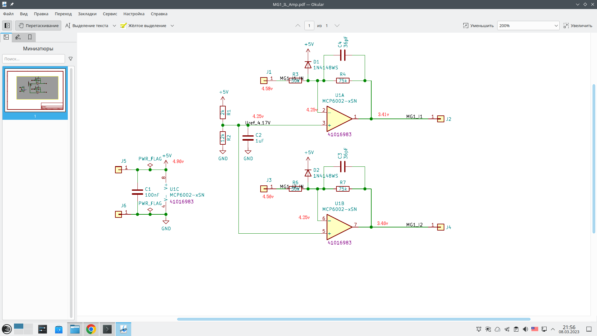

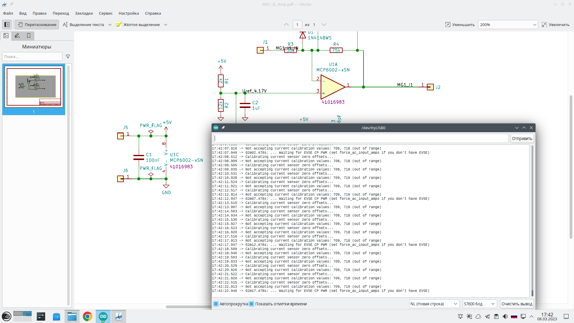

Everything stopped for me because of the annoying message of the current sensor.
how to set it up? I tried by selecting a voltage divider resistor R2 (12kOhm) - but there is such a narrow resistance range .... And when the inverter is turned on again, this divider parameter is no longer suitable. At the 3rd output of the Atmega 4.25 volts. Maybe there is an opportunity to fix this in the Atmega code?

What does your HW setup look like? Are you running an extra mod-board with op-amps, like in the schematic in your screenshot?
The log implies that the 328p receives approx 3,5V at the current sensor inputs and the standard SW expects 2,5V.
When running the above mentioned op-amp you should have a 2,5V input with zero current if everything is ok.

These are the voltages around the operational amplifier. :?

The current sensor output voltages seem low, should be closer to 5,0V when there is no current?
What are the supply voltages to the current sensors, +5V, -5V and 26V?

instead of 26 volts - 11.5. This is a fiasco. :(
I will understand the problem of powering the 26 volt circuit. Here the problem with the -5 volt power supply caused trouble. For some reason, the LM2776 does not want to start when the inverter is running on battery power. If I connect the power supply - it starts.

26 volts - there is an unsoldered resistor in the strapping of the converter chip. For some reason, the 5 volt to -5 converter stopped starting at all under load. :roll:

With good help - the problem was quickly solved!
and the annoying LM2776 chip in the next edition of the printed circuit board was replaced with a MAX735CSA + T. We continue to continue! :D

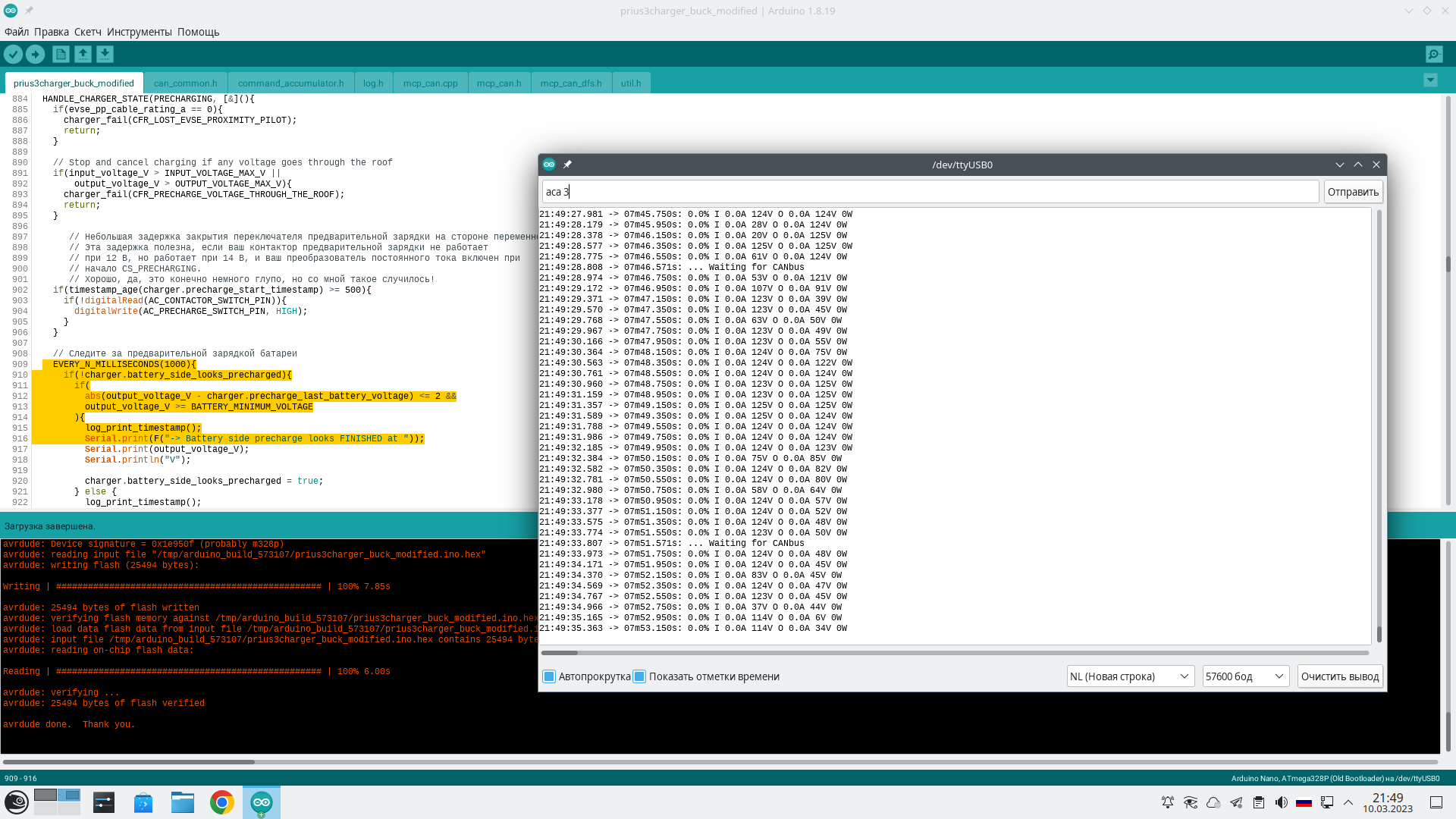

My actions:
1 I supply 12 volt power to the inverter board - "PRECCHARGE_RELAY" is turned on, as well as "HV_CON"
2 button start I start the inverter - turns on "MAIN_CONN"
3 I pull EVSE_PROX to the ground, in the terminal I give the command "aca 3" - "HV_CON" is turned off, that's it.
what conditions must be met to enable "AC_Precharge" and further start the inverter?

Looks like you need a CAN-bus connected between the charger and BMS.
HANDLE_CHARGER_STATE(WAITING_CANBUS, [&](){
		if(CANBUS_ENABLE){
			if(canbus_alive()){
				log_println_f("CANbus detected");
				charger_state = CS_WAITING_CHARGE_PERMISSION;
			EVERY_N_MILLISECONDS(5000){
				log_println_f("... Waiting for CANbus");
		} else {
			// Skip ahead, we don't need no CANbus!

You need to edit the code to your liking for the CAN part. Either make it understand your BMS, or disable the CAN requirements.

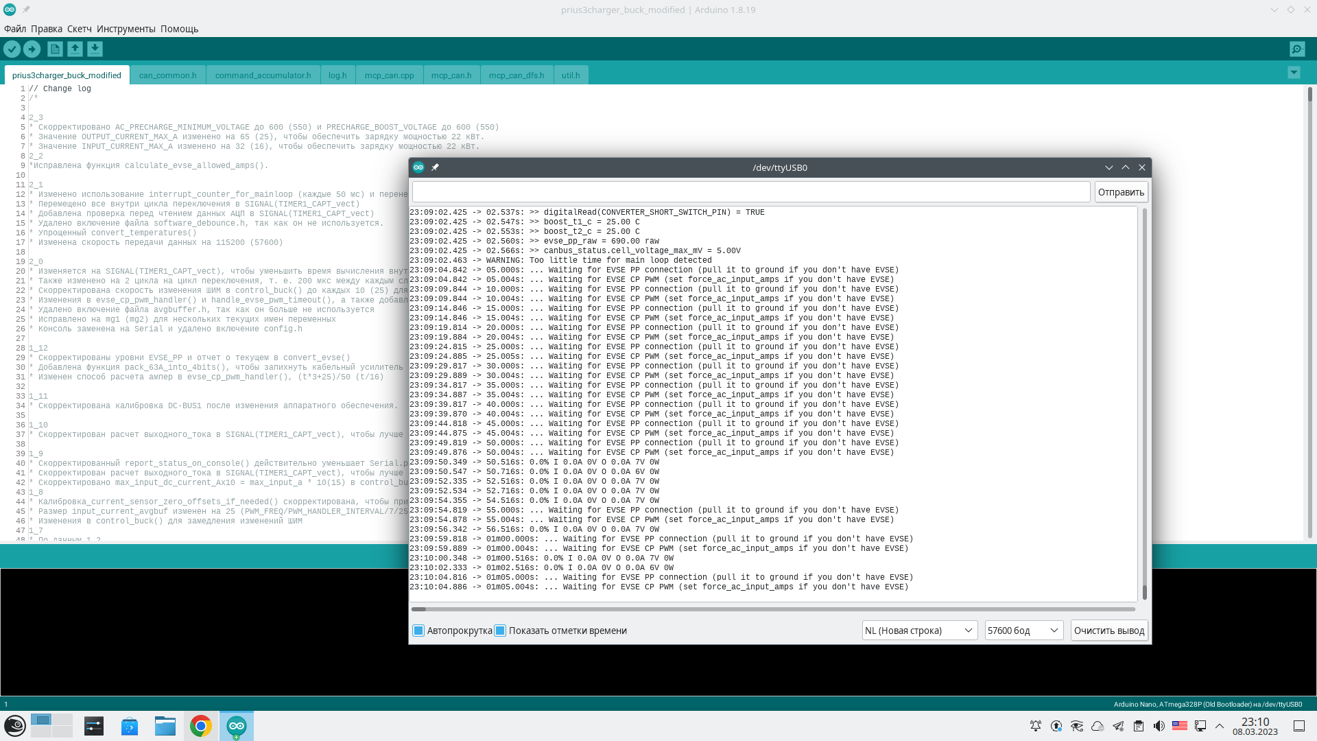

I don't have BMS yet. I'm experimenting with lead batteries
turned off the kanbus and saw - 10:27:39.662 -> 23.112s: >> digitalRead(AC_PRECHARGE_SWITCH_PIN) = TRUE :D

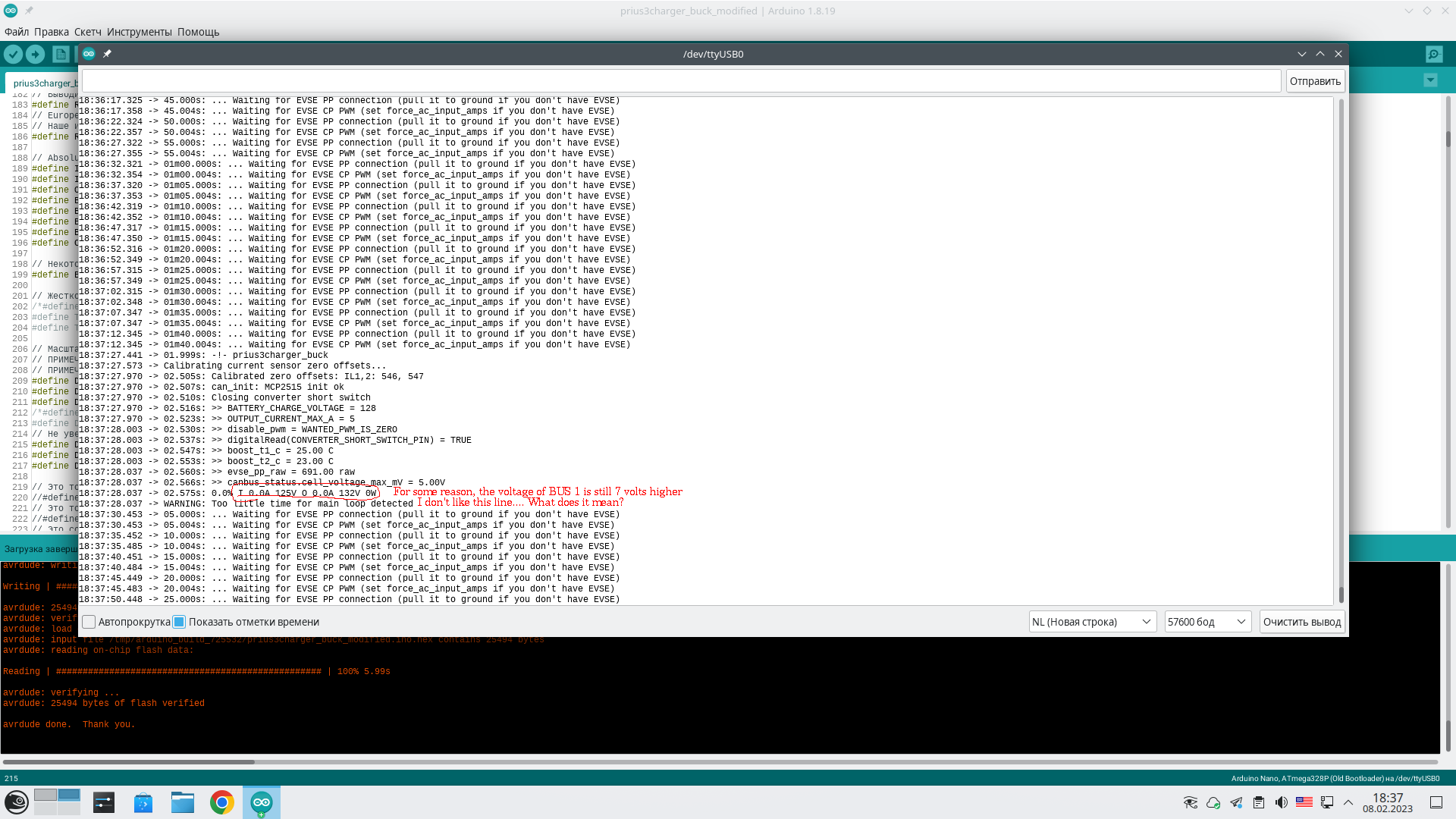

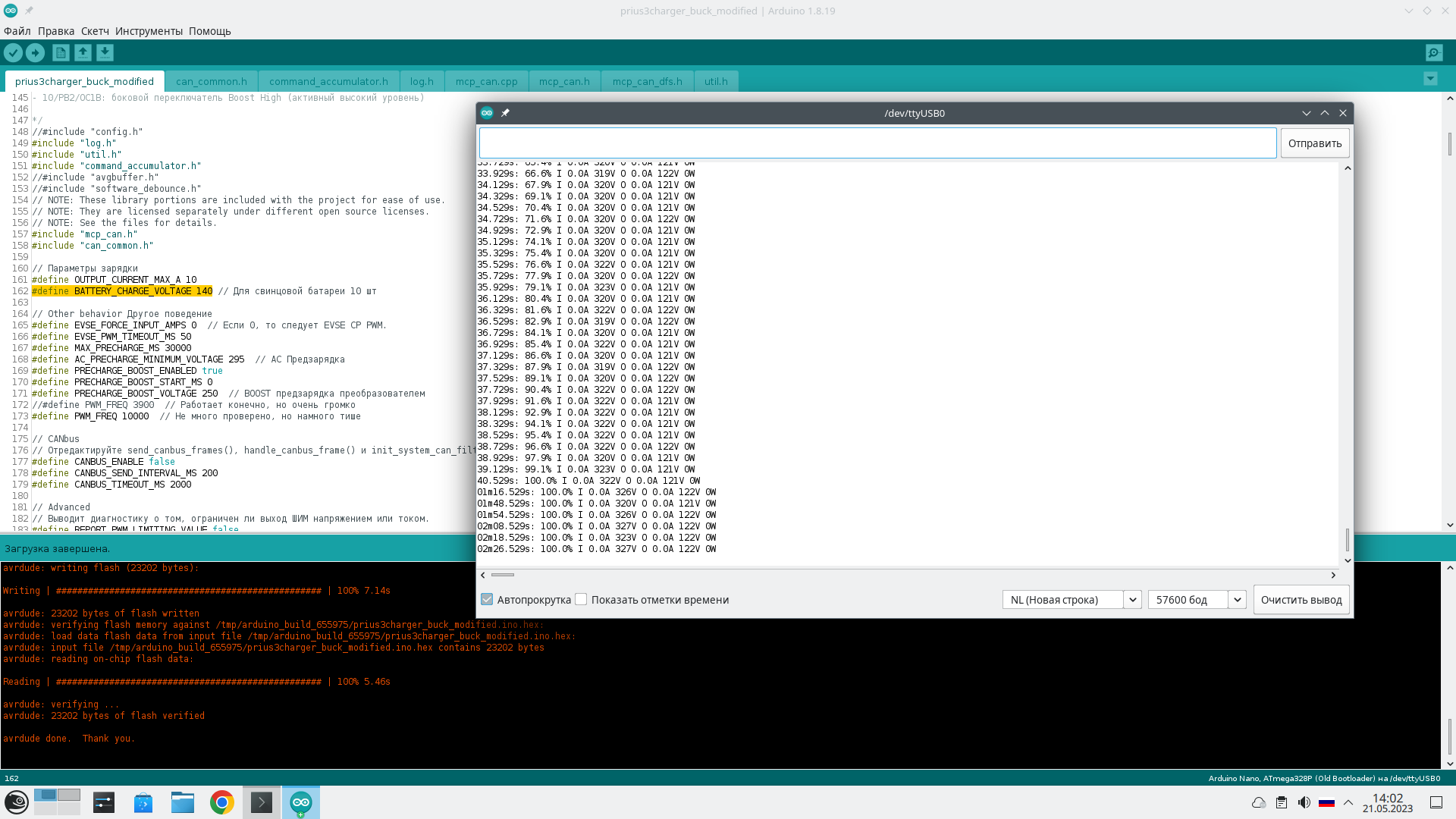

Hello! So I got back to my charger. So - my configuration: battery - lead 10 * 12 volts(120 volt). The mains voltage is 235 volts, 1 phase is supplied to the rectifier terminals with current sensors. The whole cycle is worked out - but there is no charging current. :( What can be recommendations?
#define EVSE_FORCE_INPUT_AMPS 0 // I tried to change - this did not give anything ...
Here is the terminal output:
Charge.txt

Yahha777 wrote: Sun May 21, 2023 11:17 am Hello! So I got back to my charger. So - my configuration: battery - lead 10 * 12 volts(120 volt). The mains voltage is 235 volts, 1 phase is supplied to the rectifier terminals with current sensors. The whole cycle is worked out - but there is no charging current. :( What can be recommendations?
Here is the terminal output:Charge.txt
Hello,
I think your EVSE_FORCE_INPUT_AMPS 0 should be your charging AMPS if not using an EVSE
what is your INPUT_CURRENT_MAX_A?

Mhs wrote: Tue May 23, 2023 2:35 pm Hello,
#define EVSE_FORCE_INPUT_AMPS 3
#define INPUT_CURRENT_MAX_A 25

Yahha777 wrote: Tue May 23, 2023 3:36 pm #define EVSE_FORCE_INPUT_AMPS 3
I believe 3 is low,
Did you pull PP to ground? Your terminal output suggest something going wrong with the signals

Re: Gen 3 inverter converter control software
Post by Yahha777 »
I think that the program expects EVSE CP PWM
#define EVSE_FORCE_INPUT_AMPS 3 //set to 10 - nothing changed
01m51.162s: Command: r
01m51.163s: >> BATTERY_CHARGE_VOLTAGE = 140
01m51.164s: >> OUTPUT_CURRENT_MAX_A = 20
01m51.171s: >> disable_pwm = PWM_ENABLED
01m51.178s: >> wanted_output_voltage = 140.00 V
01m51.186s: >> wanted_output_current = 20.00 A
01m51.195s: >> wanted_pwm = 100.00 %
01m51.201s: >> digitalRead(AC_CONTACTOR_SWITCH_PIN) = TRUE
01m51.211s: >> digitalRead(AC_PRECHARGE_SWITCH_PIN) = FALSE
01m51.221s: >> digitalRead(CONVERTER_SHORT_SWITCH_PIN) = FALSE
01m51.233s: >> boost_t1_c = 26.00 C
01m51.239s: >> boost_t2_c = 24.00 C
01m51.245s: >> evse_pp_raw = 400.00 raw what does this mean?
01m51.252s: >> get_max_input_a() = 3
01m51.258s: >> charger_state = CS_CHARGING
01m51.265s: >> charger.fail_reason = CFR_NOT_FAILED It's the same that confuses me
01m51.275s: 100.0% I 0.0A 322V O 0.0A 122V 0W
WARNING: Too little time for main loop detected
