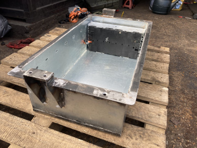

Has anyone installed these modules on their side rather than flat? Is there a good reason not to do so?
chrskly
Posts: 153
Location: Dublin, Ireland
Has thanked: 55 times
Been thanked: 42 times
Post by chrskly »
I guess since they're cooled out the bottom plate you might want to have their bottoms touching the outside wall of the battery box. Not that they get very hot by all accounts (not firsthand knowledge).
bobby_come_lately
Posts: 467
Location: Manchester, UK
Has thanked: 41 times
Been thanked: 40 times
Post by bobby_come_lately »
chrskly wrote: Fri Aug 06, 2021 2:53 pm I guess since they're cooled out the bottom plate you might want to have their bottoms touching the outside wall of the battery box. Not that they get very hot by all accounts (not firsthand knowledge).
This was my thinking. But the temps really don't seem to change much, at least on charging. I've only charged at 8A so far but the temperatures didn't move more than a degree.
If I can rotate the modules 90 degrees I can fit five side by side between my chassis rails, saving a load of space in the engine bay and lowering the weight down in the car. Might give it a try.

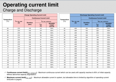

Living in Finland, the first thing I really want to know about batteries is in what temperature they can be charged. I'm planning to use these without active heating, so I needed to find some source of information.
Well, the closest I could get was a datasheet for some Samsung SDI 94 cells, which I guess are used by BMW in the i3. I think these PHEV cells are the same series, but with less energy density and more power density. I'm going to assume these can take about half the charge current of those 94Ah cells:
I think these are pretty good batteries for cold climates, as they can always be charged, albeit with lowered current. No need to waste energy heating them just to charge them.
Even so, if you have just a measly 3.3kW charger, you don't need to even think about current limits before -25°C, which is really nice. You do need to be aware of this for regen though, pretty much right at 0°C.
Here's where I found the datasheet: https://shop.gwl.eu/Samsung-SDI94-NCM/L ... g-NCM.html

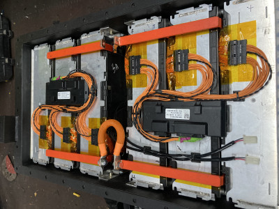

OutlandishPanda wrote: Thu Jul 09, 2020 7:54 am Got to my pack, connected a MCP2562 transceiver to a Teensy 3.2, loaded SimpBMS BMW PHEV as per Tom's posts above (latest version) and connected as below. Success!! I can see all the modules and cells and its a healthy pack. Couldn't test balancing as my pack seems well balanced (2mV delta), which was a surprise given it has sat untouched for many months. I assume it can't balance disconnected from the vehicle?
A few pics of my setup and links if that is any help to anyone below.
Transceiver (I used 2562 and connected VIO to 3.3V):
http://ww1.microchip.com/downloads/en/D ... 05167C.pdf
Tom's code:
https://github.com/tomdebree/BMWPhevBMS
I disconnected the BMW BMS and connected in to the blue connector: PHEV CAN2b.jpg
You can see from this picture of my breadboard I had to terminate the CAN lines at the transceiver with 120R.PHEV CAN3.jpg
The 3 first modules power and CAN is separate from the last 2, so needs two sets of 5V connections.
The CAN lines for the 3 and 2 module sets also "seem" to be separate, measuring the continuity of the CAN lines to the modules and this connector, but only one of the CAN lines for the first three modules needed to be connected to be able to see them all on that CAN bus. No idea how/why, but seems to work fine and means termination is easier. Perhaps I measured it wrong.
The 5V line takes about 64mA when enabling all 5 modules, so probably also powering some of the logic of those boards.PHEV CAN1.jpg

So, from what I've found on the web, the 330e pack, I think, will do somewhere between 23kW and 32kW continuous power (with cooling), and 58kW to 65kW peak for 10 sec (With lots of cooling!) Some references state 70kW peak, and BMW state the 330e has a 65kW motor, which would match a 70kW battery peak, but that seems quite extreme!
The usable capacity is consistently stated as 5.7kWh. We can work out the usable SOC range and so voltage range from that.
These are all with a very capable, active refrigerant system. Unless that is re-instated, I'm not sure we can access those peak power ratings very often! Also, I'd wonder if the BMW BMS would be modeling the thermal behaviour of the cells vs current in and out and be running a kind of feed forward control to the cooling system. Activating cooling from the sensor measurements may be too slow I'd guess? For a huge EV pack I don't think this is such a big deal but operating these small PHEV packs at peak power for more than a few seconds is going to need care I think?
