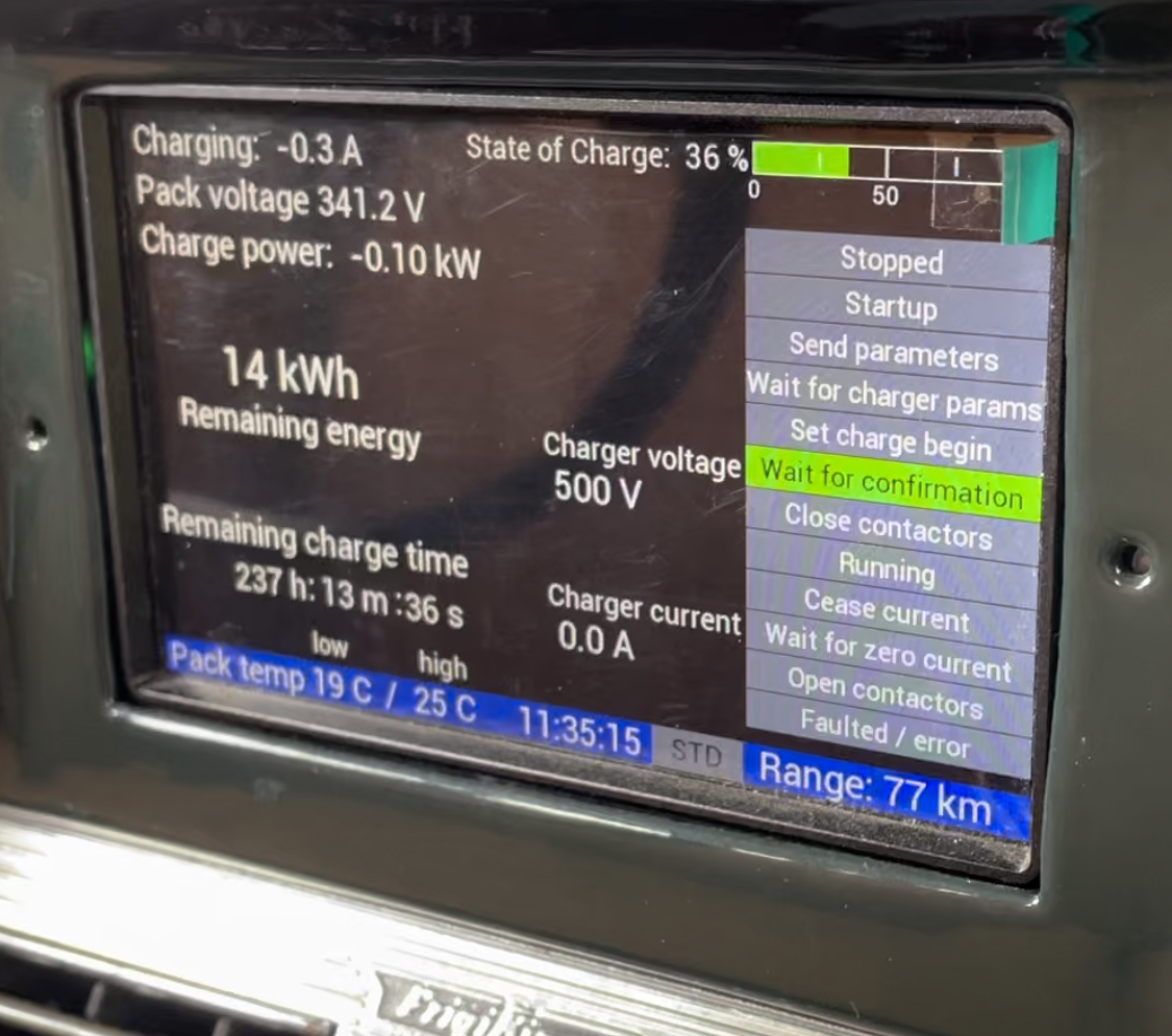

Correct, the isolation test is indeed during the “Wait for confirmation” state.
Car contactors open and CHAdeMO contactors closed does not happen.
You need to send “car in charge enable” aka “ready to receive charge”. So at that point the car contactors are closed. Only further down the process the CHAdeMO contactors close. If you open the car contactors amd thus send “car not ready to receive charge” the process will abort. See process flow here https://www.evcreate.nl/chademo-fast-ch ... mo-process

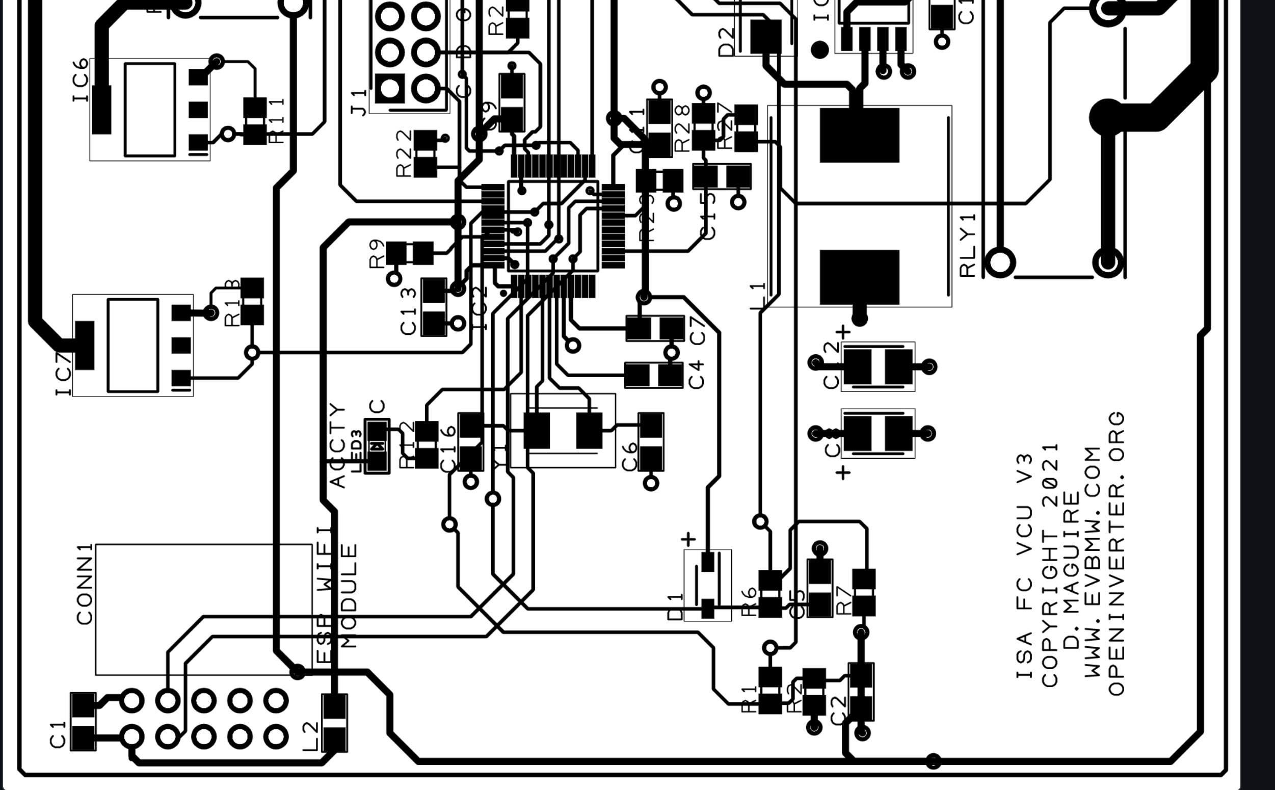

Hello,
How does the web interface work with this board, I have flashed the board and I had a spare esp8266 for an inverter board I had. Do I need the flash the esp8266 with and updated web interface?

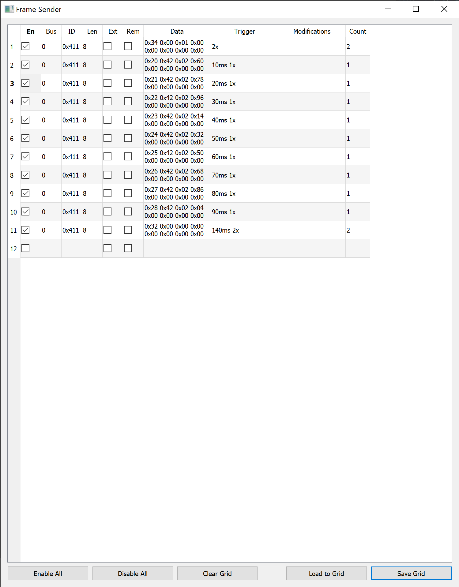

This question may be dumb, but, well, I'm dumb.
Do I need to do anything to the ISA shunt to set it up for use? Right now I just wired it up and that's it.
I went and attempted to charge for the first time today, and it appears that the process failed right when the board started to need info from the shunt. Frankly, it was too cold to do other trouble shooting even though I had a CAN sniffer with me.
Isaac96
- Posts: 656
There is an initialization procedure in the library (it tells the shunt to send more things, changes timings, and changes endian-ness).
Assuming you're running one of the Due-based boards, the SimpleISA example has an initialization function triggered by pressing 'i' in serial monitor.

I just soldered up my board, upon looking through the GitHub there’s :
https://github.com/damienmaguire/Chadem ... _HowTo.pdf
And
https://github.com/damienmaguire/Chadem ... /SimpleISA

Isaac96
- Posts: 656
You could also use whatever other CAN board you have available to send the required messages.
These are just pasted from the SimpleISA library in current use on the Due-based Chademo boards.
STOP command:
<code>
outframe.id = 0x411; // Set our transmission address ID
outframe.length = 8; // Data payload 8 bytes
outframe.extended = 0; // Extended addresses 0=11-bit1=29bit
outframe.rtr=1; //No request
outframe.data.bytes[0]=0x34;
outframe.data.bytes[1]=0x00;
outframe.data.bytes[2]=0x01;
outframe.data.bytes[3]=0x00;
outframe.data.bytes[4]=0x00;

And the settings command:
<code>
for(int i=0;i<9;i++)
Serial.println("initialization \n");
outframe.data.bytes[0]=(0x20+i);
outframe.data.bytes[1]=0x42;
outframe.data.bytes[2]=0x02;
outframe.data.bytes[3]=(0x60+(i*18));
outframe.data.bytes[5]=0x00;
outframe.data.bytes[6]=0x00;
outframe.data.bytes[7]=0x00;
canPort->sendFrame(outframe);
if(debug)printCAN(&outframe);
delay(500);
sendSTORE();
delay(500);
</code>
You go STOP, settings command, then STORE.
The incrementing for 'i' in the settings command cycles through all 9 available readings, sets them all to cyclic, sets the bit ordering, and sets the interval.
I'm really not sure what the intervals are - they are set by bytes 2 and 3 but byte 3 gets modified by the value of i for some reason.

Ok, I am going to attempt to use Savvy CAN to send the messages.
Isaac and/or others, would you mind looking over what I have to make sure I've got it right before I send it? I think I may have screwed up the data because hexadecimal and I are not friends.
Isaac96
- Posts: 656
18 decimal is 0x12 hex.
So for those incrementing bytes (data byte 3 counting from 0):
0x60
0x72
0x84
0x96
0xA8
0xBA
0xCC
0xDE
0xF0
That should match the original library's outputs. Not sure if those are desired values but it appears to be what works.
And perhaps a longer delay before sending the 'store' command -- I think the shunt needs time to save the values. Say 500ms? (Again copying the library.)
Otherwise all looks good!
