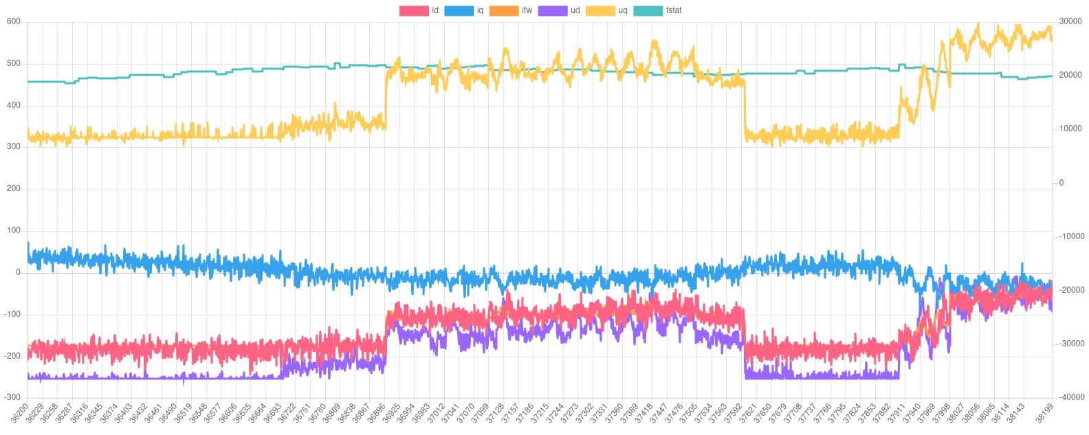

I've also been out for a run and I think I've pretty much nailed it.
Only software change as been the anti-windup scheme from above, everything else untouched.
I increased fwki to 500 and started with fwmargin 4000. It never saturates, no weirdness when coming off throttle and regen works as expected. Remaining weirdness was non-linear throttle response, so as soon as FW starts, the car accelerates more.
This next one was downhill. fwmargin 2700. I came off throttle but the car was merely coasting, no regen. Thus sped up past fmax, but by gravity, not electricity. Touched the brake pedal which increases regen and then regen came in nicely. What exactly limited it I'm not sure.
Final run, fwki=300 and fwmargin=2500. We see saturation again but throttle response is now linear. Regen comes in without issues at 7000 rpm.
EDIT: plots look a little different today as I took 100 sample bursts. All the jumps you see are artifacts

One word of warning: since we are now successfully putting throttle-independent current into the motor it is possible that the rev limiter no longer works in a no-load scenario. The slightest misalignment will create some small amount of torque which is not noticeable when attached to the weight of a car but could become very destructive on an unloaded rotor.
So do not rev up the motor beyond base speed when it is not loaded!
Posted: Sun Sep 11, 2022 11:16 am
by Pete9008
johu wrote: Sat Sep 10, 2022 4:42 pm EDIT3: liking this so much that I drafted a new release viewtopic.php?t=2650
Got to say I feel a bit awkward about this! I post saying I think there is a stability issue with the controller, you post saying it's all good and here is a new release. It's your code and your descision but it's not a way of working that I'm particularly comfortable with :?
At the risk of sounding like a broken record, please be careful. In your final plot both Iq and Id controllers look like they are maxed out for a lot of the run meaning that they are running open loop and not fully controlling the motor. It doesn't look like it caused any issues but it's not a good place to be above base frequency.

Pete9008 wrote: Sun Sep 11, 2022 11:16 am Got to say I feel a bit awkward about this! I post saying I think there is a stability issue with the controller, you post saying it's all good and here is a new release. It's your code and your descision but it's not a way of working that I'm particularly comfortable with :?
Yes, I hear you, but: it is an improvement over the version before that (5.14.R) that certainly developed unwanted regen even at relatively low speeds.
Pete9008 wrote: Sun Sep 11, 2022 11:16 am At the risk of sounding like a broken record, please be careful. In your final plot both Iq and Id controllers look like they are maxed out for a lot of the run meaning that they are running open loop and not fully controlling the motor. It doesn't look like it caused any issues but it's not a good place to be above base frequency.
yes, agreed. Essentially that limits FW current but the cleaner solution would be to have an extra parameter for maximum FW current rather than just setting it to throtcur*50.
EDIT: in the first plot it looks much nicer but it felt much worse. Field weakening current also creates reactance torque creating large torque ripple as it comes and goes.

johu wrote: Sun Sep 11, 2022 1:48 pm EDIT: in the first plot it looks much nicer but it felt much worse. Field weakening current also creates reactance torque creating large torque ripple as it comes and goes.
I'm not convinced it's reluctance torque. I think it's caused by the change in the rotor angle between the commanded Iq and Id being calculated and the time they actually take effect. This means that the motor sees a chunk of the -Id as torque producing Iq and a chunk of the commanded Iq is wasted generating positive Id. Something along these lines should help:
in foc.c
void FOC::SetAngle(uint16_t angle, uint16_t syncadv)
   sin = SineCore::Sine(angle + syncadv);
   cos = SineCore::Cosine(angle + syncadv);
inpwmgeneration-foc.c
at the top
      CalcNextAngleSync(dir);
      FOC::SetAngle(angle, 0);
and lower down
      s32fp syncadv = FP_MUL(frqFiltered, Param::Get(Param::syncadv));
      syncadv = MAX(0, syncadv);
      FOC::SetAngle(angle, FP_TOINT(dir * syncadv));
      FOC::InvParkClarke(ud, uq);
More details of what it's doing is here viewtopic.php?p=45185#p45185. It should help by better aligning the Id and Iq to the rotor position. It should also reduce the magnitude of the commanded Uq which will help keep the Uq and Ud controllers running closed loop.
I may not help but without trying it we won't know (and in any case the results from trying it will help understand exactly what is going on).
