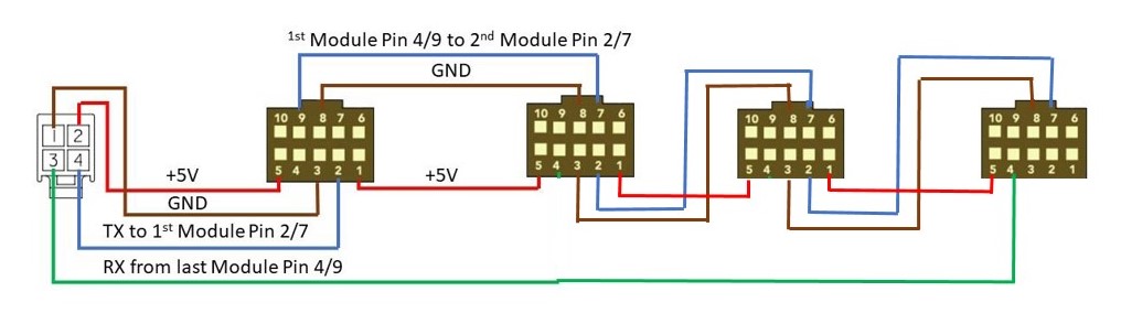

Hello All
Having a bit of trouble with my SIMP BMS and was wondering if all you highly intelligent people could lend a helping hand!
I am running 4x tesla modules split up into banks of two and for some reason when i connect to the serial interface it only recognizes one bank (two modules)
I'm pretty sure my wiring is correct and both banks are getting +5v. Question is how do I find out which bank is or isn't registering?
BMS status is ready but only registering half the pack!! any ideas??
Thanks!
Posts: 2393
Location: Bristol
Has thanked: 207 times
Been thanked: 563 times
Re: Simp BMS
Any diagram of your wiring? If you only got half the banks reading unplug to find the offending plugs.
Reading only half is very very strange and points to a wiring issue 100% due to the way information is daisy chained.
Jackk
Posts: 57
Joined: Thu Dec 17, 2020 6:29 pm
Re: Simp BMS
Post by Jackk »
Hi Tom,
thanks for your time, please check out my wiring and tell me if you spot anything off...
I cant see how pulling the plug to each module will work as its a daisy chain so if I pull the any of the plugs I will get no readings whatsoever as it breaks the circuit, what am I not understanding here?
Each module has a blinking LED. I presume that means power or comms?. another question does the HV circuit need to be connected, have had it connected and doesn't seem to make any difference....
Jack
Posts: 2393
Location: Bristol
Re: Simp BMS
LEDs blink a bit on first power application.
They will keep blinking during correct comms.
If only a few modules show up when wired like shown above it should mean comms do work but there is another issue.
Try using the reset switch on the teensy while the setup is powered on, this should have the LED on the Teensy turn off and then back on after a few moments. This may solve the issue, if it is down to the startup.
What software version is listed in your settings menu?
Bryson
Posts: 179
Location: California
Re: Simp BMS
Post by Bryson »
Wiring looks incorrect based on the diagram above. It should always go pin 4/9 -> 2/7 from left to right.
Cables from connectors 2-3 and 3-4 need pin 2 moved to pin 4
Jackk
Posts: 57
Re: Simp BMS
Post by Jackk »

Jackk
Posts: 57
Re: Simp BMS
Post by Jackk »
Bryson wrote: Tue May 04, 2021 2:41 pm Wiring looks incorrect based on the diagram above. It should always go pin 4/9 -> 2/7 from left to right.
Hi swapped pins 2 to 4 on connector two and three and now getting fault...
BMS Status : 5 Error 0
Out:0000 Cont:0000 In:0000 Charge Current Limit : 0 A DisCharge Current Limit : 0 A

Bryson wrote: Wed May 05, 2021 2:23 pm How many modules is the BMS recognizing? All four?
Only recognizing two modules (four wired up) . All four leds are flashing. Really at a dead end with this one as have checked wiring countless times... any more suggestions would be fantastic!
Jack

Jackk wrote: Sun May 09, 2021 5:48 pm
Jack
Jack, the way you wired (picture you posted earlier) you basically skip the middle two modules. the comms pins you connect to are connected top/bottom, so that's why you only see the first and last module.
the led's can flash even without anything connected, and they probably flash due to 5v being present.
Tom already wrote about your wiring error.

Post by Jackk »
Thanks boekel!
OK sorry if I'm being a bit stupid but what alterations to the RX and TX do i need to make on modules 2&3...
I tried Brysons suggestion but no joy!
Many thanks for your help!
boekel
Posts: 135
Been thanked: 23 times
Re: Simp BMS
Post by boekel »
Jackk wrote: Sat May 15, 2021 6:53 am Thanks boekel!
look at the last module...where does that connect? the same should be done with he middle modules. so use pin 2 instead of pin 4
