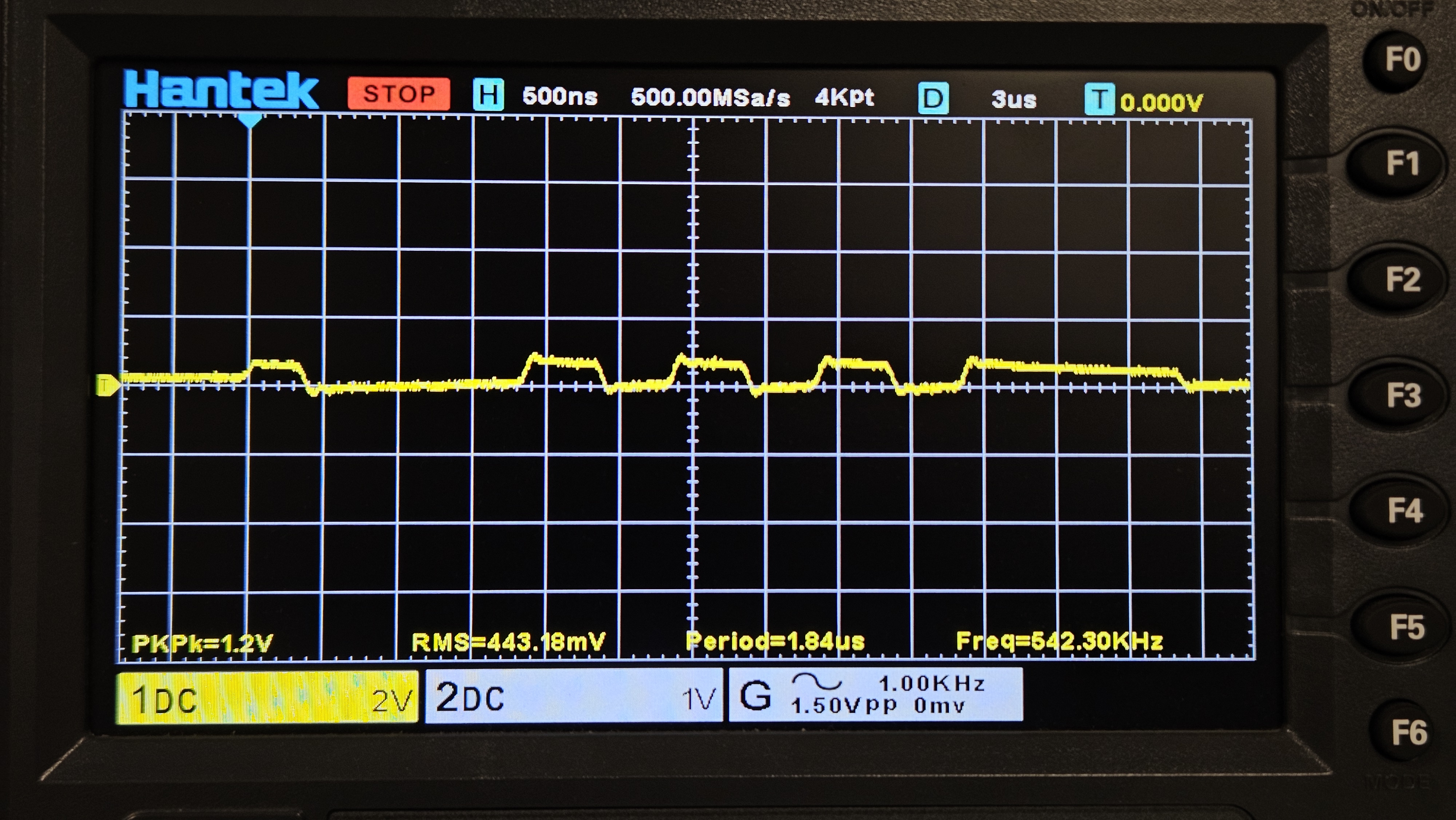

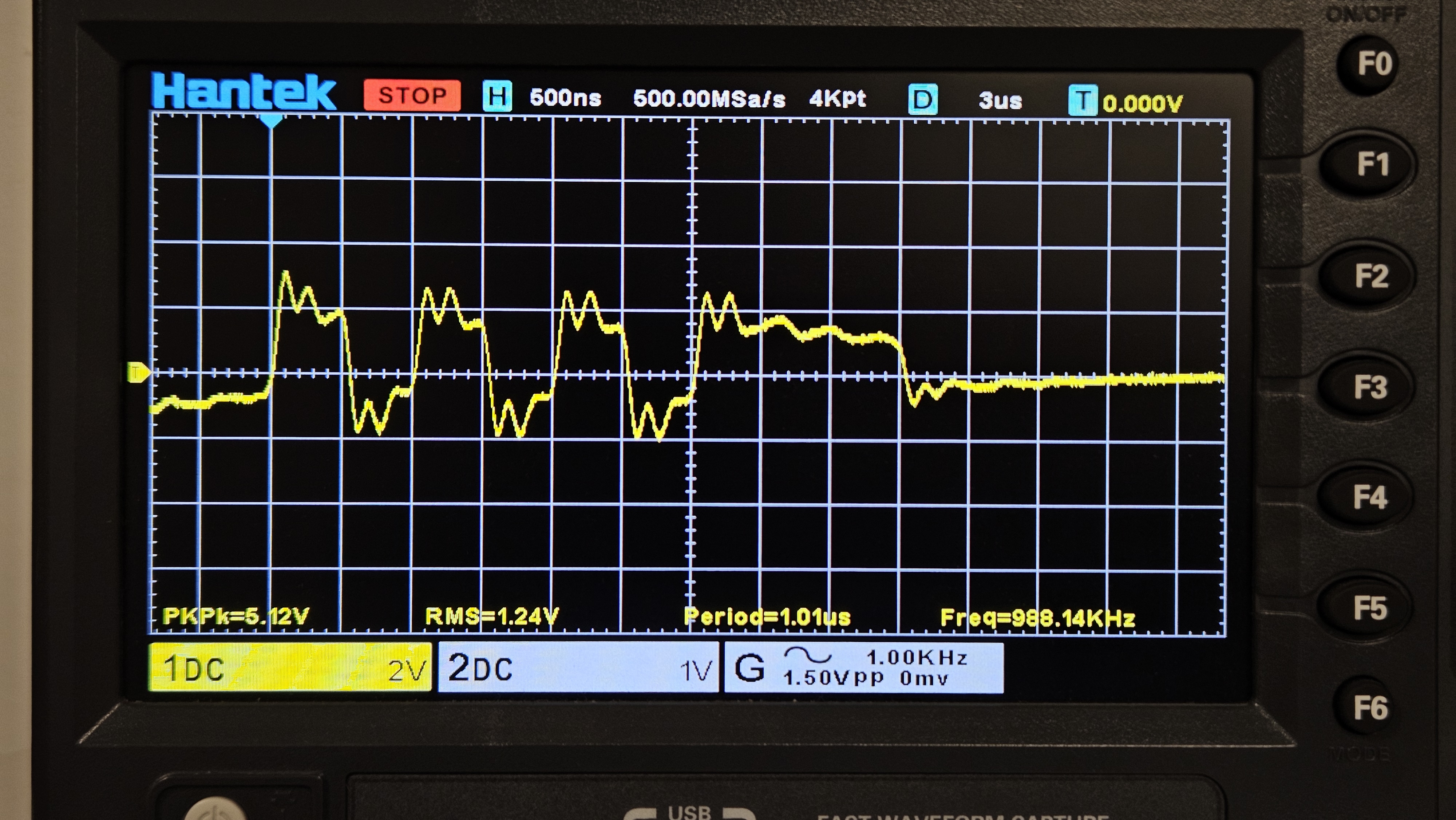

Do these signals look right?
TXP before transformer
TXP after transformer
TXN before transformer
TXN after transformer
Re: Kia Niro BMS
Posted: Mon Nov 24, 2025 5:52 pm
by bexander
They don't look bad to me.
How does the RX singals look before and after the transformer?

RXP before transformer
RXP after transformer
RXN before transformer
RXN after transformer
With the BMS_test_OI_modified2.ino code from bexander
EDIT: Could someone scope their signals? Then I know what the signals have to look like. Did grab another module, but still no data coming out of them

The RX signals look very similar in amplitude to the TX signals, and that is a very good thing. Your signals seem ok at this stage.

Yes 211 is indeed impossible. Don't know where this number comes from. Loose wires? I only have some cables for the loopback and all other connectors are not plugged in. So I think the 0xD3 is just a random number that the code sends? I will have a look at connecting all the slaves. Only got 2 modules missing. One module damaged and the other one lend it to a friend that also recently bought a E-208 pack. I will update my findings.
Also I get the same signal in the loopback that looks like image 1 en 3 from my post about the RX signal. Do these signal come from the MAX17854 chip on the slave PCB or from a circuit on the slave PCB. I don't think my MAX17854 is waking up? Or it doesn't recognize the signal i'm sending? This code was written for modules with a MAX17823 chip if i'm correct?
