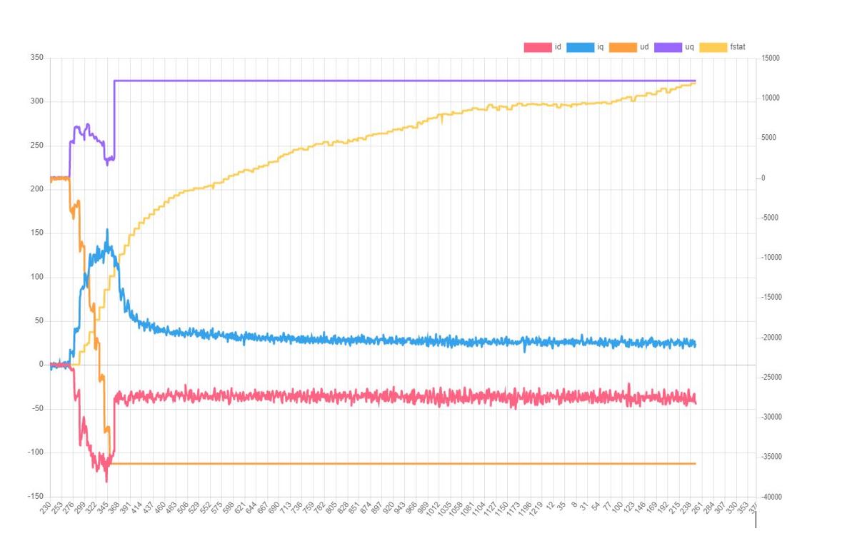

celeron55 wrote: Wed Dec 30, 2020 11:11 pm Can you collect a plot of fstat, id, iq, ud, uq of an acceleration from 0 to 40mph all the way to where the speed has plateaued so that we can see what FOC is doing when the car doesn't accelerate anymore?
I did this test today and have attached a plot. This was 0 to around 50mph on a fairly flat road with full throttle (once I'd begun moving). Contrary to what I said before, it would continue to accelerate, I just ran out of road. It just accelerates very slowly after the initial nice strong acceleration, any kind of incline limits the top speed massively.
I have also attached the current parameters I'm using. One thing I don't really understand is the throtcur parameter. I found last time that when I increased this to the maximum value of 10 it helped a lot. However, in theory I guess this means that at 100% of throttle it should be demanding 1000A. I'm obviously not getting anywhere near this so what is limiting the current? Is this all back EMF/field weakening related? Just seems that I should be supplying more current (at least during the first section of the plot) with 100% throttle acceleration.
I'm still having some overcurrent errors (even with the fault signal line from the Prius disconnected) when under load at low speeds or when releasing the throttle too quickly. It is also still jerky and very difficult to control at very low speeds. It's almost impossible to start from a standstill on a hill.
Any suggestions or advice much appreciated!

I’ve just noticed that Johannes released a firmware update last week that may help with the low speed jitter. I will try this and report back.
I’ve also been comparing my plot to Bexander’s. They appear to show exactly the same behaviour with mine just being at a higher frequency due to the higher pack voltage. Is there anything I can try with parameters to see if the performance in the field weakening region can be improved? Or does it look like this is just a characteristic of this motor and higher voltages will be needed?

As johu said in Bexander's thread (viewtopic.php?p=18453#p18453), uq and ud are maxing out, meaning the inverter is putting out maximum PWM, meaning the motor won't take more current without more battery voltage. The only thing that can be adjusted at that point is the Iq to Id ratio, but I'm thinking there's probably not much to gain there as this motor is fairly similar to what the FOC code has already been tuned for.
Increasing throtcur will help in the lower rpms where the motor is willing to take more current but 1000A should probably trigger an overcurrent event. Is your potnom reaching 100%?

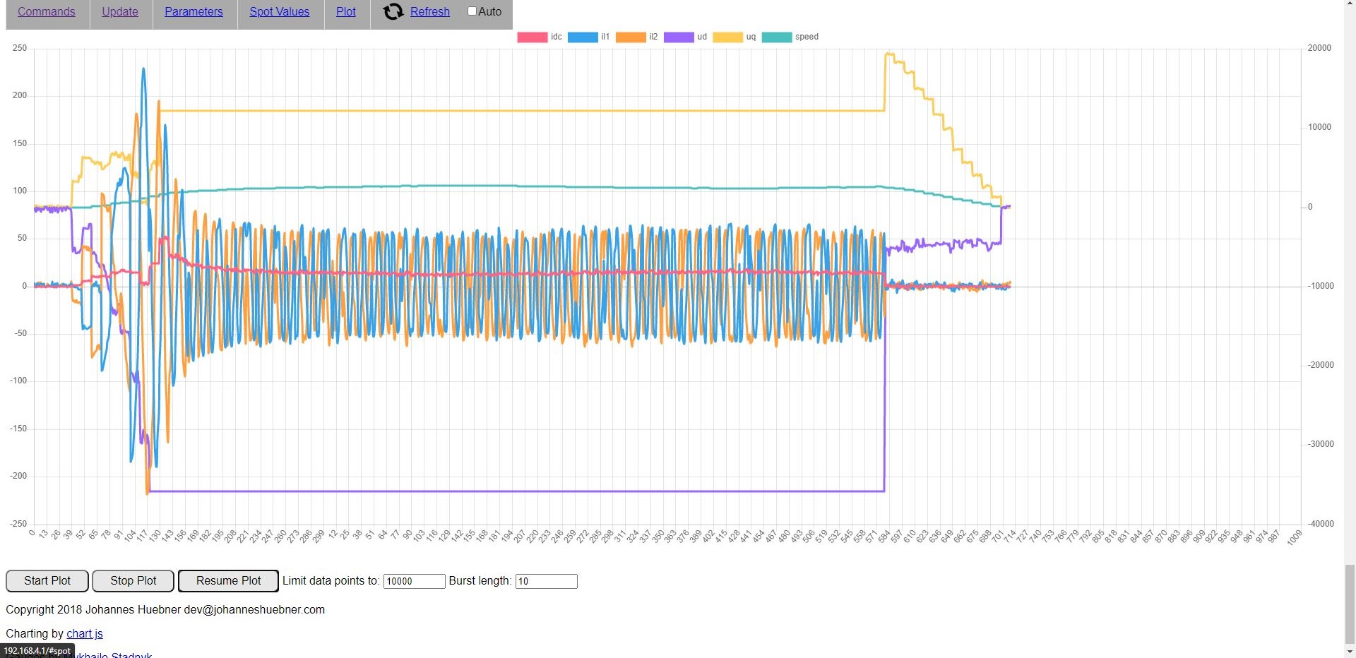

Updated to 4.97 firmware and also played around with some of the parameters. I've reduced the throtcur back down and increased the throtramp back up. This combined with the firmware update has made the low speed control much better.
I also did some testing on a hill. I started from a standstill on a hill (approx 500m long with a constant 7.5% incline). At full throttle I was able to accelerate up to a maximum of 20mph and maintain that. This is the plot:
This shows the phase current peaks at 250A (my throtcur was set at 3 so seems about right). Also that the peak DC current is 50A so I'm only ever using a max of ~15kW. It seems odd to me that it drops off at such a low speed and that I'm not able to push more power into the motor.
I did some more top speed testing on a flat road too. I hit a maximum of 56mph (GPS measured) on a slight downhill. On the flat it is able to maintain 50mph at full throttle.

Let's check the physics: It's going up a 7.5% slope at 20mph (8.9 m/s). Ignoring wind and rolling resistance that should require the same power as going straight up at 8.9 m/s * 0.075 = 0.668 m/s, and that power is 0.668 m/s * 800kg * 9.81 m/s^2 = 5.24kW.
On the electrical side, 20A * 300V = 6kW. Well, that's a match, and also a reasonable efficiency given the inaccuracy of these measurements.
It needs more voltage, but the question is how much. My guess would be the voltage has to be increased as much as you want to increase the speed it can do in a given situation. To make it do the slope at 30mph, you need 300V * 150% = 450V, or for 40mph that's 600V.
Going up the slope at 40mph requires 10.5kW plus wind resistance, I'd say a total between 15 and 20kW, which should be boostable by any prius converter. A 600V battery sounds rather scary, so boosting makes sense. Rewinding the motor could also make sense, altough probably not.

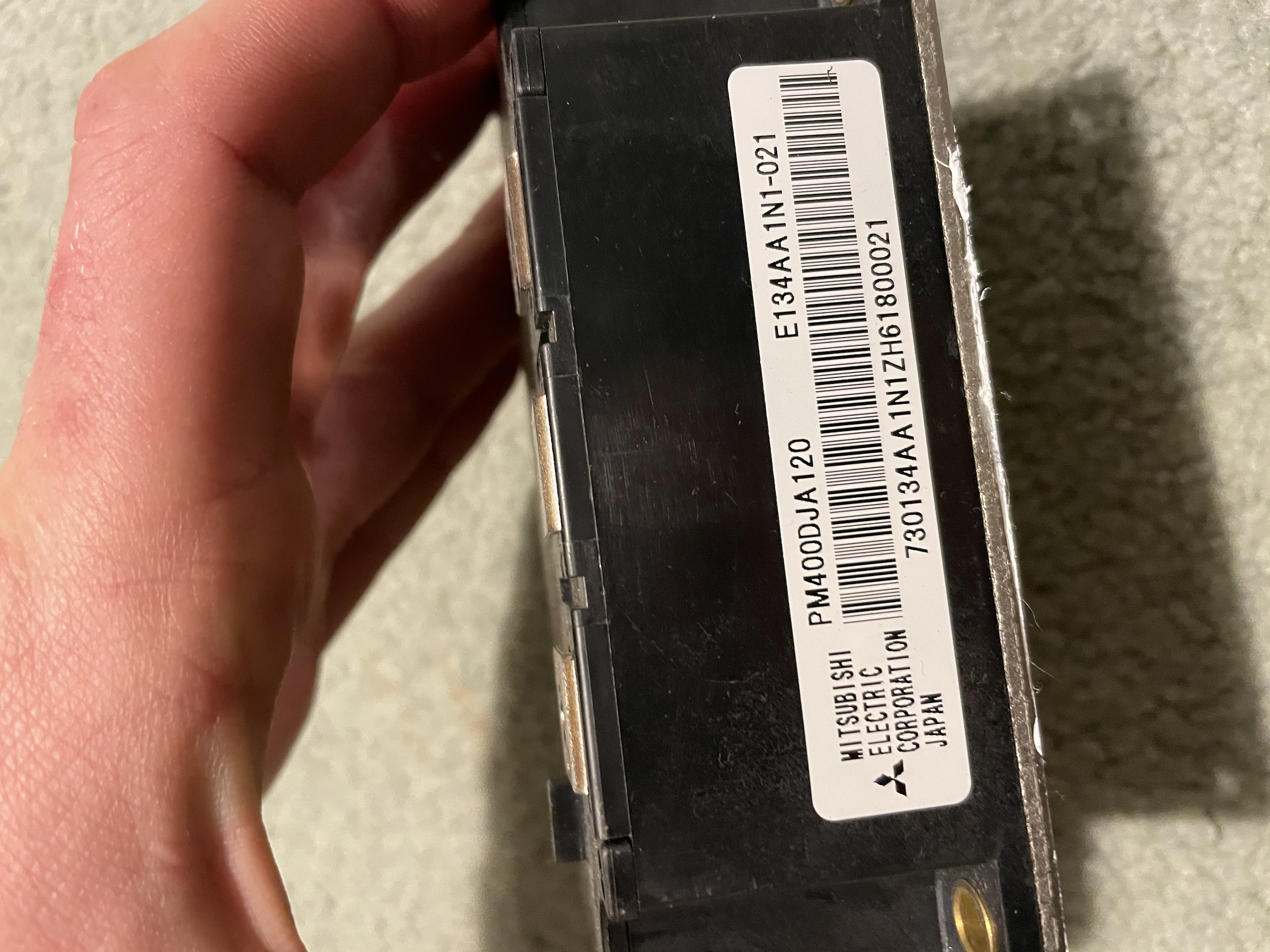

I removed the boost converter inductor and IGBT module from the inverter when I first installed it in the car. I’ve just dug them out to have a look at them. There’s no markings whatsoever on the inductor but this is the IGBT module:
Going from the Mitsubishi naming convention this appears to be rated at 1200V and 400A. I guess the inductor could be unable to handle this much but would seem a bit strange to me to spec the IGBT so highly if it couldn’t...

The gen2 boost converter isn't known for failing in normal use like the gen3 is, so maybe it's "sufficiently" overkill. How much? Well, I'll keep reading this thread. :mrgreen:

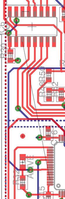

So this would be the wire to add in order to optionally run booster PWM off TIM4_CH4. It uses the remaining channel of the ULN2003 making it backward compatible. Outputs need to paralleled, making it a wired-OR.
Let me know if you want to try this and I can make the necessary software mods.
Nevermind, wasn't much to change so test firmware attached. When detecting a Prius2 hardware it will clock TIM4 down to 8.8 kHz.

Just to make sure, I need to add a wire between pin 6 of the UL2003 (currently connected to TIM1_CH2) and TIM4_CH4 (the third pin along on the STM32) as shown by the thin black line on your drawing? Do I need to disconnect anything in addition to this?
Thanks again.
Been thanked: 1918 times
Re: Suzuki Cappuccino
Pin 6, what? No! Pin 3. Pin 1 is the one adjacent to R30. And bridge pin 13 and 14.

I then started to have a look at doing the boost converter modifications. I got stuck trying to add the wire onto the pin on the STM32 chip. I don’t seem to have the skill/tools to be able to do this. As far as I can tell there’s nothing else on the PCB connected to this pin that I can use to connect to it? Or is there a trick to doing to soldering a wire to the pin?
Ok, so we know that. Maybe time to strip out parameters on next release. dmargin that is.
I don't know a special trick besides a steady hand and fine soldering iron. I use very fine enamelled copper wire. And no the pin just ends up on a pad...

johu wrote: Sat Jan 23, 2021 1:48 pm I don't know a special trick besides a steady hand and fine soldering iron. I use very fine enamelled copper wire. And no the pin just ends up on a pad...
Ok. I’m going to see if I can borrow a finer soldering iron and fine wire from work.
celeron55
Posts: 805
Has thanked: 39 times
Been thanked: 136 times
Post by celeron55 »
Wire wrapping wire should work fine for this case, it's about 0.25mm in diameter. One trick is applying soldering flux separately. It helps in long and annoying soldering attempts as you can add more flux without adding more solder to keep the surfaces from oxidizing.
