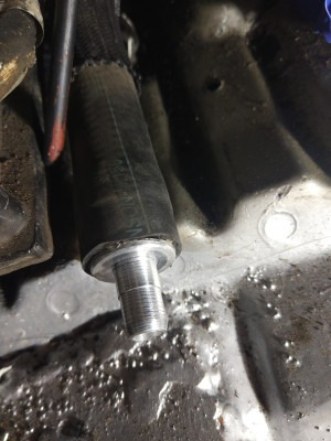

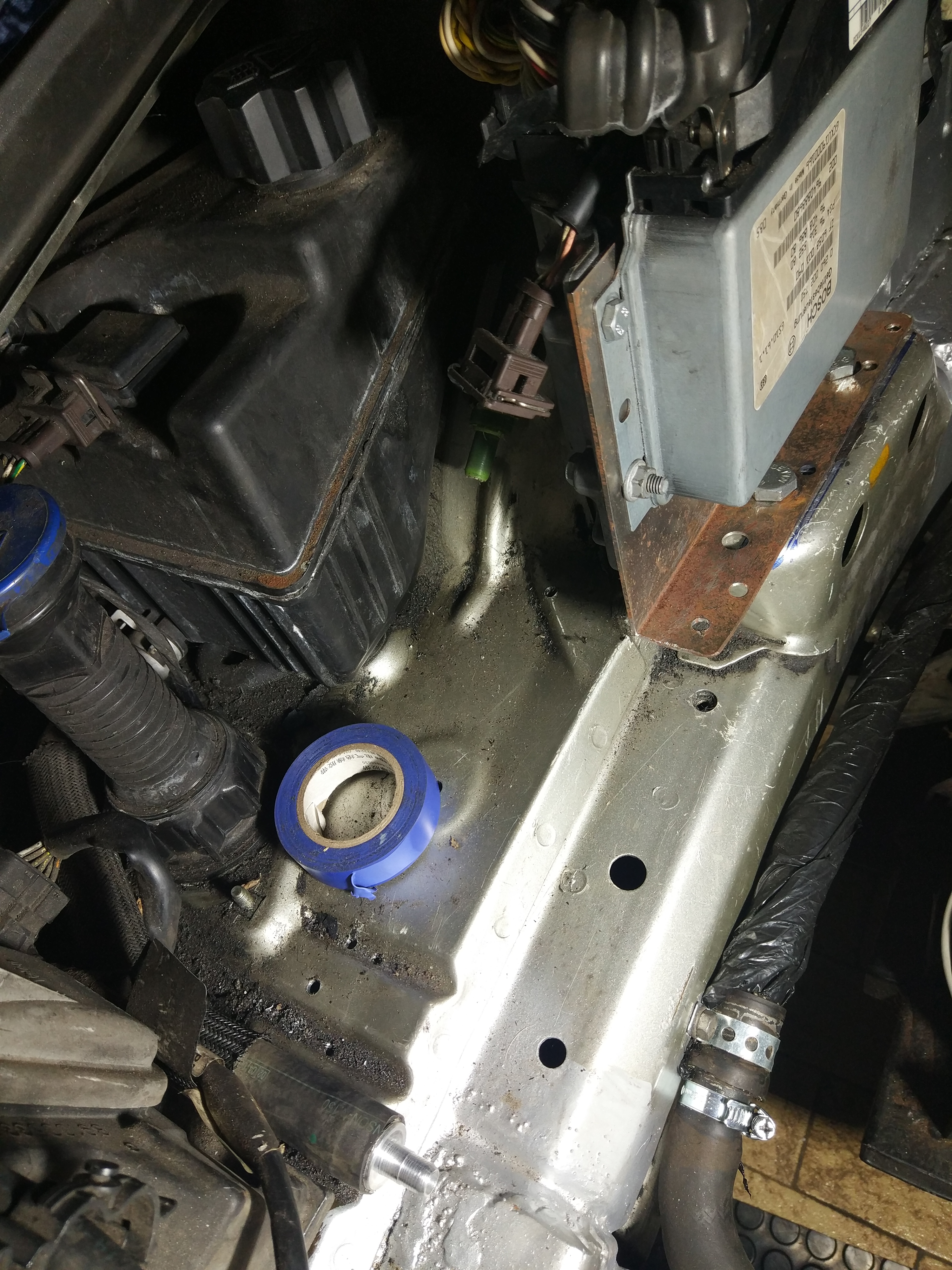

My lathe broke the belt drive spindle. Of course its chineese and everything important is made from plastic :shock:.
I will have to replace the spindle and the belt. Luckily i was almost finished with coolant hose adapters. I will have to take the last one to a friend with a beer.

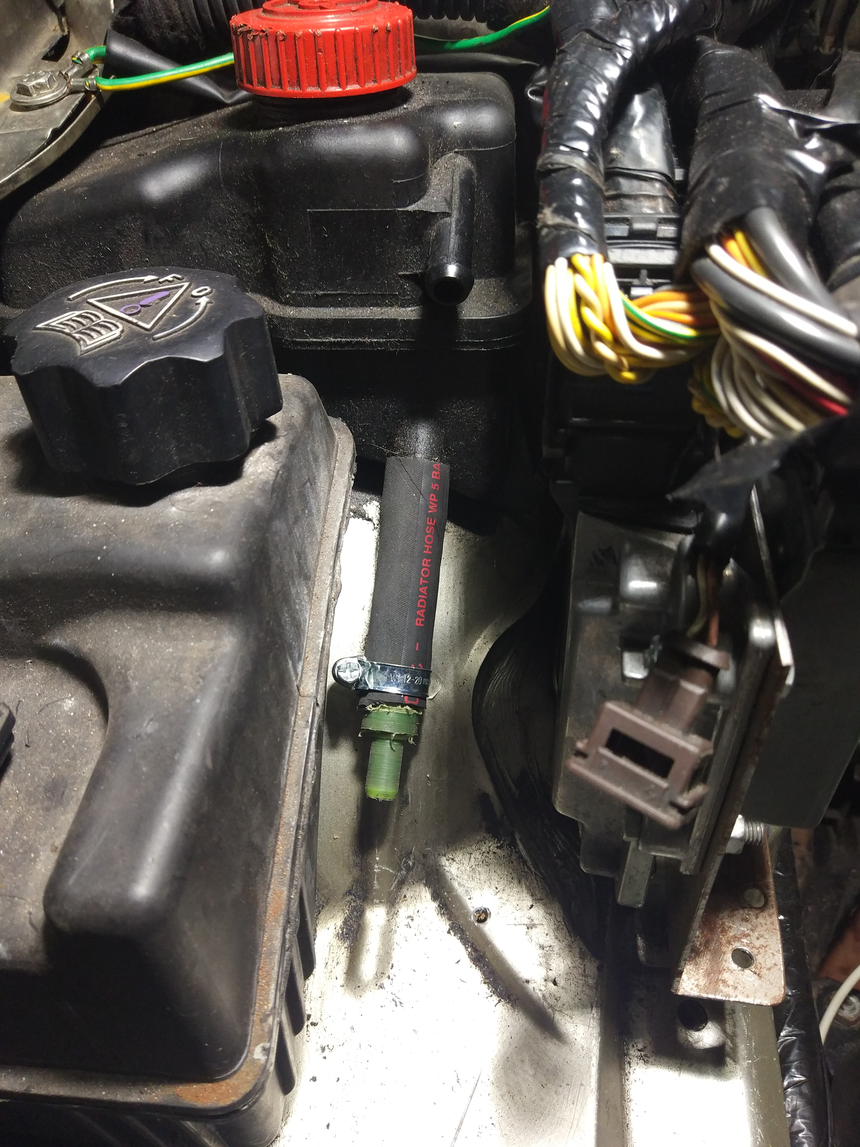

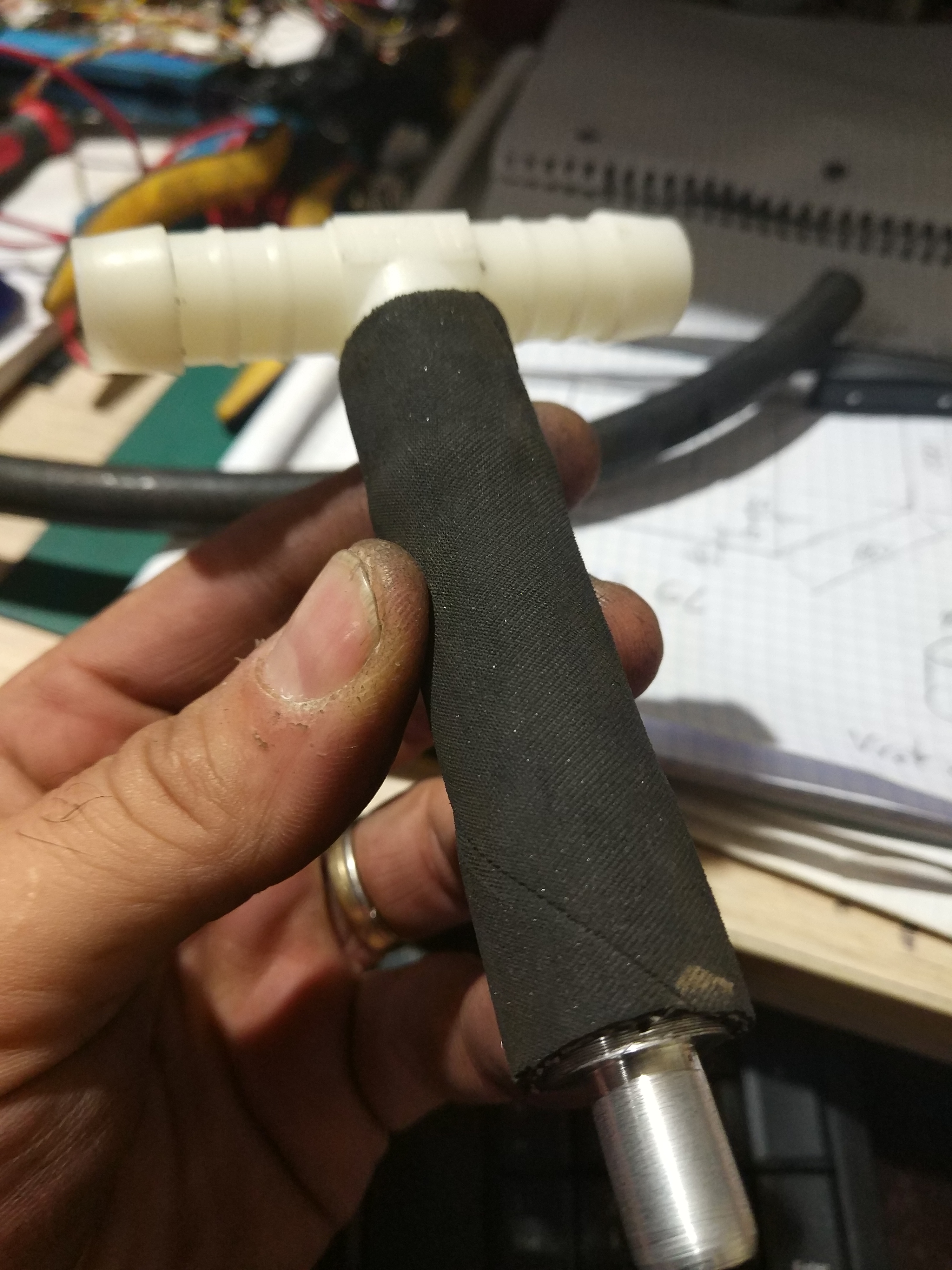

I decided to not waste 18mm coolant hoses and reduce supply hoses to 10mm. They only bring coolant to the loop and are not needed in normal action. I couldnt get reducers anywhere so i made my own.
Two are for supply of the coolant loop and two to supply webasto heater loop. The last one will be attached to T piece in Webasto loop.

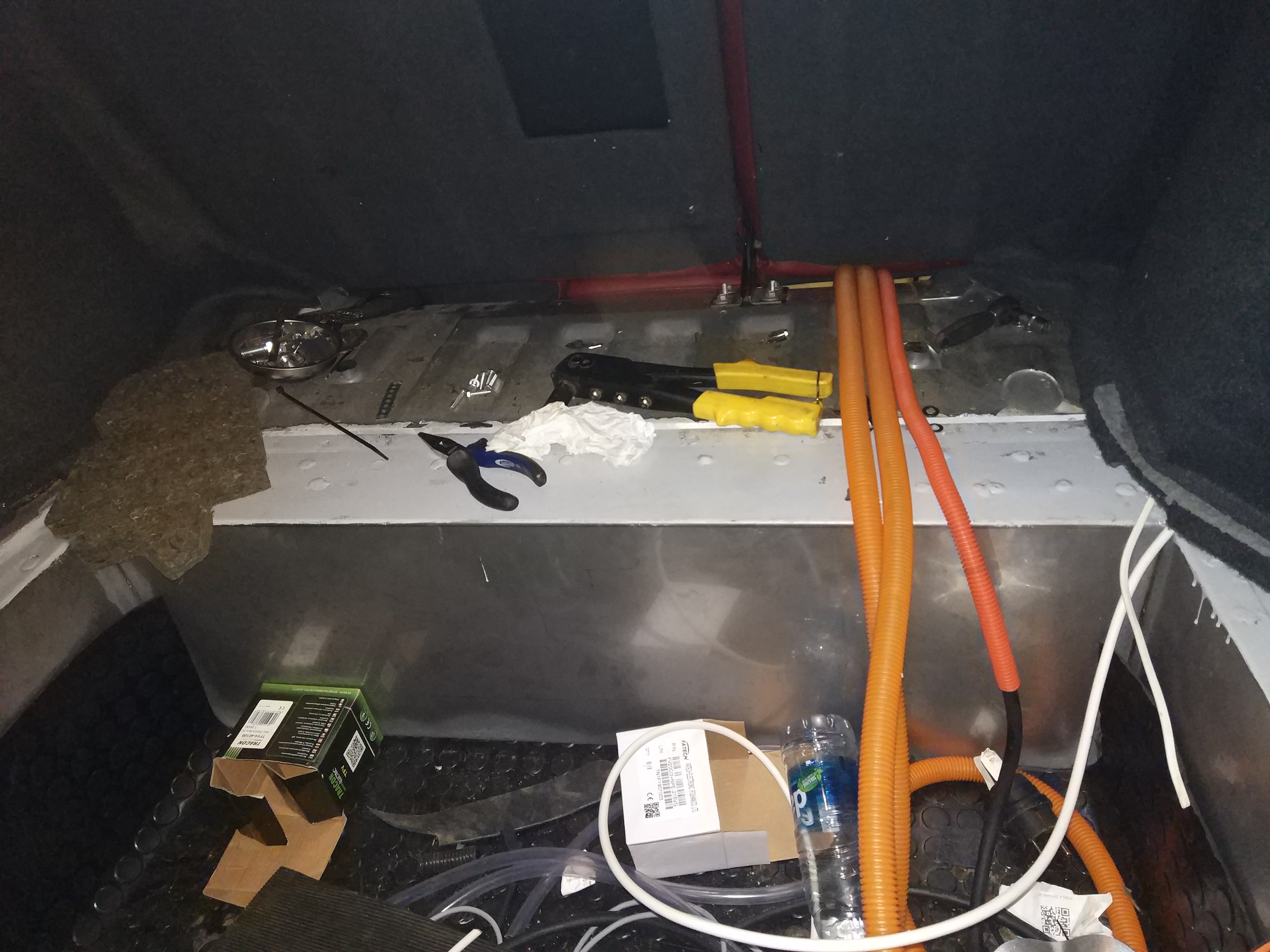

I will use the steering pump oil tank, the one with red cover, as webasto fluid supply.

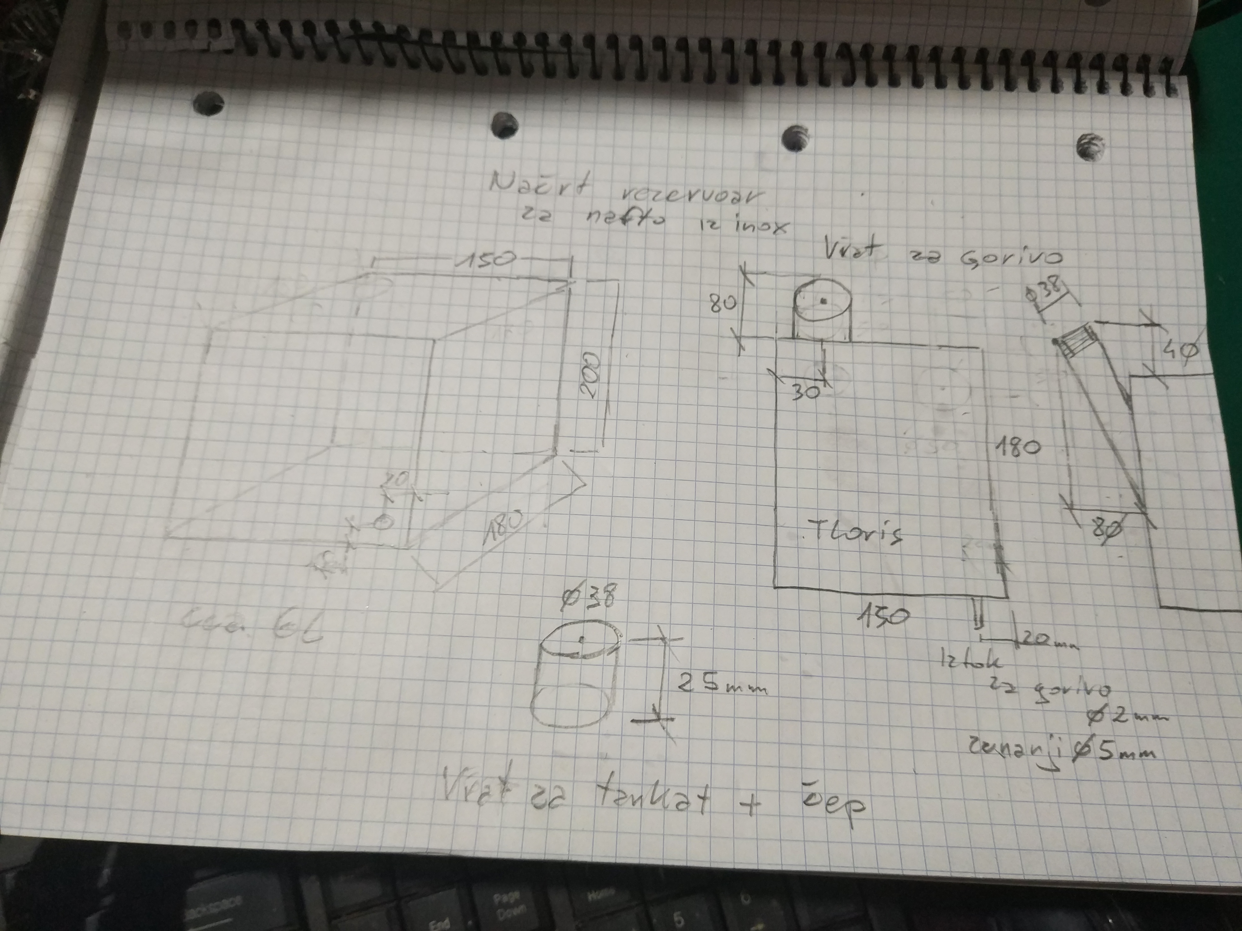

In the empty space below i will put a fuel tank with filling neck and cover. It will be made from welded stainless steel sheets. Filler neck i will make from 38mm steel pipe, so it will fit the fuel handle on the petrol station.
Webasto heater will get its 6L fuel supply there. It should last a week i think.
Of course webasto is installed and working. All i need is some plastic fuel line and rubber hose to fit it to the fuel tank.

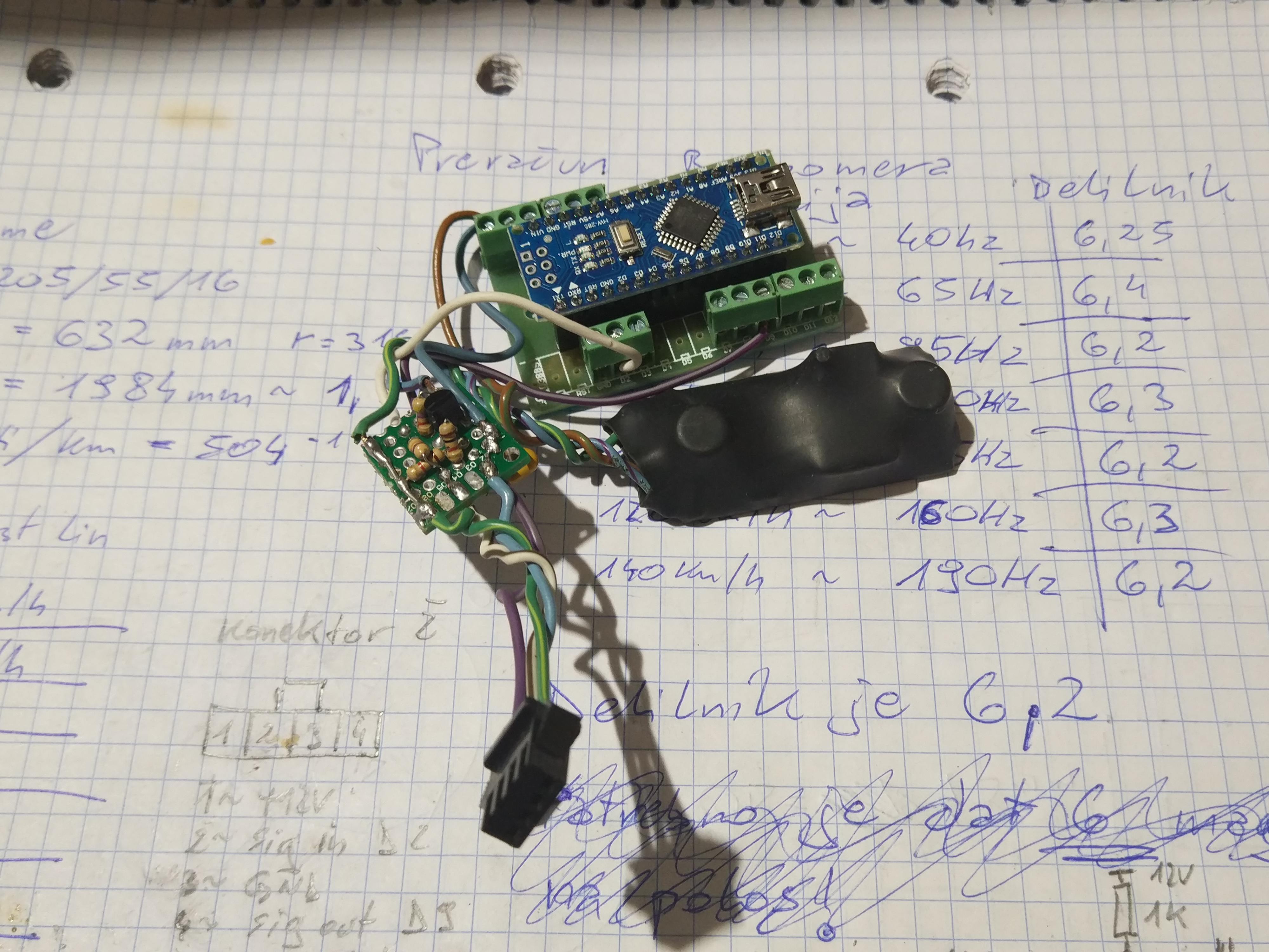

I am now battling with speedo signal. I cant get it to work propperly with Arduino divider. Sure it wakes up, but it also jumps all around... I will have to find some solution for speed sensor...

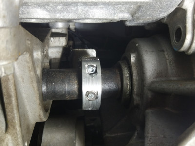

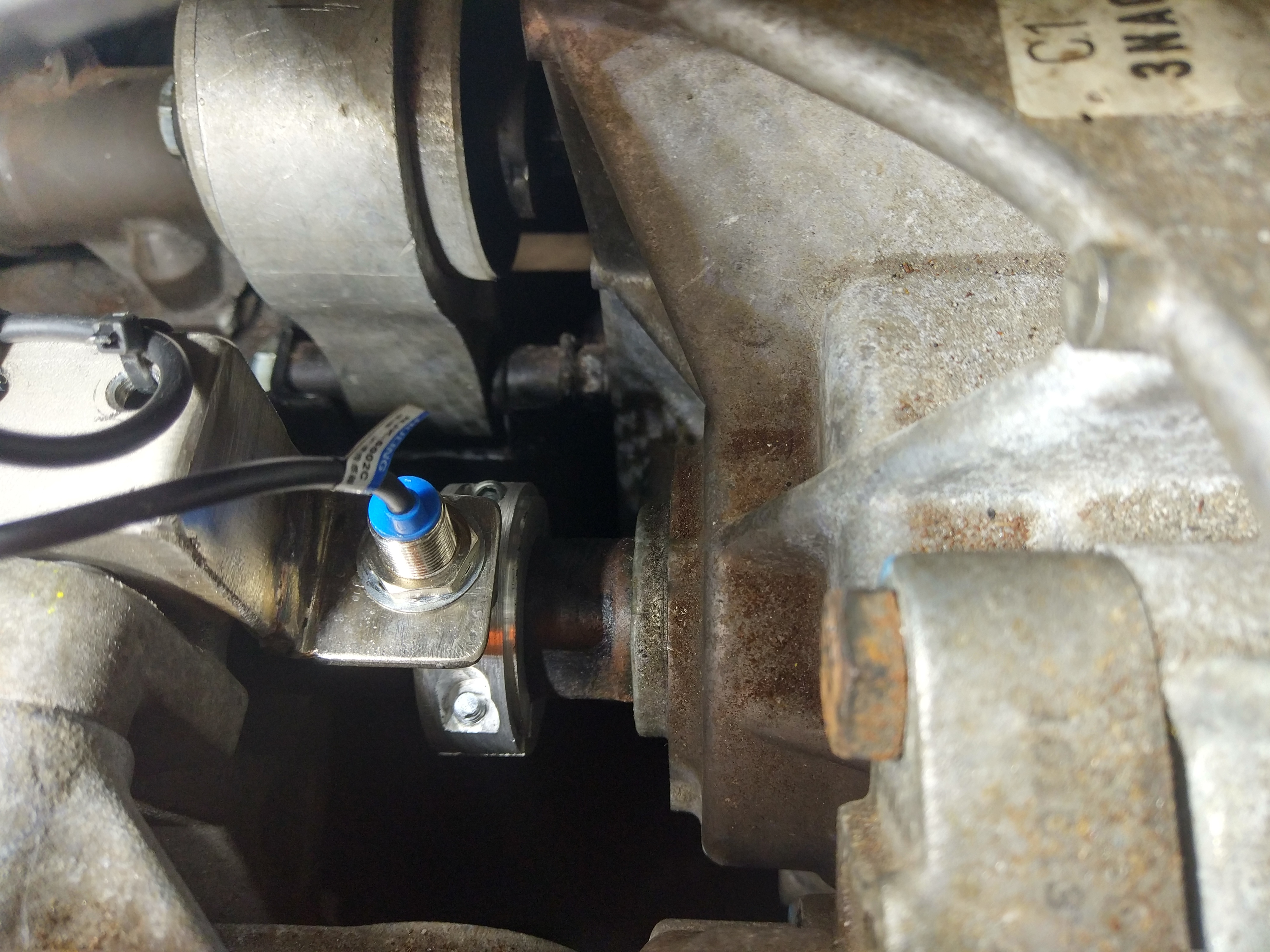

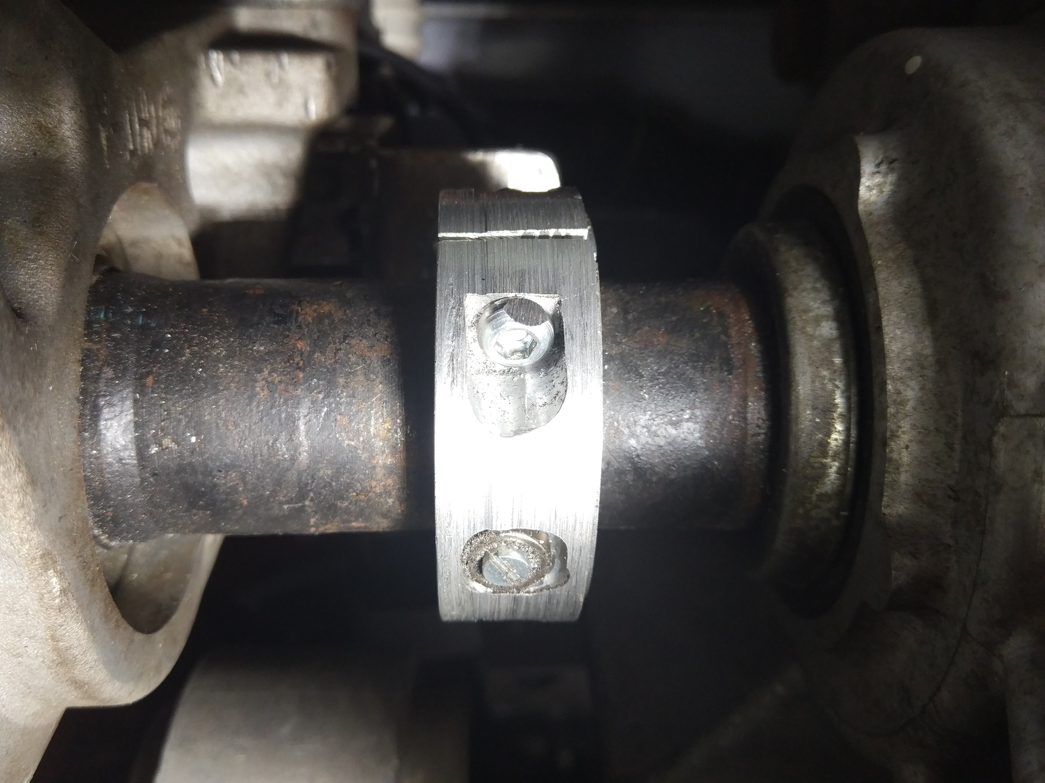

Well i managed to move along with speedo. The real problem was not my car that was the first suspect, but rather the shady chinese Arduino socket.
I managed to find that there was a cut trace on my socket and it prevented it from sending correct pulses to transistor.

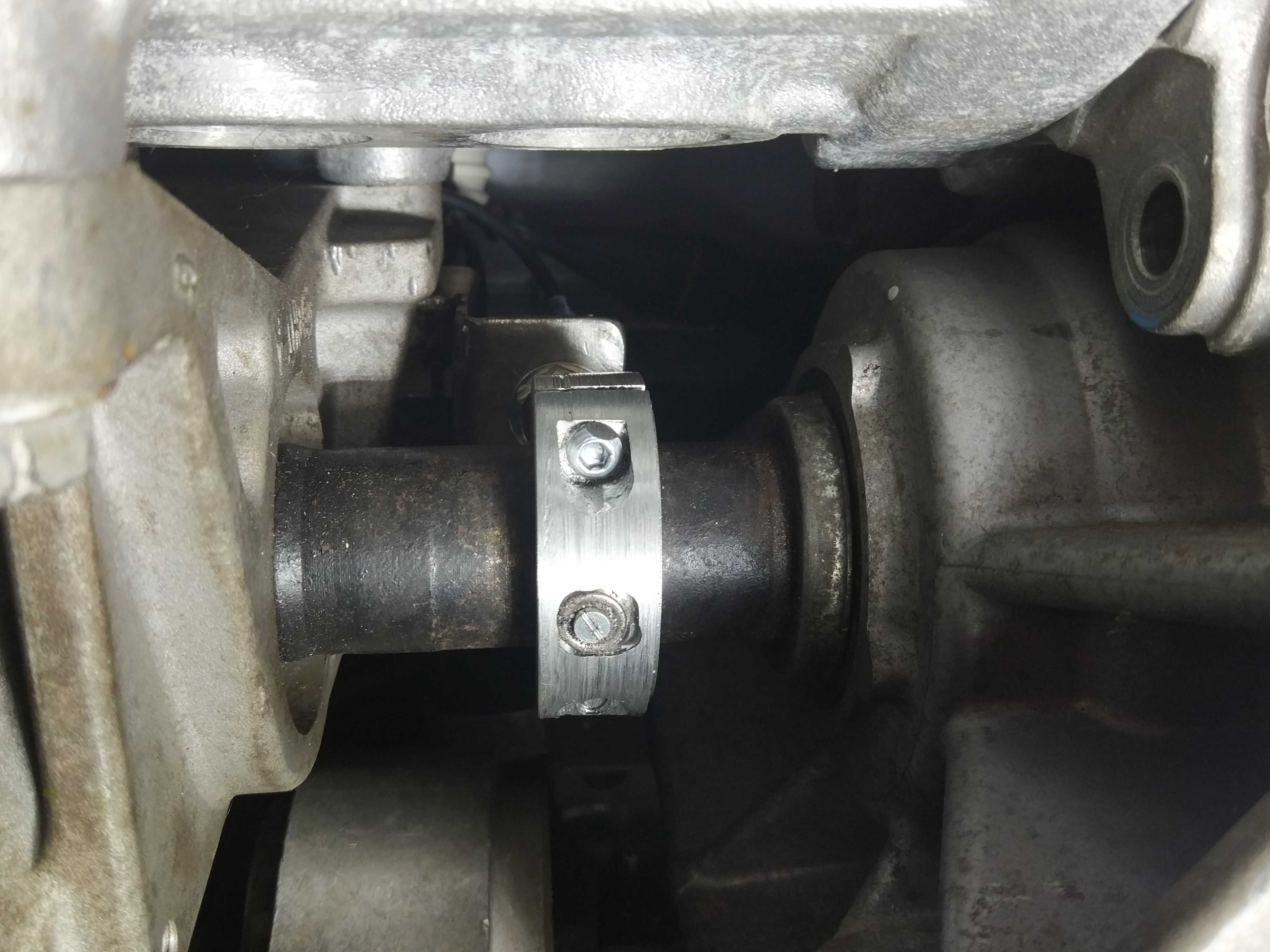

This is my first iteration of speedo sim. I use an alu collar around the drive shaft. It is tightened to the shaft by two bolts and it has slots for two magnets end to end. I needed to fit it where the shaft runs in paralell with motor so there would be no lateral movement. This gives me 2 pulses per turn of the shaft. I take those pulses and divide them in Arduino to get correct pulsetrain to run the speedo. I had to built in a DCDC to lower the supply voltage and make a step down on the signals from 13V to managable 5V. Then i added one darlington transistor to amplify the signal from 5V to 12V that the speedo is familliar with.
Software was written by Ron AKA doobedoobedo here: viewtopic.php?f=9&t=52
I can now get normal pulse distribution for the speedo to show fairly accurate Km/h on. I will still have to time this to a GPS meter.
My plan is to make a propper interface board to use with Arduino NANO (or two if applicable ) to give a real time speedo signal with optional RPM signal. That is still under development now, but the part under the car will remain the same. I expect enable signal from the key to start RPM signal at steady 600RPM. This should make the ABS system work as before and maybe shut the engine light.

Dang! Speedo is still jumping all over. I guess I will need to put phase cables in socks and use lycy cable for signals...

EVdisplay is also acting up under high load. I really need to shield my phase cables.

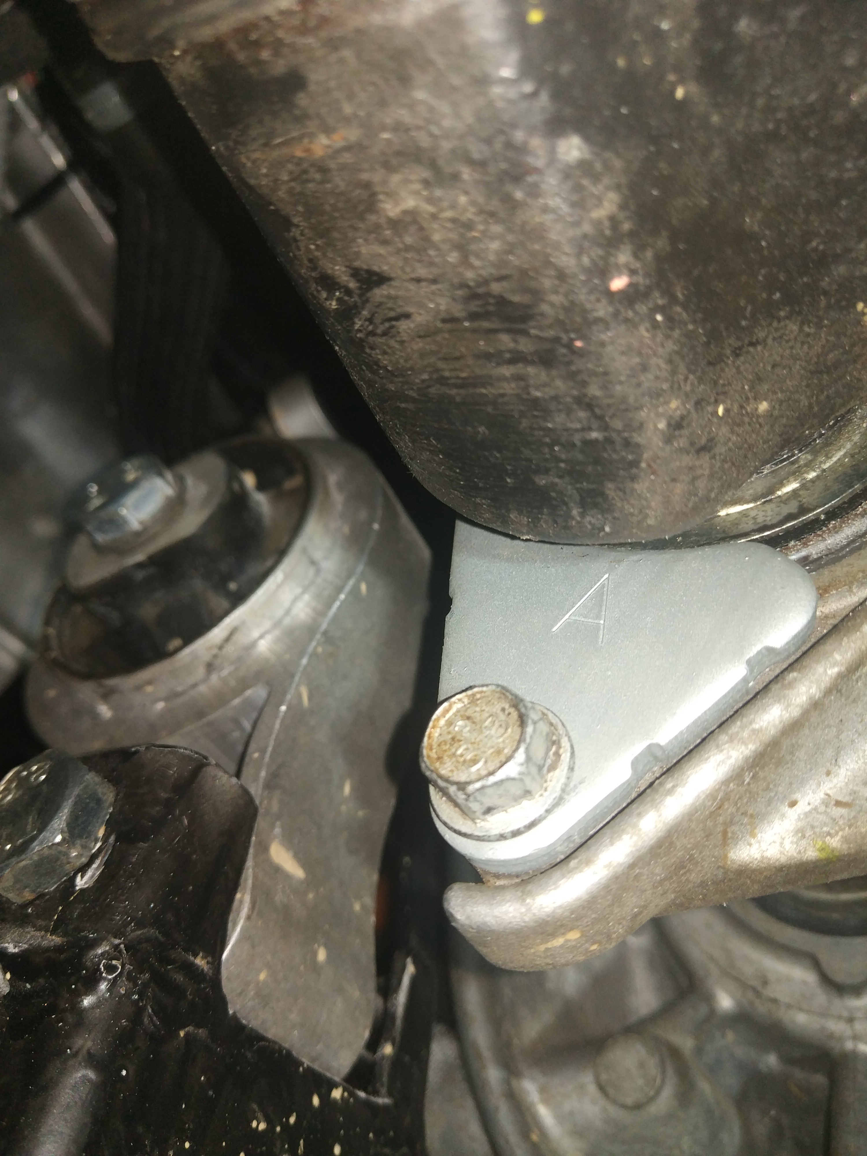

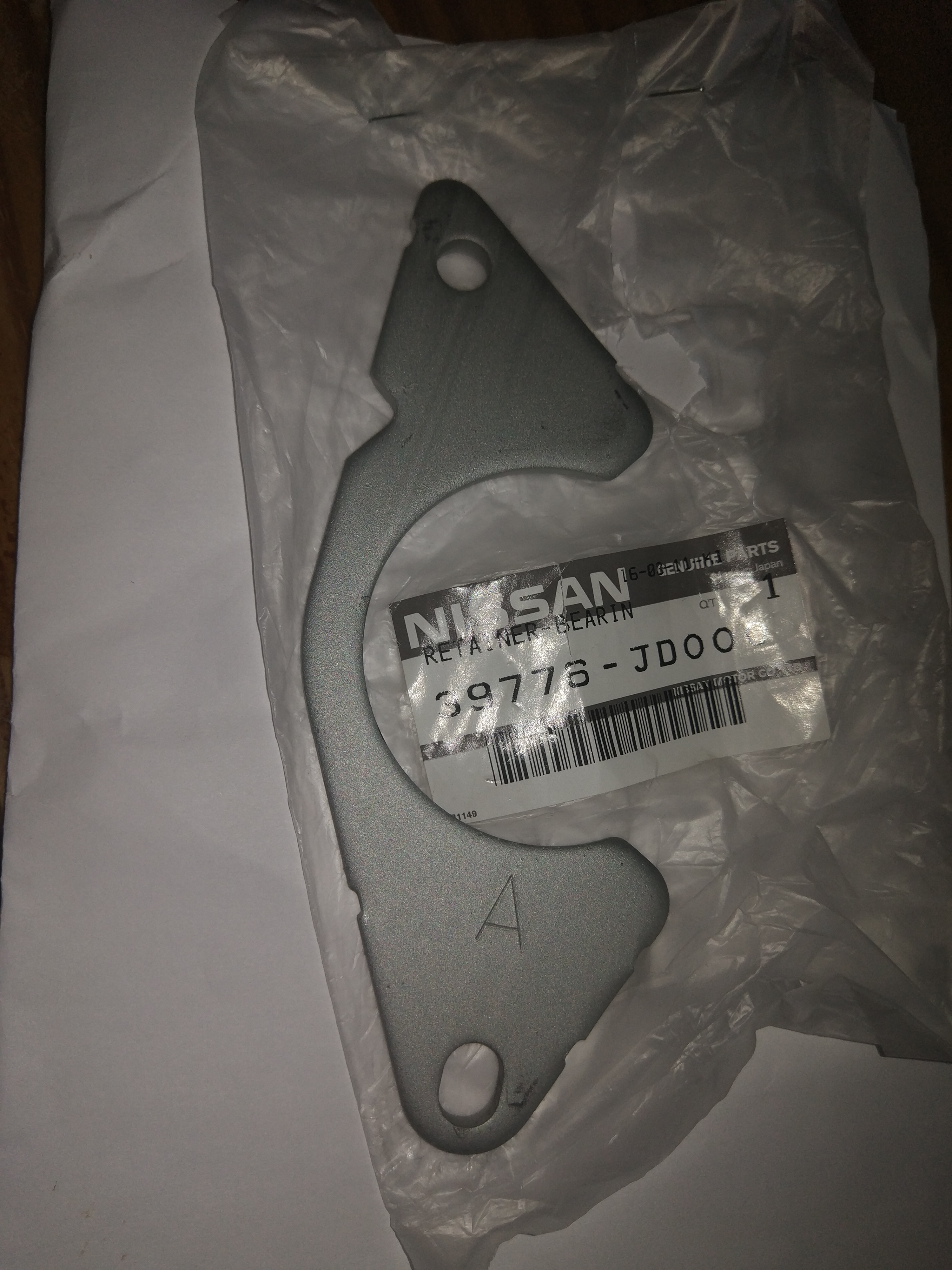

Today was a good day! I got my Pug rolling with all support elements operational. I still see DCDC is overheating and i need to turn it around and provide some better 12V cooling fans. Maybe i will also need to provide fresh air to inside of trunk.
We got liftoff and i tried various throttle pedal settings with and without regen.
Also i still need to get a driveshaft bearing retainer to fix driveshaft in place. There is some wobbling in driveshaft when accelerating and regen and i am cautious because the bearing can be moved by hand.
I found online Nissan declares the retainer part 39776JD000 a consumable and to be replaced everytime driveshafts are taken off.
https://www.ebay.com/itm/NISSAN-OEM-11- ... 2784598170

Ah you are using CAN bus to transmitt RPM and speedo. I havent had that luxury since my Pug is not CAN connected. At least i think not? I see no twisted wires anywhere!
I have put some Arduino PCBs to manufacture according to my protoboard. I posted it on my Github. I have made a 12V to 5V converter and used transistors to transmitt signal.
On RPM pins i put one pin to GND and the second one i output signal with a twist. Like Ron suggested i use inline ceramic 105 cap. This creates pulses that go below the GND plane and my RPM indicator reads them as reluctance wheel signals.
There will also be some signal inputs on the board. For example ENABLE signal for the RPM to start with engine start not at the turn of the key. Now i get some noises when RPM dial starts to work even before i apply engine on signal from alternator. Maybe it just confuses the BSM.
Also i will have two additional signal outputs with transistor to signal 12V (pullup or open collector) if i need to start a cooling fan relay or something.

I got the bearing retainer and installed it. Bearing is supported from all sides now.
I ordered speedo PCB boards from manufacture and they should arrive next week.

to think on the underside cover now. Do you think 1.5mm alu sheet will be sufficient? I would like to get lexan sheet, but it is a bit pricey.
to sort out the wiring in front and add some original sensors. There are some strange errors on the dash now that ECU gets "engine" RPM.
