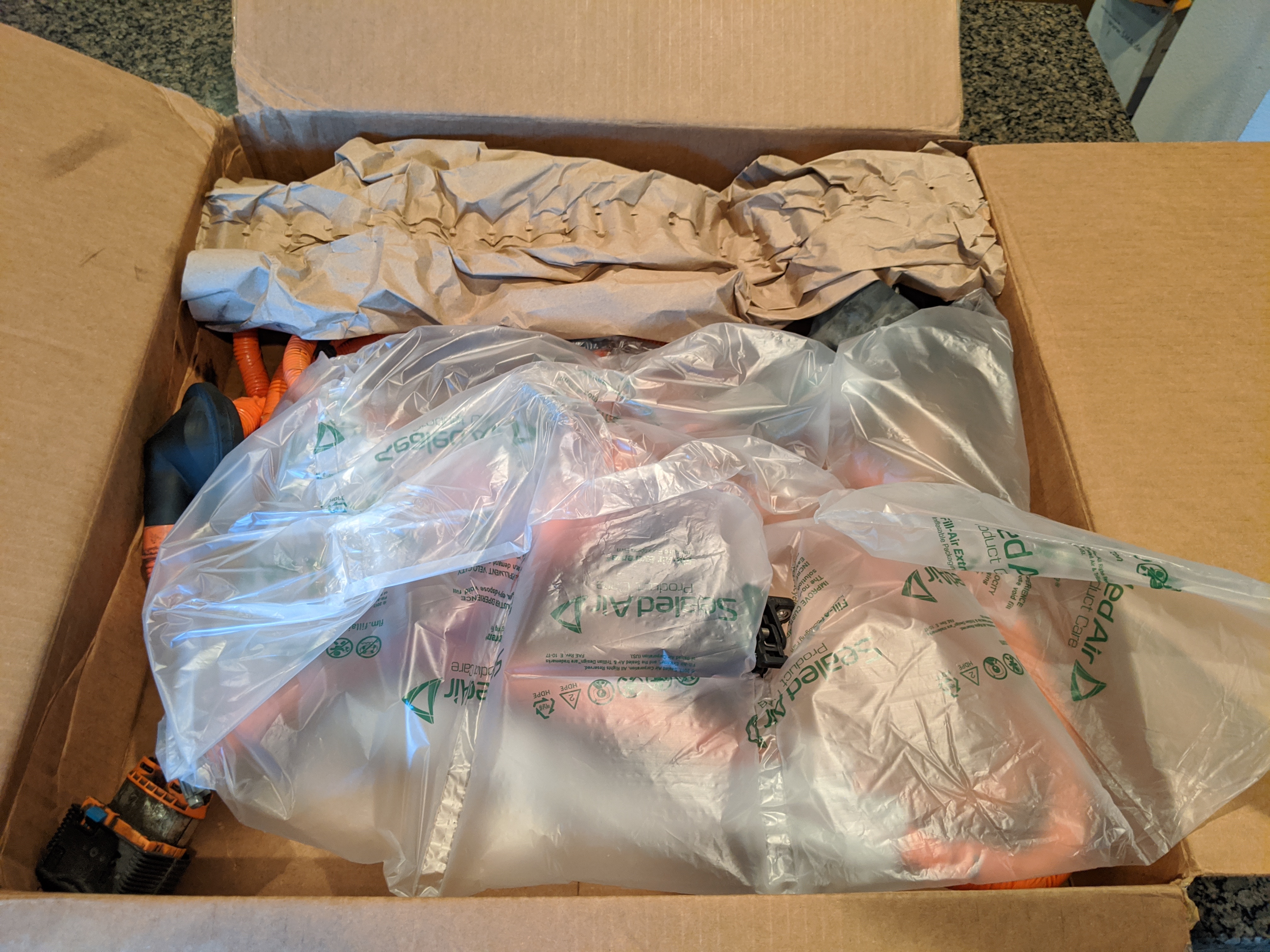

Other items of note:
I got the CHAdeMO port (along with a J1772 port) from a LEAF.
Seller must sell a bunch of electronics stuff given the amount of times the box was used already. :)
Packaged well.
Dirty as usual.
It got a little broken. You can also see the covering connector which pretty easily came off.
It cleaned up pretty well.
Part number.
I'm looking for the mating connector to this, so I can hook it up to the CHAdeMO cable...
