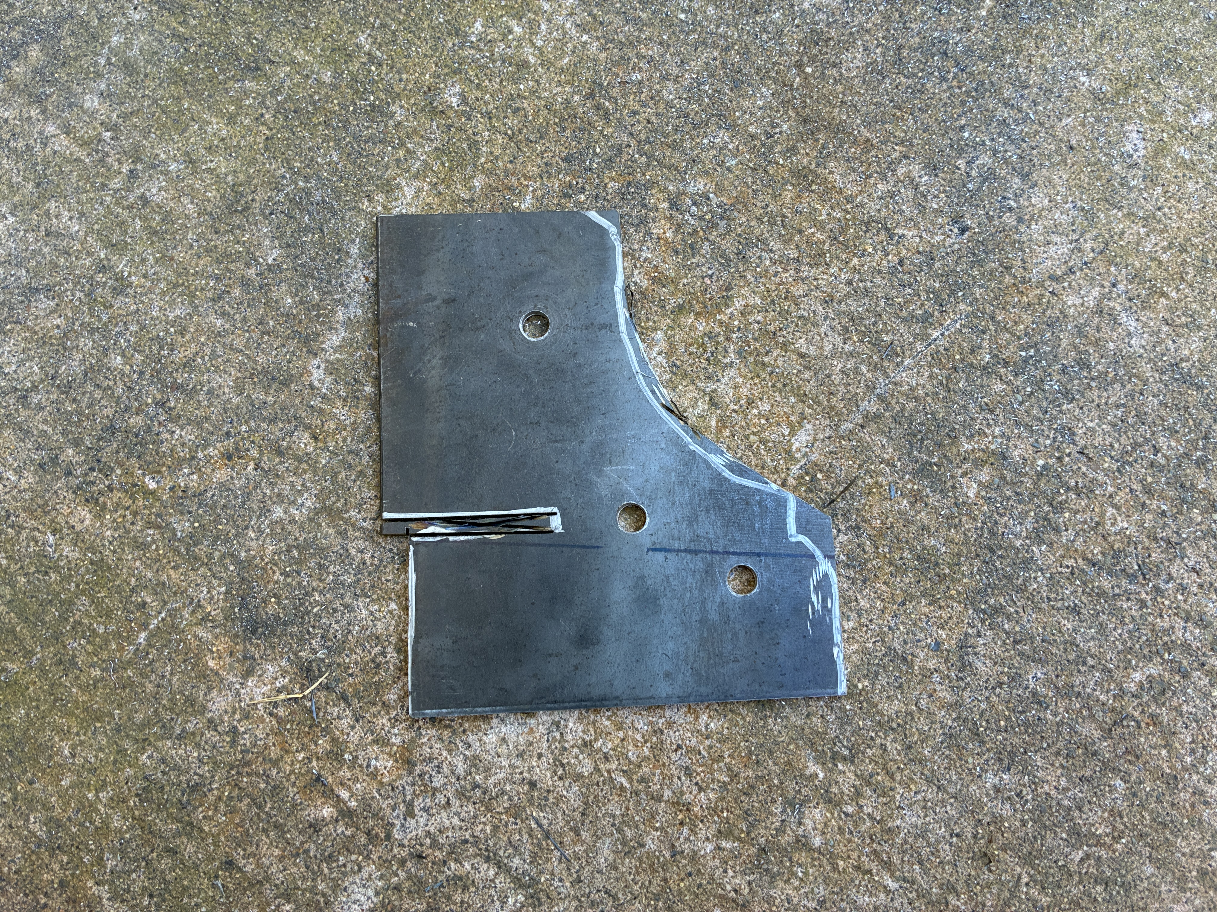

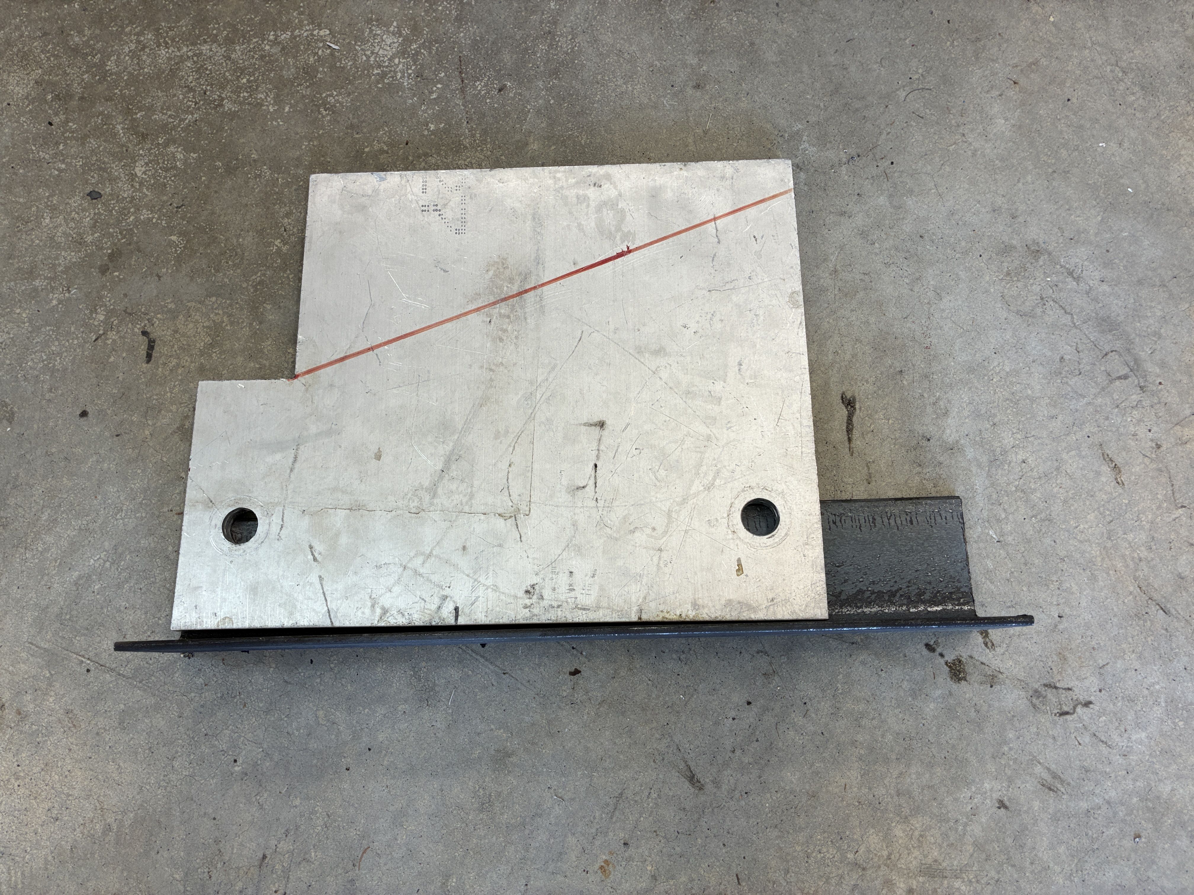

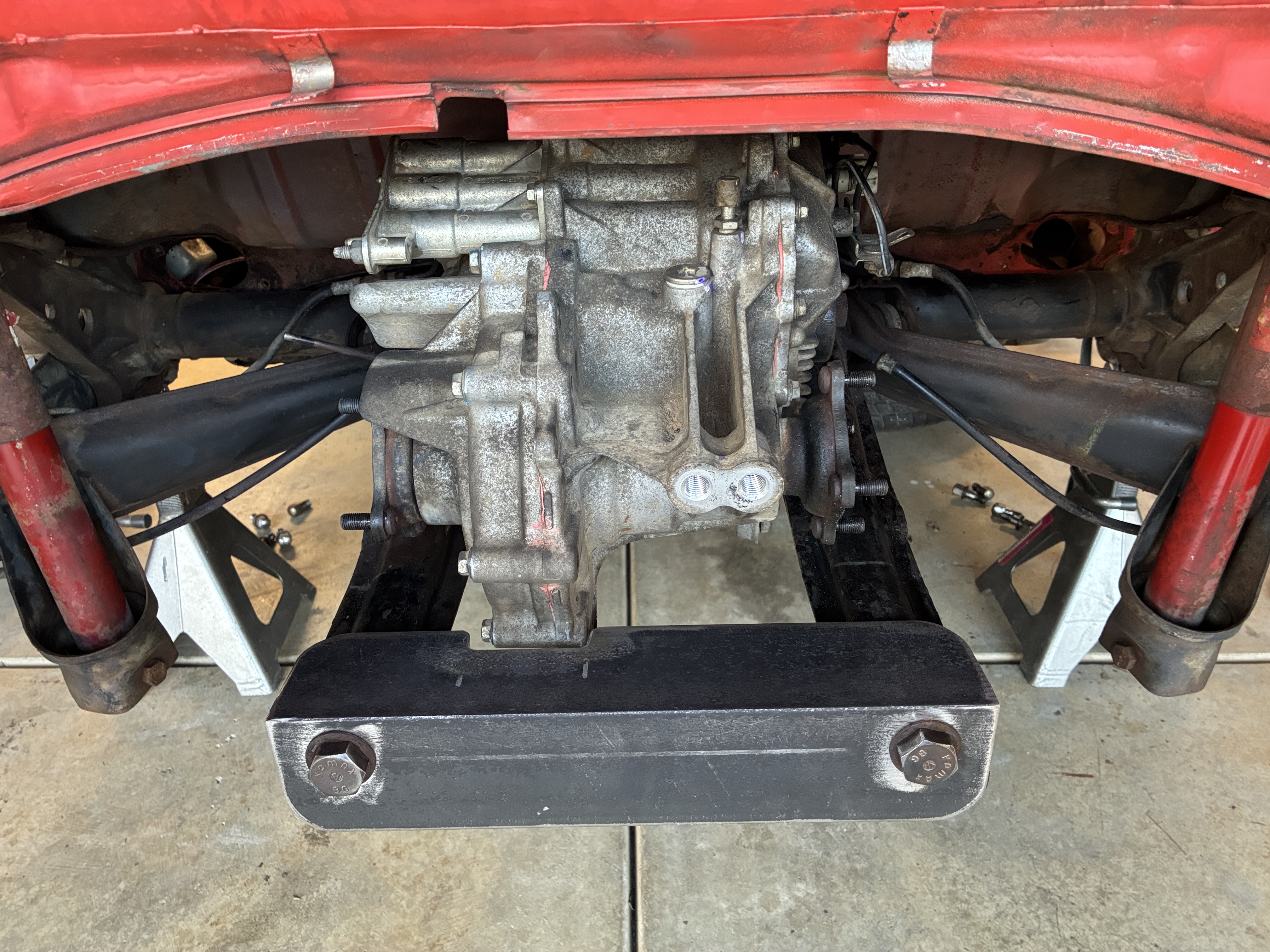

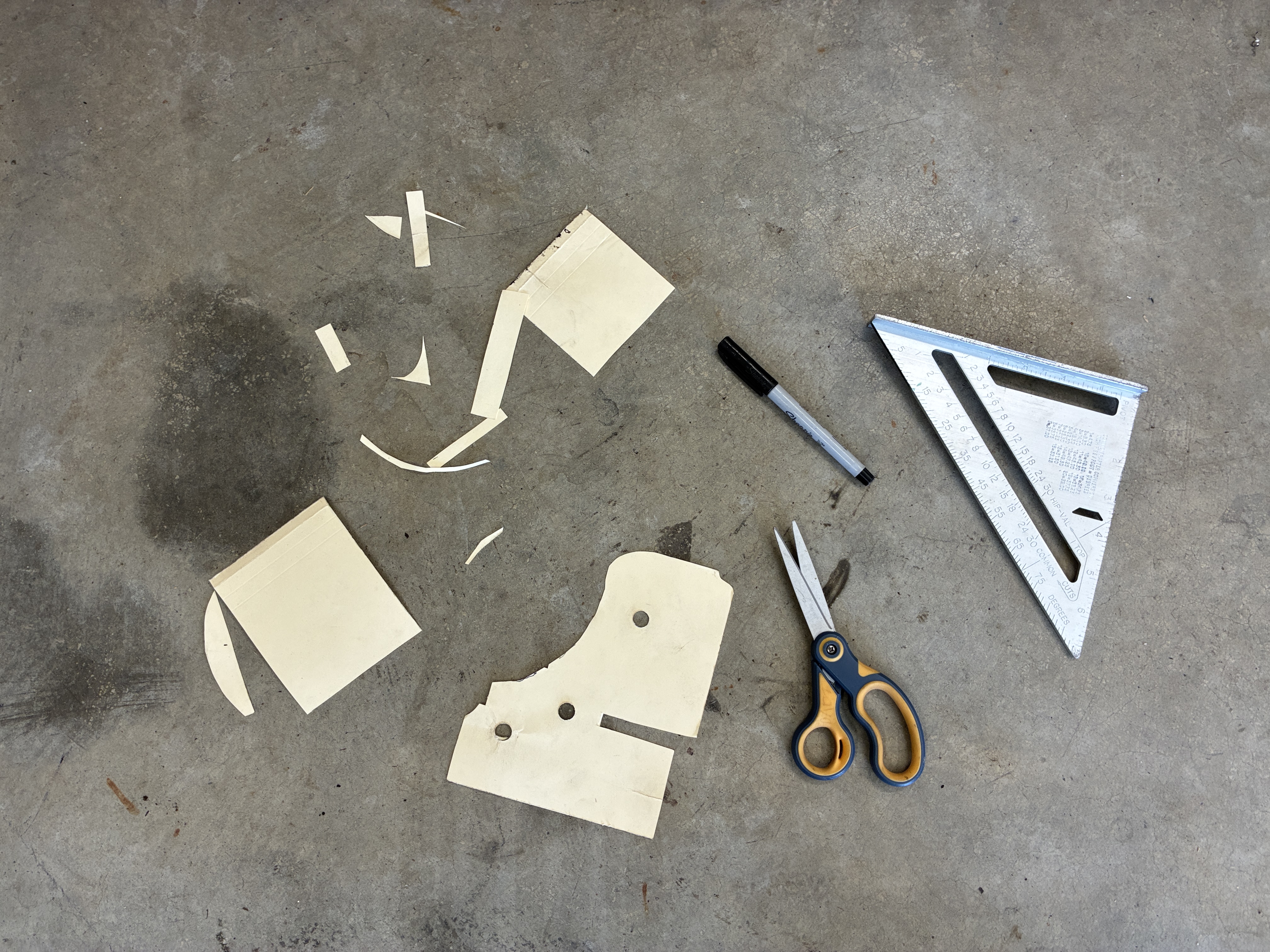

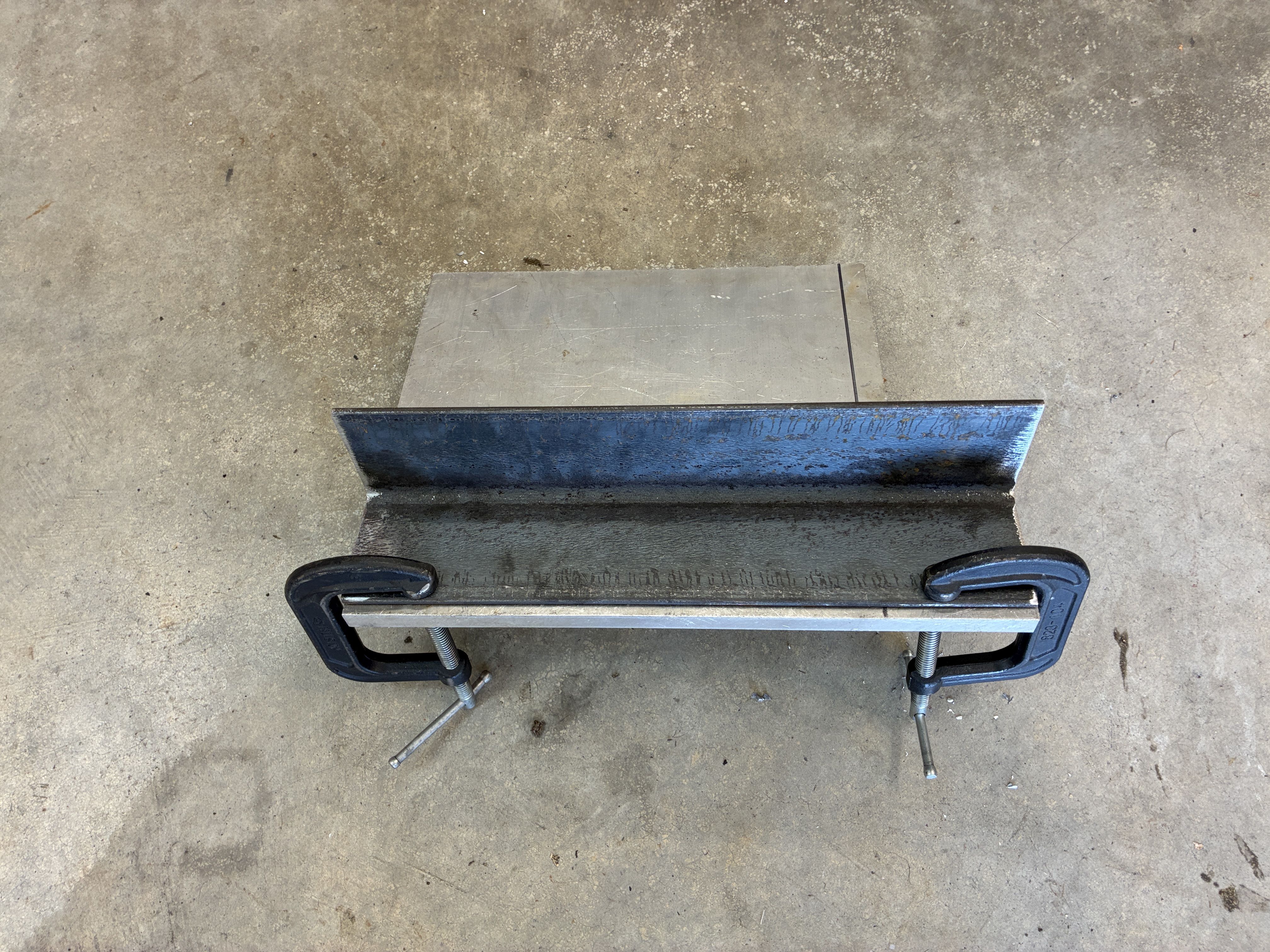

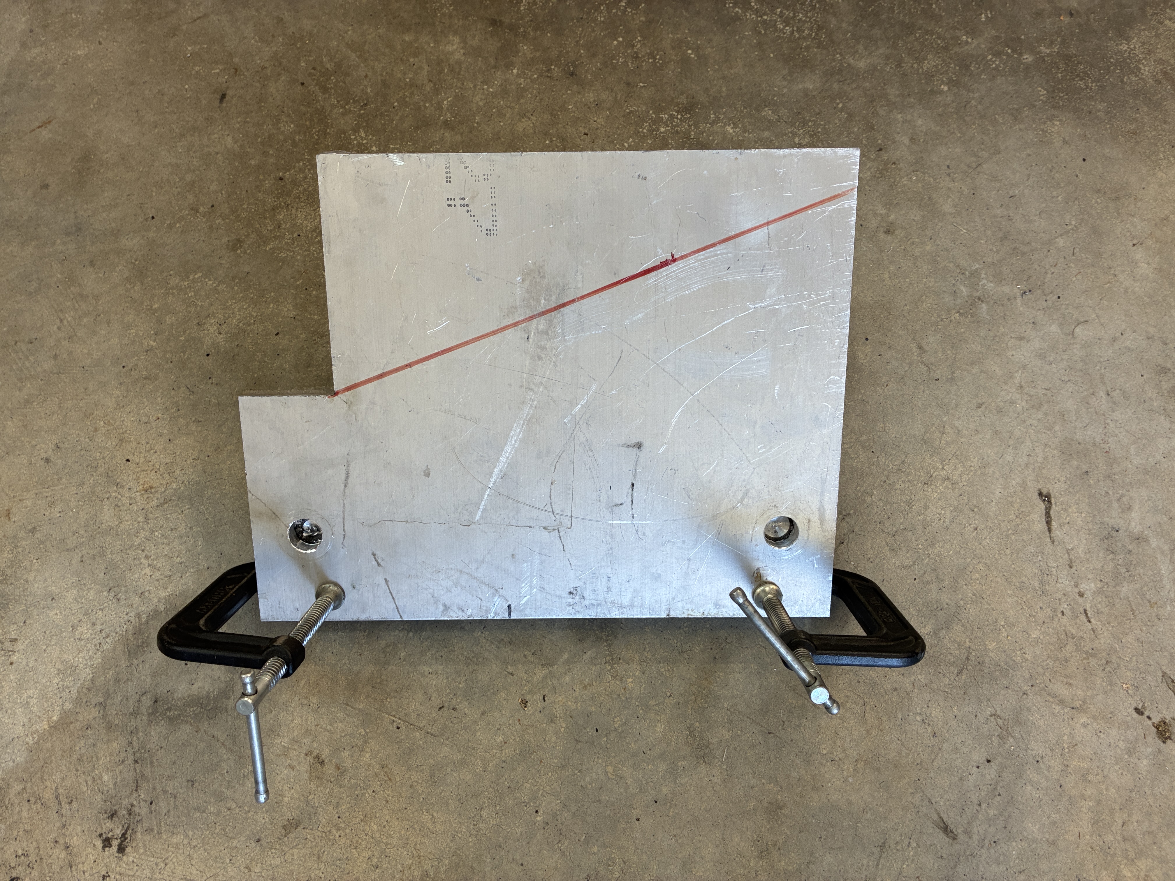

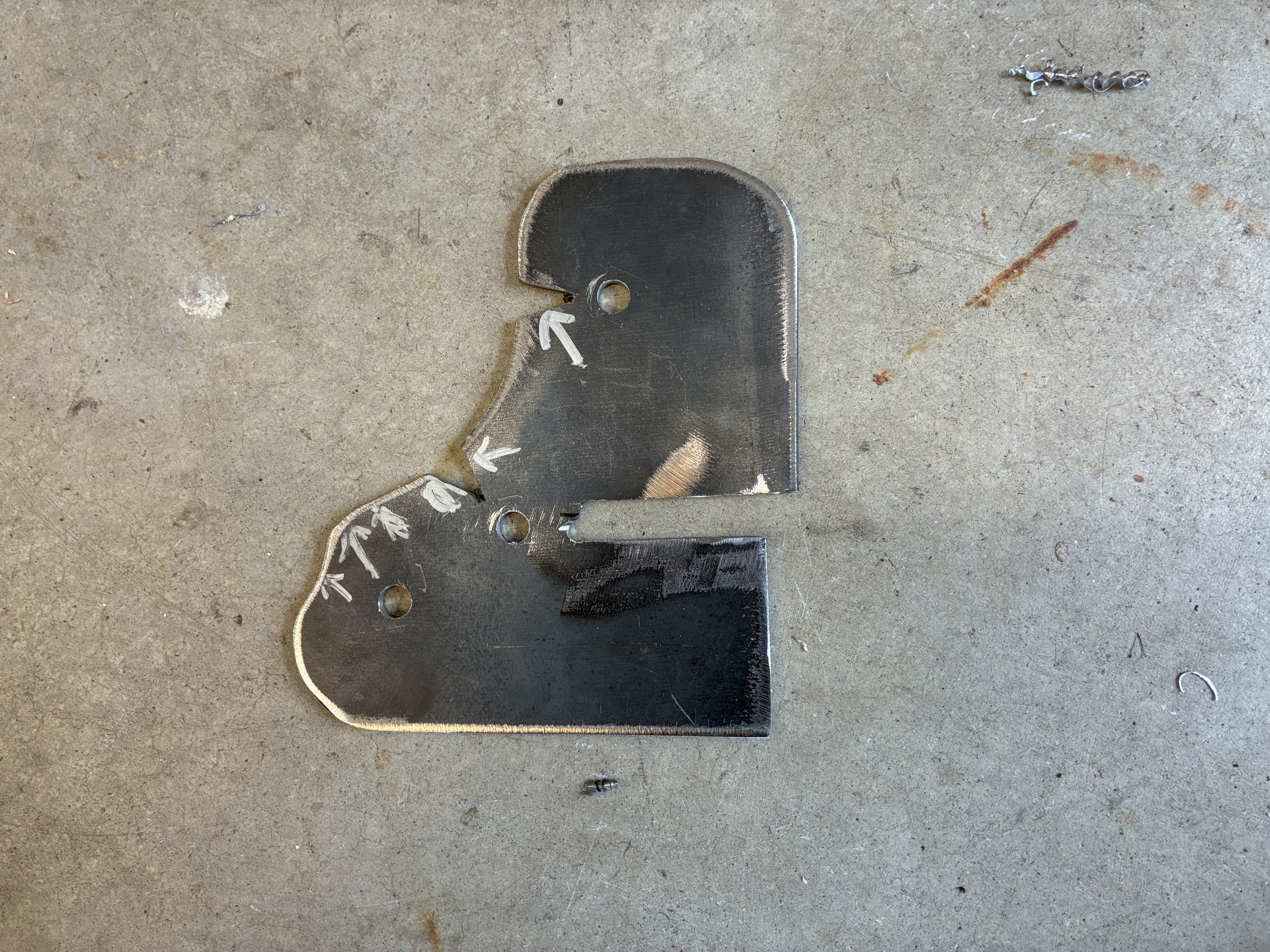

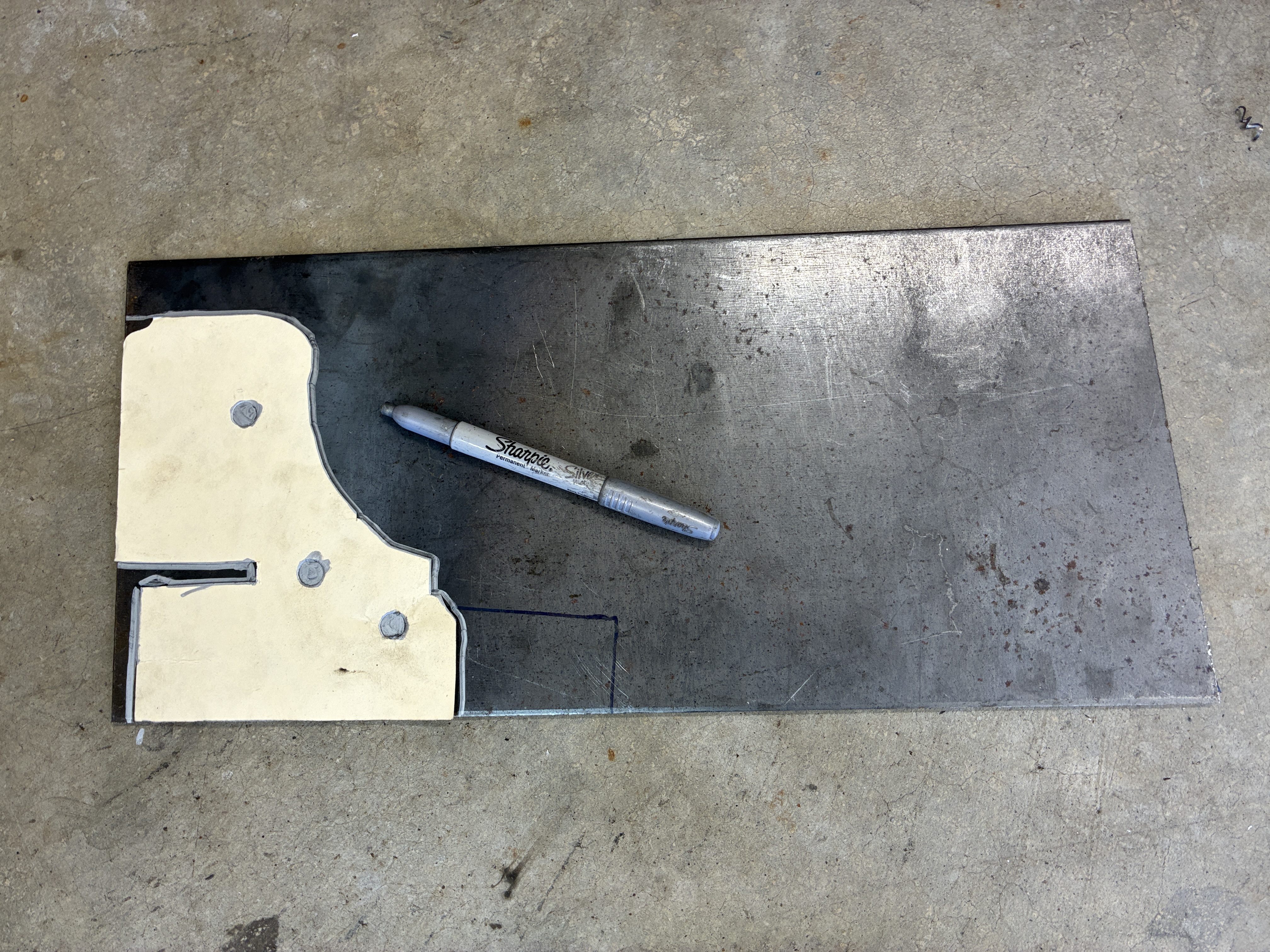

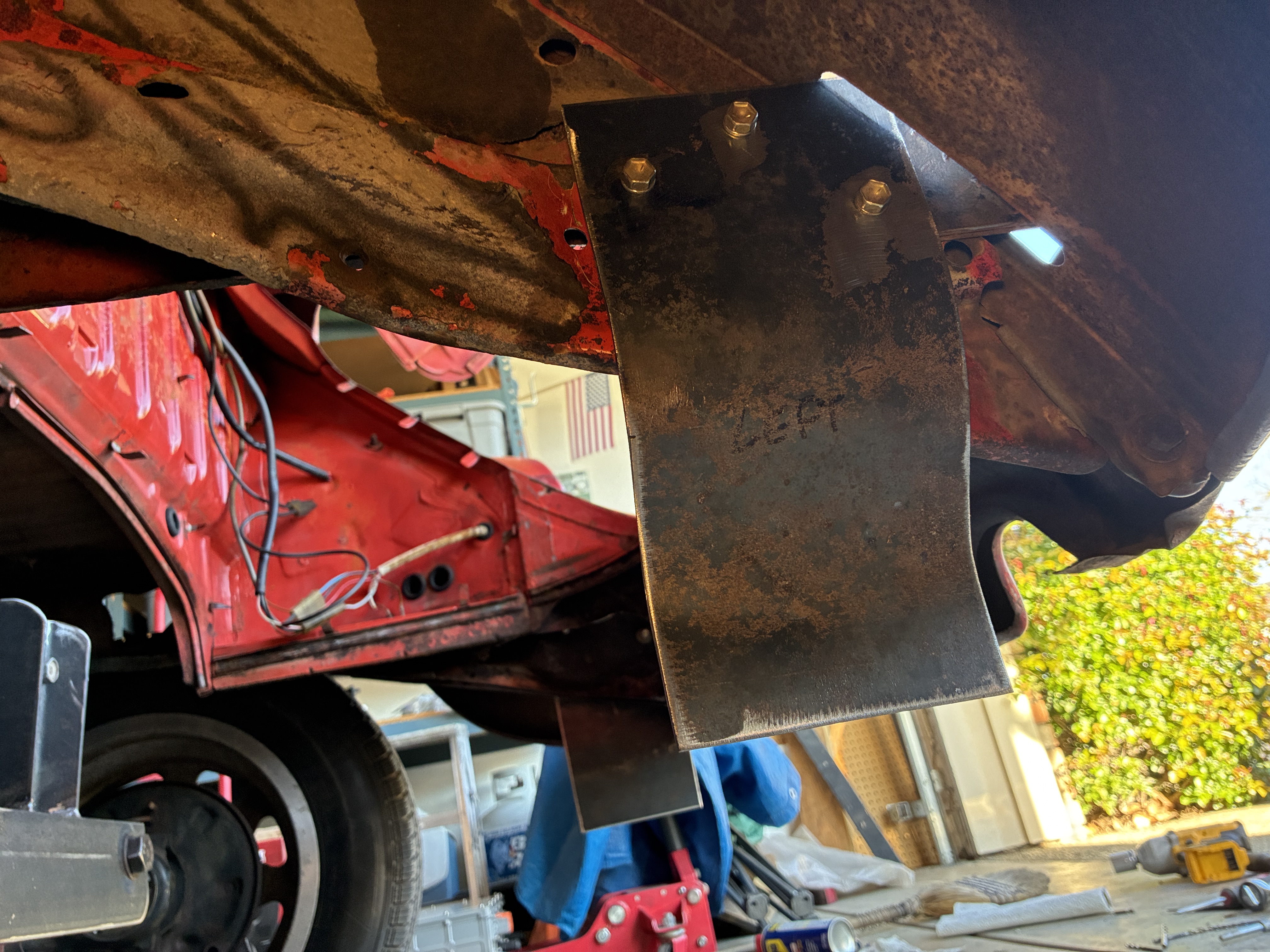

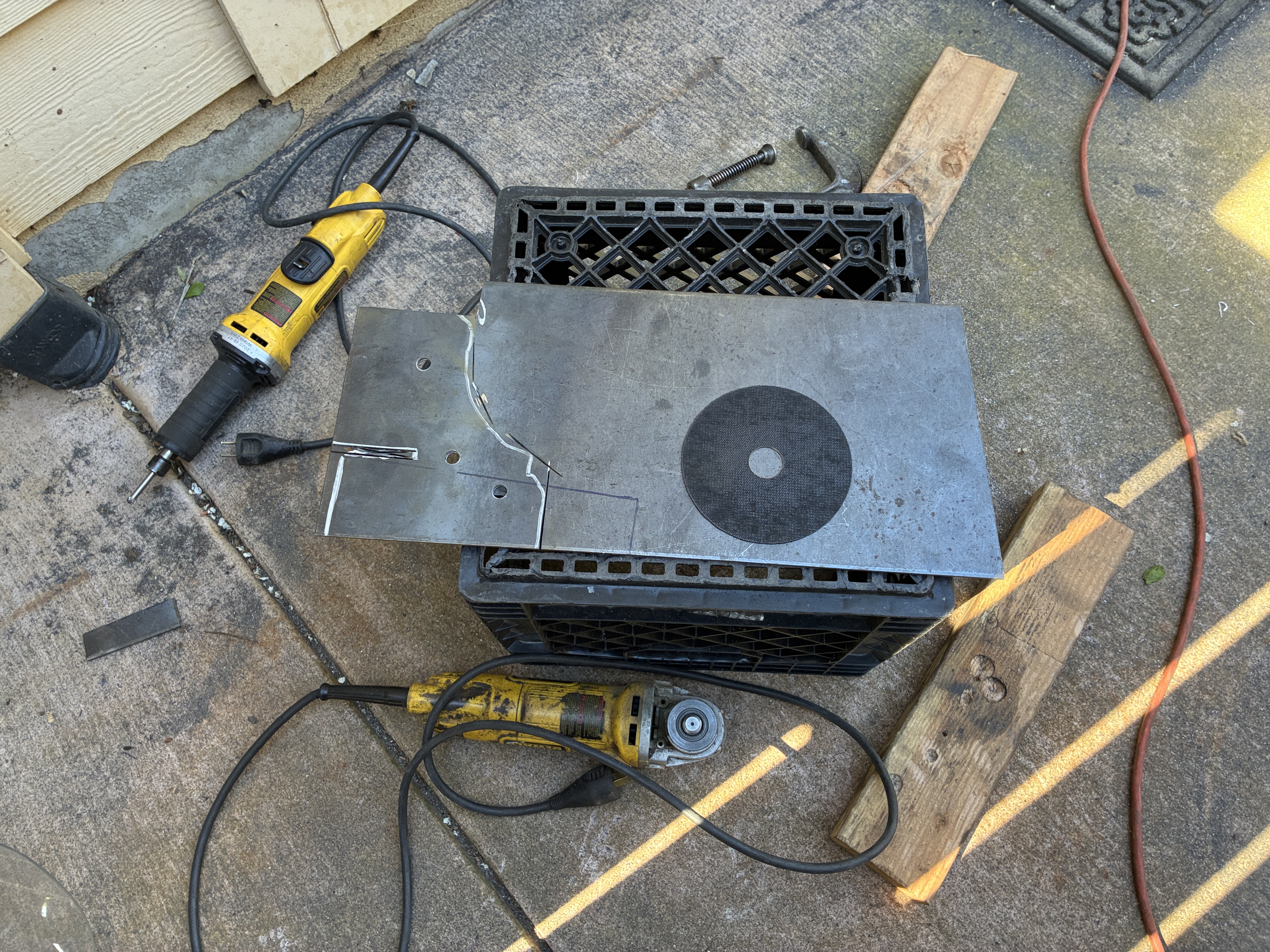

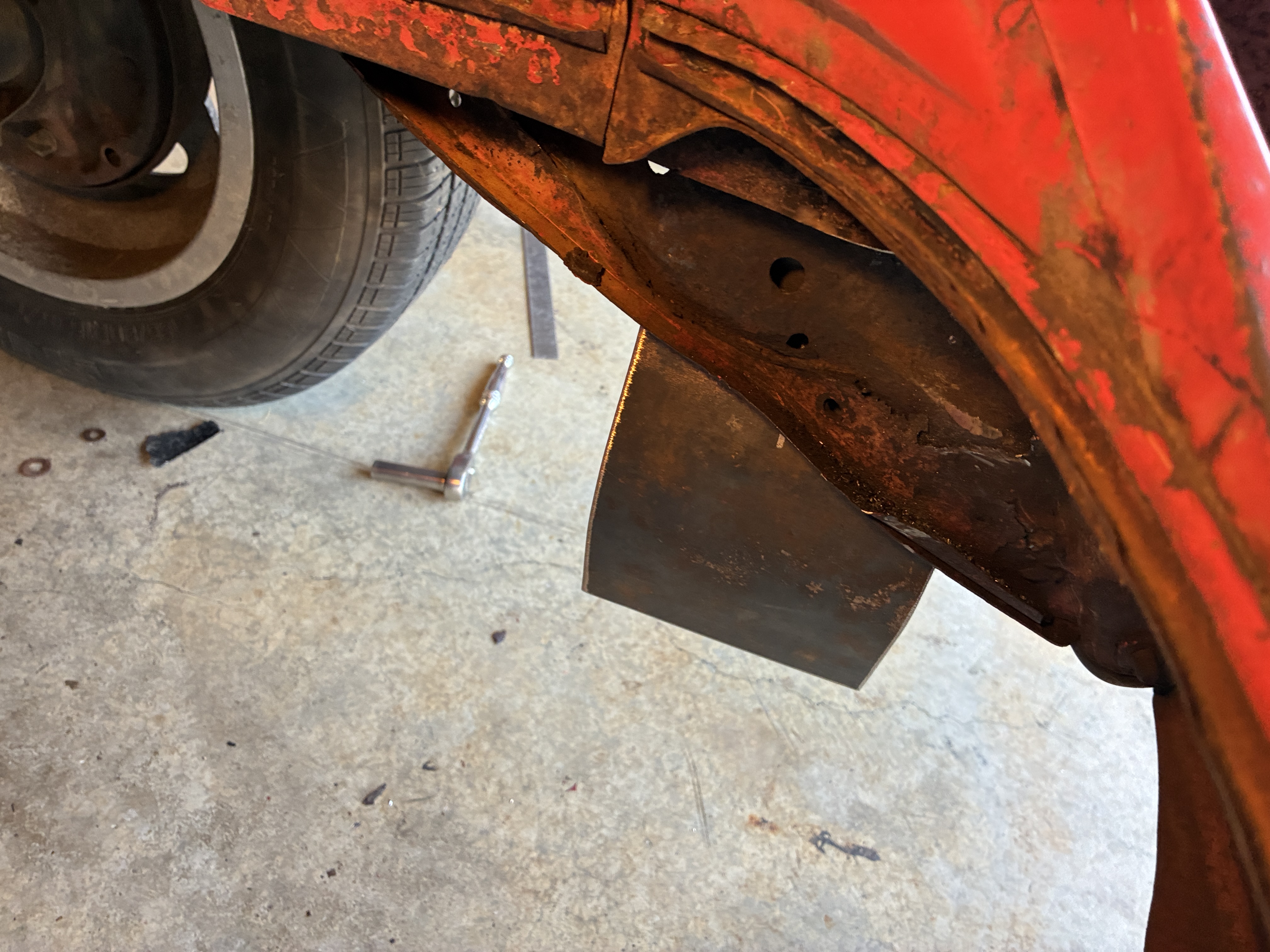

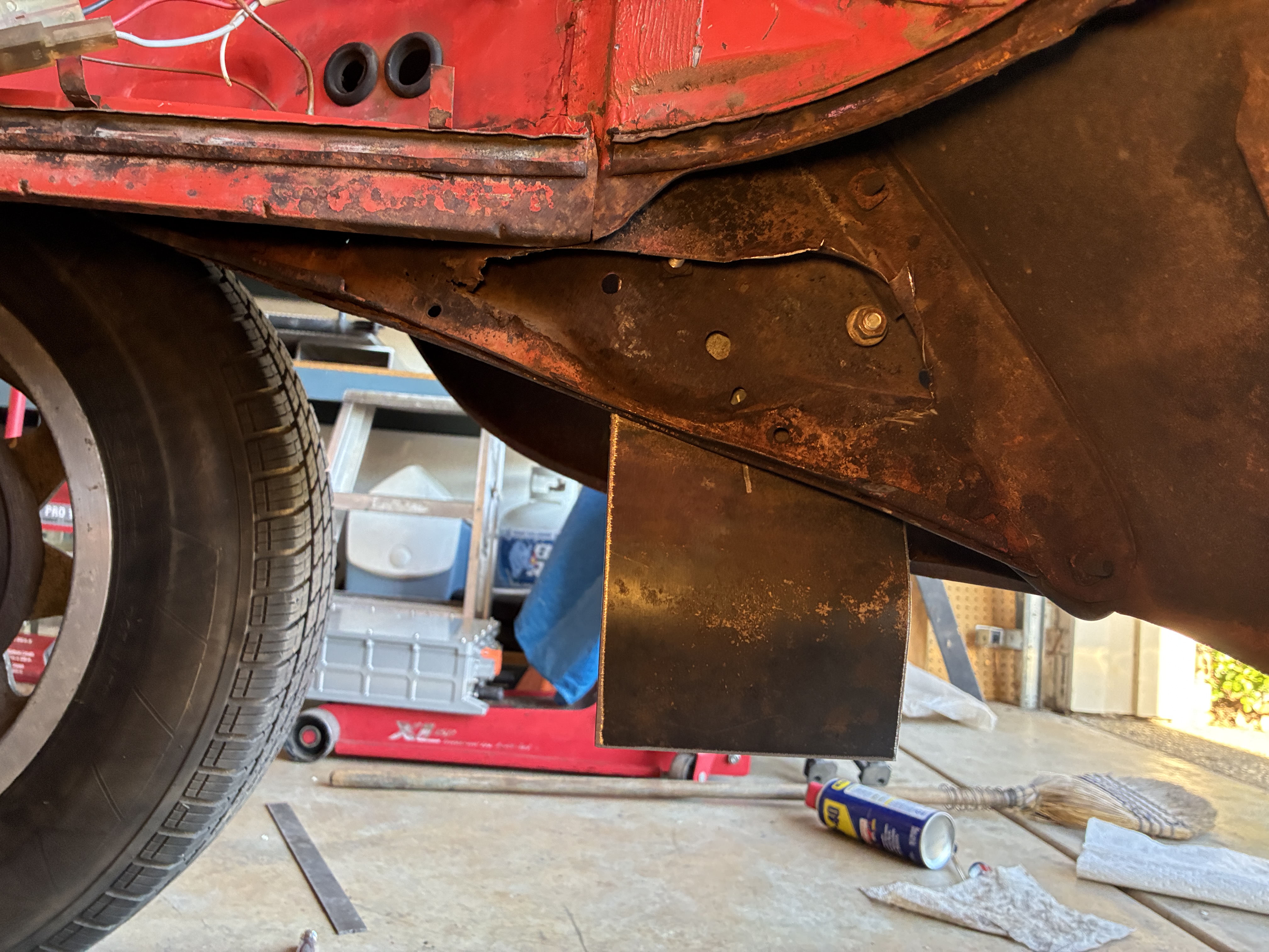

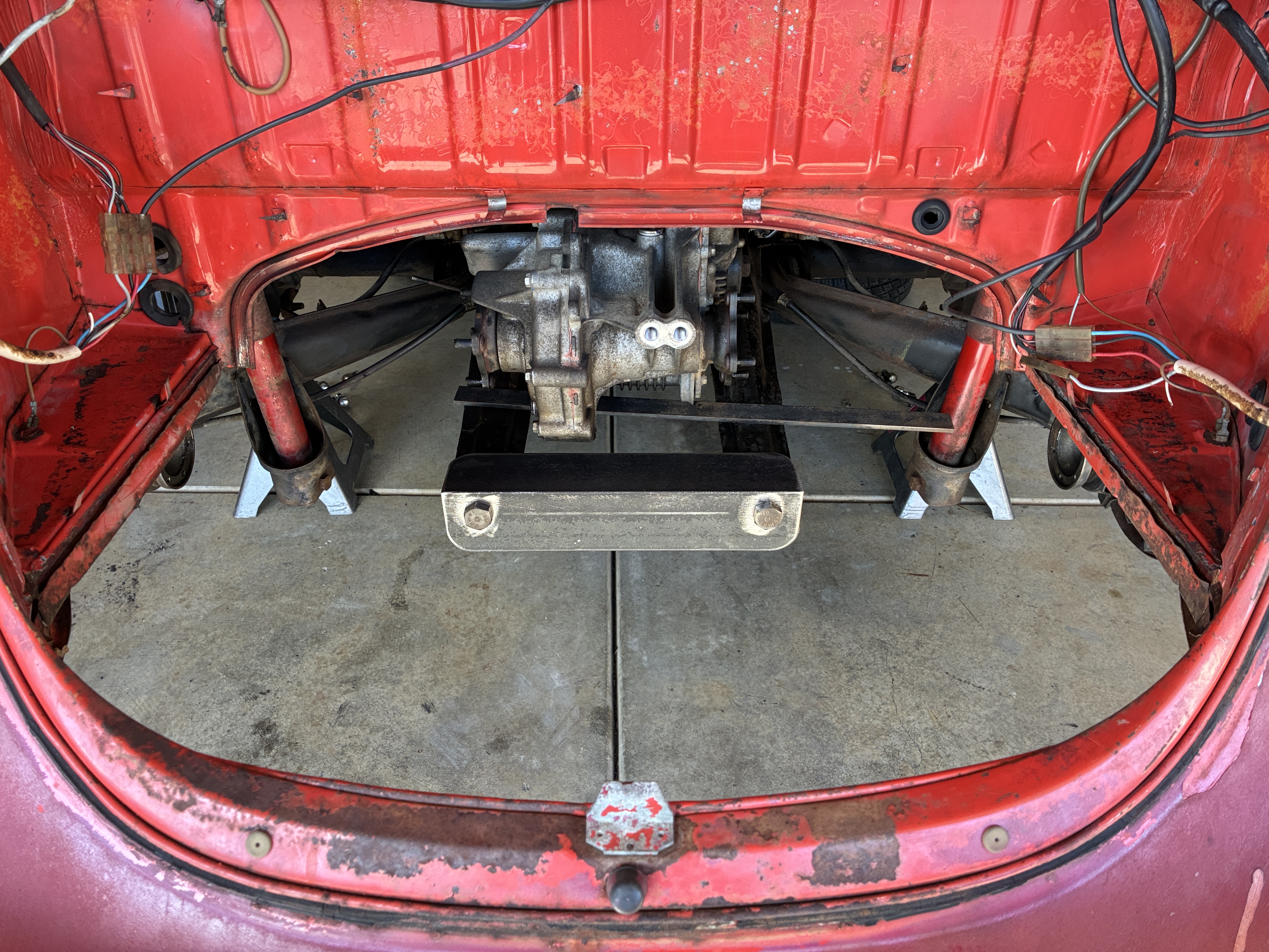

this now being my 3rd EV Conversion I offer some advice: Allow yourselves to fail.
take this fugly plate that was supposed to serve as the rear motor mount, this was Plan A, well it did not work out, but it learned me that the frame horns that the MGR rests on are not parallel to the ground but that they swoop up a bit in the rear, had I not mounted this monstrosity to the horns it would have been nearly impossible to find this out
and so here I am making a copy of a copy sort of speak and using that large aluminum plate to transfer the two bolt holes onto a 14.5" angle iron 3/16ths thick

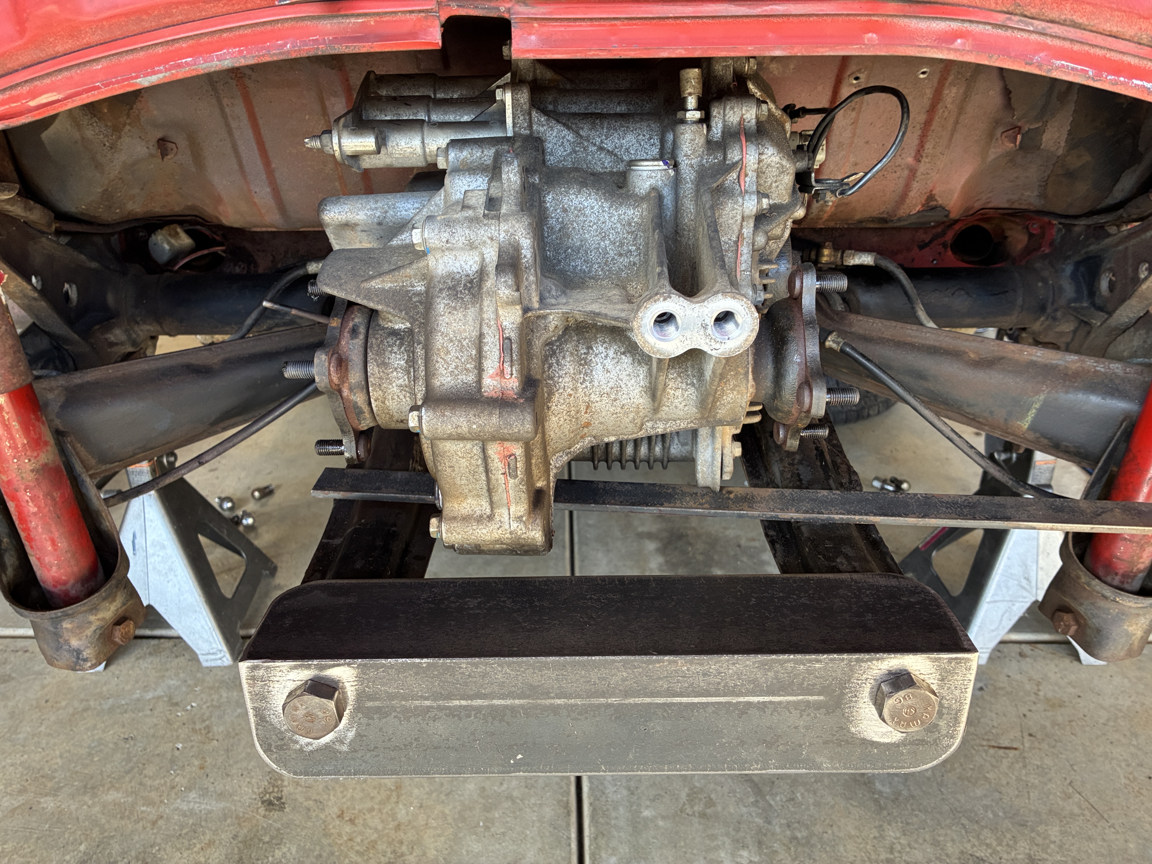

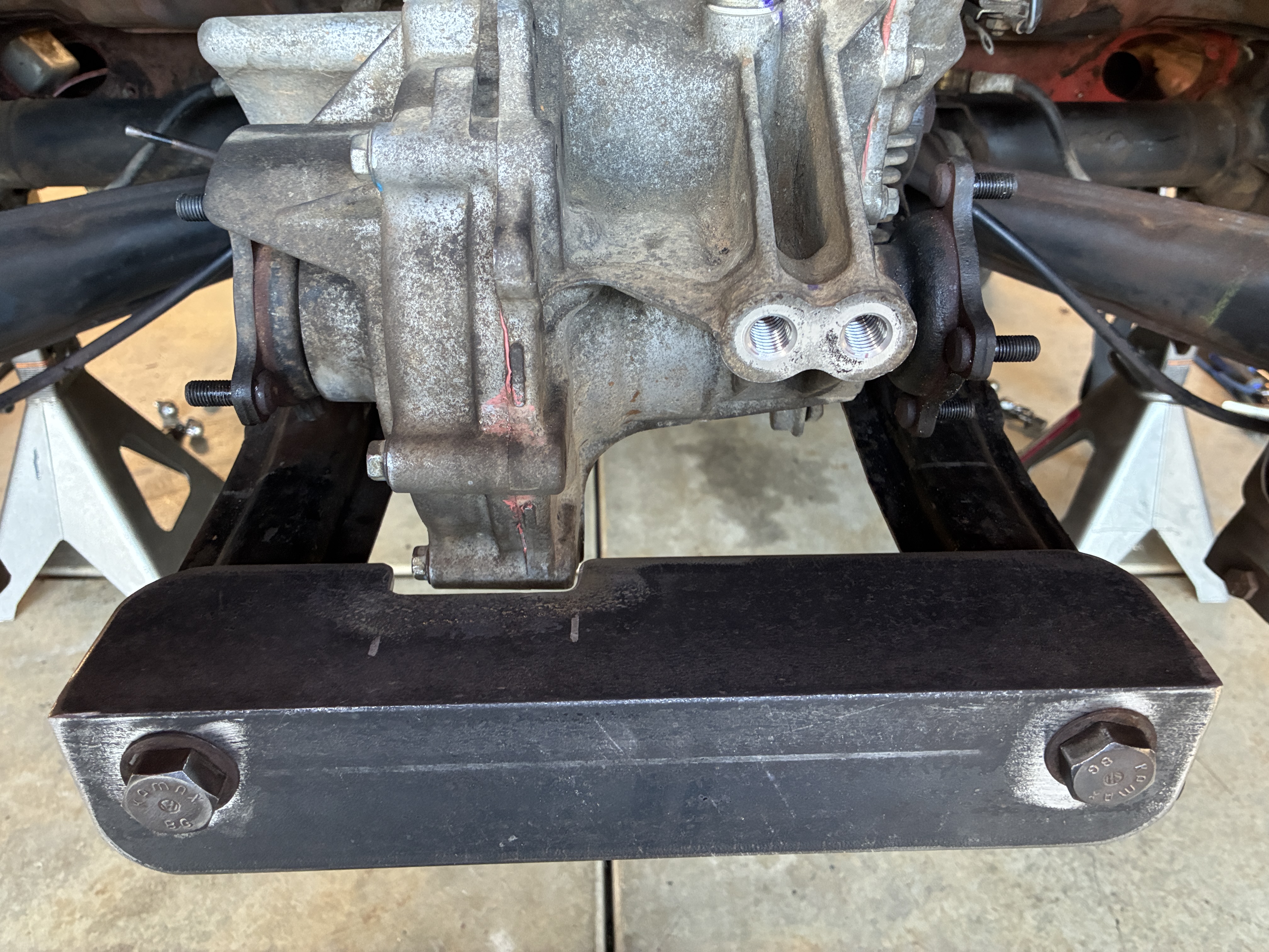

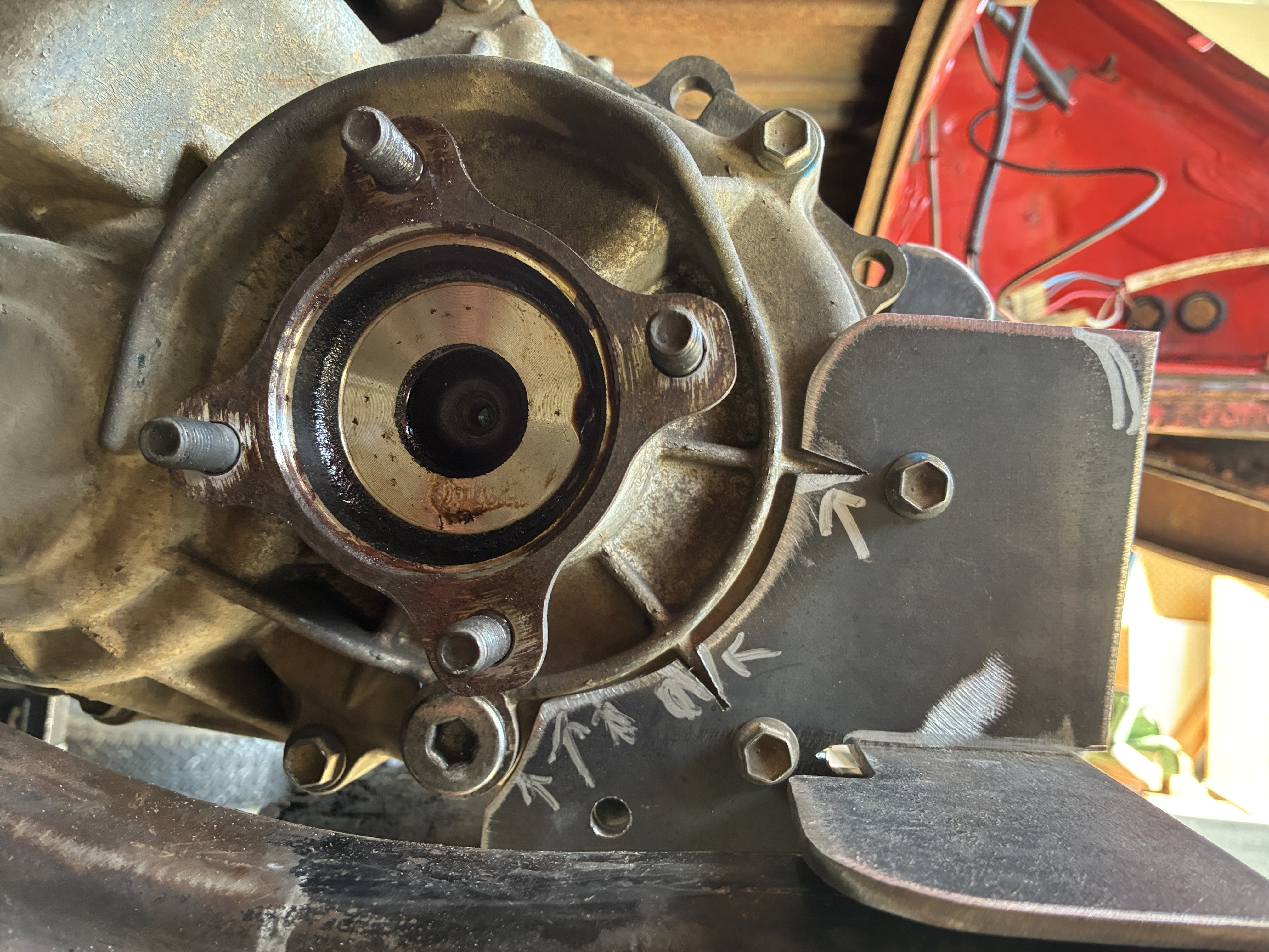

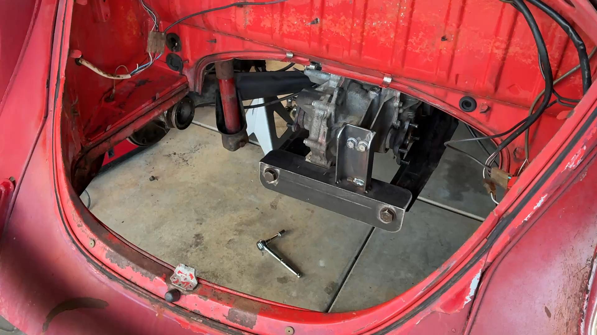

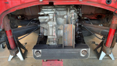

Rear Motor Mount - Plan B (let me know if you like this design one more better)
here I am just showing you that I had to notch that rear bracket a little bit to get the motor to sit as low as I wanted it

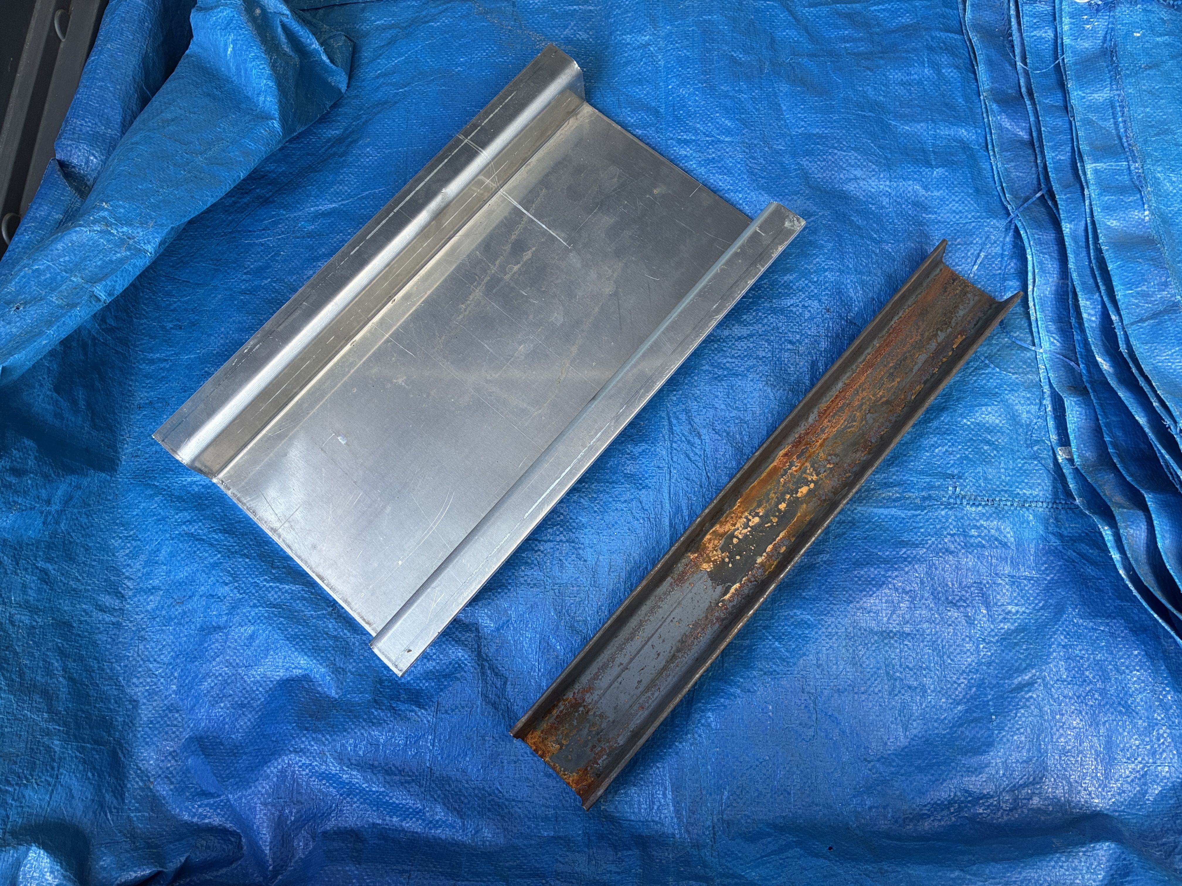

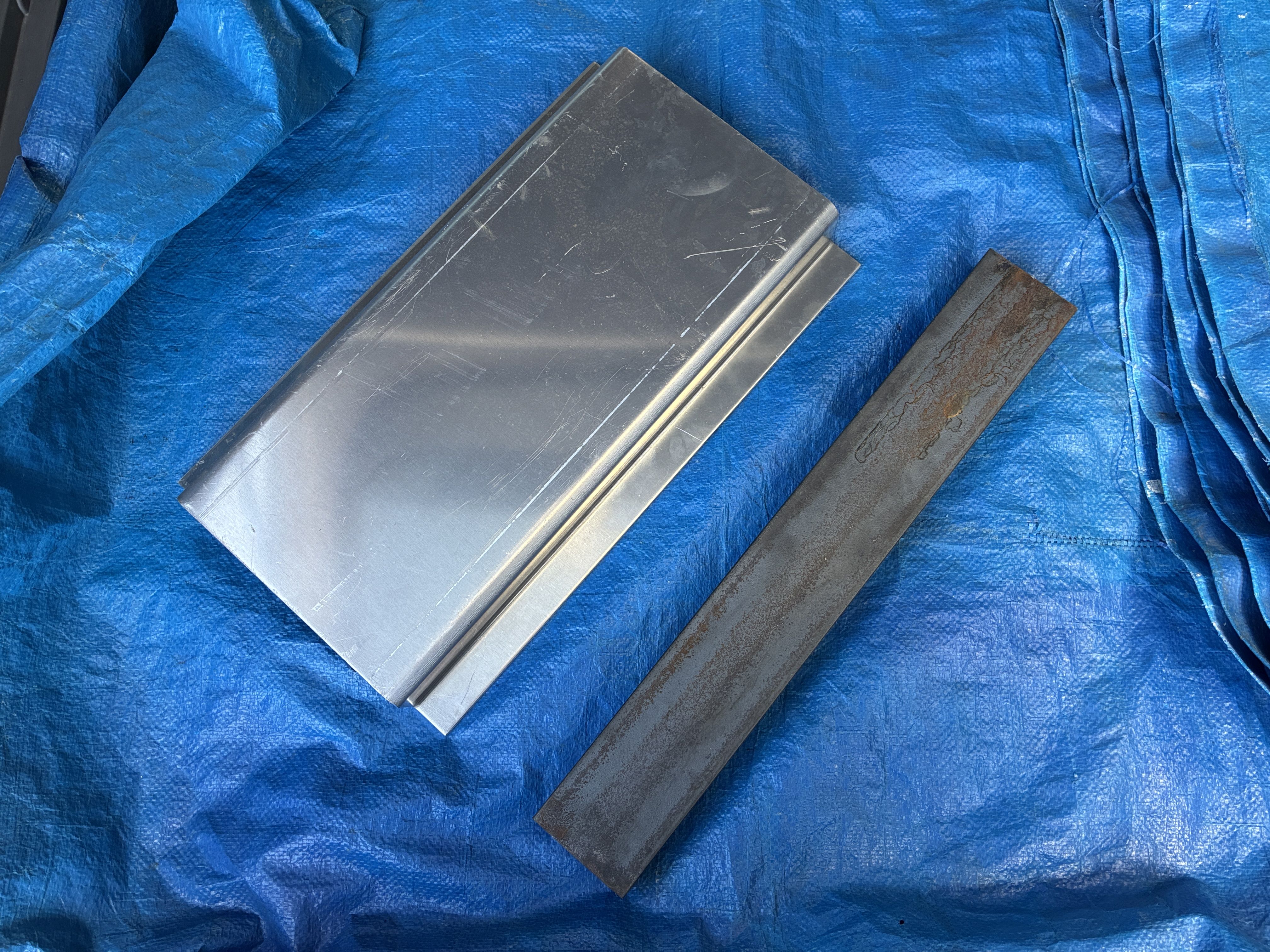

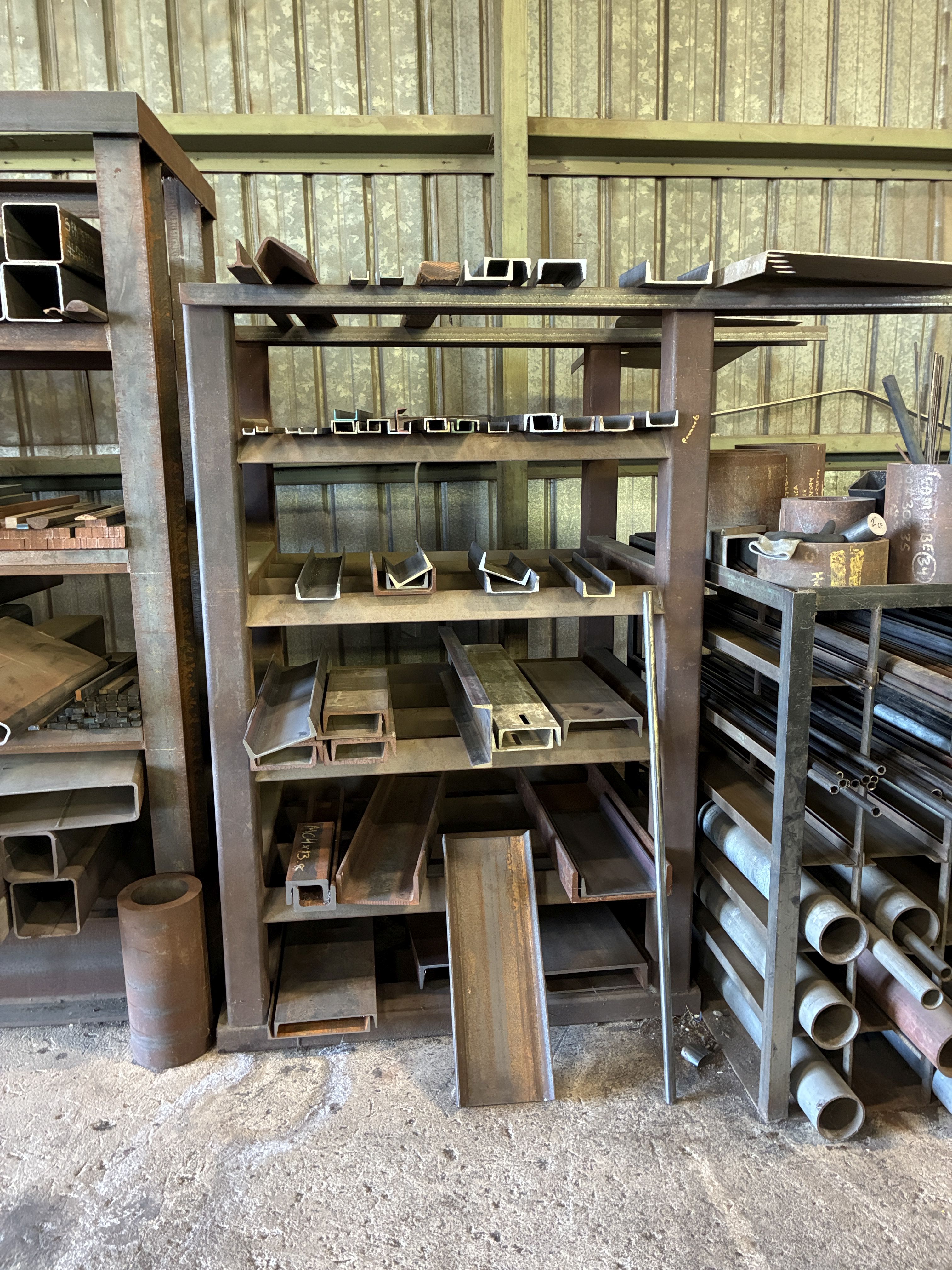

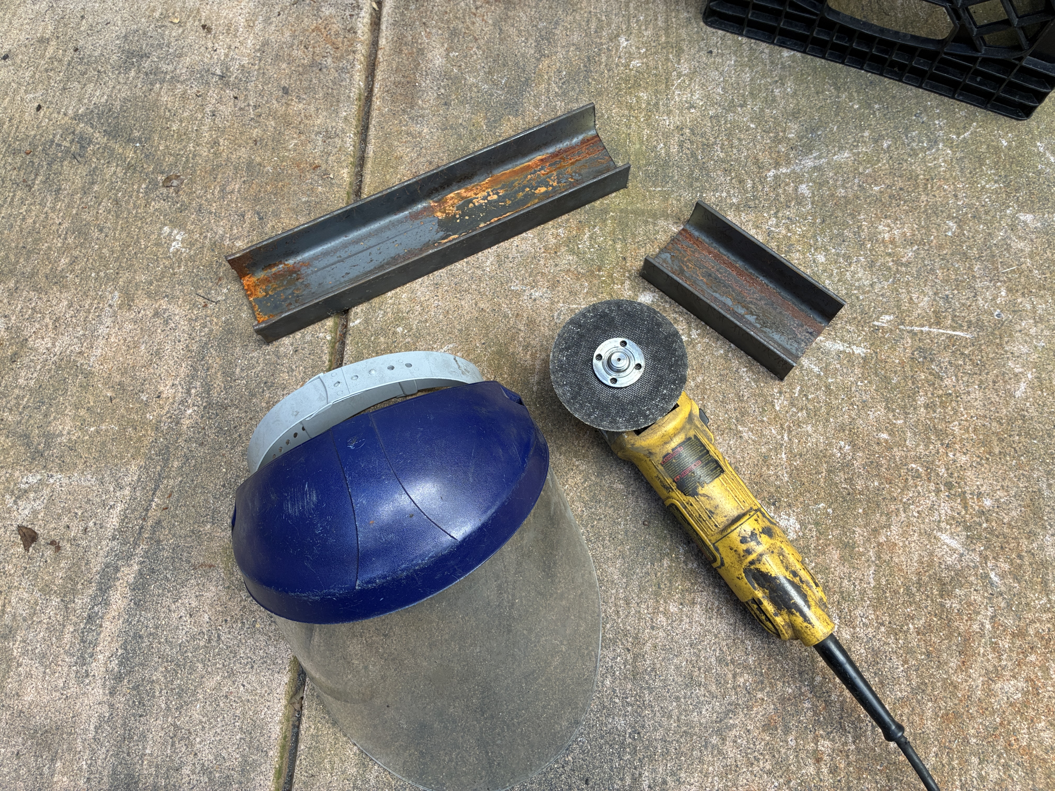

then it was time for another run to S&K Steel for some U channel
these types of shops are going the way of the dinosaurs
I saw this pre bent piece of 1/4" thick aluminum so I bought it for $25 in hopes of using it for something
the U channel steel next to it was only $5 bucks

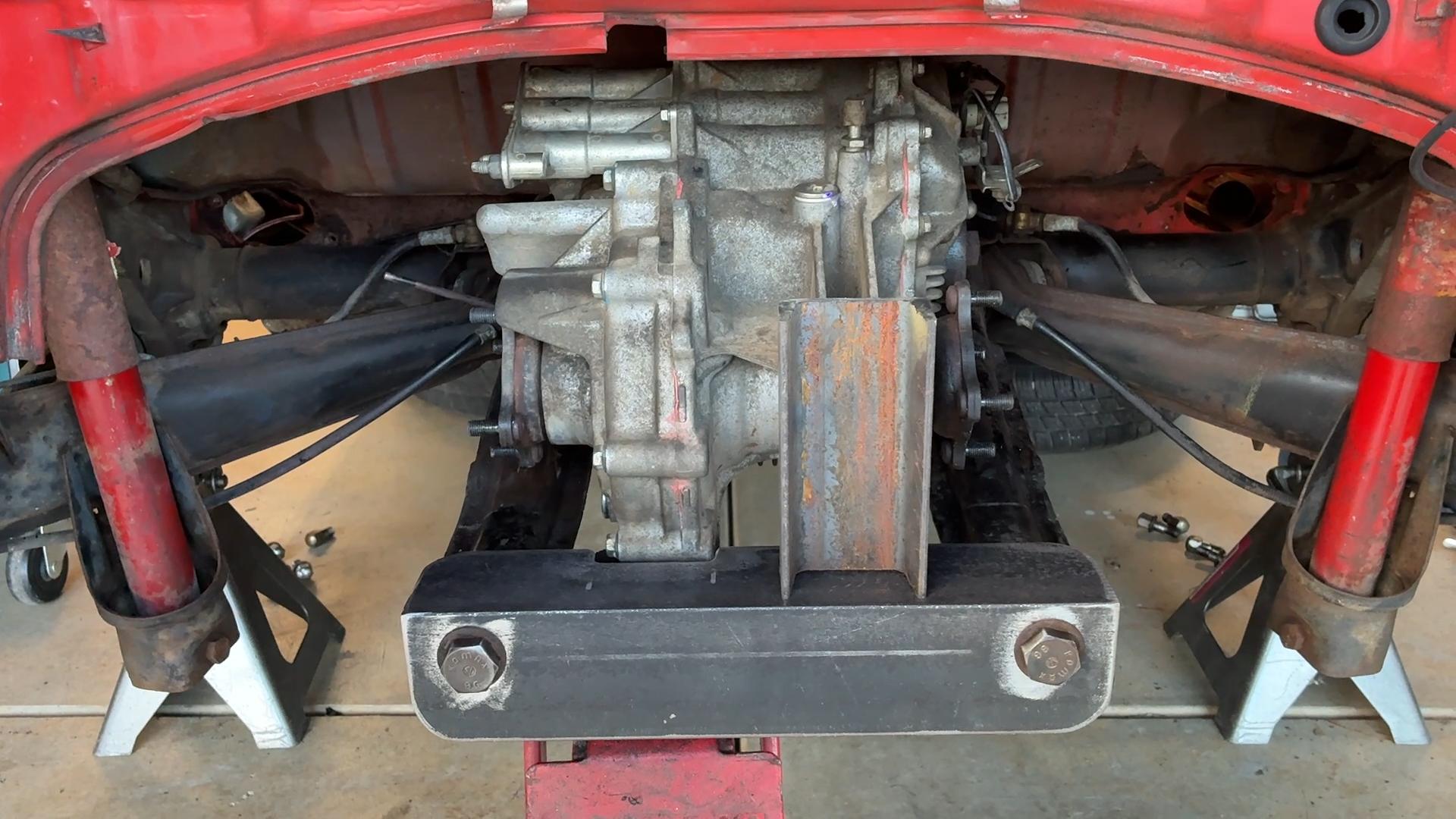

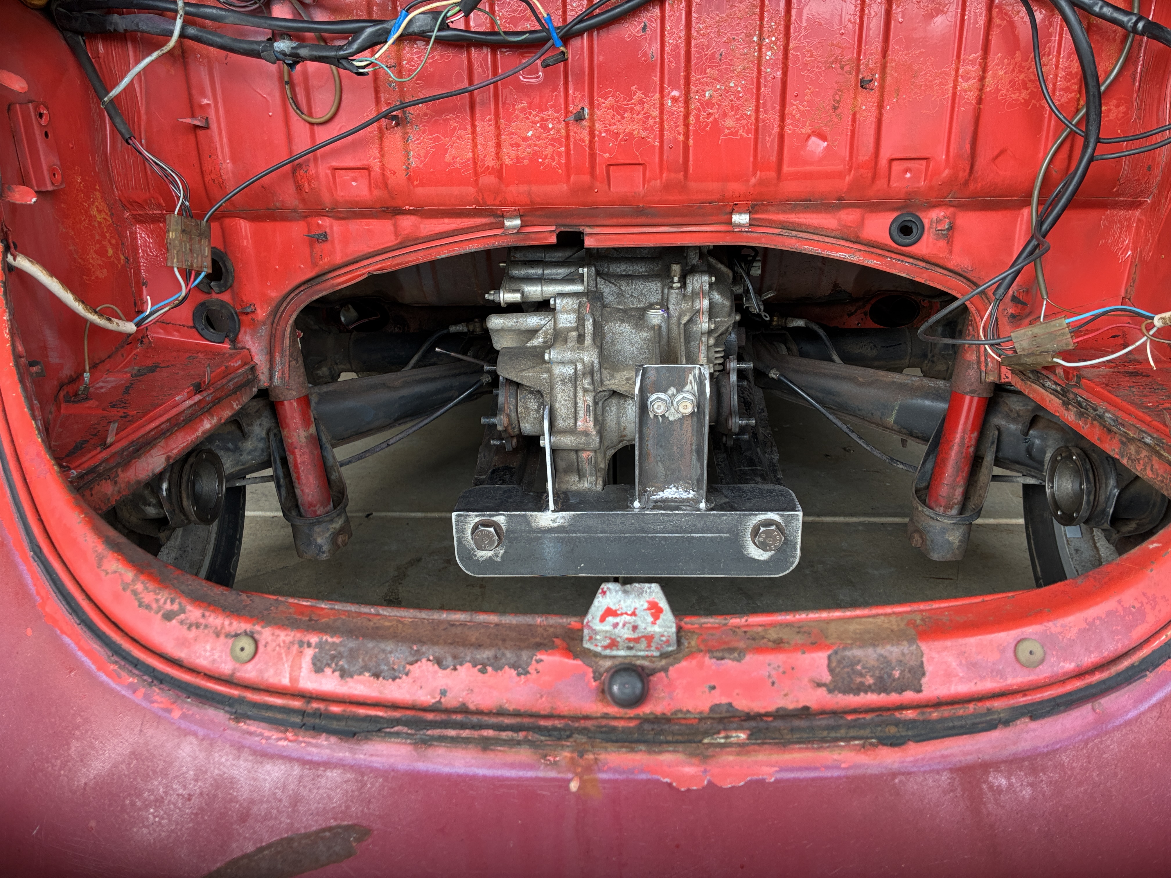

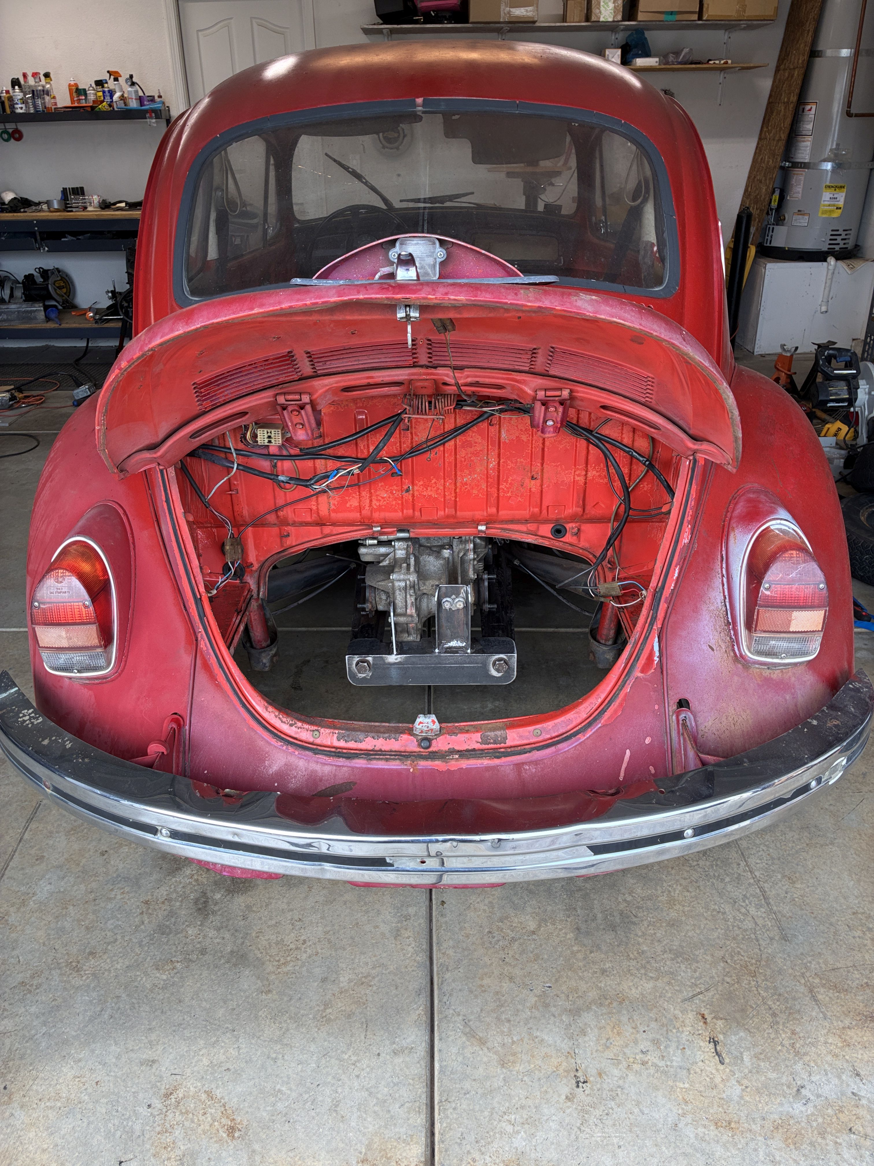

so here's the general idea
no floor jack, it's sitting under it's own weight, strength what ever it's called

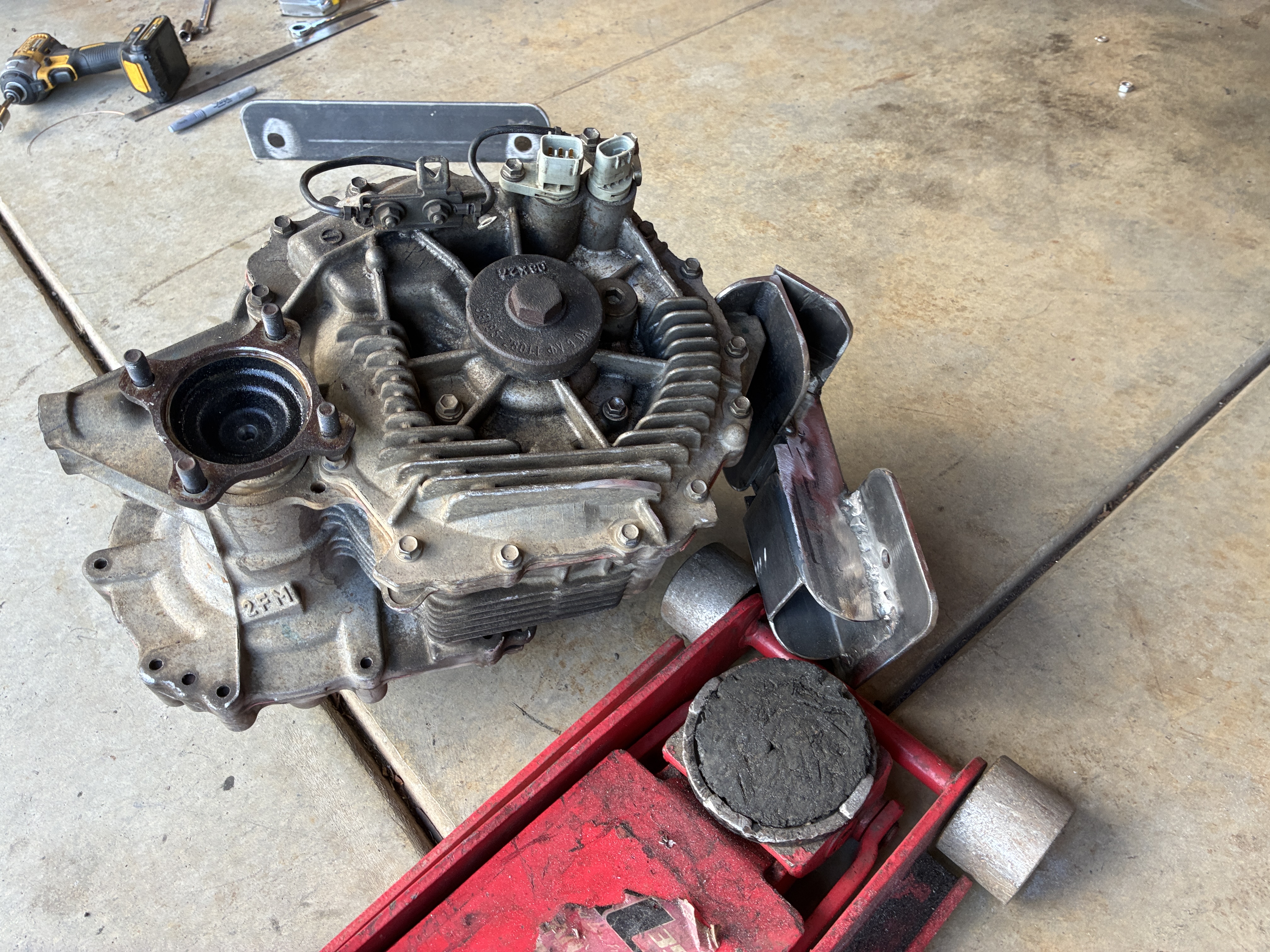

Re: Bunky the eBug: A 30 Day EV Conversion
Post by Gregski »

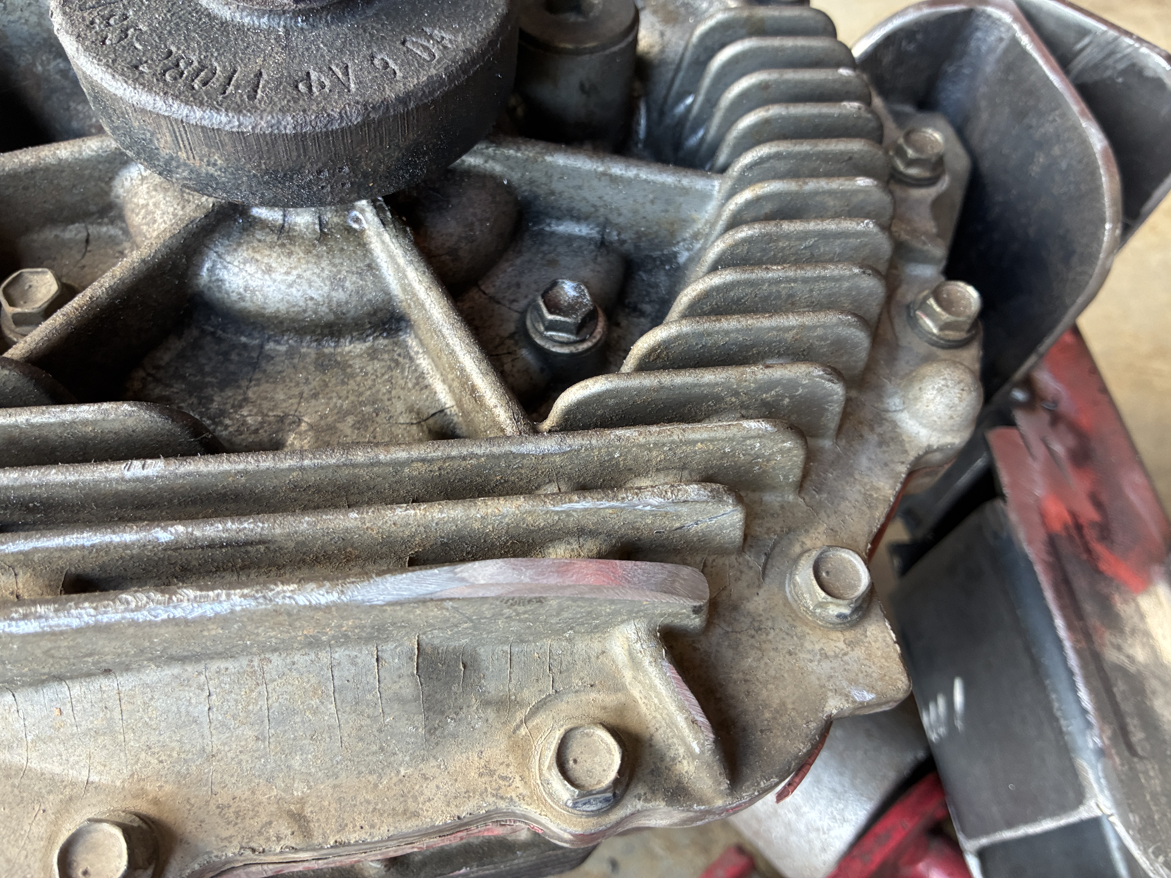

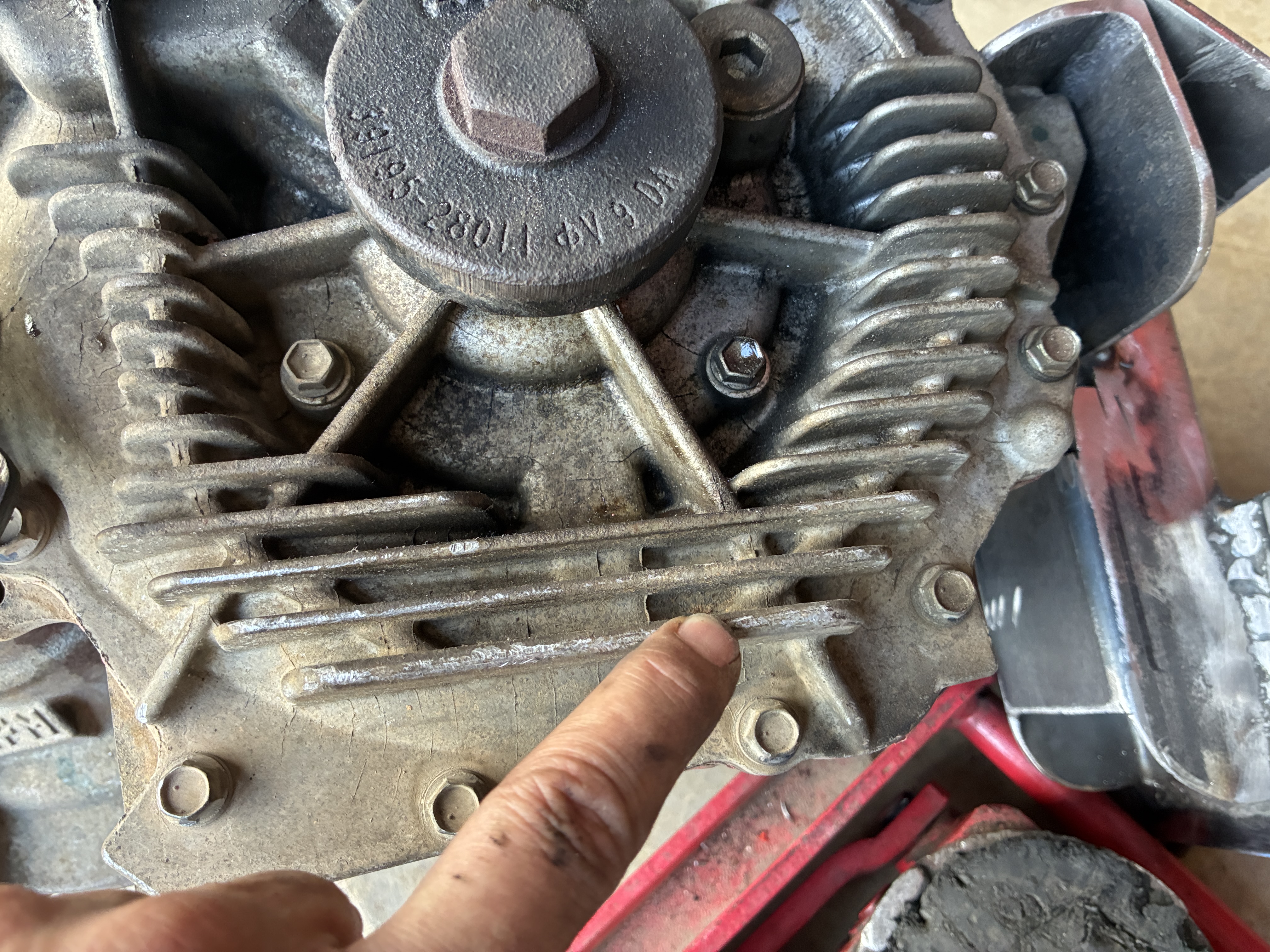

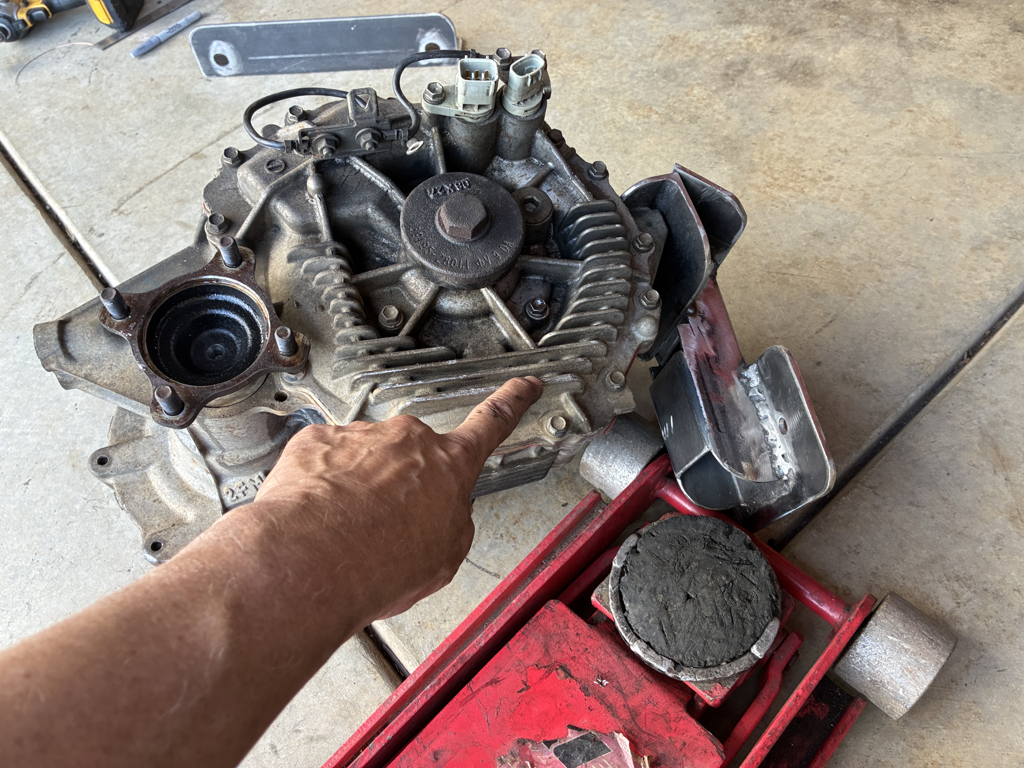

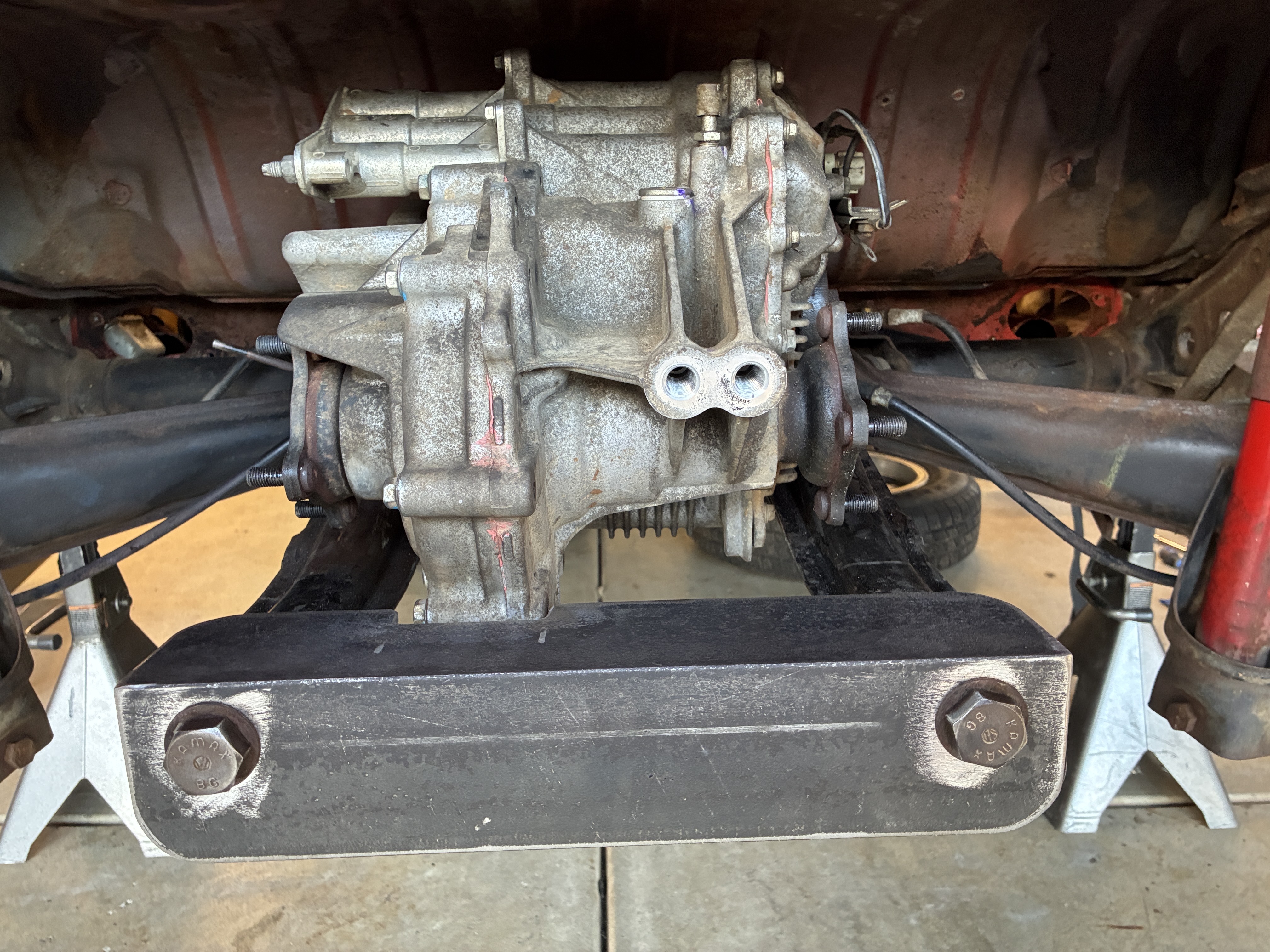

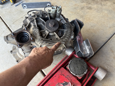

in order to get the motor to sit as low as possible on the frame horns and be centered to keep both of the CV Axles as close to the same length as possible, one of it's bottom cooling fins had to be tickled a little bit

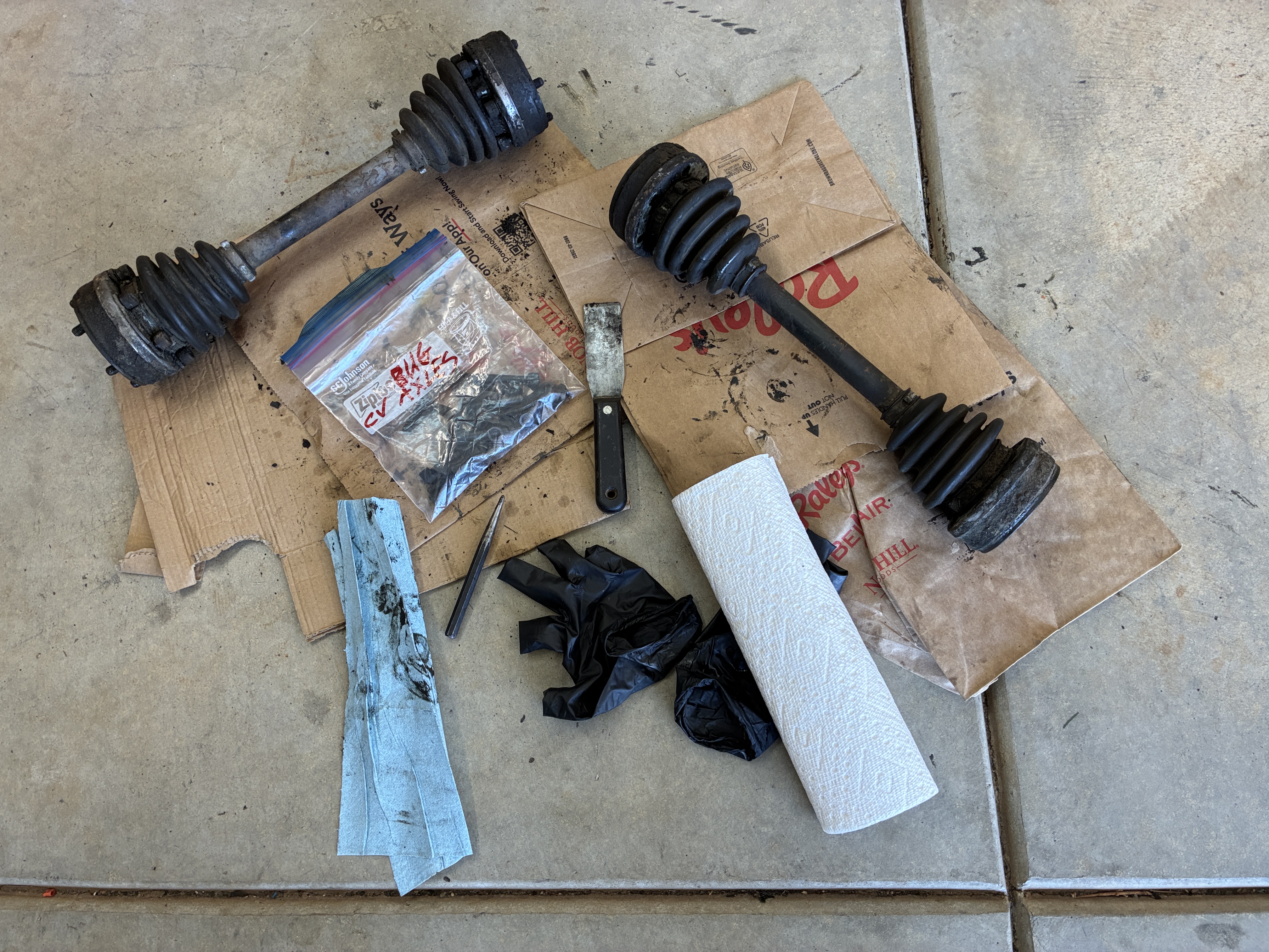

Bratitude wrote: Fri Mar 06, 2026 12:41 am thats for the outlander, but your using the MGR, which has flanges already with 4 bolts. you just need to get machined a simple puck that has the 4 bolt holes for the MGR side, and the 6 threaded holes for the beetle CV flange.
did you not center the diff? best to keep your diff center and your axles equal length.
hey I appreciate the suggestion, and I finally get it, sorry I have been so caught up in mounting the motor and worrying about it's front and rear brackets I was not even thinking CV axles yet, I just re read your comment and what you are suggesting does not exist yet (as in I can't just order it from you off your website) and I need to have it made, I thought you were offering up a product that has been around, that's what confused the hell out of me. Anyway, the question/concern is will there be enough room for such an adapter aka a simple puck, without the need to shorten the stock VW axles, and if they need to be shortened, then they might as well be grafted or machined to fit mate with the Highlander joints, I think the VW shafts are slightly thicker at 24mm than the Highlander shafts which are 23mm but don't take that to the bank as both are dirty and dusty as hell so I need to remeasure them
here I was just getting the bolts out of the grimy VW ones

and the air cooled 90 pound 70 horse power motor mount is done, I luv how it turned out

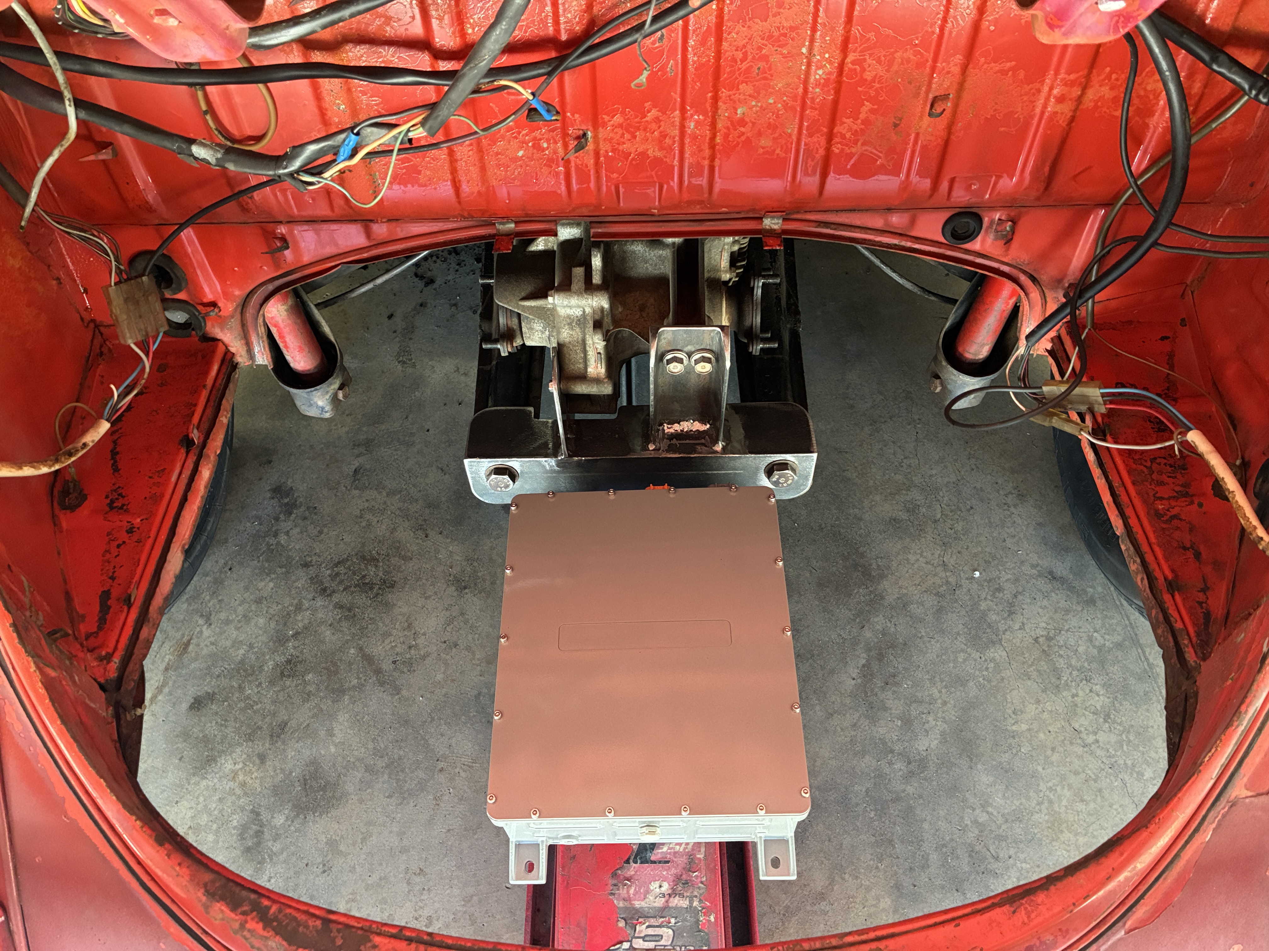

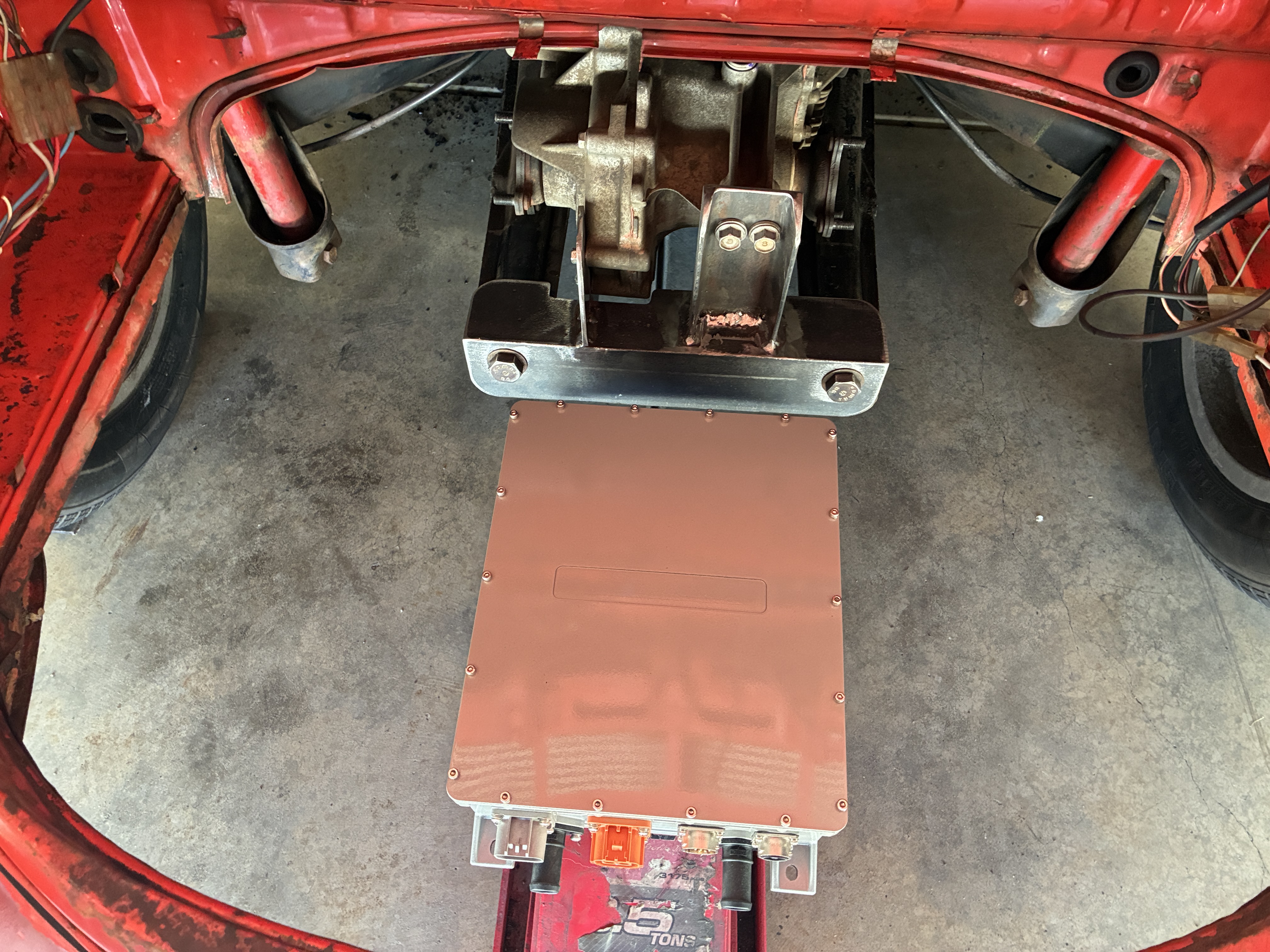

contemplating how to mount the Dilong 6.6kW 550 volt charger / DC-DC Converter, nipples in, or nipples out ?
decided to go with this one instead of the Mitsubishi Outlander one, for two reasons:
1. I already had it
2. word on the street is, this MGR may be volt hungry

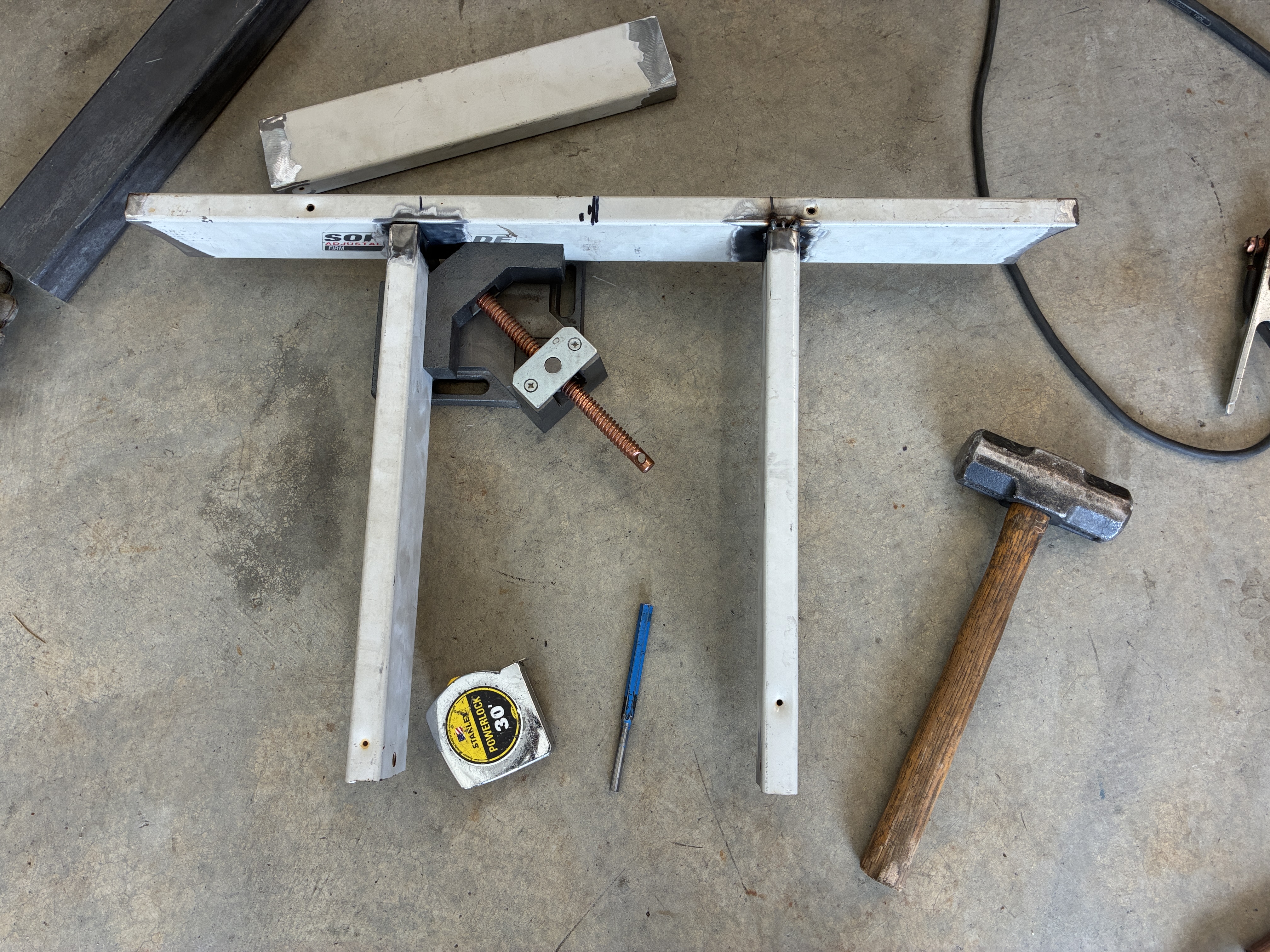

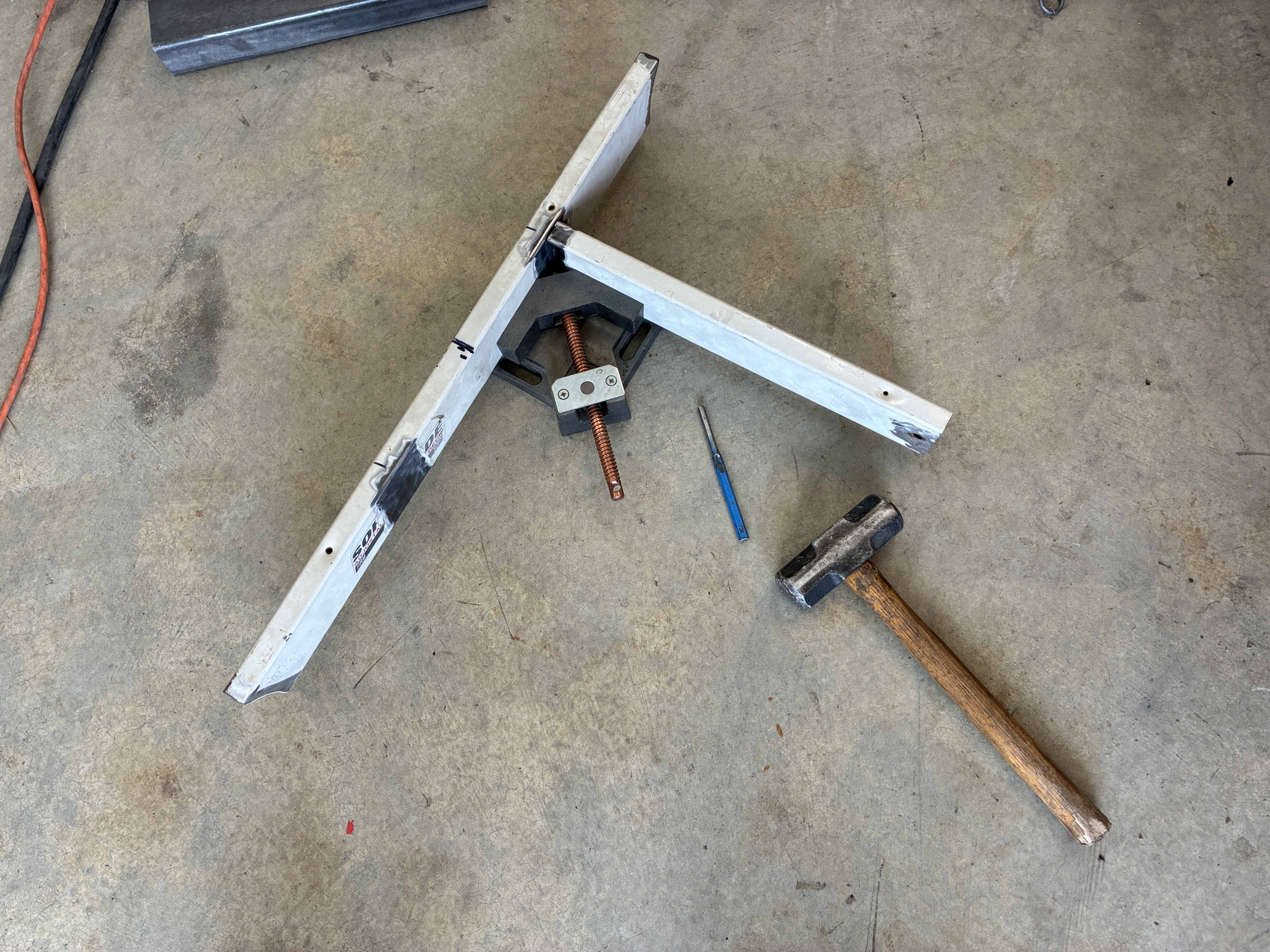

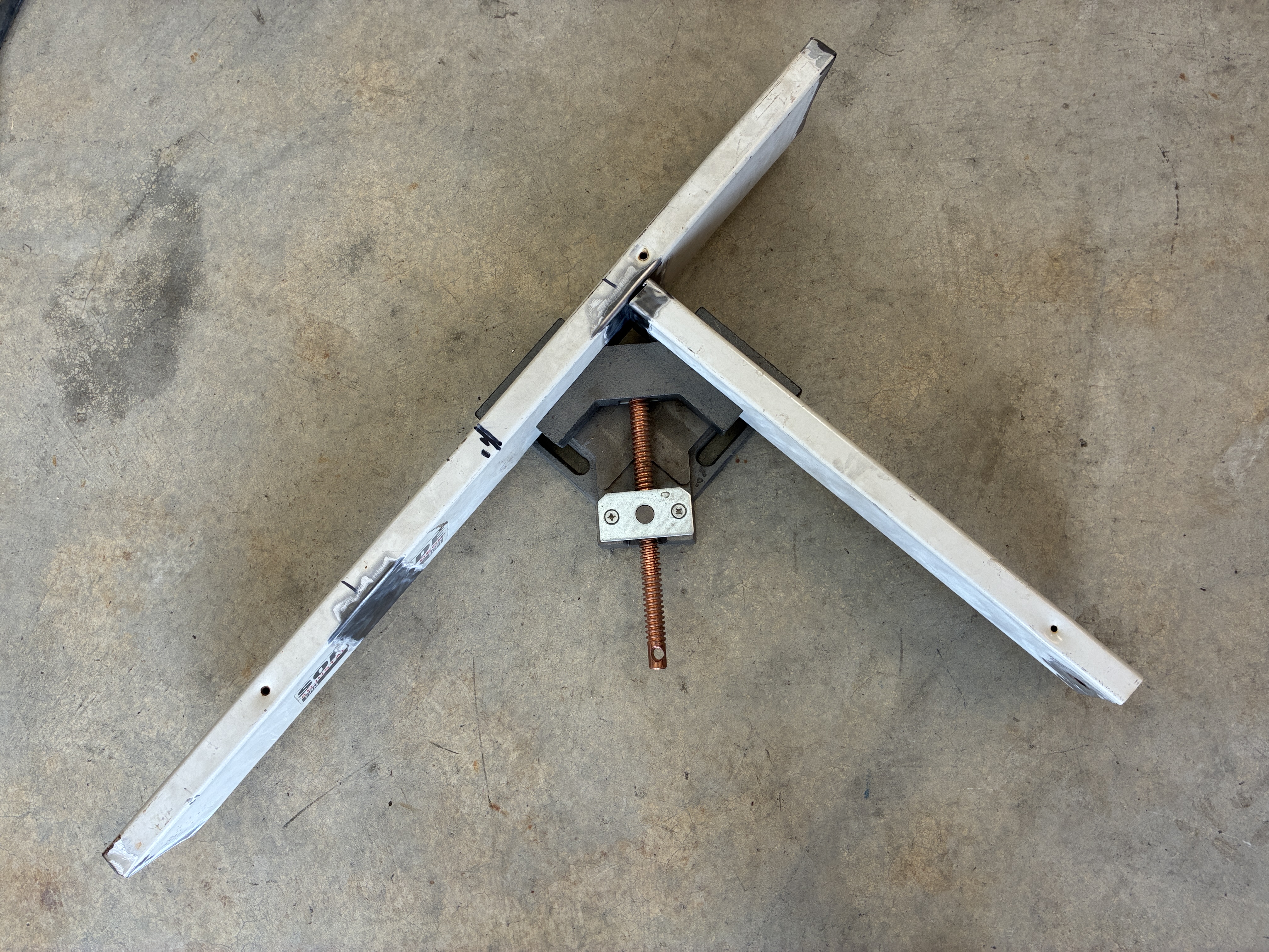

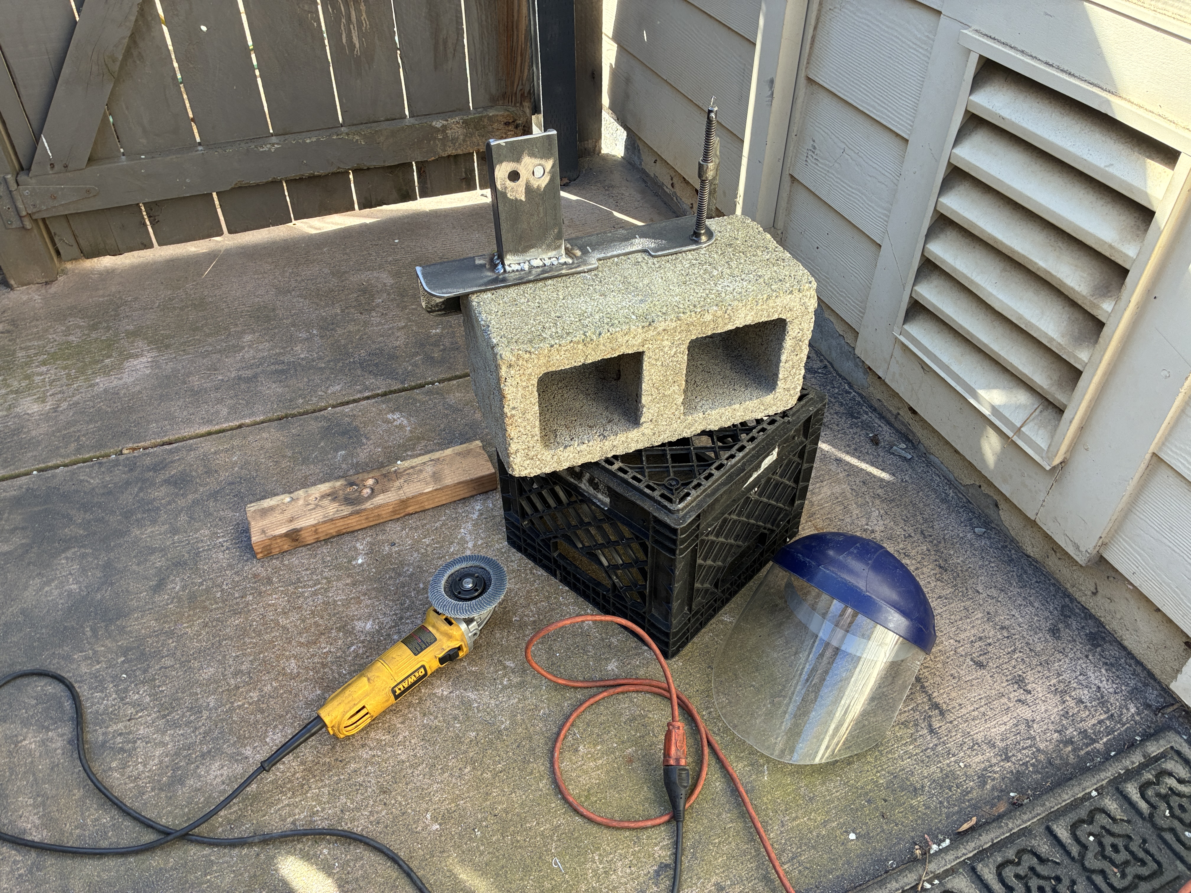

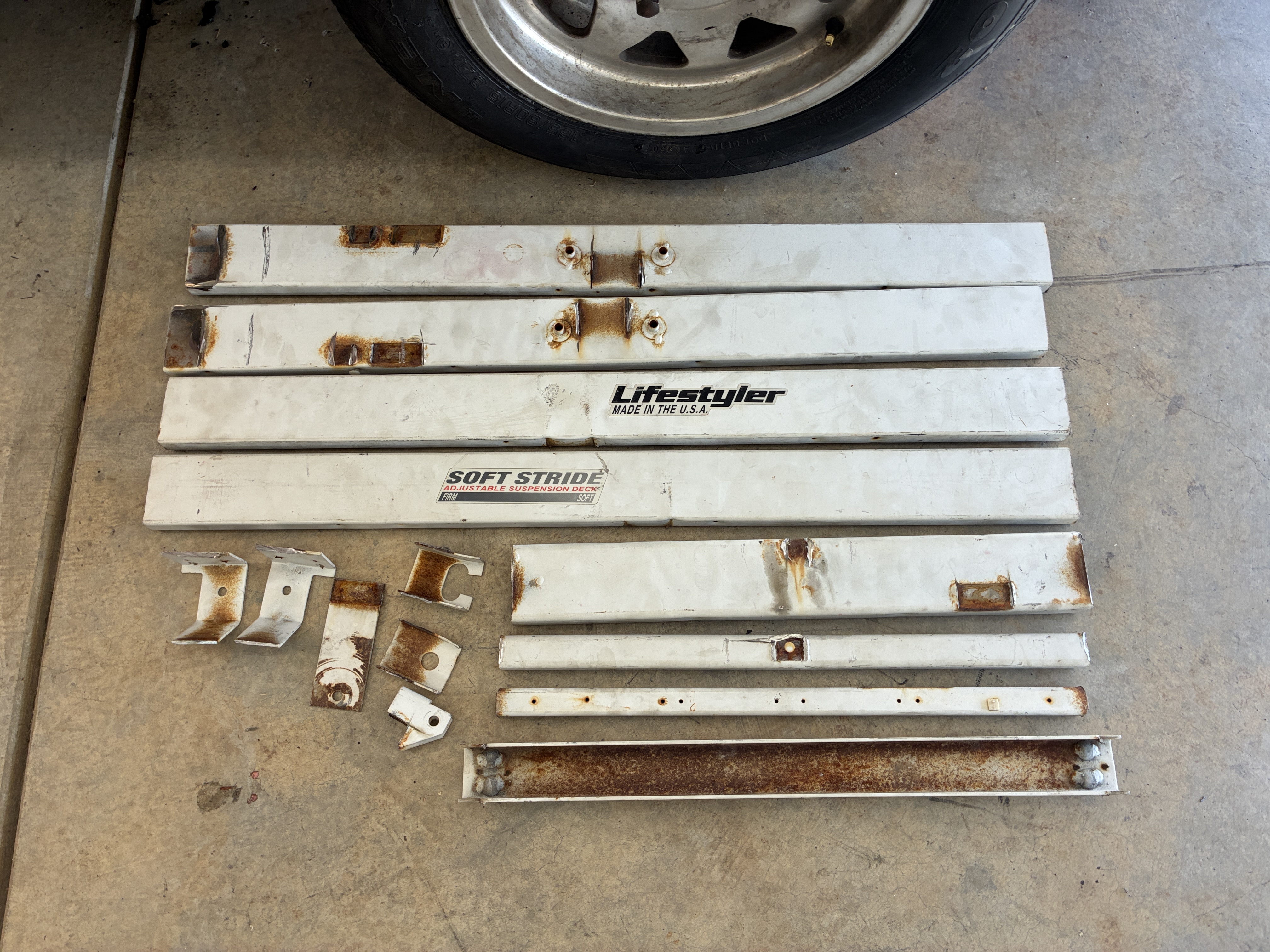

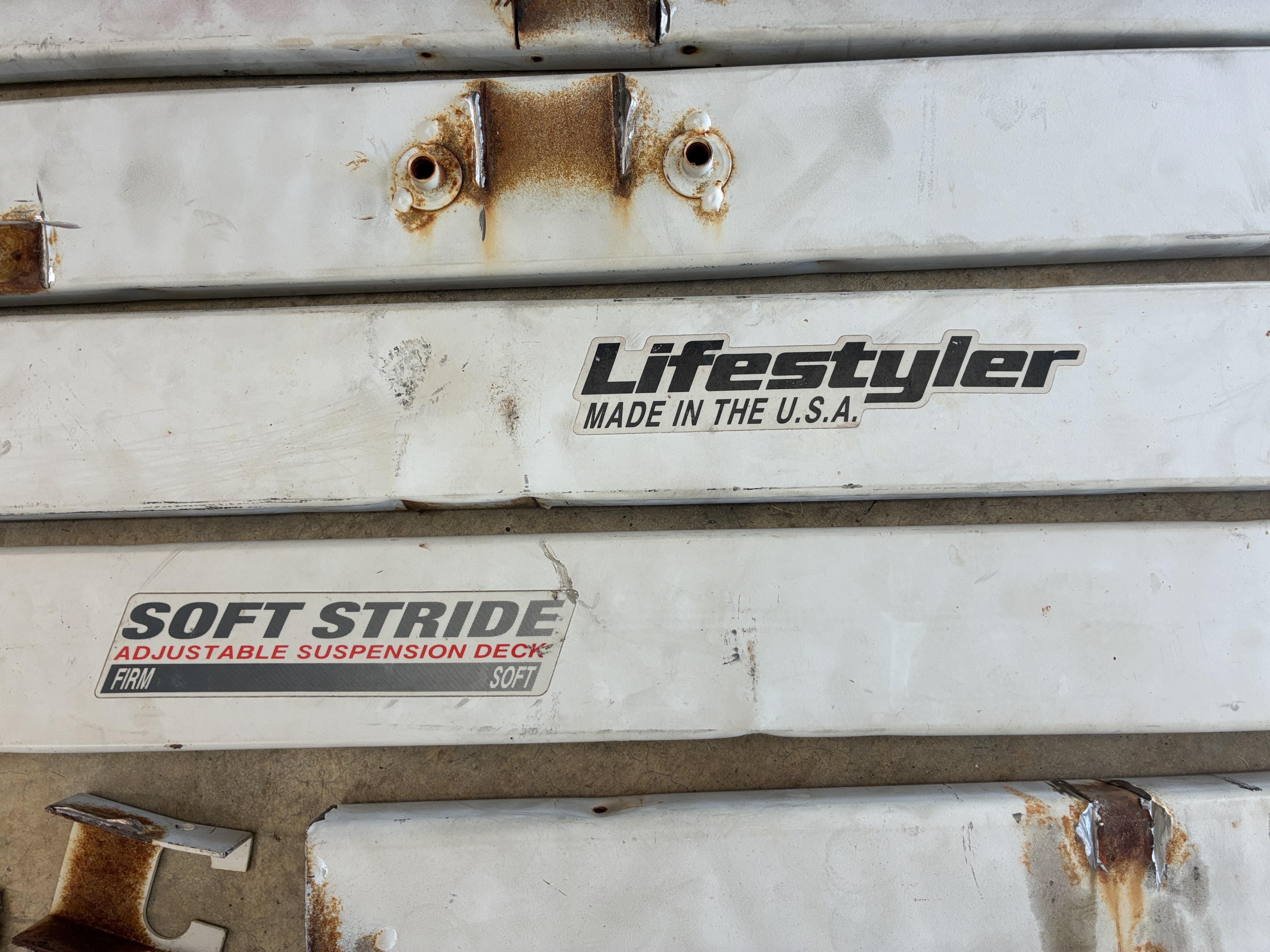

hope to make something out of these Lifestyler Soft Stride treadmill remnants
I actually had to shape [pronounced: "beat the crap out of"] some metal, in order to make the rear hangers for this bracket, which is suspended from the rear bumper mounting points (commonly referred to as rust and dust)

Gregski wrote: Fri Mar 13, 2026 3:13 am contemplating how to mount the Dilong 6.6kW 550 volt charger / DC-DC Converter, nipples in, or nipples out ?
1. I already had it
Wherever leaves the most space for batteries.
