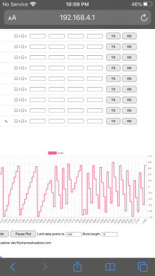

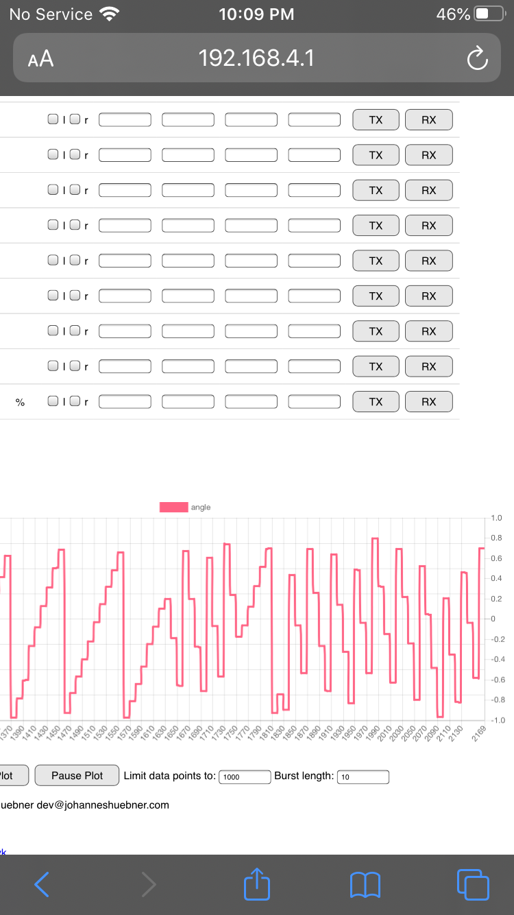

New STM32 board arrived today, the comparator is working great now! So I guess there was some sort of ADC issue.
In manual mode without encoder I can spin the motor beautifully. The current readings, however, are much higher than my clamp meter reports - 60A claimed by inverter, and 32 from clamp ammeter. I still suspect noise in the current sensor wires. I just switched the wires to twisted pair shielded wires which are grounded at the control board, total length is 9". They run perpendicular to 2 phase wires. Anyways manual mode seems okay, besides the sensor noise.
But when the encoder is connected strange things begin to happen. No matter the settings, as soon as I set ampnom high enough to move the motor it clunks and claims overcurrent. This occurs both in start mode 1 and start mode 2.
My encoder is AB type, open collector, and requiring a 5-20v supply.
When building the board I populated everything except J1. R7 has a jumper across it and is feeding the pedal and encoder.
I just scoped the outputs of the encoder itself and they look correct. Past R2 and R5 (which feed the signal to the STM32) they also look good.
In regular "Run" mode (slip control), the 'angle' variable begins to move around. When the pedal is in the regen area the angle goes backwards, and when the pedal is in the acceleration area the angle goes forwards.
If I rotate the wheels by hand I can counteract this and get the angle to remain steady.
And lastly, in slip control mode, the motor will not do anything until I reach potnom of 60%. Then it hits overcurrent and dies. The 'amp' variable also stays zero until 60% potnom. I think this is linked to the angle weirdness somehow.
Any ideas? I've been about tearing my hair out the last 2 weeks with this...

YES! That enabled the motor to spin under pedal control! (although it was super jumpy and soon hit OC). It also spun up nice and fast and then shut off from the OC. It now makes whining noises just as a motor should :D
But the encoder is still behaving strangely. I dove pretty deep into its behavior and figured out exactly when it happens.
Whether the encoder is connected or not, when I turn the key or send 'start 1' then the angle variable begins increasing steadily. I have posted screenshots in this thread already.
If I just turn on 12v and then send 'start 2' the angle doesn't change. But if I turn on 12v and then turn the key for start (turning on the main contactor) the angle starts ticking upwards. Even if I send 'start 2' afterwards the angle keeps changing. I think this is causing the jumpiness of the motor.
The encoder, however, does get read correctly; I can counteract the changing of the angle by turning the wheel backwards.
Also the 'turns' variable doesn't change just from the ticking of the angle variable.
I'll scope the MCU inputs and see if there's some noise on the line.
Progress!
