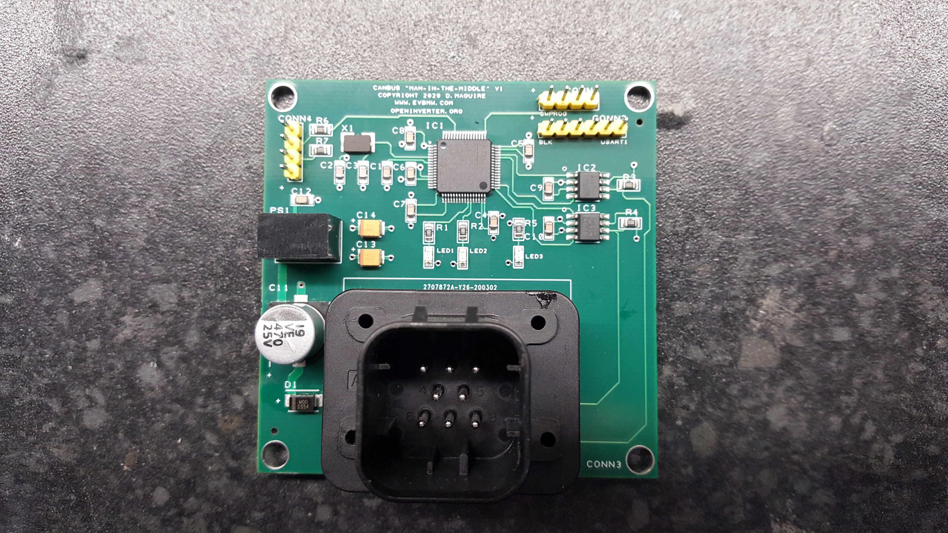

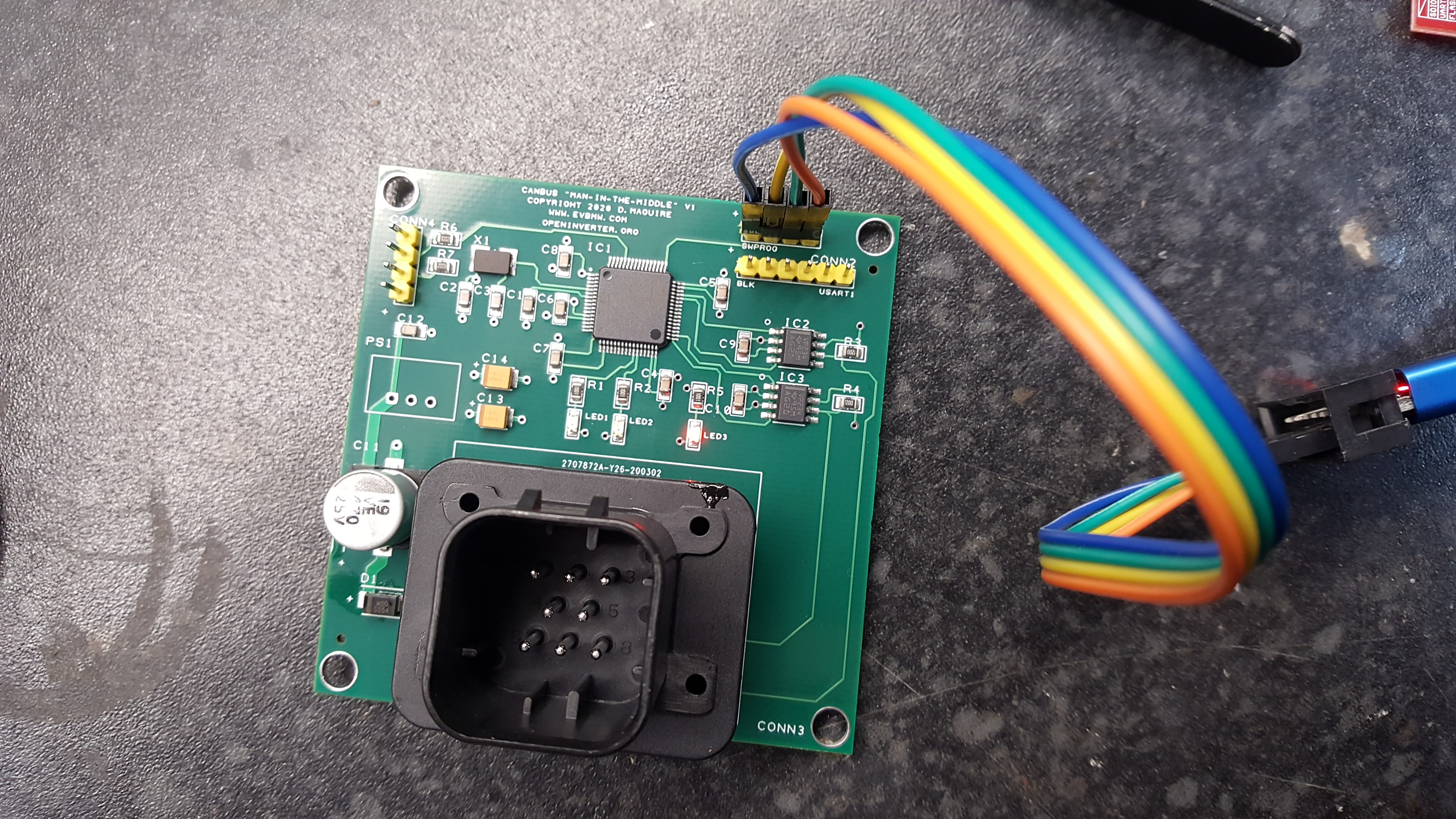

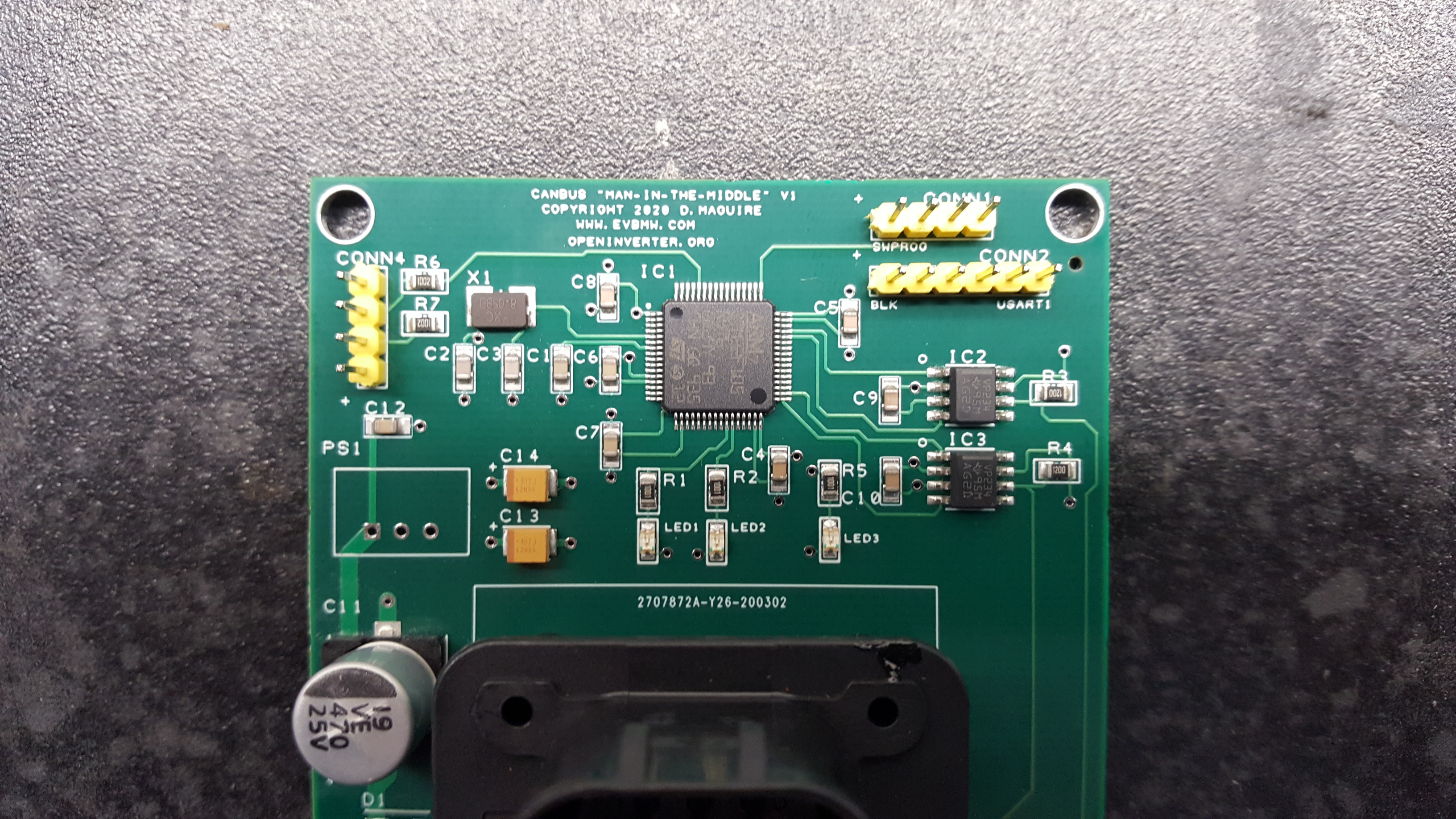

Got the boards from JLC. Communicating fine with stlink so just waiting on firmware which should be available next week.

Software now available and in beta stage for the man in the middle. I have updated the webshop and github.
