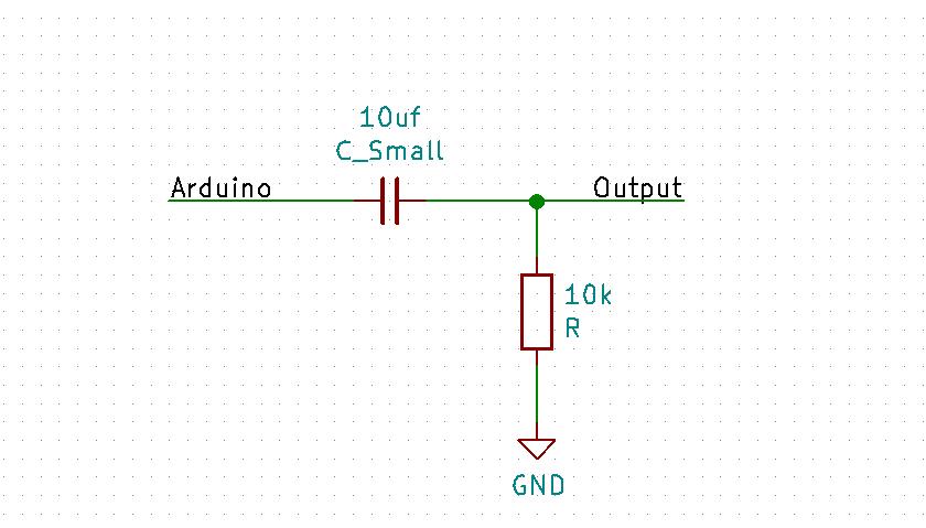

Well i finally managed to try and connect one Nano with your code. On the scope i got good square signal.
I removed RPM sensor and cut the connector. Then i lengthened the wires since i will need to put circuit in separate box.
I connected one of the wires to pin D10.... I left other one in the air
Well i got a fan relay to engage and everything worked without temperature too high warning which was nice.
BUT! There was no activity on RPM indicator.
How would i need to connect sensor leads to excite BSI to show RPM dial? I think i have a problem because sensor provided its own excitation for both wires, i only have one signal wire. Should i connect the other one to GND?

OK Damian how did you connect Arduino to your RPM sensor wires? Did you use push pull pair to simulate both sides of sensor?
Posts: 4006
Been thanked: 1136 times
Re: Weird Speedometer Question
I used an npn transistor as a pulldown but it depends on how your crank sensor works. Might be worth checking the wiring diagram for your car.

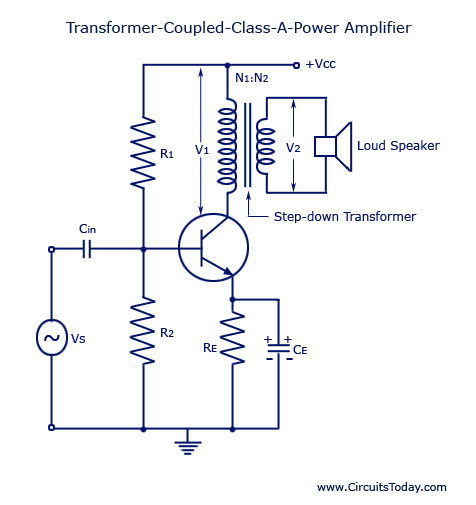

Jack Bauer wrote: Mon Sep 30, 2019 7:47 pm I used an npn transistor as a pulldown but it depends on how your crank sensor works. Might be worth checking the wiring diagram for your car.
Yes i see it needs isolated pulses. Both sides need to be connected to some sinus signal. I need transistor connected to NPN transformer. Transformer will simulate pulse from sensor then.
Posts: 3796
Been thanked: 413 times
Darn! I tried everythink i know with transistors. I tried one NPN amplifier with pullup. I tried with pulldown also. I even made one transistor pair NPN PNP with pullups to 12V. They gave two inverted signals. But i dont get anything from the RPM dial.
I see Bosch explanation that sensor reads 60-2 zero crossings. So 58 pulses should be enough, except if it actually requires to go below 0V.
Then i should use one isolated +/- DCDC regulator.
Any suggestions?

If it's doing zero crossing detection you could try putting the output from the arduino through a ceramic capacitor which would give +/- 2.5V square wave. If that isn't enough you could amplify the 5V to 12V with a transistor before the cap which would give you +/- 6V.
Have you scoped the output from the arduino to make sure it's giving the correct signals?

Well i scoped it on desk when i put my frequency generator to pulses and i got good signal on it. I already use one NPN transistor with it to get signal to 12V level.
Your idea with capacitor is interesting. How would i wire that? And what value cap do i use? Like 1uF or more?

Something along these lines:
You might need to experiment with the cap value, the 10k resistor just makes sure it's referenced to the car's ground, anything around there or maybe higher would do.

Thanks. I just verified signal response. I used fixed signals with Arduino and there was nothing.
Then i applied 135Hz from my signal generator and speedo went directly to 100km/h. I see on scope my function generator signal dips a bit under 0V. Maybe -2V or so... this must be it. It should see zero crossing. Tomorrow i will make this circuit and try again.
EDIT: DANG! I just remembered i could also use this circuit with my RPM indicator. I think it would also need like +/-6V signal to display RPM.
