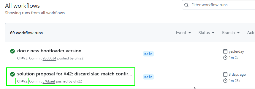

We have a confusion regarding the Clara version. On the github continuous integration page (on the "actions" tab) https://github.com/uhi22/ccs32clara/actions, there are the binaries available for each official version. The latest version is on the top of the list, with the highest run number. In this case, the #72 contains the fix:
In the "Artifacts" section of this run there are the zipped bin and hex files for flashing. After flashing, e.g. with STlink command line utility
ST-LINK_CLI -P stm32_canloader.hex -P CI_72.hex -V
the serial log of Clara should show the version:
This is Clara version 4=0.42.72.B
githubRunNumber 72
The 72 in the version and the githubRunNumber 72 are referring to the continuous integration build 72.

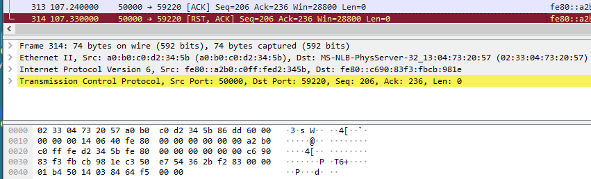

Clarified: The last two messages from the charger are just a TCP ack and reset:
This indicates that the charger does not want to further talk on this TCP connection (socket was closed).
So let's increase the TCP timeout and see how this improves the situation. Issue created: https://github.com/uhi22/ccs32clara/issues/43
[Edit] Done: https://github.com/uhi22/ccs32clara/com ... 21ef3d3ec4
