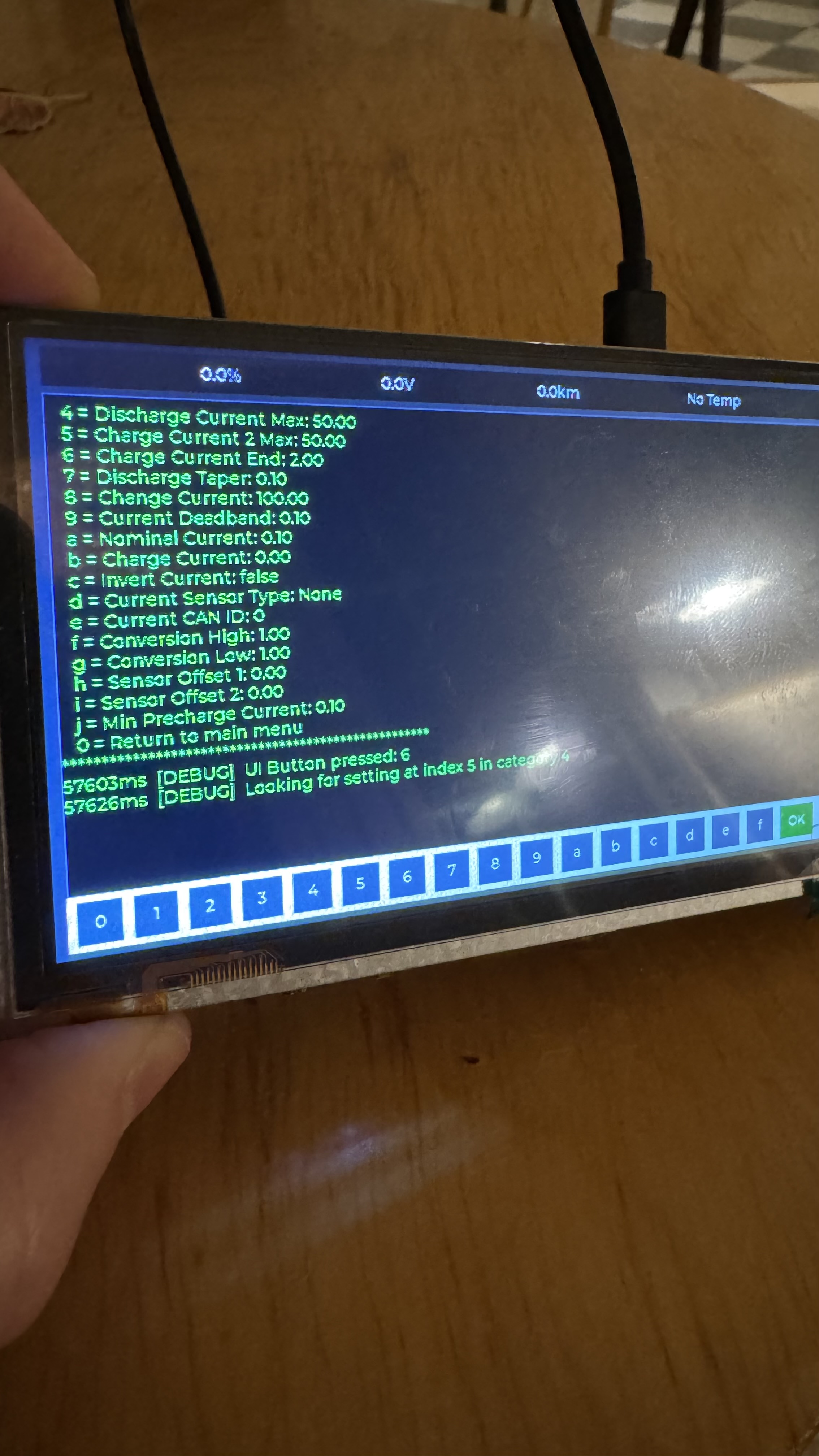

btw, sbox sees 60V too.
and when hitting capital A (close all contactors) it shows 90V
Battery Current: 15.00mA
Battery Voltage: 89.90V
Output Voltage: 60.10V
CAN 0x100 control byte: 86
Battery Current: 18.00mA
Output Voltage: 90.10V
CAN 0x100 control byte: AA

Re: [WIP] BMW E6 - 2002 Touring
When you have all the contactors shut what does it show there? If you are loosing 30V somewhere there is a high resistance and it would suggest the contactors are not great condition or some other resistance.mane2 wrote: ↑Sun Jul 21, 2024 7:37 pmCode: Select all
*************************************************************************************************** Battery Current: 13.00mA Battery Voltage: 89.90V Output Voltage: 0.23V CAN 0x100 control byte: 0 ***************************************************************************************************
Will have a quick look at the code.
Precharge... resistor doing something or some other loop through a measurement circuitmane2 wrote: ↑Sun Jul 21, 2024 7:44 pm btw, sbox sees 60V too.
and when hitting capital A (close all contactors) it shows 90VCode: Select all
*************************************************************************************************** Battery Current: 15.00mA Battery Voltage: 89.90V Output Voltage: 60.10V CAN 0x100 control byte: 86 ***************************************************************************************************
*************************************************************************************************** Battery Current: 18.00mA Battery Voltage: 89.90V Output Voltage: 90.10V CAN 0x100 control byte: AA ***************************************************************************************************
Mind measuring the resistances when commanding the different contactors.

Btw code from zombie is this:
you have a reported 0x86 which is not here
Yup so 0x86 is just precharge, which will cause leakage through HV measurement circuits, NOT a state you ever want to be in. Precharge never is the only one active.
switch (opmode)
case 0:
CCByte=0x00;//all contactors off
break;
case 2://Precharge
CCByte=0xA6;//Prech and Neg contactors activated
break;
case 1://Run
CCByte=0xAA;//All contactors activated
break;
case 4://Charge
break;
case 3://Precharge fail
break;
}Yup so 0x86 is just precharge, which will cause leakage through HV measurement circuits, NOT a state you ever want to be in. Precharge never is the only one active.
Yeah, I guess it leaks, but only when positive or precharge relay is enabled.
Test with 120V battery voltage:
But yeah, It seems to be okay if only using those commands that Zombie has. So on precharge do negative + precharge (0xA6) and once voltage is up, do all (0xAA)
I guess this is the case with others using sbox too? Just got me wondering if something is broken here, I guess not.
negative contactor active (0x62) = 0V
positive contactor active (0x0A) = 80V
precharge active (0x86) = 80V
positive and precharge (0x8A) = 80V
negative and precharge (0xA6) = 120V
all contactors activated (0xAA) = 120V
- Posts: 2962
- Has thanked: 328 times
- Been thanked: 847 times
Nothing is broken, you can break it if you do not use it correctly.
The box is designed to function as per Zombie code, doing anything else can break it.

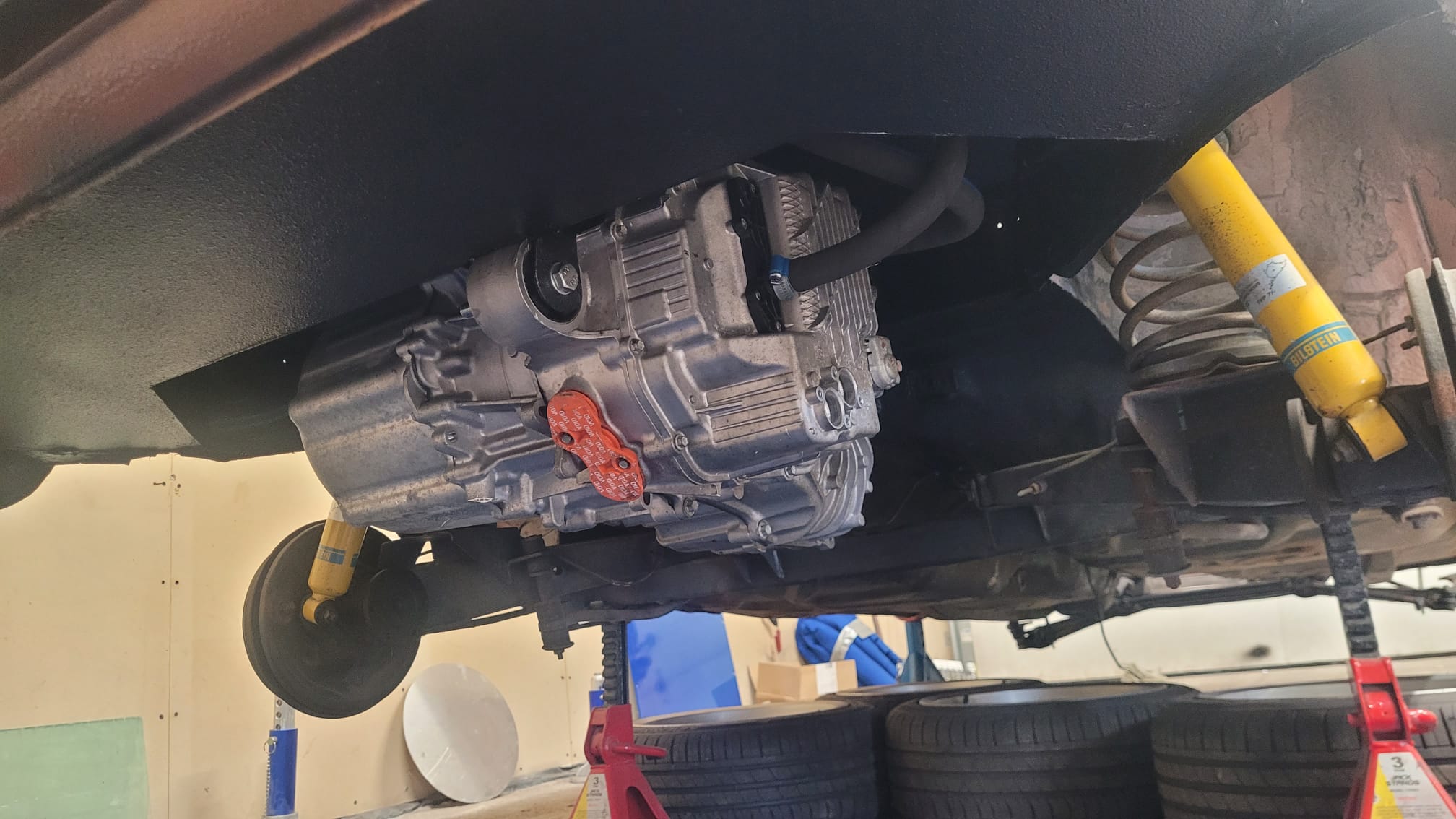

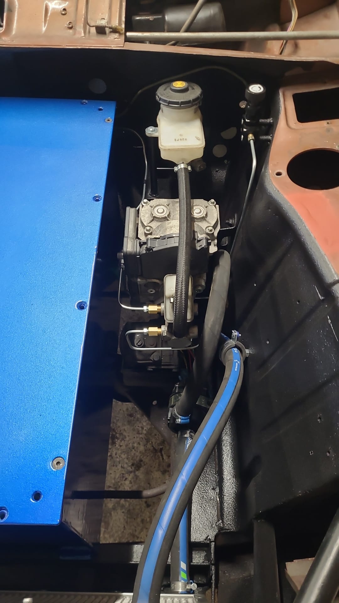

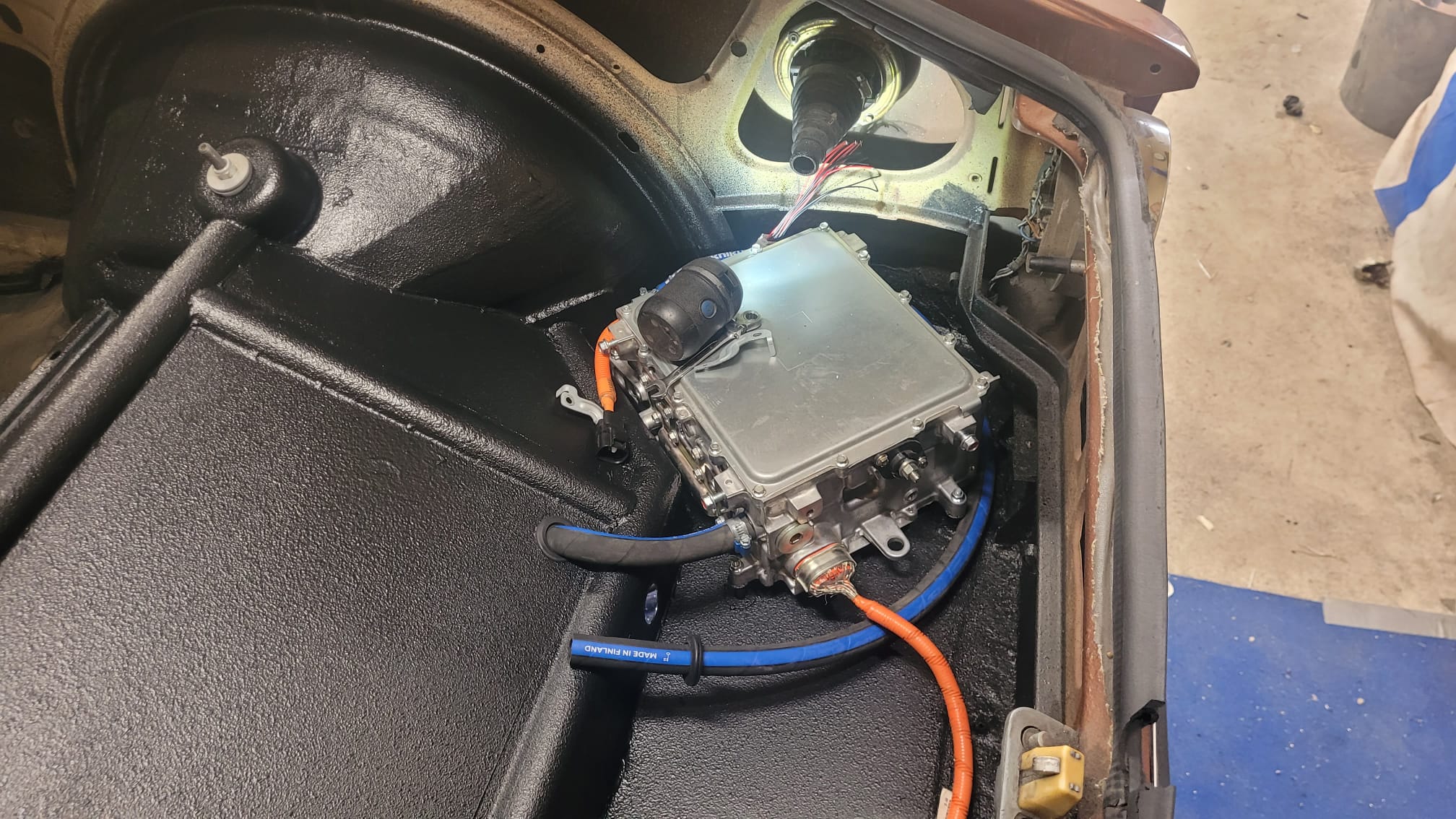

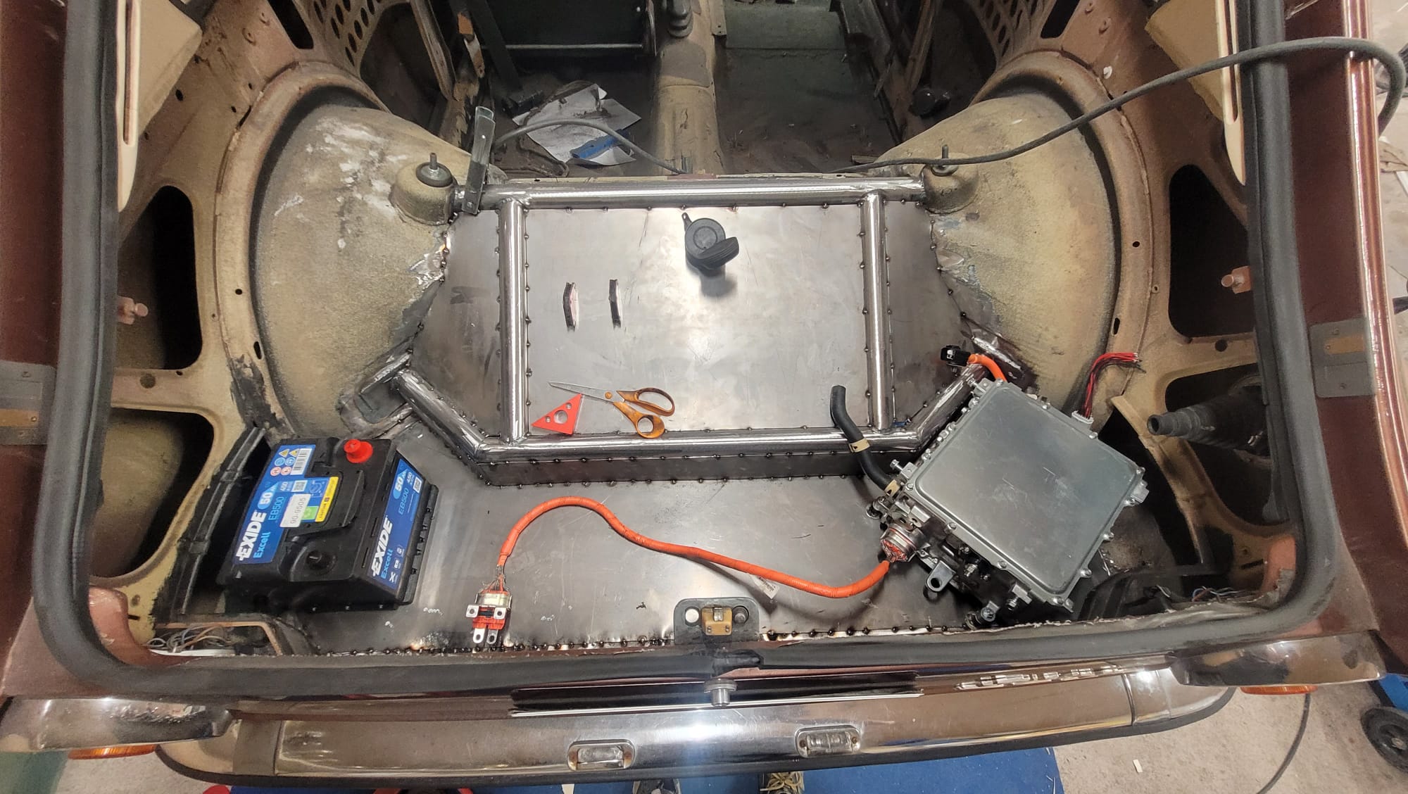

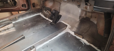

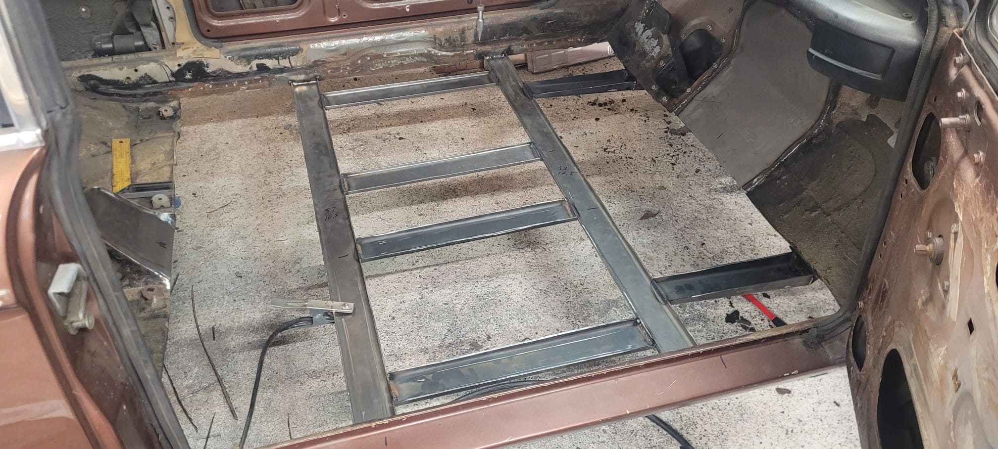

Progress update. New trunk floor with outlander charger and 12V battery in place. Motor mounts done and cooling. Radiator, pump and hoses done. Batterybox almost done and painted, just missing data cable connector. Remote reservoir for iBooster. Brake balance/proportioning valve installed for rear drums as well as new brake lines. Testing out e-ink display for showing state of charge, range and other things. Bought VW Golf mk3 GTI seats to replace those big sofas. 3d-printed plastic rollers to rear trunk lid shock arms. Epoxy + raptor paint for new metal parts. Front struts modified to have level adjustability. New coils to front.

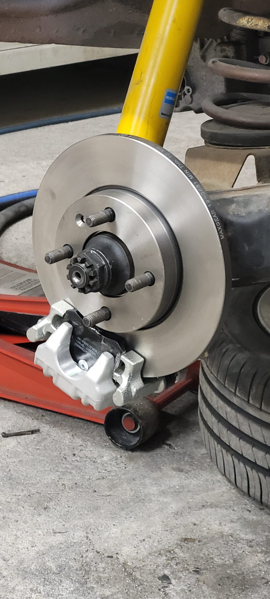

Next week:
- install small E21 front hubs (to allow vented rotors)
- install E21 323i vented rotors
- install Volvo 240 calipers and pads (only ones that fits factory BMW 2002 strut mount with those vented rotors)
- finish brake lines and bleed the system
Week after that:
- Take the car to painter to install 2002 Turbo fender flares.
Originally I was thinking of not having those turbo fender flares, but as front wheel well is so shallow, wheel would hit the fender lip with these rims or the car would have to sit very high - which just looks bad. Rims would have to be 6" with 175mm ET30 tire to go inside the wheel well. Those kind of 4x100 rims are very hard/impossible to find with nice styling. So need to do the turbo-mod.
Next week:

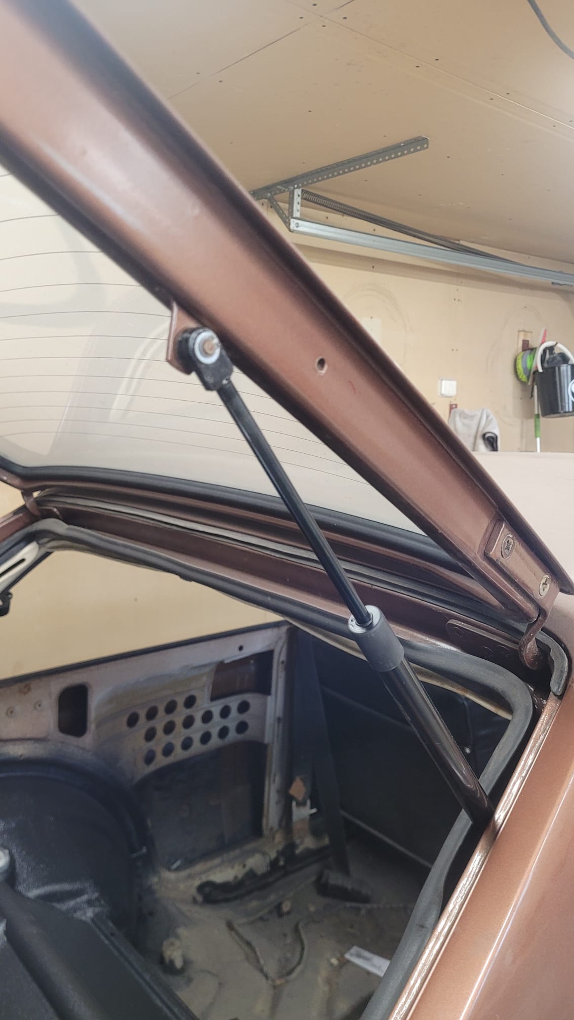

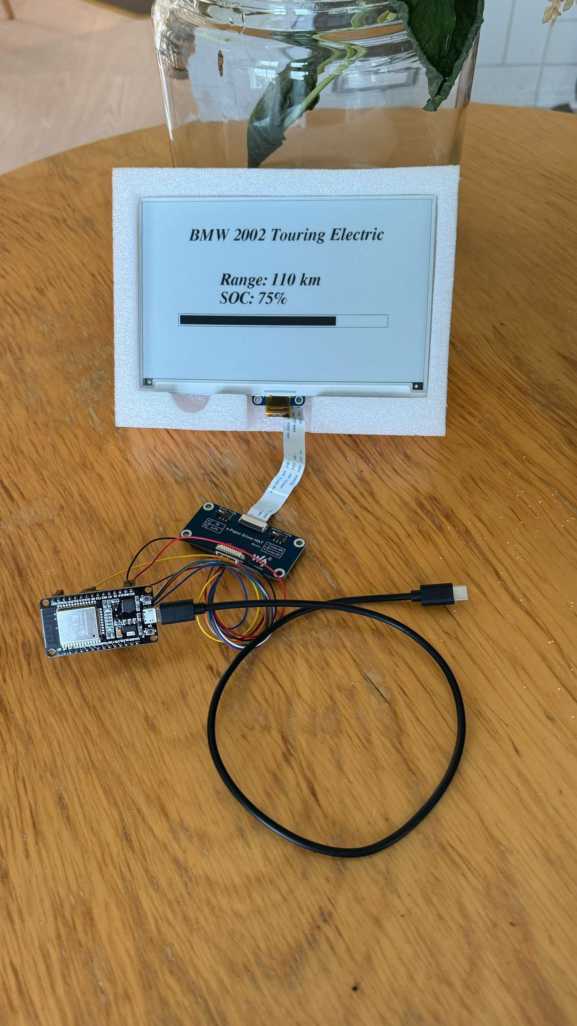

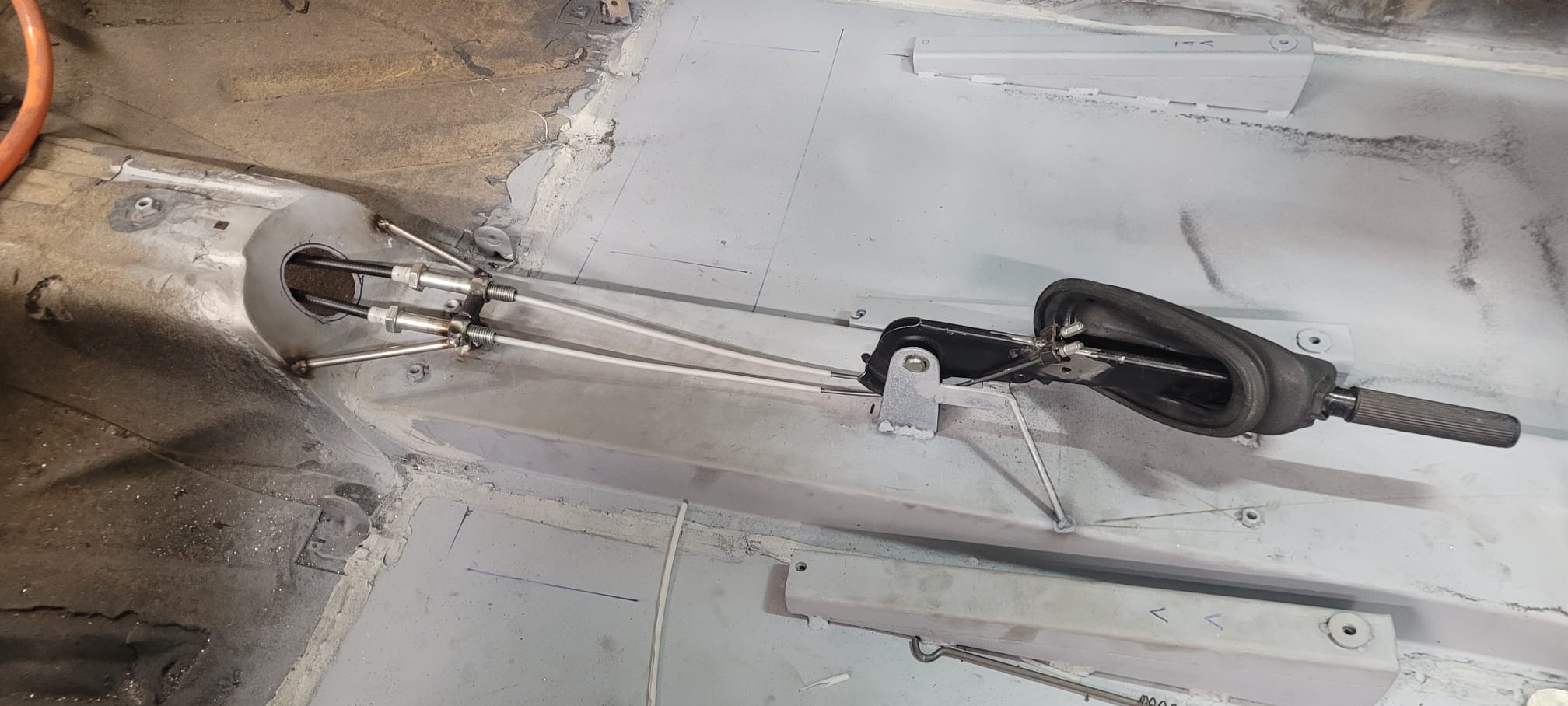

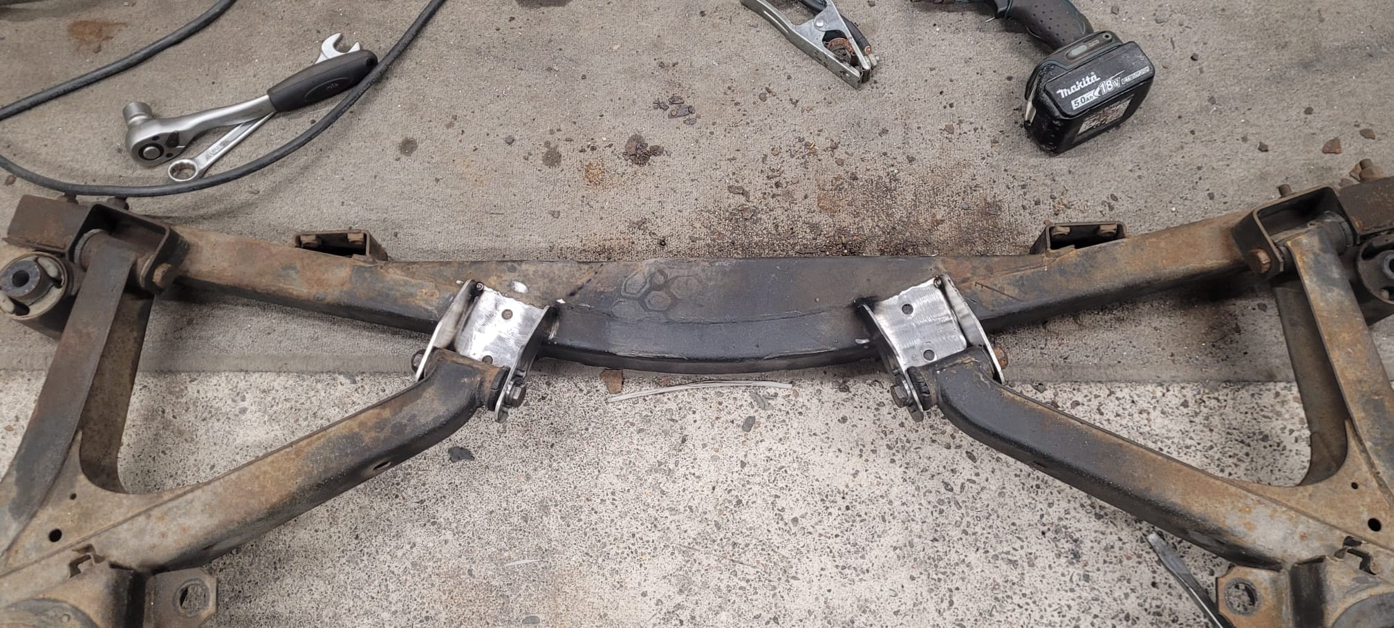

Lots of progress during past month.

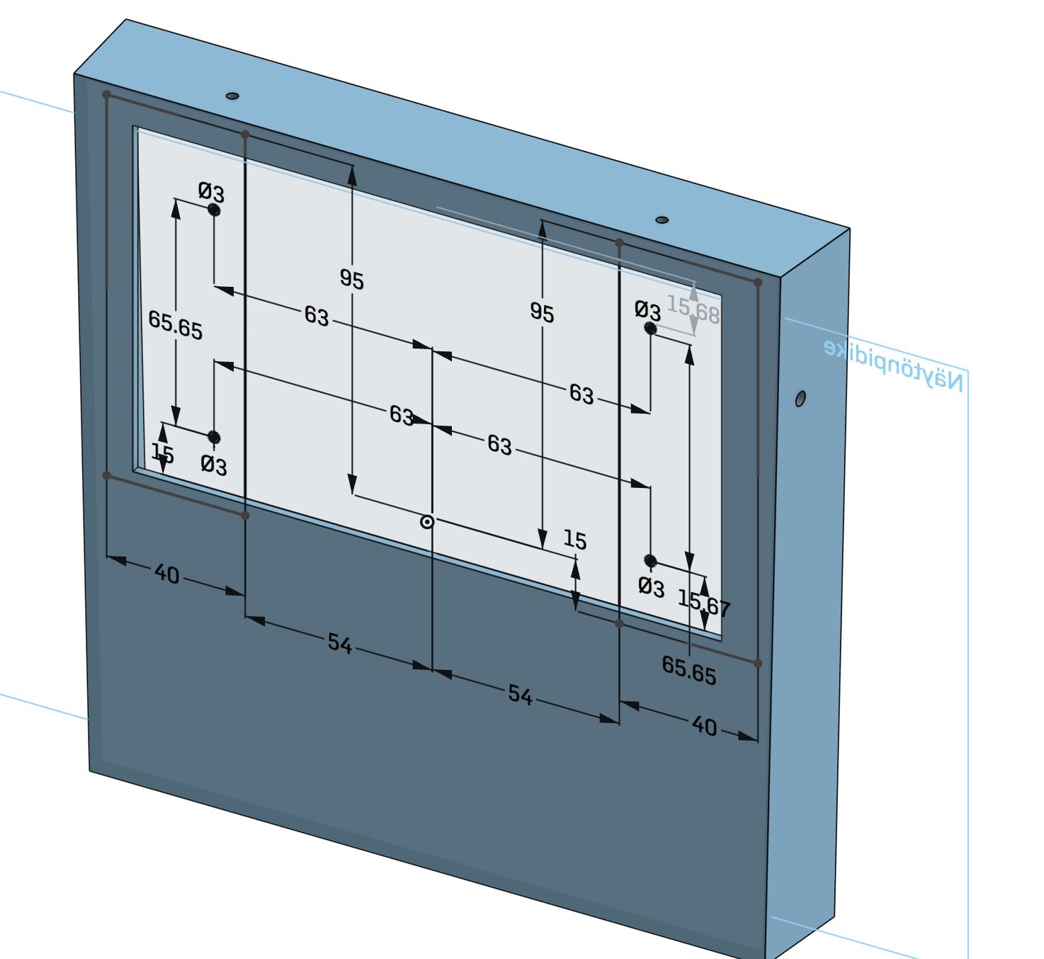

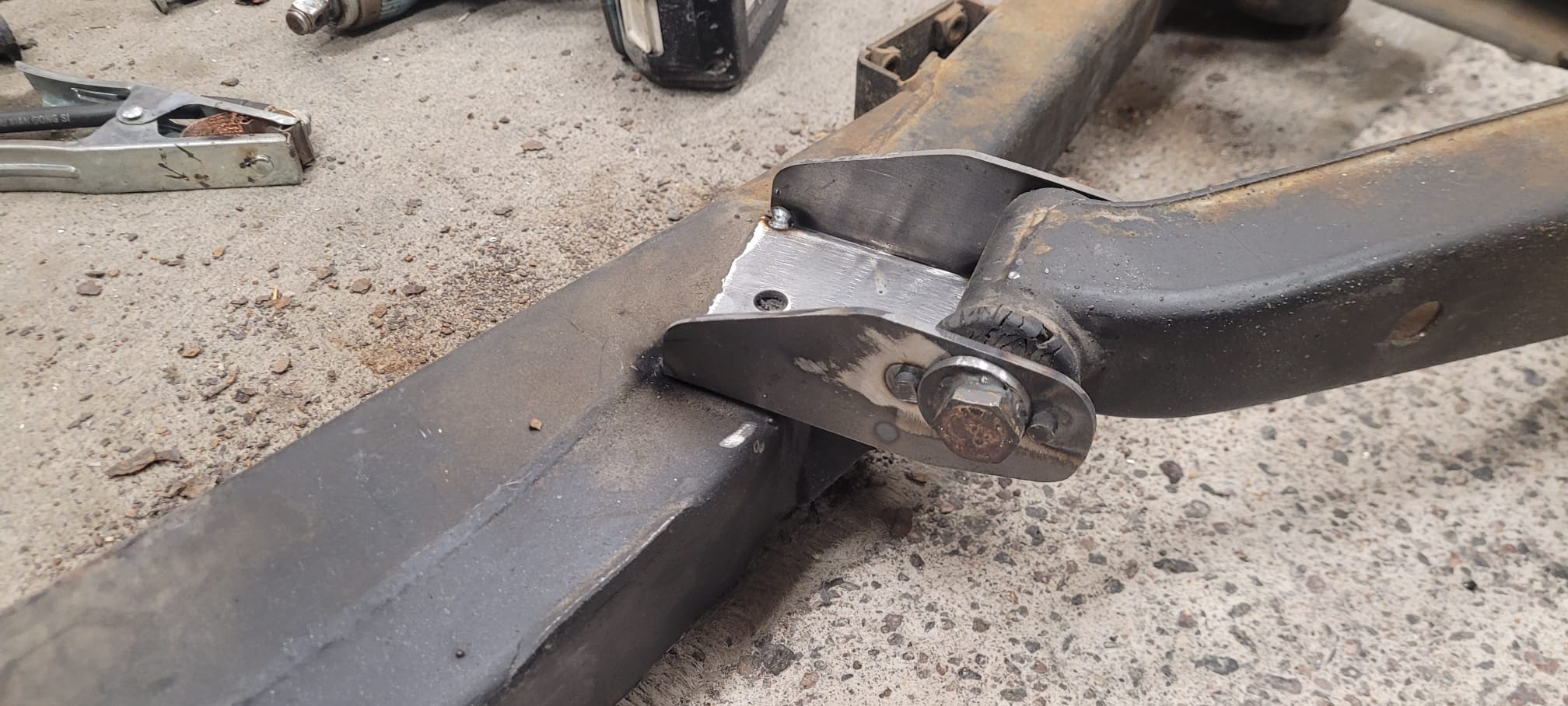

Desinged a frame for esp32 display (lvgl, can, esp, touch display) Original plan to have Golf GTI seats did not happen, as seller couldn't find the seats. So plan B, BMW 2-series (G42) alcantara sport seats. This simple seat replacement accumulated way bigger project, as original seats sit high on top of transmission tunnel but new seats need to go to bottom. So first the tunnel was cut a bit, then bit more.. until we realized that they don't sit straight in front of steering wheel.. So need to cut more.. and eventually, whole floor was completely removed and made a new one to make the seats align and sit low enough properly
Rear drums also gave a headache, as they we party stuck and adjustment screw was so round and stuck that it was not revivable. New turbo drum brakes from Walloth & Nesch was around 1000 euros.. So started looking for alternatives. 2002 forums blog post suggested using VW Golf MK1 front rotors, MKIV calipers, Golf carrier and custom brackets. So went with that.
As floor was removed and rear brakes upgraded, some new handbrake wiring was required. As car sit lower, rear camber was way off. So new plates were done to allow camber and toe adjustment. Next up is revamping the rear shocks, plan is to replace separate coil and damper with coilovers.

jrbe
- Posts: 766
- Has thanked: 360 times
- Been thanked: 249 times
Nice work!
Just watch out for welding the bolts with the eccentrics, it changes the bolt hardeneing / strength. You might be able to find some that have the eccentric as part of it or the many keyed styles OEM's use like the D shape, pin, etc.

Thanks! This project was supposed to be much more like that in the beginning, but as my friend happened to have time to help with metal and mechanical work, things got out of hand and become full professional. Once the car gets painted and I get it back to my garage the professionalism goes out from the door

Thanks. I think the idea was to find the correct position with that and weld it fixed.

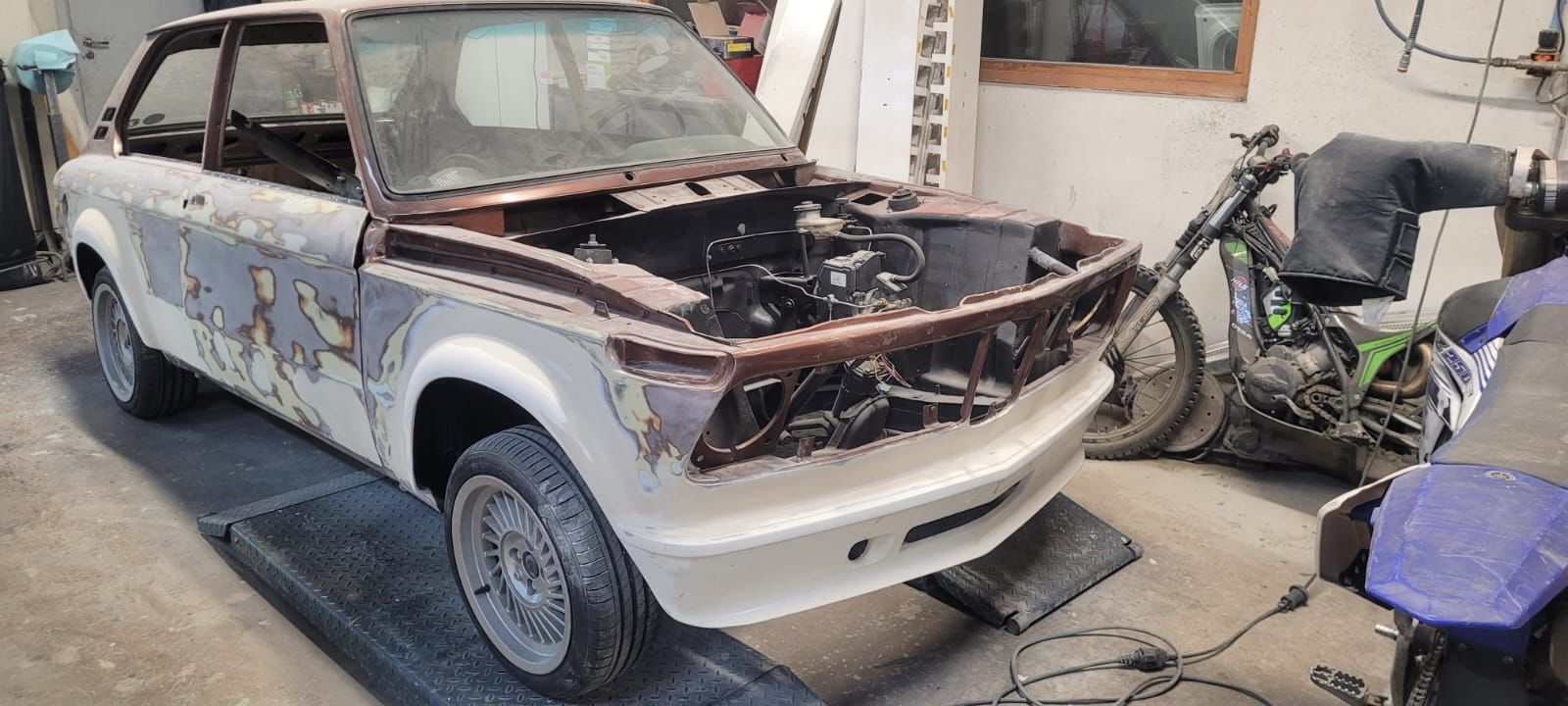

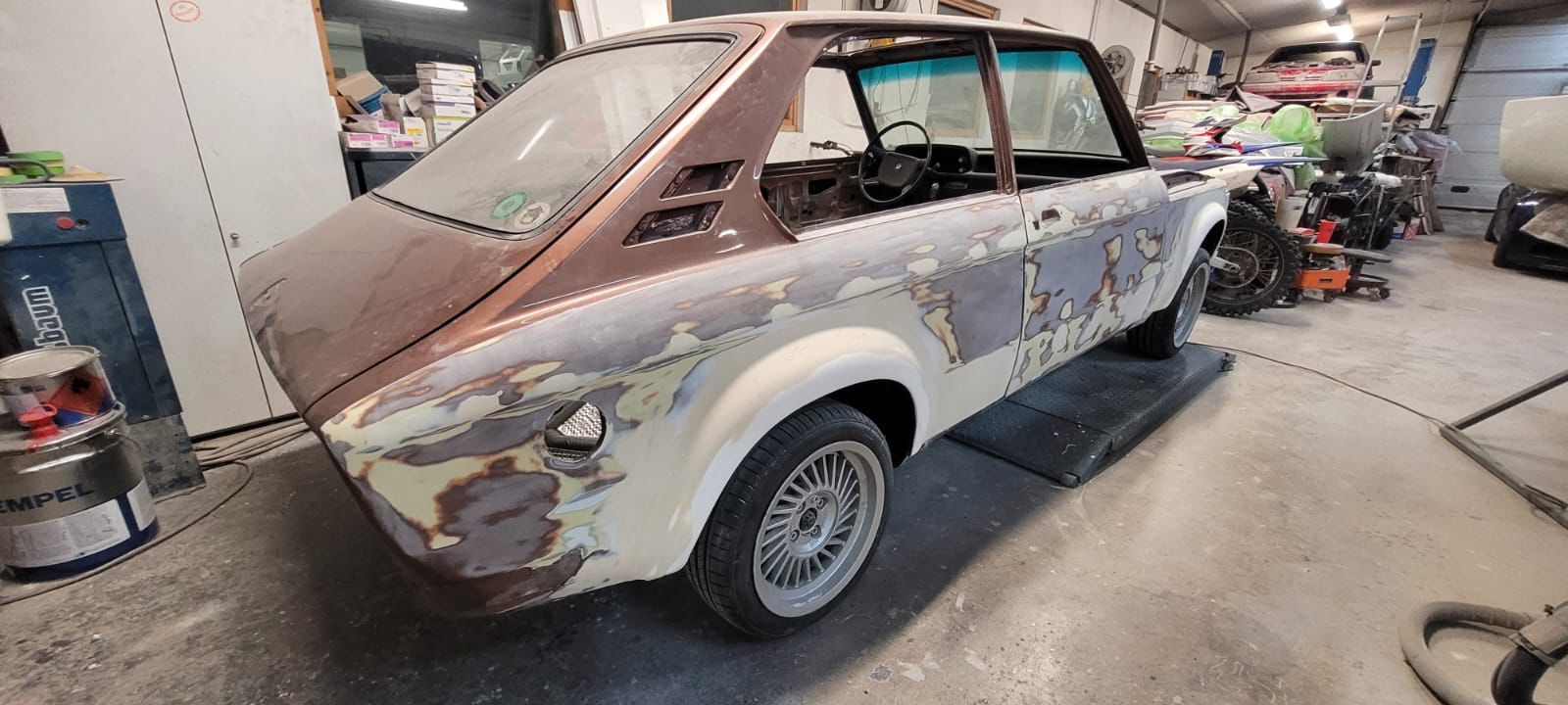

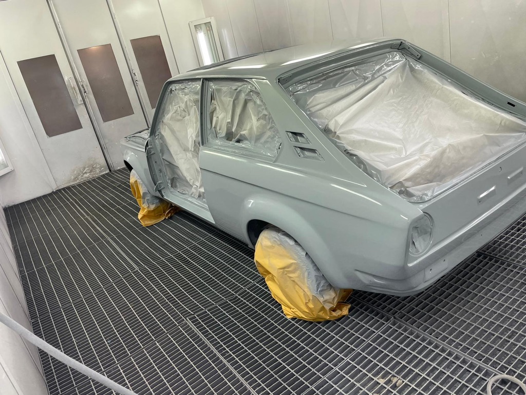

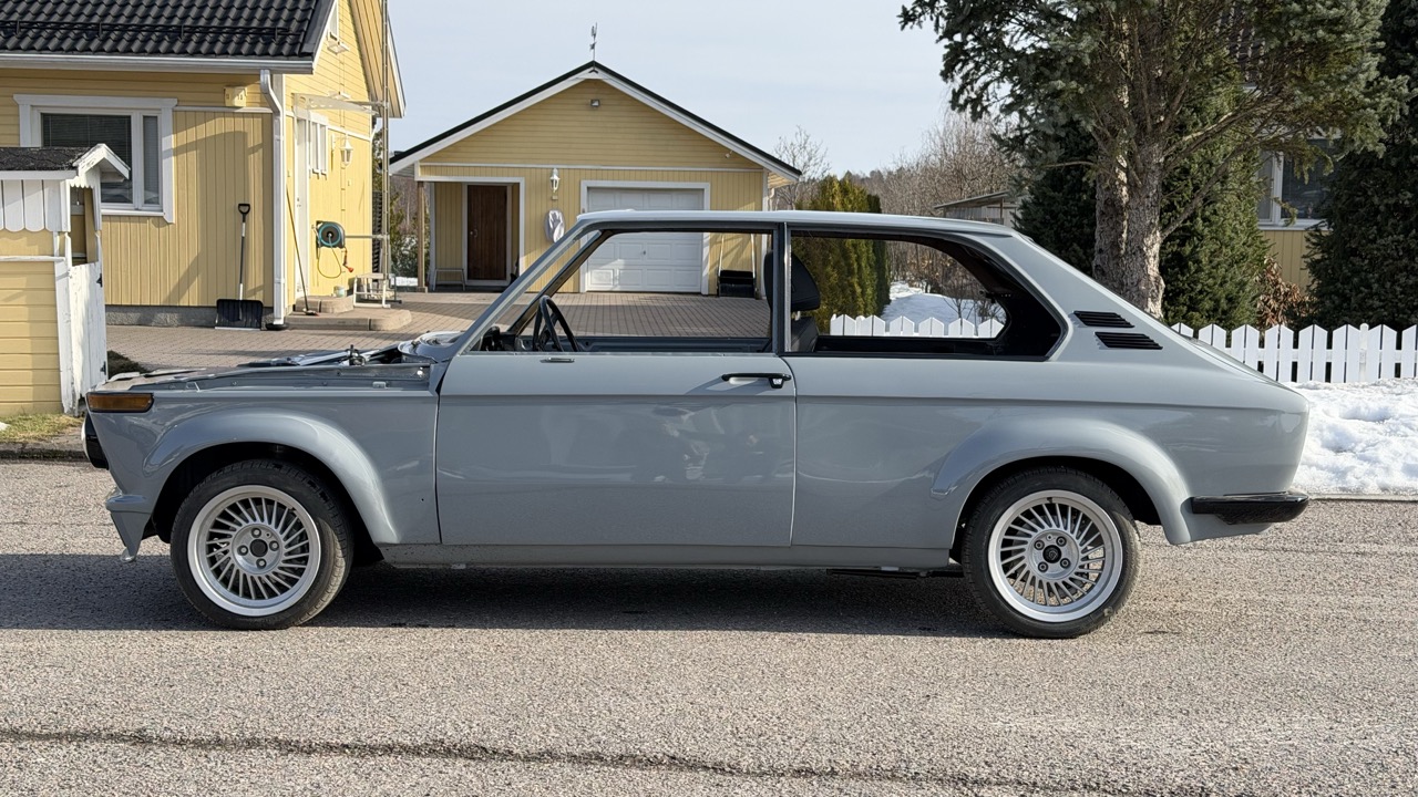

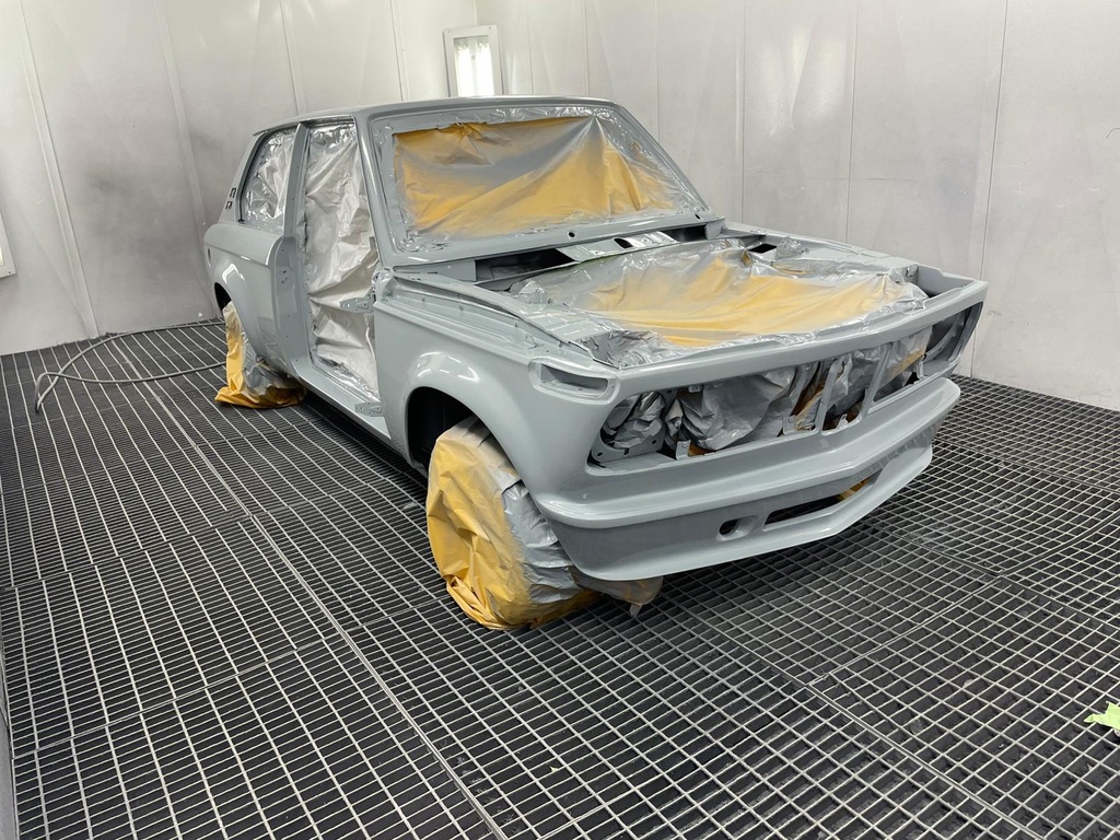

Update from the paintshop. Turbo flares and front lip installed. Prepping for the paint.

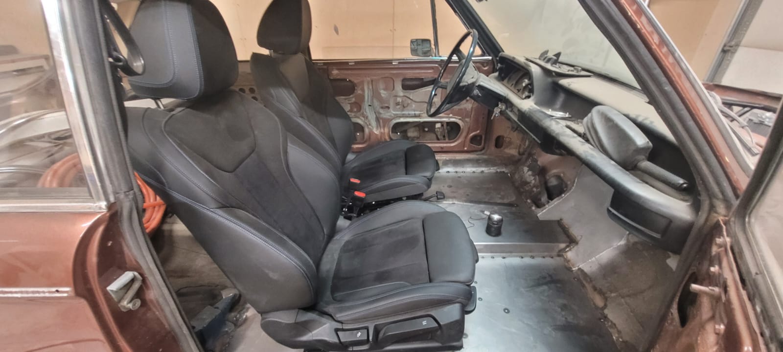

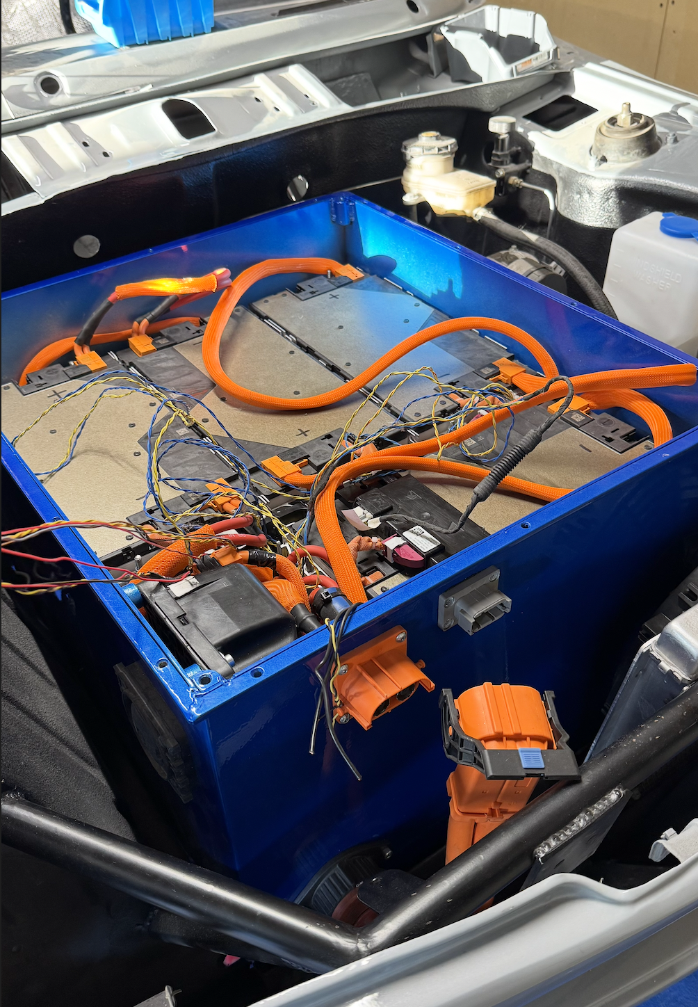

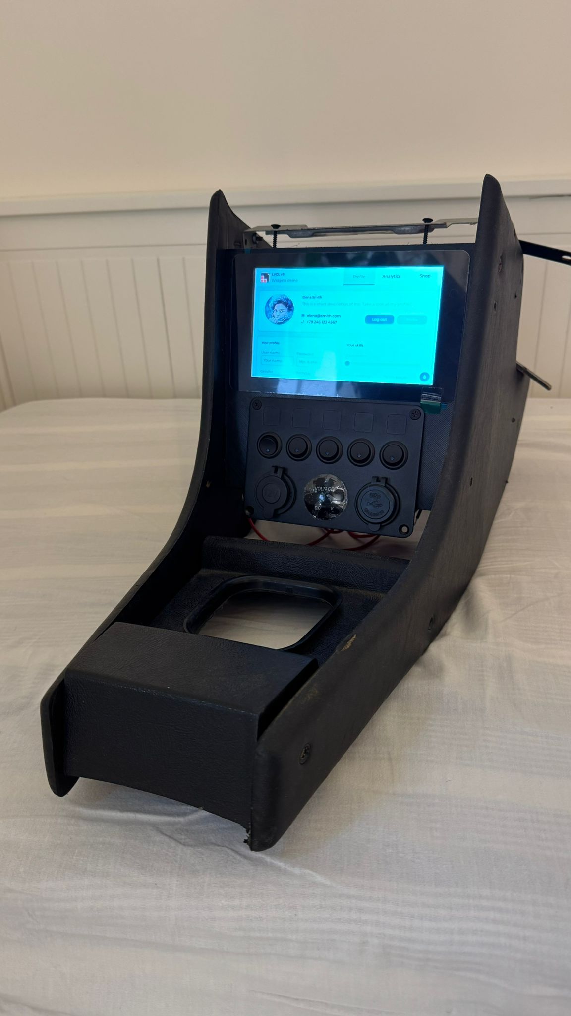

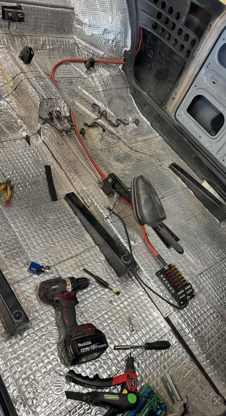

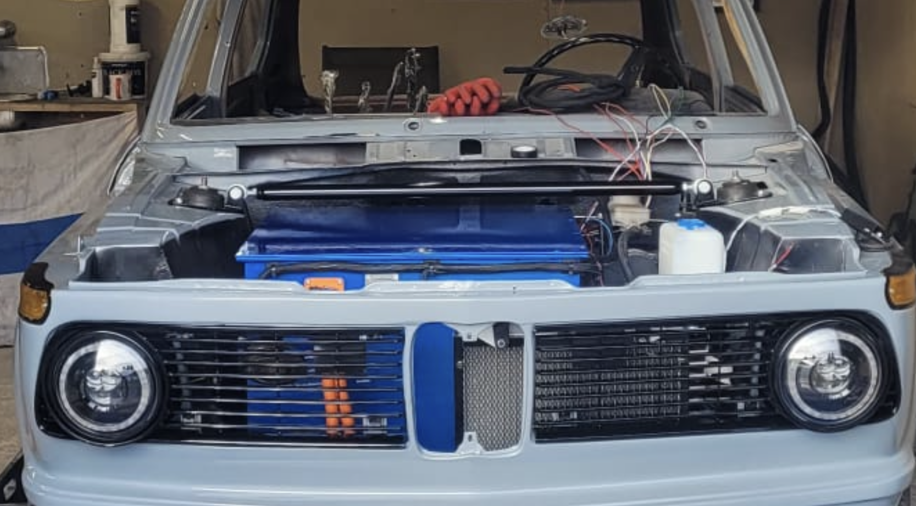

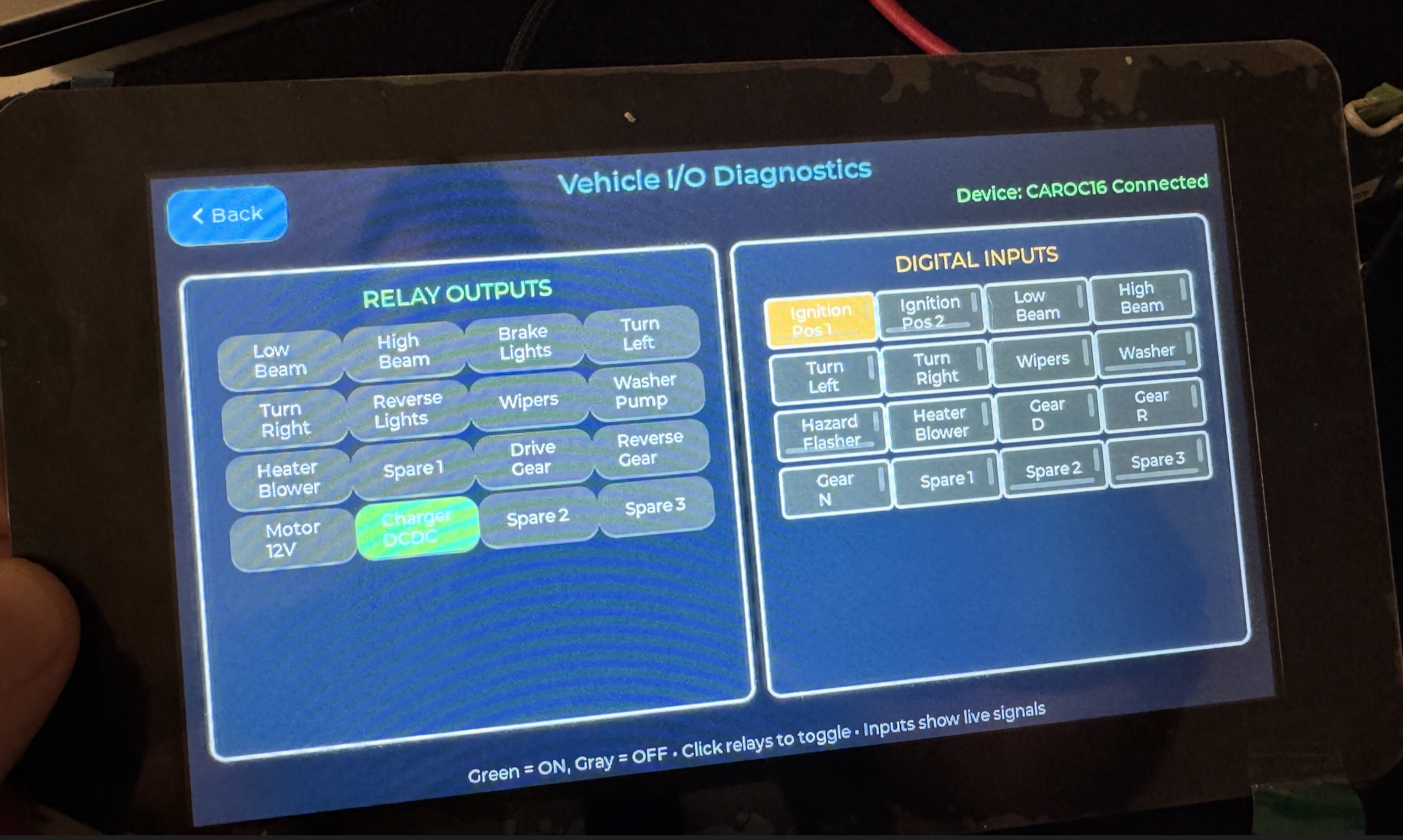

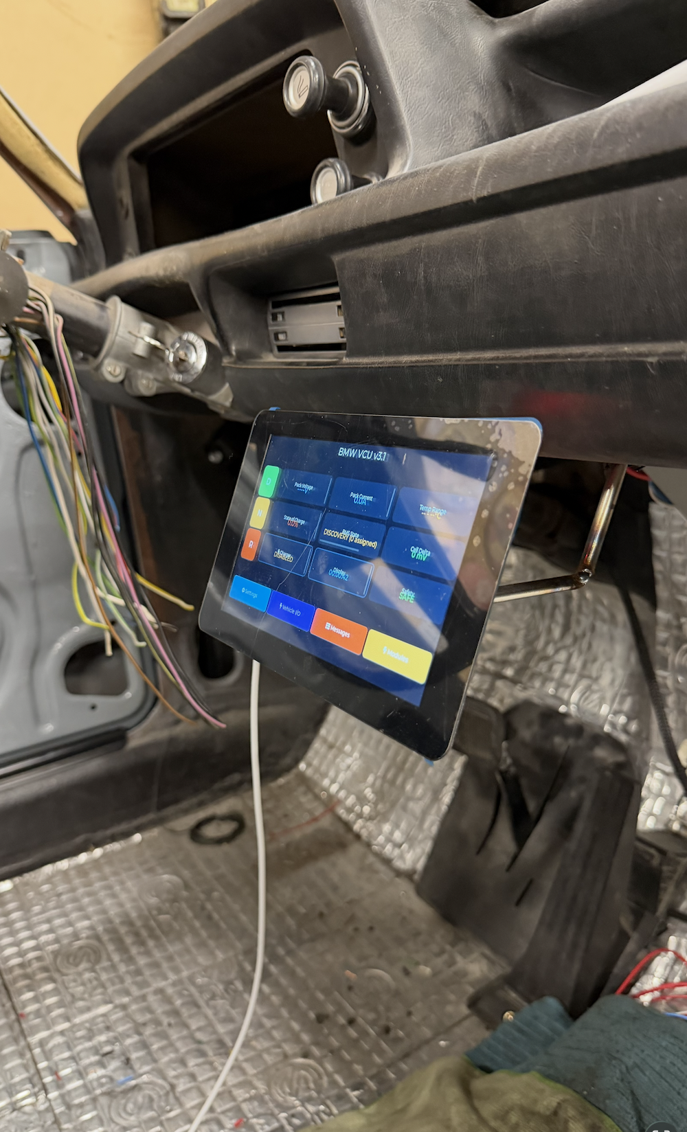

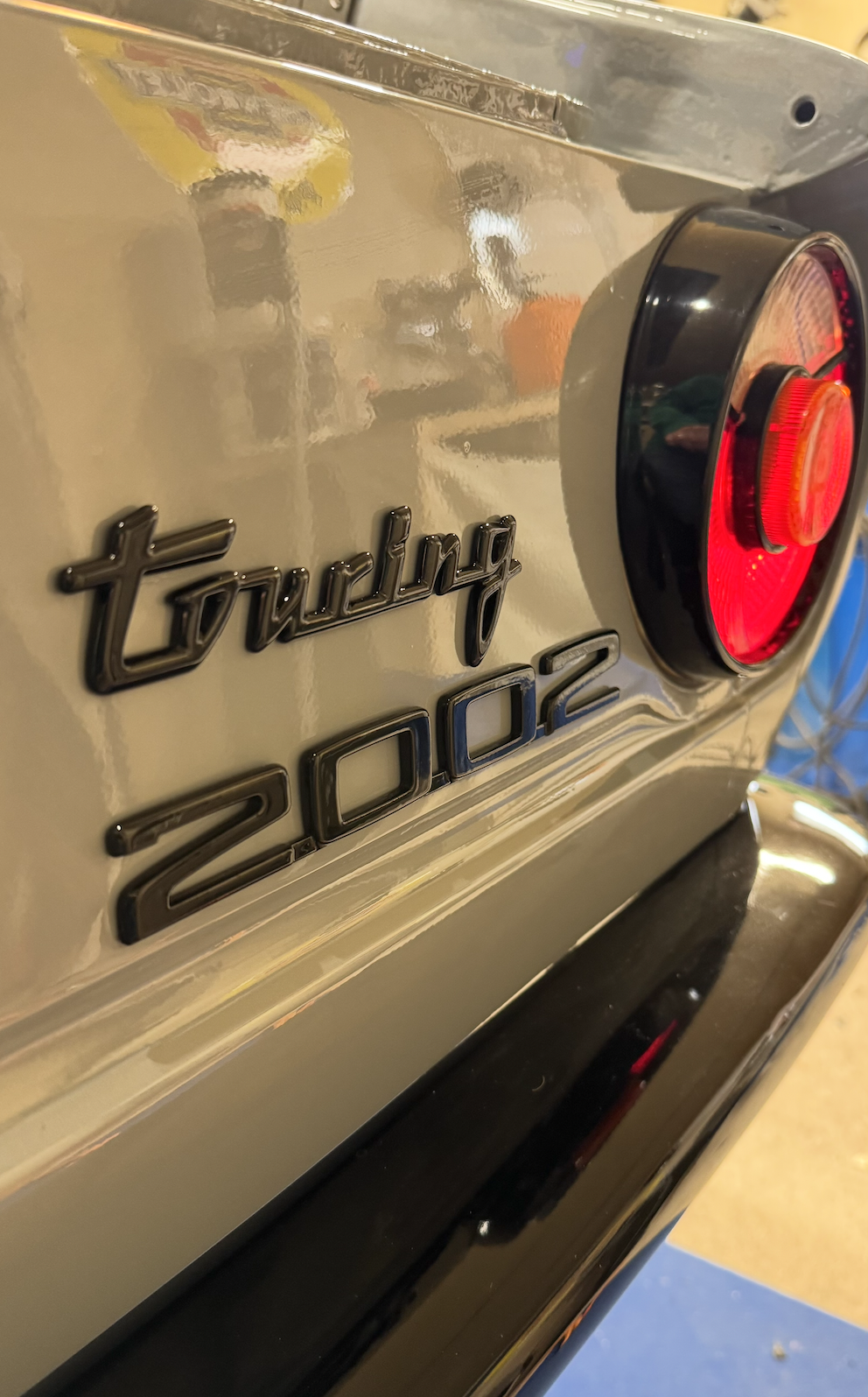

Lot has happened since my last update.
Car got it's final color on June. Color is Brookly Gray from modern BMWs.

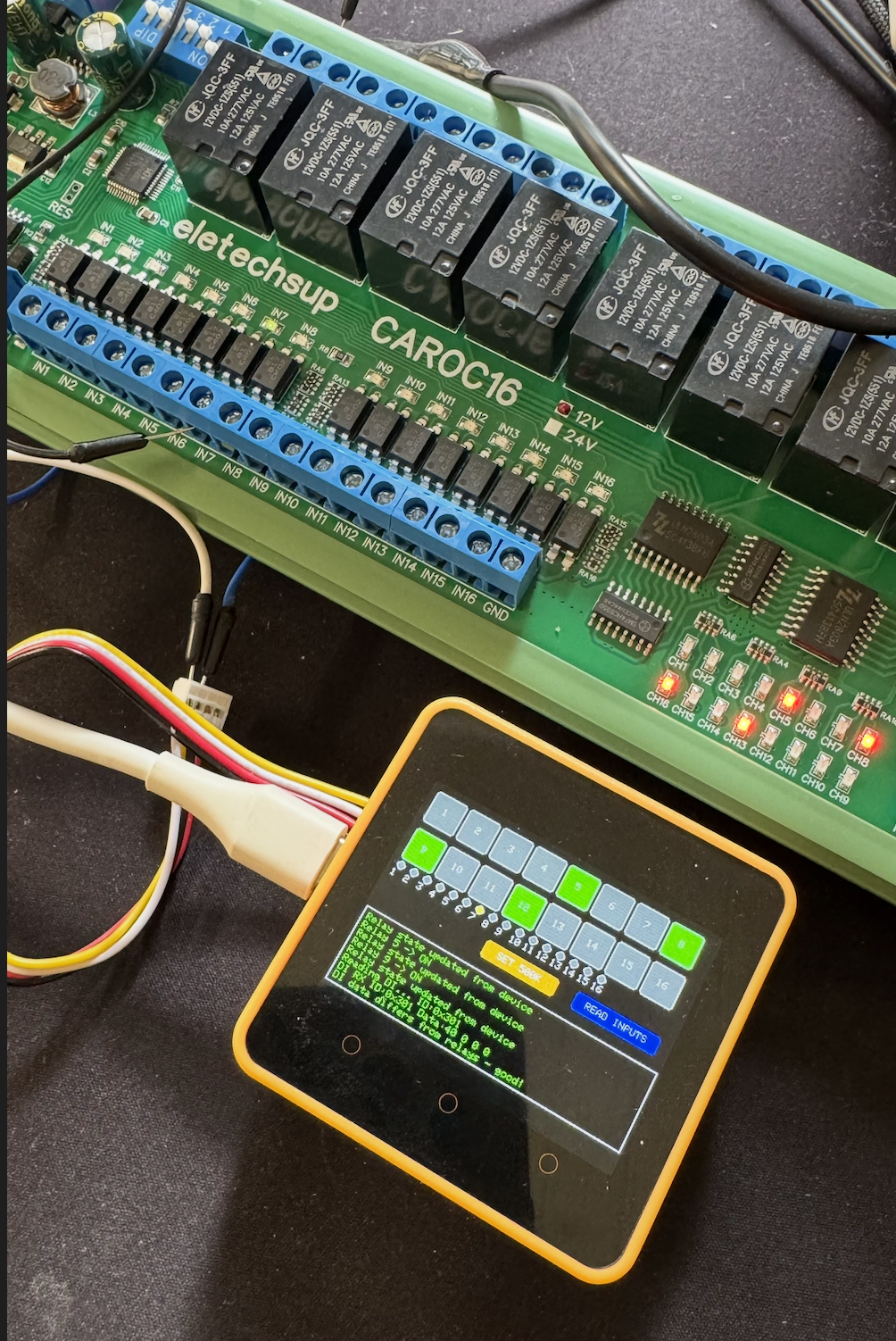

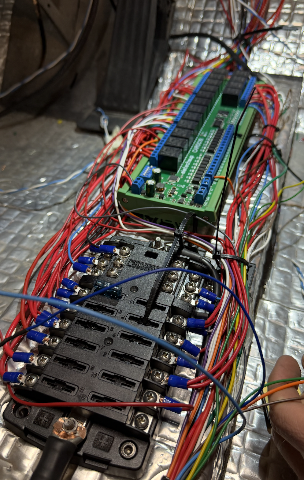

Worked on setting up the relay board to talk to can and control it with diy VCU/BMS.
Some noise insulation, 12V wiring
Installing batterybox and X5 batteries
Badges and rear lights

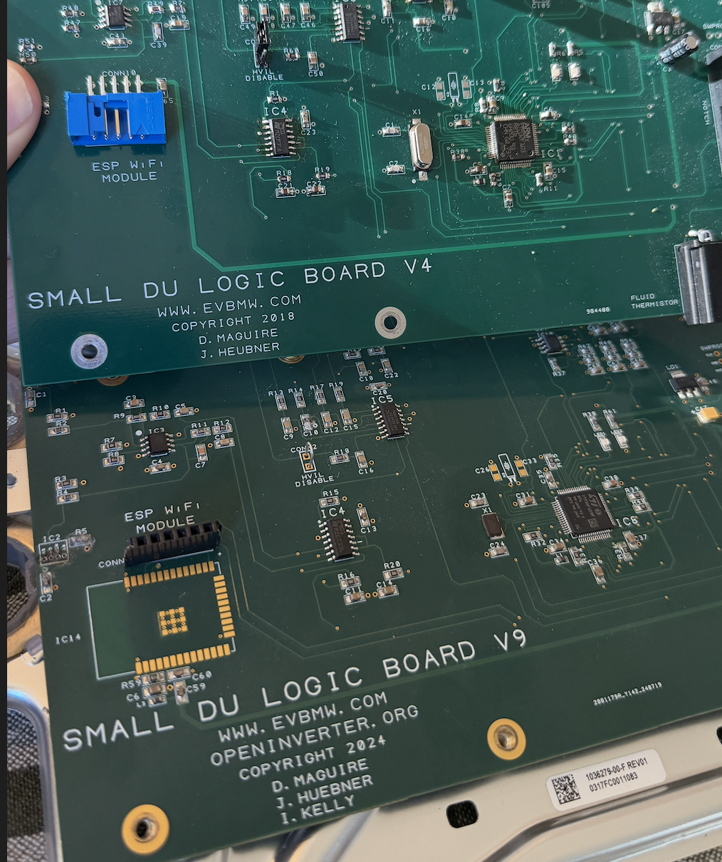

Realized that I had burnt my old SDU board. Desoldering and removing current sensors was not succesfull
New board to the rescue and ordered new current sensors from mouser
First test, wheels spinning! (Can't attach video)
12V wiring
Center screen (vcu/bms) supports and testing

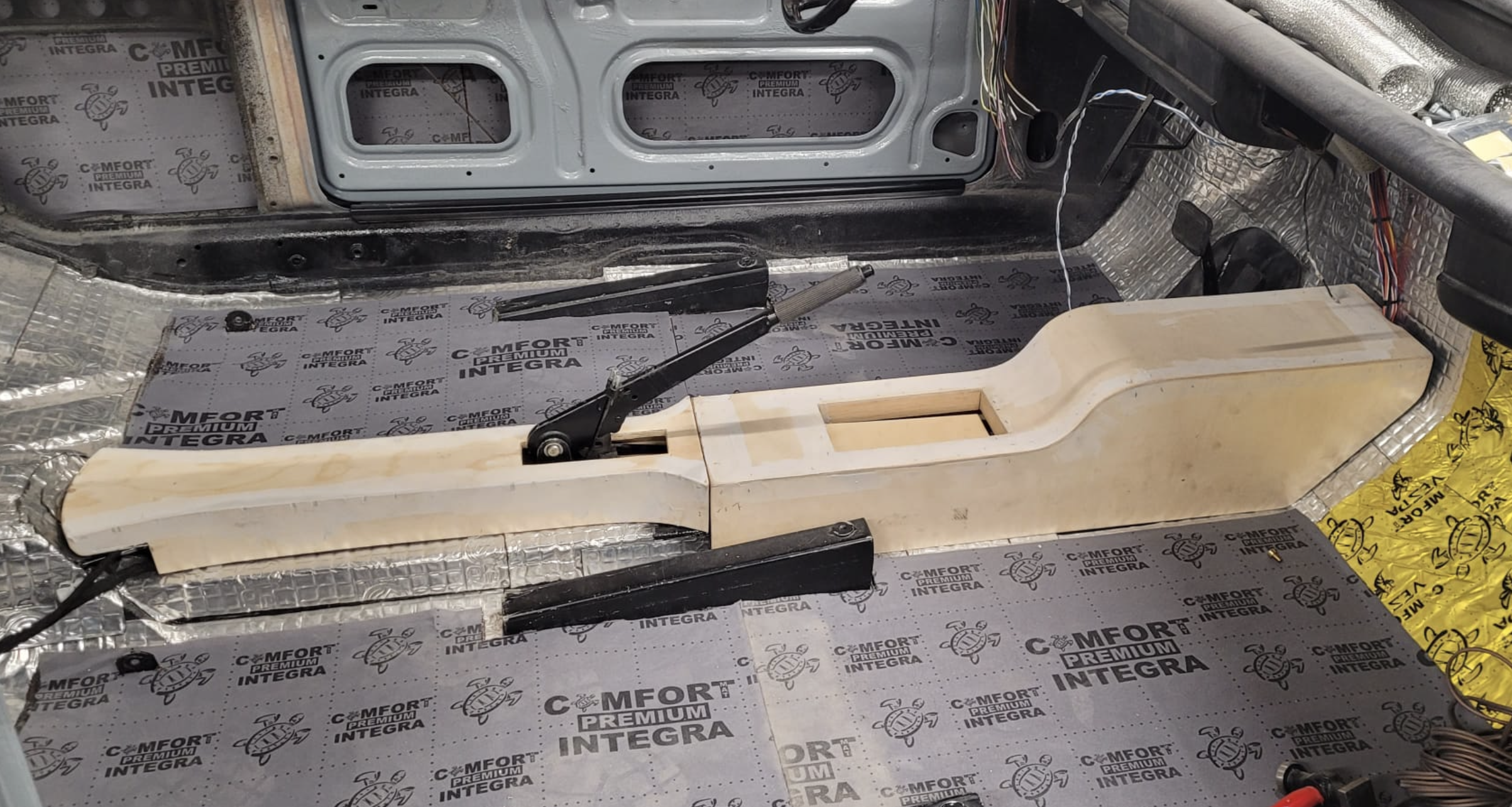

More insulation materials and custom center console
Strut bar, painted grills, new headlights, painted blinker frames
And some other progress
- Seat belts installed
- Rear HV Junction box, charger wired, amplifiers, subwoofer, trunk flooring
- Door sensors
- Instrument cluster displays (3x ESP32-S3 round displays)
For the looks, some changes are still to be done, like all springs need to be swapped to shorter ones, rear tires wider to fill the wheel well.
Some next steps:
- install door & window & hatch seals
- door windows
- central locking
- install speakers to front doors and dash
- testing 12V wiring and systems
- Charger setup (outlander charger)
- iBooster setup for reading brake pressure from CAN and triggering brake switch to motor from that
- carpets and interior, interior lights

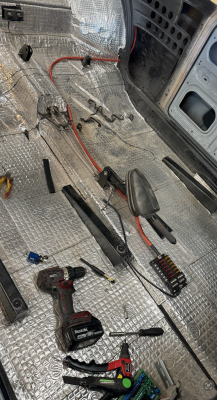

12V wiring
- Door sensors
Some next steps:
- door windows
- central locking

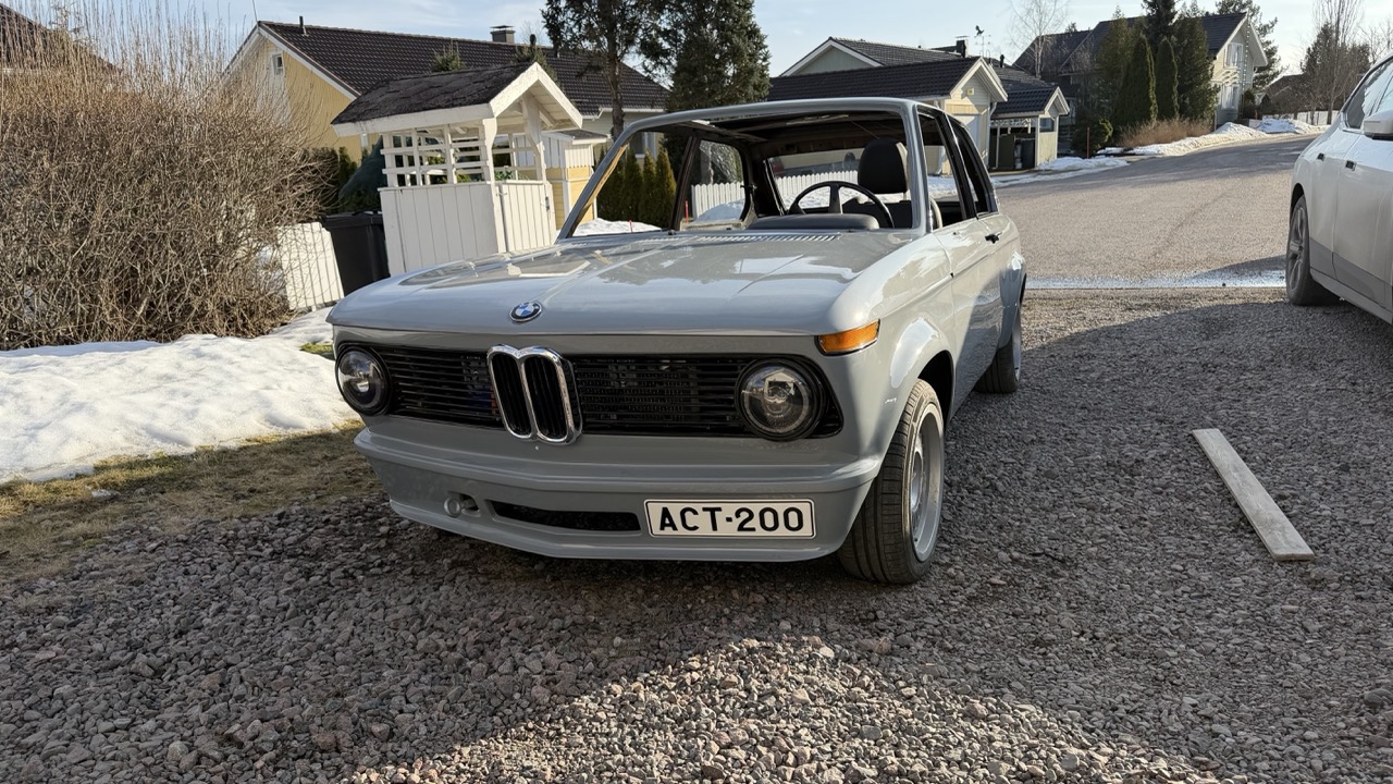

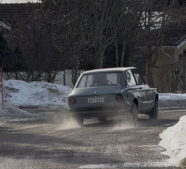

Re: [FIRST DRIVE] BMW E6 - 2002 Touring
First drive yesterday!
It drives very well and SDU seems to be kicking nicely with X5 battery. LSD doing it's work in picture where both wheels skid.
It's light and analog in feel, fun to drive.
Some stuff still missing
- correct height springs
- spacers for wheels
- some windows and seats
- carpets and interior stuff
- Configuring BMS
- enable DCDC + AC charging setup
- Configuring BMS
