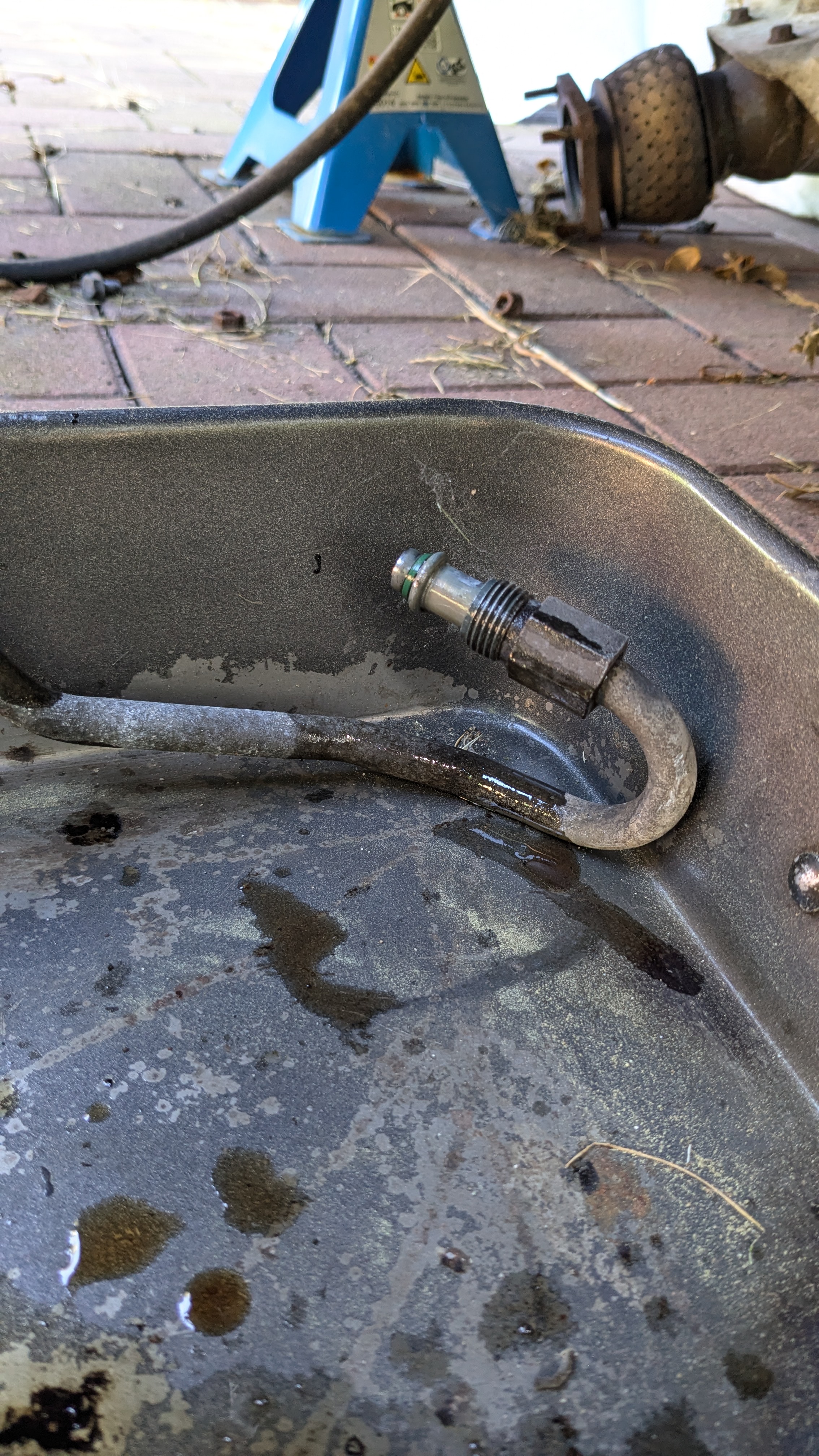

Next, I was finally able to remove the clutch master cylinder (I found an 8mm plug made from Nylon, which is resistant to brake fluid).
The clutch master cylinder leaves behind a hole which has to be covered, so I designed a small plate, which will be 3D printed tomorrow and plasma cut from steel next week.
The stud you see in the picture also holds part of the pedal bracketry, so I don't want to rely on plastic for an important job like that.
Volvo had the so called "cover washer" for automatic cars, but it's no longer available and I'm not so keen on trying to find one on a scrap yard.
The finished cover will be published on Printables as usual.

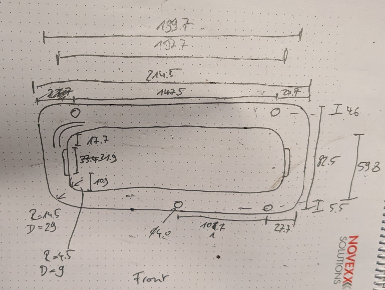

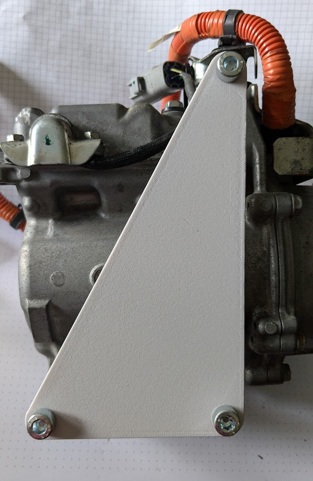

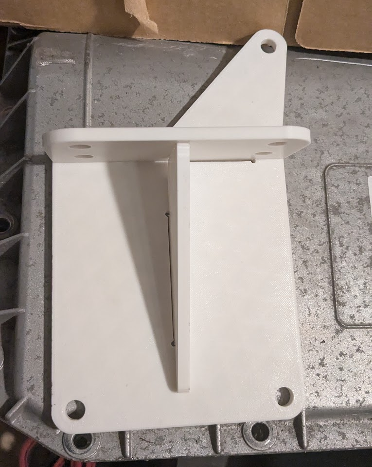

The next big thing is power steering, which I finally began to make progress. The bracket sits on the left frame rail where the air box bracket used to sit. This is a convenient place close to the battery and adventageous for hose routing (at least I thought that).
Getting all the dimensions right took more than one try, but I don't want to go into toooo many details here. The process was pretty similar to the vacuum pump bracket design.

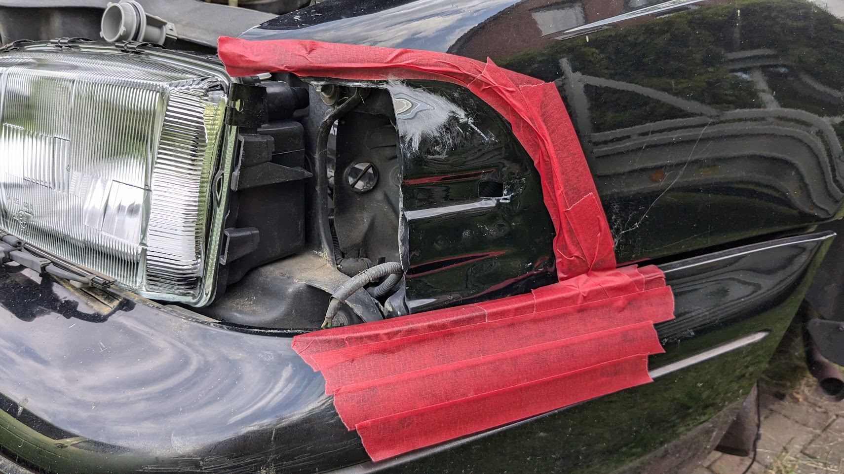

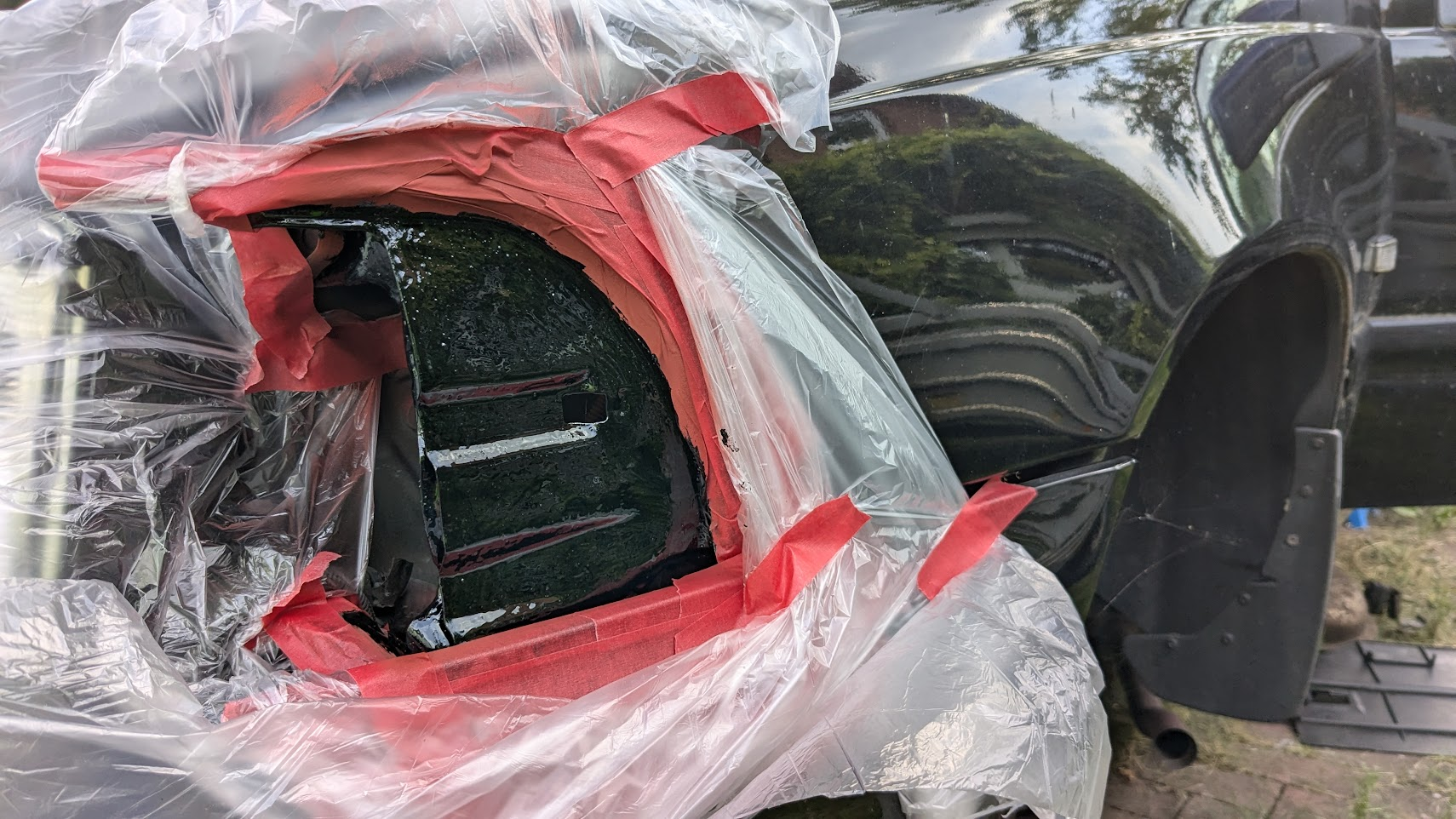

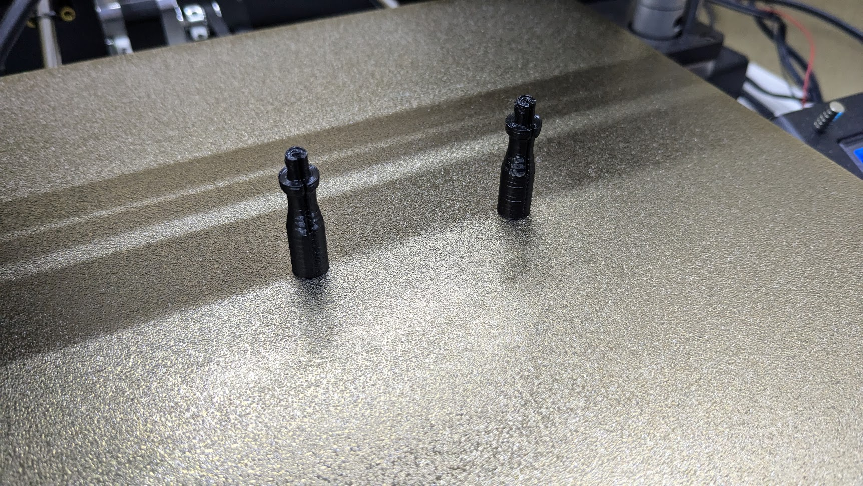

Then I wanted to install the door side marker light in the drivers side door... which led to another (unplanned) project. The silicone seals just crumbled away when I tried to insert the connector:
So of course I had to fire up Fusion 360 and design a replacement. The first prototype, printed from PLA, fit perfectly so I printed the final version in TPU.
The seals have a split, so they can be installed on the bullet connector without undoing the crimp. The split is then glued together with CA glue:

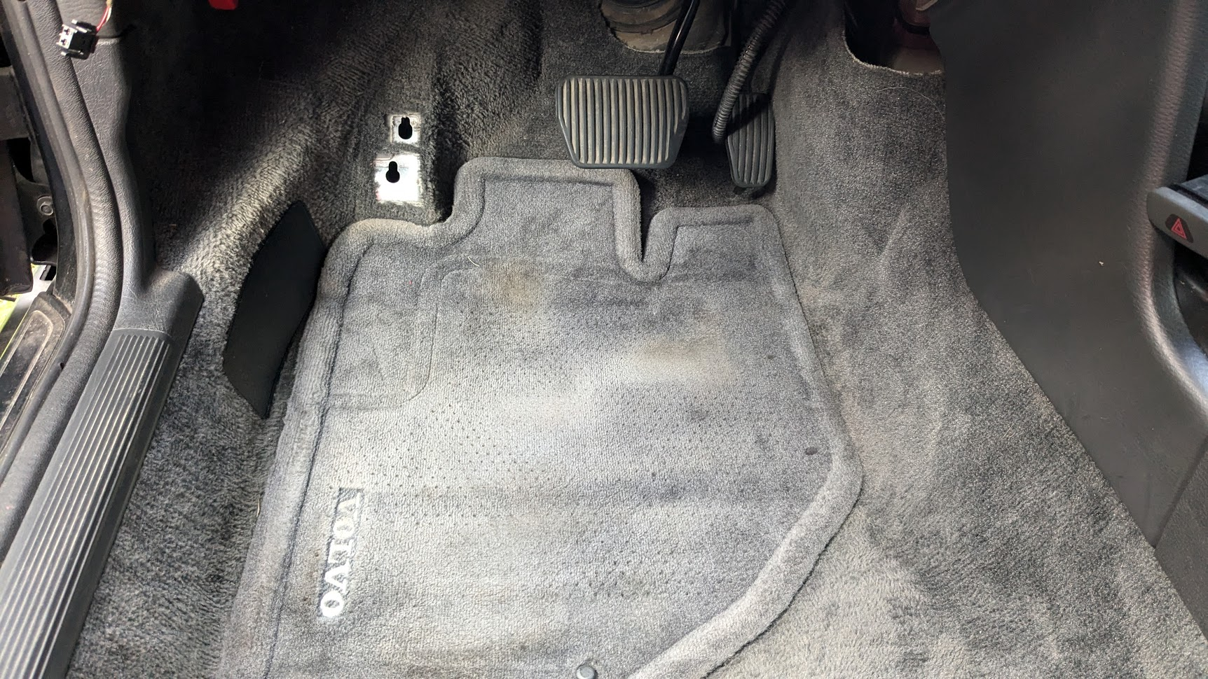

In the true spirit of "don't get it running, get it right!" I wanted to complete the work on the carpet.
As you know, the carpet on the drivers side of my V70 had a hole worn through it (I still don't really know how or why, but I bought it like that).
Since carpetry is not really my strength, it took some time to figure out a solution that is in the realm of my capabilities. So first we start with a pattern:
This pattern is then made into a 2D sketch in Fusion. Furtunately it is really easy to import an image as a background, so that was quick work:

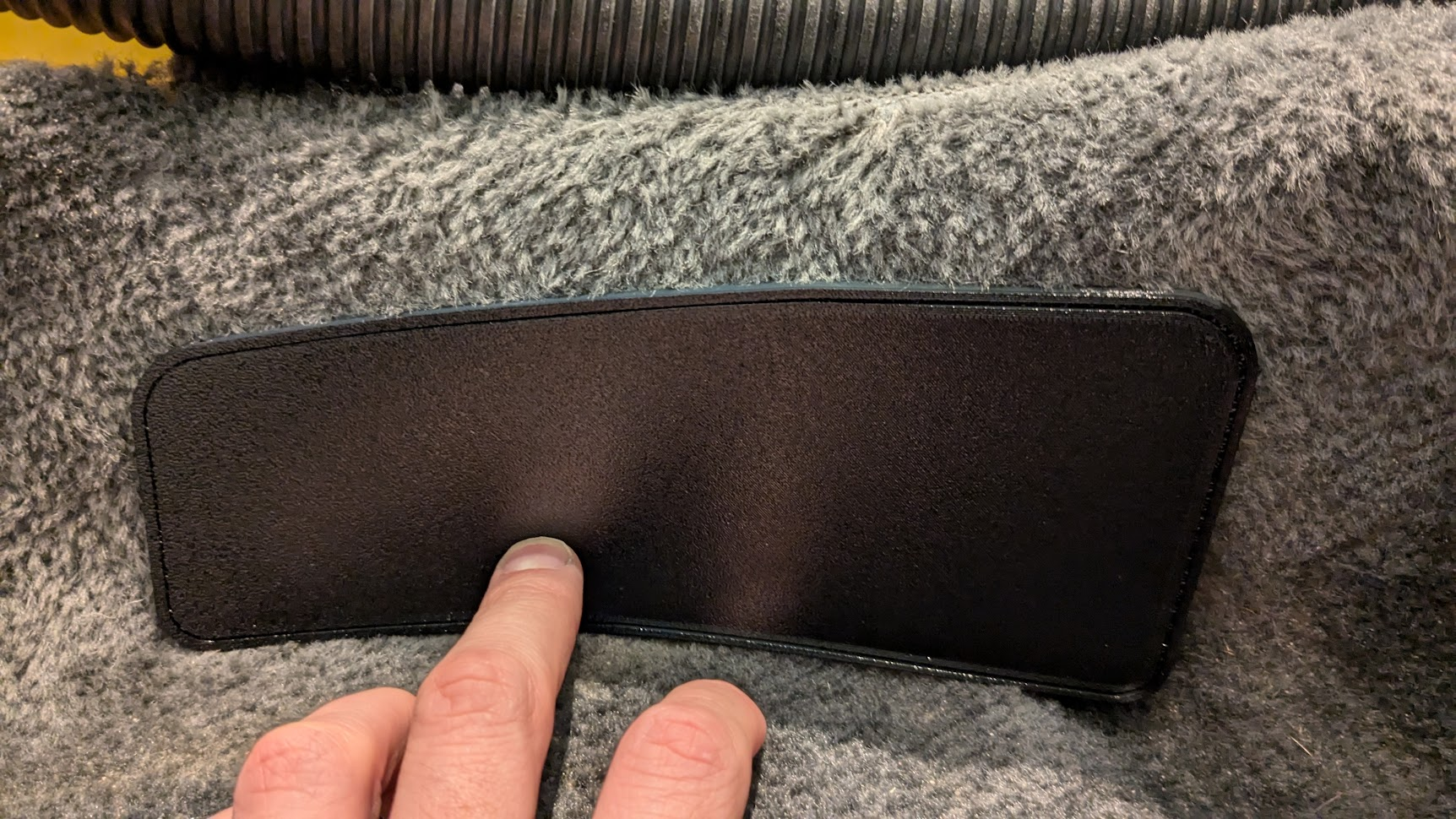

The decision was made to 3D print a patch. 3D printing is something I am familiar with, working with carpet isn't, so this promised to give the best result. The first prototype was printed from PLA, because it is much cheaper and much faster to print than flexible materials. The final patch is made from TPU with a Shore hardness of 95A. The prototype fit very well, so the final patch was printed the next day (it took nearly 5 hours instead of 1 hour).
To avoid ripping the carpet at the seam that is created at the stitching, a backing piece was 3D printed. The trick here is that the model was sliced without solid top and bottom layers, so only the infill grid remains. This allows for more flexibility (in a literal and figurative sense) during the stitching process:
Everything was aligned and held in place by a lot of pins and then I got to work:
I haven't stitched in a couple of years and even then I didn't have a huge amount of experience, but the results are not tooo bad I think:
Just the stitching took about five hours, the 3D prints took about seven hours in total and designing the patch took maybe an hour.
So now the carpet is finally ready to be put into the car again and I can finally reassemble the drivers side footwell :)

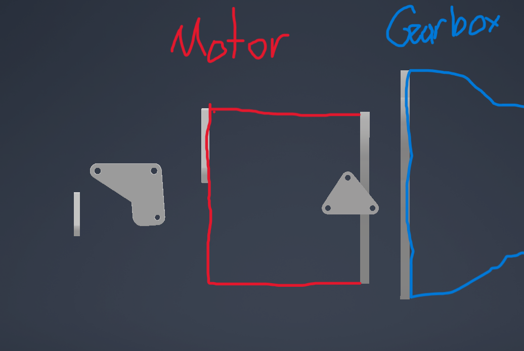

The idea behind the motor mount mockups is that I treat the data as if the engine block sits in the center and I build "against" the original engine mounts.
These mockups are then 3D printed to verify that the bolt pattern matches the original mounts. It's quick and easy to do, so why not. The PLA I use will be recycled into new filament by the German Startup "RecyclingFabrik", so it's okay to print some more prototypes :)
With all the mockup motor mounts designed, the measurements can be set into relation. I always measured two mounts in one go, so they can be put into relation.

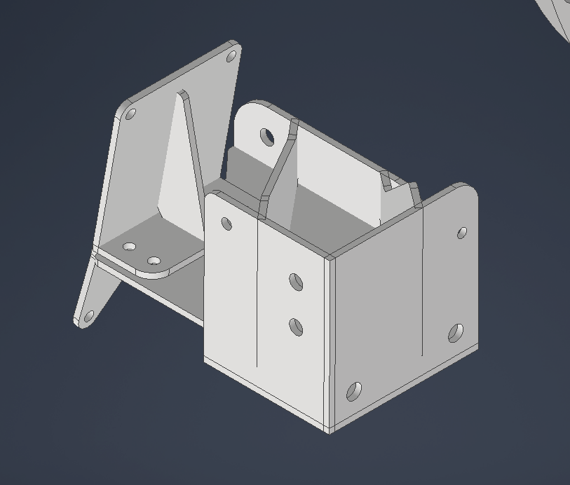

Yesterday night I did the first (and second) iteration of the side engine mount. This is the first draft that I made to get an idea and to see how it might look like:
Turns out: This is not what it would look like :D
Tomdb gave me some very valuable hints and directions. The main issues with this are 1) that it'll be hard to precisely cut, position and weld the box section steel and 2) it is not really strong in the direction it has to be strong in. The biggest issue here is the CV axle support bearing, which (hopefully) won't experience any torque (if the bearing is not shot), but certainly some forces transfereed through the CV bearing.

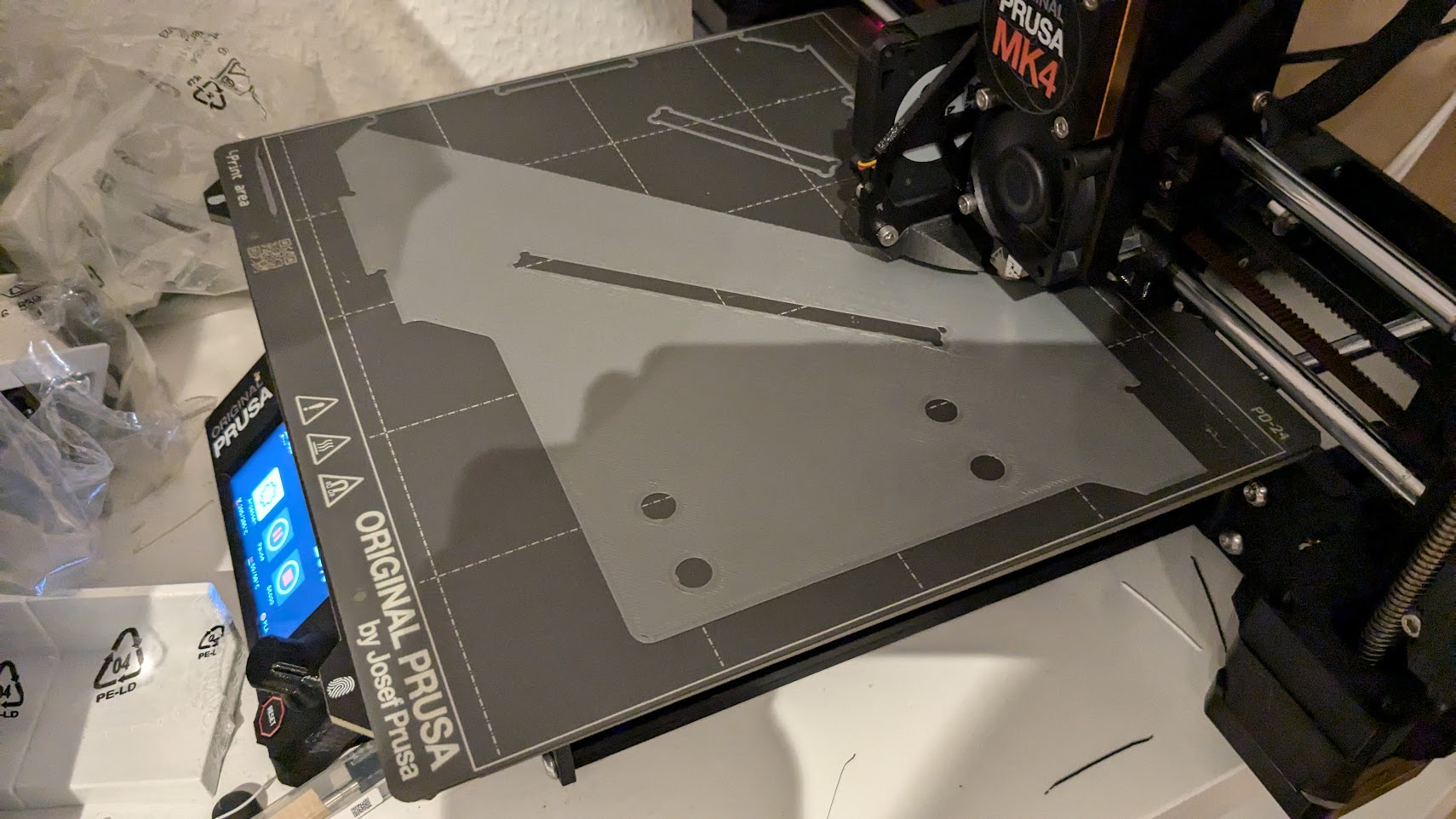

The better and simpler approach is to use flat sheet metal, in my case 5mm steel. That's probably way too thicc, but since I don't want to do any fancy calculations with forces I don't know, it's better to build thicc than weak.
Placing the mount on my 3D printer was... challenging. It is pretty much maxed out and I had to cut the model a good bit (on top and on the left):
This was my longest print yet with the highest amount of filament used. In the end it took 19.5h and about 440g of filament. But the Sovol SV06 handled it like a champ and printed it without any flaws in PLA:

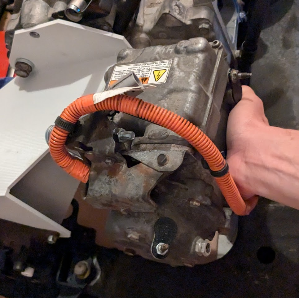

Of course, I had to test fit it to the motor and everything seemed to fit quite nicely. The only oversight was that I forgot about the sleeves in the CV axle bearing holder. Since I don't want to mount the CV axle yet, this wasn't a big issue though.
Since my partner took his engine hoise back with him again in February, I can't really get the gearbox and motor in the car. But I can get the subframe out of the car. :D
I wanted to do that anyway, because the subframe bushings are pretty much shot.
The engine mounts are pretty shot as well, but I only have the replacement for one of them. At this stage it'll be good enough, but when the ICE was still in, the gearbox was already bottoming out on the rubber endstop (which it should never touch). Especially in the last picture you can see just how much the mount sagged. The chain is usually very tight and you can not get it off the mount... yeah :D

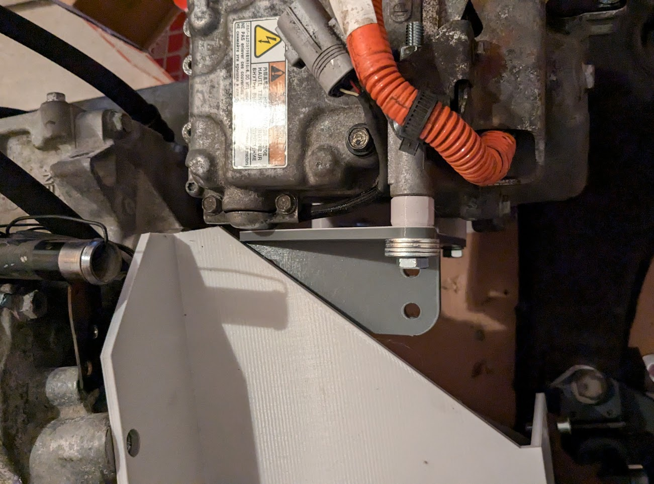

Aaaaaaaaand here it is. Especially the front mount was quite a tight fit, but it looks good. It's just so nice to see everything coming together from the CAD system. And I'm even more impressed that everything held up, it's just PLA with not toooo much infill :D
The CV axle support bearing holder seems to sit in the right spot as well, but I didn't want to fiddle around with the drive shaft yet. It has a torn CV boot and is very greasy.
Unfortunately I probably won't be able to use my fancy phase gland (check my Printables page). The space is just too limited.
Now... the seasoned reader probably knows that I have a soft spot for fancy stuff, so of course I couldn't help myself and designed some feet for the subframe, so I don't have to drag it on the ground so much :D

Thanks to the awesome work of larsrengersen, LRBen and Tomdb we now have control over the VAG MEB PTC air heater and Tom even made a 3D model (see his GrabCAD).
A rough check of the dimensions showed that it might be a good candidate to fit into the Volvo.
So I bought one from Poland for a reasonable price and removed the heat exchanger today.
Depending on who you ask this is a "dashboard out"-kind of job, but you can get around it. This is what we are talking about:
I struggled a lot to get the screws of the coolant line holding bracket out, because there is not much space. You probably don't have to, because you can just remove the whole block including the lines (which I found out afterwards):
But in the end it was out. You can "just" take out the whole lower part of the heater core box:
So now we are in an area I am more familiar with, making an adapter plate (now without a laser tracker :D ). First I took all the relevant dimensions and then turned them into a simple CAD model that can be 3D printed to verify the dimensions.
With the aforementioned CAD model of the heater, I designed an adapter plate that should allow fitting the heater to the Volvo quite easily. I will probably have to shave the guide rails of the heater to fit into the box.
The PTC heater will arrive in a few days and until then I'll have the adapters 3D printed and tested.

Friday we continued on our mission of "Don't get it running, get it right!" and replaced the headlight. As you can see, the reflector is very blind. That is the downside of the scandinavian cars which always have their low beams on. Increased security, decreased reflector lifetime (but to be fair, the reflector is 26 years old too). The actual reason for replacing it though was the broken mounting tab. I just didn't feel like investing a lot of time into fixing that (with fancy 3D prints) when the reflector is pretty much shot.
After removing the indicator (which will be replaced as well) I discovered a small rust spot, so of course this had to be addressed while we're at it. Since it is hidden behind the indicator, I didn't have to do a suuuuper clean job and just painted 2K acrylic paint on it:
The trunk lid received some temporary rust prevention as well. Ugly: yes, will most be hidden: yes, will it rust again: probably, but not so fast.
The next job was getting back to the AC compressor. First I created some plugs to protect the compressor from dirt and debris entering it (more than is already in it...). As usual, this is published on Printables as well: https://www.printables.com/model/949837
Getting the dimensions of the mounting flange right was a bit difficult because the mounting holes are recessed relative to the "belly" of the compressor. Therefore the first try was... not super successful :D
But hey, that's what 3D printing is for and the second try fit a lot better :)
Since the compressor will be mounted on the motor mounting bracket, it has to be designed as a part of that bracket of course:
And this is how it will look like on the bracket:
I wasn't supper happy with how close the bracket sits to to the little cap that protects the control cables, so the design had to be modified a bit:
Of course, the bolt pattern is published on Printables as well: https://www.printables.com/model/949824
Please check the models out and give them a Like for the statistics :)

crasbe wrote: ↑Sun Jul 14, 2024 8:47 pm MAYBE I'll print the big part again, but I'm not certain. 430g is a lot of filament and when I don't have to, I probably won't. (But knowing myself I probably will).
Well... I did reprint it. Initially I thought that the dimensions were incorrect again, but it turned out everything was right and the white piece just flexed a bit (a lot) under the load. Who would've thought?
Then I started to chop the piece up to prepare it for plasma cutting, but of course 3D printing prototypes ahead of time. While steel is not super expensive, 3D printed plastic is cheaper :D
And of course this was a good opportunity to test my new Prusa Mk4 :)
This is how the puzzle looks. Please excuse the pictures, when you don't hold it right, it all falls apart spectacularly :D
For SOME reason not all dimensions in Inventor got updated and AGAIN we had misaligned holes... This was very unfortunate to discover at this point, because I did all the cutting in Fusion with the imported Inventor model. However you can't update the imported base model and it wasn't enough to shift the holes, the hole side plate had to be moved. Therefore my Fusion model is now a hot mess and the Inventor model is a hot mess too...
Of course everything had to be reprinted, but now it fits. The AC compressor holder got chopped as well, of course :)
And the next step is plasma cutting... but we'll have to wait till next week to see that :P
*CLIFFHANGER*!

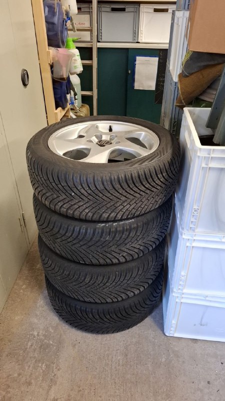

I also scored a new set of wheels, since the old ones were a bit worse for wear. But they'll make great winter wheels I guess.

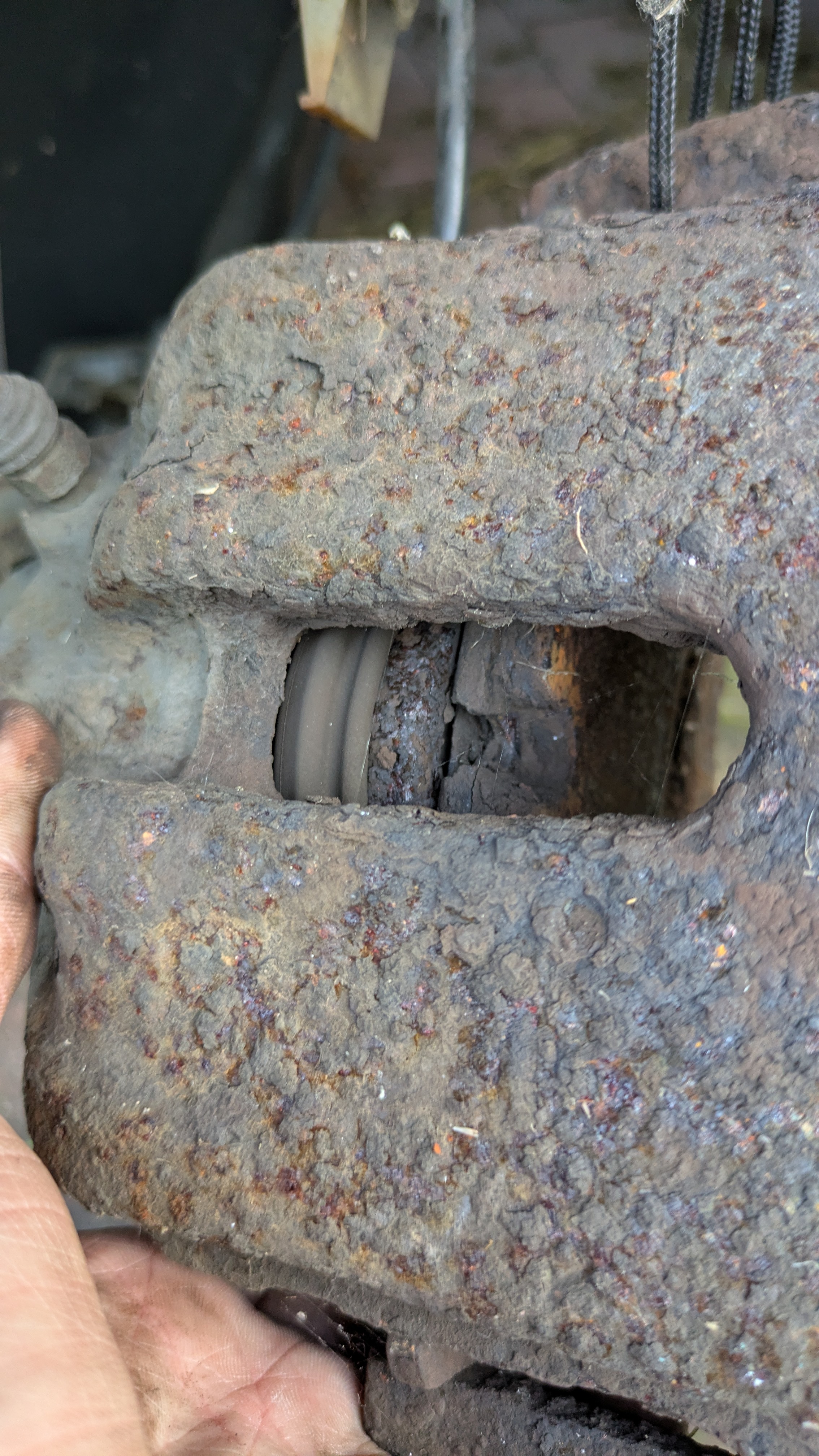

The front brake calipers will also be replaced. I thought they weren't so bad, but looking at the cylinders... meh.
The Vee70 also will get fancy new steel braided brake hoses, since the old rubber hoses were quite bad already and I really just don't want to redo stuff, so these will probably last as long as the vehicle.

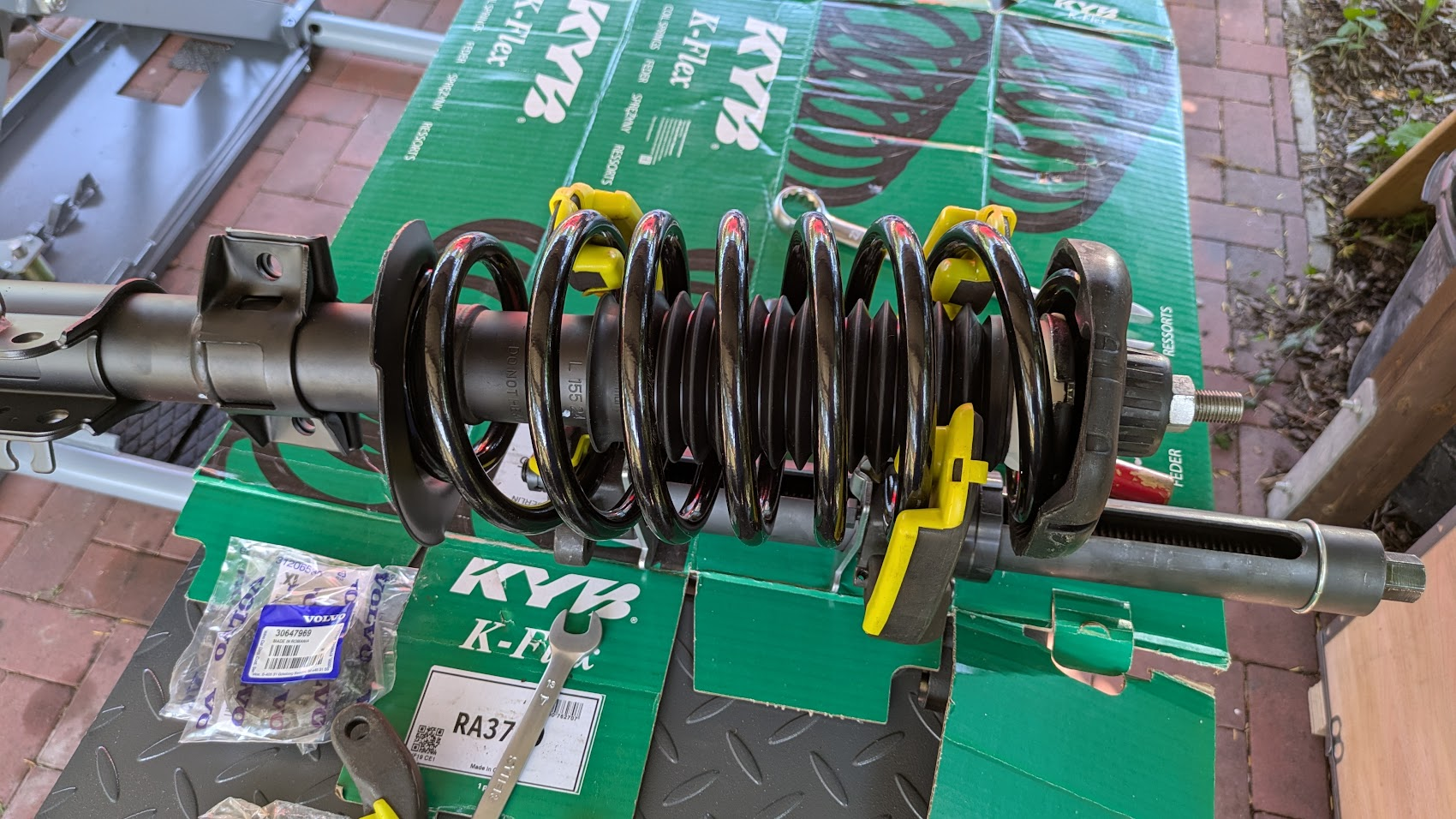

The front shocks were also assembled. On the P80, they have quite a lot more tension than on the P2 series, so this was really pushing my tool (it wasn't sketchy or so, but there was not much more travel available).
This will be a bit of an experiment and I expect that I'll have to disassemble them again for other springs at some point. The upper shock mounts are from SKF (but the bearing was branded INA I think?), the spring is from KYB and the shocks are from TRW.
