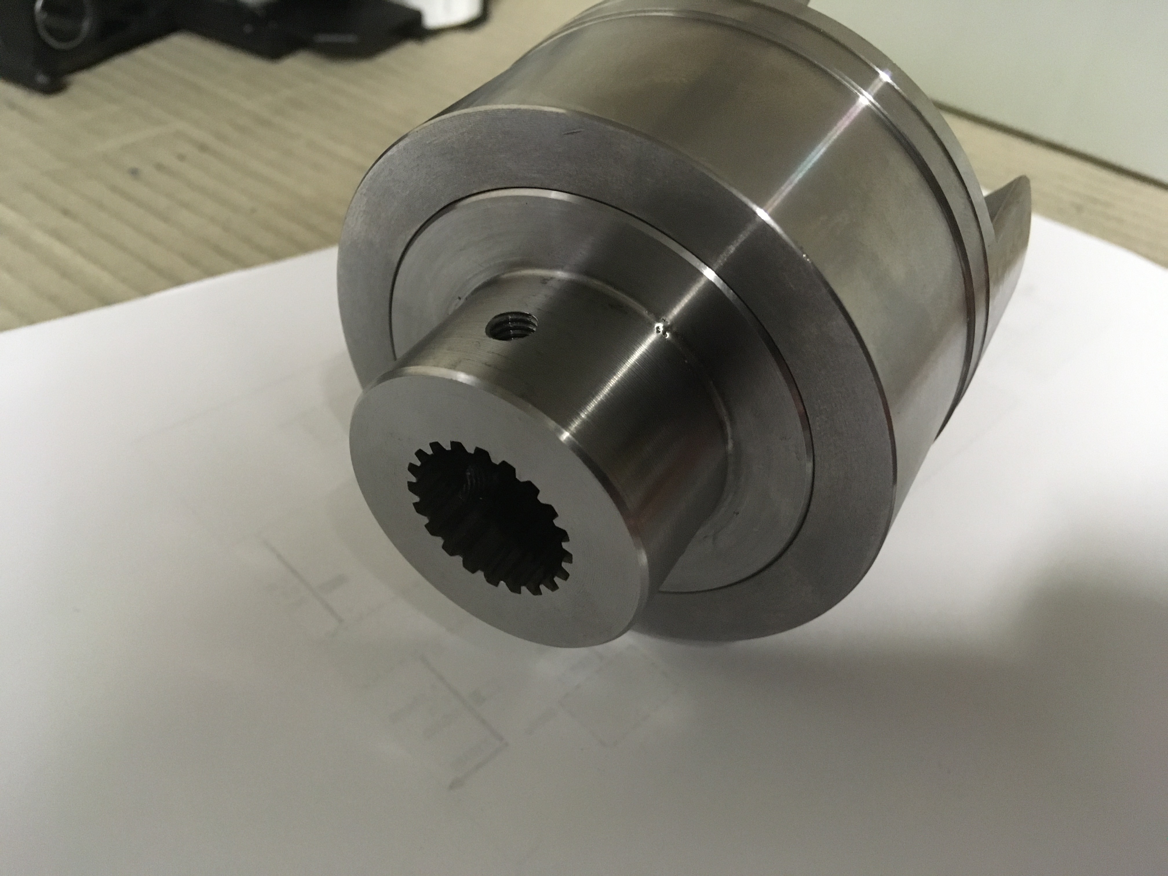

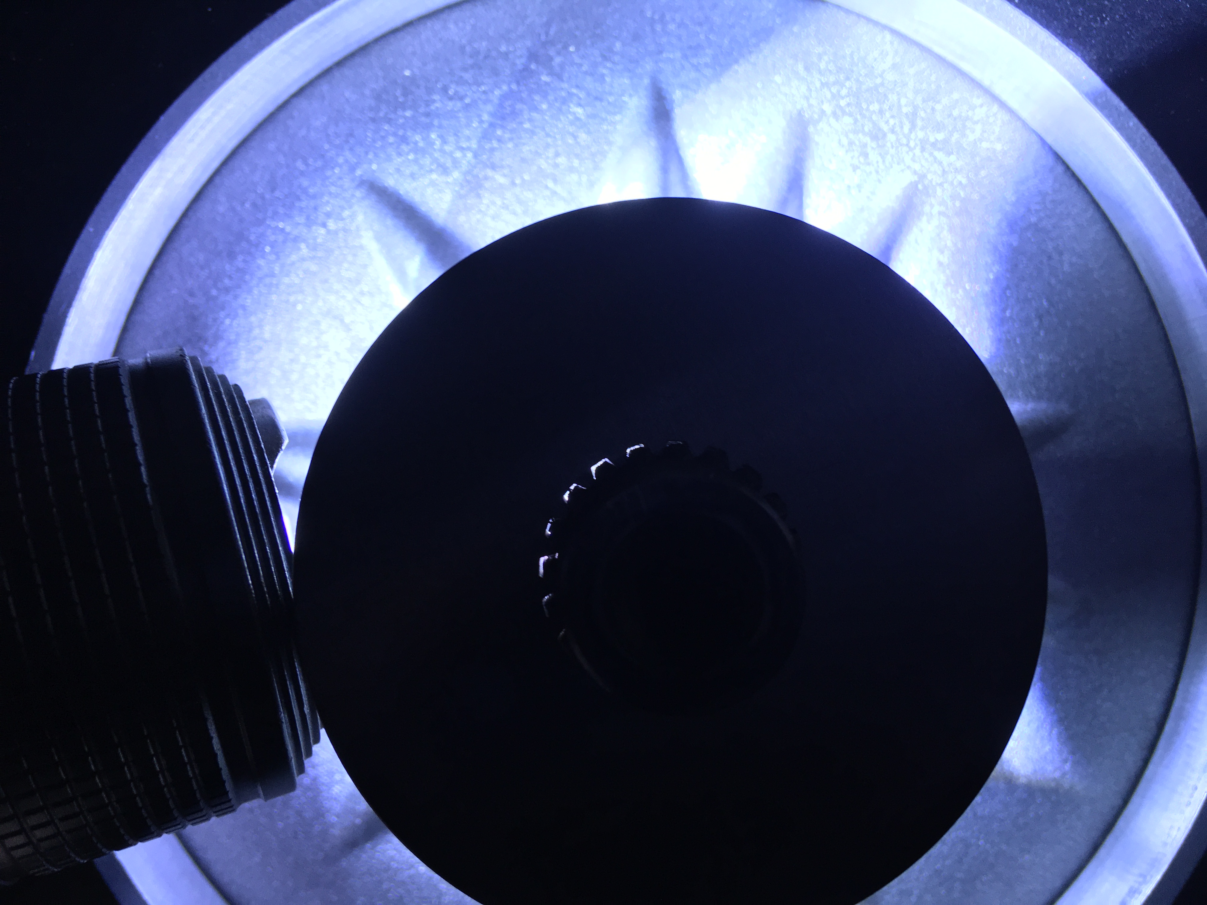

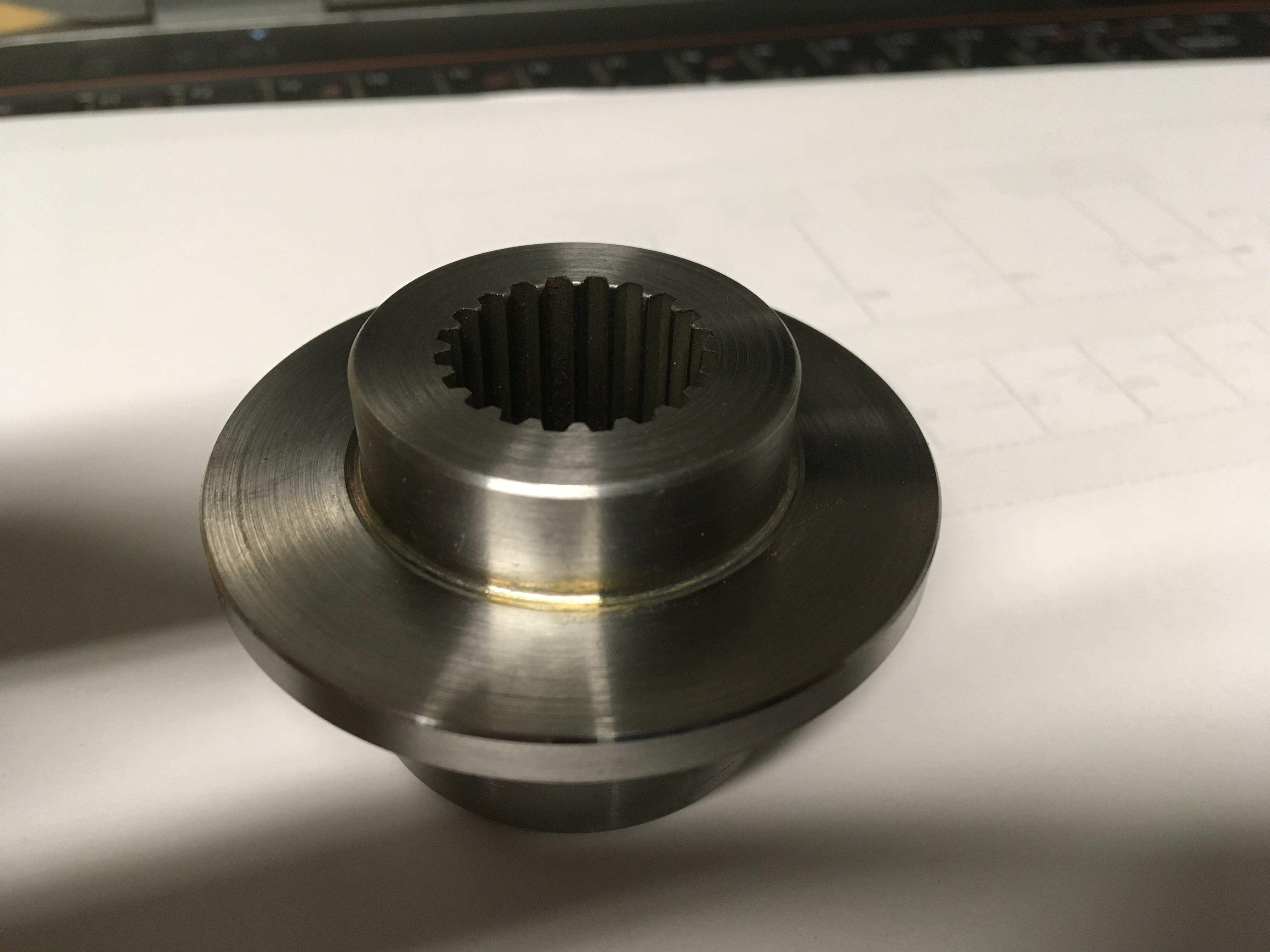

damian.lo wrote: Thu Feb 13, 2020 12:57 pm Hello,
I'm really happy, that Bratitude did his 3d model of spline in last days, because I was searching my way to replace my spline from Multipla 1.6 clutch disc. First I want to go to to Honda 1.8 spline, which like Zapatero said was a little to loose ( about 0,2mm) but then I was curious how will fit spline from You.
Result after wire cutter EDM is visible on pictures. Like is written above: higher diameter is ok, lower 19,22 is a little to small and was needed to brush a little with sand paper, so in next version first I will cut by wire and next make chamfer on end and clean inside on internal grinding machine. Everything will be welded inside of Rotex also with small endpoint for motor axis.
I hope this will good and will be not necessary to take one more time gearbox out.
Bratitude: thanks for Your job :)
This is awesome, do You think you can take some macro shots of the coupler on the shaft? would like to see the meshing of face angles, involutes, chamfers, etc. If you can backlit, so light shines, threw that helps.
19,22 so the trough of the coupler splines needs to be deeper ? We only want the faces to contact, not the top and bottom of the spines.

Yes, I will do all photos, which can help You, but tomorrow. Today I left this disc on my desk at work ;)
What I saw, angle was ok, outer diameter was good, because is enough space between external diameter of Leaf spline and bigger diameter of my coupler. Problem was with smaller (19,22 between opposite hills of teeth) diameter of coupler. After wire cutting was necessary to brush with paper. My spline will be 35mm long, so after cutting will be grinded on machine like I wrote.

Hello,
Yesterday I did more photos of your spline and is how I wrote last time. In my opinion spline shape is ok. What should be bigger is tooth height - means internal diameter of spline: 19,22 +0,05. On monday I should receive spline 35mm long and grinded inside, so should fit better. Gap between outer diameter of motor spline and inner diameter of my coupler is visible now only where is light, but of course is the same all around.

damian.lo wrote: Sun Feb 16, 2020 2:27 pm Hello,
Awesome, re-reviewing the photo, looks like the depth coupler is too long and need to wifi the teeth/ adjust angle. Have you received your new piece yet? how dose it fit?

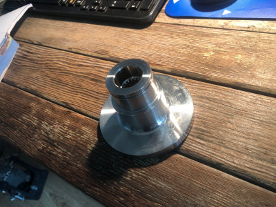

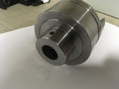

Hi again,
Parts I received at saturday, so I had a few days to do trials :)
Result is below on pictures and I think - it's okay. Like I said - we regrinded a little internal diameter but it was less than 0,05 - in practise it was only a touch :)
Mine spline now is welded together with Rotex, because it was sorry to felt him (!), but next version will be probably like Yours one part with rotex clutch side.
I saw, that You want to produce those parts - can You say in which metod - EDM or other? If You will have problem with EDM machining I can ask my friend what will be cost here on place.

damian.lo wrote: Mon Feb 24, 2020 8:30 pm Hi again,

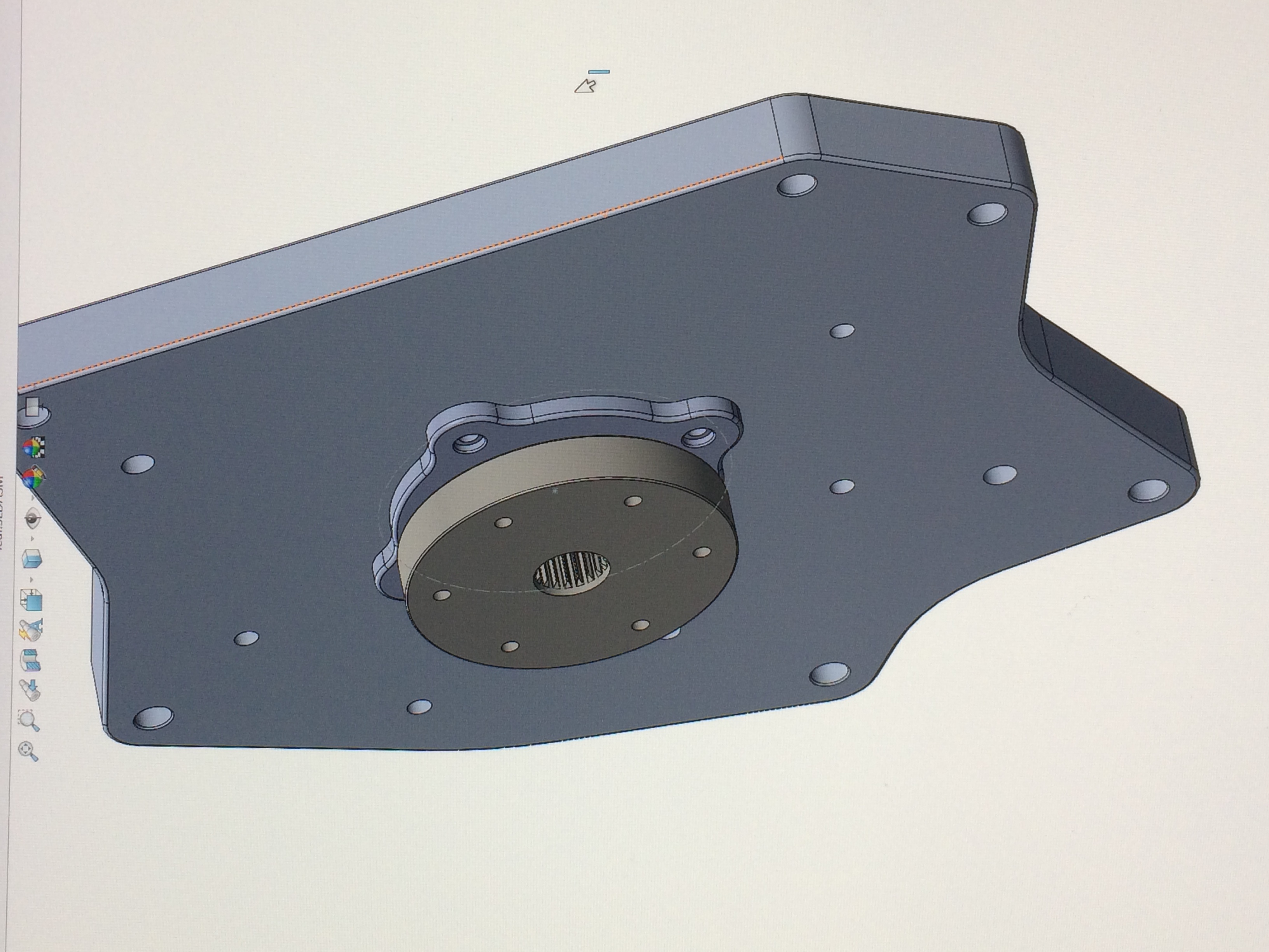

Awesome work! Very cool to see
I’ve made an update and changed the Piece to match the rotex bolt pattern and increased the internal spline radius. Slight change in face angle. Based off the 1in long 3d printed parts, it the best fit yet.
https://github.com/angusjo/leaf-splines ... xtleaf.STL
I was thinking of getting 5 or 10 cnc’d from 3dhub. looks like it will be cheaper this way than wire edm, how much was it for yours?

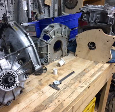

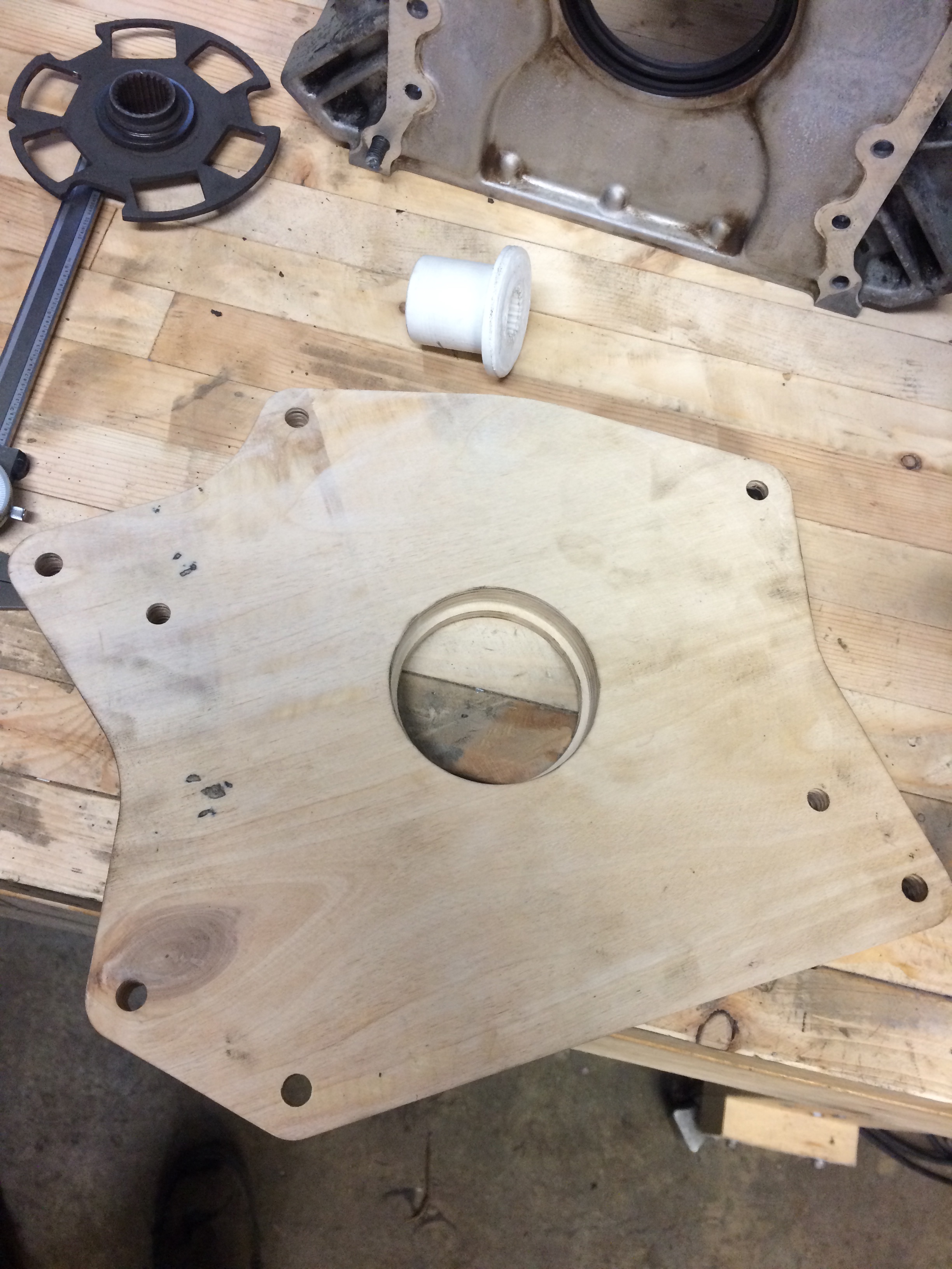

Posts: 1156
Has thanked: 246 times
Been thanked: 469 times
Re: Leaf powerd lifted Subaru BRAT

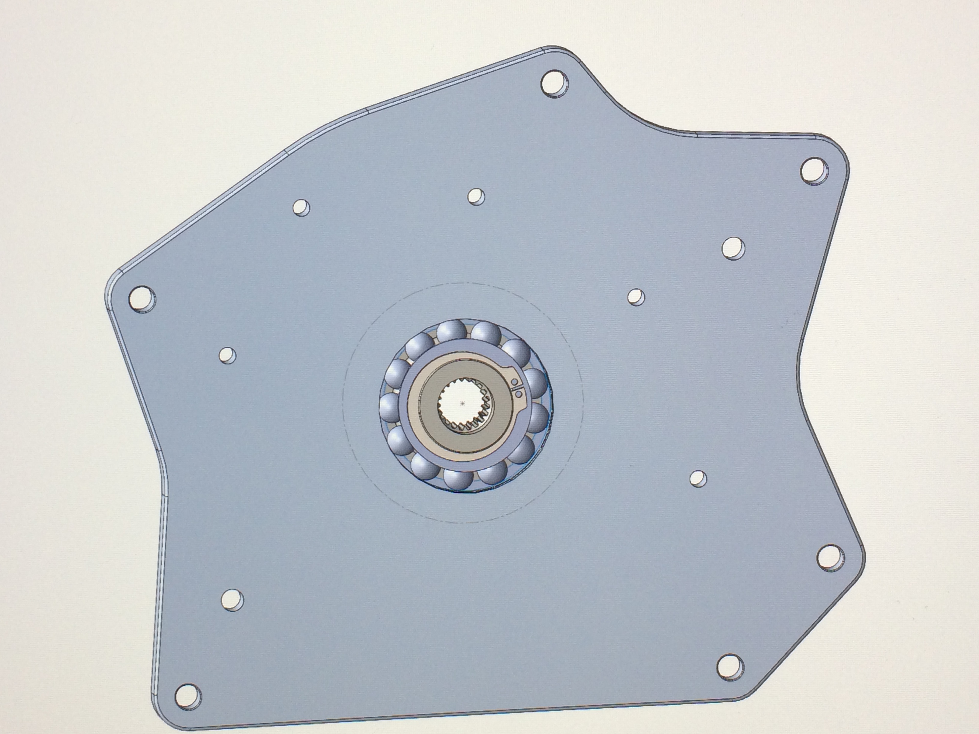

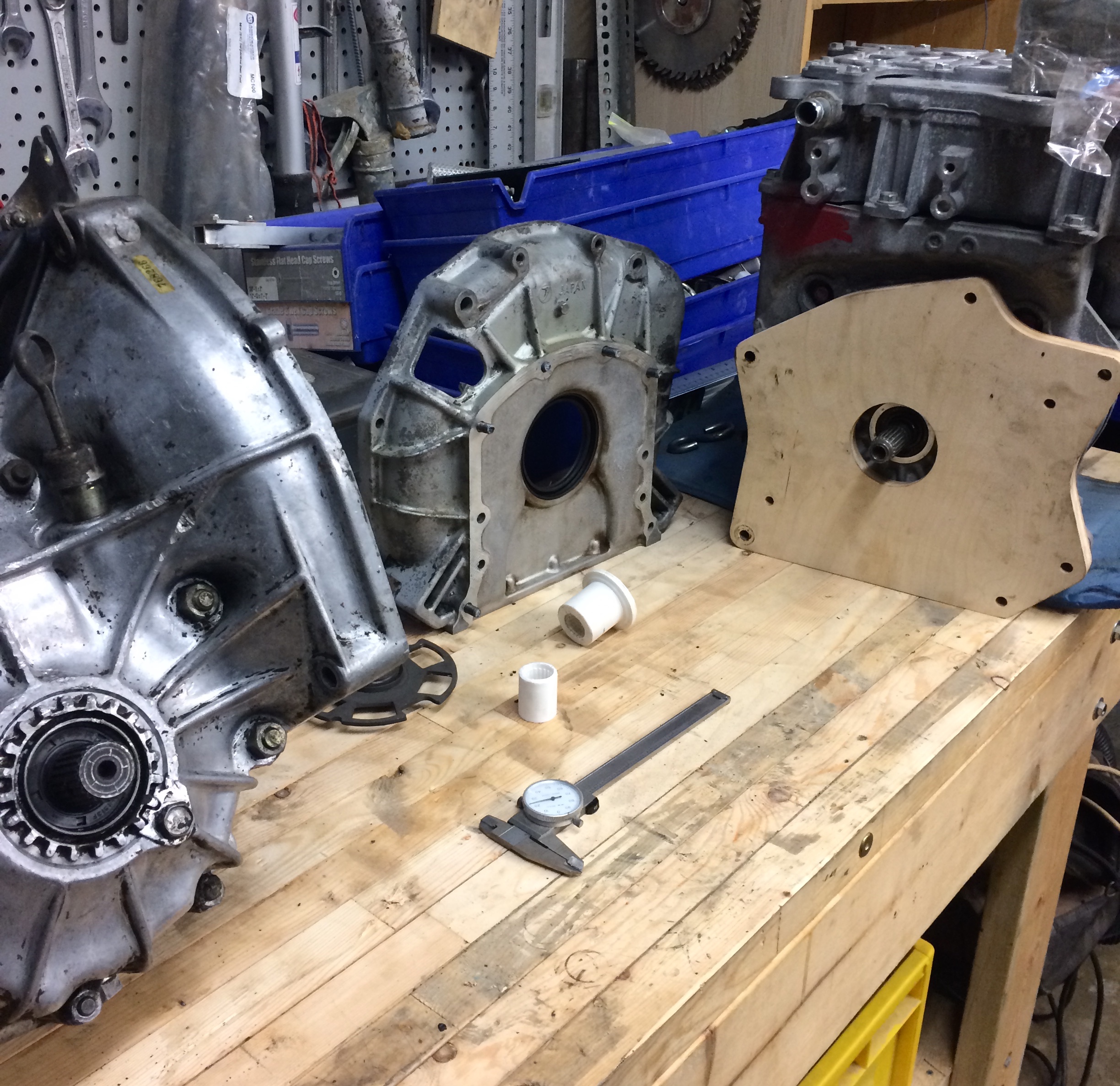

Some updates:
coupler/ general assembly finalized
wood mock-up cnc’d

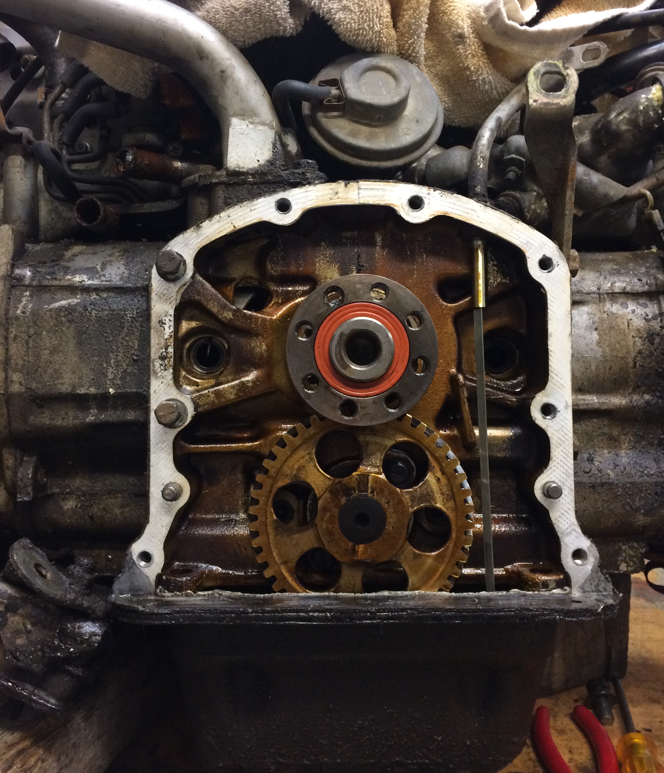

The old ea81 Subaru engine with the bell-housing removed. I’ll graft this bolt pattern onto the adapter plate. back spacing as a result looks like it will be a good fit.
Transmission, engine bell-housing, mock up couplers/adapter and gen2 leaf
Posts: 1156
Couplers have arrived. Fit like clockwork.
next up get the milled aluminum plate and angular contact bearing, then motor is ready to go.

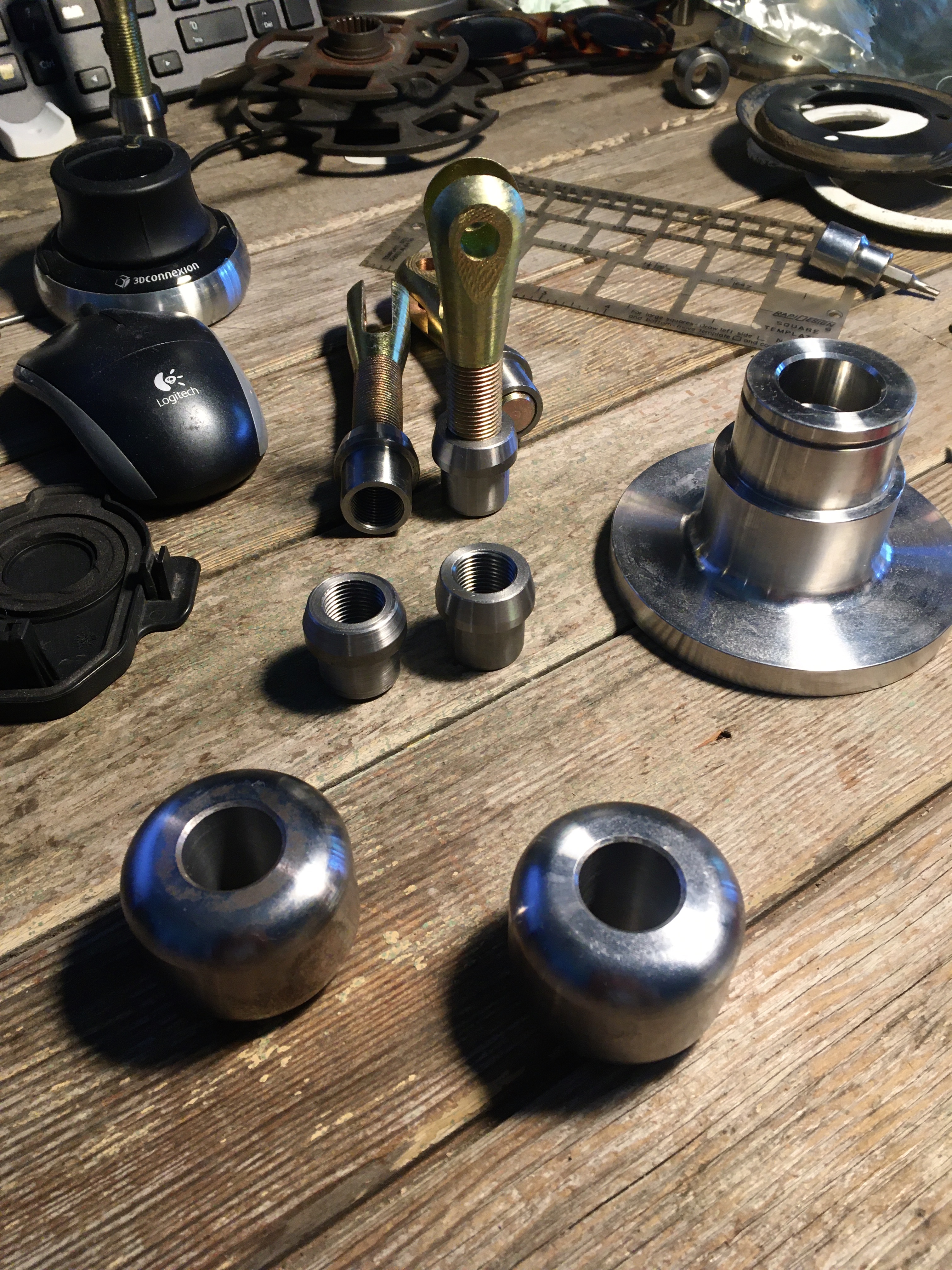

Posts: 1156
Back it!
Hardware for new wider front lca.
thanks to UB machine and tssfab

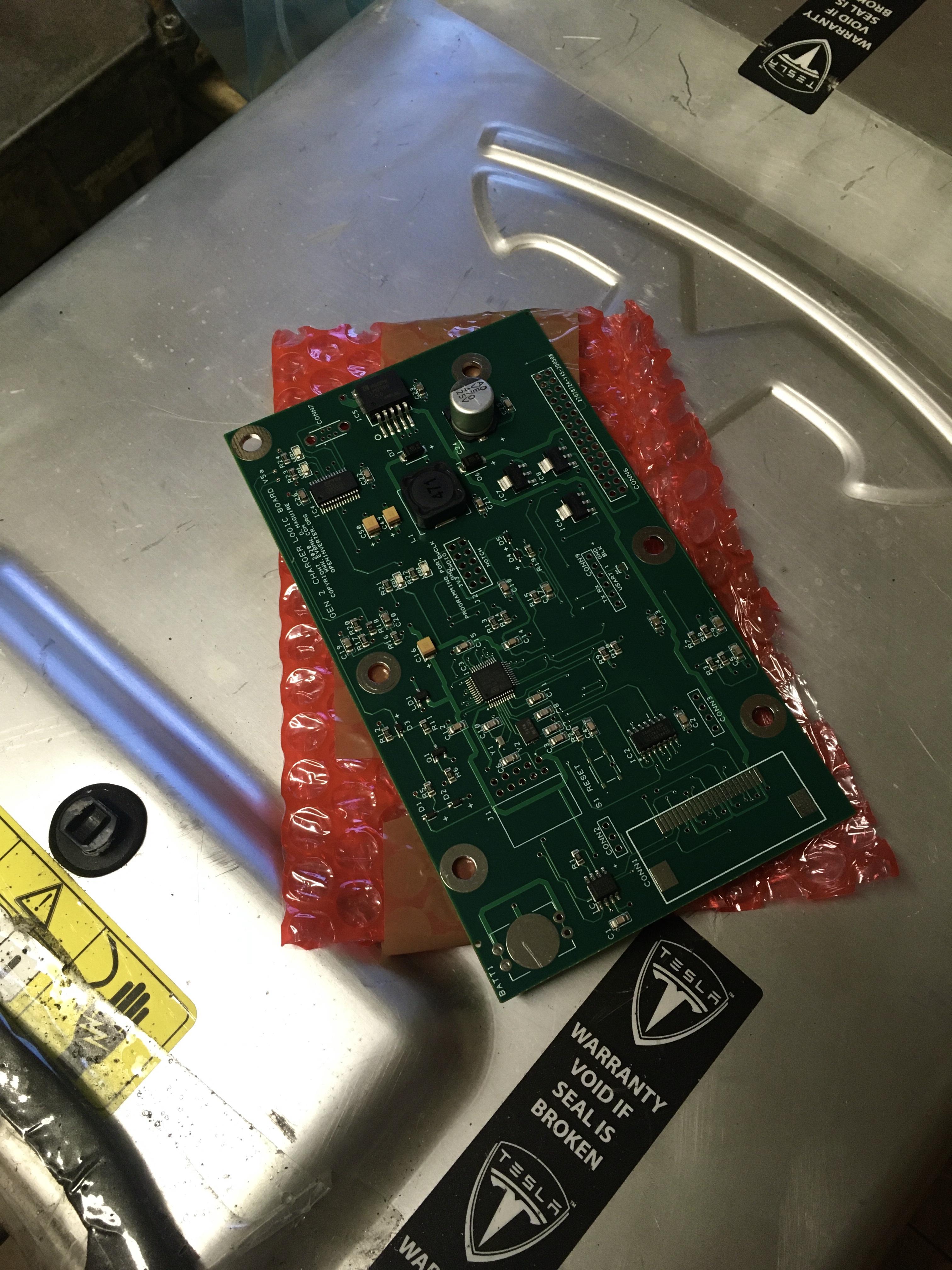

charger v5 from damien, thank you!

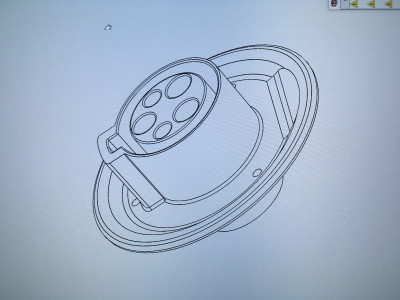

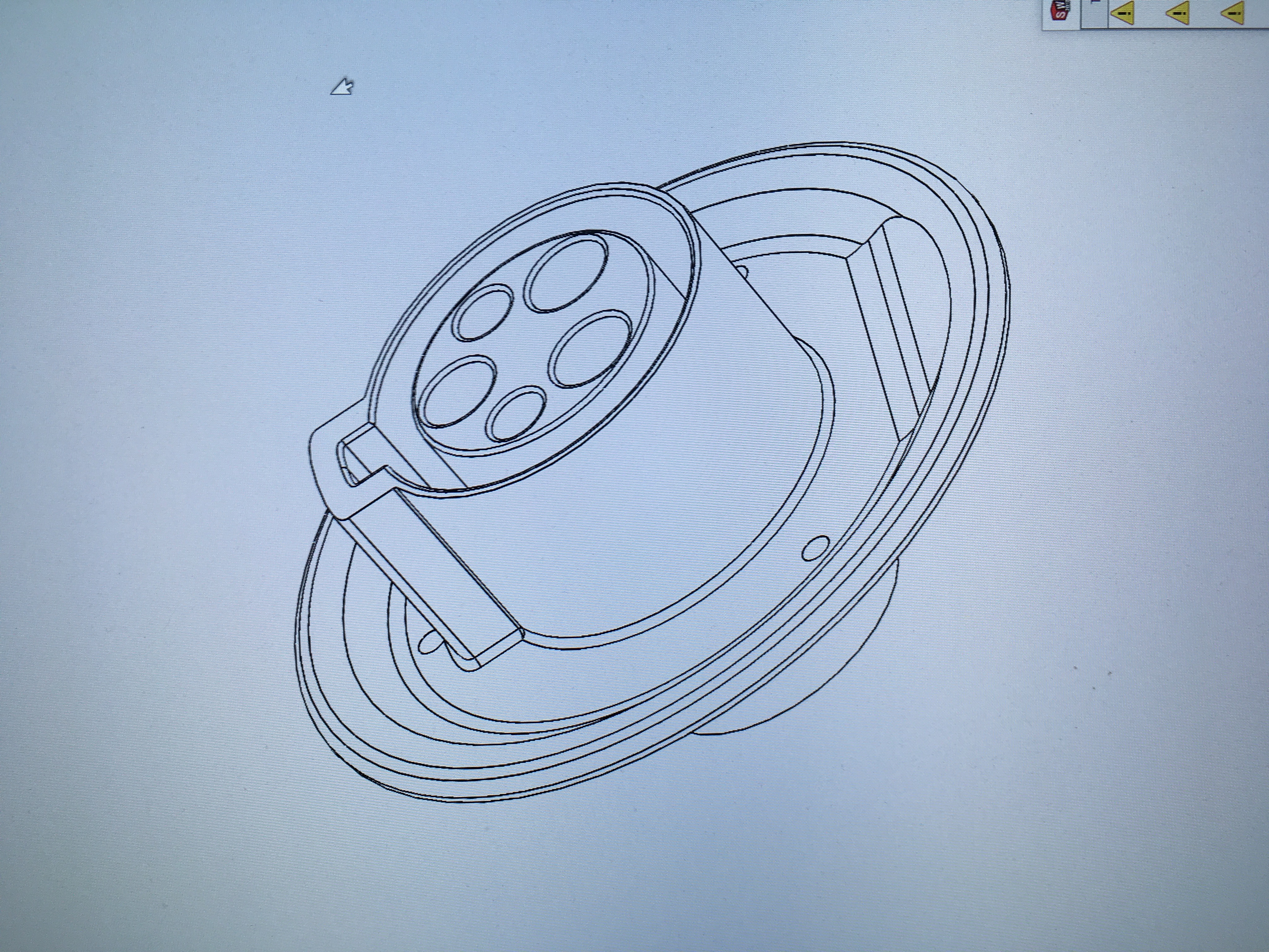

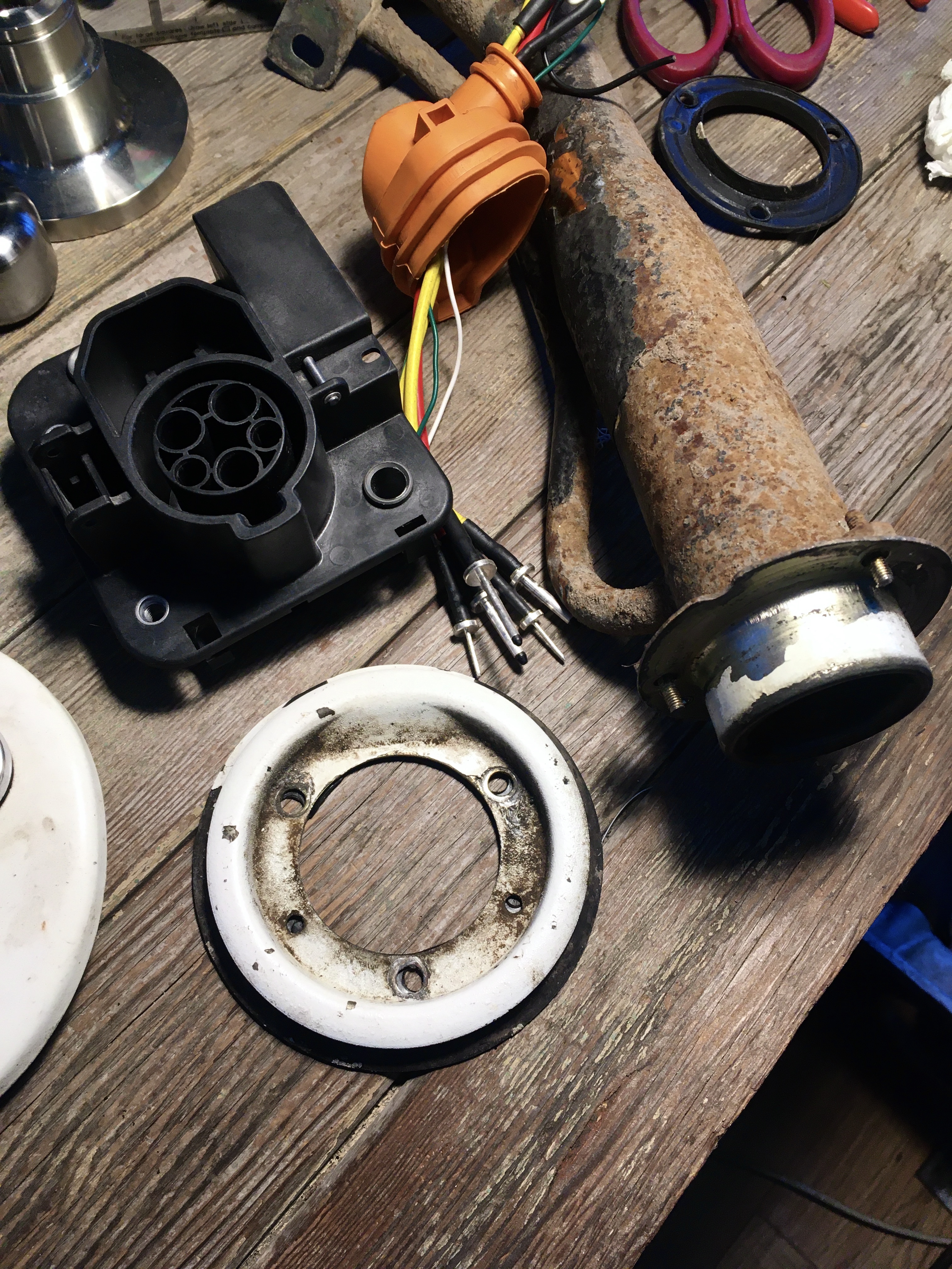

Finishing up a j1772 port to bolt right into the original fuel knock location
