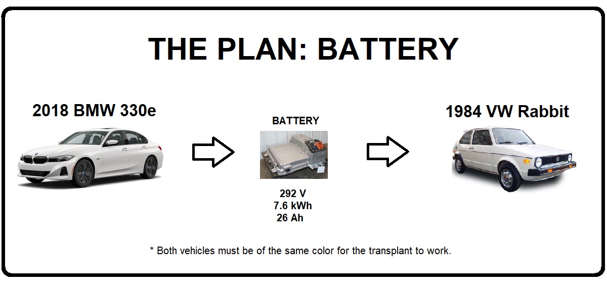

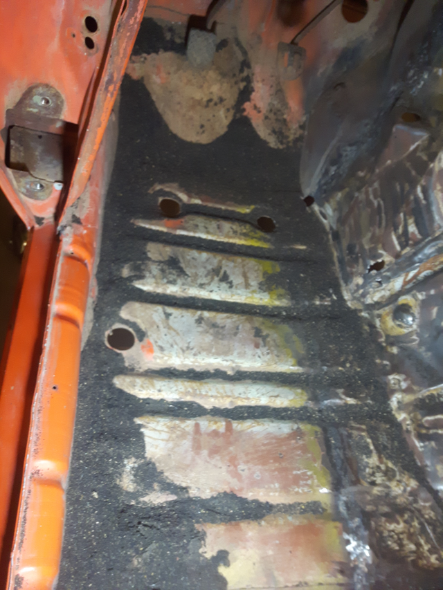

"What is this stuff? Am I going to have any car left?"

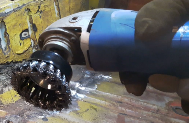

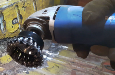

It's sound deadening. DynaMat or whatever equivalent.
It's almost identical to a kind of sticker-on roofing tar, but more expensive. I forget the brand/thing to buy that's sheets of roofing tar that's chemically identical, but, when it comes time to replace, yeah just use that.
3 ways to remove it:
1 - Abrade it away with an aggressive wire wheel, then vacuum up the grains. This is what I did. Ugh:
2 - Throw dry ice onto it, and then hit it with a hammer to shatter it. Alternatively, it was -58'F here last week, and I'm sure anyone even climbing into their vehicles crunched theirs. Best, but most expensive.
3 - Heat gun and scraper, probably worst and most time consuming:
Also, do not watch any of the rest of these videos. Get what you need and get out. They're so well done they'll make you never want to record a car video ever again.
