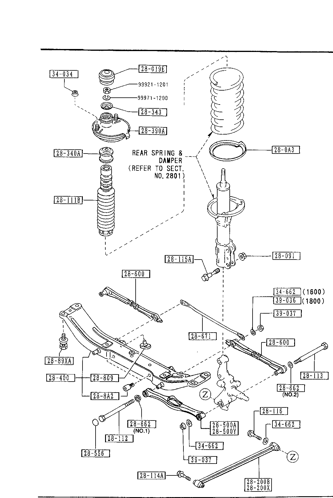

Parts on the rear axle...

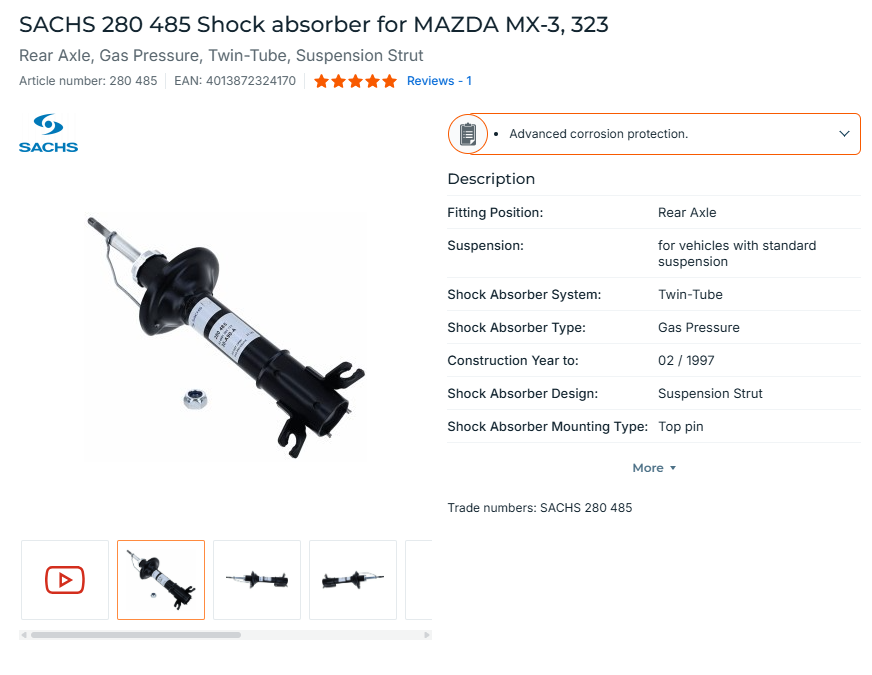

I ordered shocks and top caps from Autodoc, SACHS 280 485 Shock absorber for MAZDA MX-3

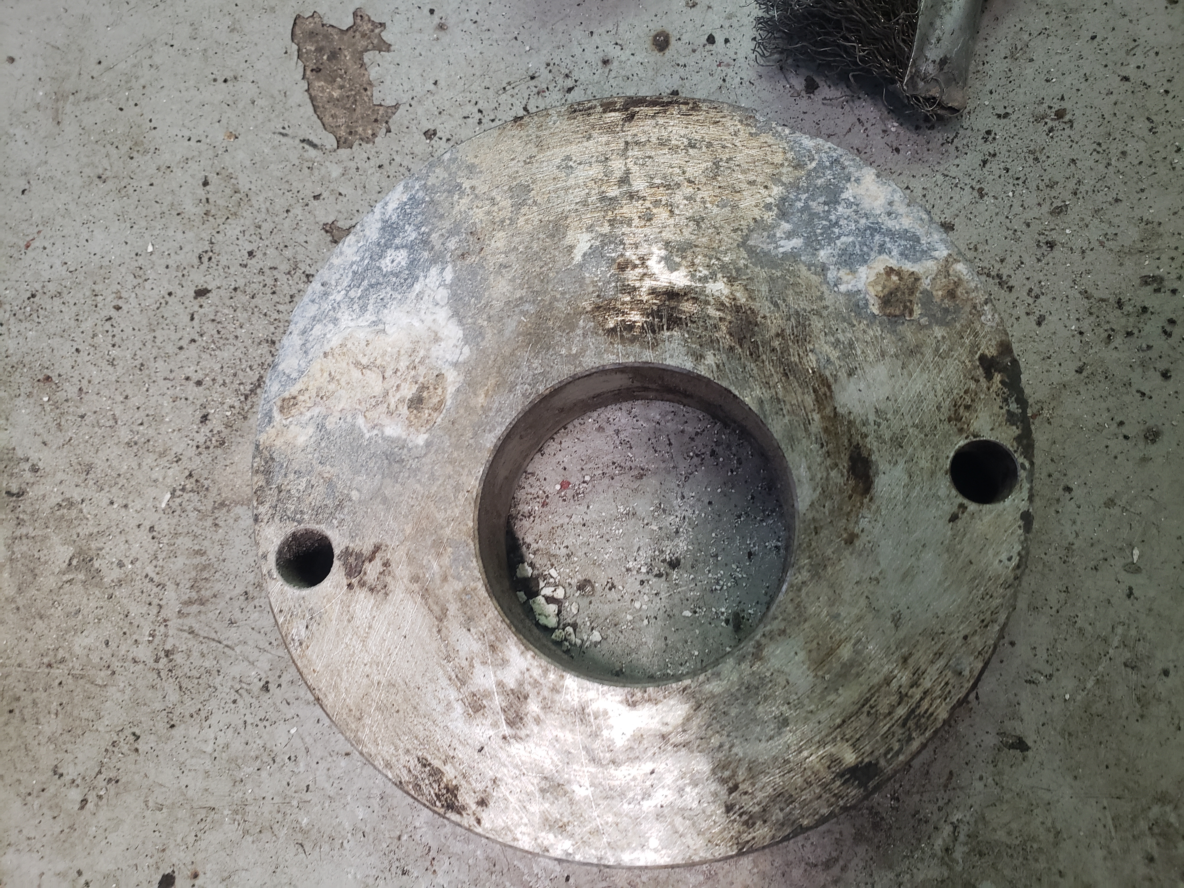

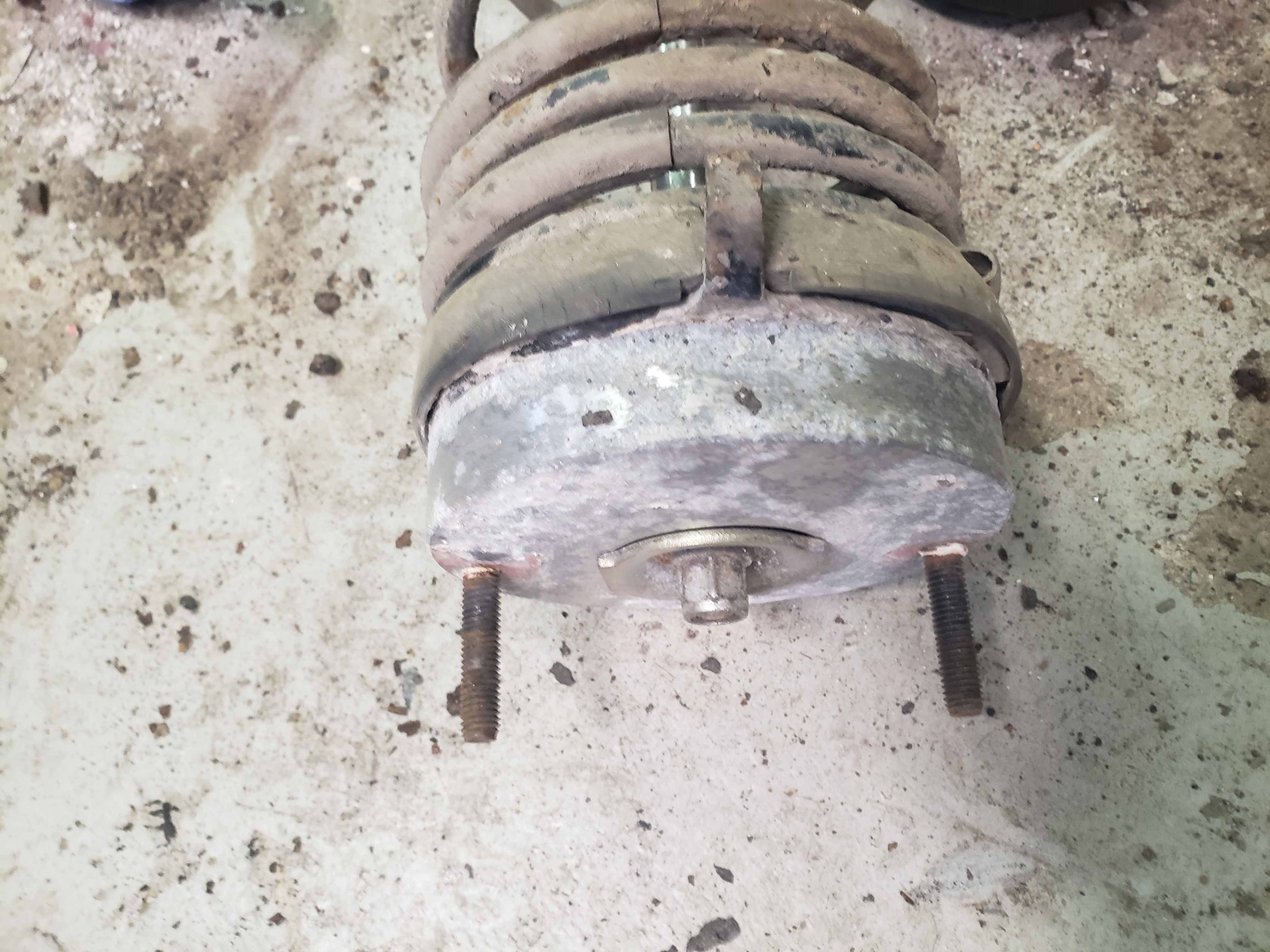

From the past i used the top shelf with long bolts which allowed me to fit 30mm aluminum inserts over each shock.
I made those inserts fitted to the old caps, but it seems like they will fit to the new caps as well...

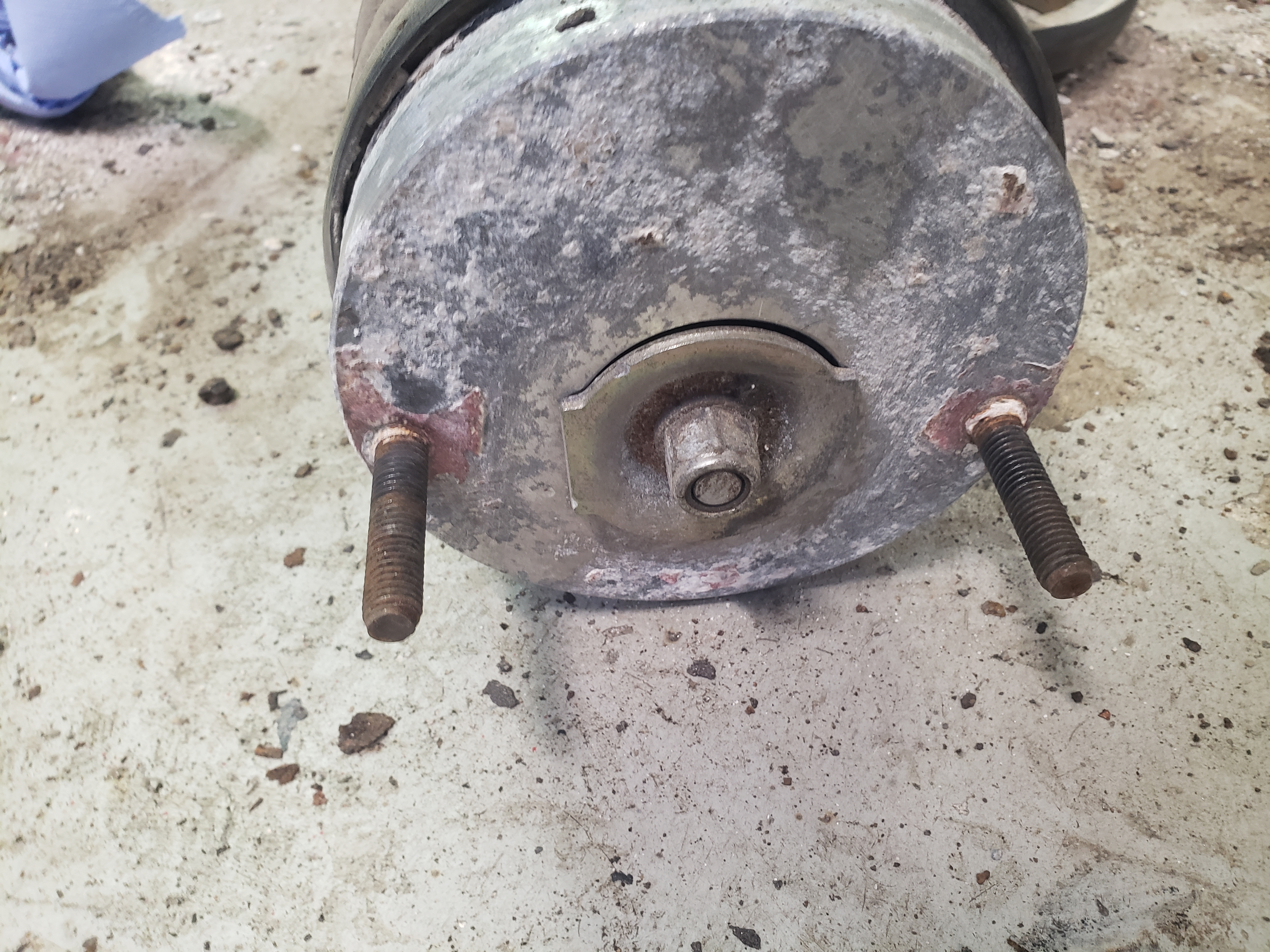

First i removed the old shocks and cleaned the inserts, sanded them and brushed

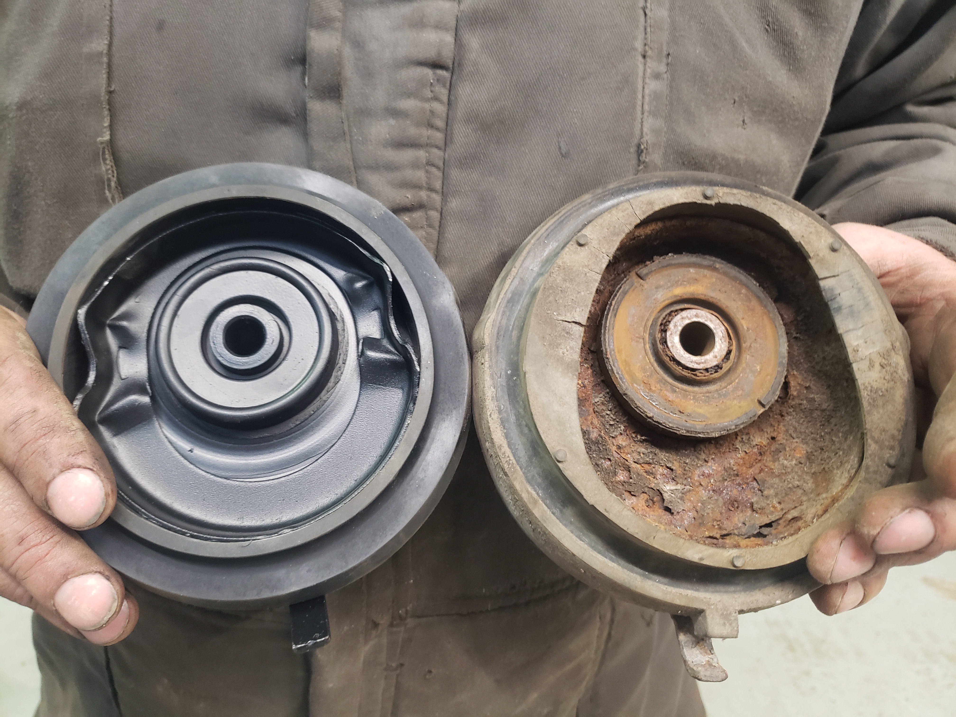

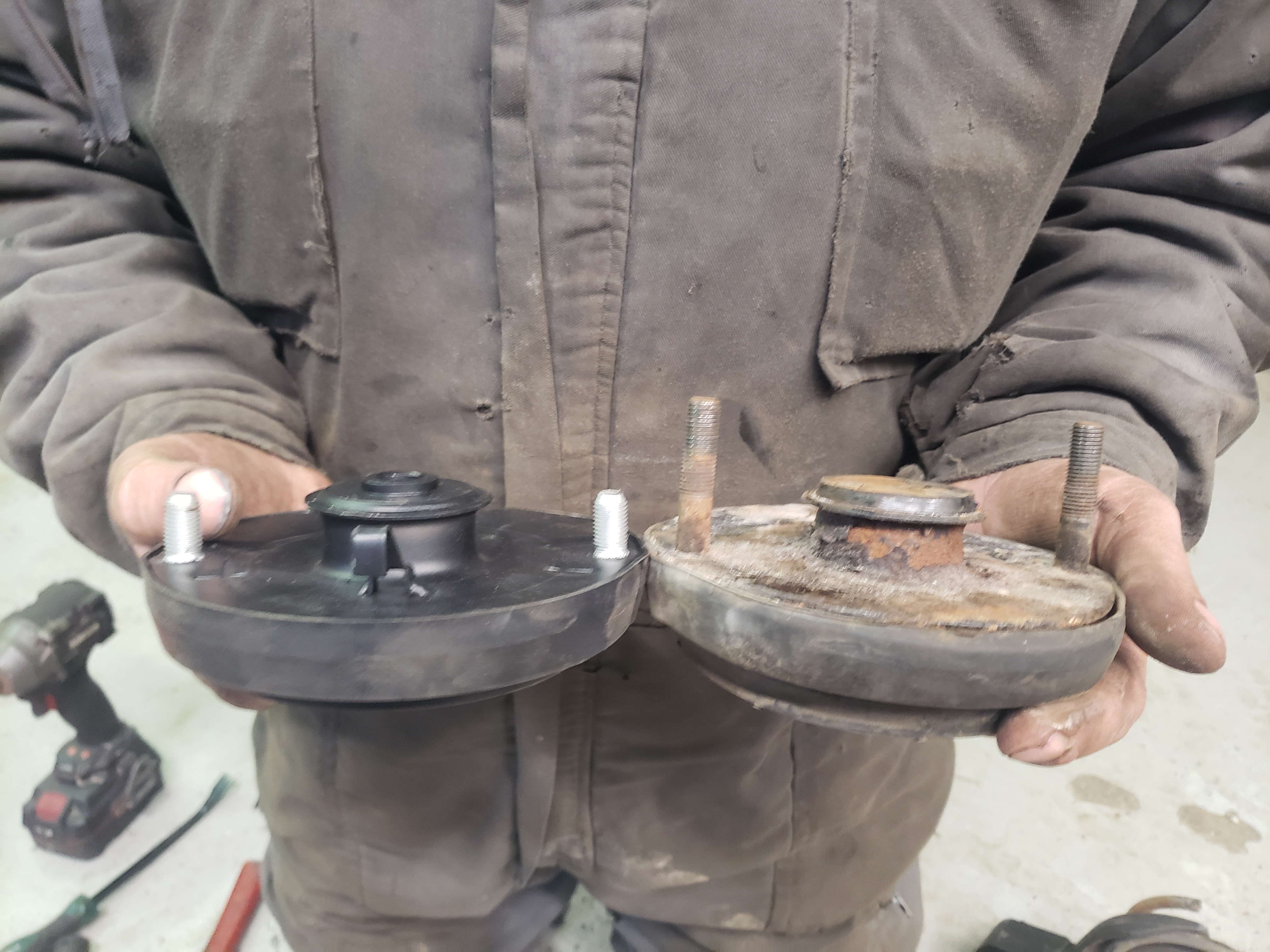

Difference old to new. You see the longer studs on the old shelf. I had to cut them off from the board and switch them to the new shelf. Tack them in place and weld themdown....
