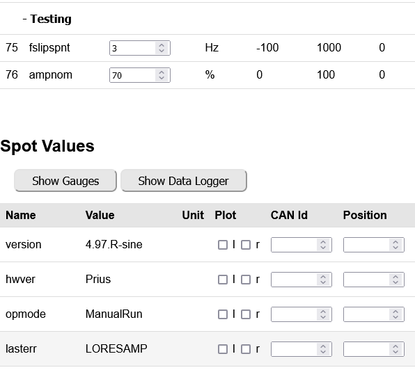

I just changed the Toyota Prius2 Inverter for the third time and replaced the wiring connections as well.
Tested the set with both program`s versions 5.27 R-foc,5.32 R-sine.
At the beginning there was perfect open loop performance.( Made a video clip of it ),but after shutting down the program and restarting get some confusing performance. The Spot value --Opmode is in manualset , but the motor & lamps don`t run. The spot value- LASTERR is stating LORESAMP instead of PRECHARGE.
After couple of restarting’s and version uploading’s get it again starting, but after shutting down and new start again the same error.
Who is causing the LORESAMP error ?
There is not a SINCOFS command in the both program`s versions. How can I perform the tuning process then ?
Test with  4.96R program

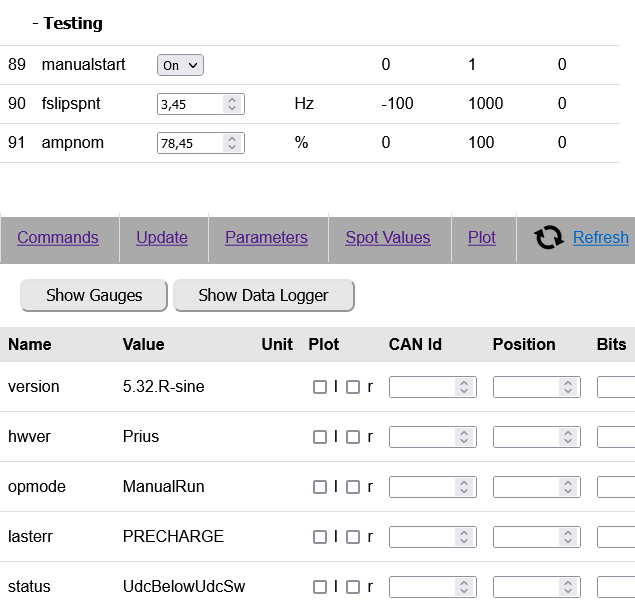

Here is picture of the 5.32 R sine programm with shown Manualrun and test settings.The problems is ,there is again no running motr at all.
No RUN  inMAUALSTART
No RUN inMAUALSTART

Is there a wiki page which explains the meaning of lasterr=Precharge and Status=UdcBelowUdcSw? Everybody is invited to improve the documentation.
My uneducated guess: The battery voltage is below the configured minimum threshold, or the related contactors/cabling is wrong. Try to measure the voltage physically with Multimeter or scope and compare it with the voltage which the inverter sees, and with the udcmin setting.
Been thanked: 1914 times
Re: Toyota Prius Gen2 board reports NOT implemented in FOC variant
DIETZENBACH wrote: Wed Oct 18, 2023 5:48 pm Here is picture of the 5.32 R sine programm with shown Manualrun and test settings.The problems is ,there is again no running motr at all.
Can you post http://192.168.4.1/cmd?cmd=json as a text file while in this state? The portion I do see looks correct, but it would be important to see the rest as well

Setting the encodermode to Single,didn`t chane anything.
Attached are frameshots from the settings.

Spot Values
Name Value Unit Plot CAN Id Position Bits Gain Map to CAN
version 5.32.R-sine l r
hwver Prius l r
opmode ManualRun l r
lasterr PRECHARGE l r
status UdcBelowUdcSw l r
udc 9.78 V l r
idc 0 A l r
il1 -0.31 A l r
il2 -0.31 A l r
ilmax 0.59 A l r
uac 0.25 V l r
il1rms 0.62 A l r
il2rms 0.62 A l r
boostcalc 1700 dig l r
fweakcalc 400 Hz l r
fstat 2.87 Hz l r
speed 0 rpm l r
cruisespeed -1 rpm l r
turns 0 l r
amp 1481 dig l r
angle 0 ° l r
pot 34 dig l r
pot2 19 dig l r
regenpreset 100 % l r
potnom -30.09 % l r
seldir Forward l r
rotordir Neutral l r
tmphs 22.87 °C l r
tmpm -18.31 °C l r
uaux 11.84 V l r
pwmio 0 l r
canio l r
din_cruise Off l r
din_start Off l r
din_brake Off l r
din_mprot Ok l r
din_forward Off l r
din_reverse Off l r
din_emcystop Ok l r
din_ocur Ok l r
din_desat Ok l r
din_bms Off l r
cpuload 3 % l r
serial 67172637 l r

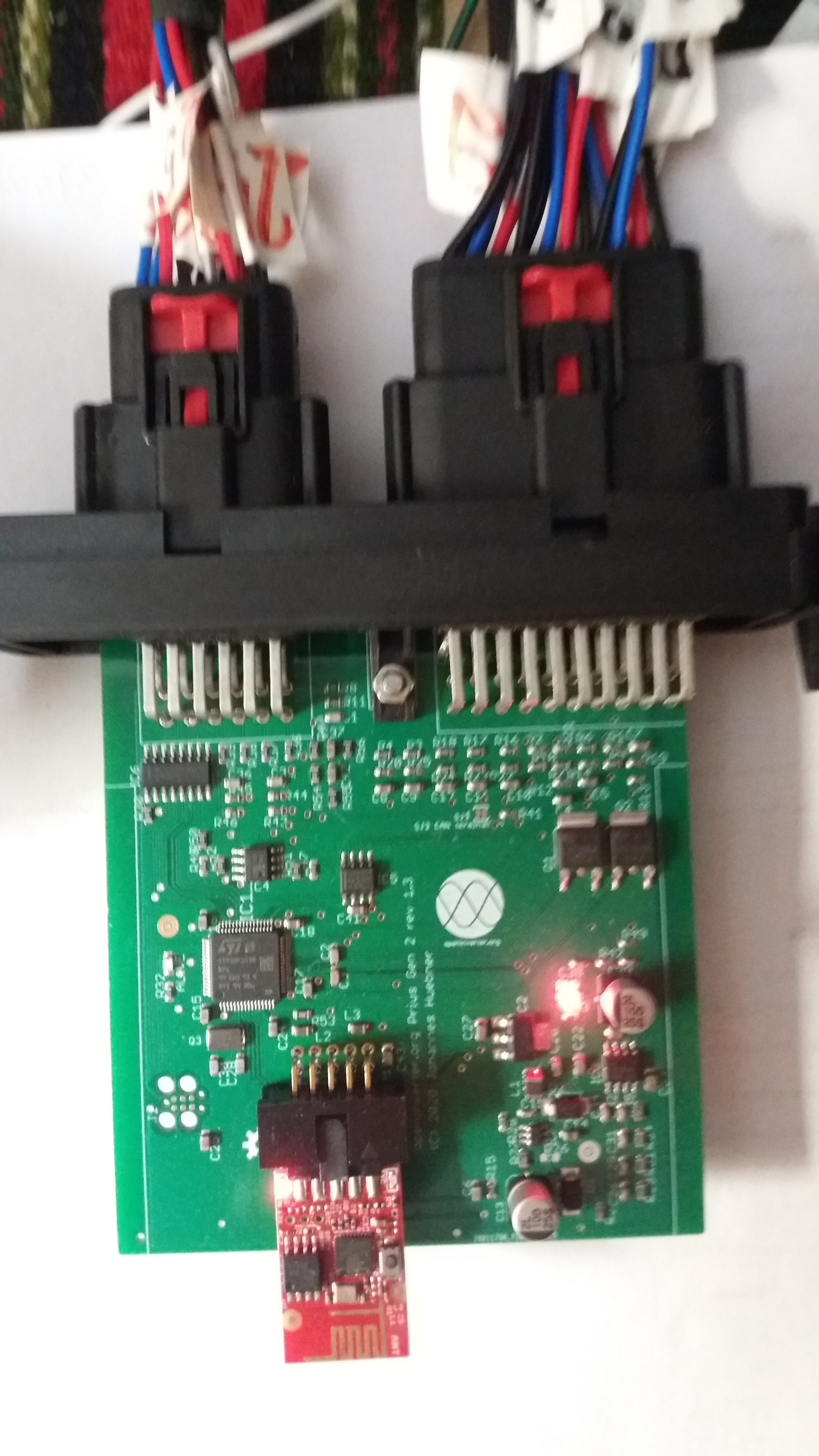

After some uploads of the sine/ foc program versions the blinking light on the board ceased work.
I am able to go to the website ,but without parameters.
Is the board clogged or damaged?

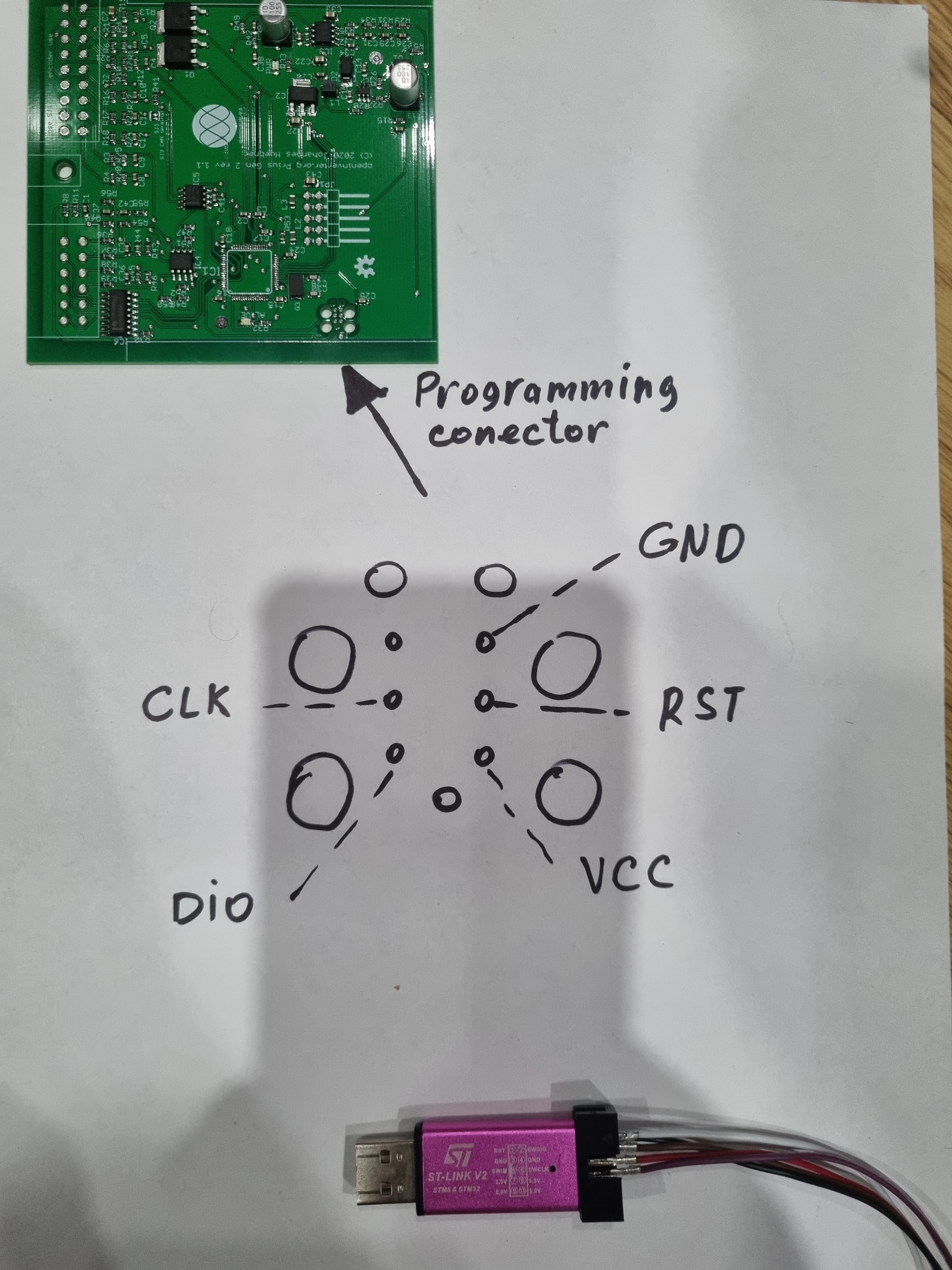

ST LINK V2
ST LINK V2
ST LINK V2
Here is the jammed VCU board .
Should I preprogram the board with the ST- LINK V2 to free it from the program`s clogging?
How could it be done then , where there are not pins but microdots for connecting to the board? Do You have one other special connector ?
Jmmed VCU board
Jmmed VCU board
Maybe first try to update over the web interface again, that should also repair it. Otherwise solder thin wires to the spots
