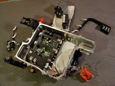

Tidbits of progress:
- Arber333 helped me clarify what type of Schottky diode I need. Also, on Damien's Prius Gen2 DC board, he has a similar reverse-polarity protection diode that's rated 40V and 5A. I couldn't find anything at Digikey at either 4a or 5a, so I went with a 3a, which Arber said should be all that the board needs. Maybe I'll stack two in parallel for whatever that's worth (they might not share equally, and unlike resistors that have a negative temperature coefficient [when they get hot, their resistance increases, self-balancing parallel resistors] diodes can be neutral or positive, but it's not going to hurt). It's only to protect you from being an idiot and plugging it in backwards, and presuming you're powering it off the 12v, you might only see 15vdc total on it, so, 40v is lots of overhead.
I think that's the last step of electronics I need before ordering.
- I believe the main Gen2 inverter plug I'm missing is a Toyota Part #: 90980-12153. Haven't found a place to buy it yet, but that seems to be the case. Source: https://attachments.priuschat.com/attac ... agrams.pdf -- Massive wiring diagram on the Prius Gen2. (Connector I10, page 393. Confirmed by page 379, and a few other places in the labelled pictorial diagram). Measured it today, The plastic width is 1.5" (38mm), which, for a 16x2 connector by the time you get through two pieces of plastic (3mm per side, so, 32mm of pins), might be 2mm pitch? [Edited 2 months later to add, it's not 2mm pitch, don't buy something with 2mm, the part number is later in the thread]. Maybe I could find some equivalent connector to temporarily scavenge. (Digging through my parts bins, it looks like old laptop IDE drives have a 2mm pitch [18pin, instead of 16, but I can cut it short], and usually had these little strip connectors to mount them to the actual laptop motherboards, one of those [or two, if the vertical spacing needs shimming] might do the trick in a clumsy way).
Regardless, unless Digikey has something comparable, I'll order my parts and start the assembly.
Next up, Damien's Github has 32 screw terminals for wires to connect to, and both his board and his schematic have them labelled... but... there's no description of what they are, what they're expected to be, whether they have to be there or not, or which wires those are on the actual Prius connector.
There's also no supporting documentation showing the pinouts of the 32-pin 90980-12153 connector.
Now I presume Damien must have these because he wired it up and got it working, but, I can't find docs for them. Anyone happen to know those pinouts and expected connections offhand? I'll spend a few hours looking but I figure someone might just have a reference handy.
Baby steps.

Close to testing time!
- At Johu's suggestion, fleshed out the wiki on the Prius Gen 2 logic board, and Damien filled in most of the wiring blanks: https://openinverter.org/wiki/Toyota_Prius_Gen2_Board
- Added some pinout pictures and documentation as best I can understand from Damien's new notes on the wiki: viewtopic.php?p=4765#p4765
- I don't have a big battery pack but I do have a 10A variac with an FWBR I can attach, and, presumably turning that up slowly will charge the capacitor bank on the inverter sufficiently slowly. It should also mean that, despite rectified AC being a poor imitation of battery DC, I won't need a large cap bank on the power supply. 120v mains will be good for ~170VDC and that should be plenty good enough to test if I can get a motor spinning.
- My "small" motor 100lb motor presumably has an encoder or something on it, it has these light gauge terminals:
No idea what all 6 pins are for or how to wire them to the encoder pins on Damien's logic board though (logic board looks like 4 pins: +, gnd, Encoder A and Encoder B... but, which those might be on this motor?) Maybe the 2-pin connector on the motor is a temp sensor, and the other 4 are the 4 I need for an encoder?
- Time to program my Blue Pill and see if everything explodes.

MattsAwesomeStuff wrote: Wed Jan 08, 2020 10:41 am I don't have current sensors. I might have an ammeter with a shunt, but, nothing for the inverter.
Could I get some from a Prius or are there some inside the Inverter already?
Well there two sensors inside inverter. I think...
Those white plastic looking things around power rails are sensors. Sometimes they are two, some inverters have 3.
Thay should connect to your control PCB with Bluepill.
You can actually run ACIM motor without them. ;)
You just have to tweak inputs so inverter does not know they are gone. But i wouldnt advise it.
